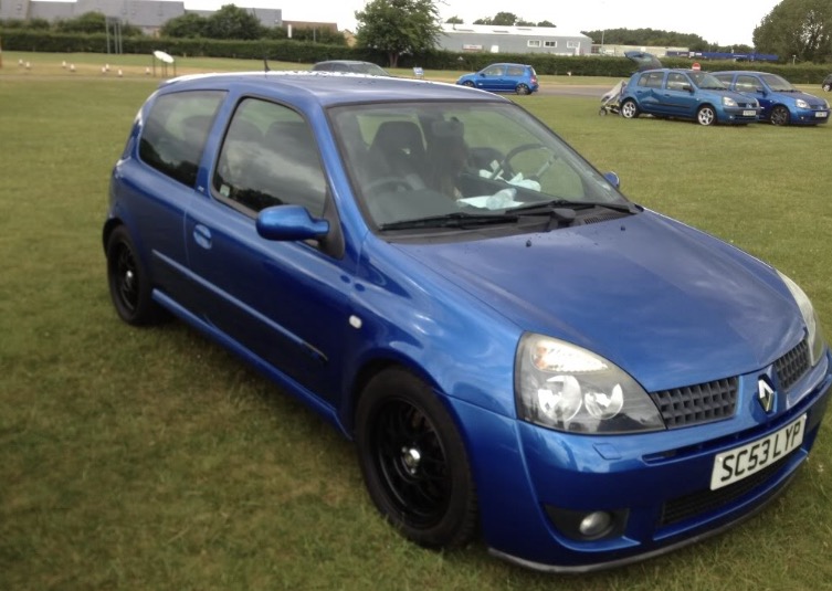

I thought I would start a project thread for my old nail.
I got it from my brother who had kept it 5 years and covered 20k in it but didn’t believe in condoms so child number 3 meant he could have a grand scenic instead ?
£2000 later I had a FSH 54k cup ?

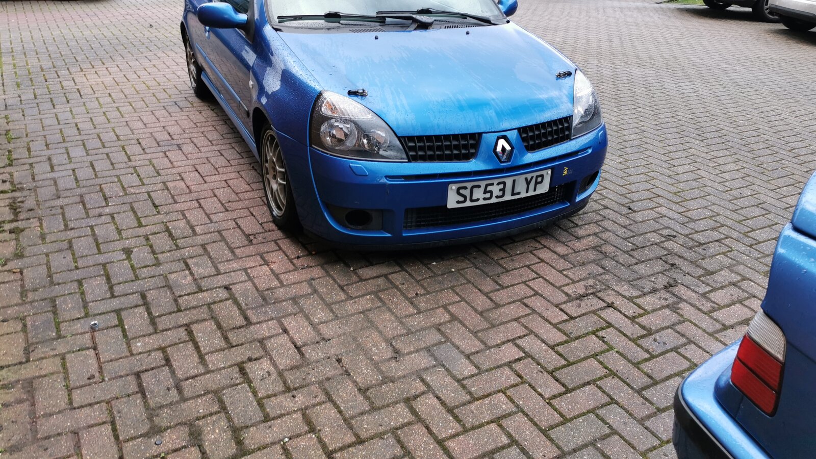

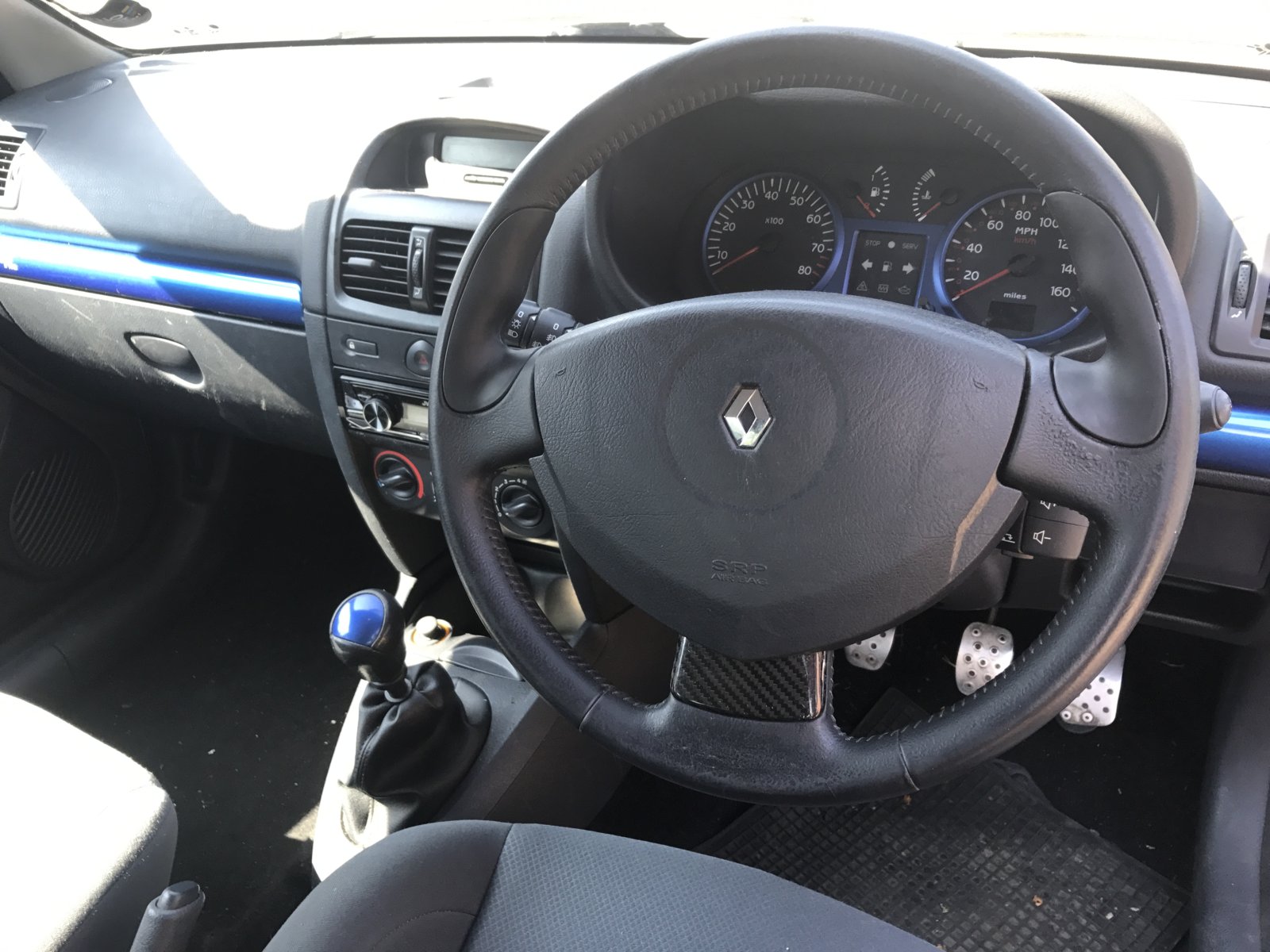

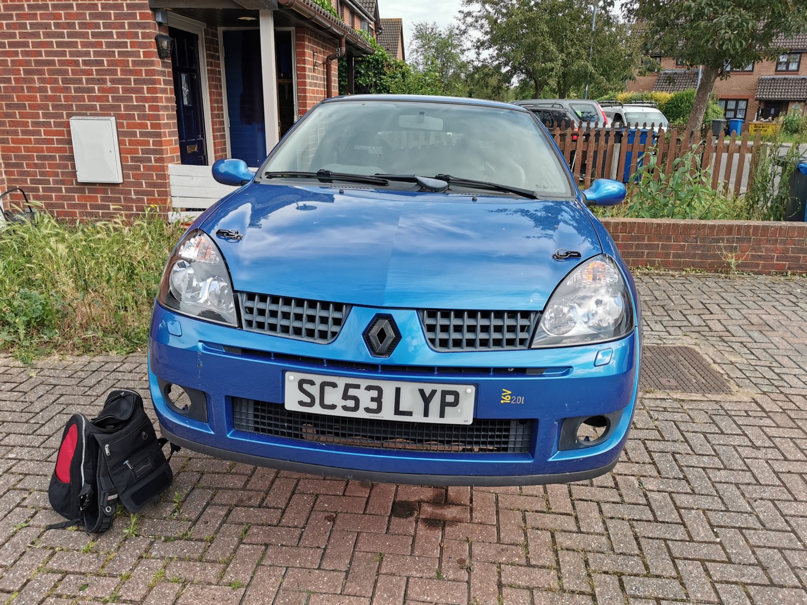

Anyway here is what it looked like before he was completely broke so in its prime

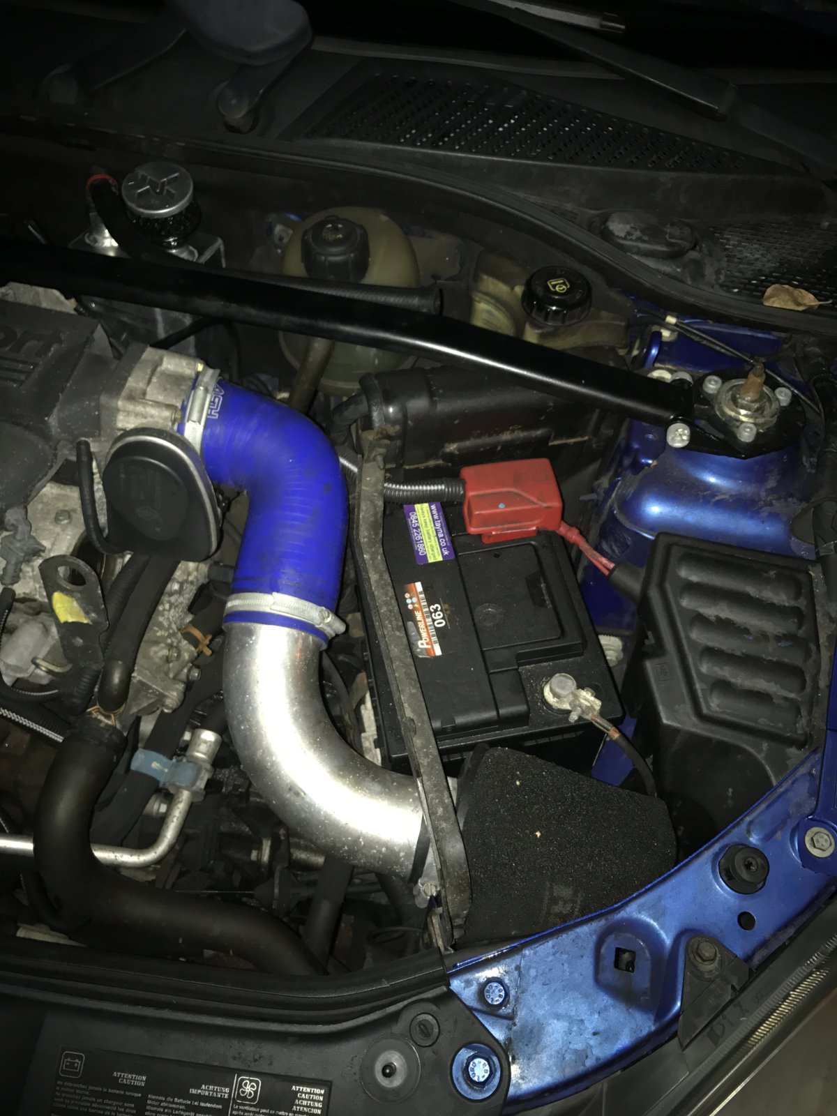

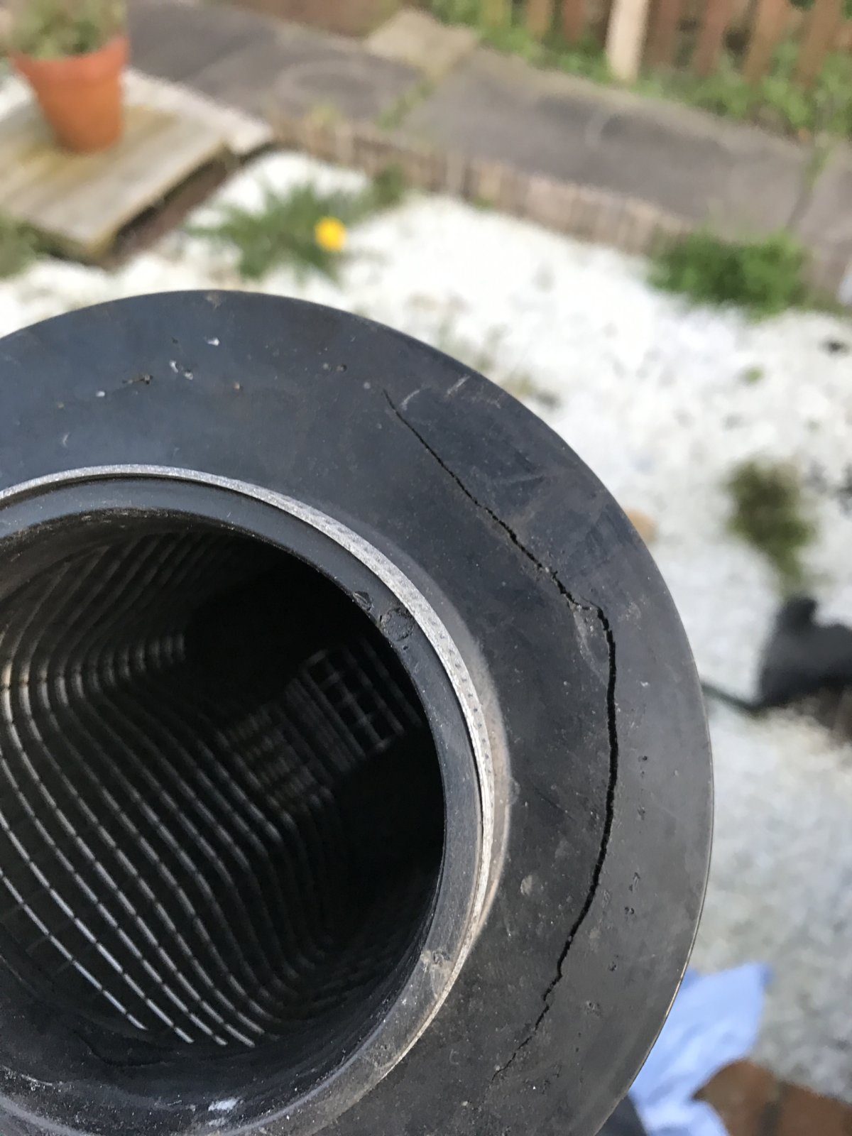

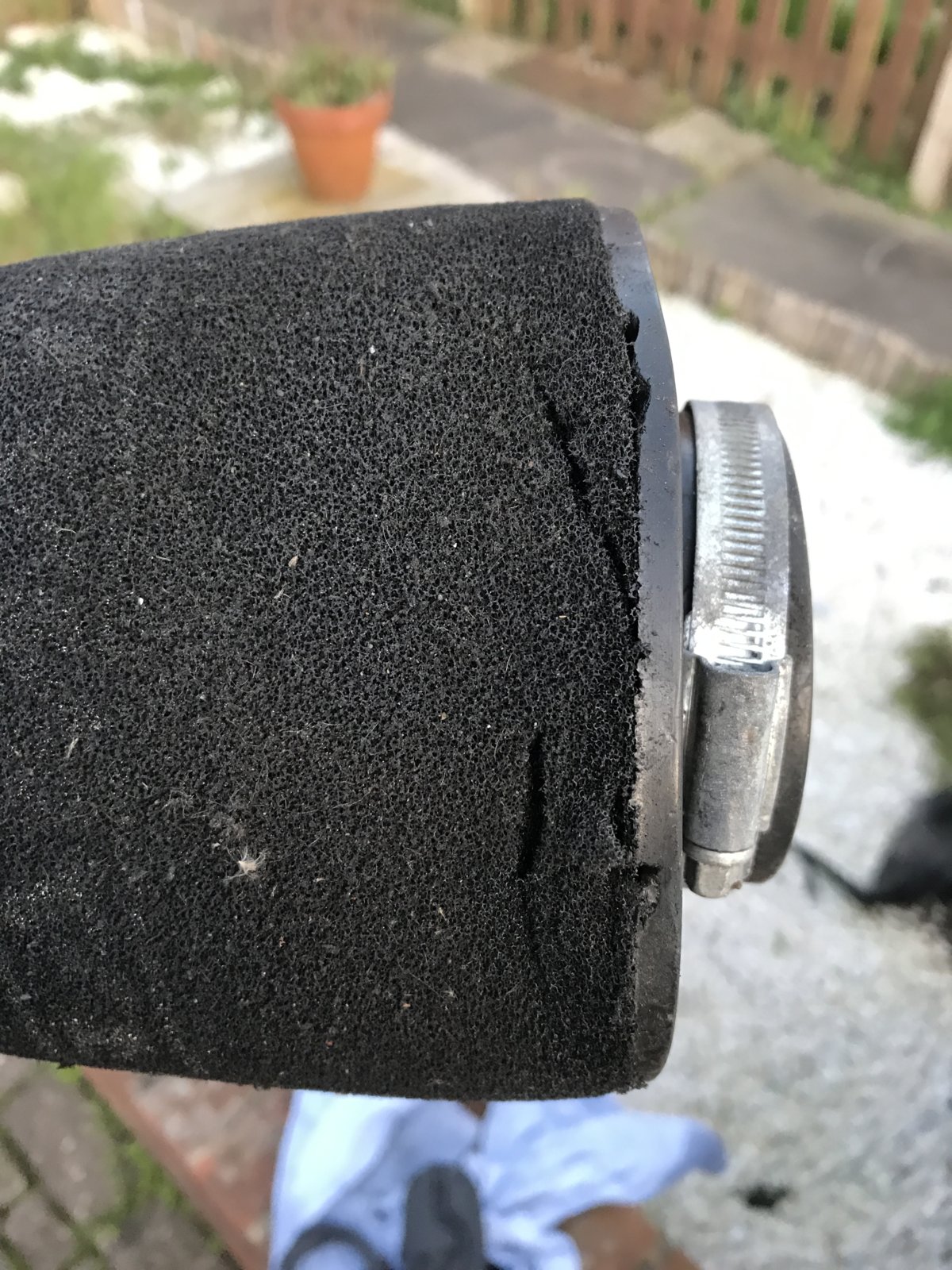

I then started to try and clean it up a bit and sort out stuff that had been not sorted as financial issues for my brother.

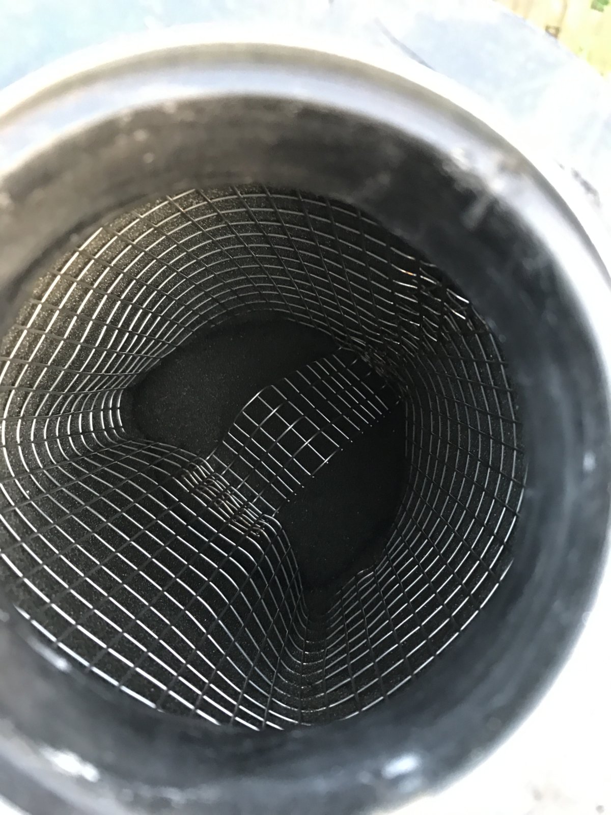

First up was the induction kit that was in a bit of a state.
1412420
1412421
The filter was destroyed inside and glad I caught it before my engine decided to eat it.
1412422
1412423
1412424
Painted it up and stuck a new filter on but plans will be to change it when I done the engine works planned

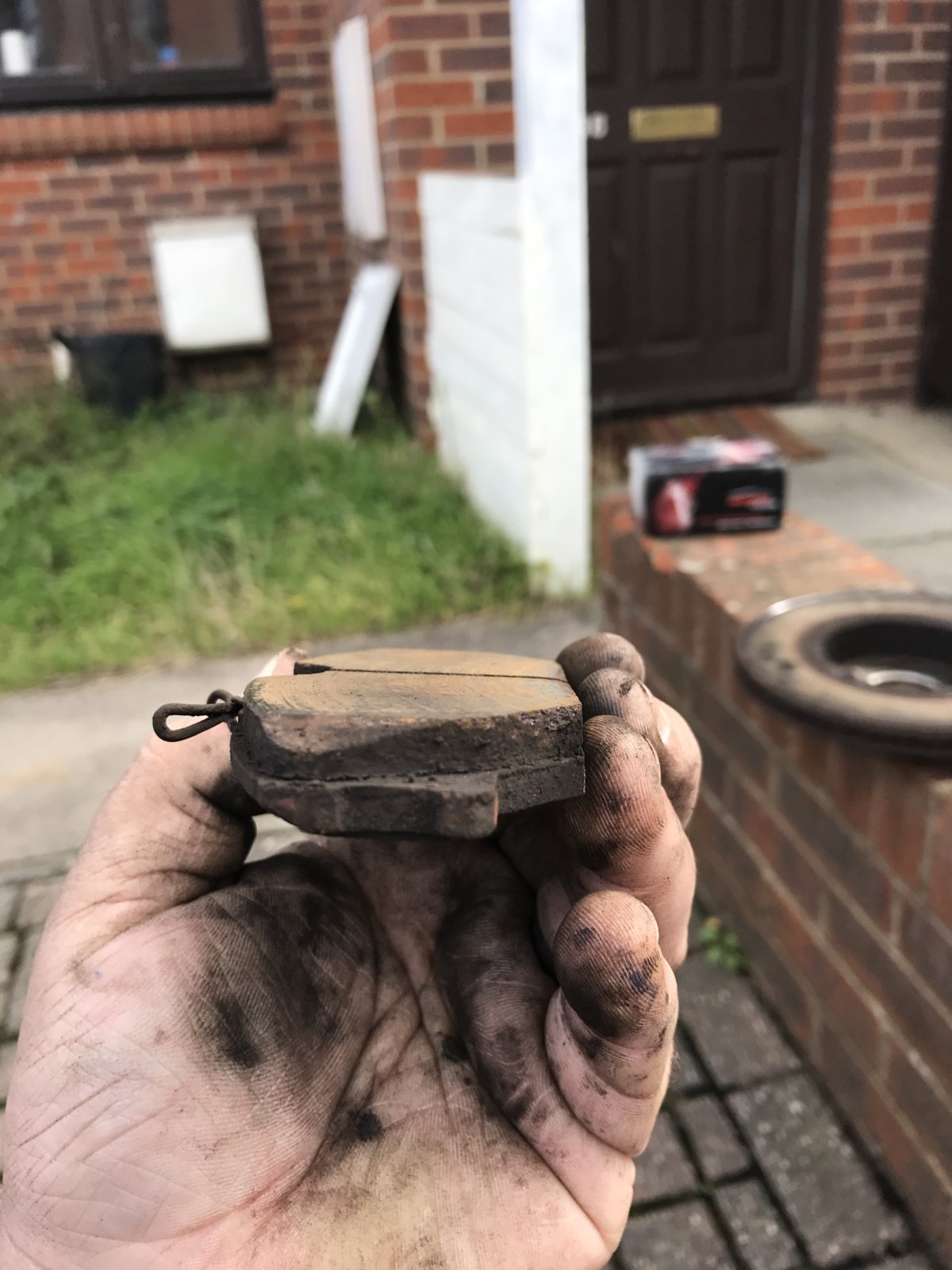

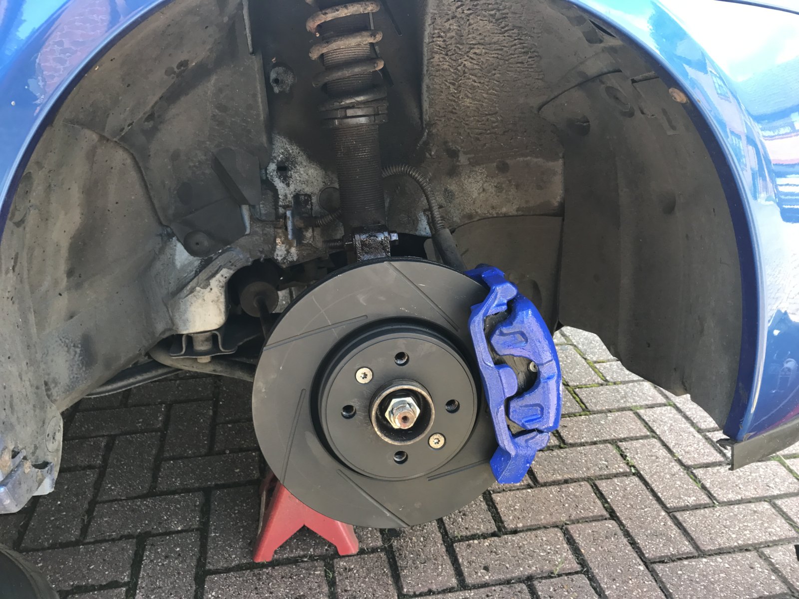

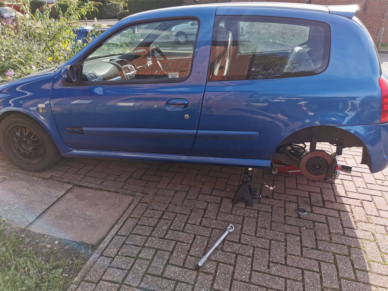

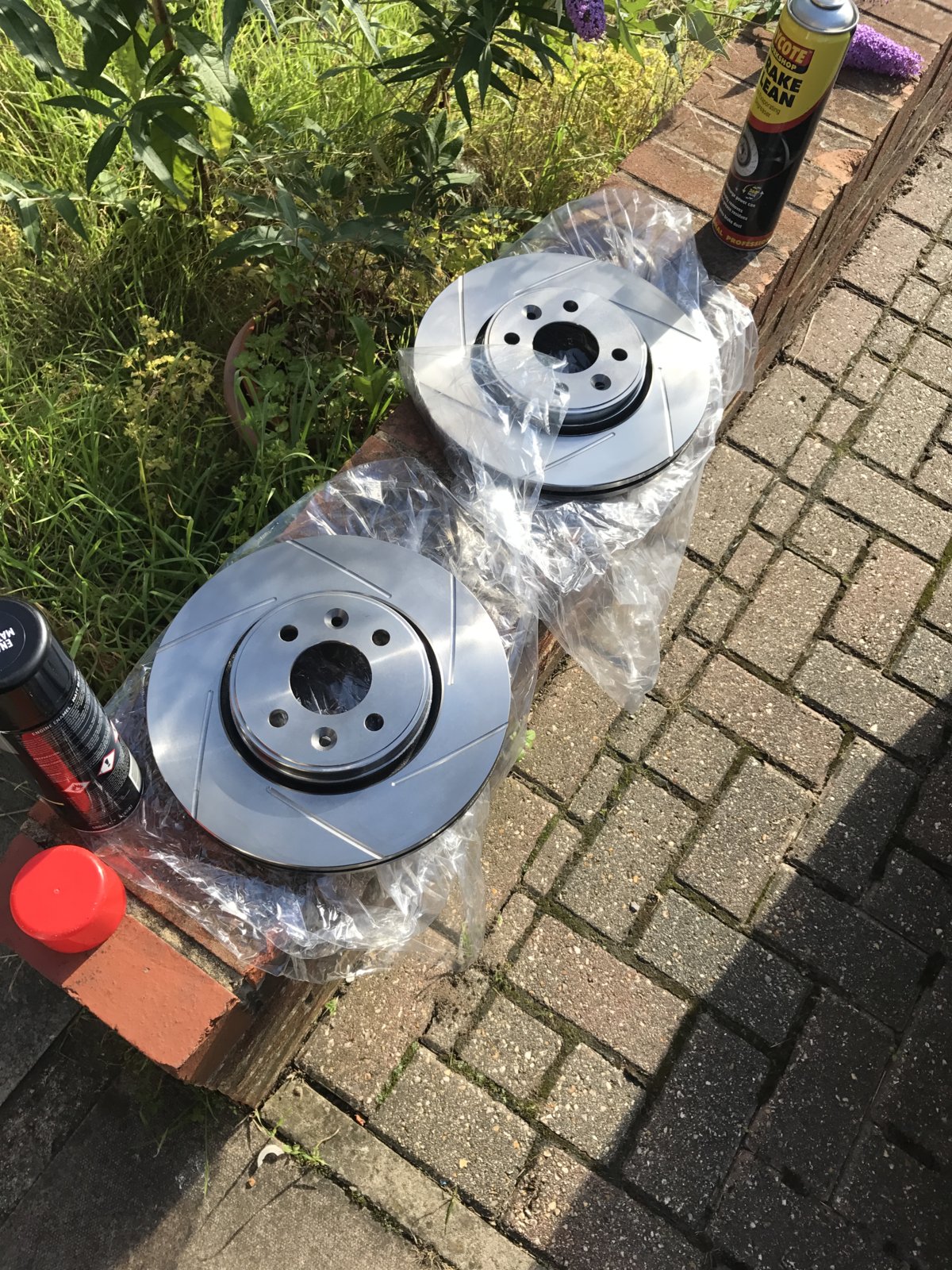

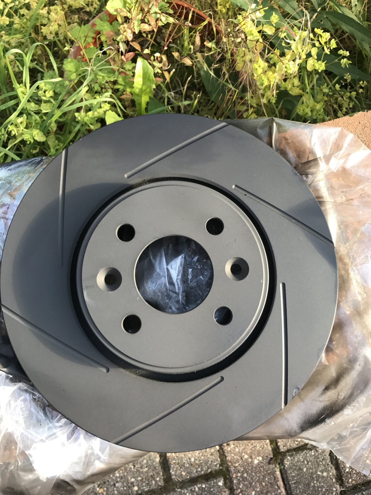

Next up the brakes

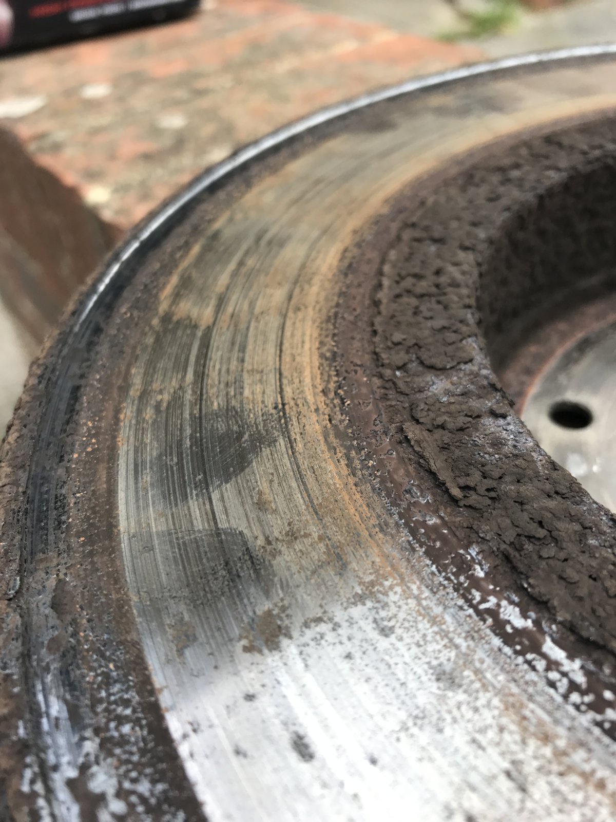

Ever since I got it I found the brakes rubbish
Decided to get a fast road setup as mainly what I’m using it for at the moment .
Evora slotted discs
Mintex m1144 pads front
Standard rear pads
ATE super 2000 fluid
New seals in calipers

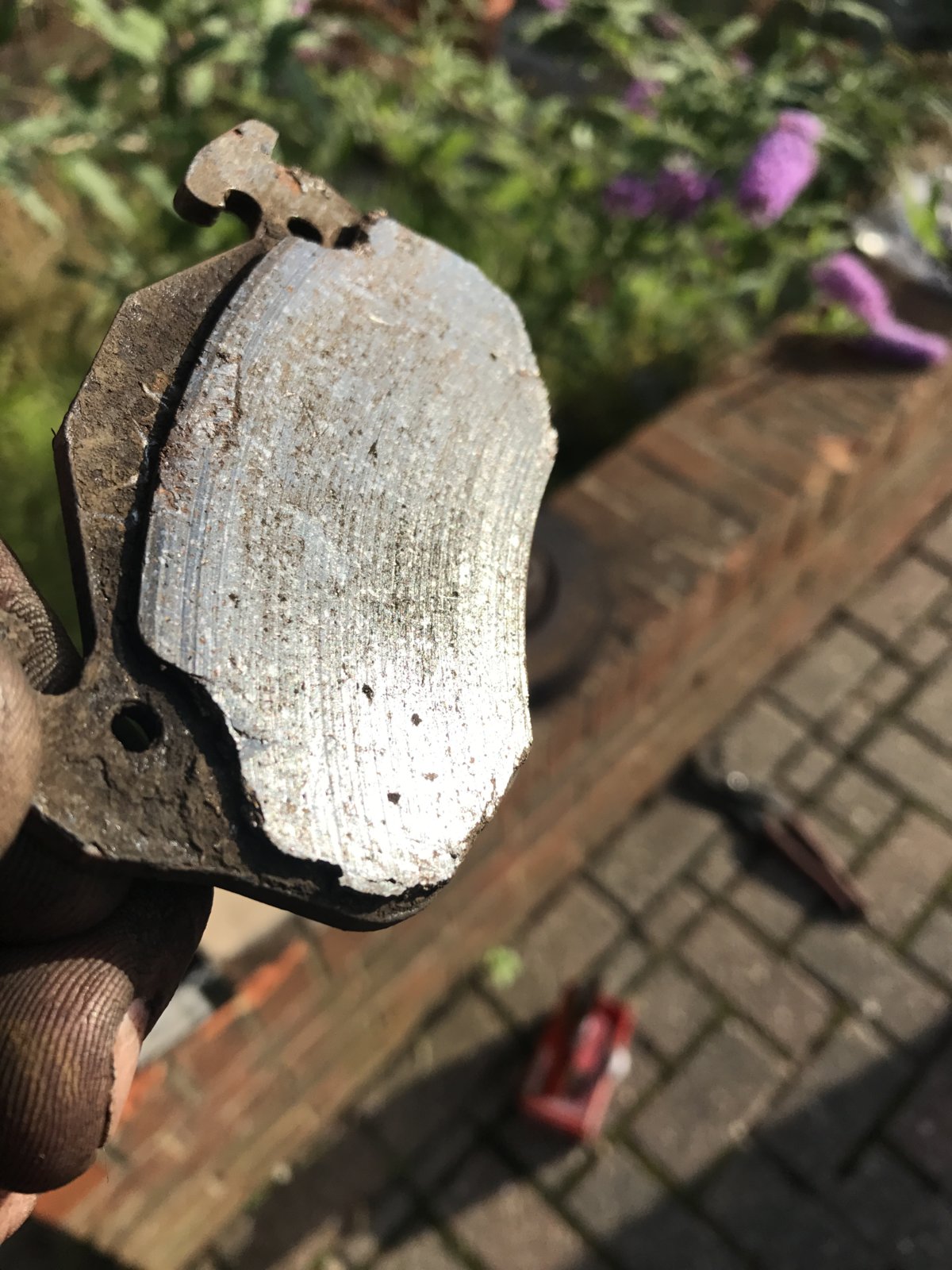

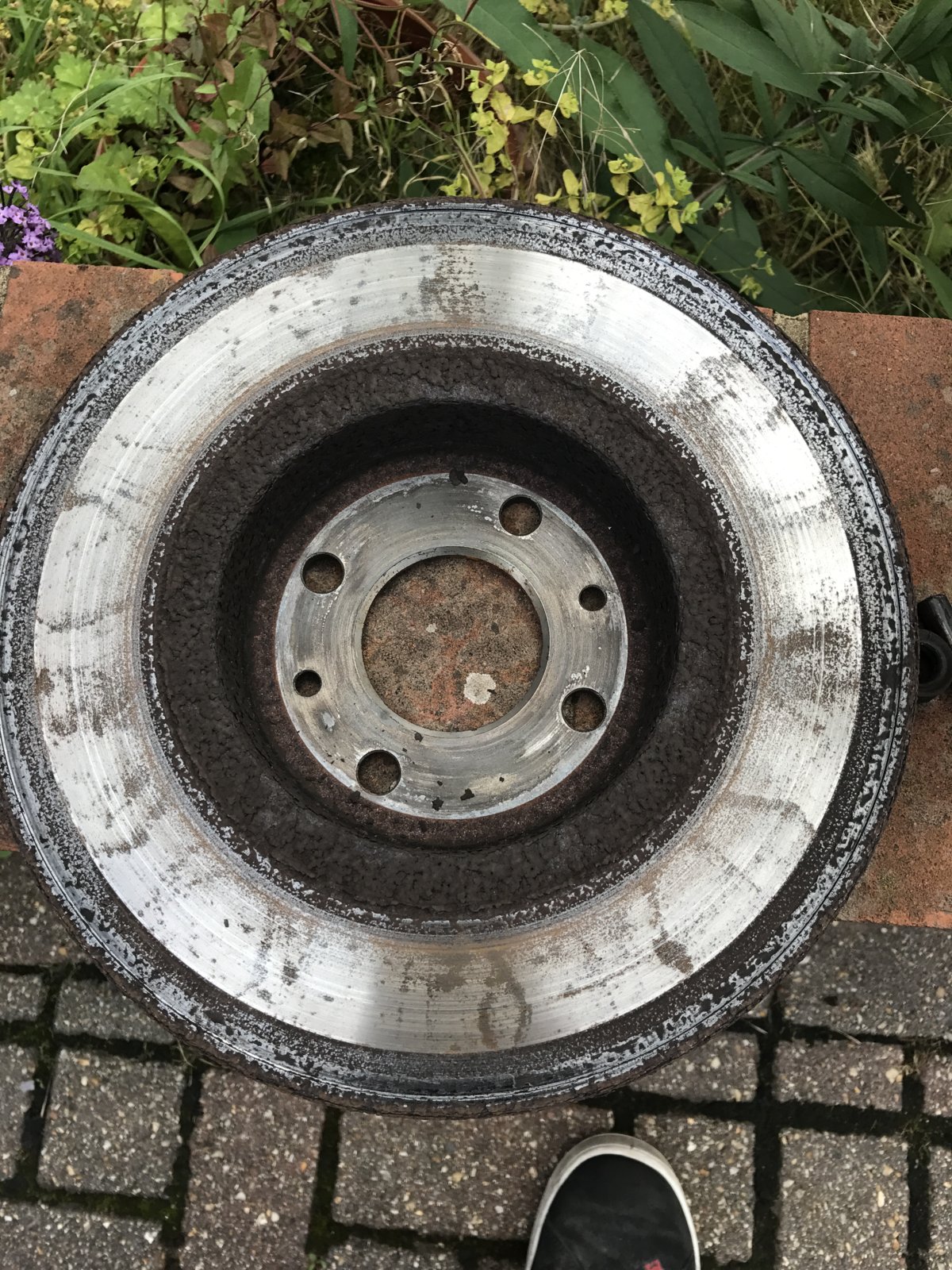

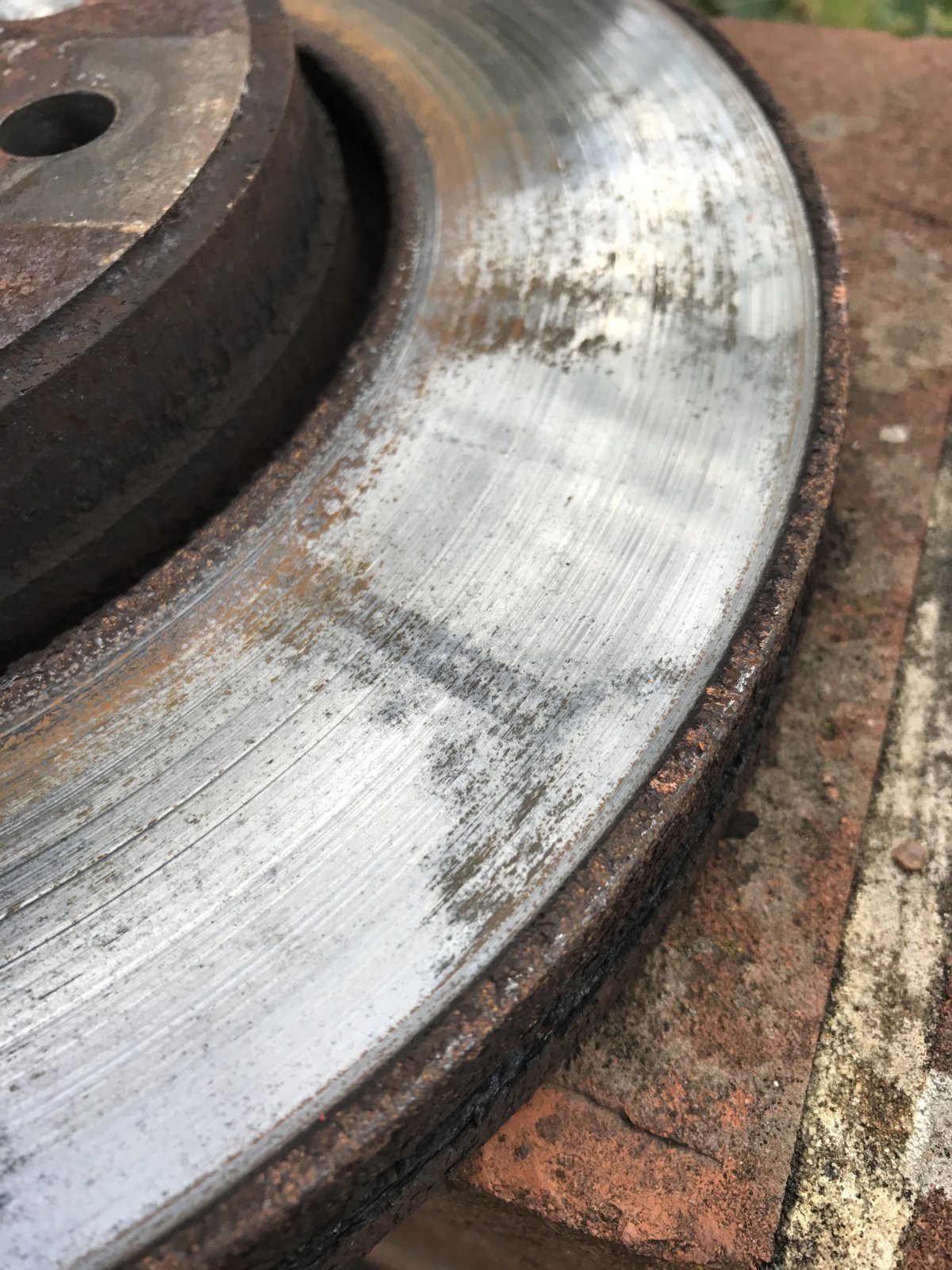

Old disks where completely shot
1412427
1412428
1412429
Pads aren’t any better
1412431
1412432
Where the sliders where seized it had wear on one pad only
Rears where to the metal.
And the new ones
1412433

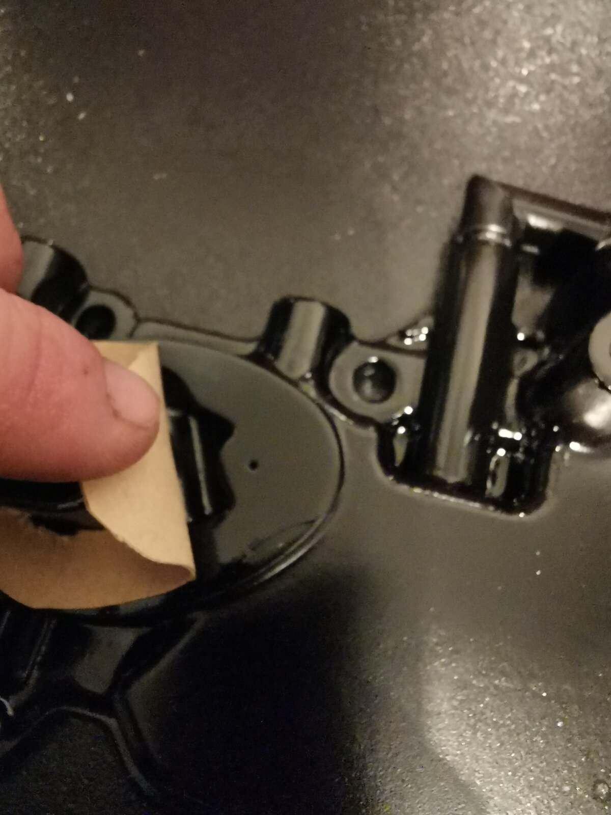

Degreased and painted in vht
1412434
New seals and painted marine blue and new sliders
1412435
1412436
Same for the rear
1412437
Brakes now on the road are very good. Bite hard from cold and can lock the tyres up if over doing it . Great road setup that’s well priced

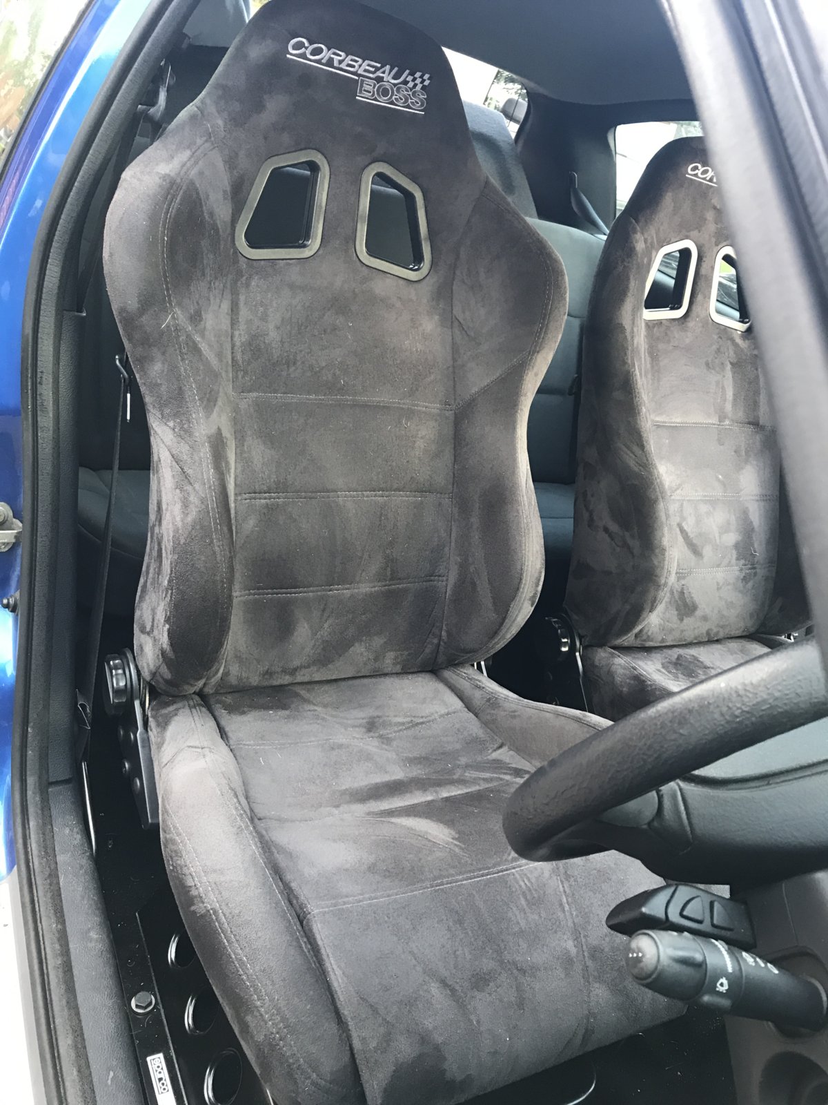

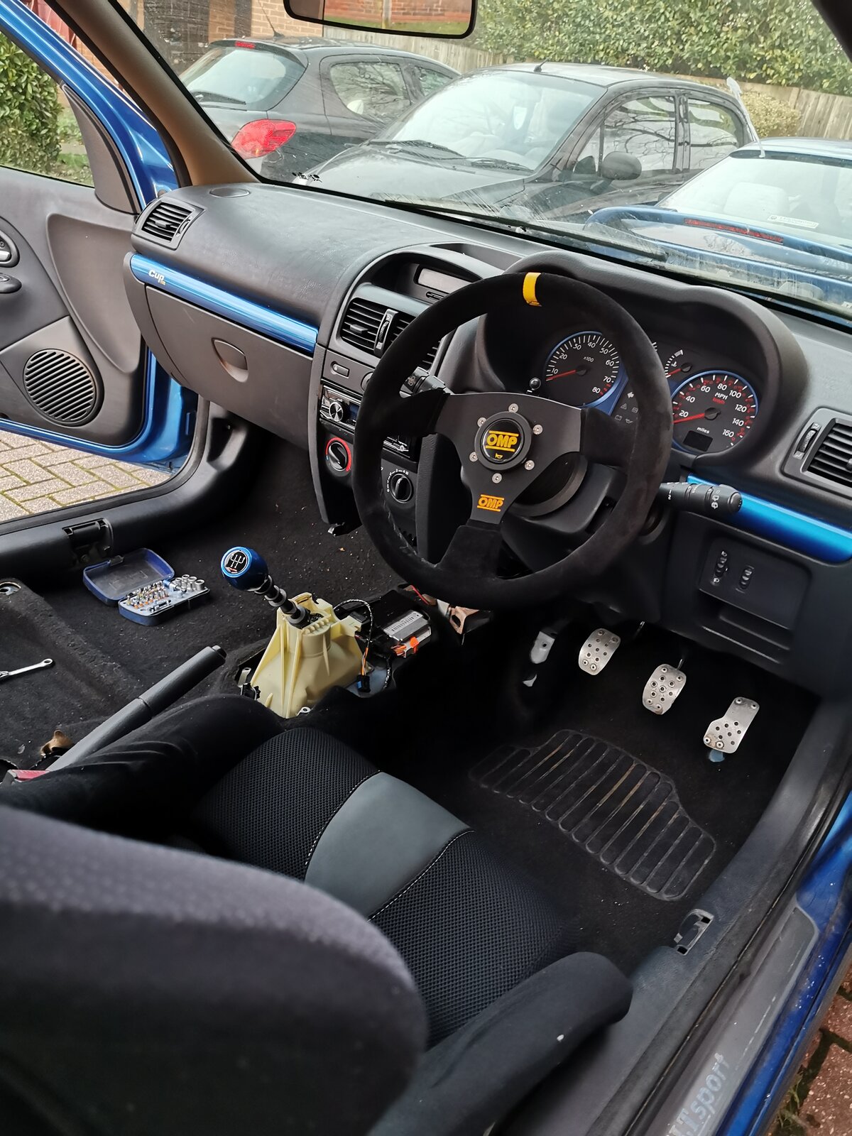

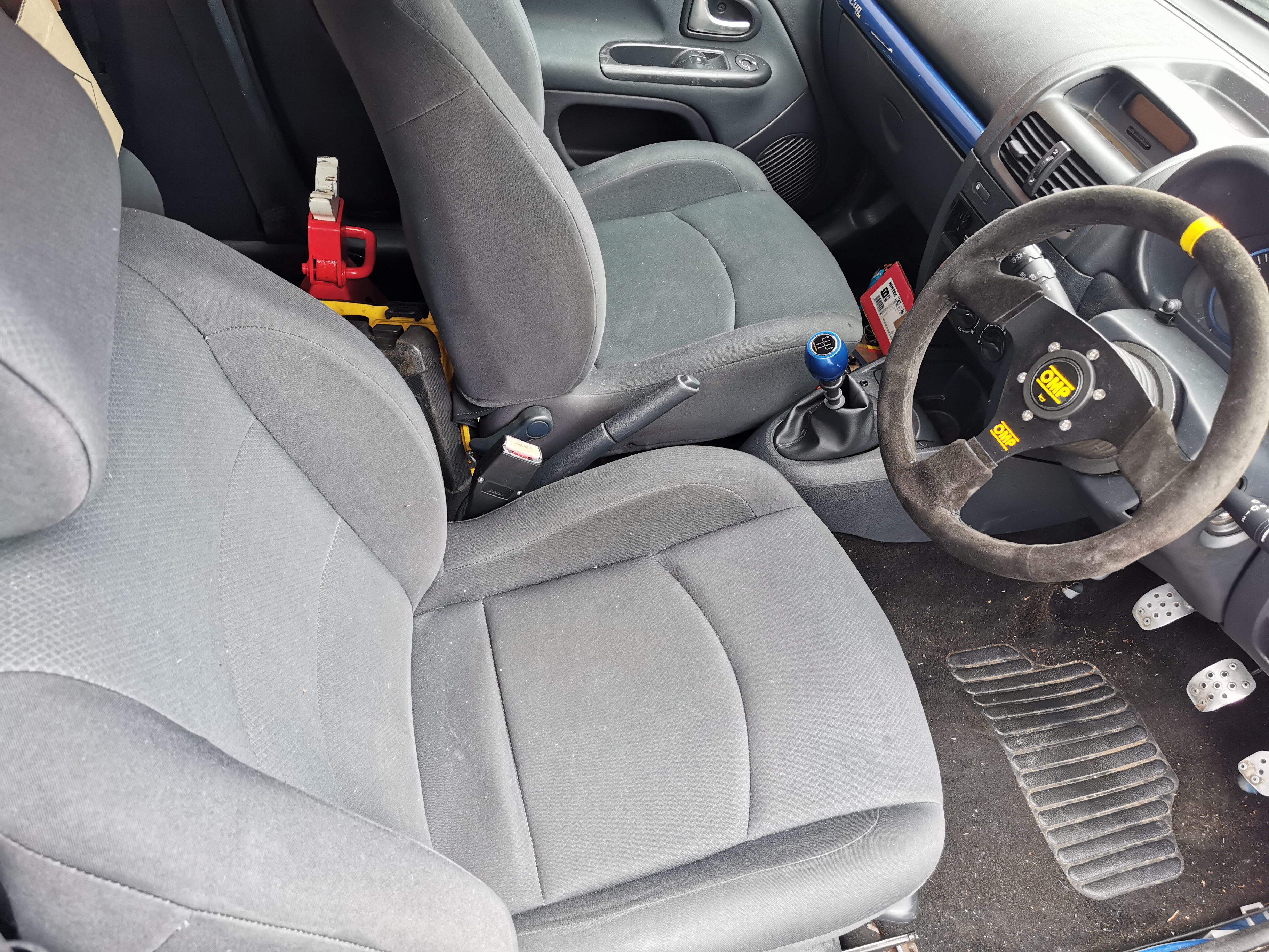

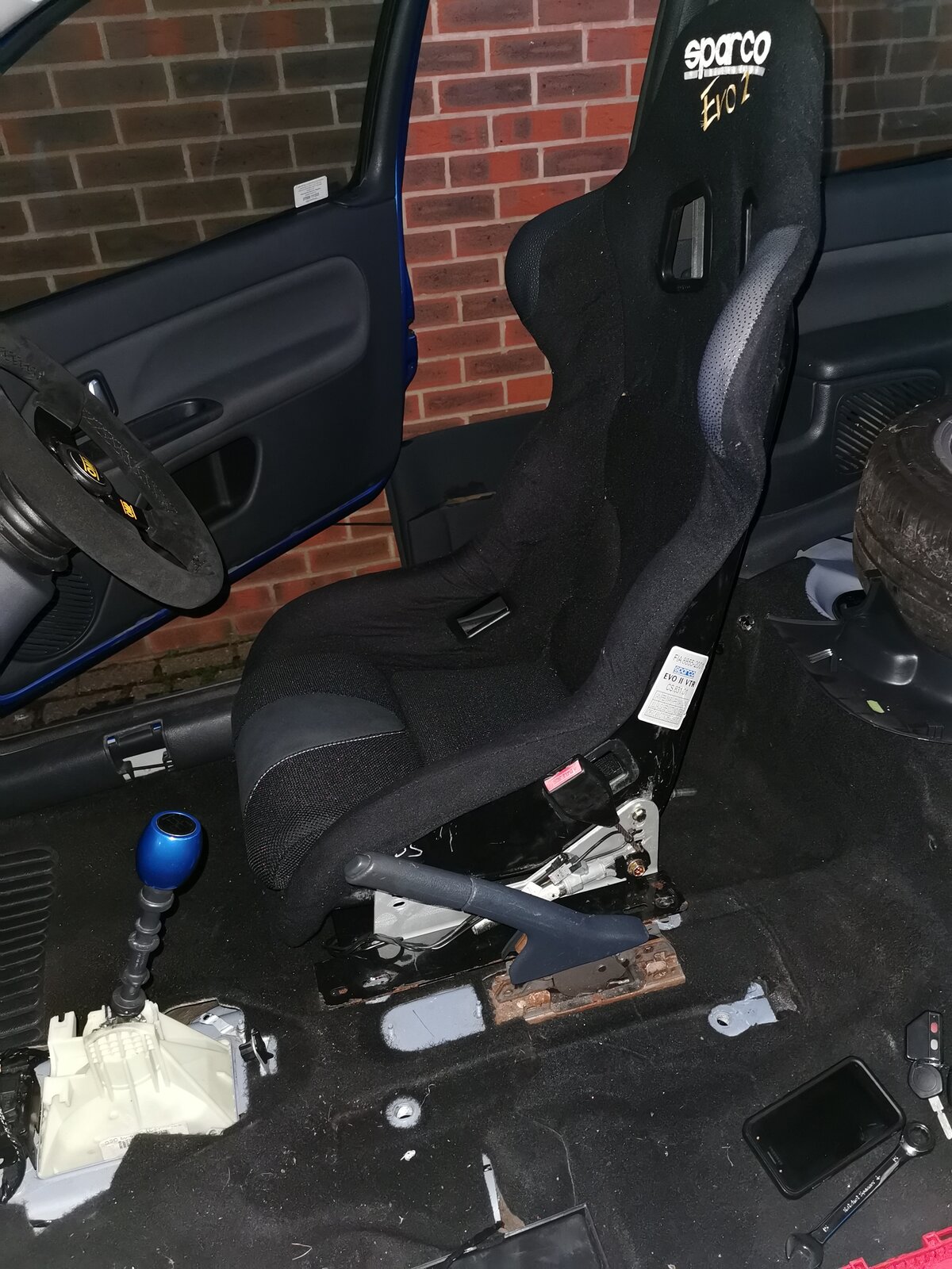

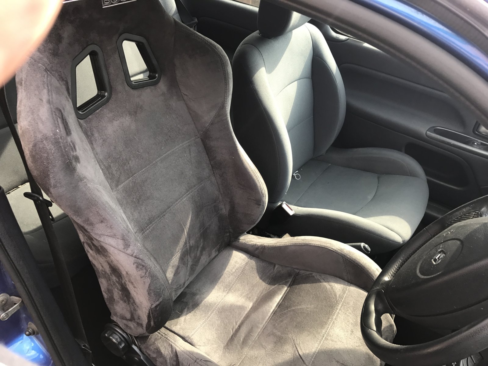

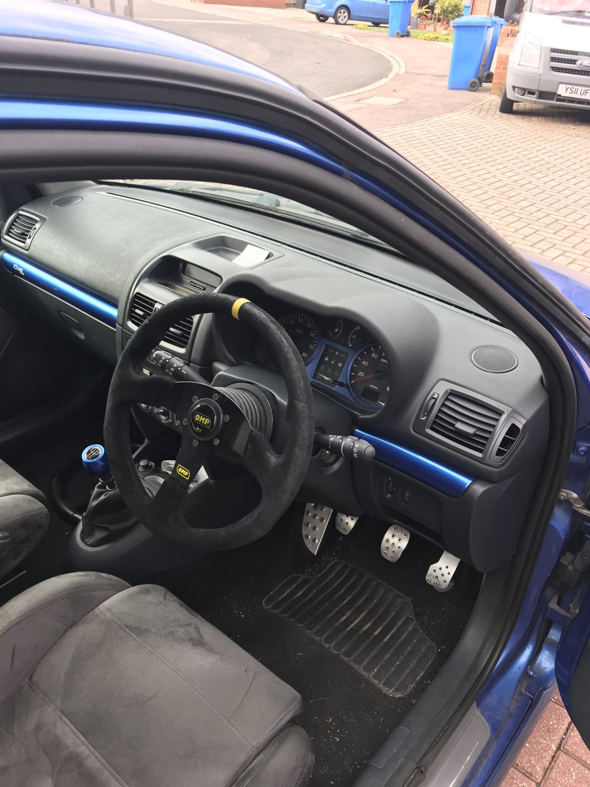

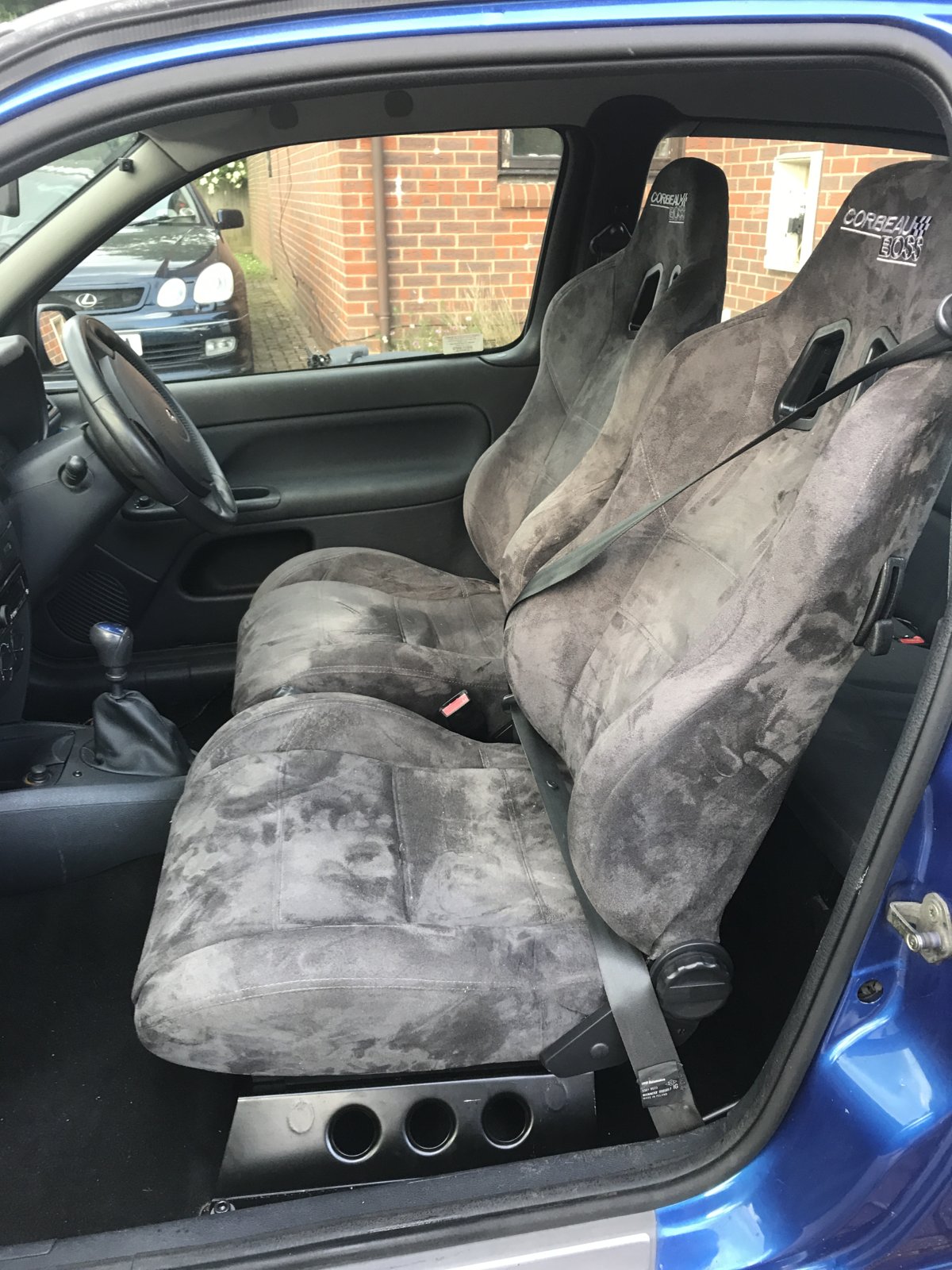

I didn’t get on with the cup front seats as they dug in my back and actually still pretty heavy.
Swapped them out for corbeau boss recliner seats as I had them sitting around.
Drivers seat on a Jon z xlow seat base and passenger on a sparco base as I didn’t like the sparco base on the drivers side.
1412490
1412491
1412492
Saved a lot of weight with these and there comfortable and allows access to the rear when I take the kids out

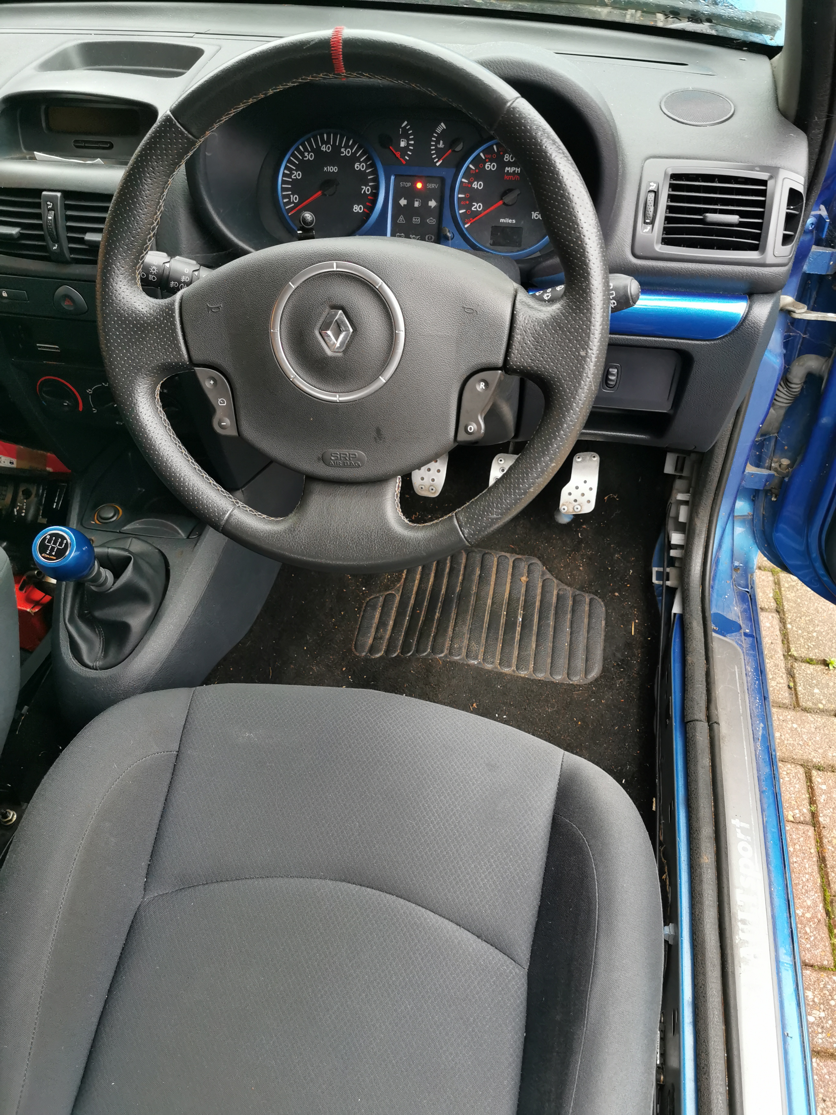

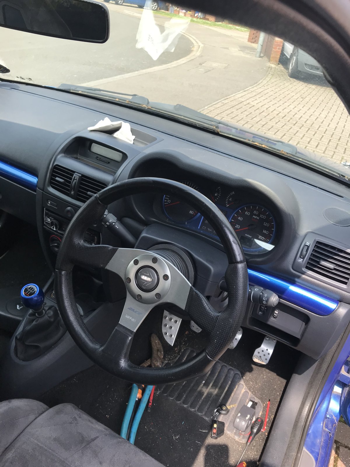

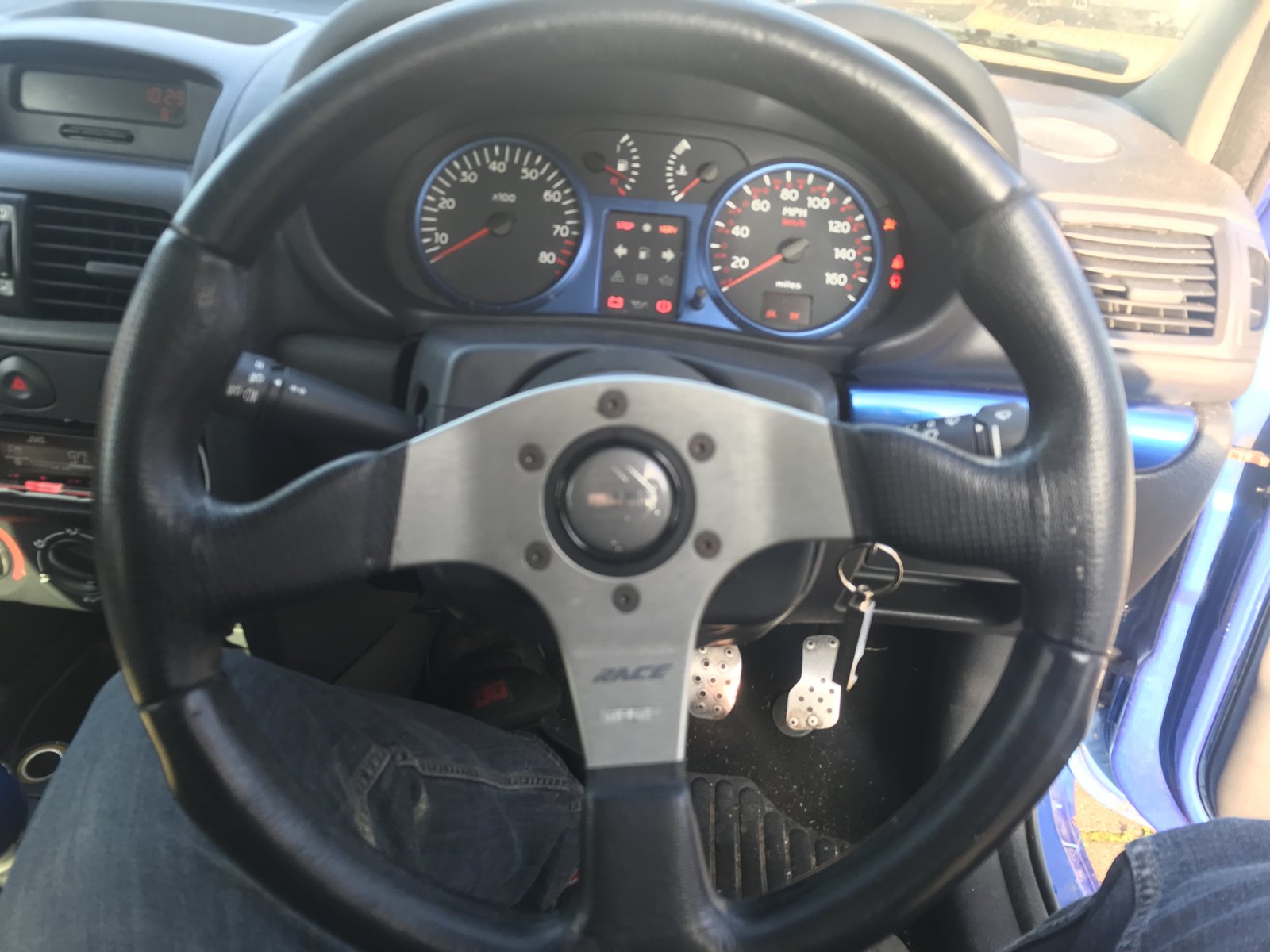

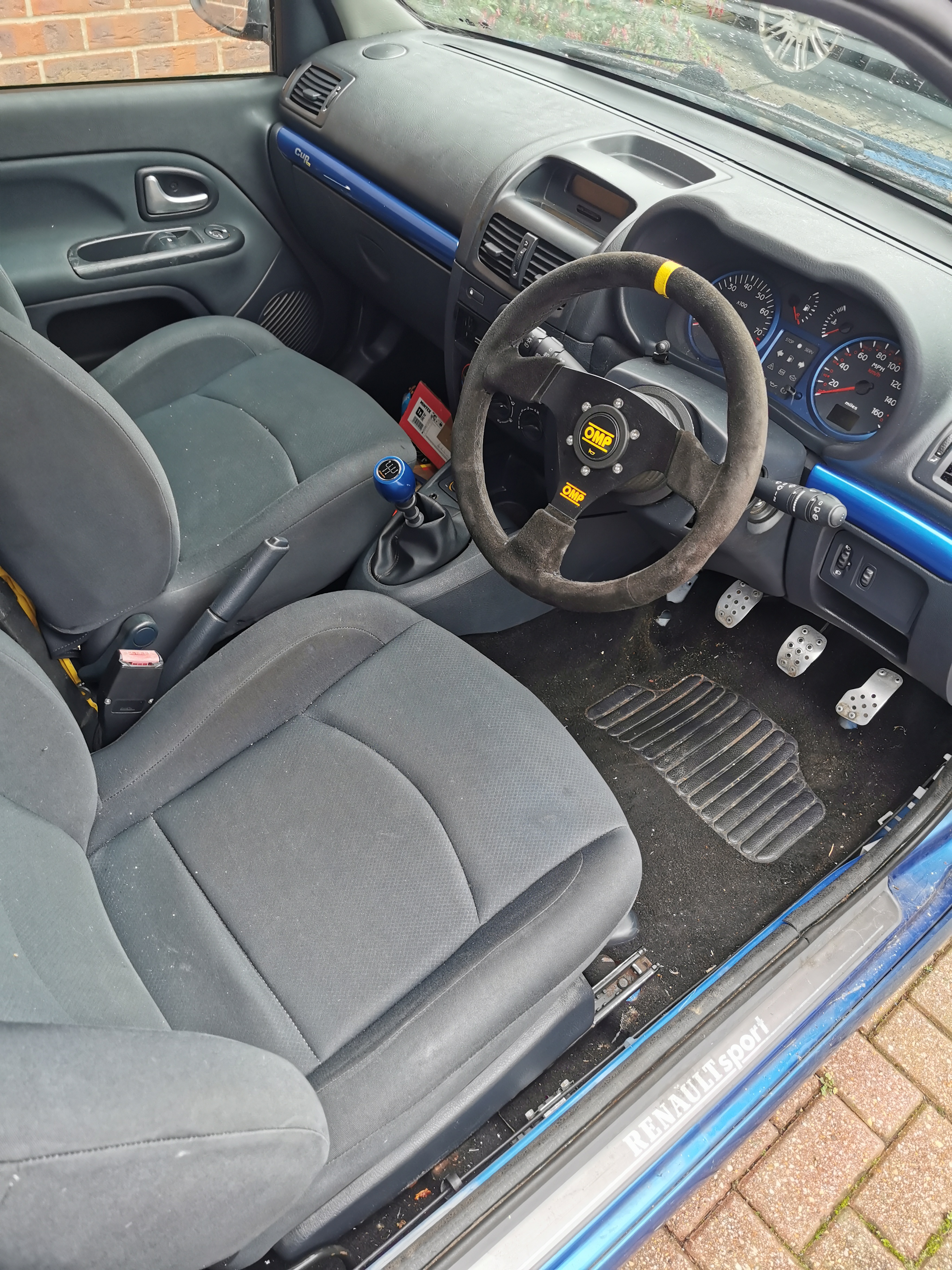

Been through various steering wheels now
Started off with a OMP suade wheel with omp boss
1412493
Turned out to be fake and soft as shut so as it was dangerous it went in the bin and put a momo race wheel in I had in the garage
1412494
1412498

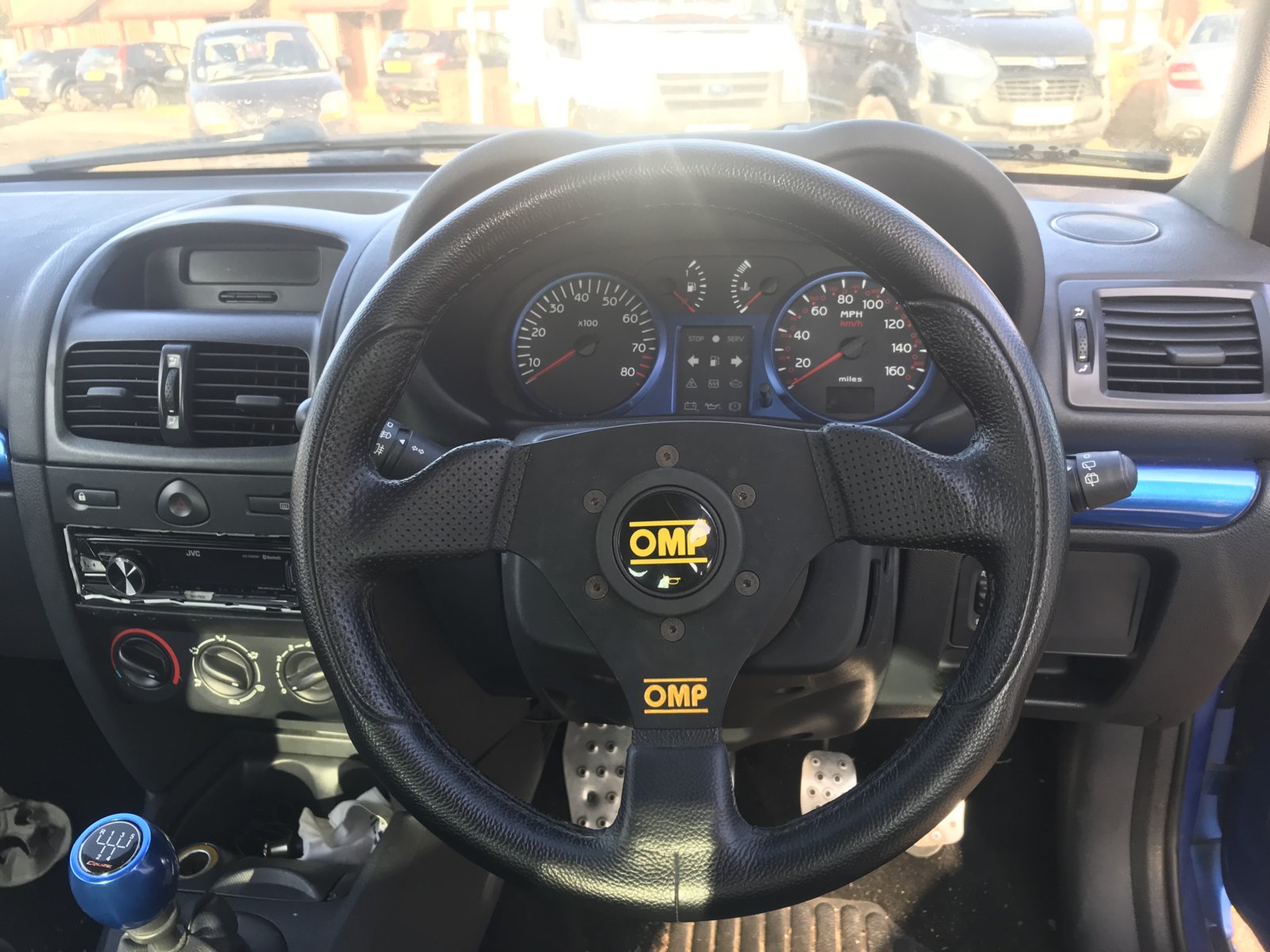

Didn’t like the feel so I got a genuine OMP 300mm steering wheel this was 300mm though
1412502
1412503
Decided that 300mm was to small for my club hands
Also wanted another suade wheel
Now I have a motamech 350mm semi dish suade wheel, tiny bit big but feels great and excellent quality
1412504
1412505

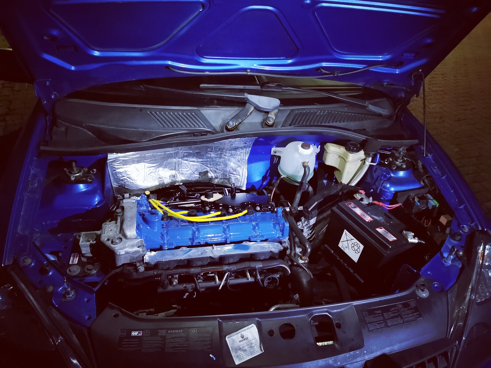

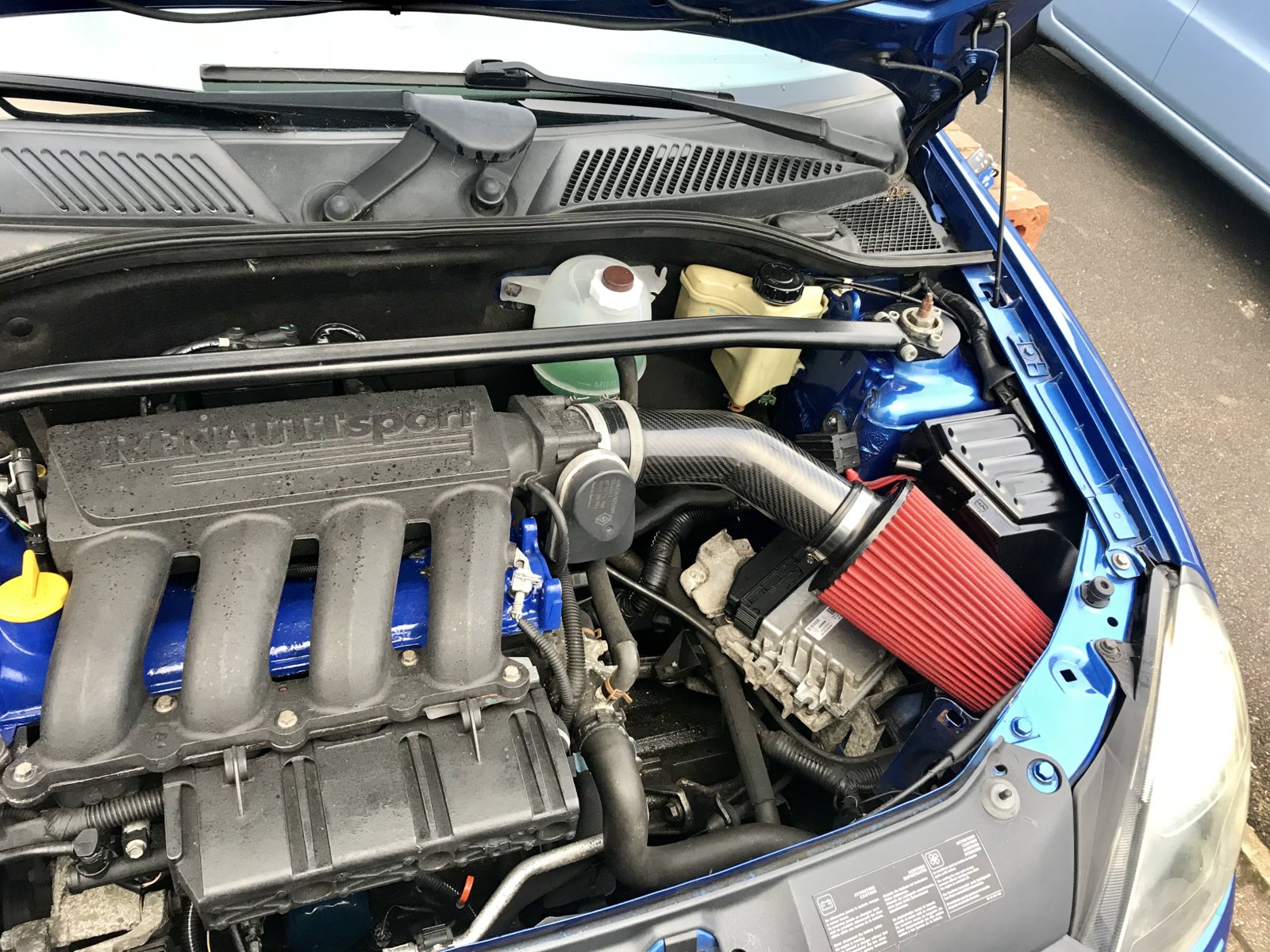

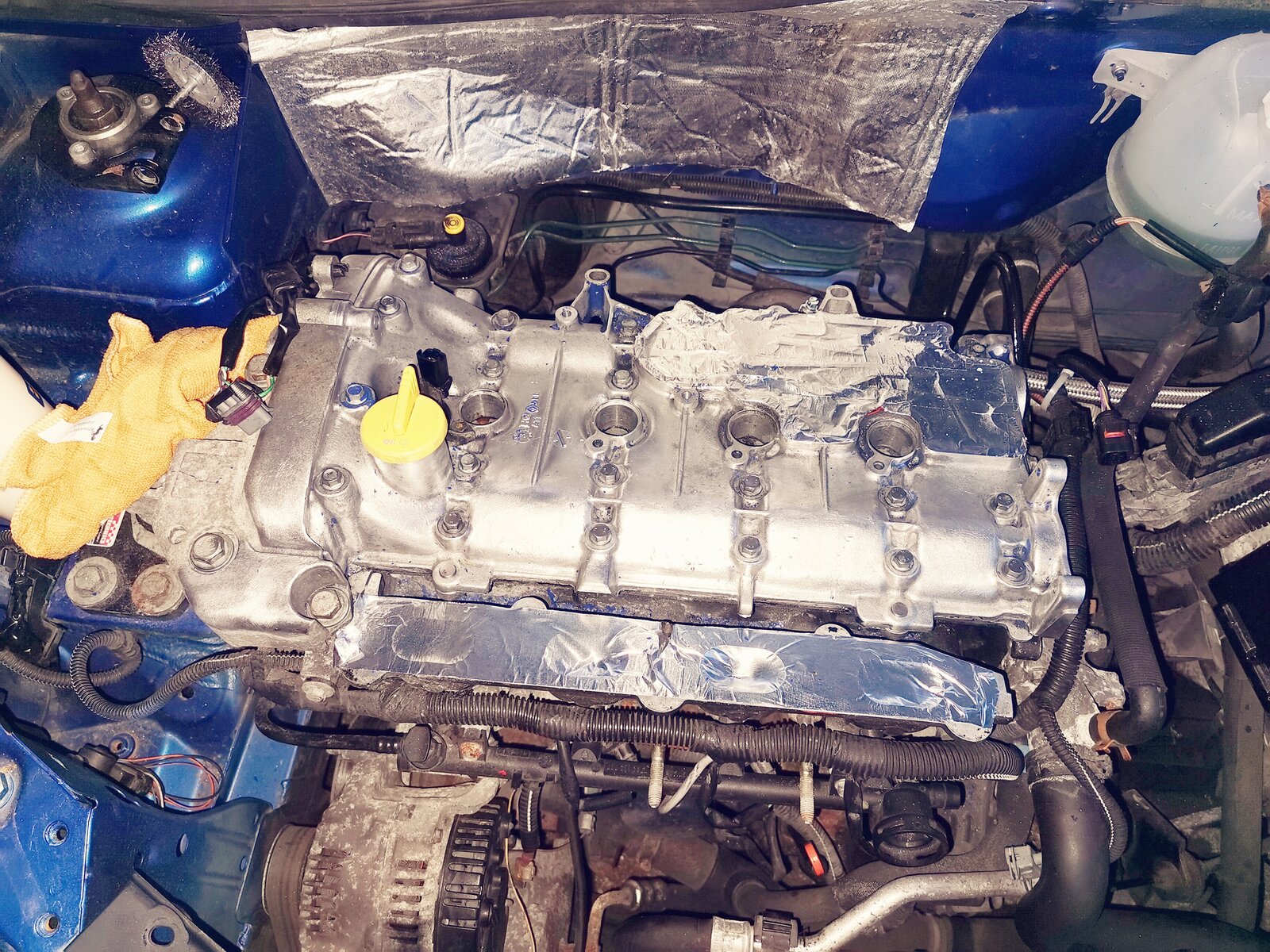

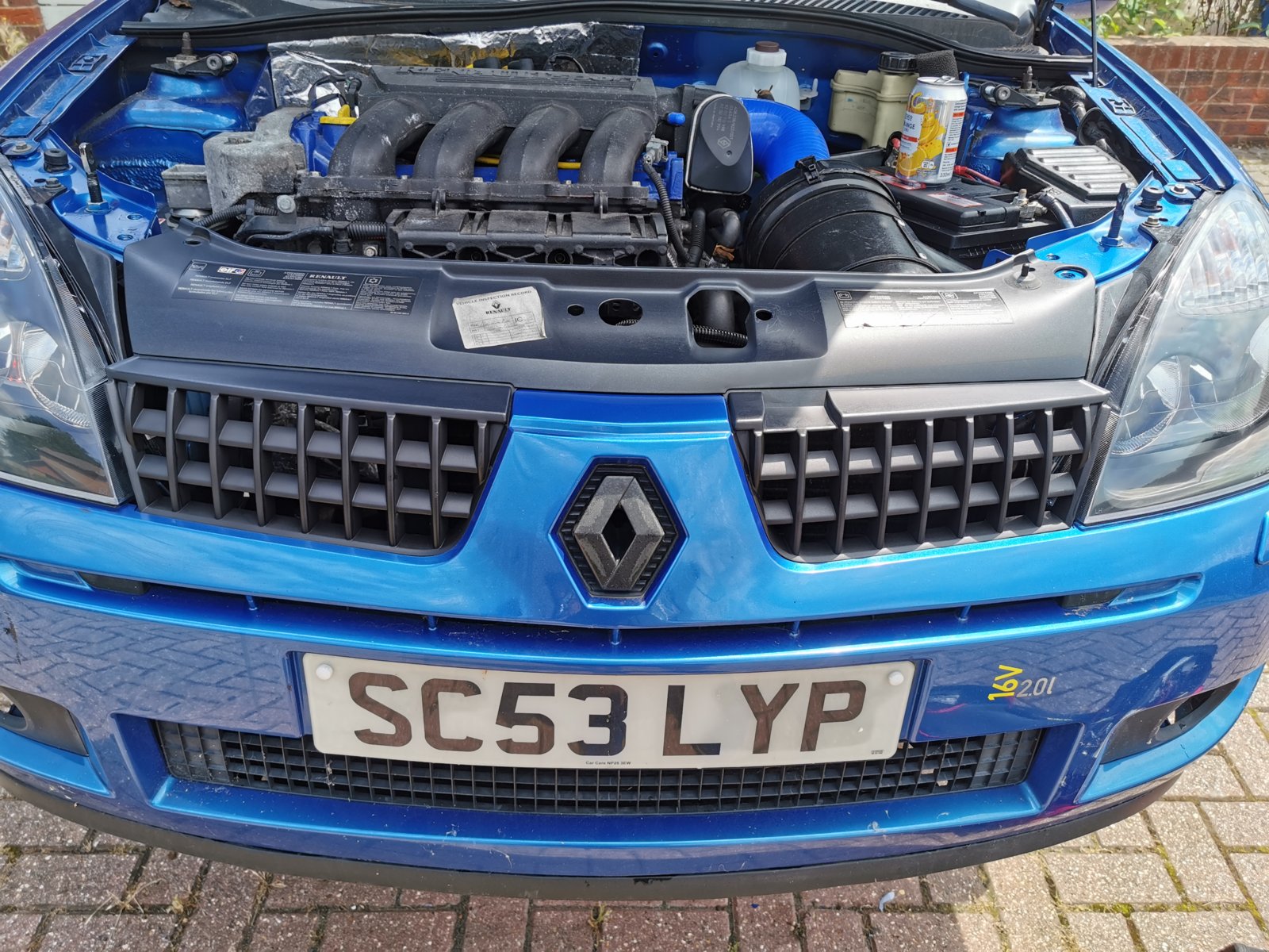

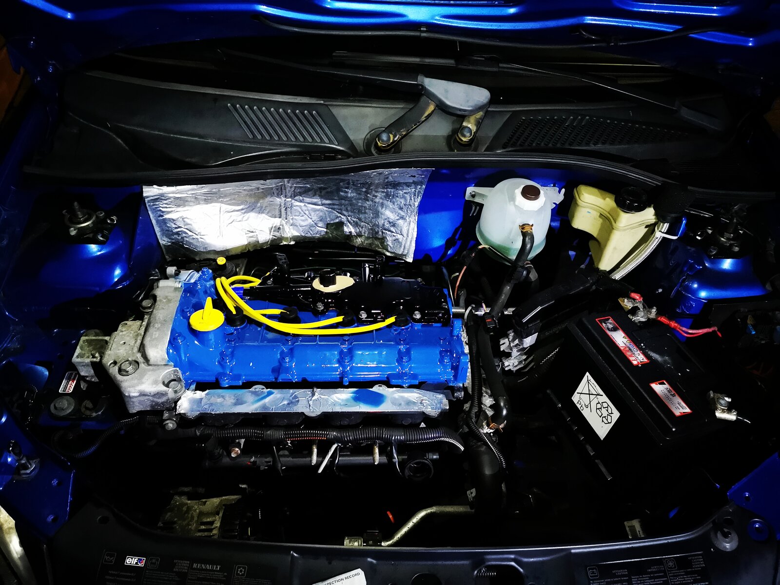

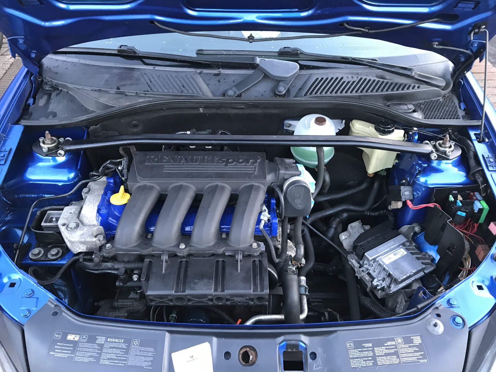

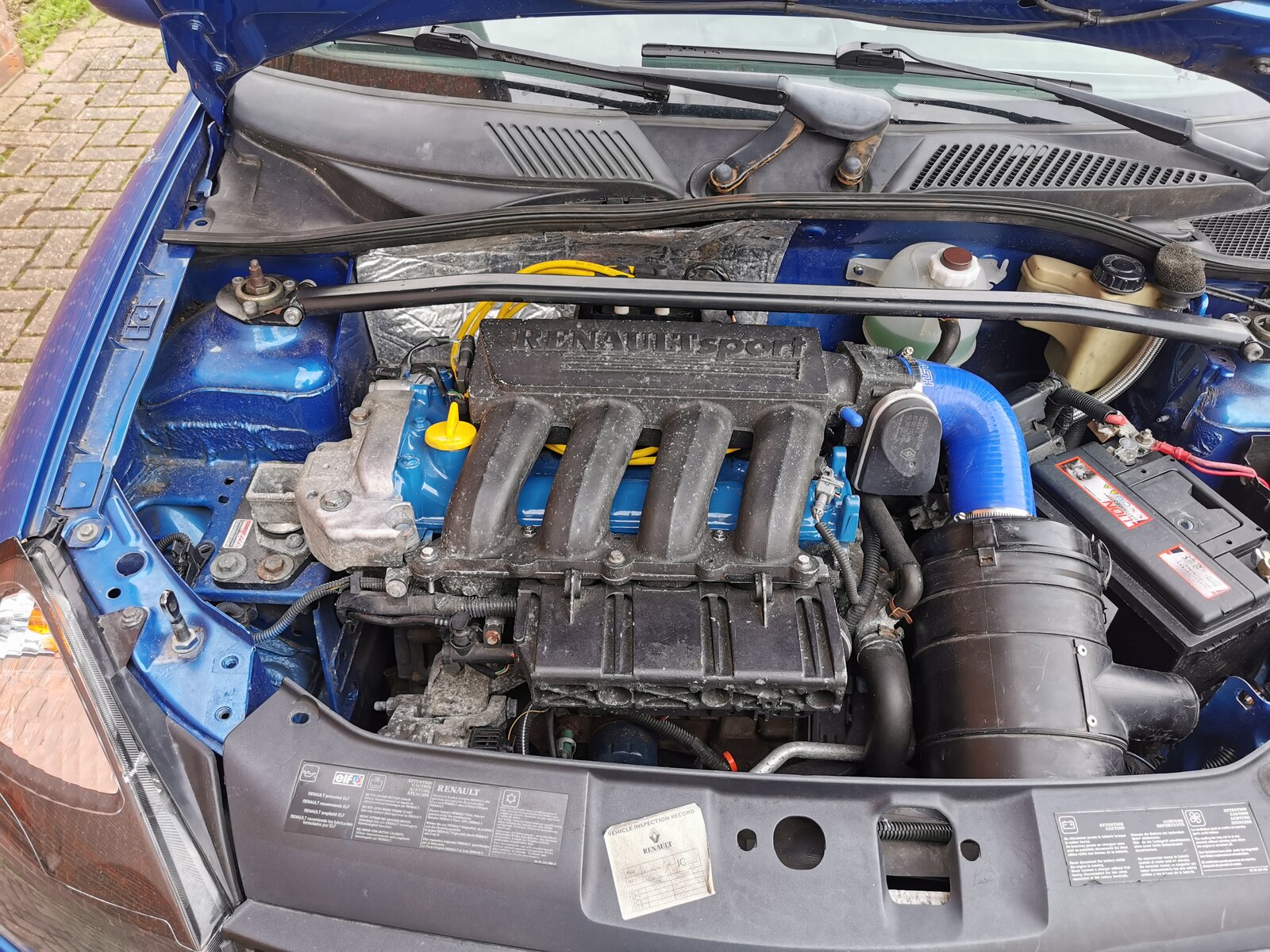

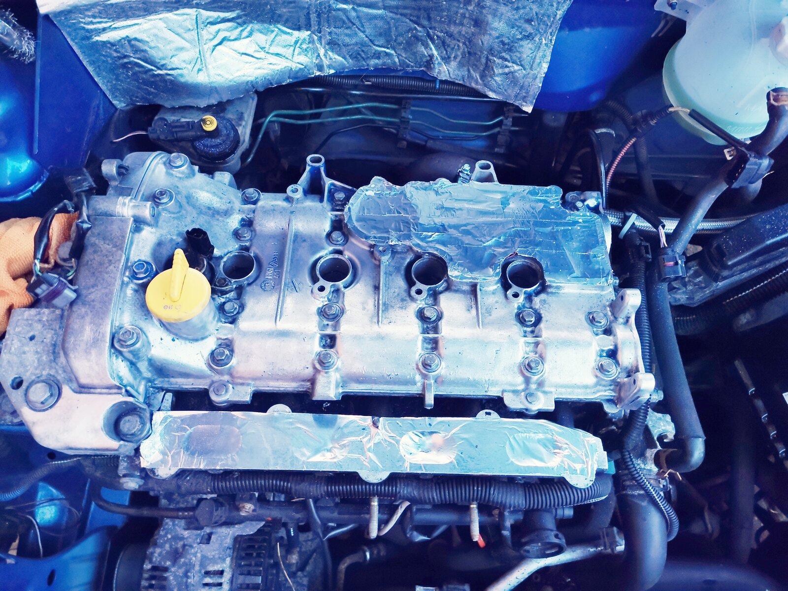

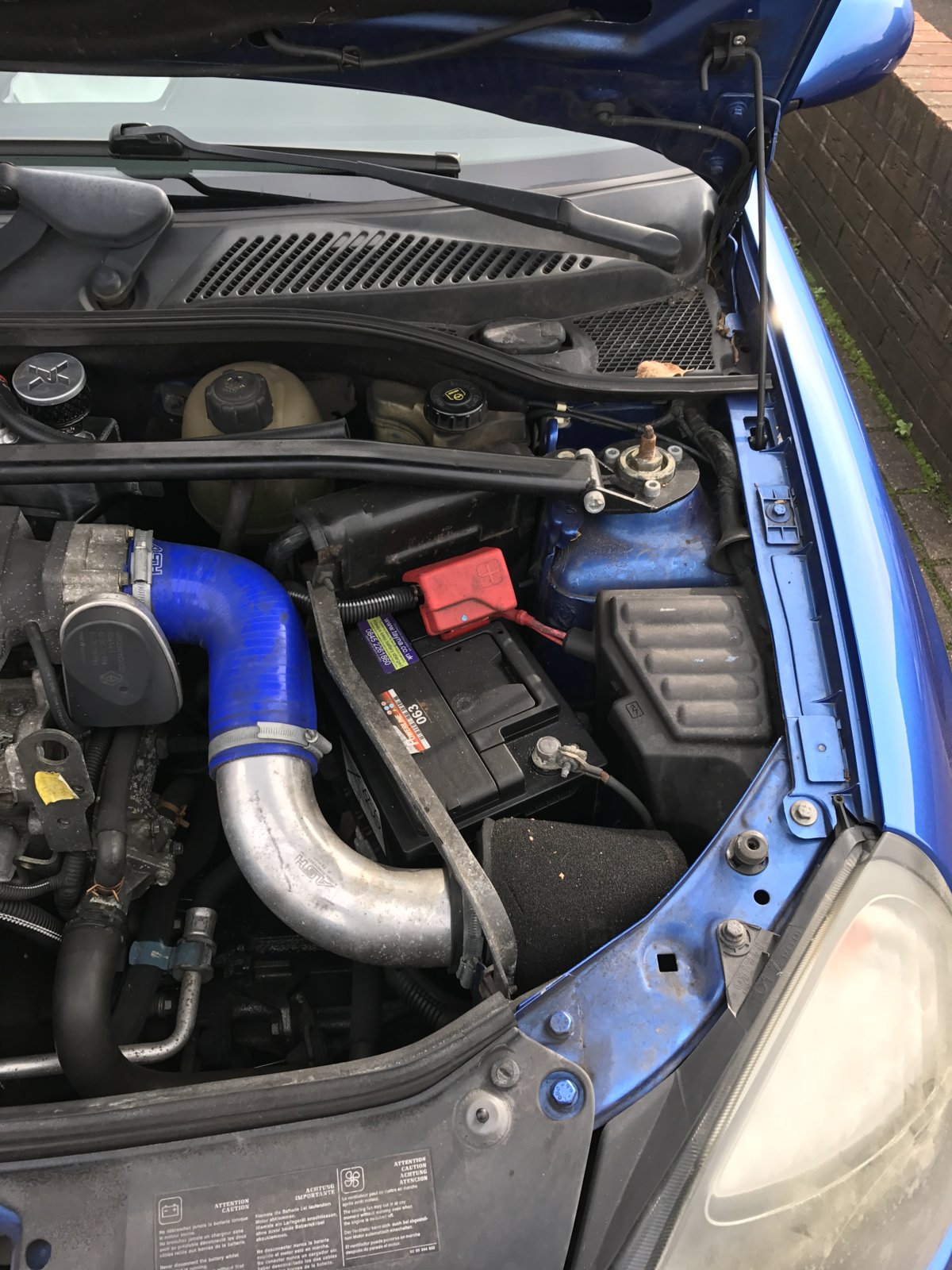

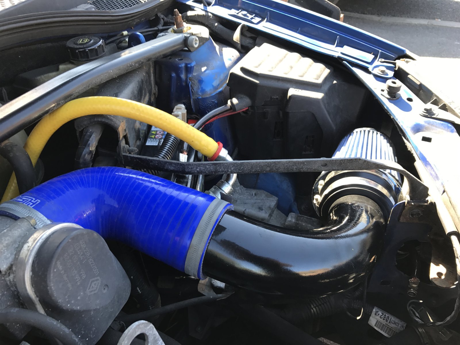

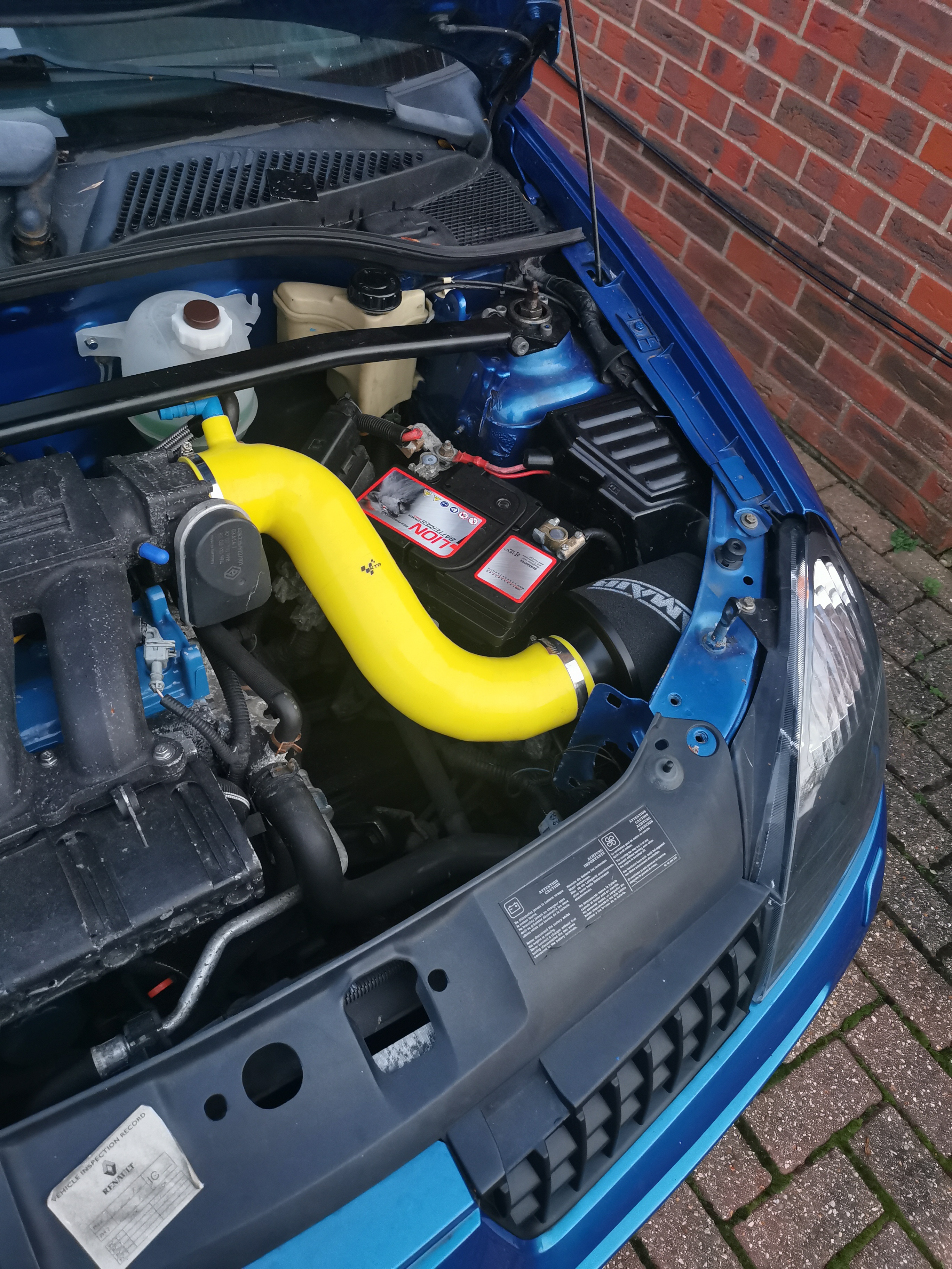

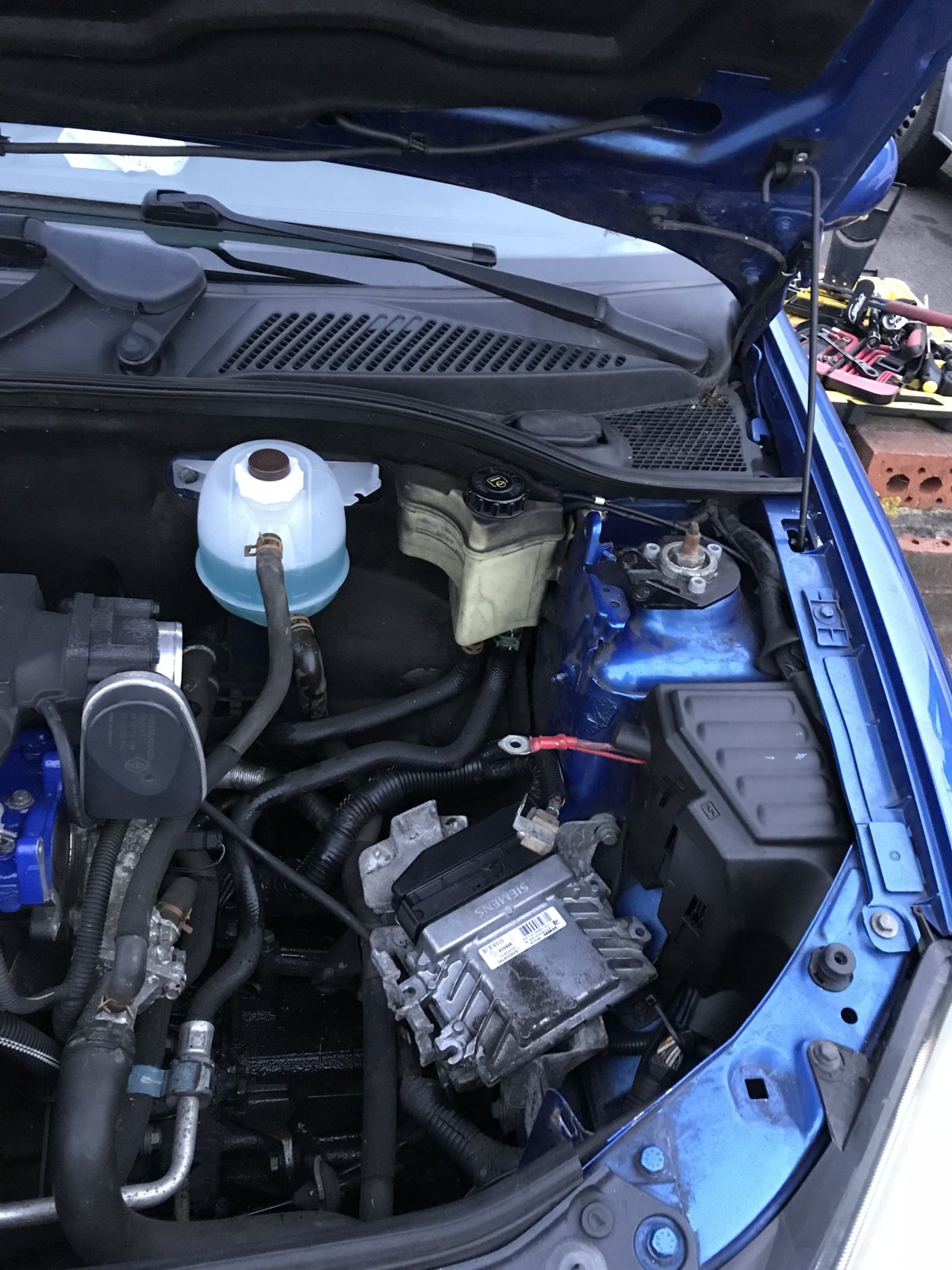

Gave the engine bay a clean up
Odessey pc680 battery in the boot in a box I made up
1412506

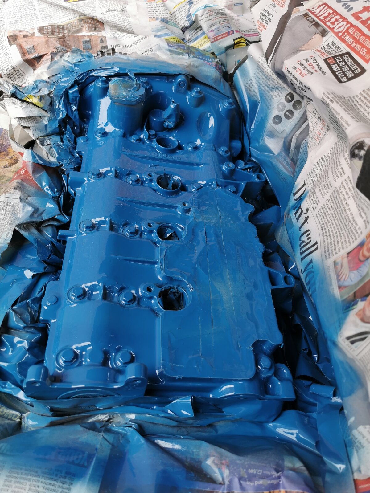

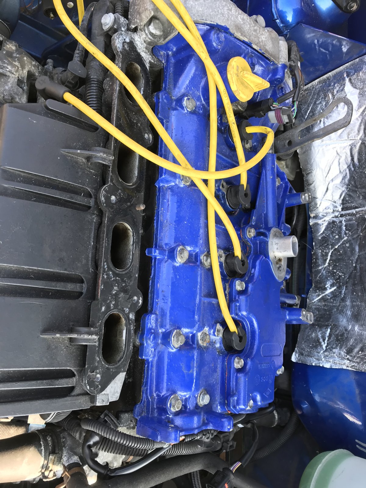

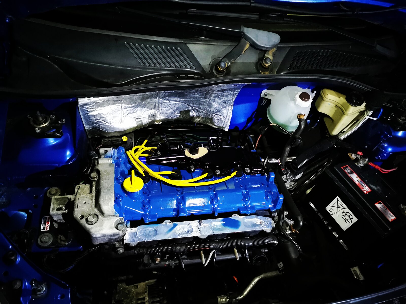

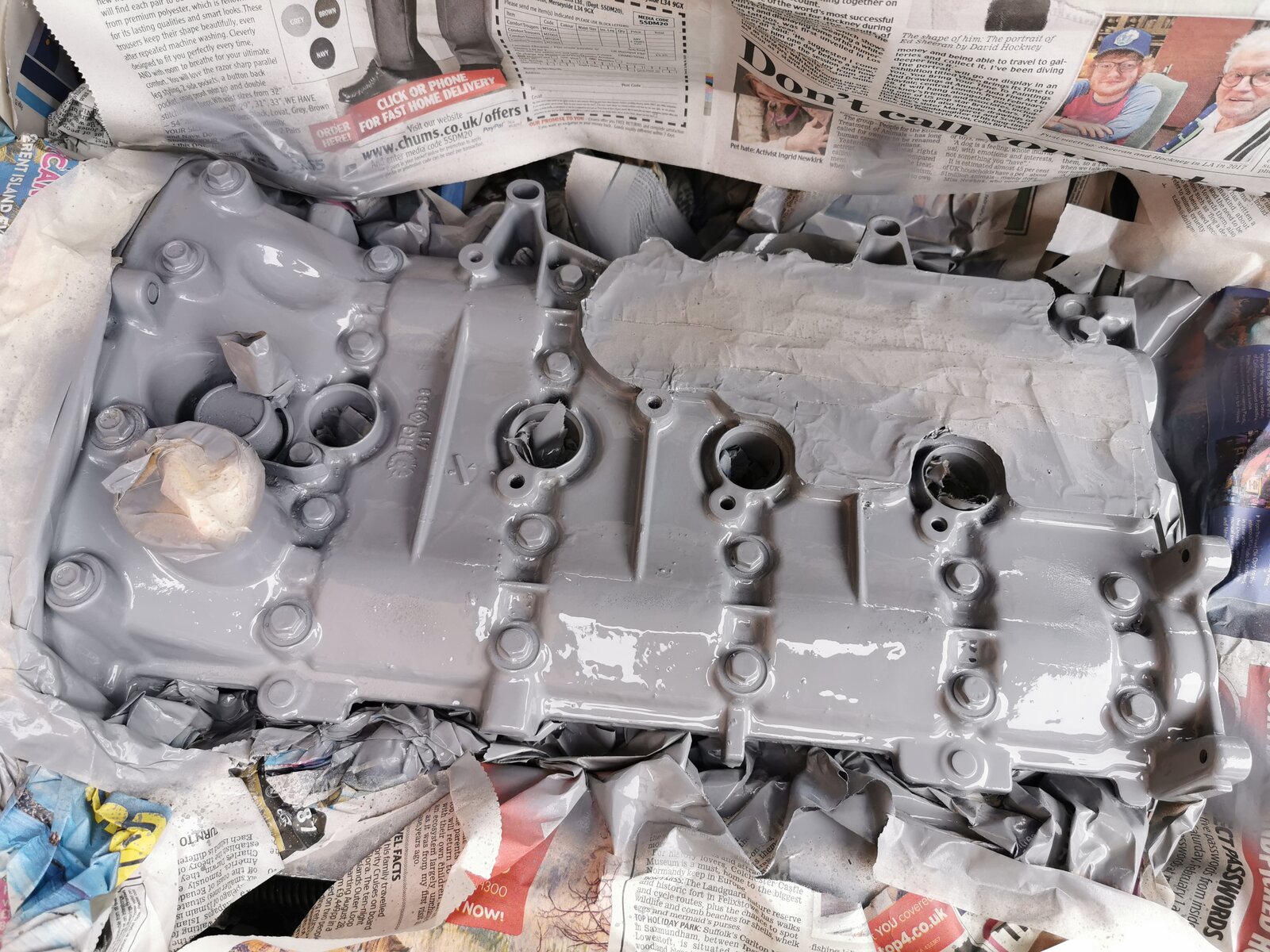

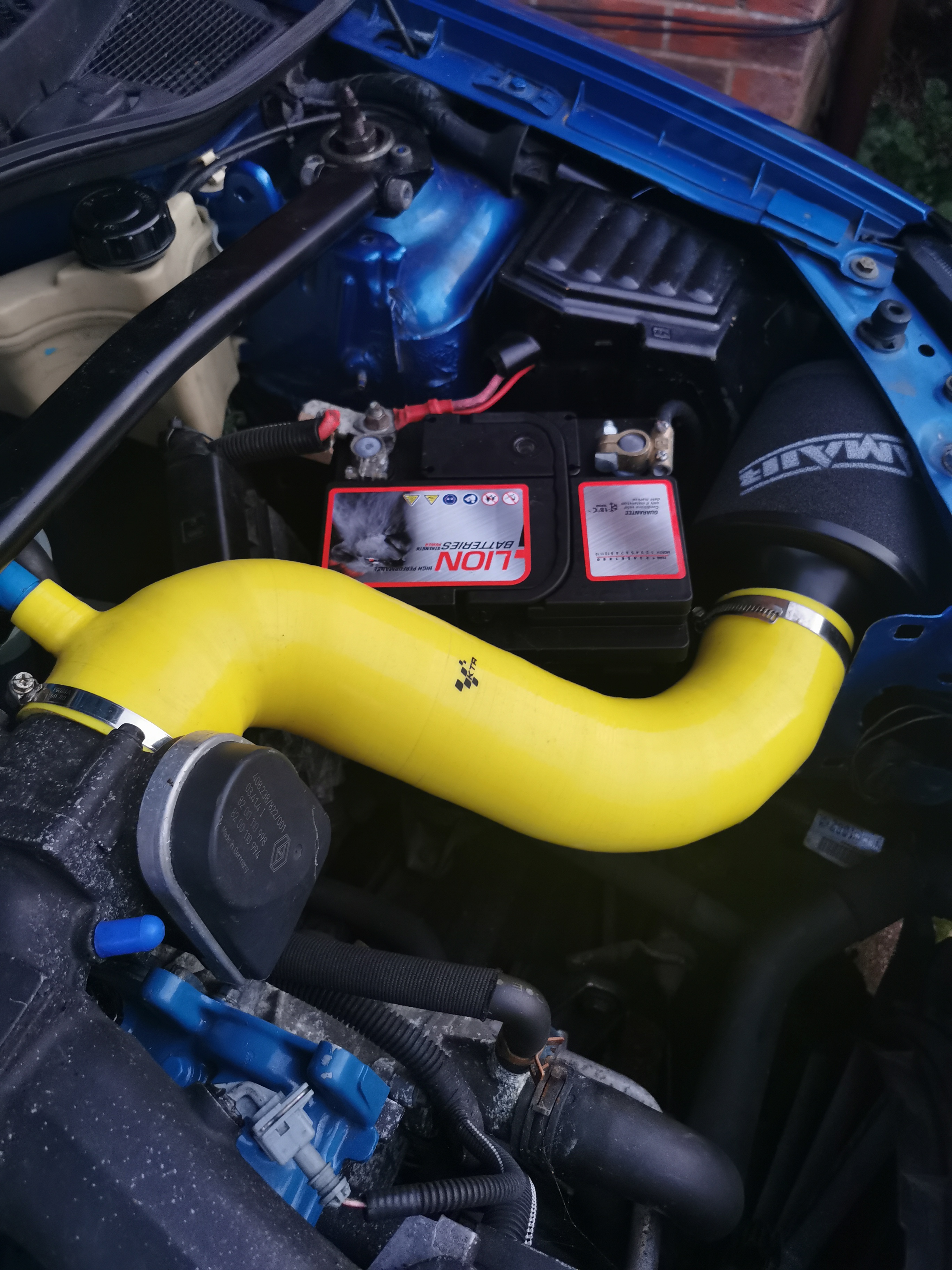

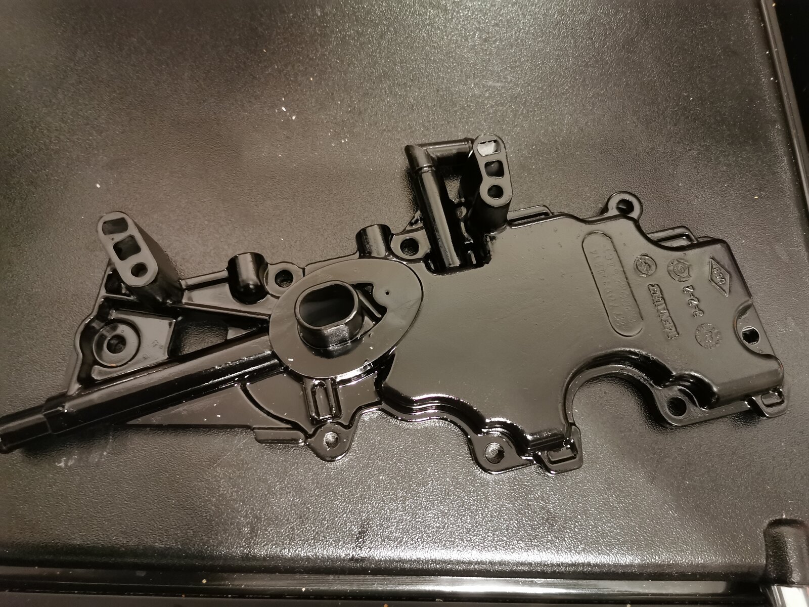

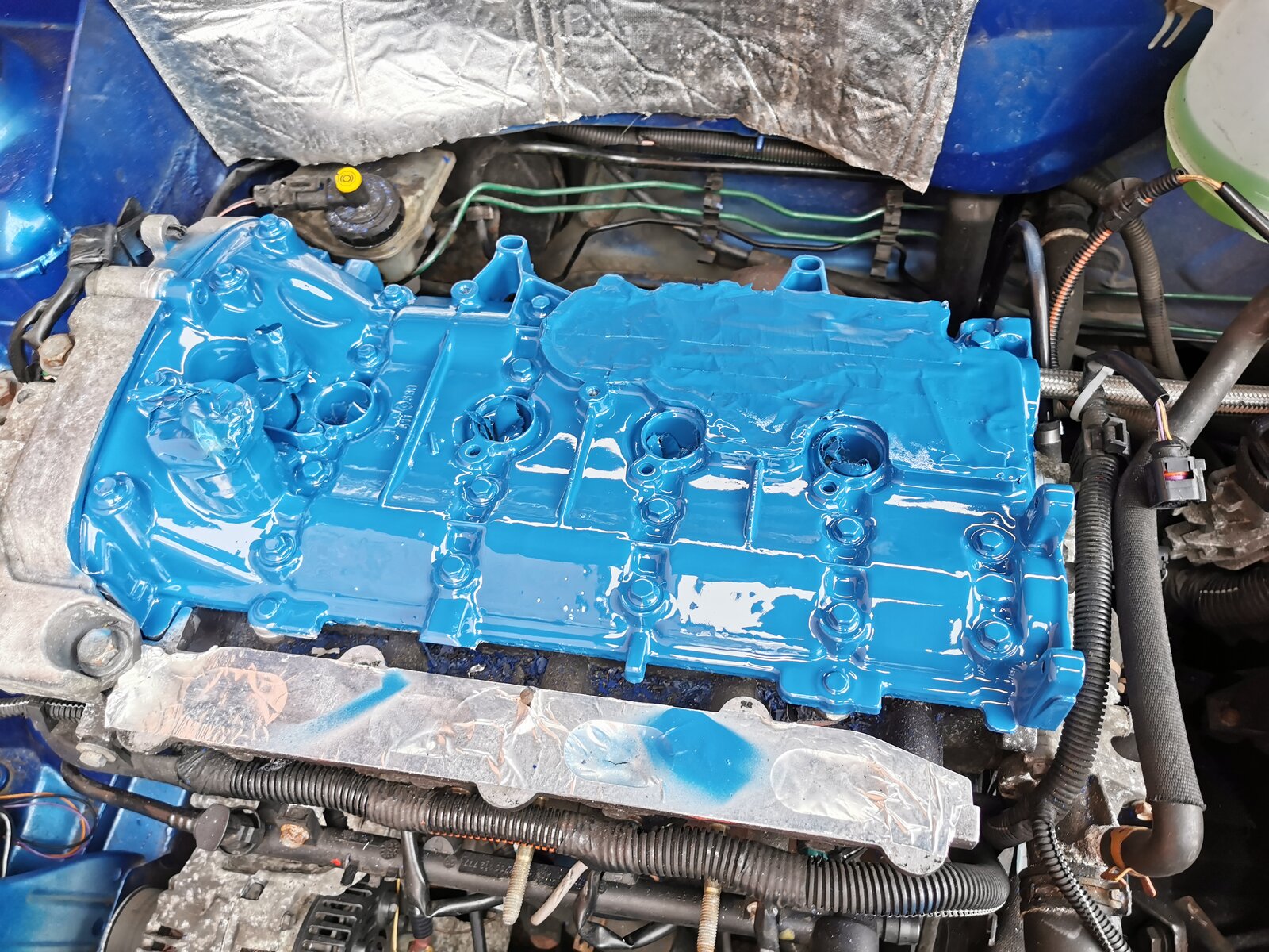

Gave the engine a clean up and paint in the left over marine blue paint I used on my calipers.
Got 8mm yellow leads which are great quality.

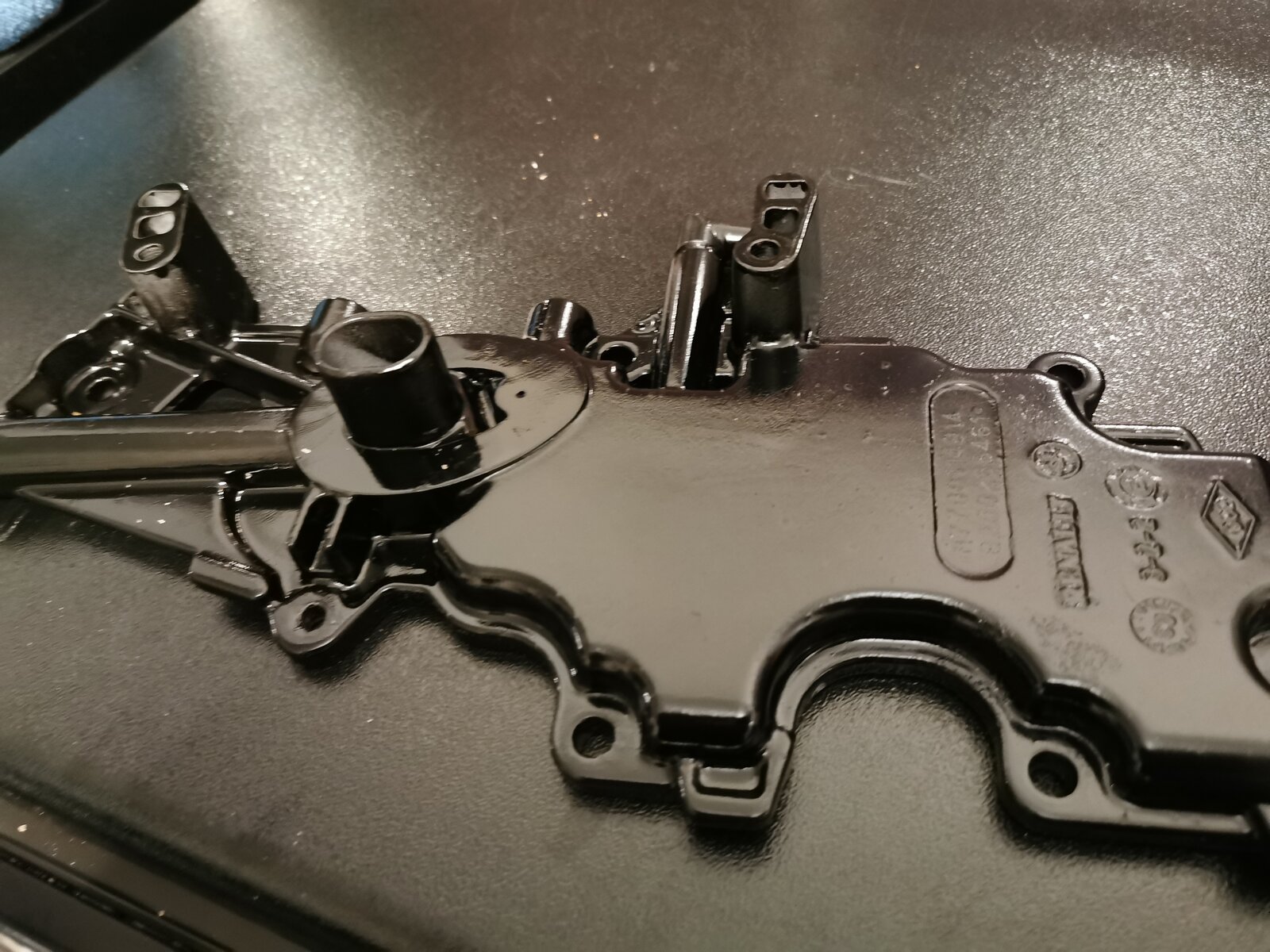

Painted the inlet manifolds and fuel rail guard in Matt vht paint.
New header tank.

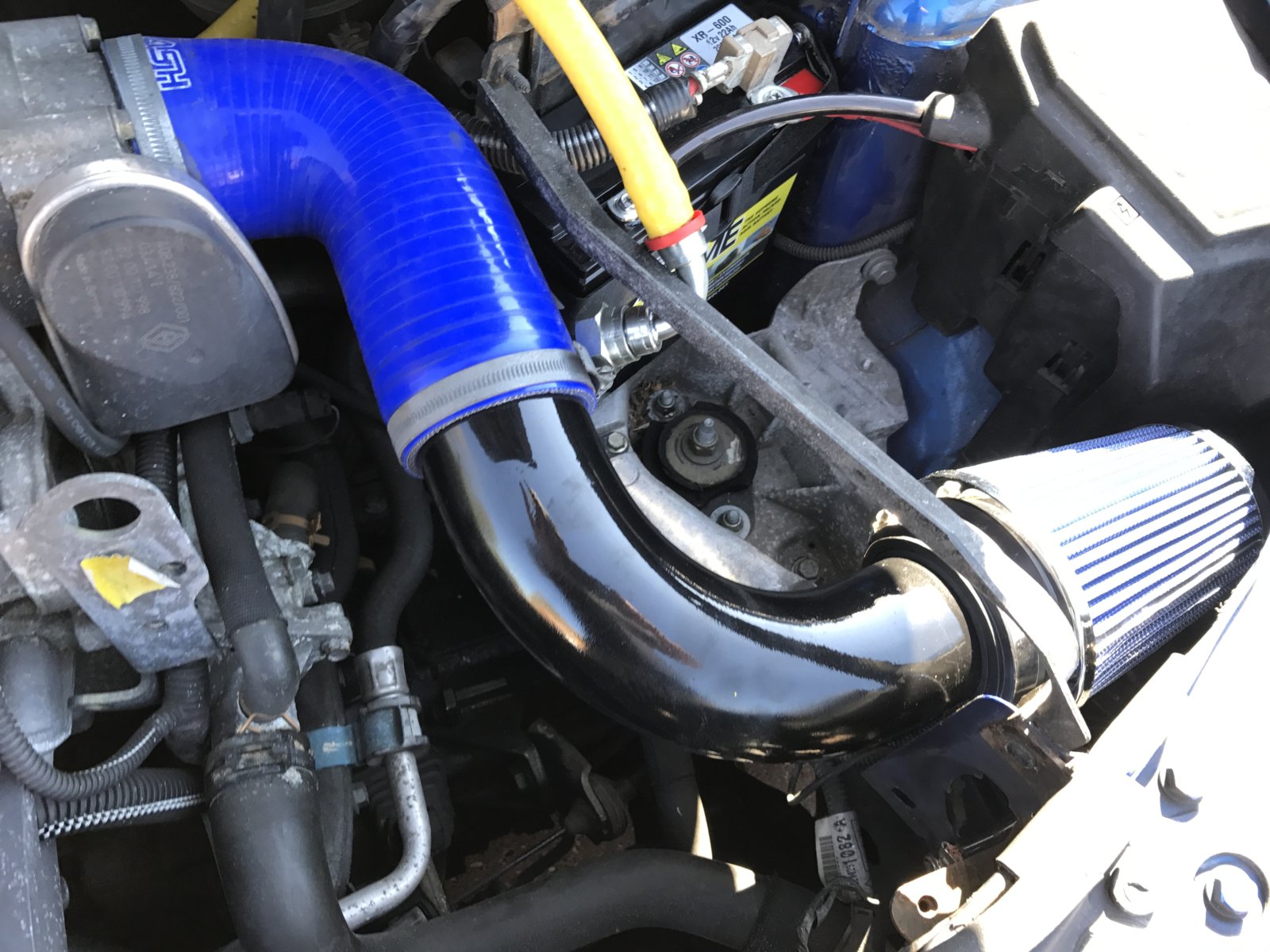

Removed the Ecu cage and laid it flat.
New carbon fibre pipework and huge K&N filter fitted. Sounds the nuts
1412507
1412526
1412527
1412528
New header tank.

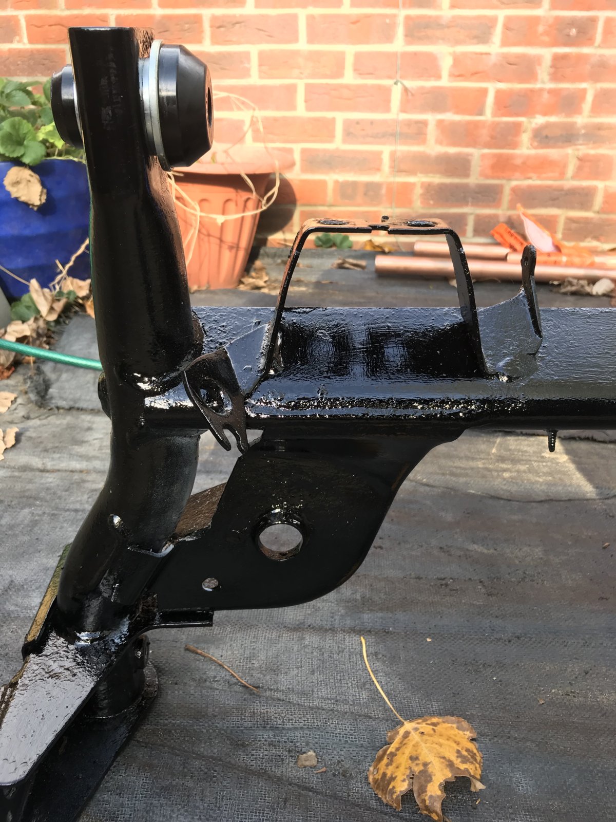

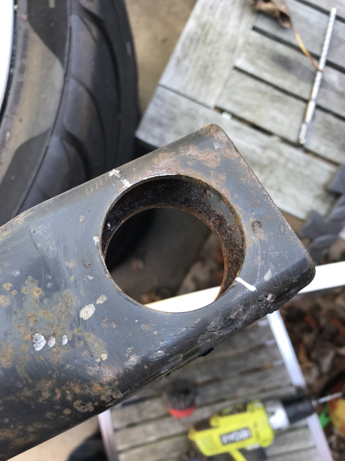

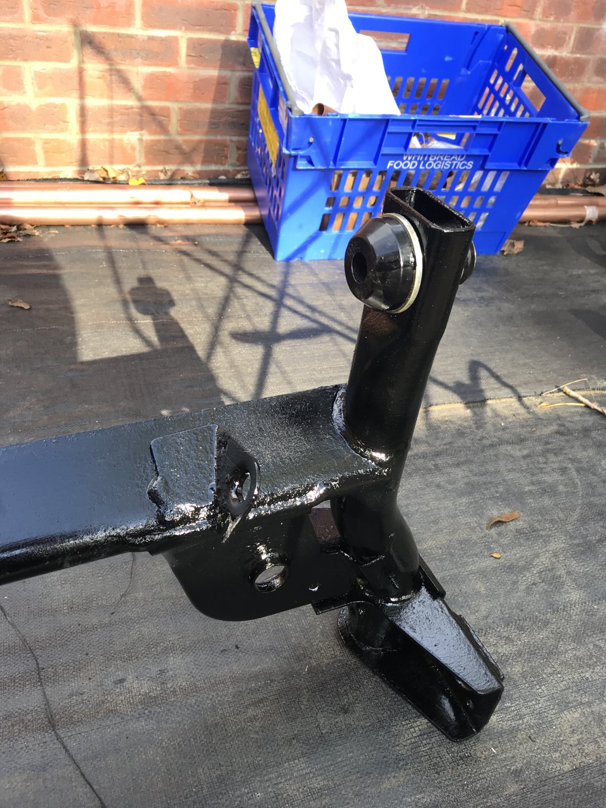

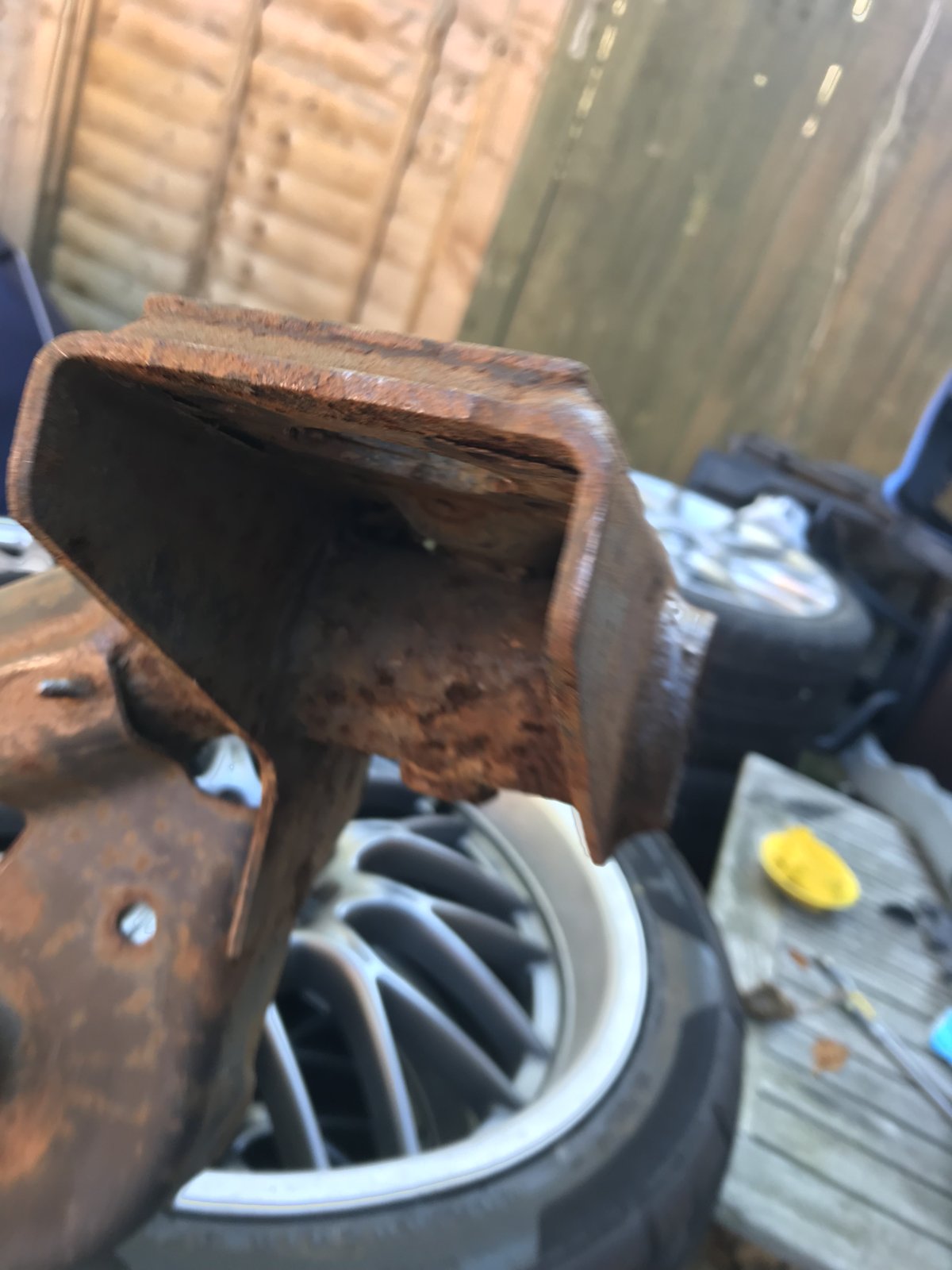

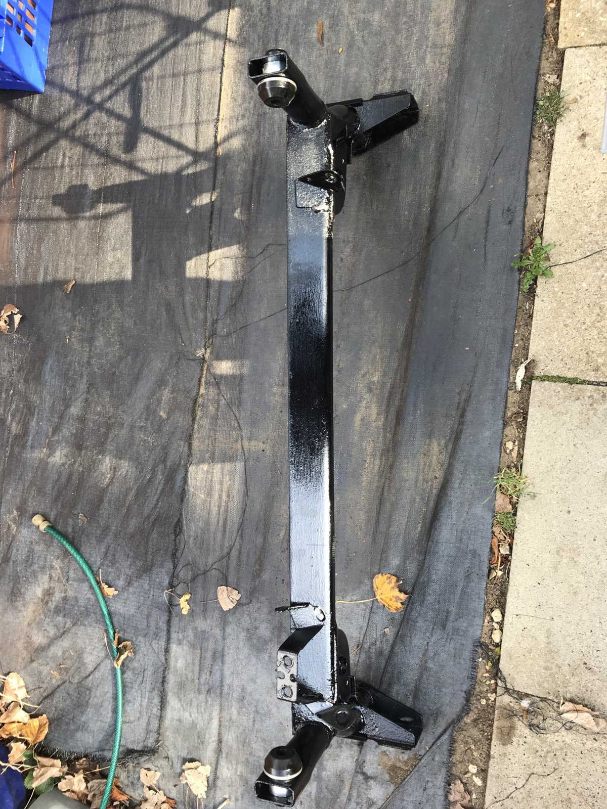

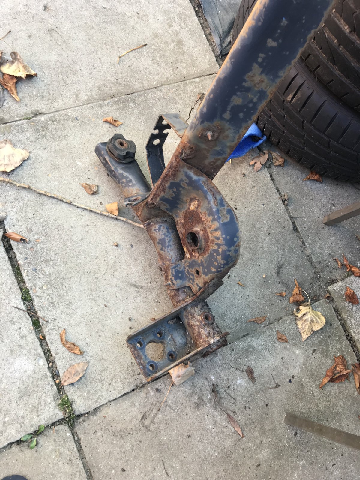

Built up a rear beam as the bushes are original, only 55k on them but 16 years old!
Looked and found the 182 rear beams have a thicker torsen bar and extra bracing to the spring plates.
Sourced a rear beam but was a tad rusty
1412596
1412602
1412603
All cleaned up, wire brushed, por 15 then black enamel paint and whiteline bushes as very well priced and excellent quality

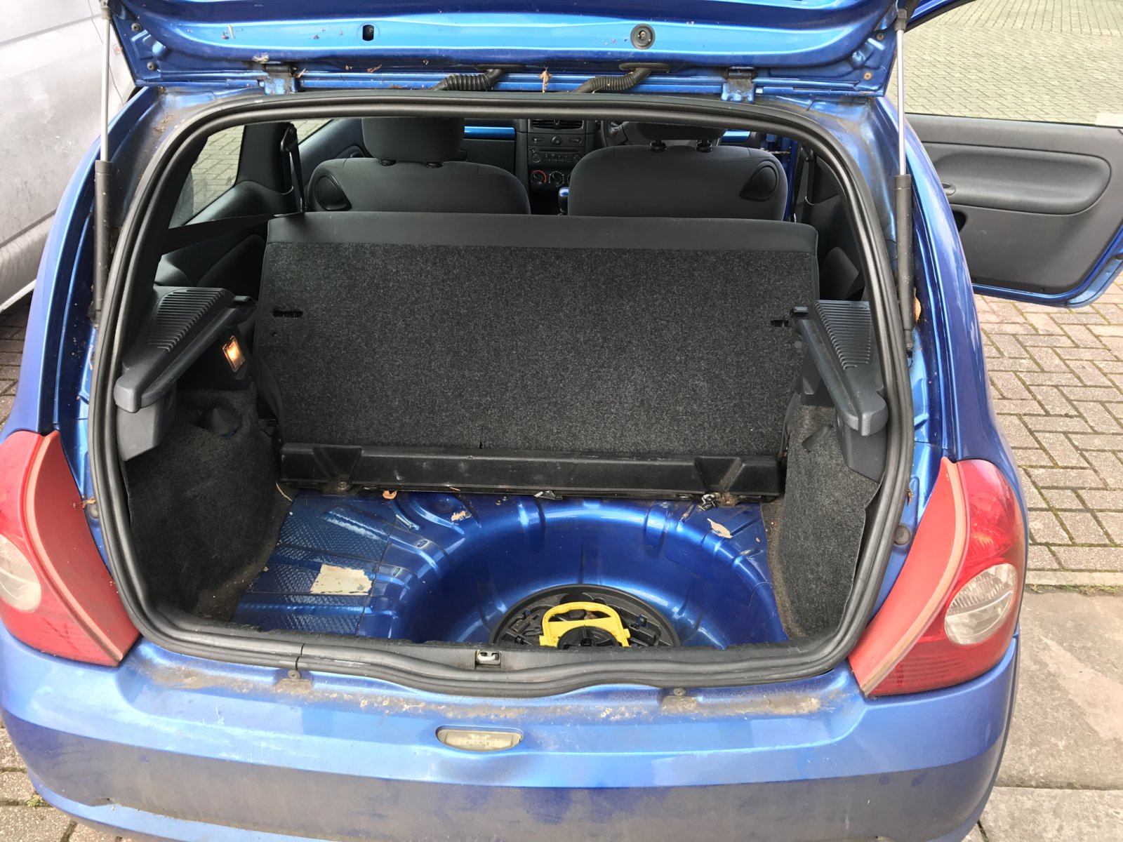

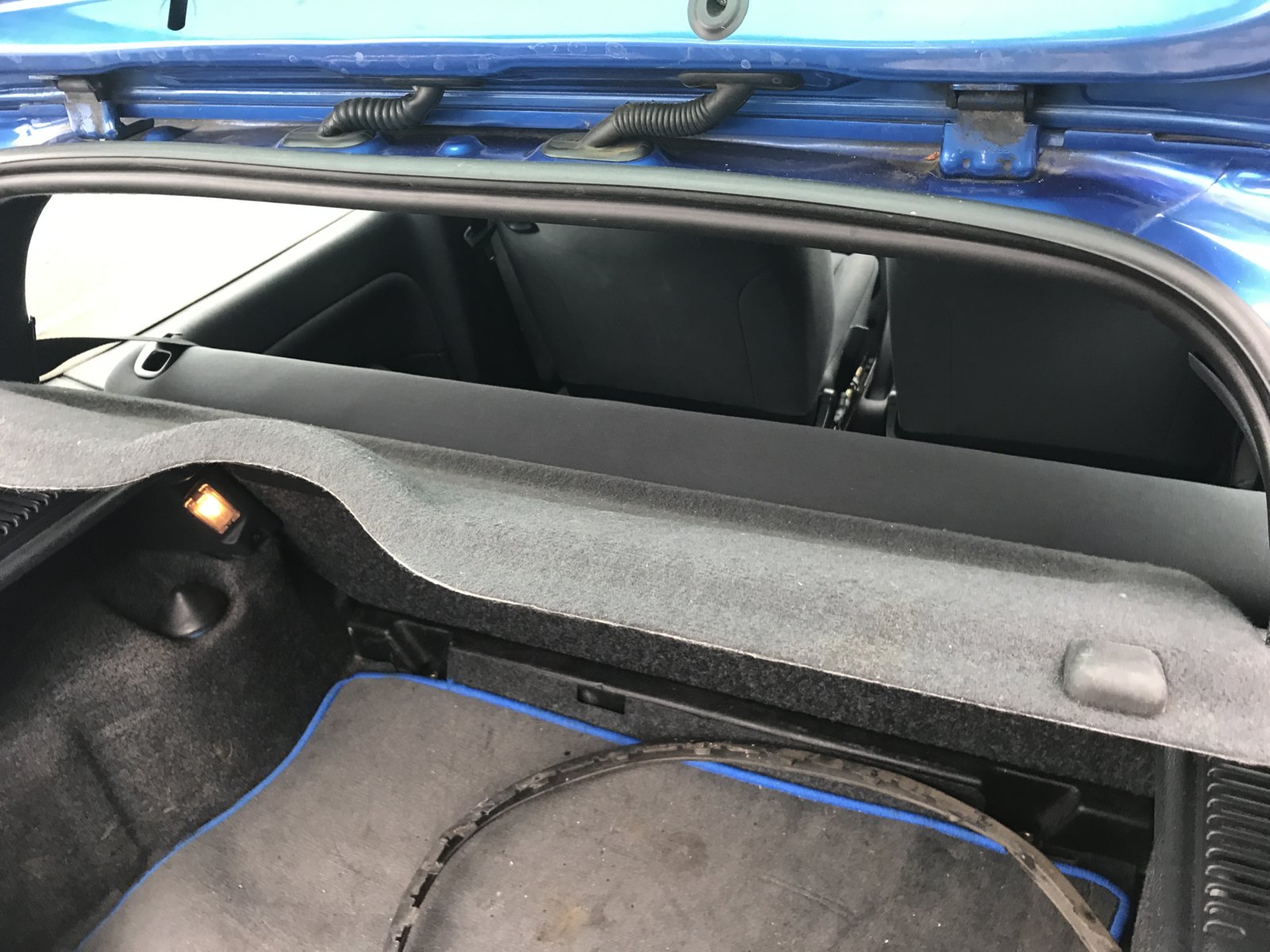

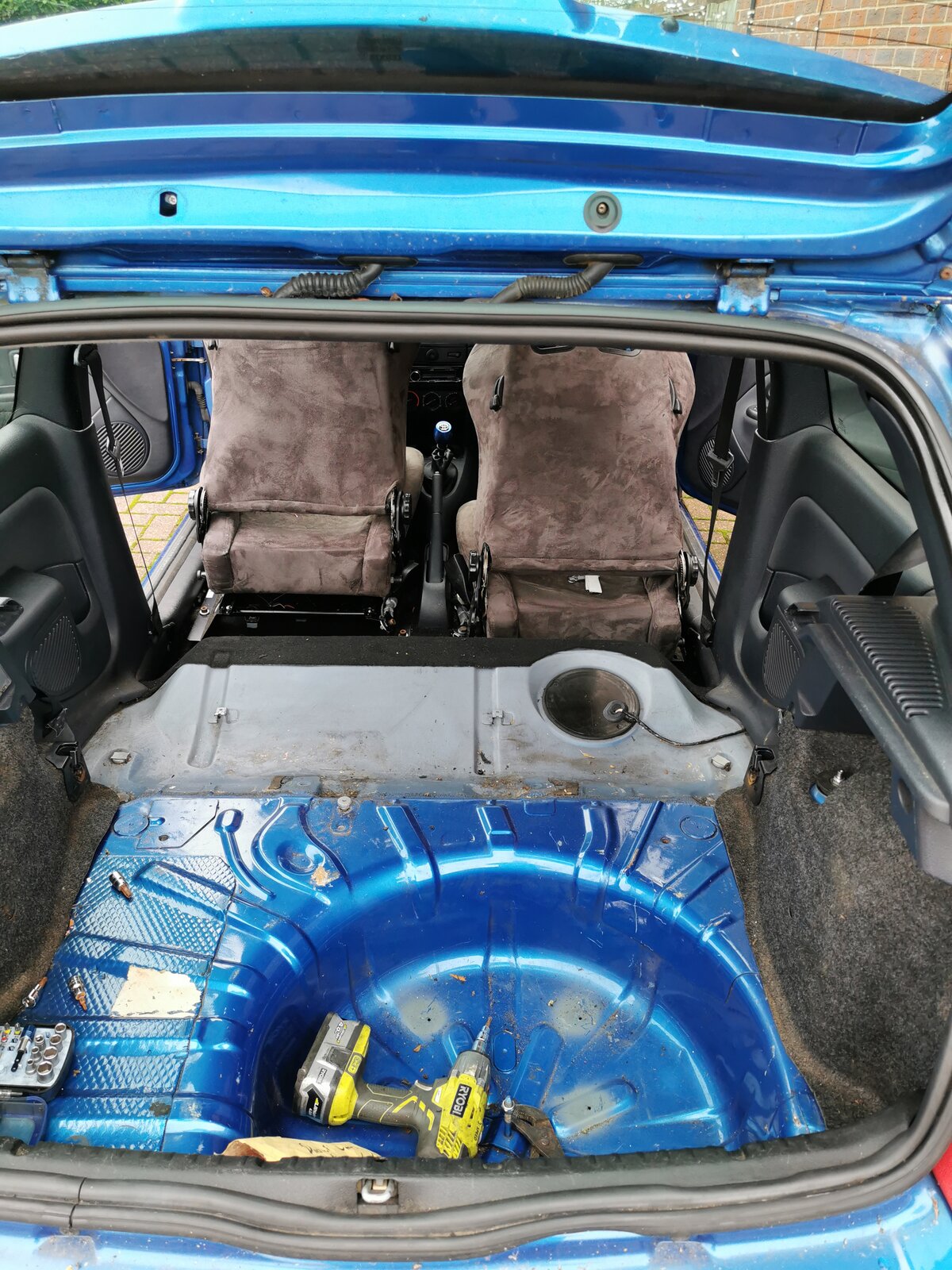

One of the key things I want to do with the cup is keeping it as a lightweight practical road car.
So I have made a list of what I have removed and rough weights as well just as I like the idea of every little helps .

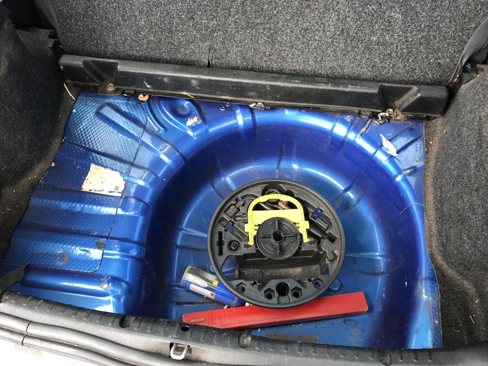

Boot area
  • Isofix bar. - 2.5kg
  • Isofix bolts .02kg
  • Tool kit -3.0kg
  • Parcel shelf -2kg
  • Boot trim
  • Boot carpet
  • Rear wiper arm
  • Rear wiper motor
  • Tailgate trim
  • Top mount covers
  • Isofix cover
  • Wheel mount bolt
  • Boot carpet
The boot area gives quite a decent saving and as I have no need for isofix or it being practical it all came out.

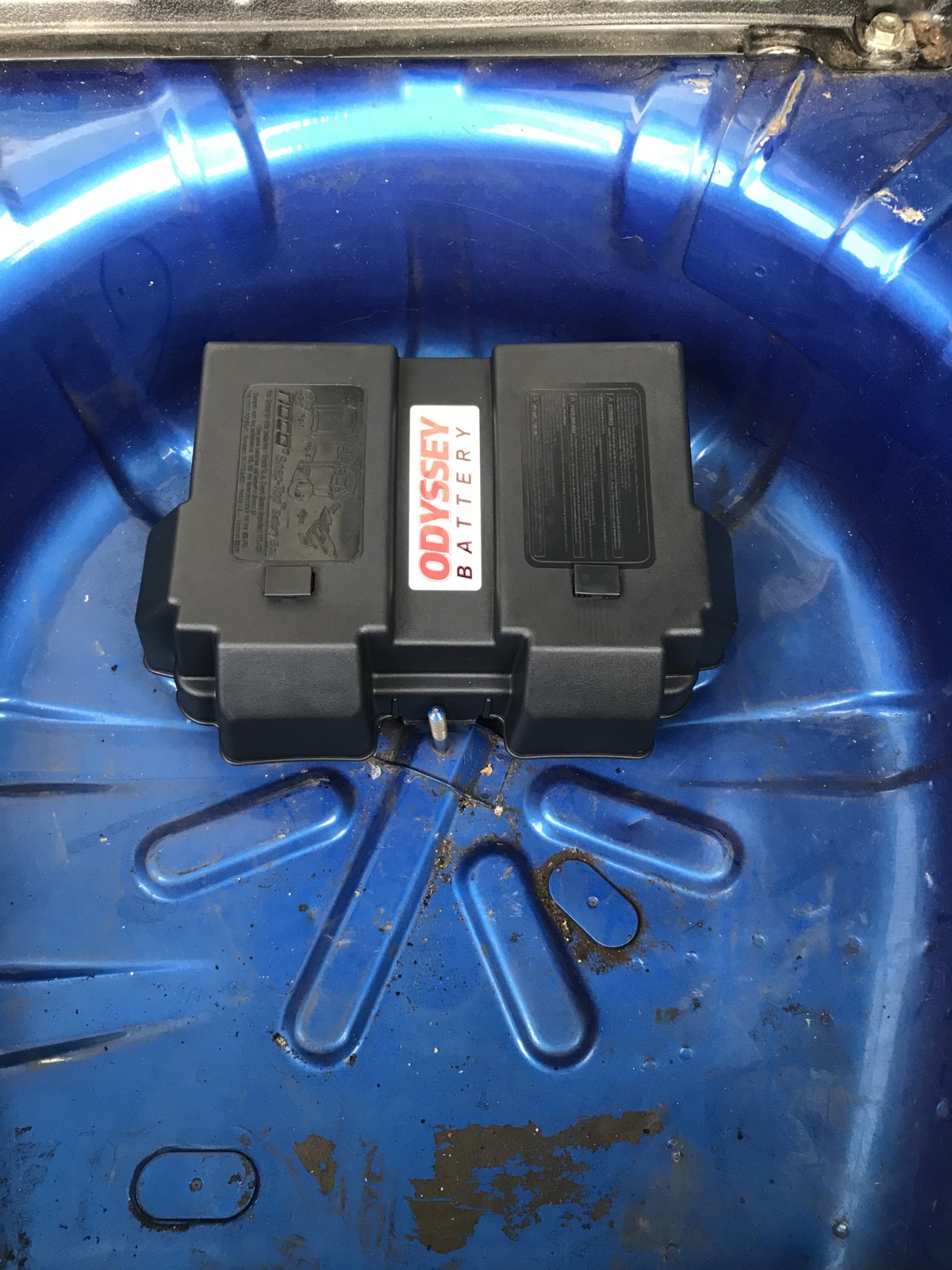

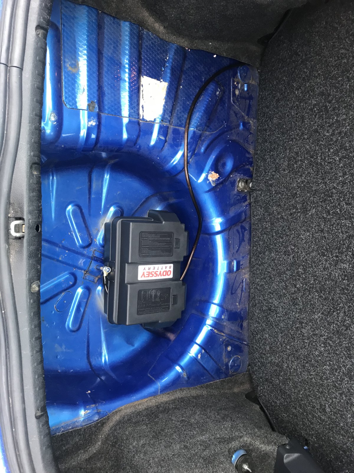

I put my oddessy battery in the boot with a battery box but this is going to be removed for a lithium battery.
1413244
1413245
1413246
It also had a large bit of 18mm plywood stuck down to it so all ripped out.
The side trim and battery box has since gone
1413247
Boot Carpet - 2.2
Toolkit - 3.5
Rear speaker panels - 1.75 each
Tailgate trim - 0.85
Trim covering rear seat belts - 0.7 each
lower boot trim - 0.7
Rear Strut cover carpets - 0.3 each

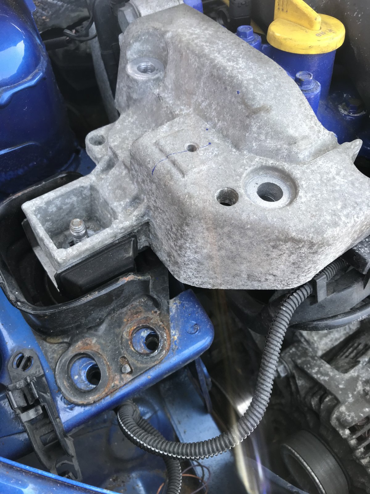

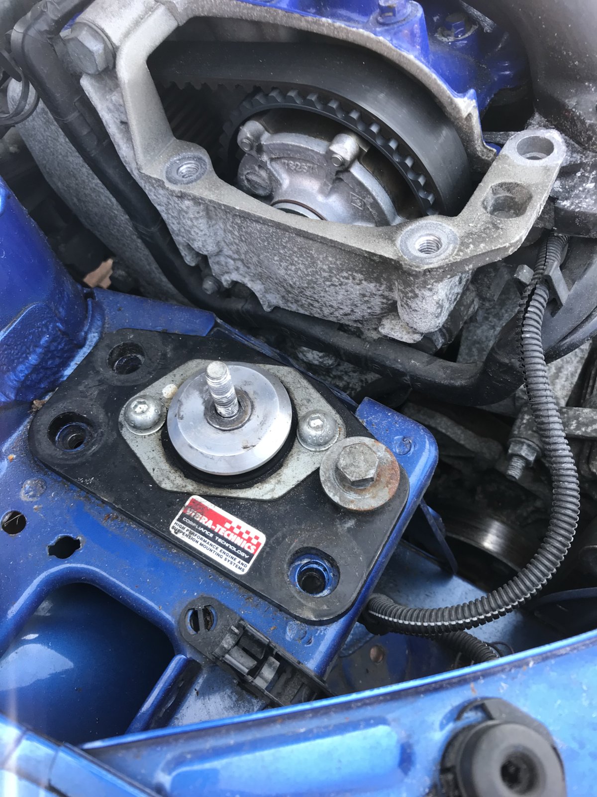

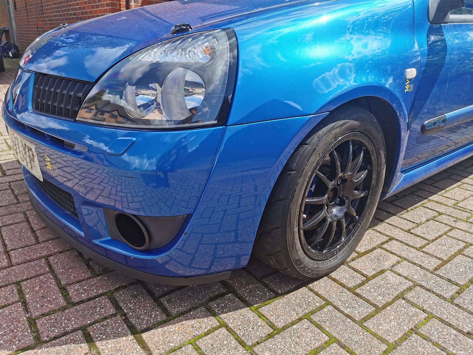

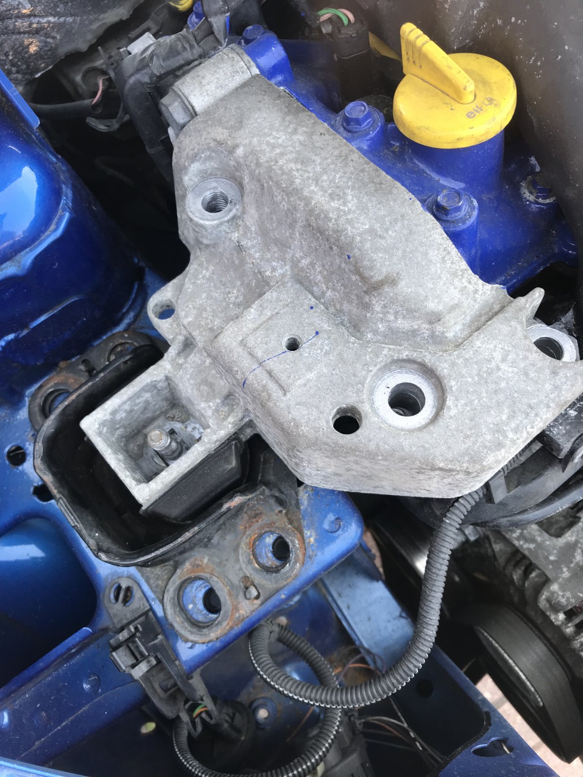

I had lots of movement in my engine mounts and got a vibratec top mount cheap so that went on! I paid Nearly the price of a standard mount

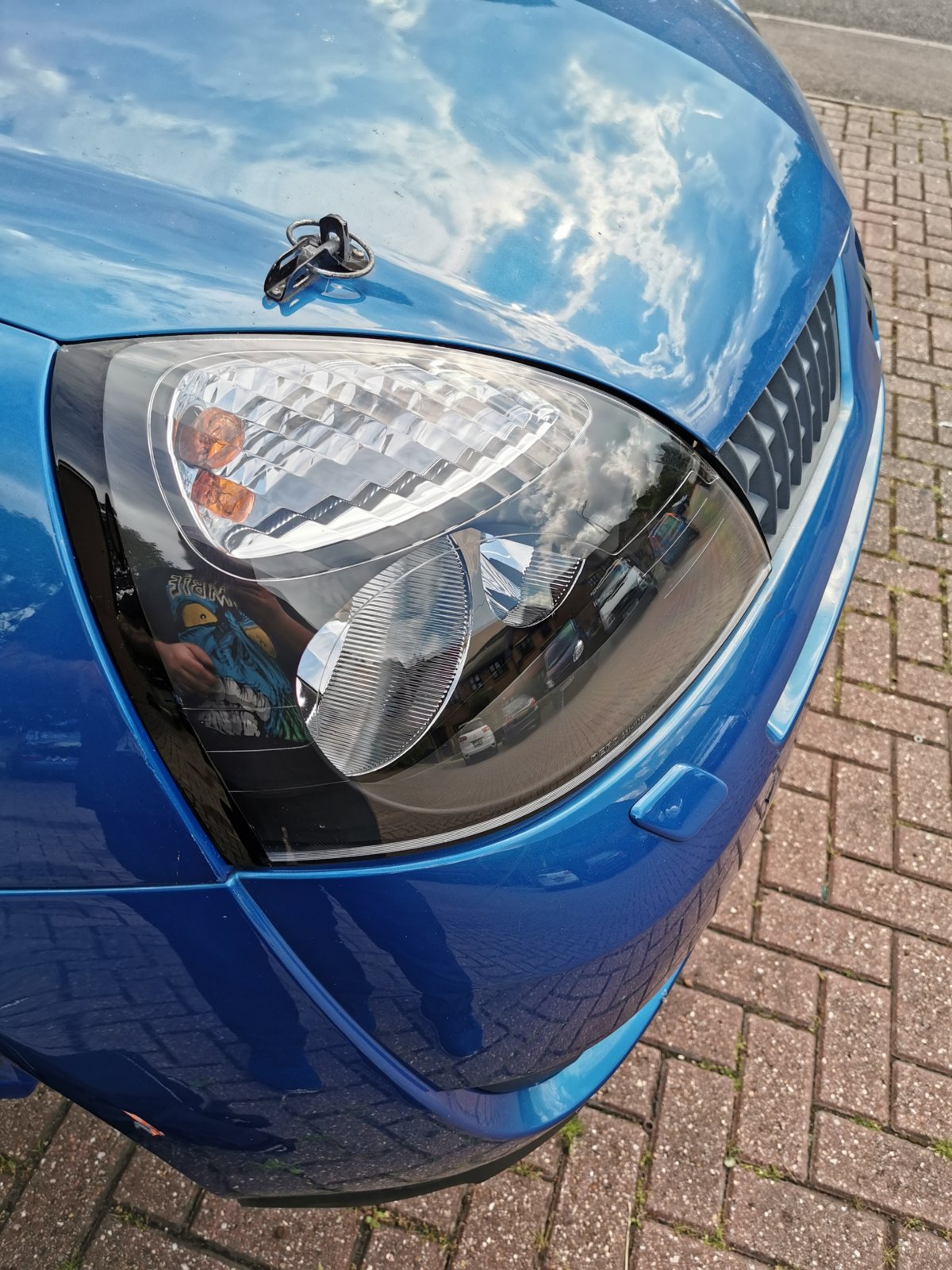

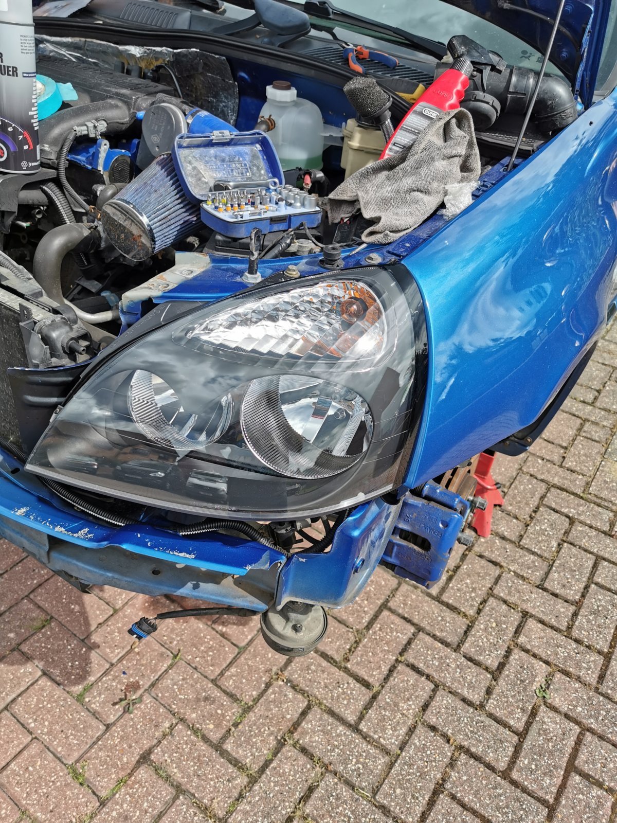

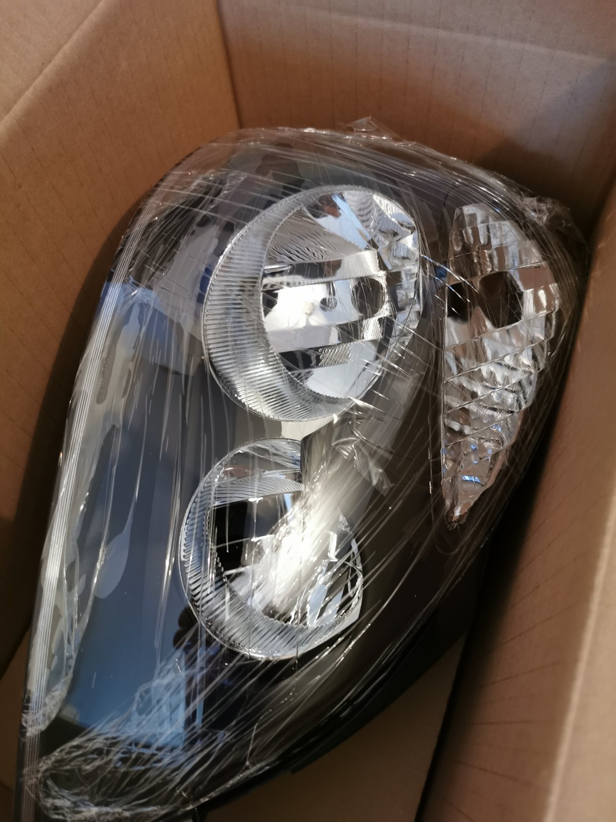

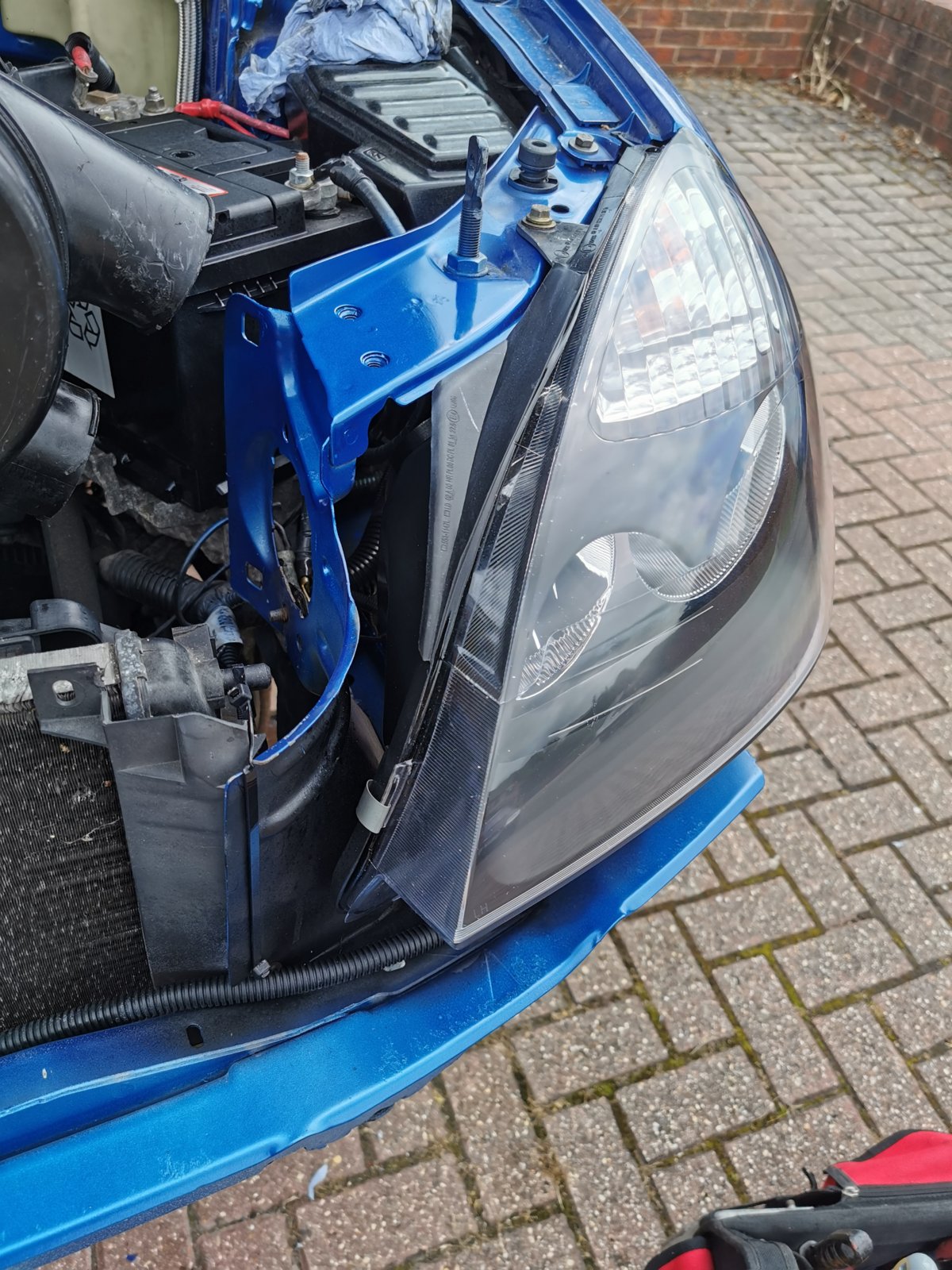

Changed the headlights as they where terrible.
Tried polishing them twice but wasn't good enough.
Got some for £52 from renparts brand new they transform the freshness of the car
You can see she is still in the air as I'm doing a front end refresh at the moment ?

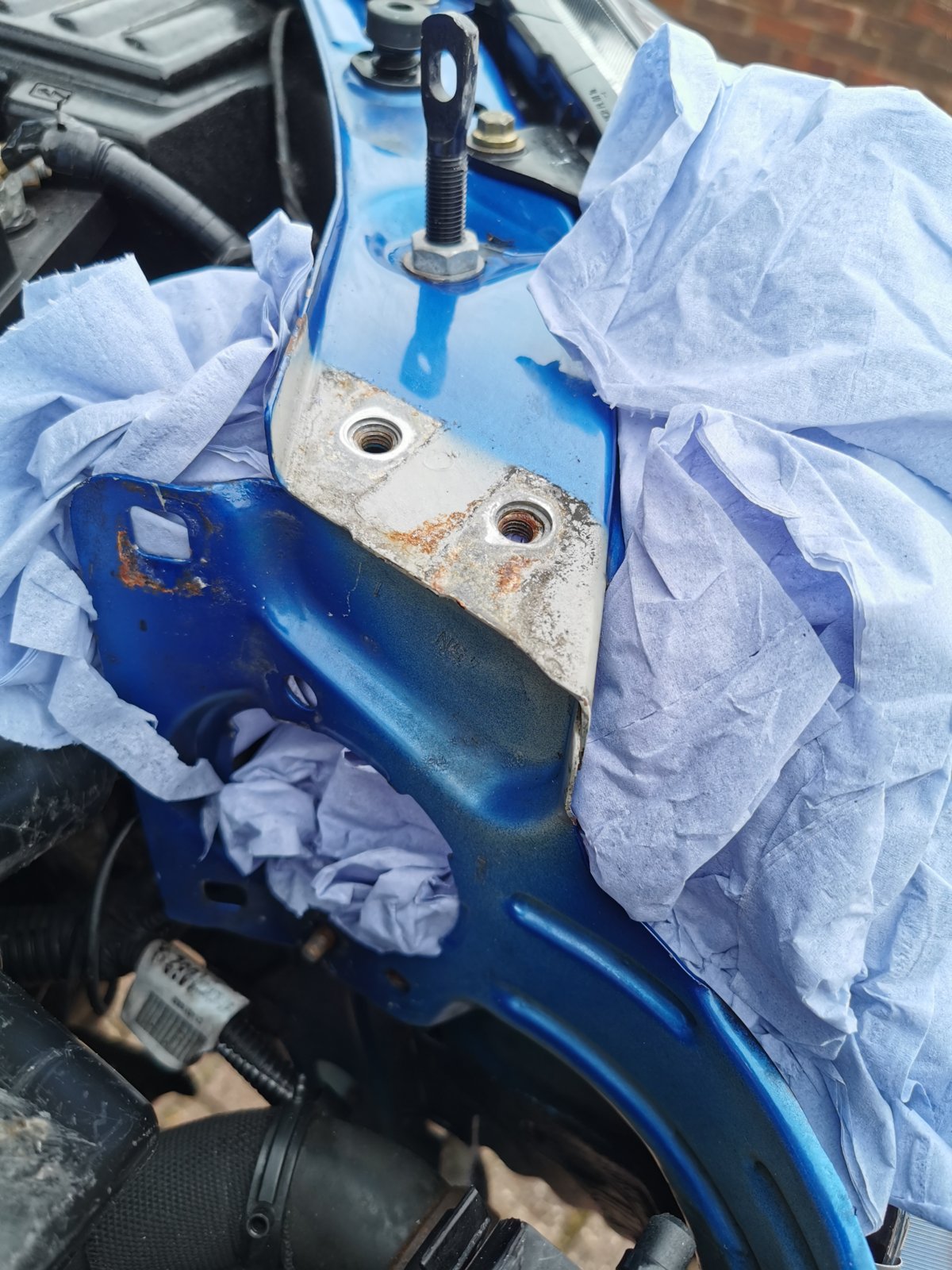

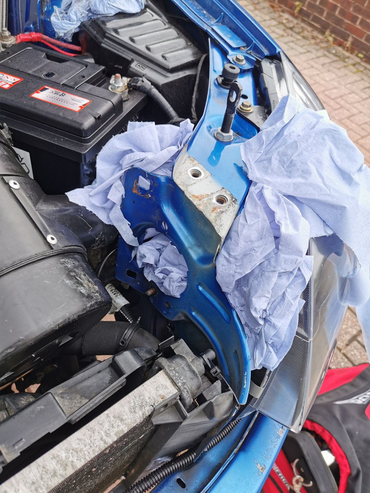

Spent a little bit more time on her today.

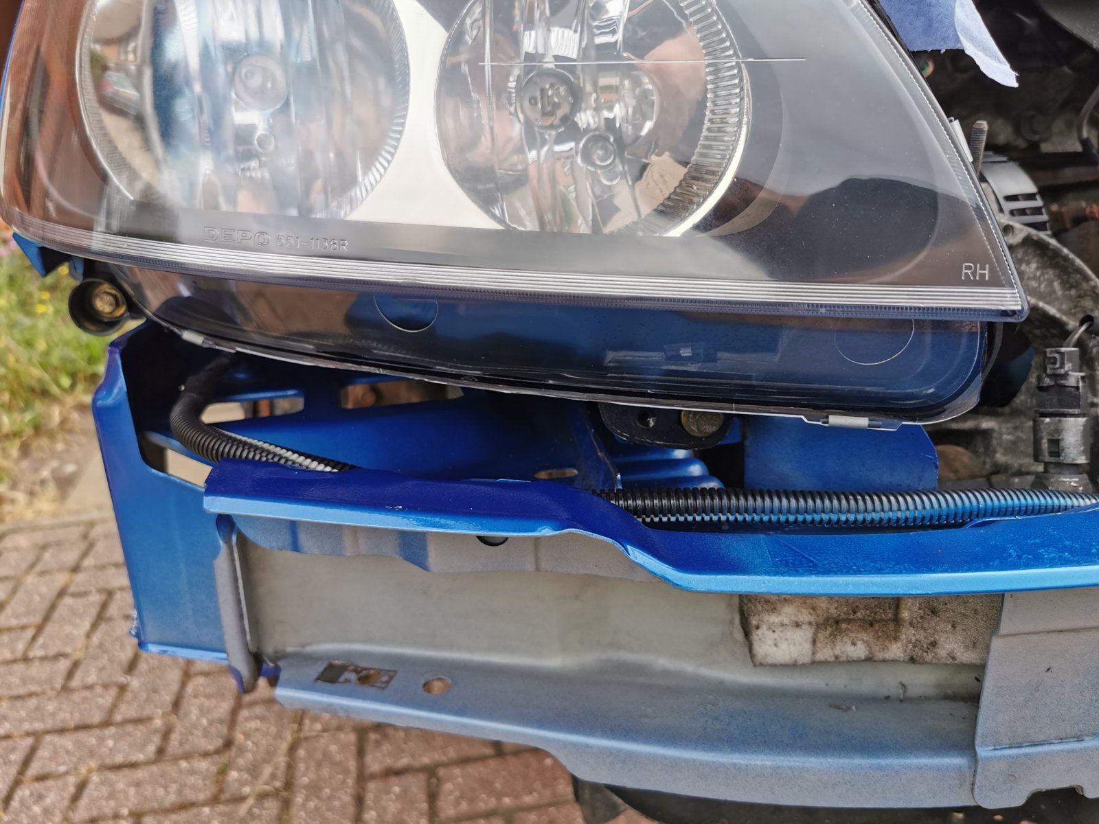

Painted the bare parts after I removed the front rad support bar.
1425442
1425444
1425445
Had a clean up under the bumper
1425446

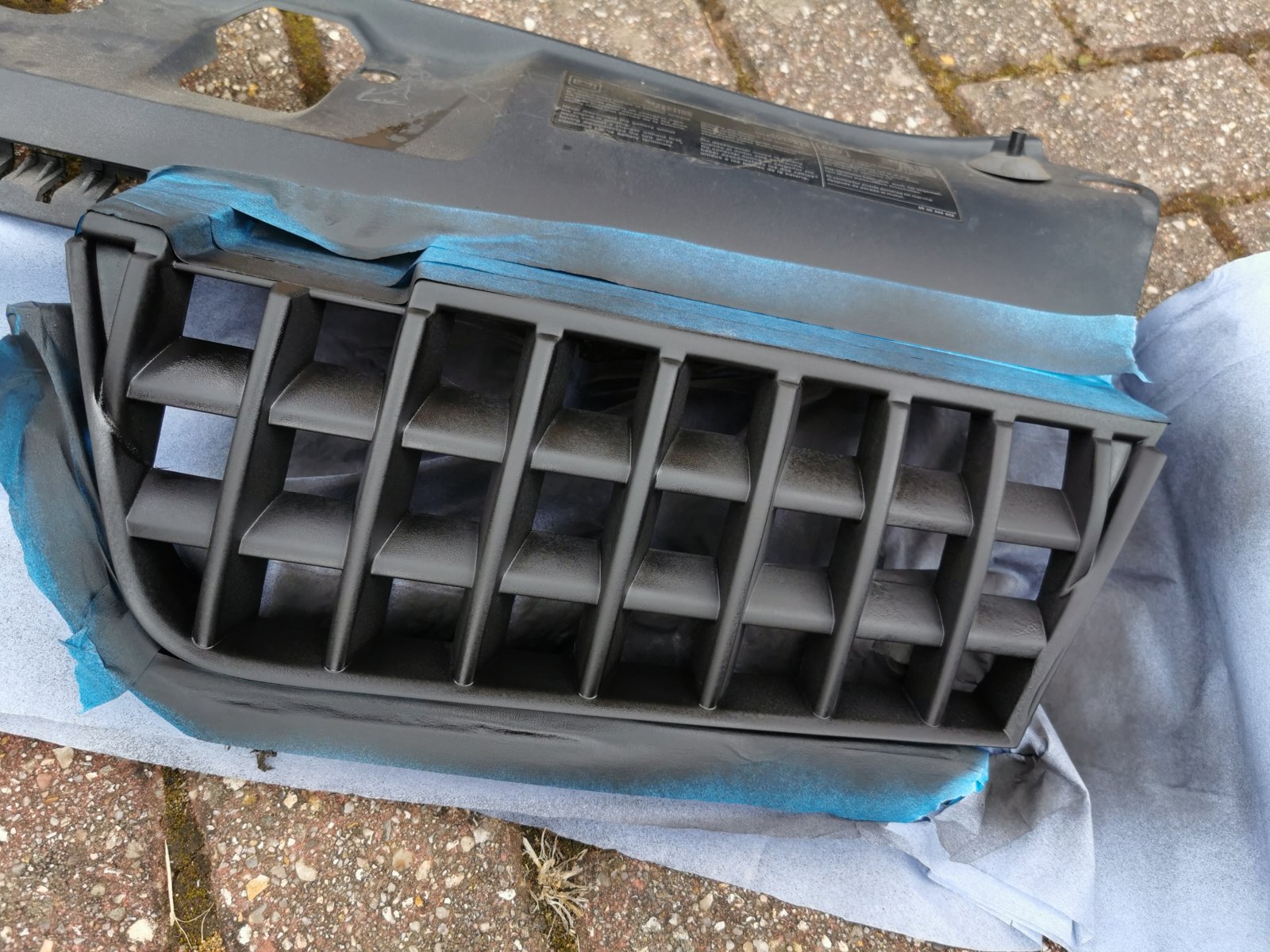

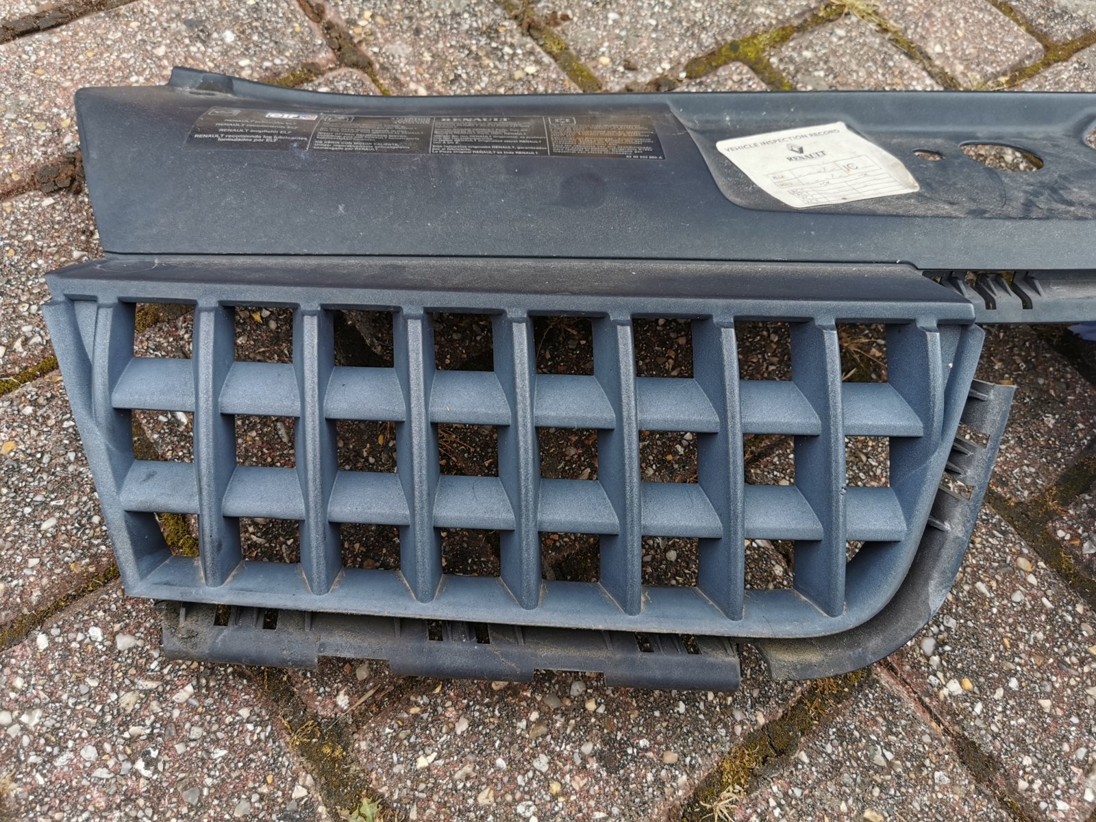

Gave the front grill a couple of coats of satin paint.
Before
1425447
During
1425449
Done
1425450
Then I decided I didn't want the whole blue/back theme anymore and going more oem+
1425451
Definitely liking the freshen up a lot.

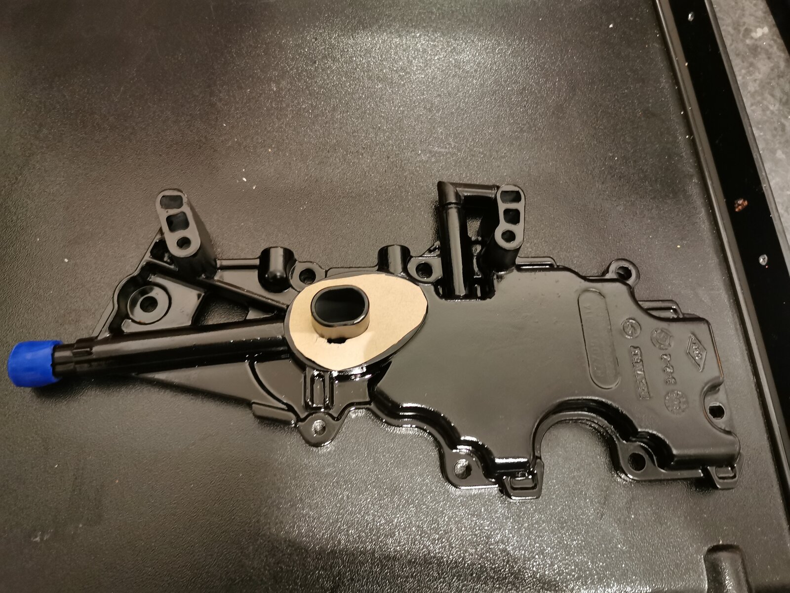

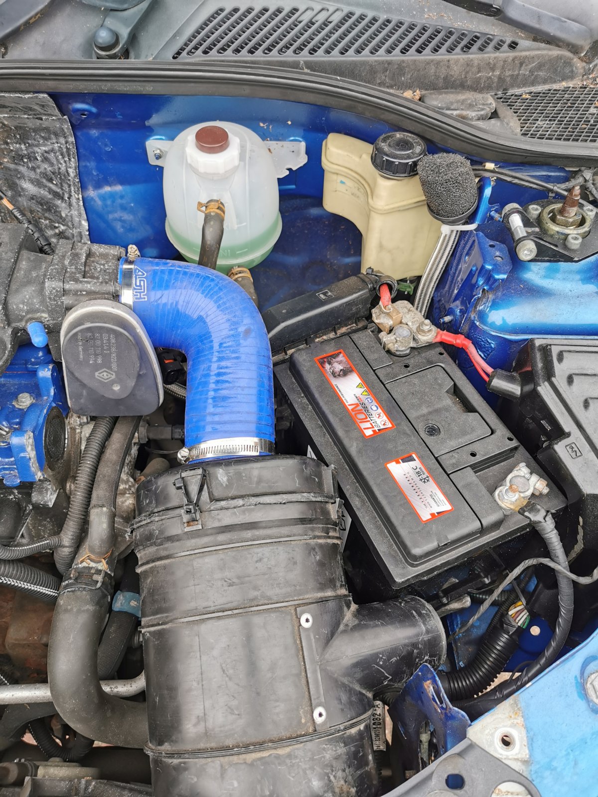

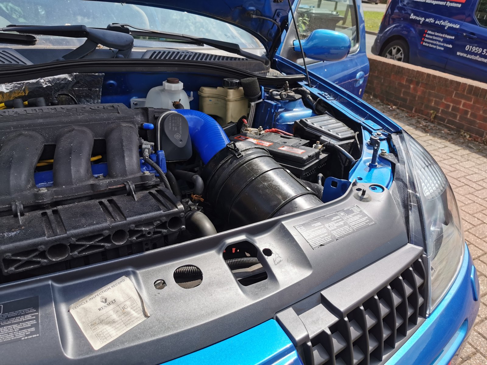

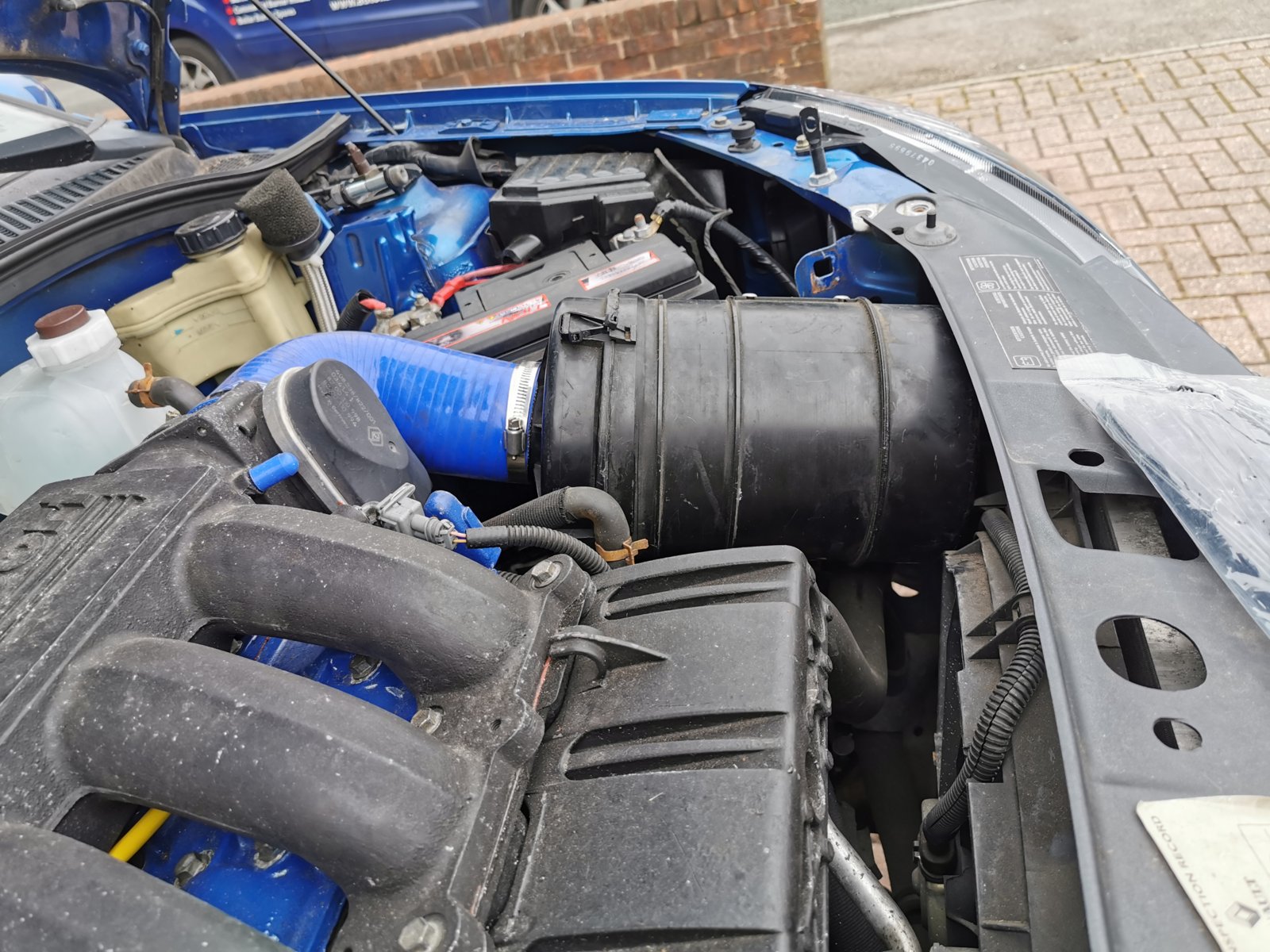

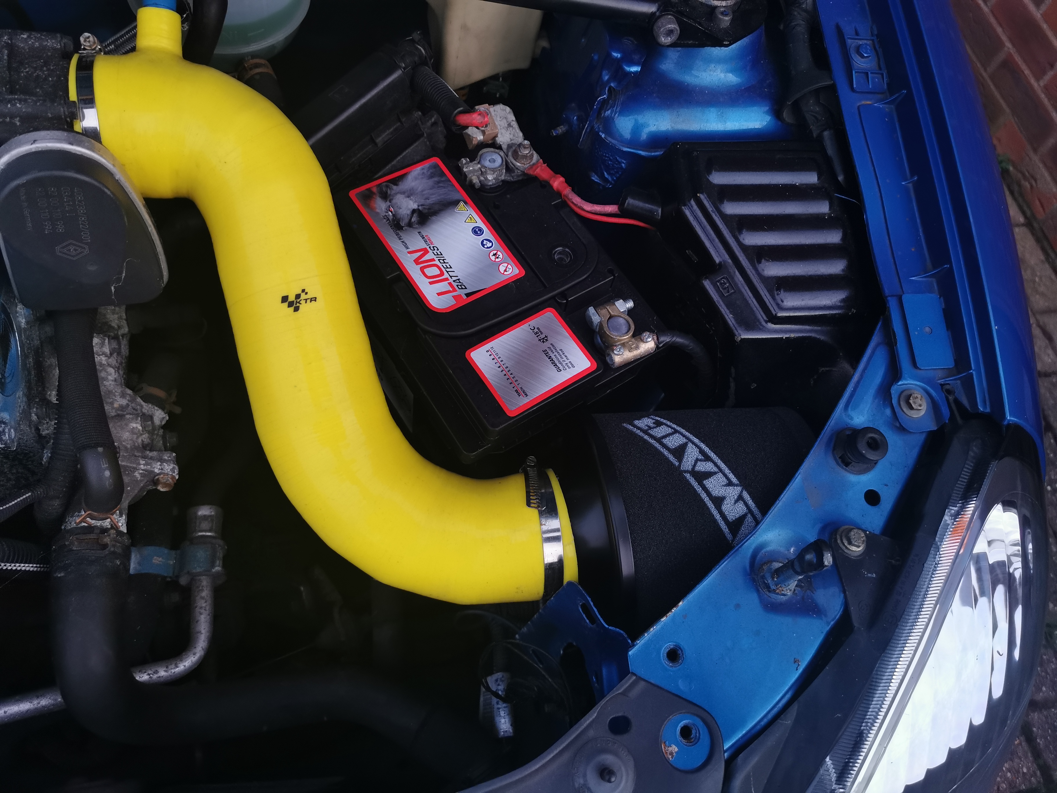

Continued with the OEM+ theme and decided a 172 ph1 air box was more what I wanted than a induction kit.
1425453
1425454
1425455
1425456

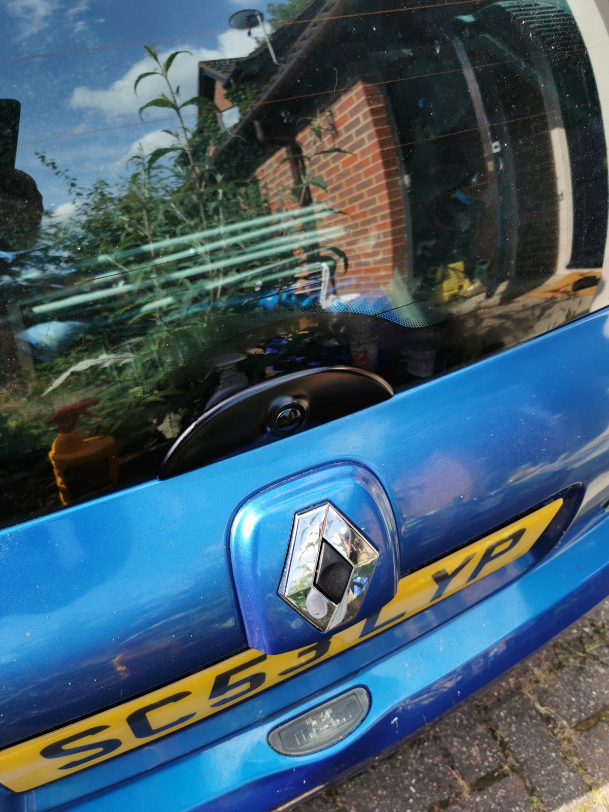

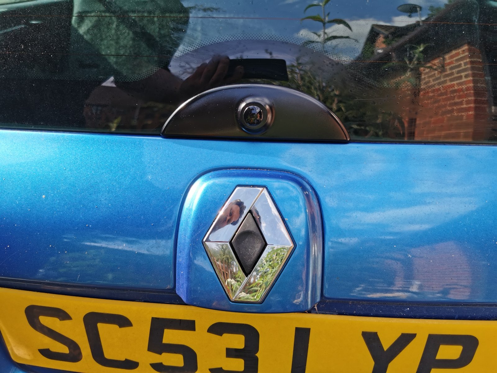

I wasn't keen on the wiper blank, although a custom sprayshack item I want more OEM
So
1425457
1425458

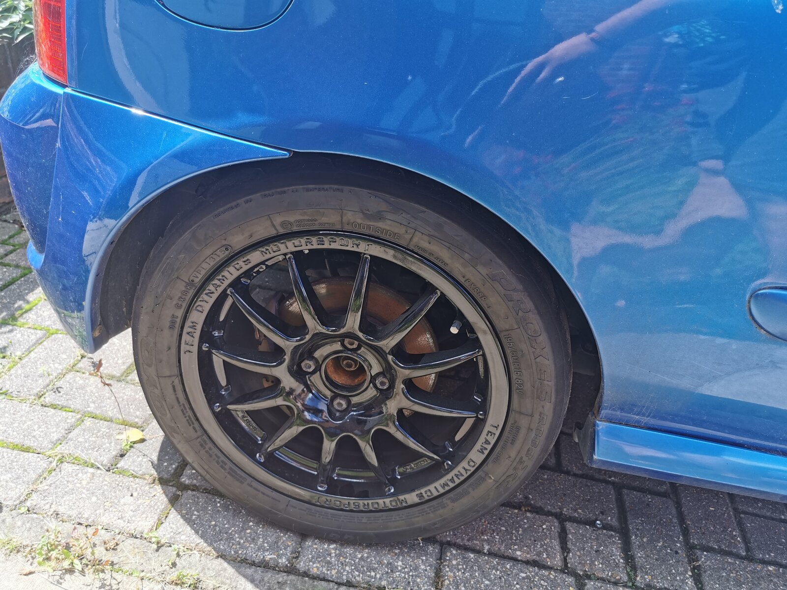

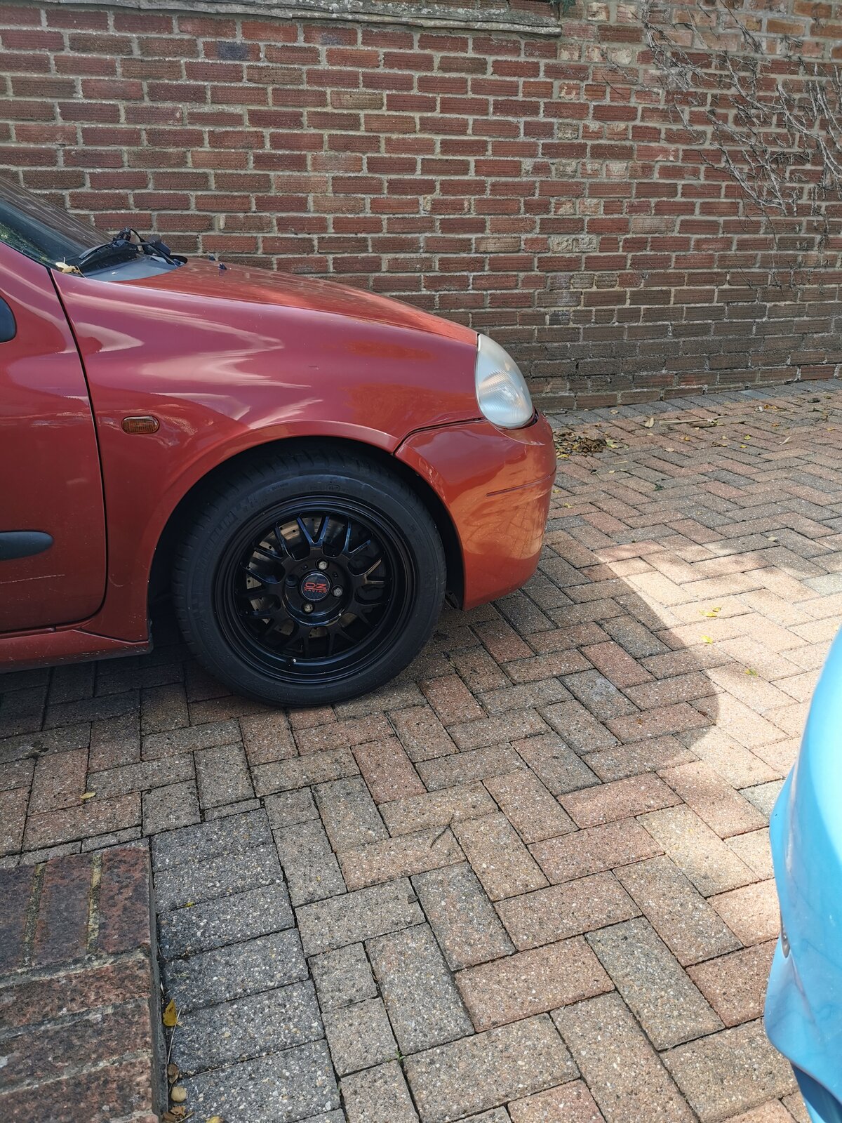

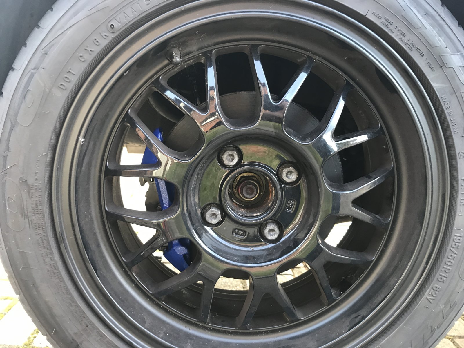

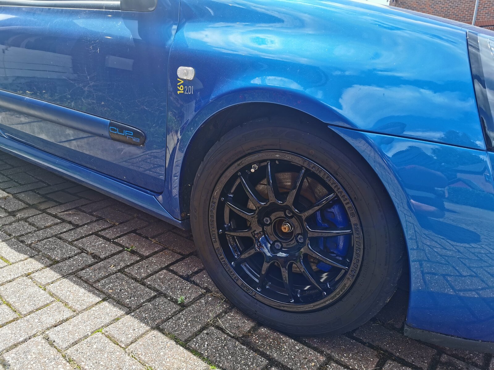

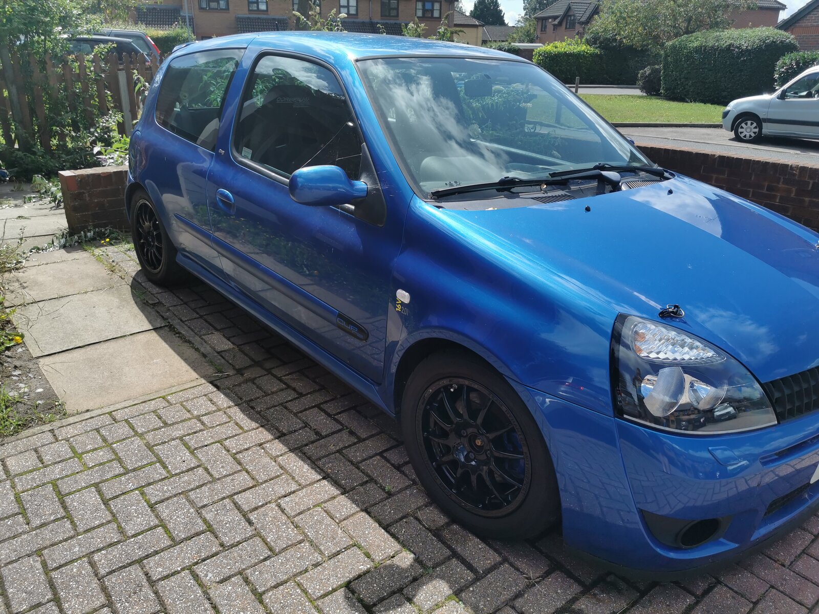

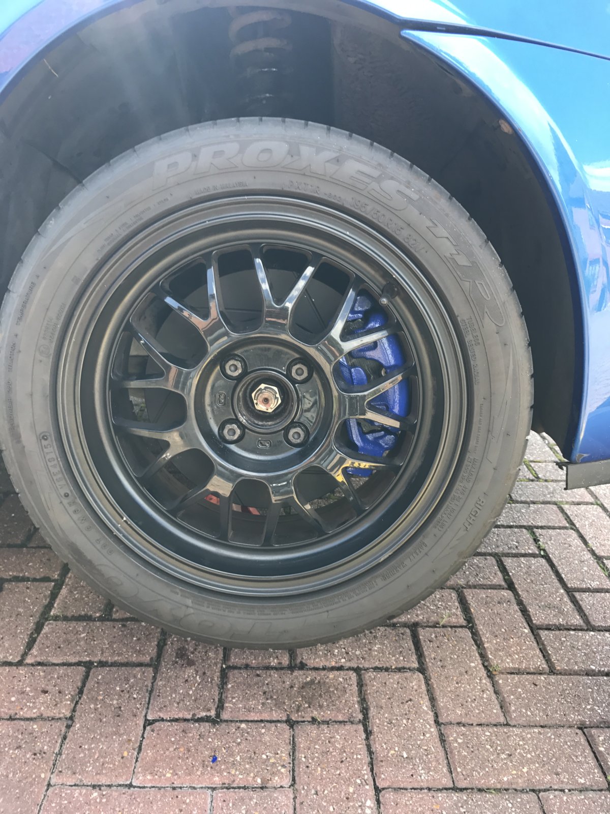

Had a swap of wheels and tyres.
Was on Cades eros stealth 15 x 6.5j et30 wheels with 195 50 15 pilot sport 3 tyres
My brother had a issue with fitment of his new wheels on his ph1 172 and also a road car used for commuting down the m25 so the toyo r888r wasn't ideal, so a trial fit of my wheels on his car and we decided to swap
Mine old wheels coming off
And now fitted on his car
And now team dynamic pro race 1.2 15x7j et35 with 195 50 15 toyo r888r, 3.1mm on the front and 2mm on the rear so need changing soon.

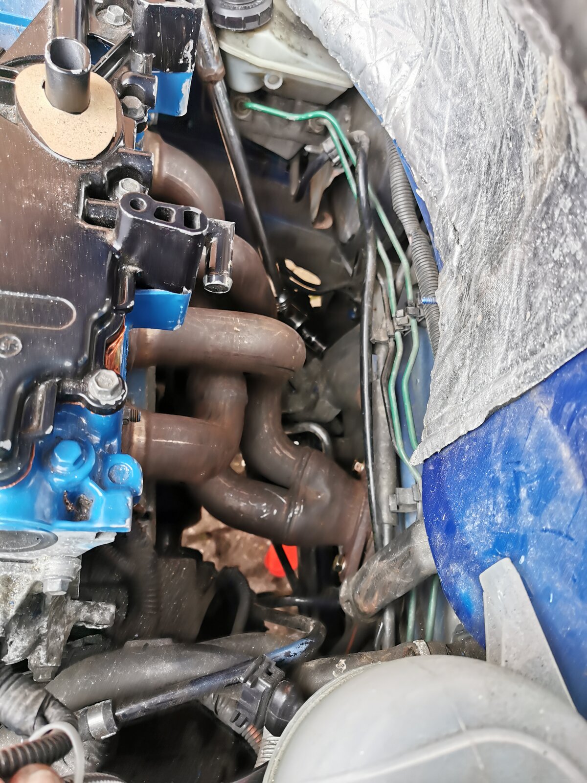

Been a while since I have updated this and its had some progress.
I decided I was going to fit some parts I have collected and had sitting around.
182 manifold
182 miltek sport cat
Modify the existing exhaust system.
Well this meant removing the subframe to fit the manifold.
So I decided I would also fit new powerflex black series steering rack bushes, purple anti roll bar inner and outer bushes while I was at it.

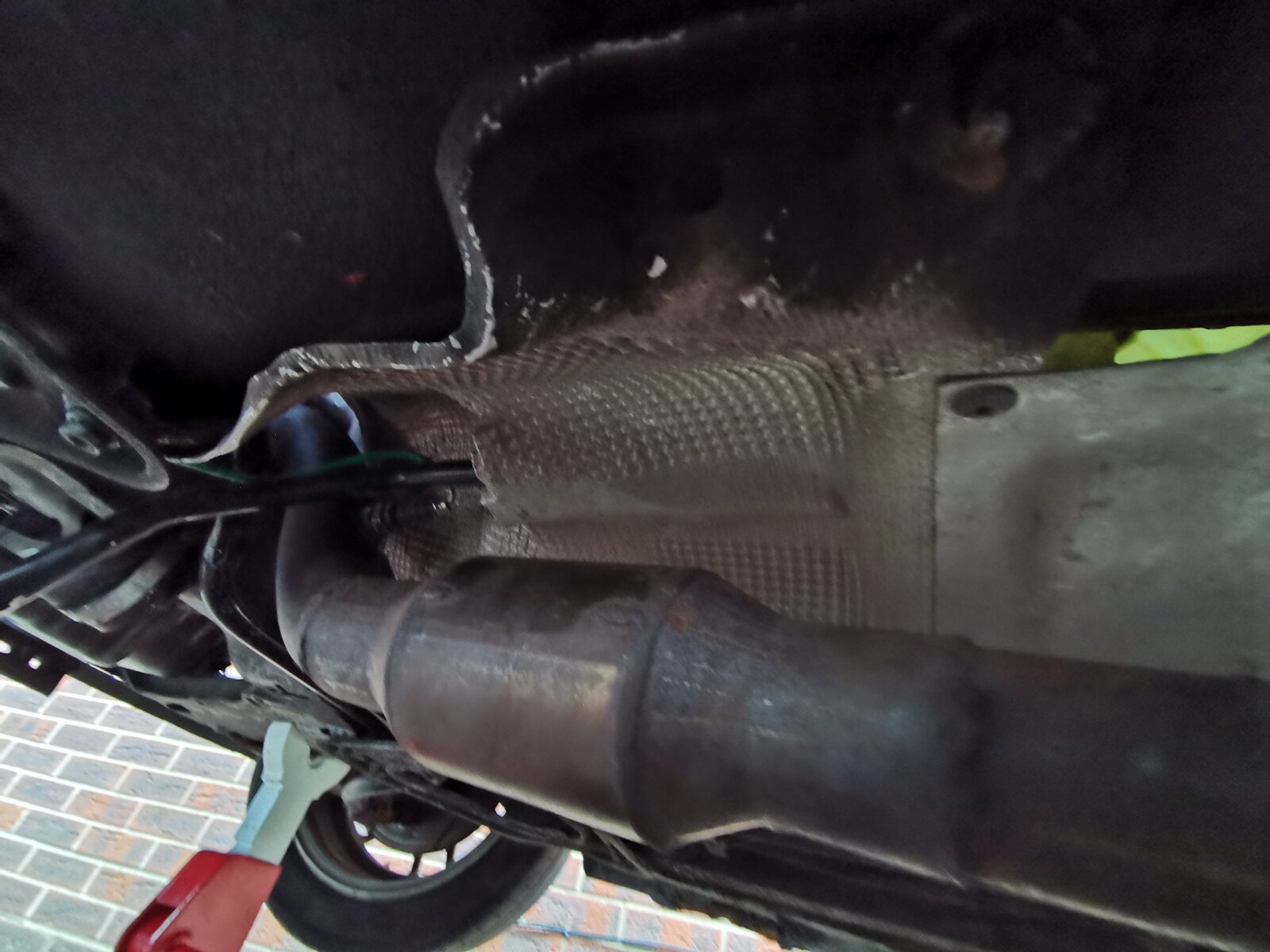

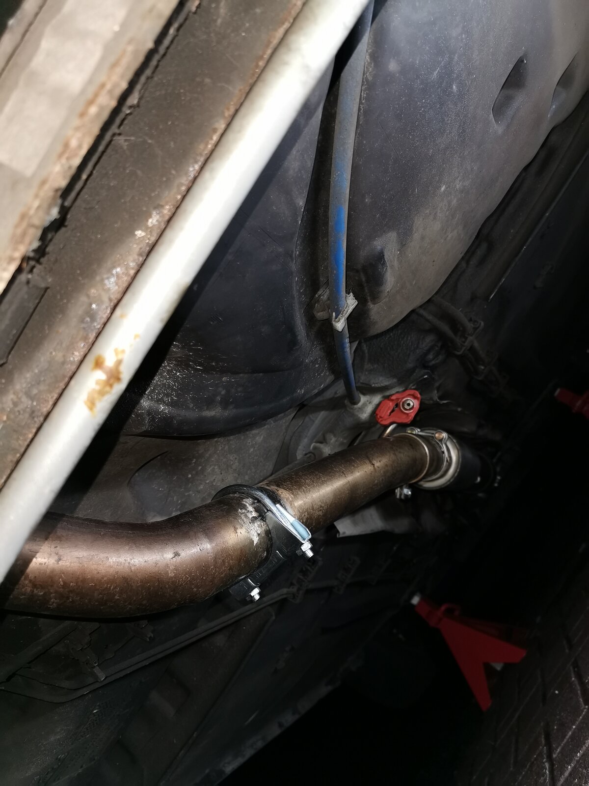

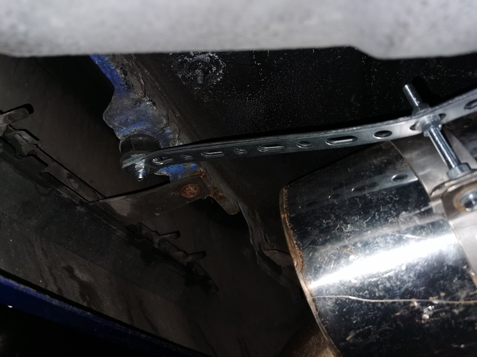

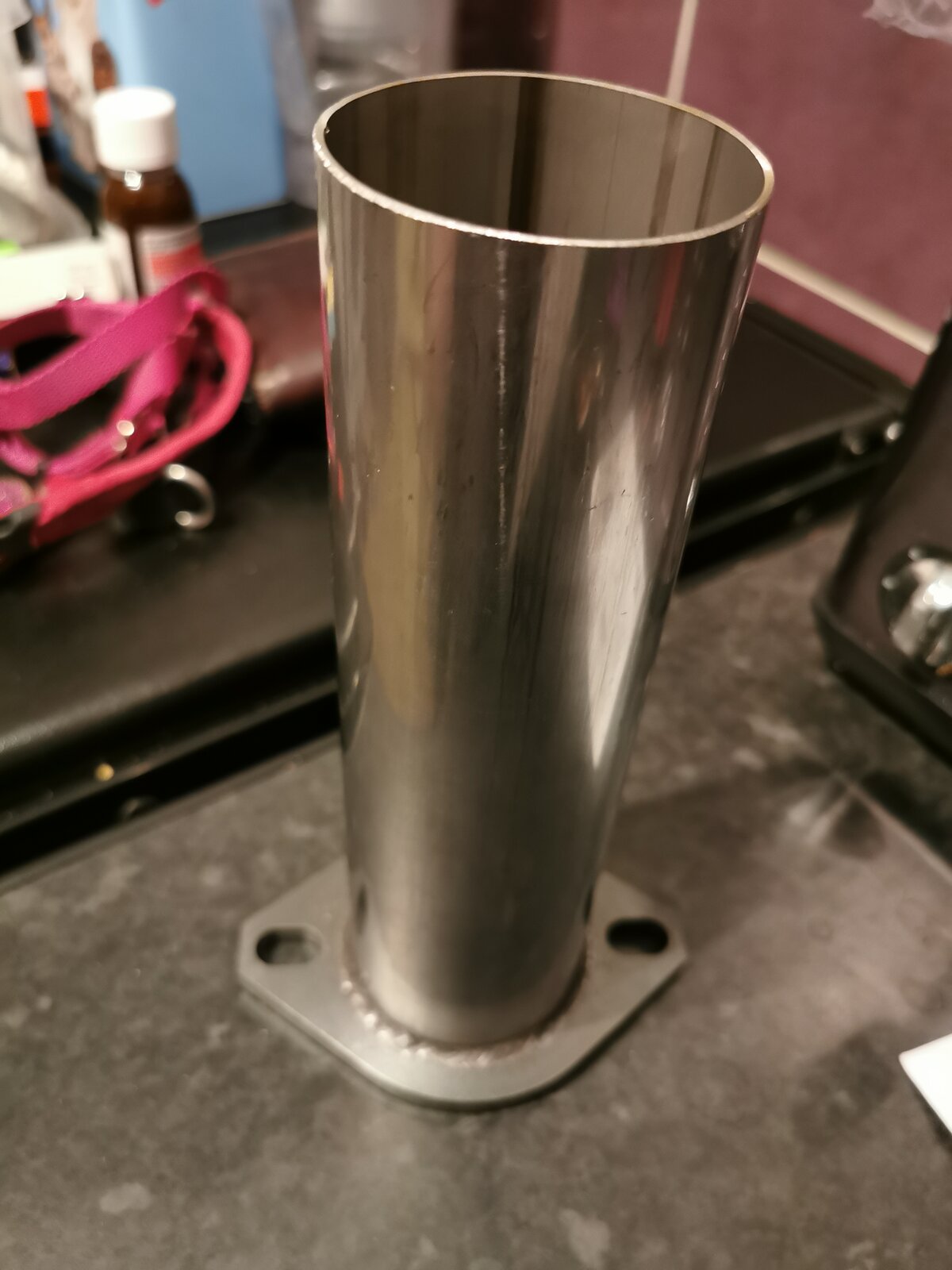

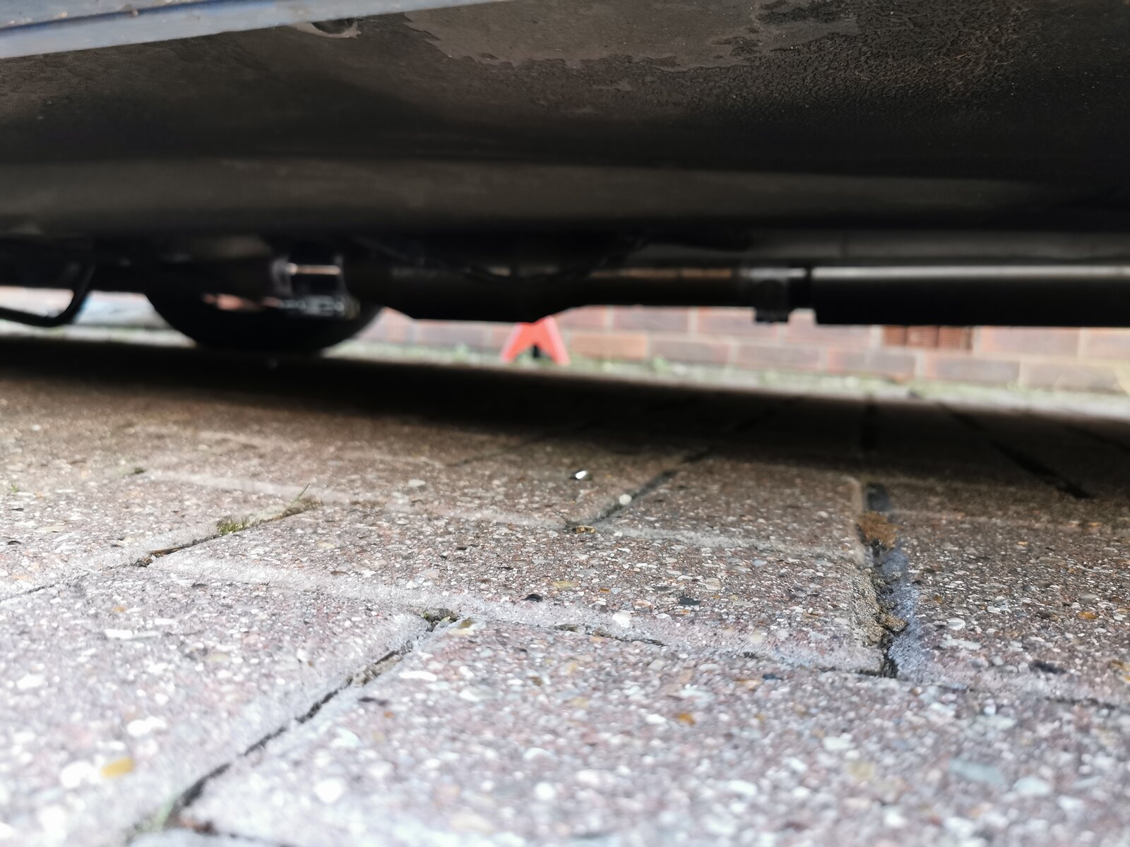

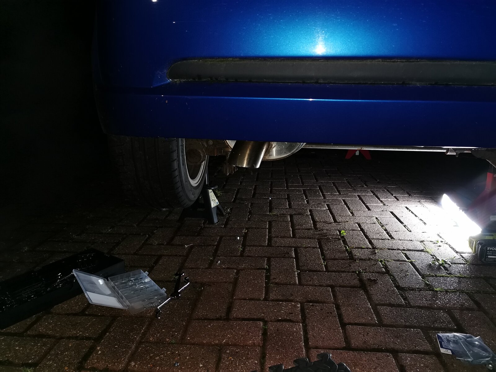

OK so fired it up and the exhaust was a bag of nails 🙄
In its current state it was a ktec stealth system. 4"x18" universal silencer chopped in, miltek sports cat and a slip coupling to the 182 manifold as the flange had been cut off both!
Moving the car around resulted in the exhaust twisting and leaking.
So given the short amount of time I had I swapped to u bolts clamps and made a extra bracket for the back box.
It wasn't the best at all but I hoped it would be quite enough for the track day and solid enough.

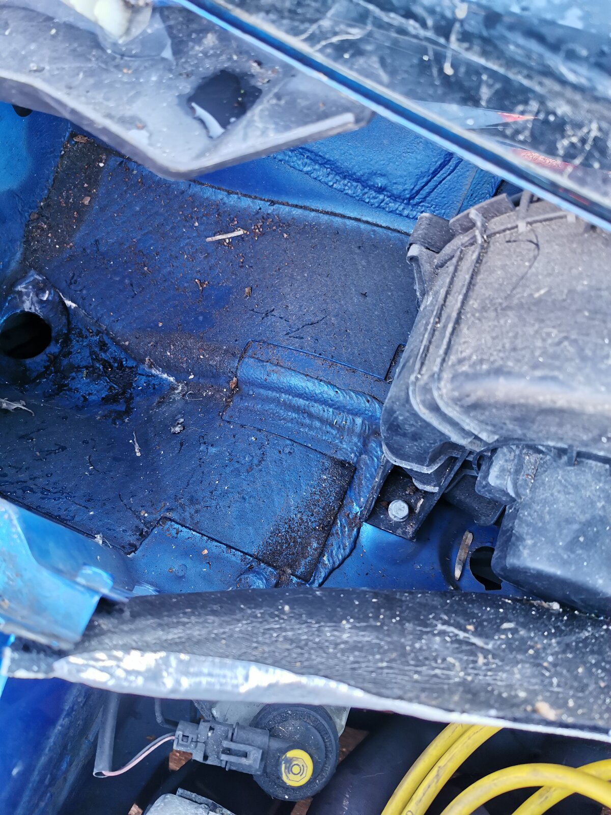

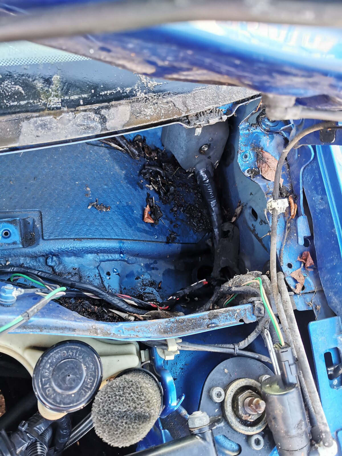

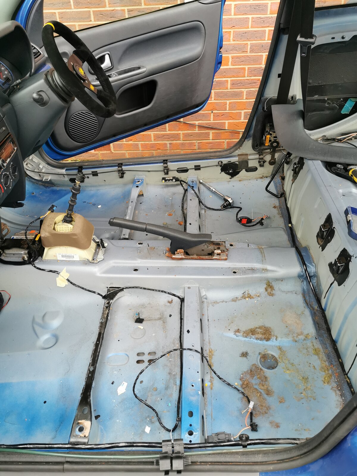

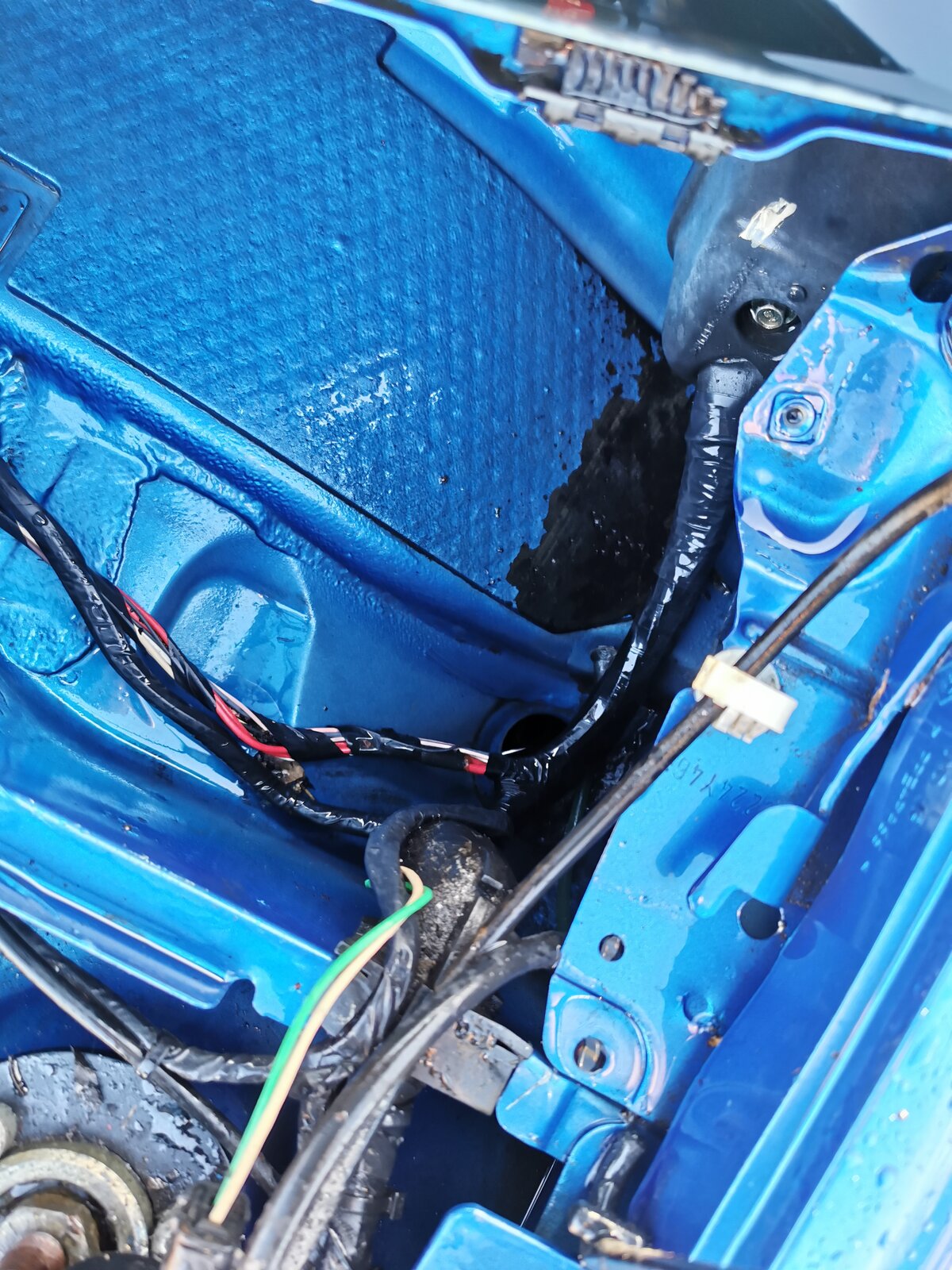

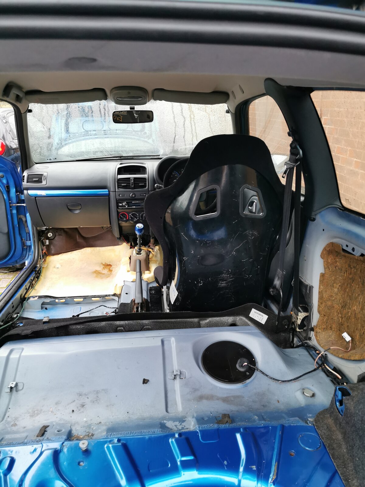

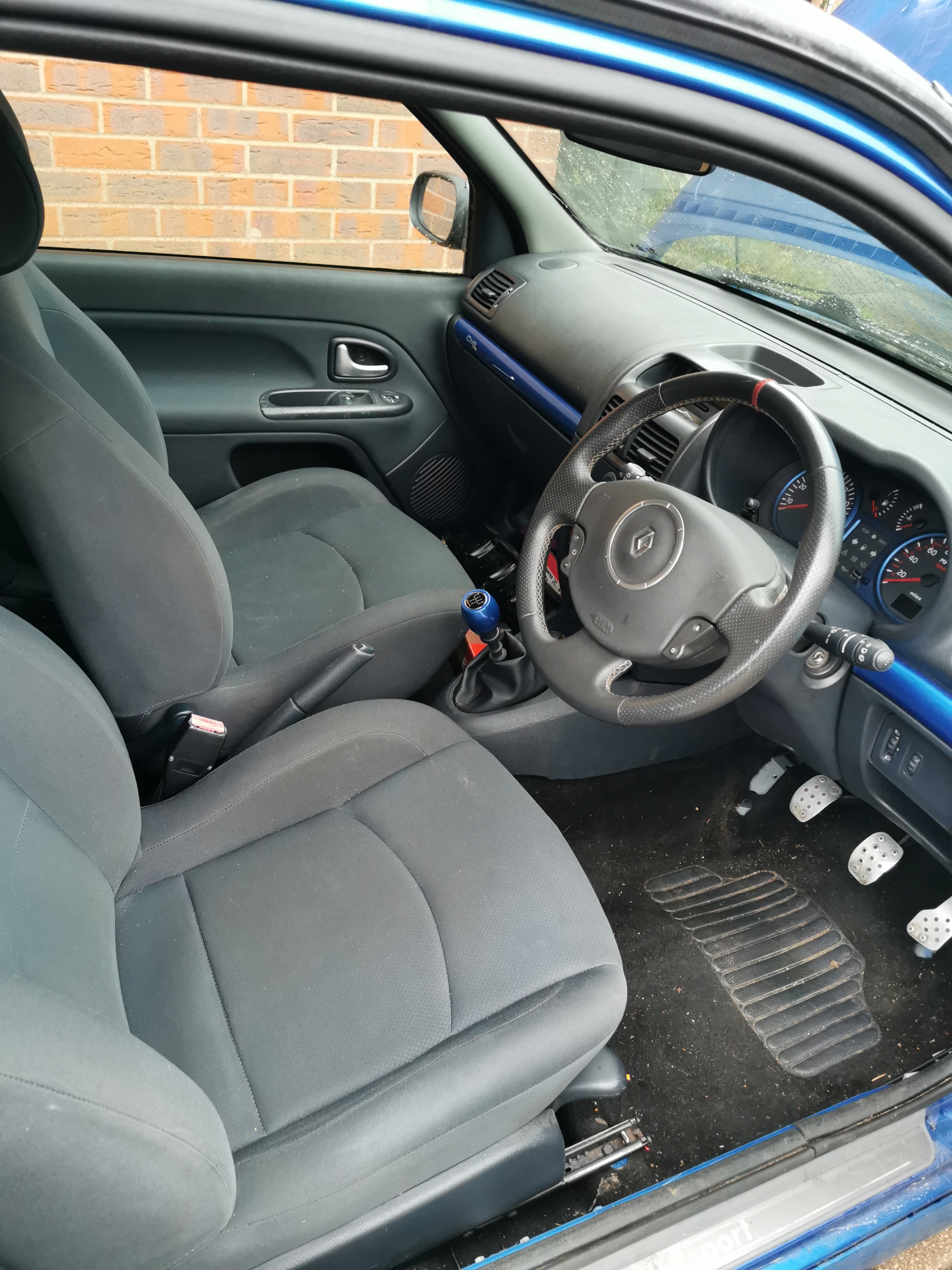

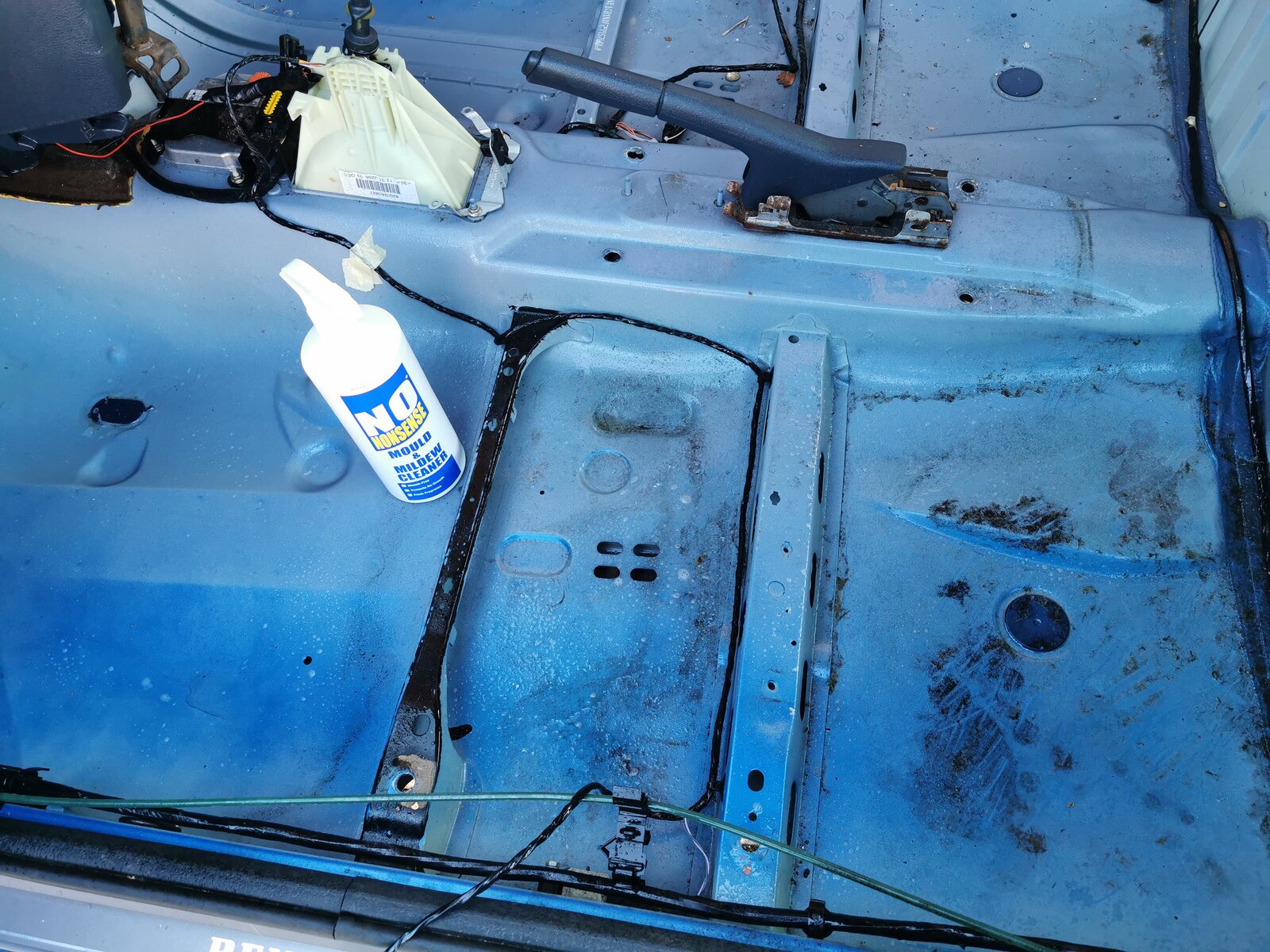

Then I came out one morning to find the passenger carpet mouldy and the seat belts mouldy 😭
So I decided a full strip down to find out what as going on.
After it was all clean, carpet had been sanitised etc I decided I might as well put my sparco evo 2 seat in, Alot of faffing and it was in place
I took out all the foam again and rear under carpet mat and put the carpet back in as I wanted a little comfort, I also put my passenger seat back in.
The rear seats where taken down the tip as where in poor condition due to the mould and all other trim put in the loft.
Swapped over steering wheels as you might of noticed as I felt the motamec wasn't good enough so I got a OMP targa 330mm wheel.

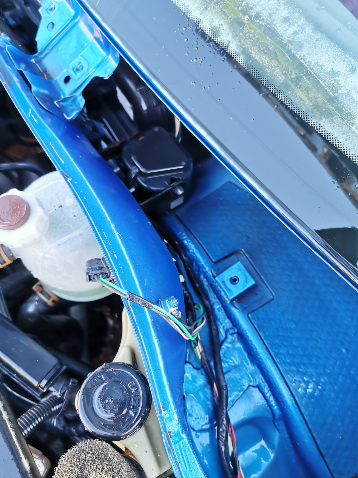

Now I moved on to stop the water returning so I had to remove the scuttle panels.
It was pretty dirty under there
Bit of a scrub up and the drains checked

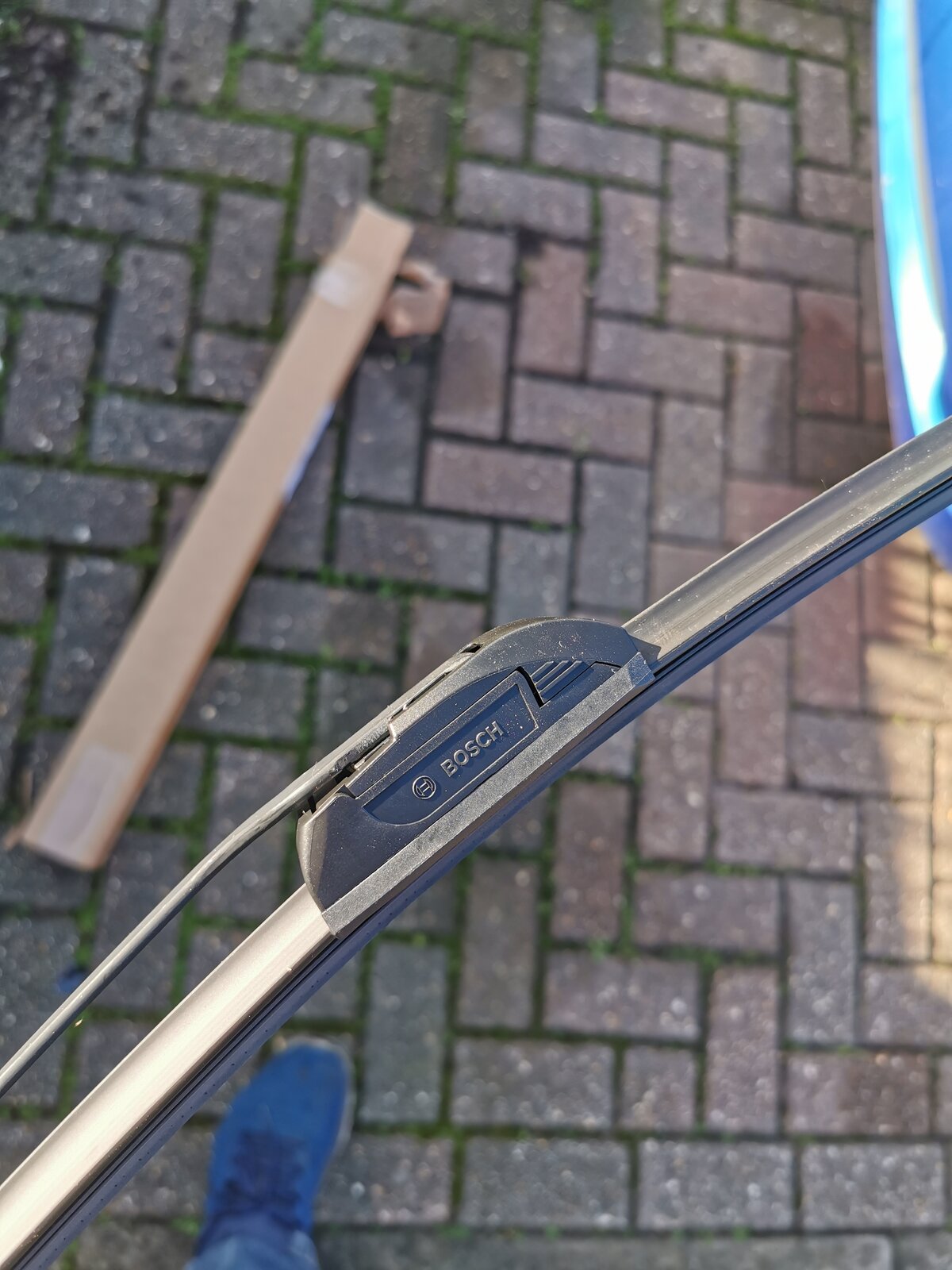

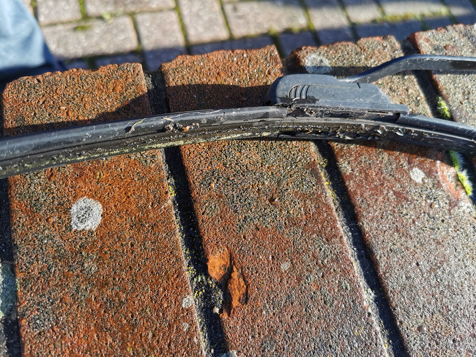

The wipers where absolutely shot to bits
New bosch aero twins fitted.

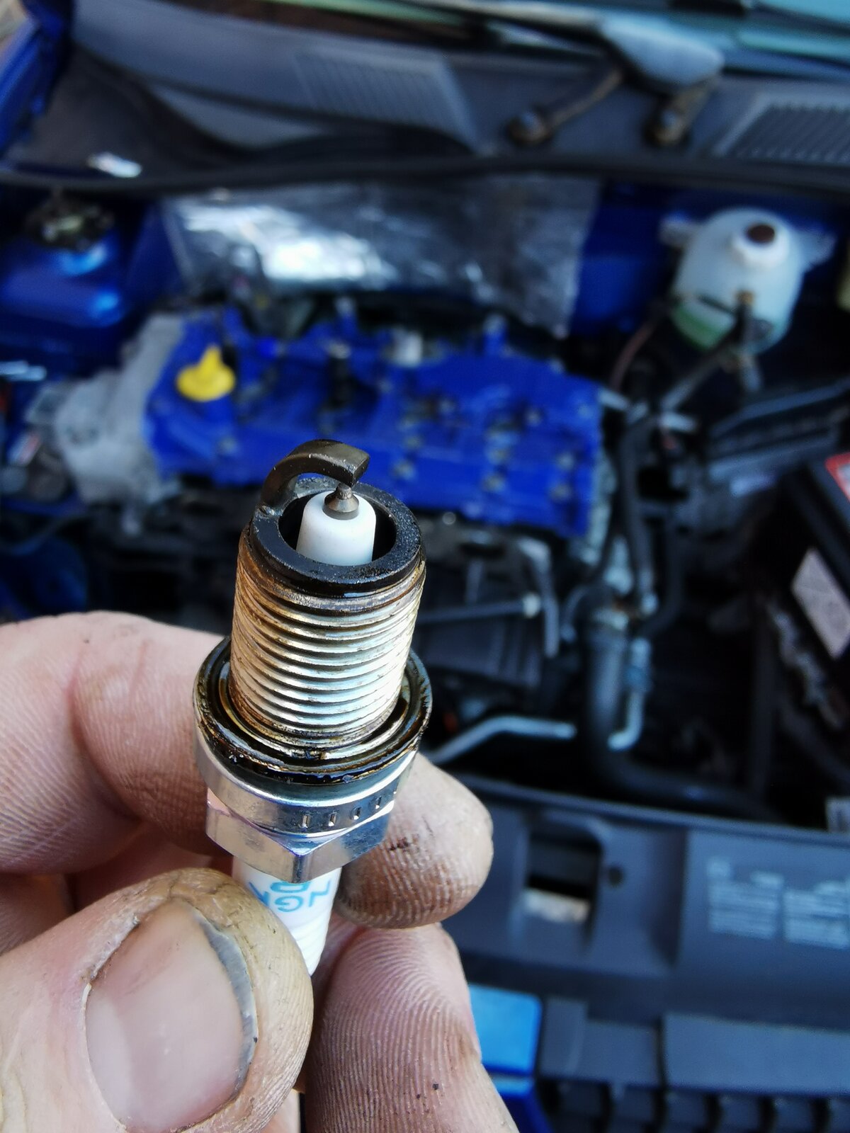

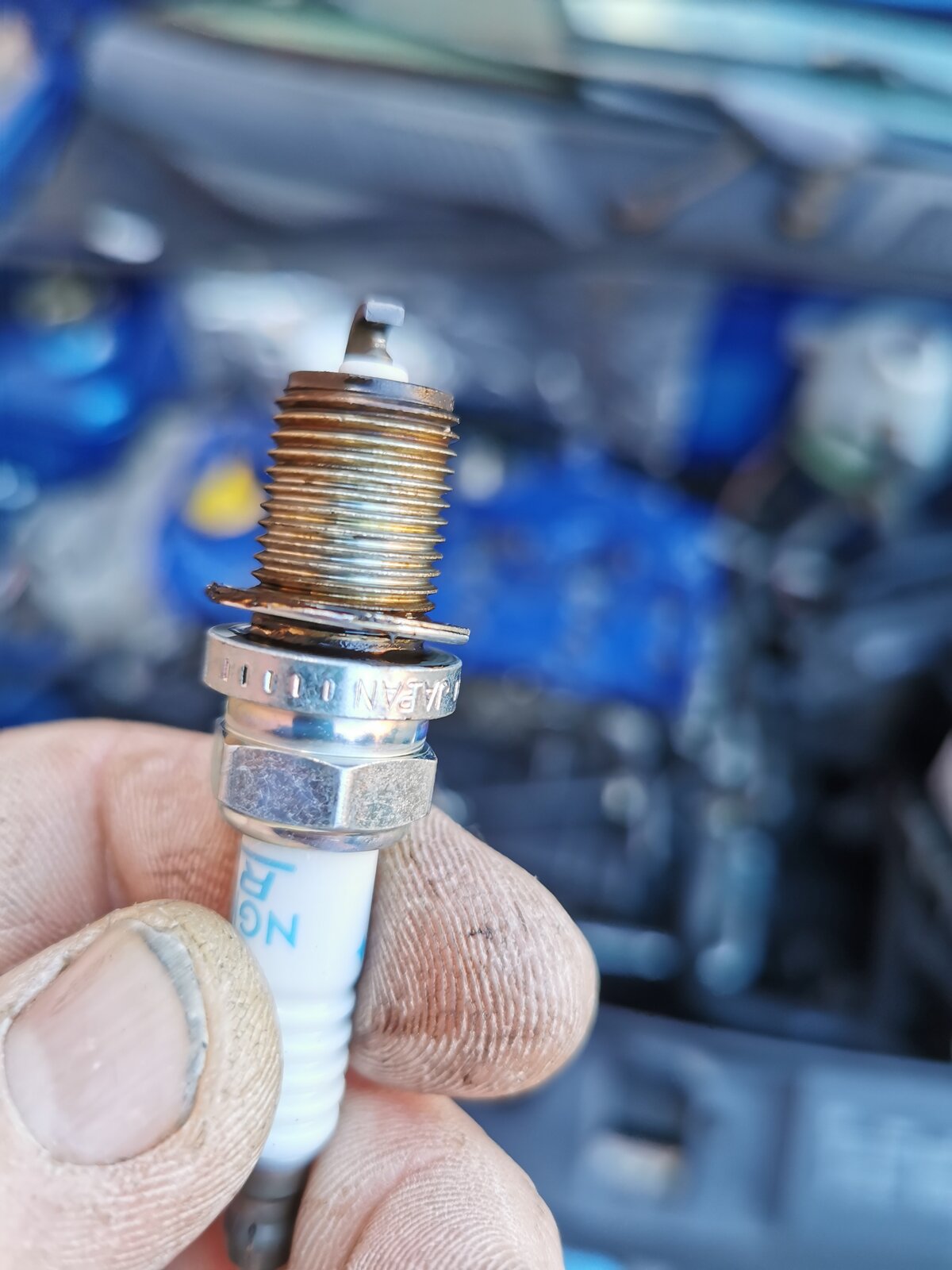

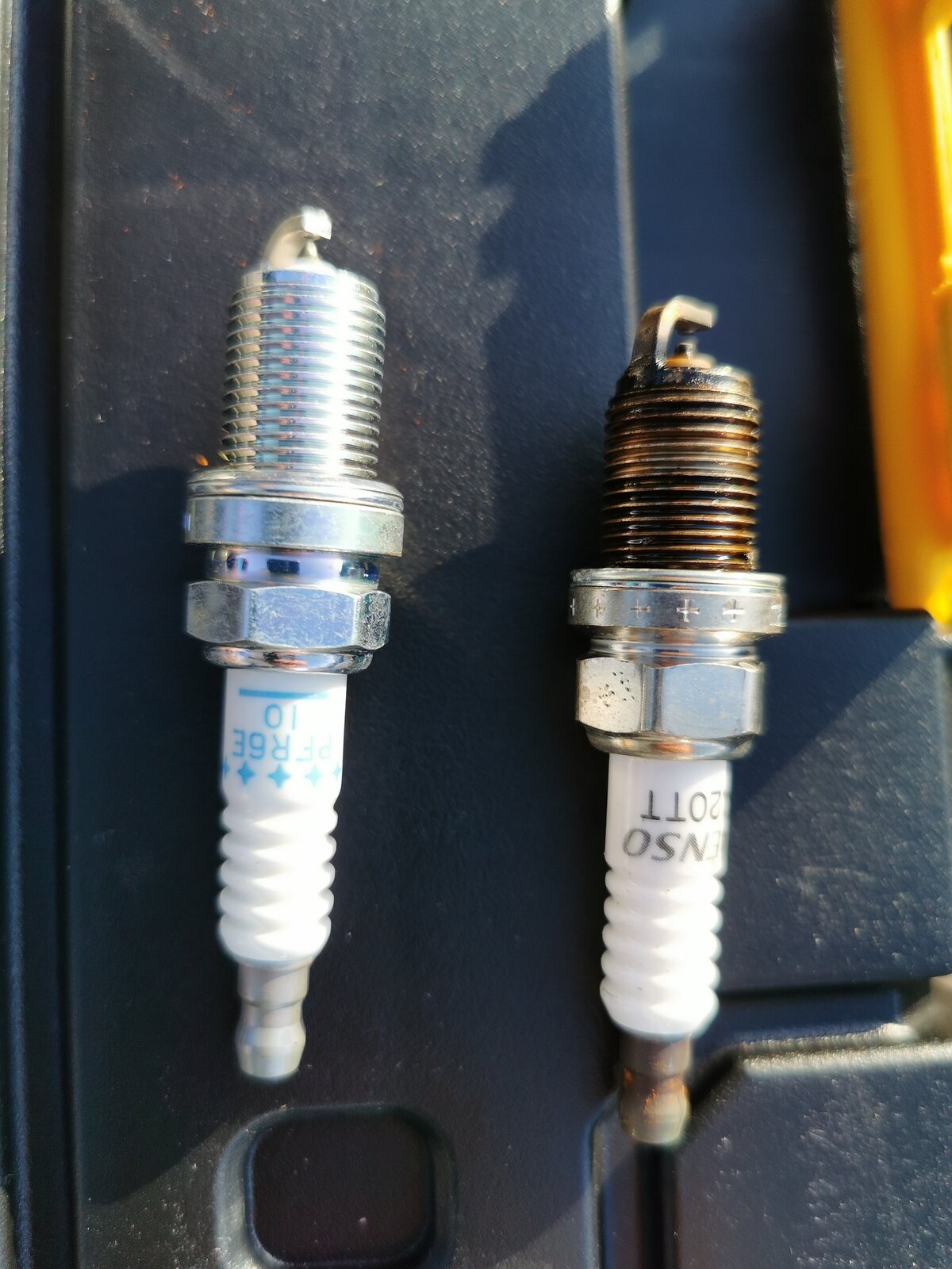

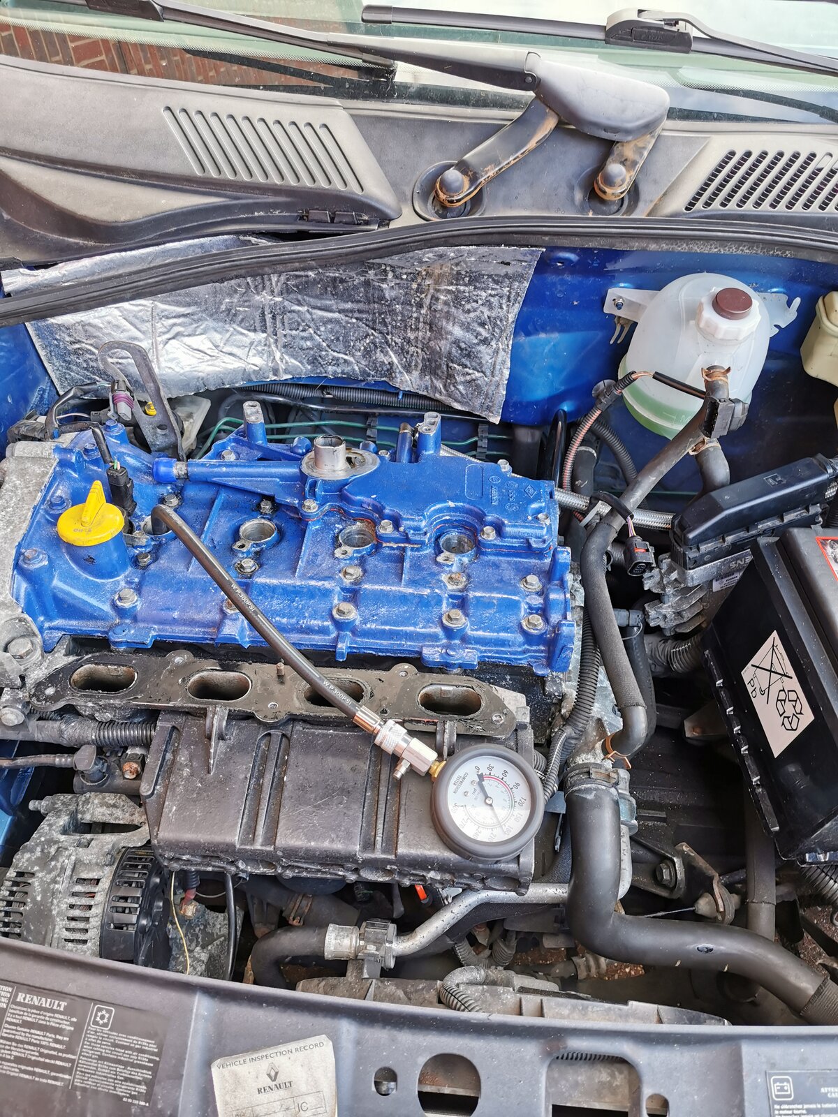

Then new plugs fitted
Old ones where cheap denso tt plugs so swapped out to genuine renualt ngk plugs.

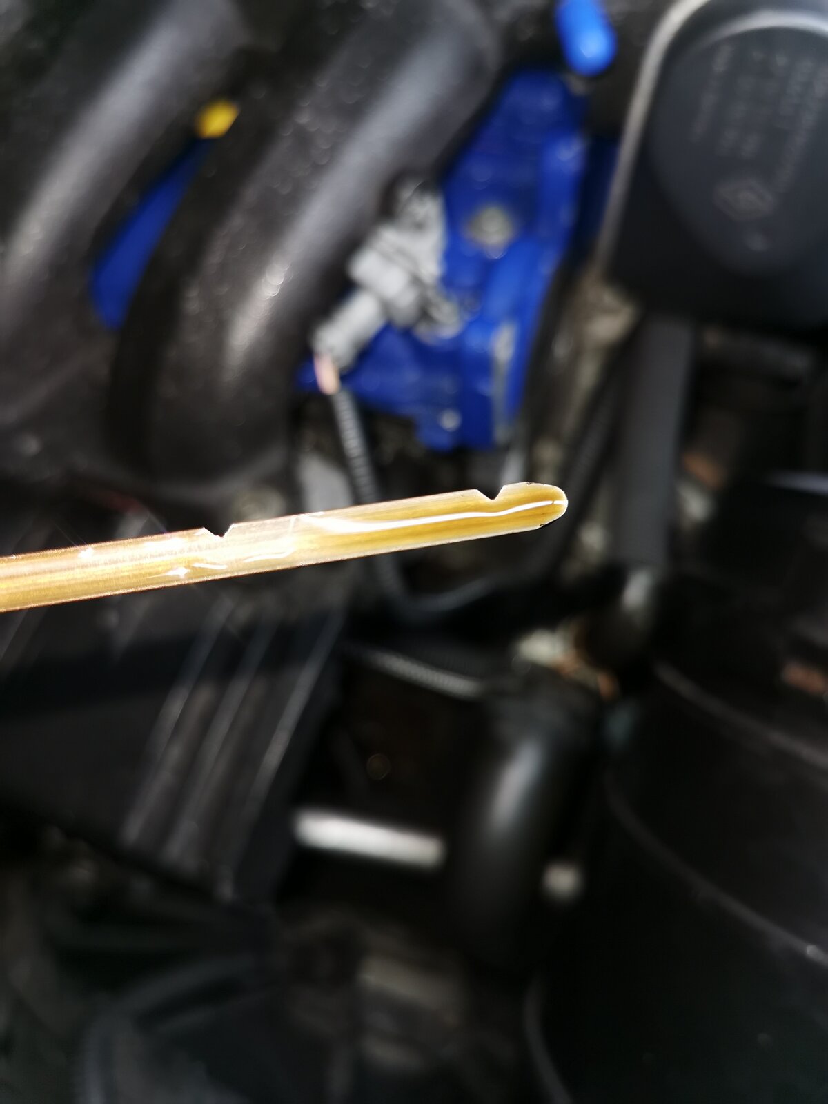

Checked the oil too which had only done 500 miles so that was left

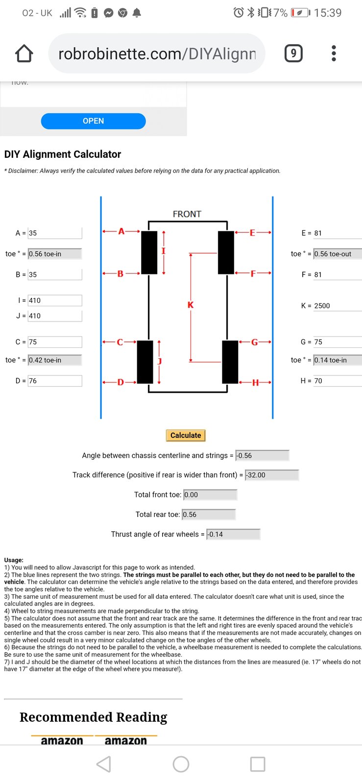

Had to do a alighment using my camber guage and string alighment technique. Wasn't perfect but OK.
I was running - 2 deg front and about -1 deg rear.
Then it was mot'ed and passed which was a relief.

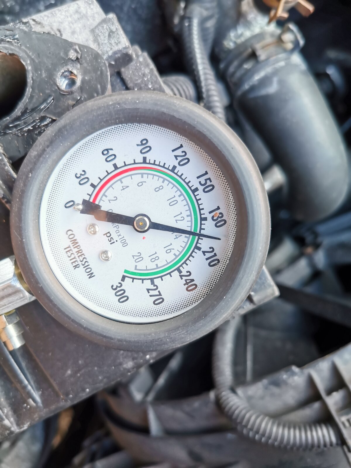

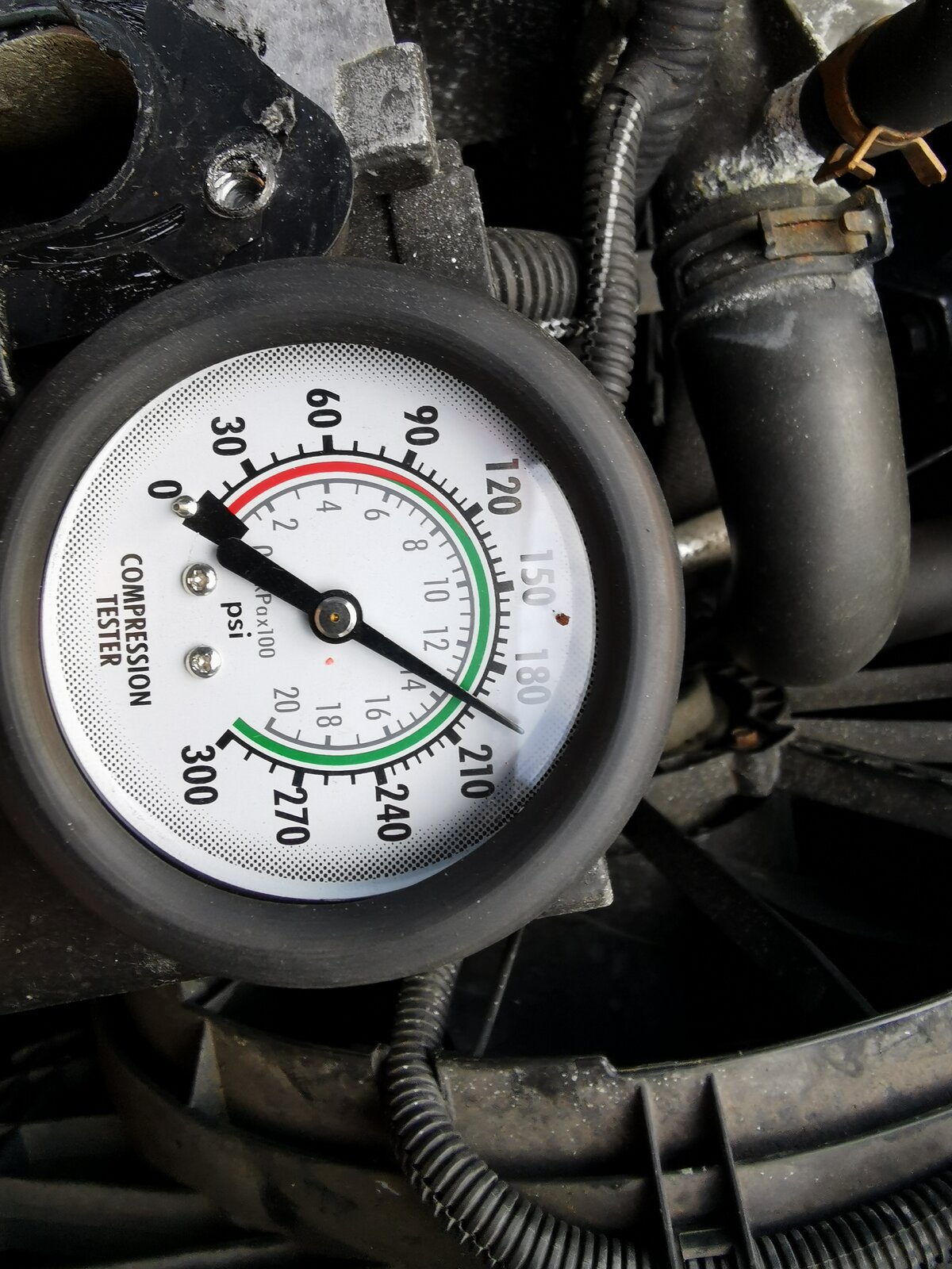

So the strip down to see what is wrong begins.

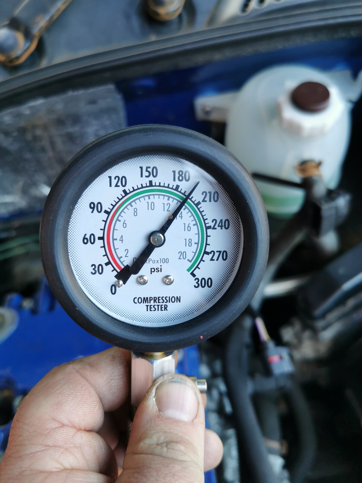

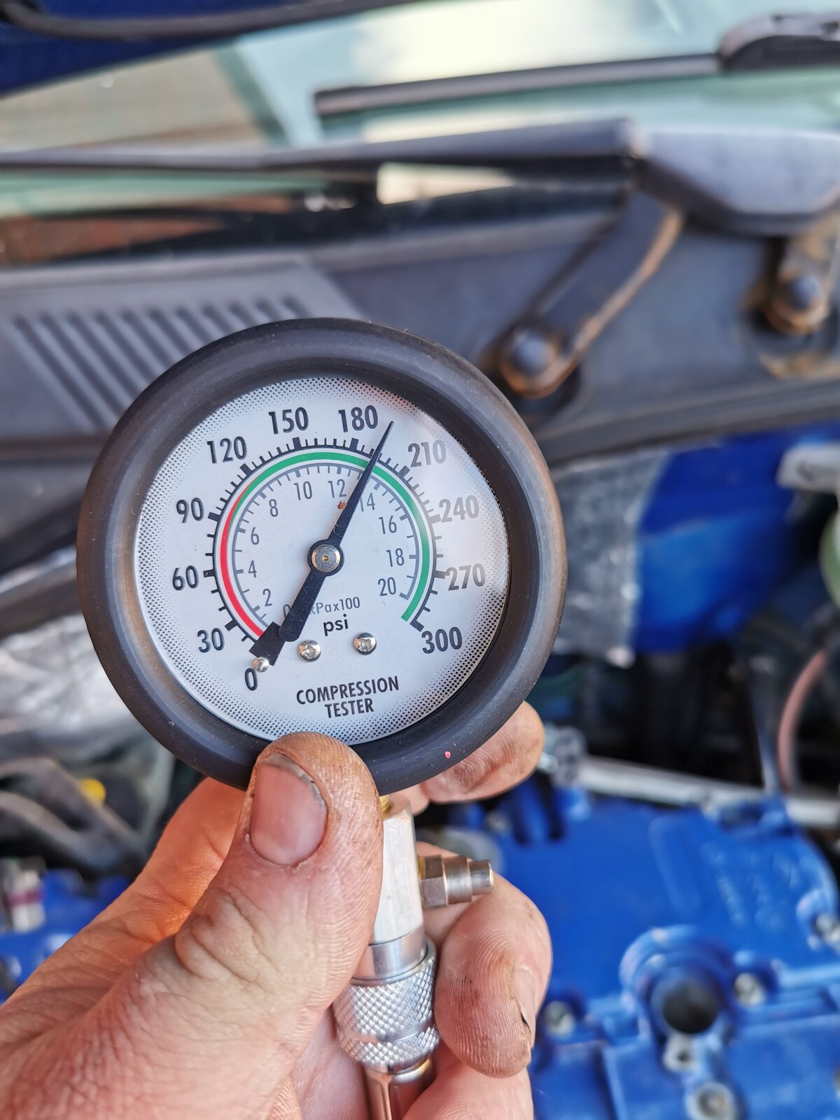

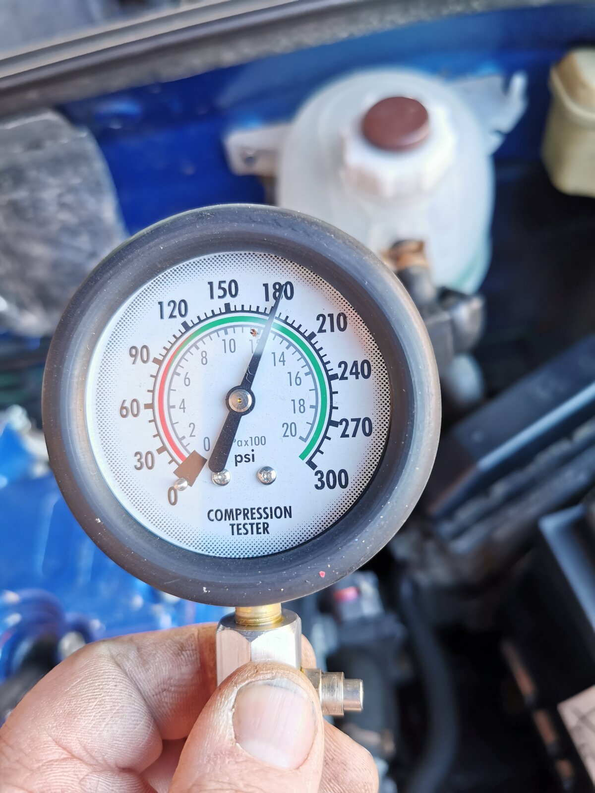

First off to take the manifold off and check the leads, plugs and compression just to make sure nothing really bad has happened.
Plugs are pretty dirty for 100 miles and 1 trackday!

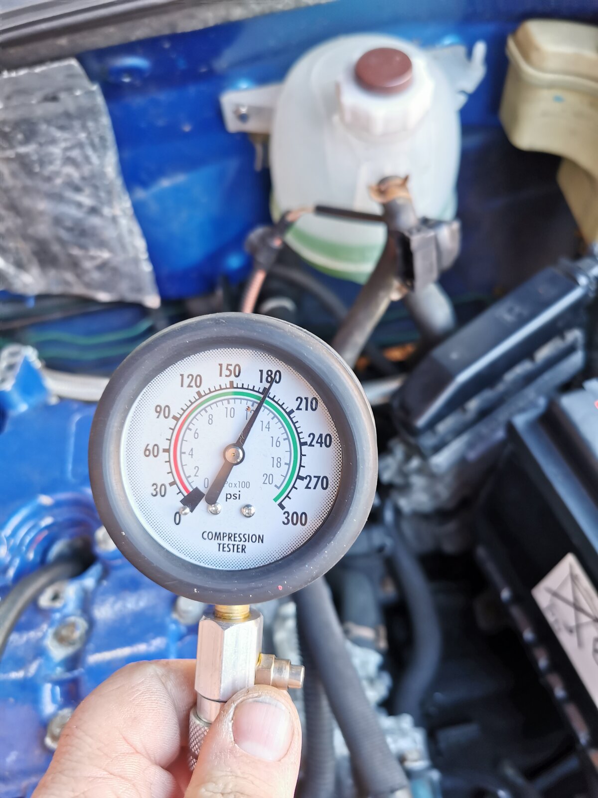

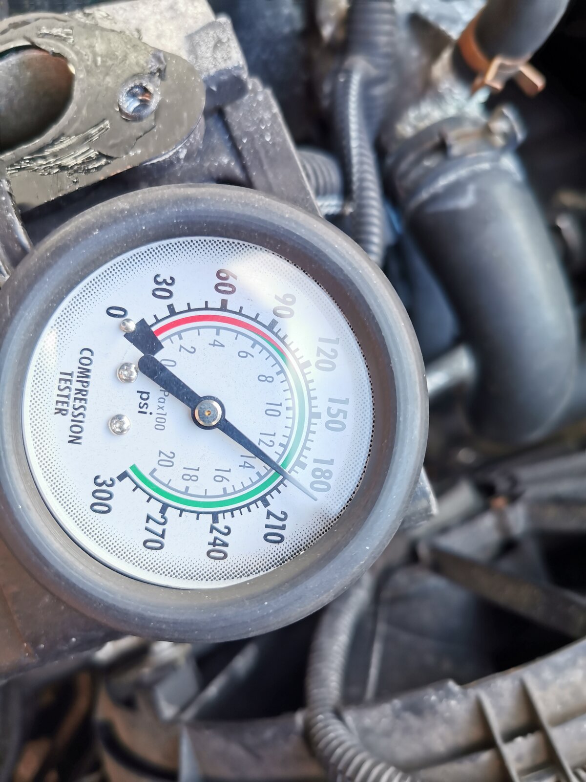

So compression test
Cly 1 =180psi two min letby test and still at 180psi
Cyl 2 = 195 psi Two min let by test still 195psi
Cyl 3 195 psi two min letby still 195 psi
Cyl 4 = 190 psi two min letby still 190 psi
So thankfully all good on the compression front, plugs where cleaned up and put back in but I put that down to running pretty rich due to the lambda wires dying.
So now I know I don't need a new engine I will sort the exhaust and update from there 😁
A little progress.
I noticed the pain on my cam cover was flaking and the was a oil leak from the breather plate.
It was a long job picking and scraping all the old paint off the cam cover.
Degreased and then preped for paint.
Three coats of Etch primer
Hammerite smooth blue used as a base paint
I wanted the breather plate a different colour to help identify any leaks later on.
I decided to block off the tiny breather condense hole as it's pretty pointless as it's near identical location to the main breather hose port, I made a blank using 1.5mm gasket paper.
Bonded it down with locktite copper gasket maker.
Then installed the plate back on the cam cover using the same stuff.

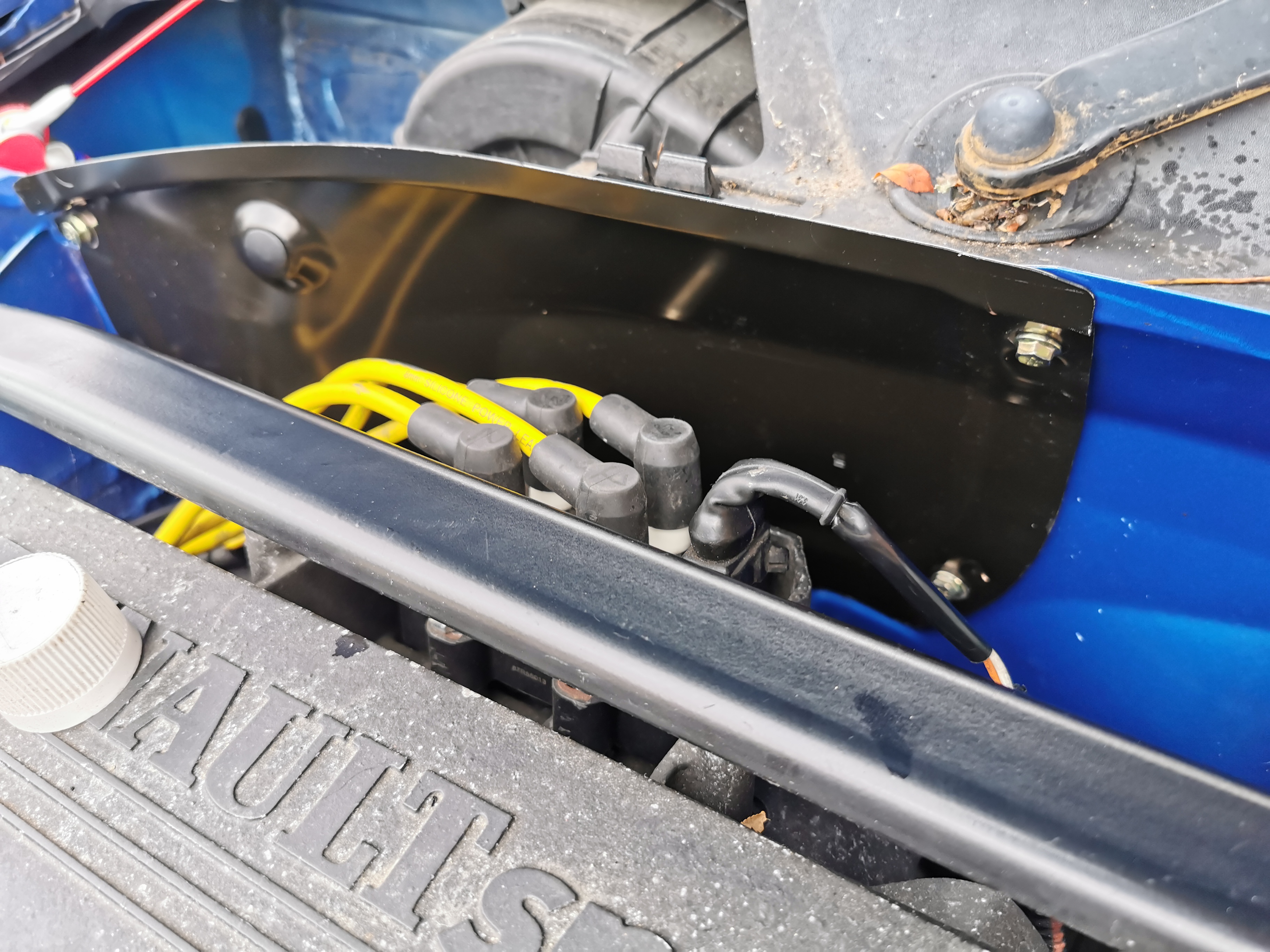

As you can see I removed all the tape etc and put the leads back in and found one wasn't going on the plug properly so might of been the misfire cause, we will see.
Next I will move on to the exhaust manifold and sort the exhaust properly. Also looking into properly porting the Inlet's using ms motorsport.

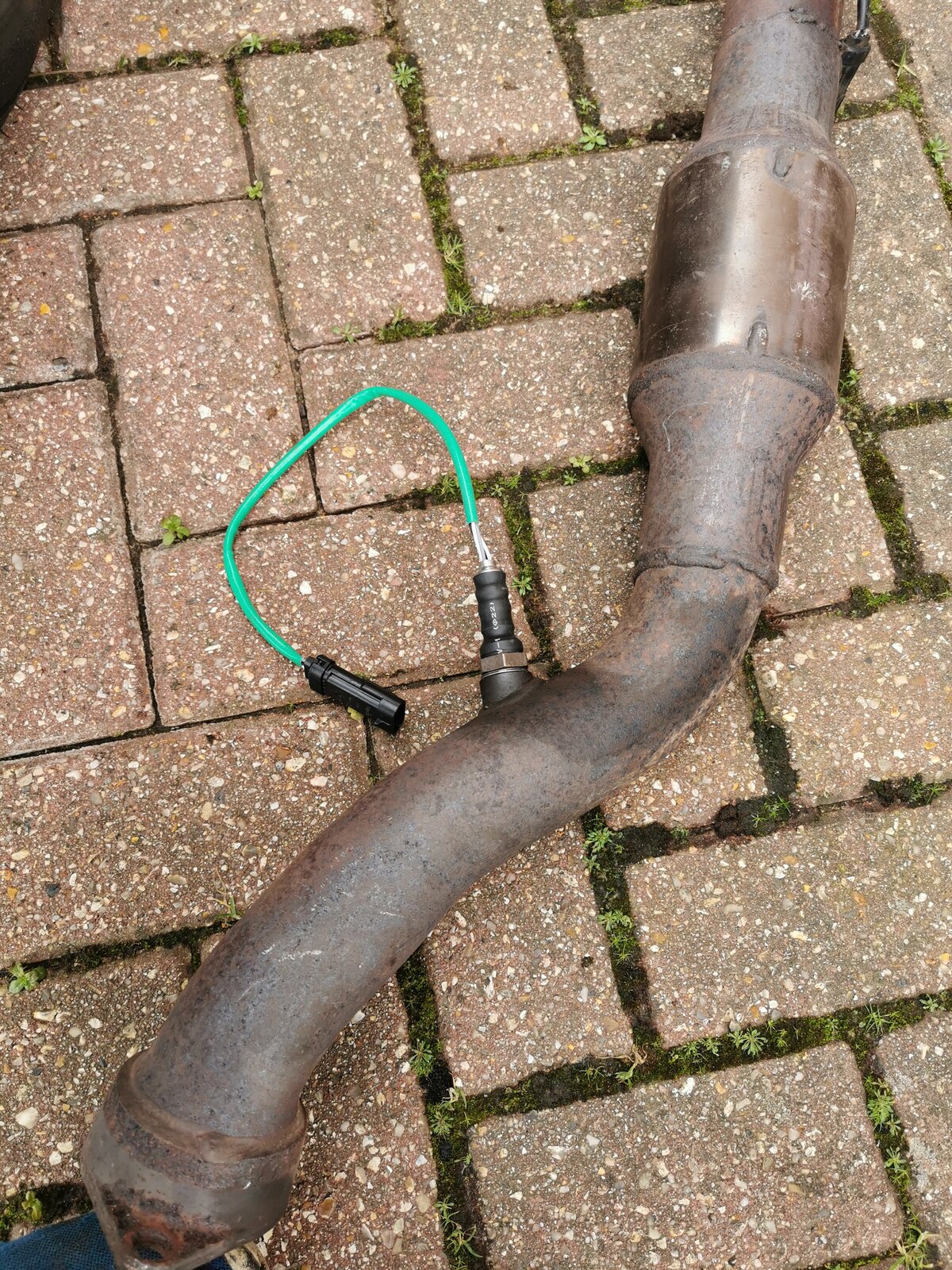

First thing was to replace the broken 182 manifold etc
I decided instead of dropping the subframe it would be easier to cut it out! Wrong that's was a ballache.
But swapped over to my 172 manifold, my brothers 172 sports cat, and a flanged 250mm pipe extension with new ngk lambda sensors as mine where toast.
I used high tensile stainless bolts and nuts for this.
All together, inlets etc needs paint now.
Took it to get the alignment done and the exhaust straightened out as was now a but crap fit. All back perfect and sounds great.
Alignment went wrong as the guy set the toe straight as I wanted but the beam jack died so couldnt do camber and is - 3 on the left and - 2 right 😭. Didn't have time to sort this so will end up doing the trackday with crap alighment.

I took the bucket seats out for them to go in my m3 so sourced a set of really nice 172 cup seats
Got these for a good price and rear seats too. Not sure if they will be put in the loft or used but good cup seats are hard to find now so bought them while still cheap.

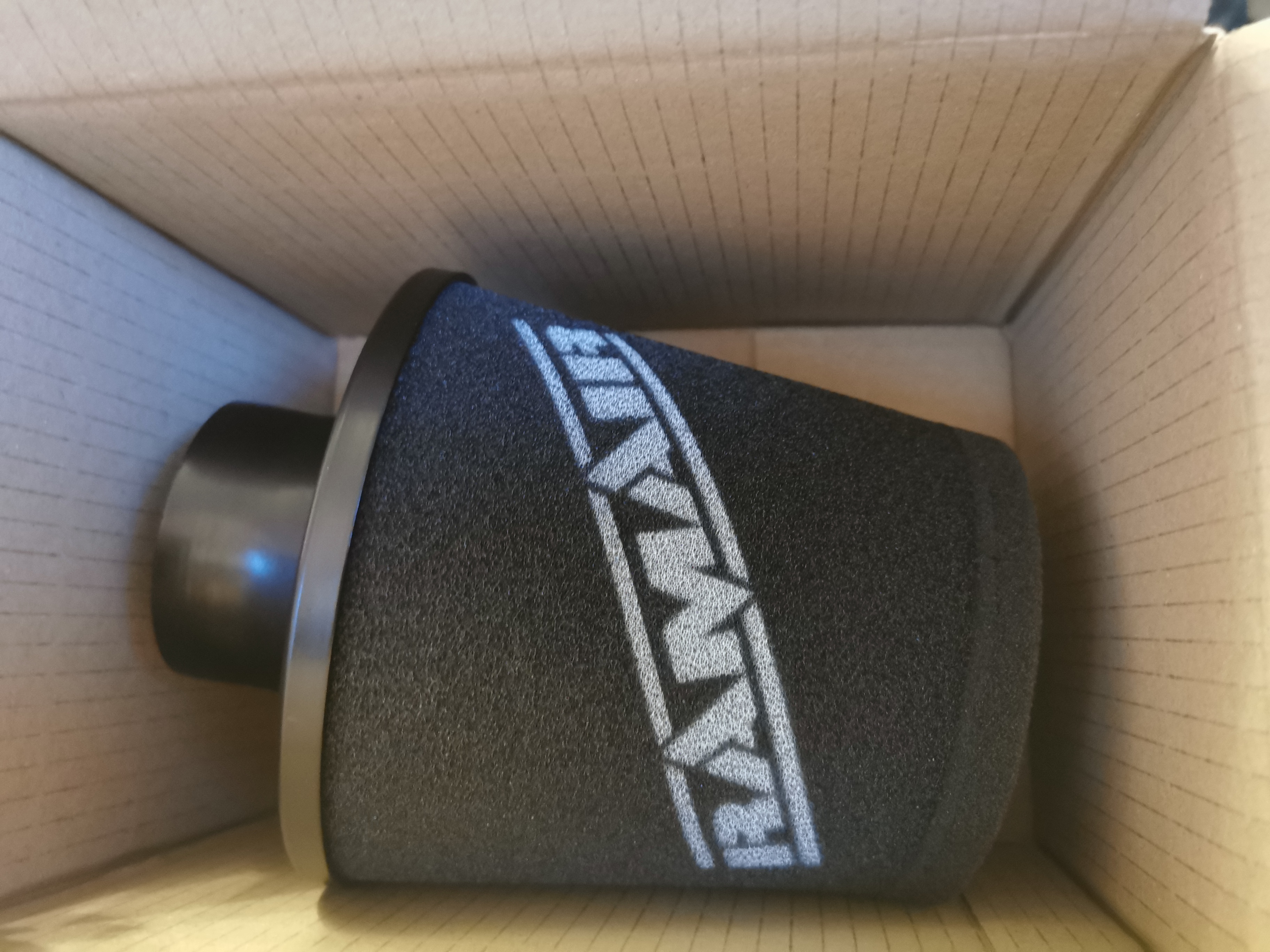

I decided as well that I miss the induction noise and wanted a tried and tested top notch kit so got a ktec pipe and new ram air alloy filter. Nice kit
While I was at it I managed to get a 172 cup bulkhead plate as I threw mine out years ago to save weight but the sticky heatshied. I made was horrible so when one came up on ebay cheap I snapped it up as these again are getting more expensive and harder to find, I used zinc coated bolts to secure it as with most things I do now.
Excuse the dirt it really really needs a clean

Today I changed out the steering wheel as although the OMP wheel felt nice after seeing how my brothers looks after light use and the fact i couldn't see the speedo at all I decided a more subtle wheel was required. Picked up a megane r26 steering wheel which feels good and can use the airbag again and horn which is nice. It's not bad condition but later on may get a retrimned one. Definitely a upgrade over the standard clio wheels.
Going to spend time getting the car up to a good condition, road use able nice low milage cup. Definitely oem+ approach and some new stuff ordered and will be updating soon 😎
