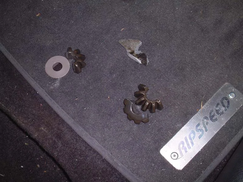

  172 cup'd extreme
This is when my Diff fell apart
Ive also striped 1.2 and 3rd gears and smash the synchro's in 2 other boxes
