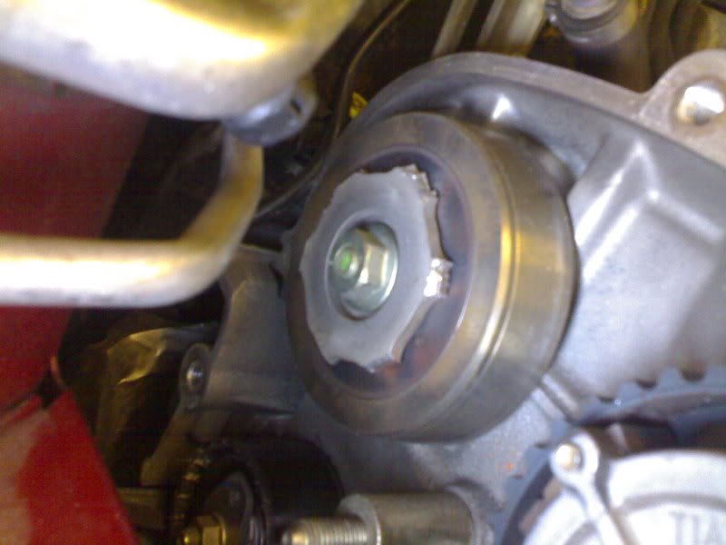

Well this is whats happened
Cam pulley sheared :

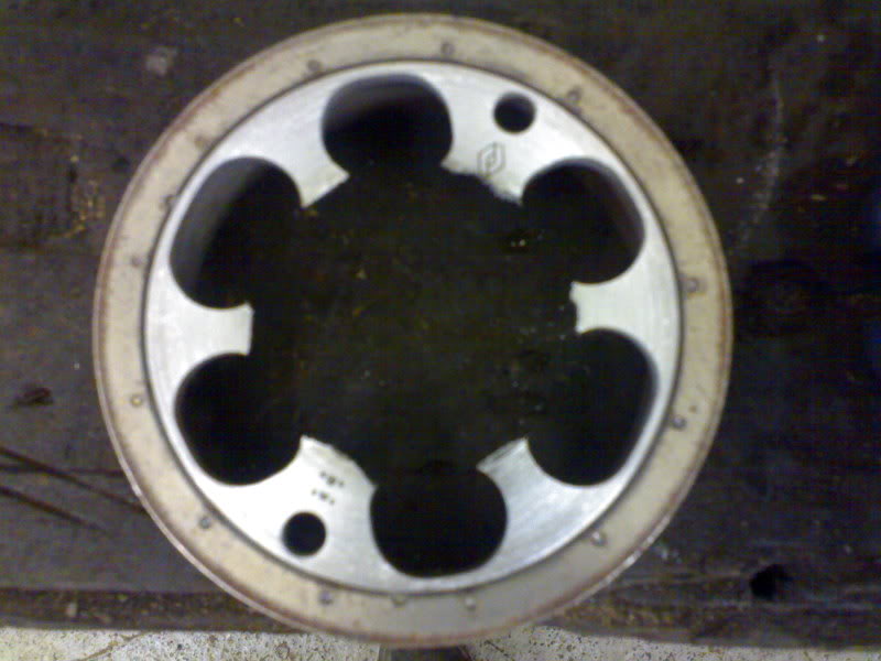

Rest of the pulley :

Well it's basically same as broken cambelt, so a lot by the looks of it.
  Mondeo TDCI 130
i would also like to know that, unable to give you an answer with the head on! there must be something wrong somewhere, that has caused that to shear!

I've seen this before pulley colapse means crank & cams are no longer timed right your noise was valves bouncing of pistons, if your lucky no damage to pistons.

Thanks for the interest car is now being fixed as we speak. Finding out if the head is knackered to.

Heads been checked, thats ok :) But needs 8 valves, gay thing.
