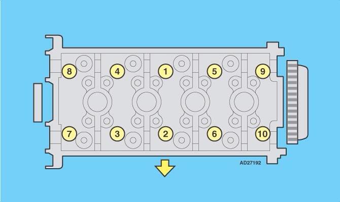

hi, can someone tell me procedure for tightening headbolts down on a ph2 172 please? standard bolts etc. also i have had the dephaser pulley off the cam, do i need to put it back in a certain position on the camshaft or just bolt it back on and just the cam back upto timing marks?? thanks
Stage 1 30nm
Stage 2 30nm
Stage 3 180 degrees
As above re new bolts
Hmm not sure the above is corr ect? as far as im aware, theres is only ONE tightening stage to 20-30nM, before a final angle tightening.
