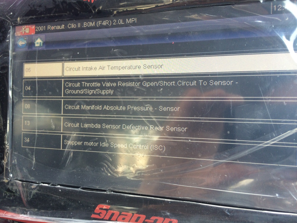

  Clio PH1 172 & E30
Code read today, cleared and none of these came back. Definitely were no codes the day before.
