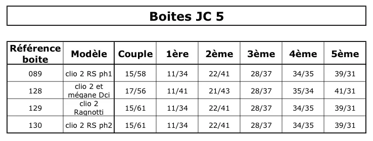

clio 172 ph1 gearbox on 182
  RB 182
I would like to mount a gearbox on my clio ph1 clio 172 clio rs 182 ....
is it possible? what are the differences?
  HBT 172 Cup
Putting a ph1 box onto a 182 would be fine?? It would still pickup the speedo from the ABS rings. Its the other way around you would have problems.
  172/1.2/E30
As above, ph1 box on a 182 is fine. But you will lose the advantage of the bolted-on-style differential. On ph1 boxes, the diff is circlip'd which can pop out.
