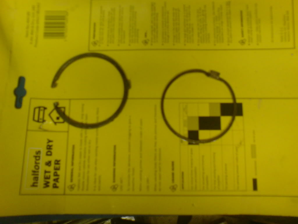

whoooop think im a lucky boy! no bits in oil both spacer and clip were just their ones bent i think! new bits on order £8.20 from renault :) :)
i have stripped it down again now! same prob the clip has snapped! but also a white ring came out too its a bit bigger that the clip and the spacer!

that white ring mate fits inside the inner cv boot to keep the boot taught when bolting the shaft flange back up to the box,it should push back inside the inner boot
my old valver used to do this,needed a new box inthe end :( hope this doesnt mean the same for you
