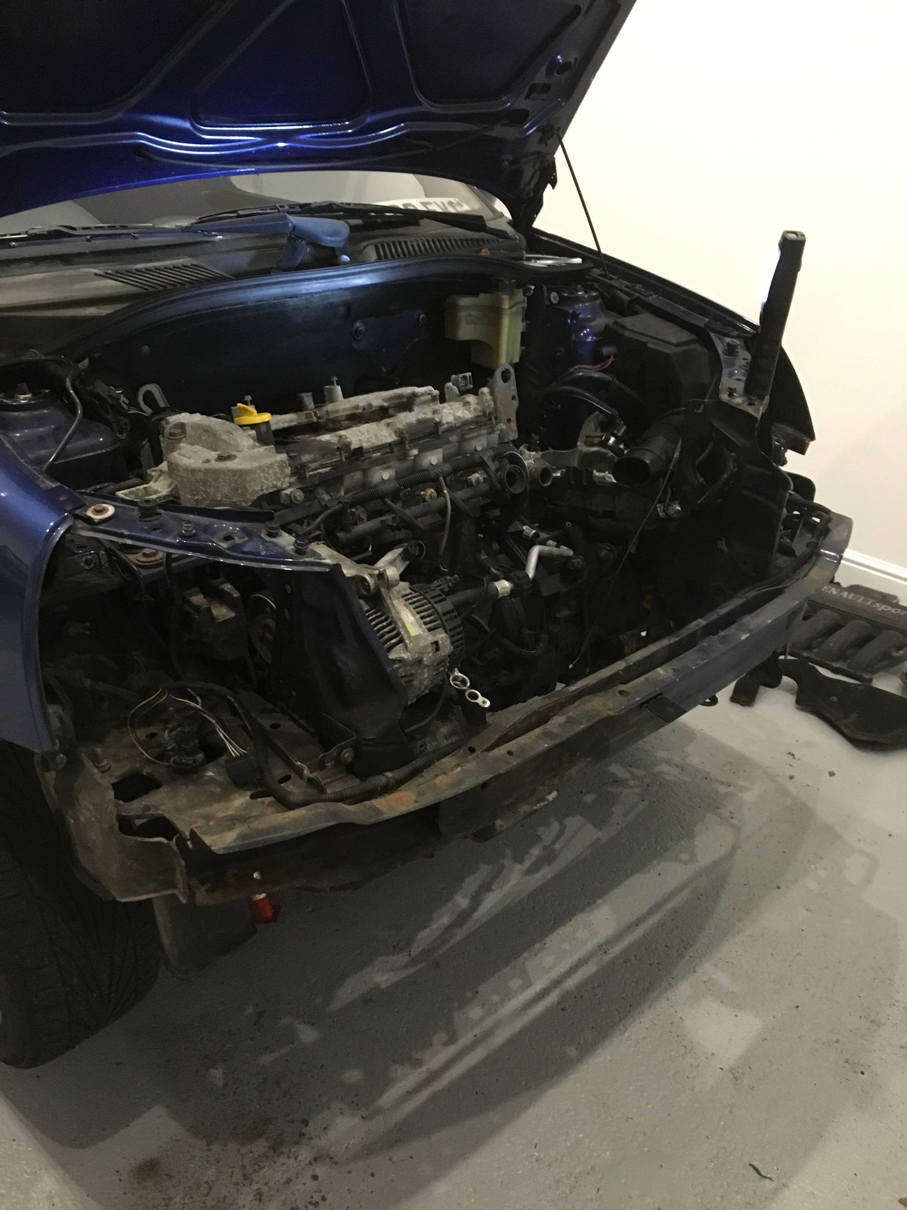

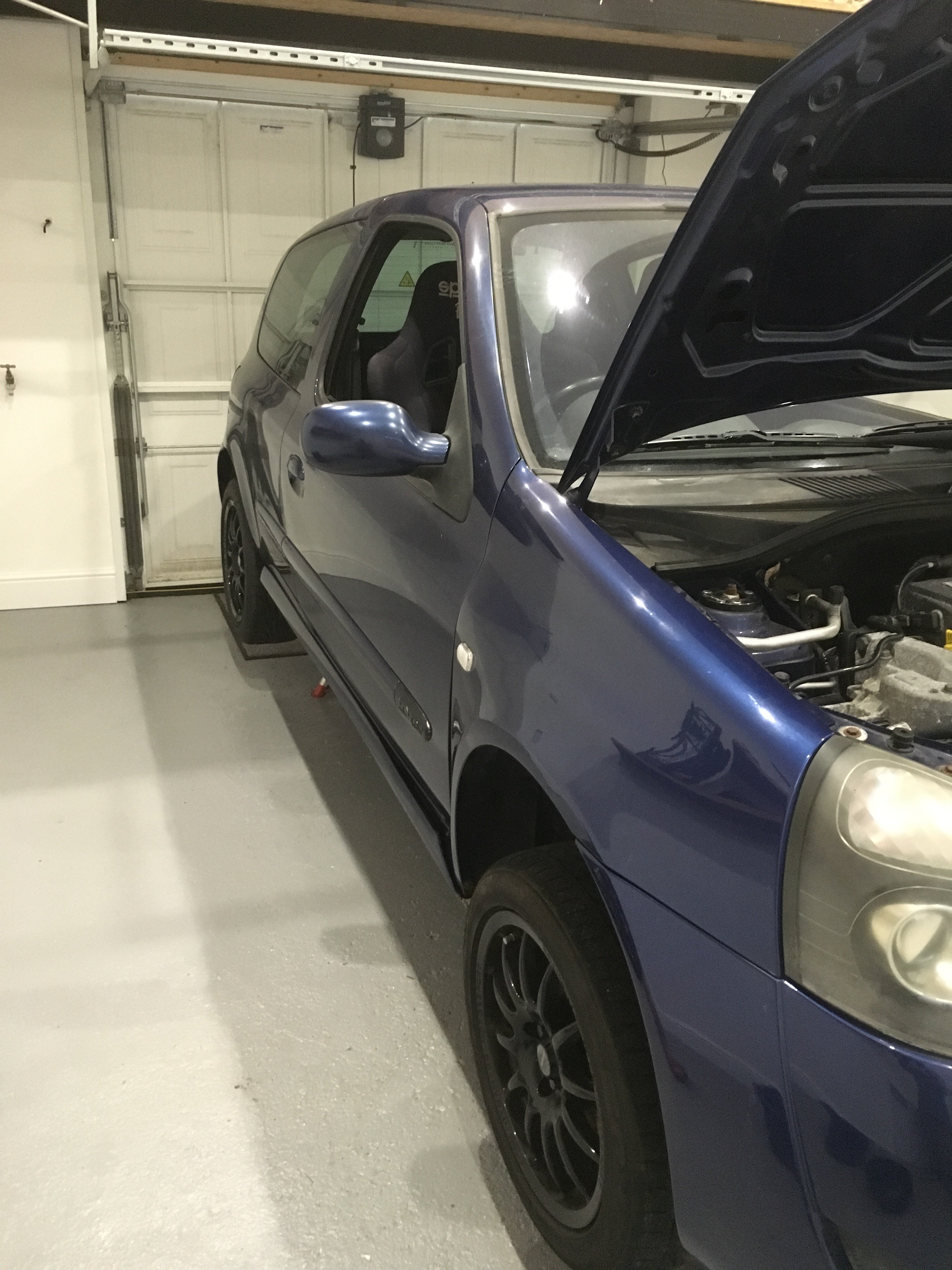

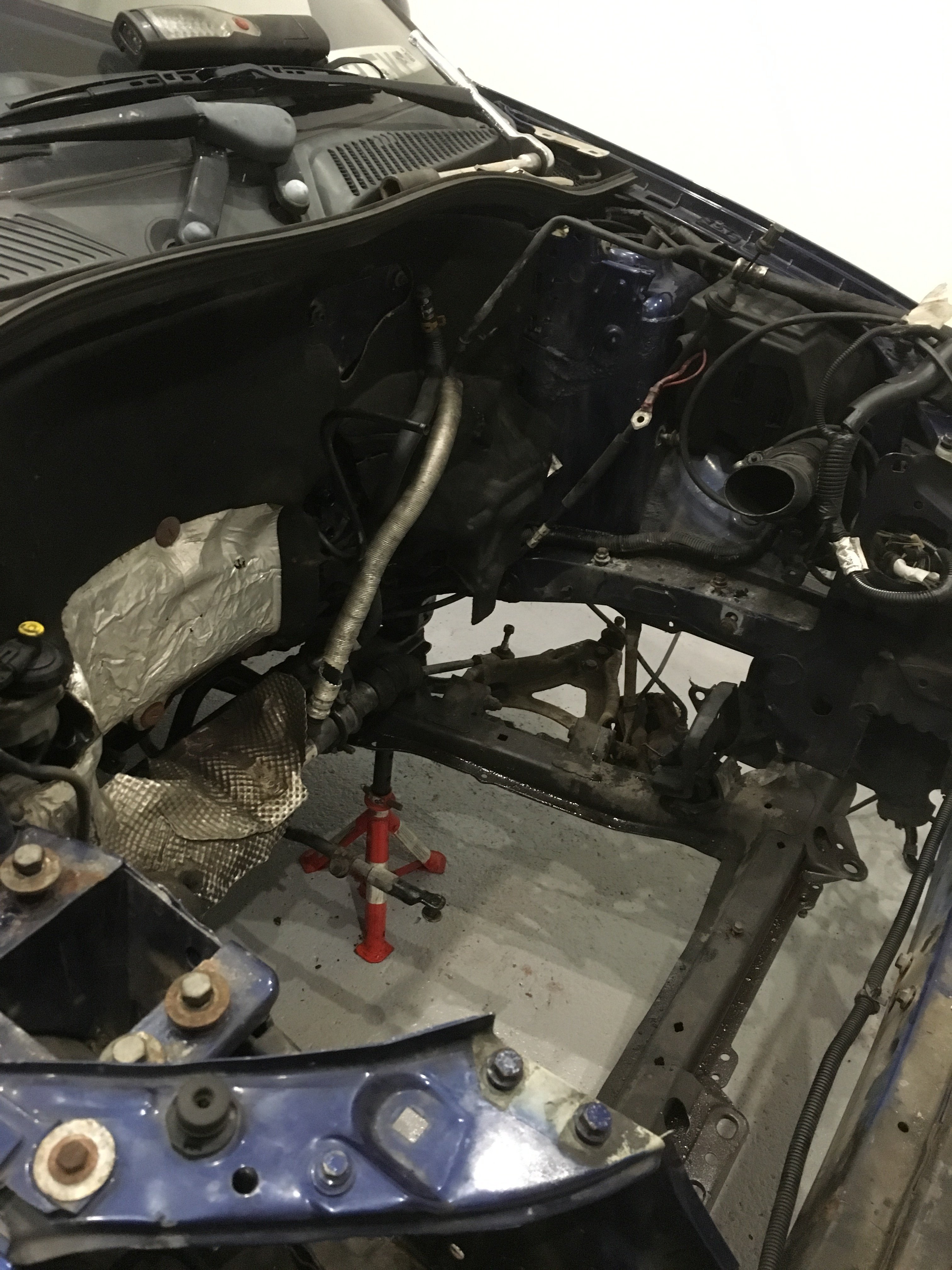

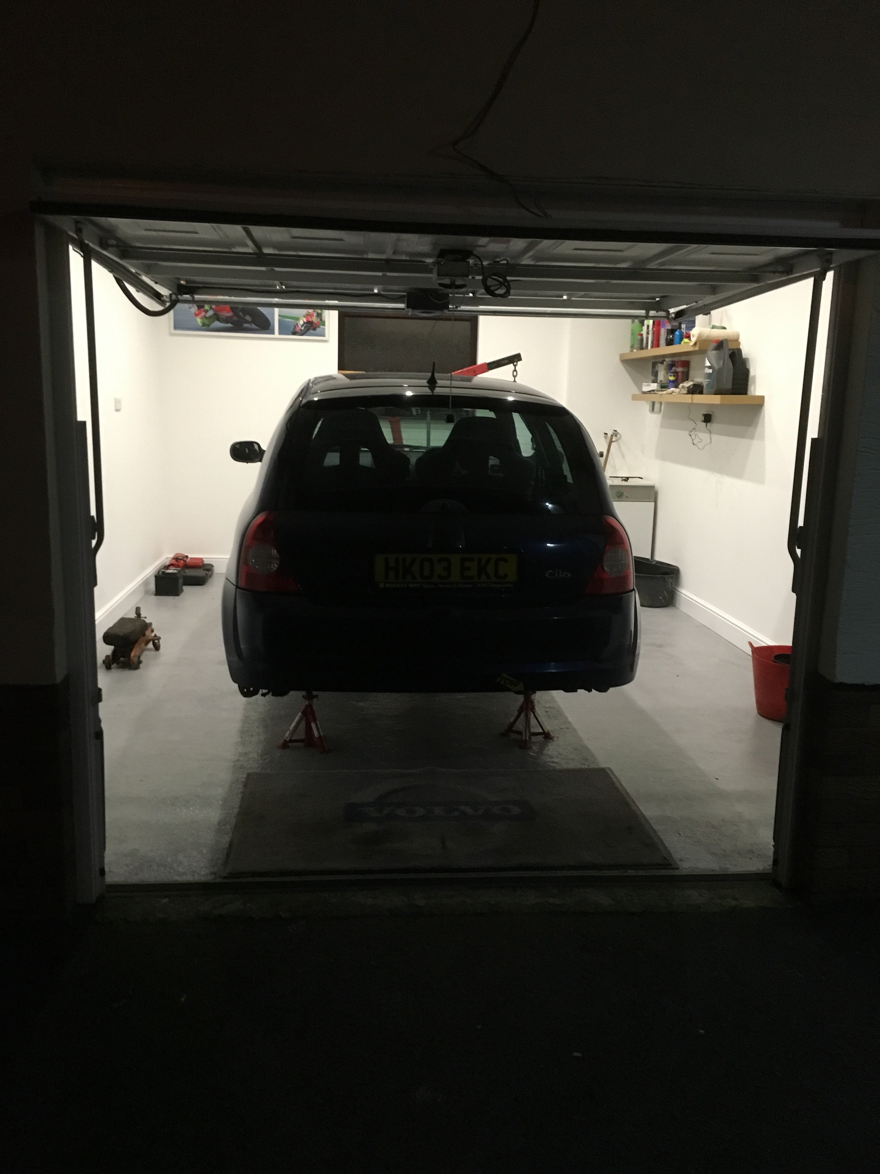

So the first job was to get the car up on stands, remove bumpers lights etc as the engine is coming out to gain access to the brake lines (there going to be running inside the car) and to remove a few a generally tidy up the bay

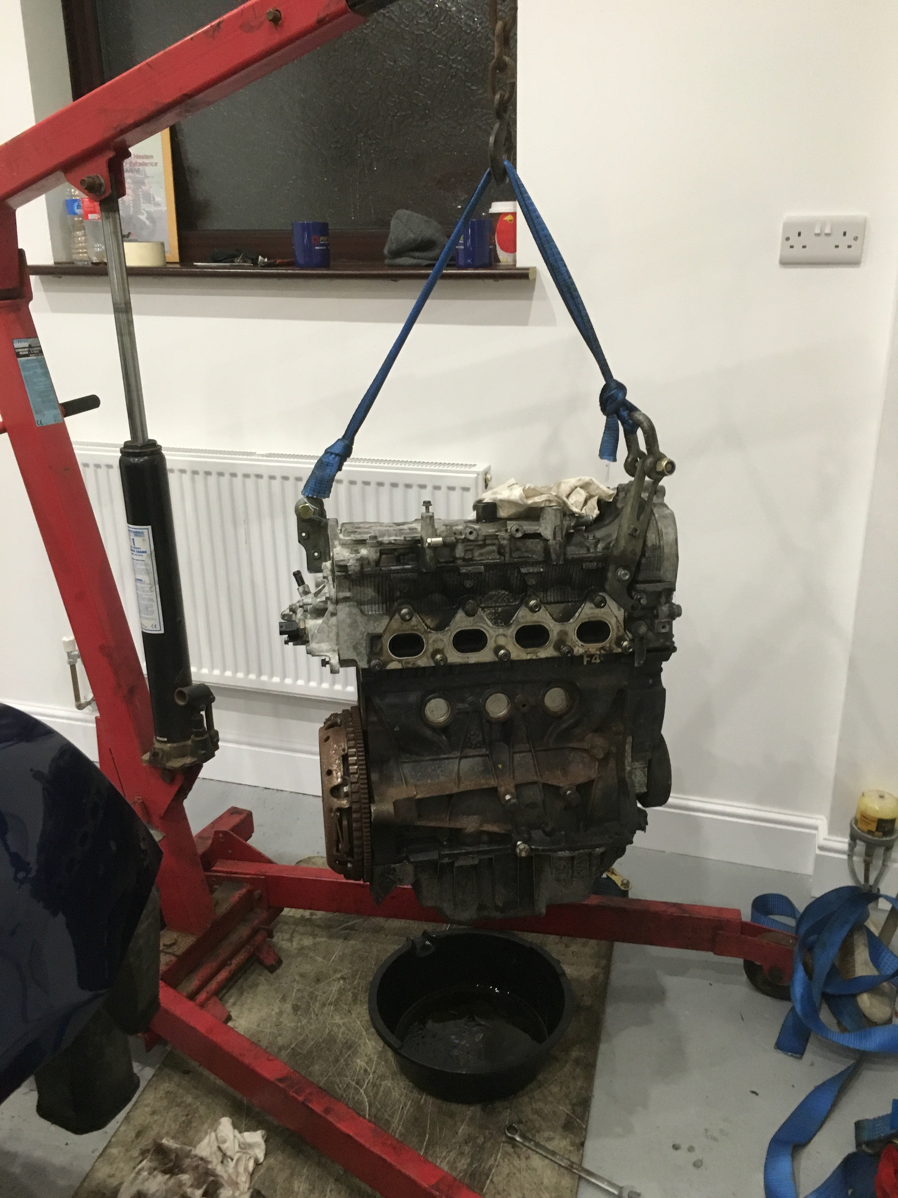

So today the engine came out. All went really well and was a nice change to work on something small( I'm a truck mechanic) hardest part of the job was removing the Ecu and cover. Not sure if I was doing it wrong but was a bit fiddly.
There is a charcoal canister on the drivers side that goes into the rocker cover. Can this be removed. And also on the passenger side were the pipe work goes into the airbox there's a small little motor there. What does this do and can it be removed. Here's some pics for you

Yeah this is it mate. Yes the charcoal canister is gone, but I retained the solenoid to overcome any warning lights. It's all gone though now as I've done a full custom engine loom along with a gen90.
Where is the solenoid located.what did you do with the outlet on the rocker cover. Breather filter ??where does the pipe work run back too. I assume fuel tank. Also noticed this Clio has no fuel return ??
Actually reading your thread. That exhaust manifold if a work of art
The solenoid is located on the top of the charcoal canister mate. It just pulls out basically. Leave the wiring connected and cut the pipes. Mine just vent to atmosphere and I have no issues with the tank pressurising etc. The charcoal canister feed pipe is rubber at the inlet end - where it connects to the breather plate. All I did was choose a suitably sized bolt and blocked the rubber hose! Yeah the late ph1's and all ph2's are single fuel line mate. Pressure regulator is in tank.
