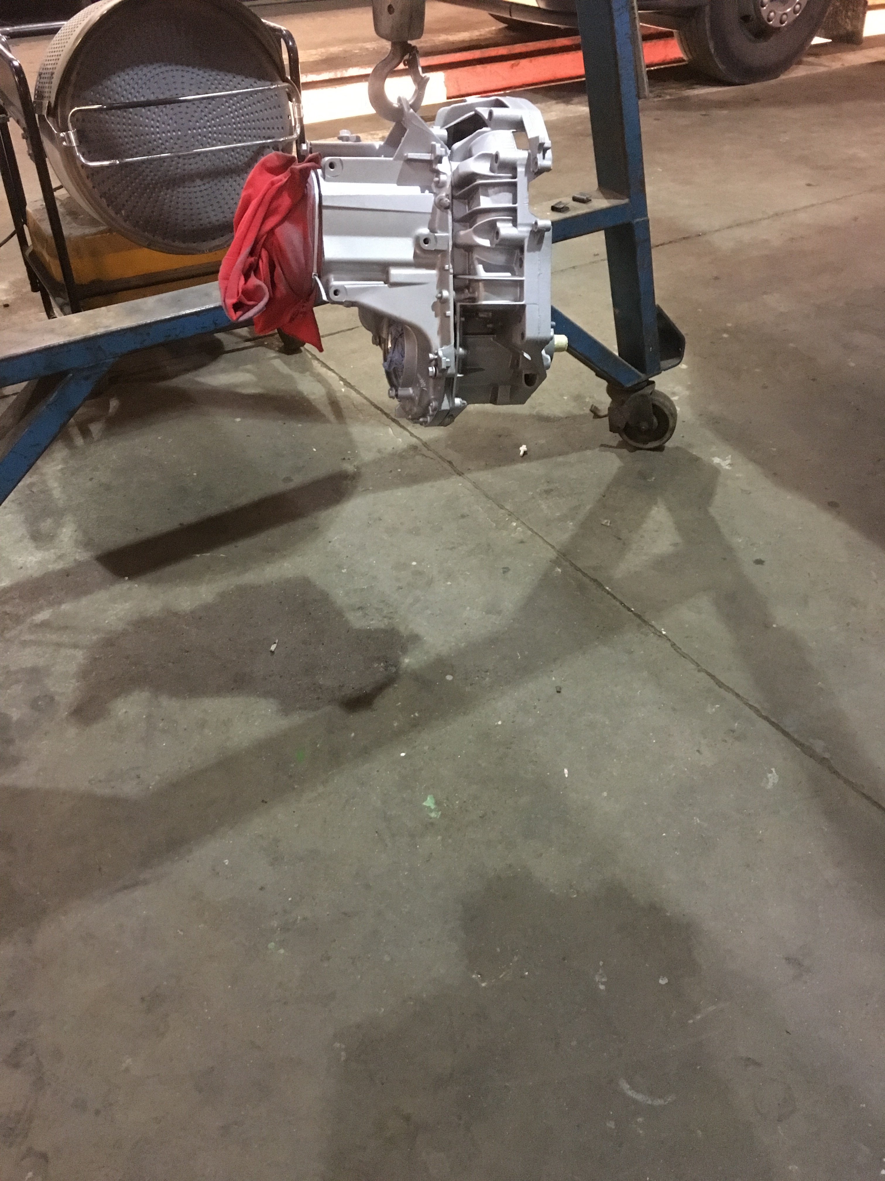

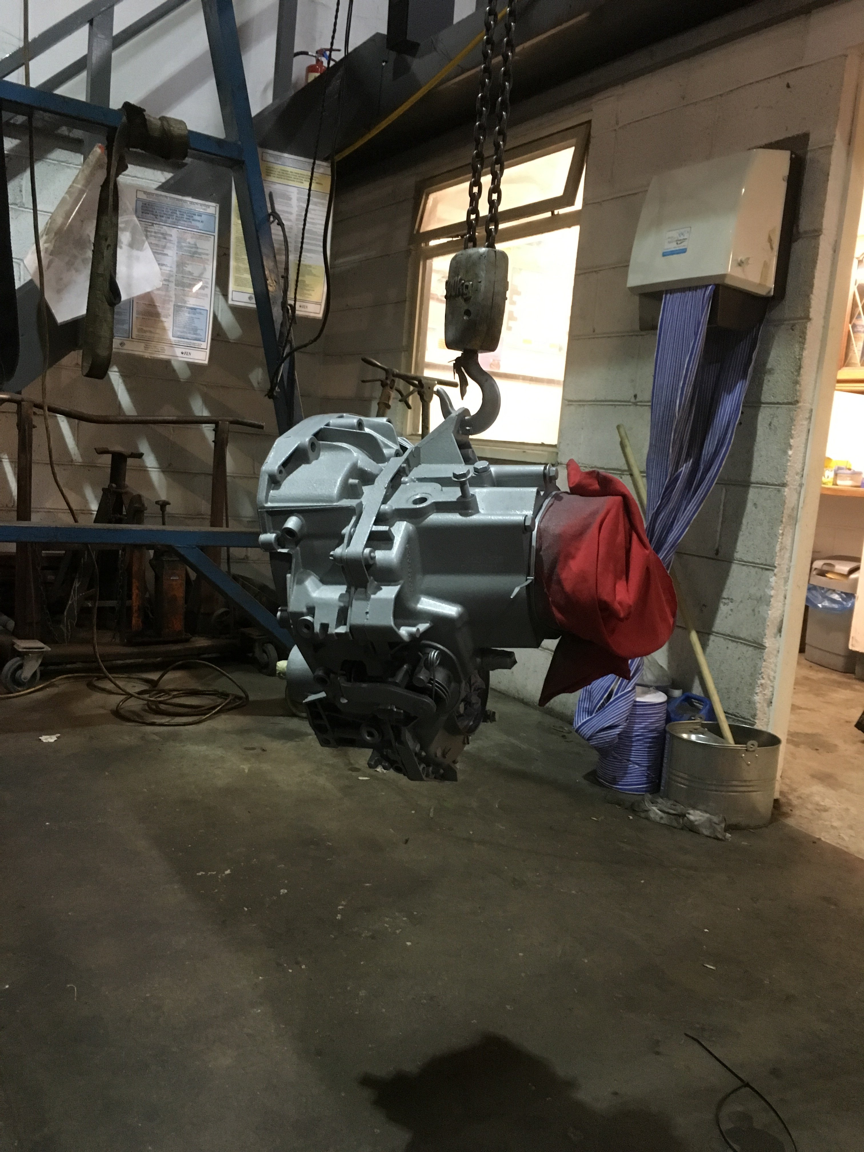

Did a bit of cleaning today.
  Clio 172
If you have a look on the front of the casing you'll see the model code of the box mate. If it says 'jc5 130' which I suspect it will, then yes it's a 182 box. Possibly an early twin taper bearing 130 box.
I'm a truck mechanic as well! Who do you work for?
You were correct its stamped jc5 130. Does this mean I have 182 driveshafts or are they all the same ?
  Clio 172
Ok I'll cross that bridge when I get there. This gearbox may only be a temp thing, if I enjoy the rallying I will get another box build with a cwp and diff of some sort
