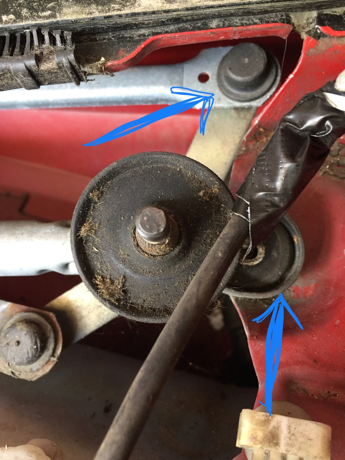

Started stripping everything but cannot for the life of me get the wipers out. Undid the 3 10mm bolts & unclipped the electrics, pulled forward off the peg..... & no matter which way I move it can only get it to move a centimetre or two.
This pic below is causing the biggest problem
The offending hose
Toys are well & truly out of the pram & I’ve had to step away from the car for a bit. What am I missing? The f*****s just won’t come out!

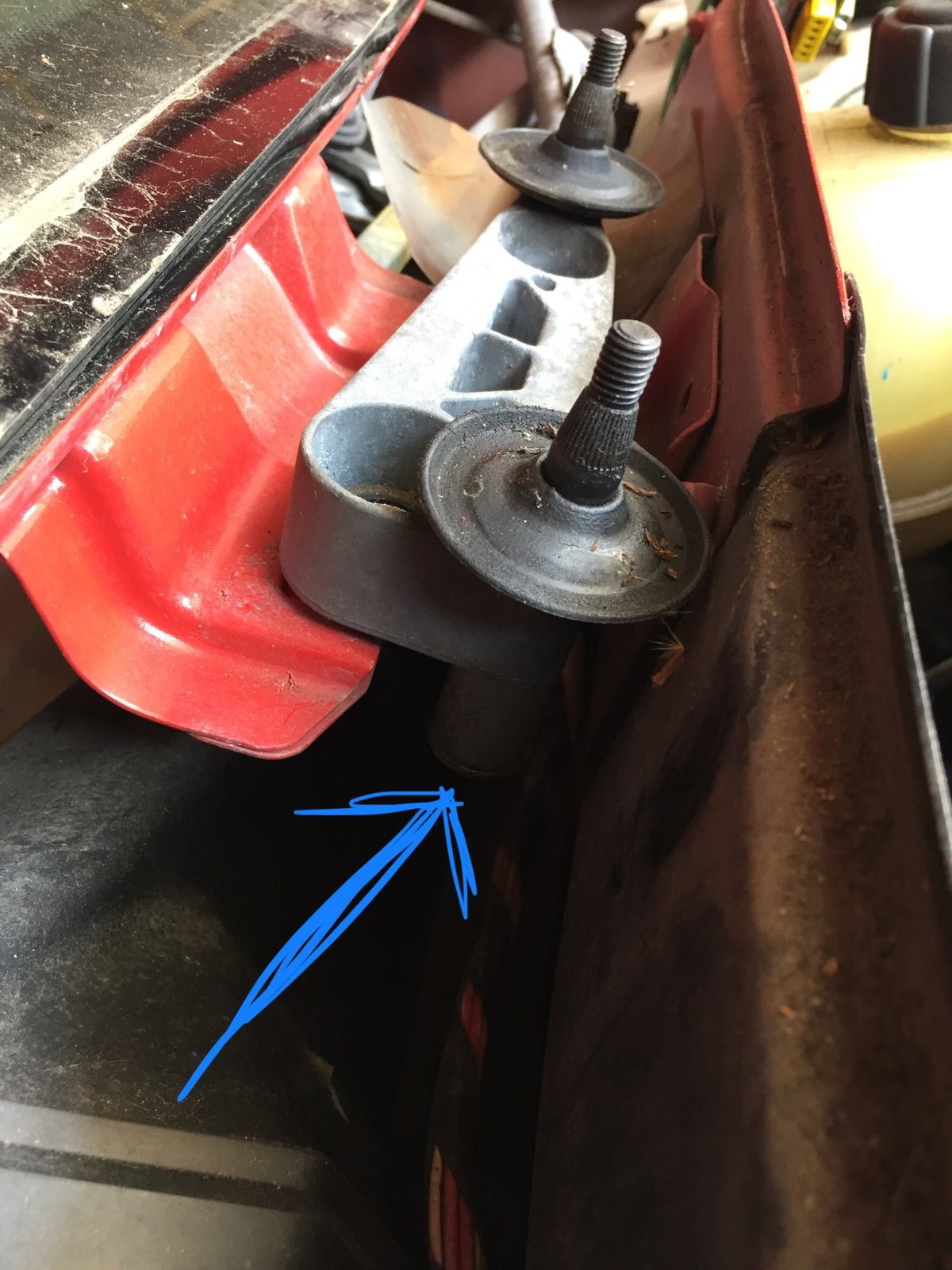

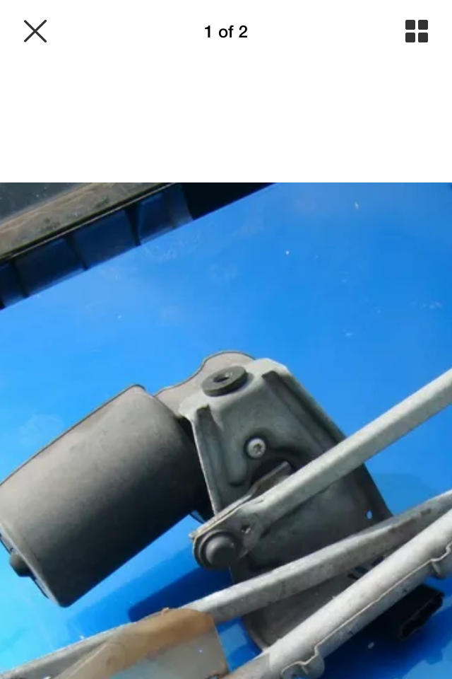

Yes 3 bolts along the top and back of the motor there is a grommet and push fit fastener. You need to give this a pull forward to release then angle the whole unit and pull out.
Here is a photo of the grommet thing that is near the motor:
