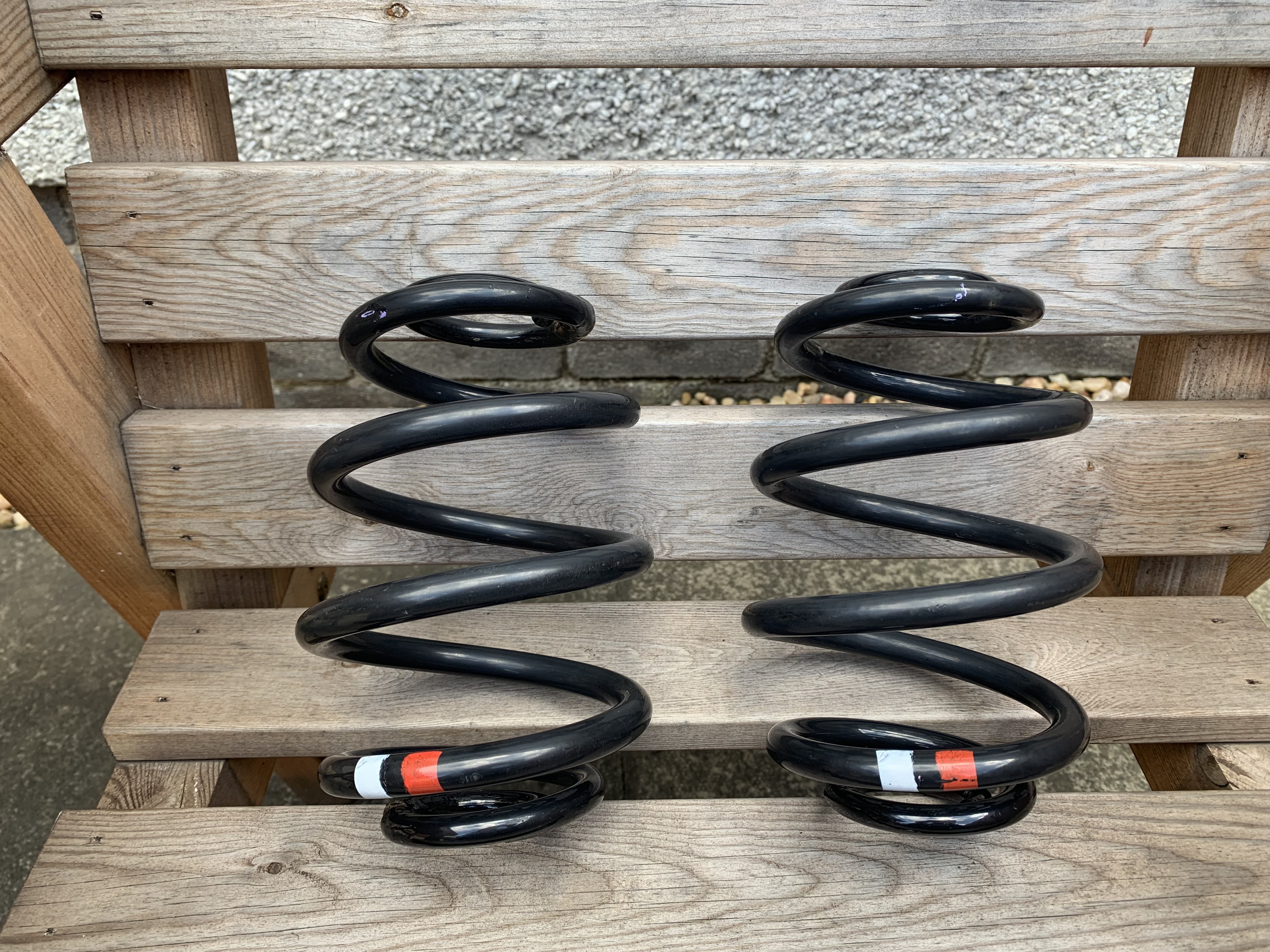

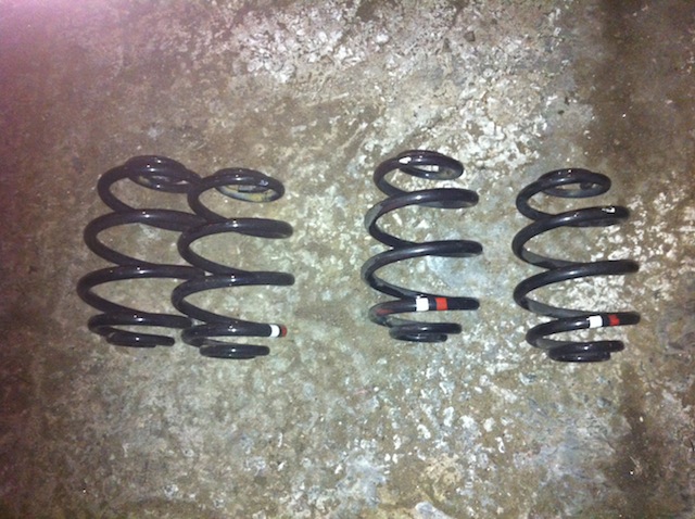

If I remember correctly. Cup springs had a blue and yellow dot on the rear and red and white on the front.
MRBILLYUK
  FF Jeden Osiem Dwa
I might have got that wrong. It might be blue and yellow on the fronts and red and white on the rears.
MarcB
  Too Many
Rear Cup Springs are Red & White Dots.
Cant get them anymore and Renault UK / France don't do them.
