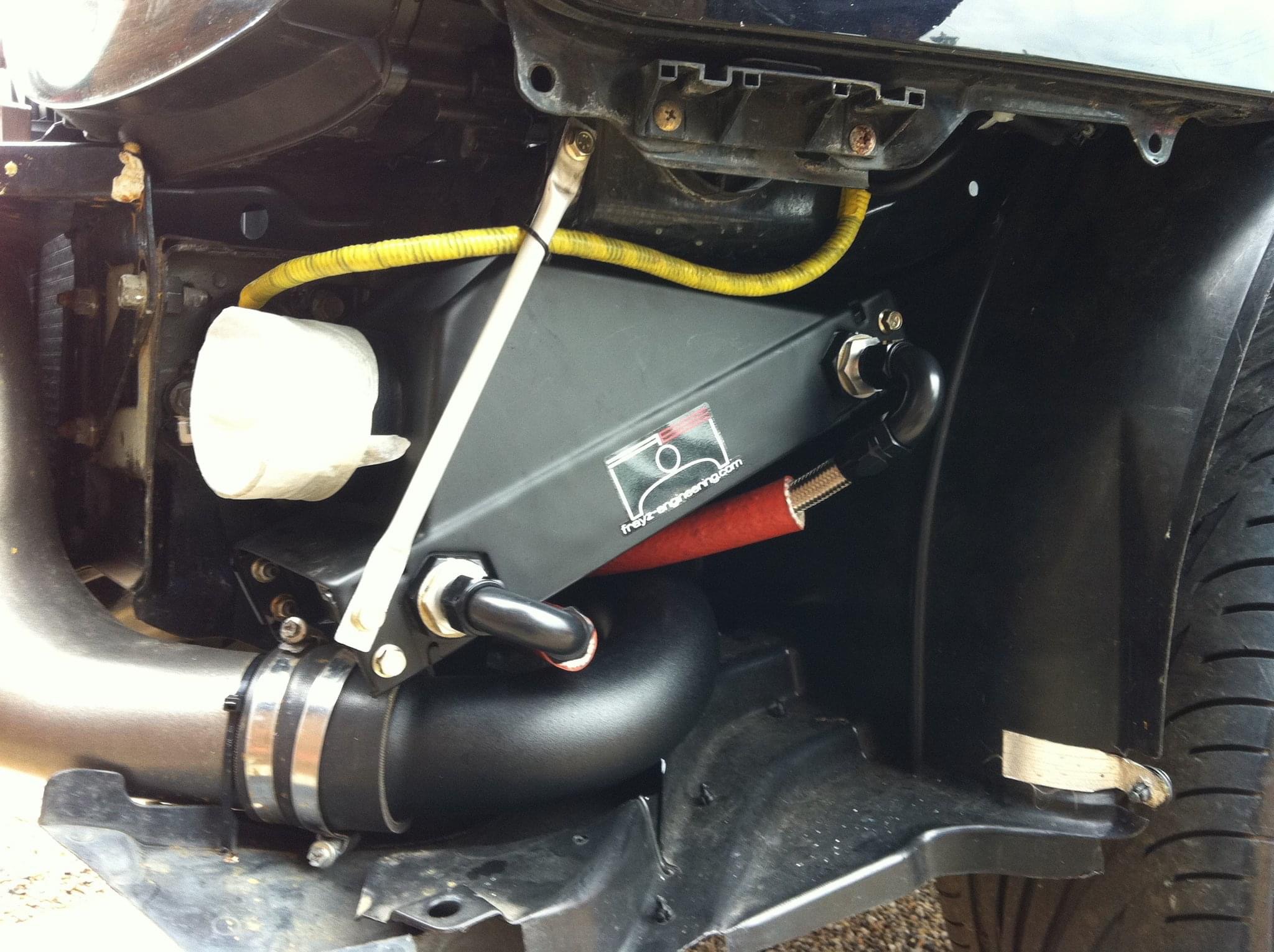

This is how I housed my Setrab 19 row cooler fed from a foglight to a sealed box and exited below the wheel well.
This car was running upwards of 1.9bar from a GT35R and it was used aggressively. Never once did I have any issues with oil temps. I also made one for a friends car with the same setup. That used to exclusively live at the Ring.
Wow lovely stuff! That looks great, definitely something I’ll be looking into! I actually have some nice 3D printed fog light scoops originally for brake ducting but ended up never plumbing up so could use them if I can’t do an effective boxing/scoop job from the grill.
Do you do that kind of fabrication as a job?
frayz
I'm an automotive development engineer and had a mate make it for me in another area of the building. Im not on the tools anymore so don't get to play with cars that much these days. He took my cooler and vacuum formed a duct to the design i wanted.
Boxed like that, the air simply has nowhere else to go but through the core, its mega efficient.
You want to have it exiting under the car as opposed to the wheel well as the wheel well is an area of high pressure, under the car is a low pressure zone so helps the air to be drawn through.
