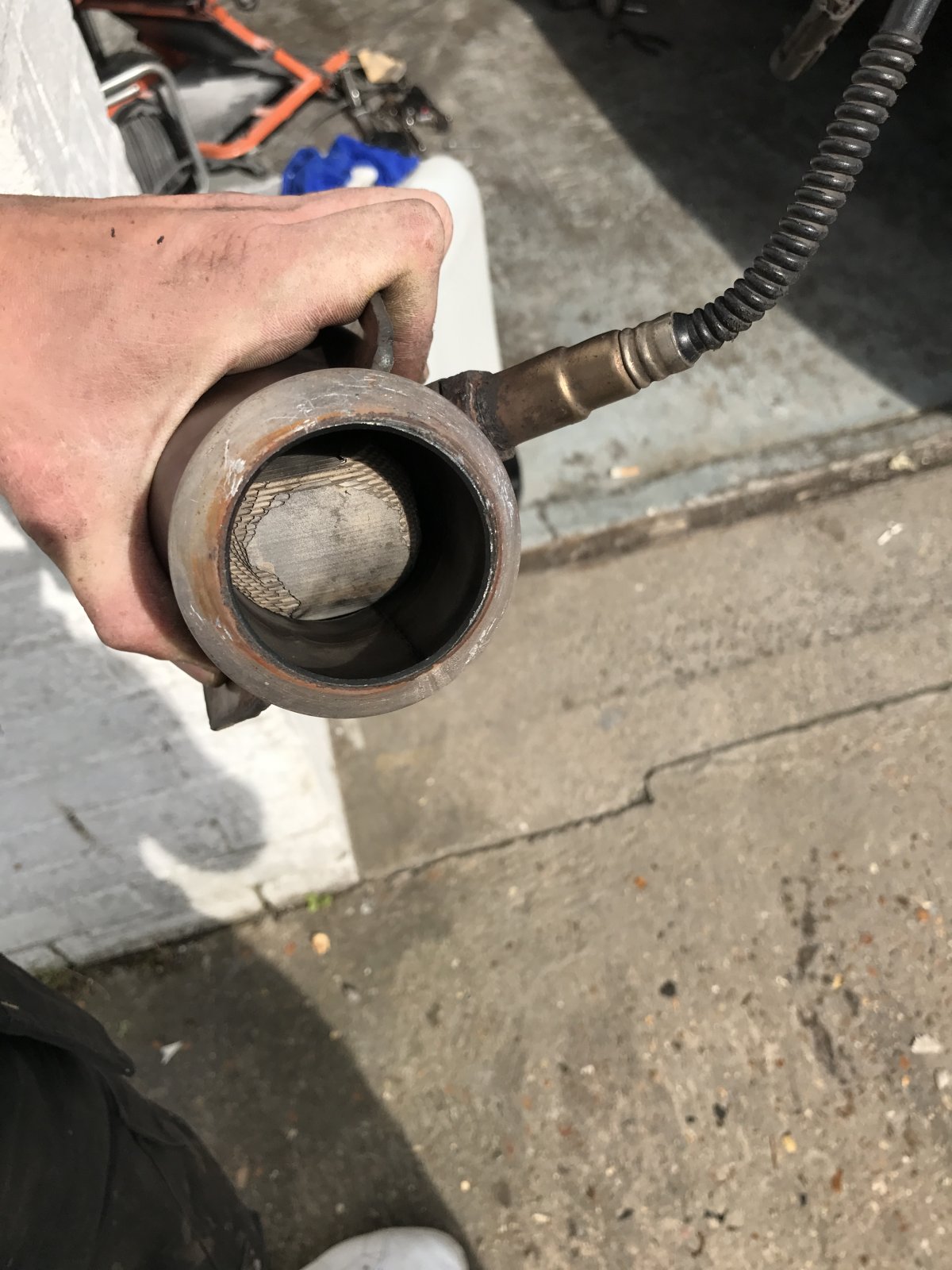

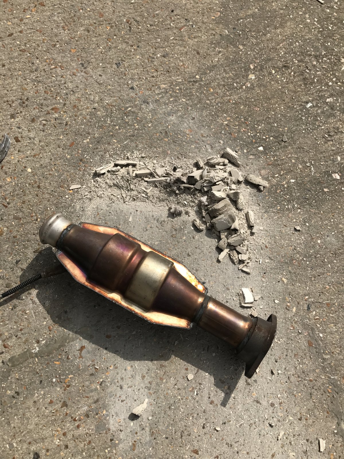

I've found my issue!!
The cat was blocked!!! Brand new cat for the MOT nearly 2 weeks ago has collapsed...
It's got very hot going around Cadwell....
I'm a very happy man!!
Just smashed it all out, and good news, it's not any louder than it was before!
Thanks to everyone for all the help!!
Chris

Glad you have sorted it. Wtf is that cat too? Not seen one like that before.
