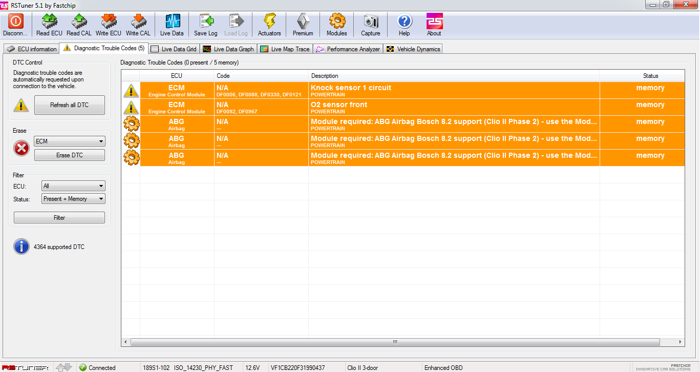

Fault codes came up as:
DF0006, DF0088, DF0330, DF0121 - Knock sensor 1 Circuit - Memory (meaning intermittent fault)
DF0092, DF0967 - O2 Sensor Front - Memory (again meaning intermittent fault)
I know what the obvious answer will be... Change them both... But I'm trying to understand why the O2 sensor or the Knock sensor, or a combo of both are throwing my MPG out :)
Cheers in advance!

I'm very confused, or probably reading it wrong but your lambda sensor is knackered and you're wondering why your mpg is bad?
The lambda sensor identifies the air/fuel ratio in the exhaust gases and adjusts your injector output according to if it's running too lean or rich.
My guess is that the pops and bangs map has chucked too much unburnt fuel in the exhaust system and your lambda sensor is caked in unburnt carbon crap and it's giving a delayed/no signal to the ECU which is throwing off your MPG.
  Mazda3 2.2D 185BHP
As Above. Replace the lambda asap
You say you have put the normal map back on and its still revving too high? Not the map then something else is wrong.
I also have an RSTuner Map and it only revs at 1.5k when cold and 950 when warm :)
