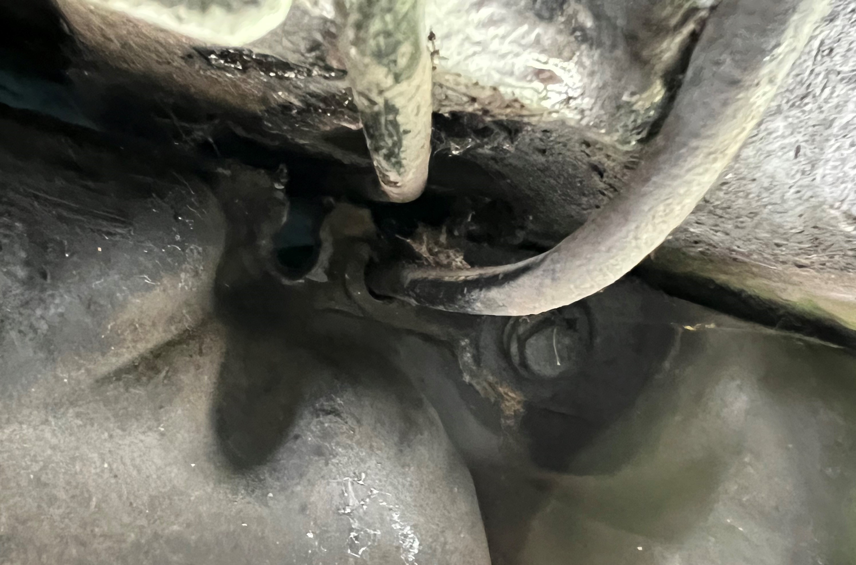

Evening all, hope someone can help. Split fuel hose (the one nearest to offside edge) 0.5mm(ish) hole causing a small leak (looks like a rodent has nibbled it). Needs replacing but struggling to get hold of one. Any ideas?
Also can anyone confirm the outer hose I'm replacing is the one that feeds directly under the rear drivers-side passenger seat under that black plastic cover?

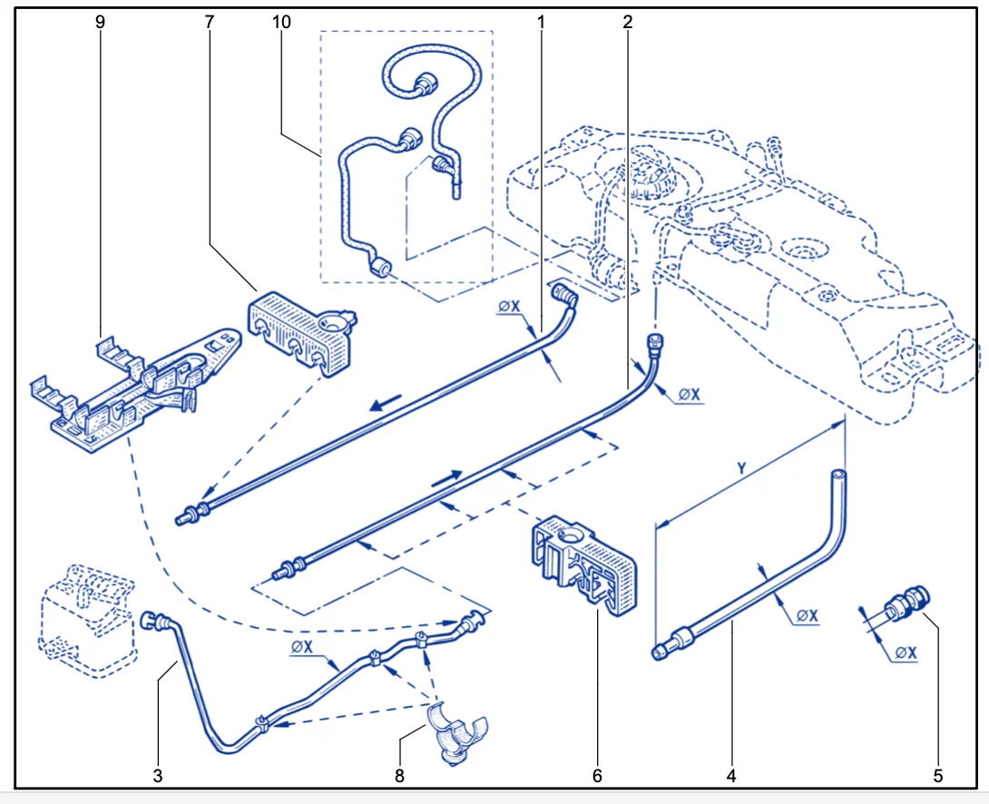

Follow up thread in case anyone suffers same problem. Took a punt on a return hose for a standard mk2 Clio as the hose with the green clips (which is I assumed was specifically for a 172 or 182) is proving impossible.
If anyone needs to do the same job, process to replace is straight forward.

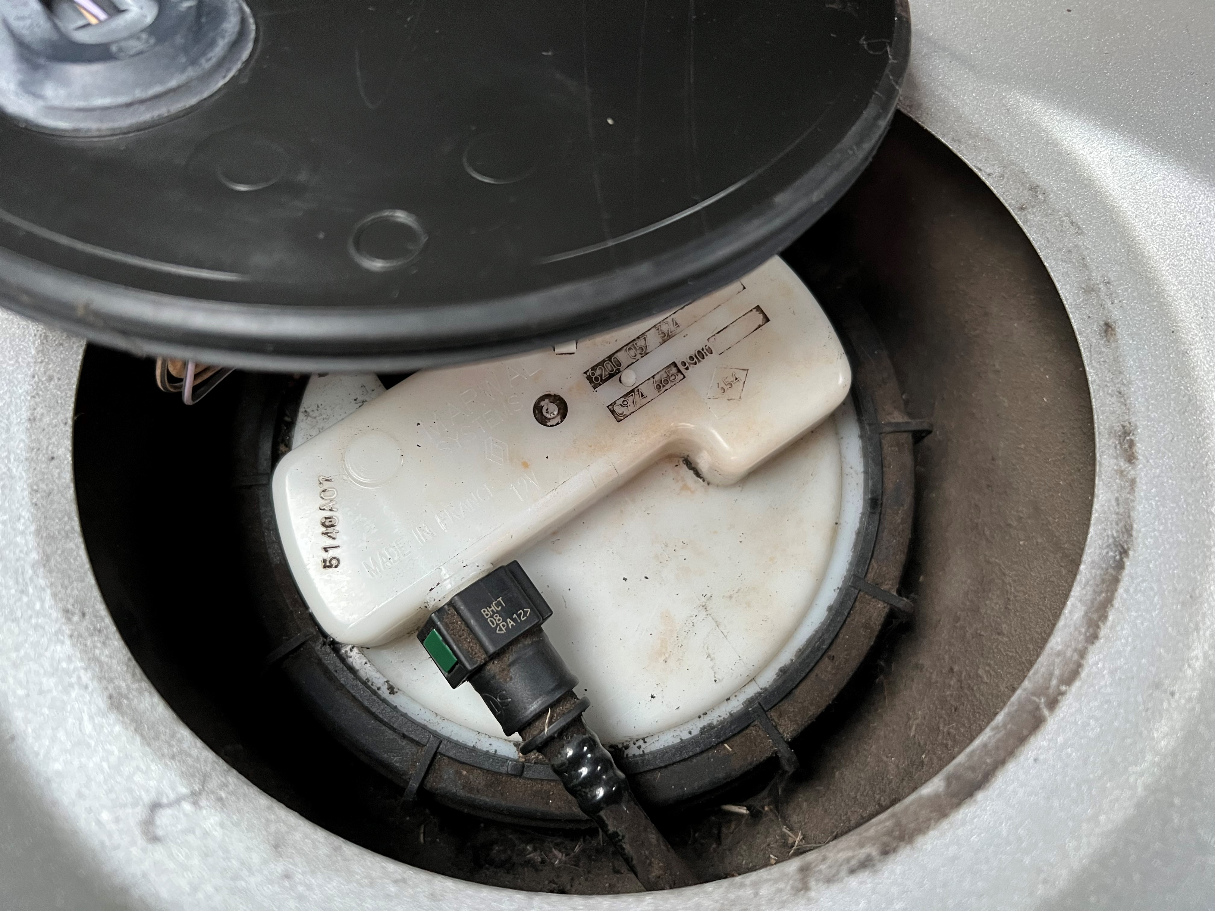

2. disconnect old hose from top of fuel tank beneath drivers side rear seat (there's very little pressure so no you won't get a mush full of petrol)

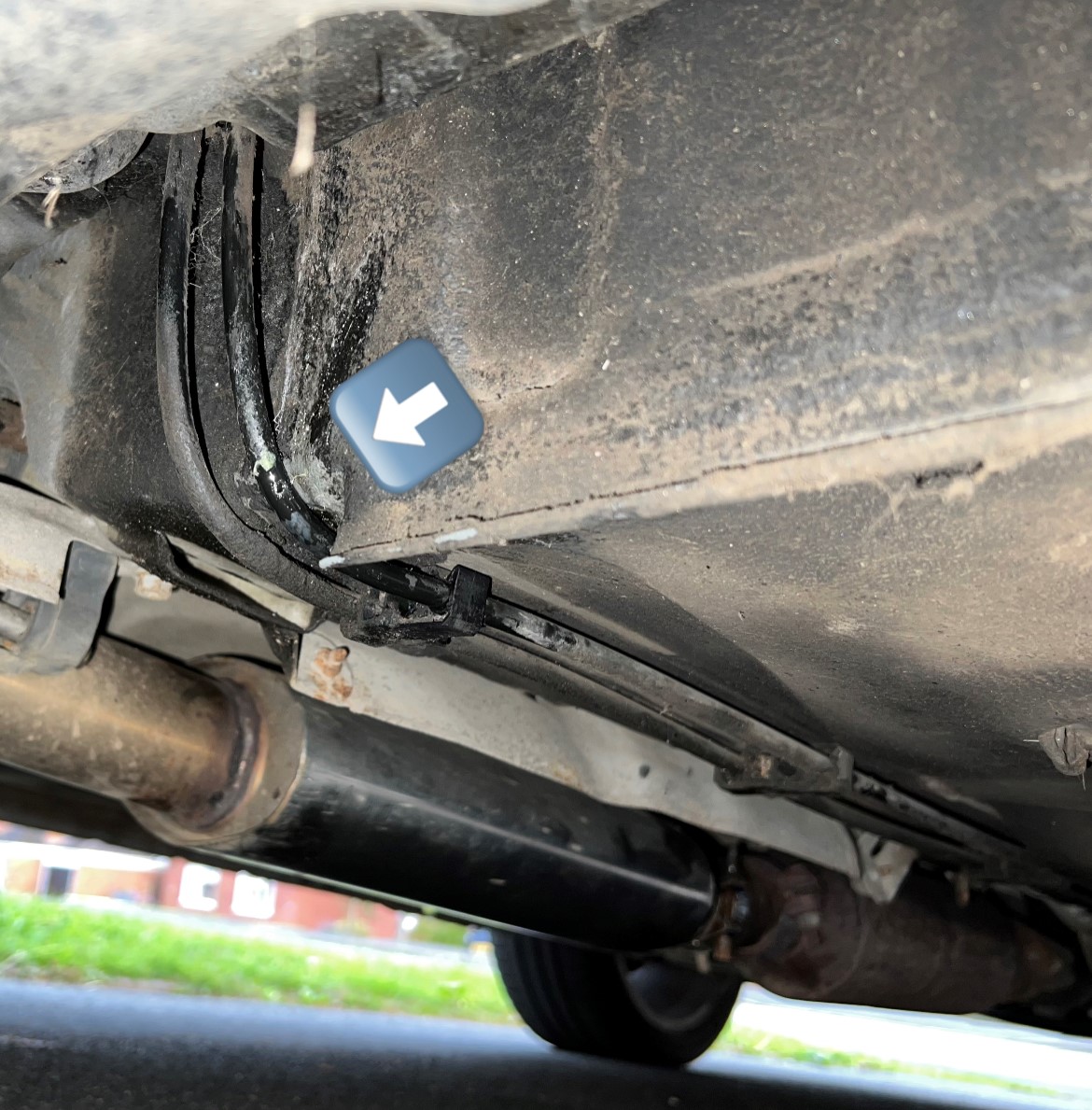

5. unclip old hose from the plastic brackets that run underneath the floor pan

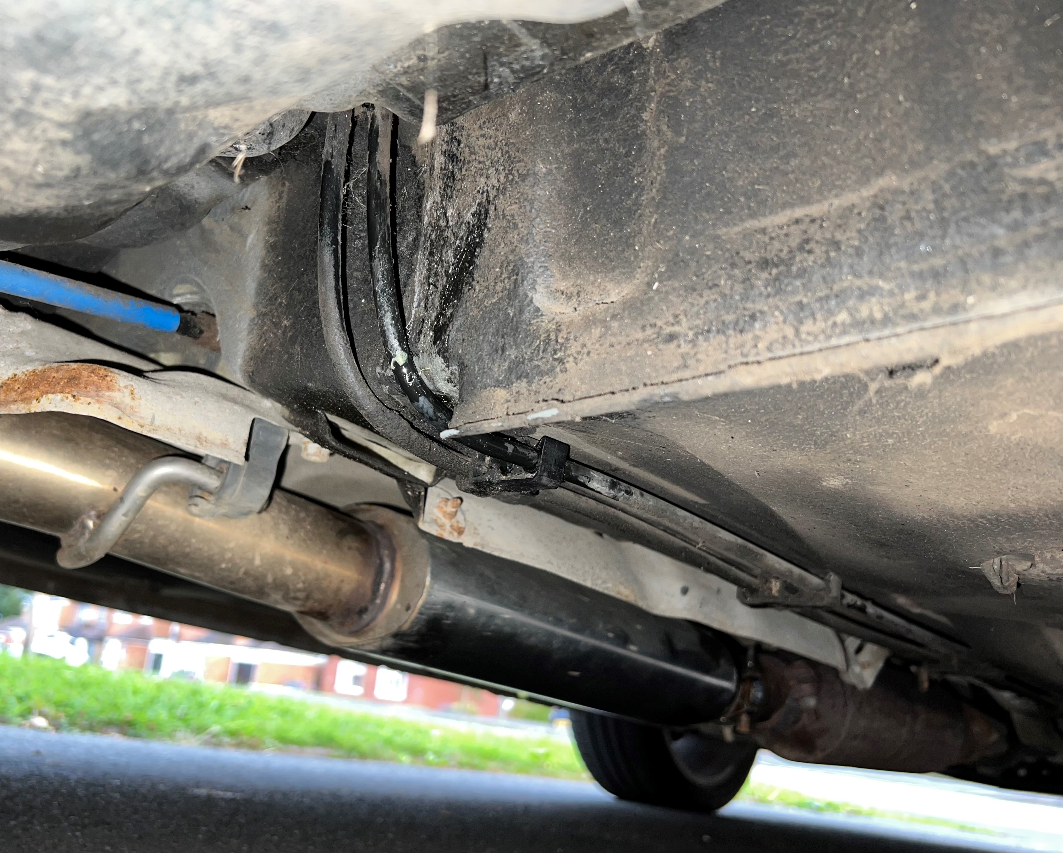

9. clip new hose in to housings under floor pan

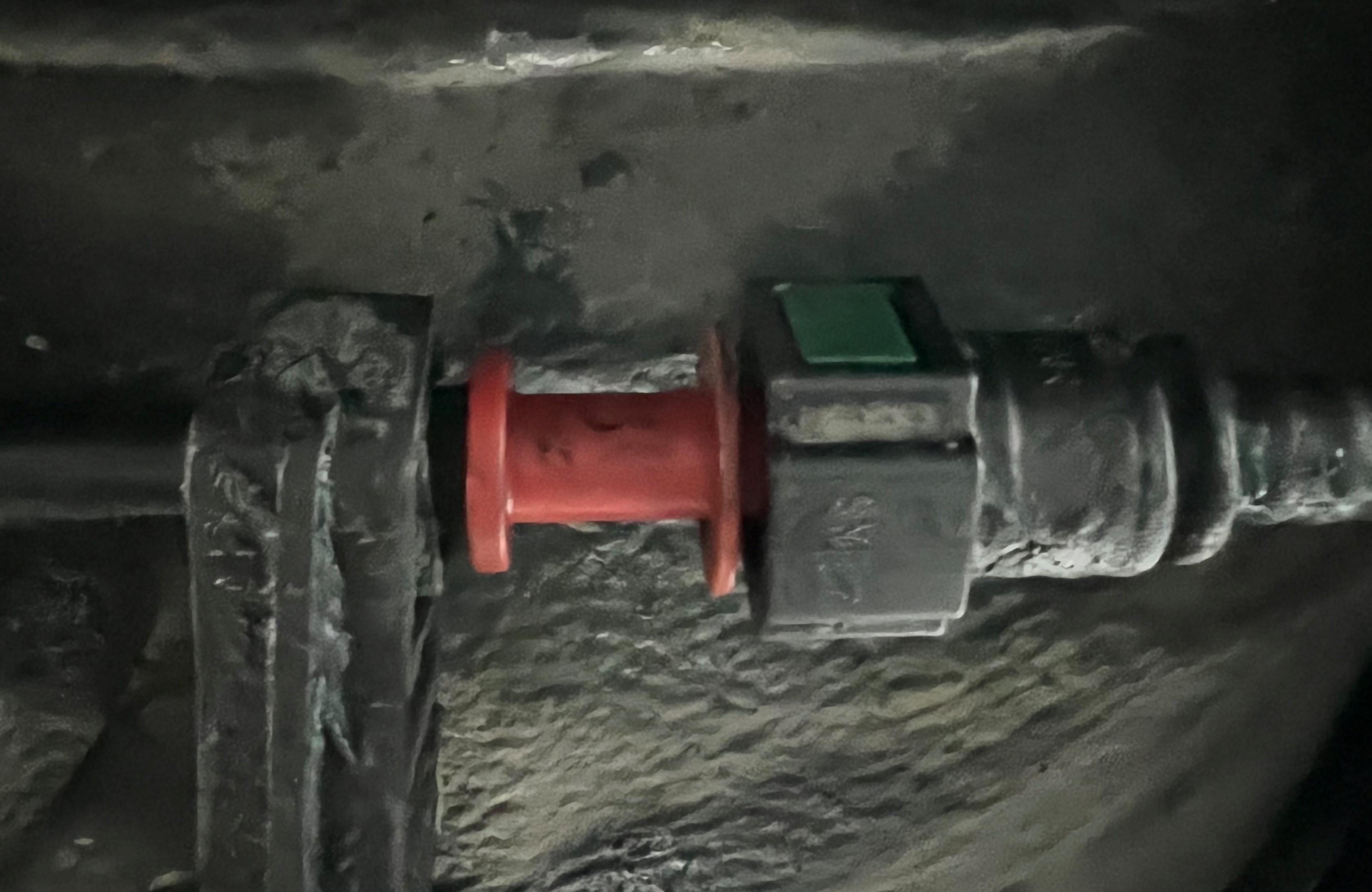

Original with green clip

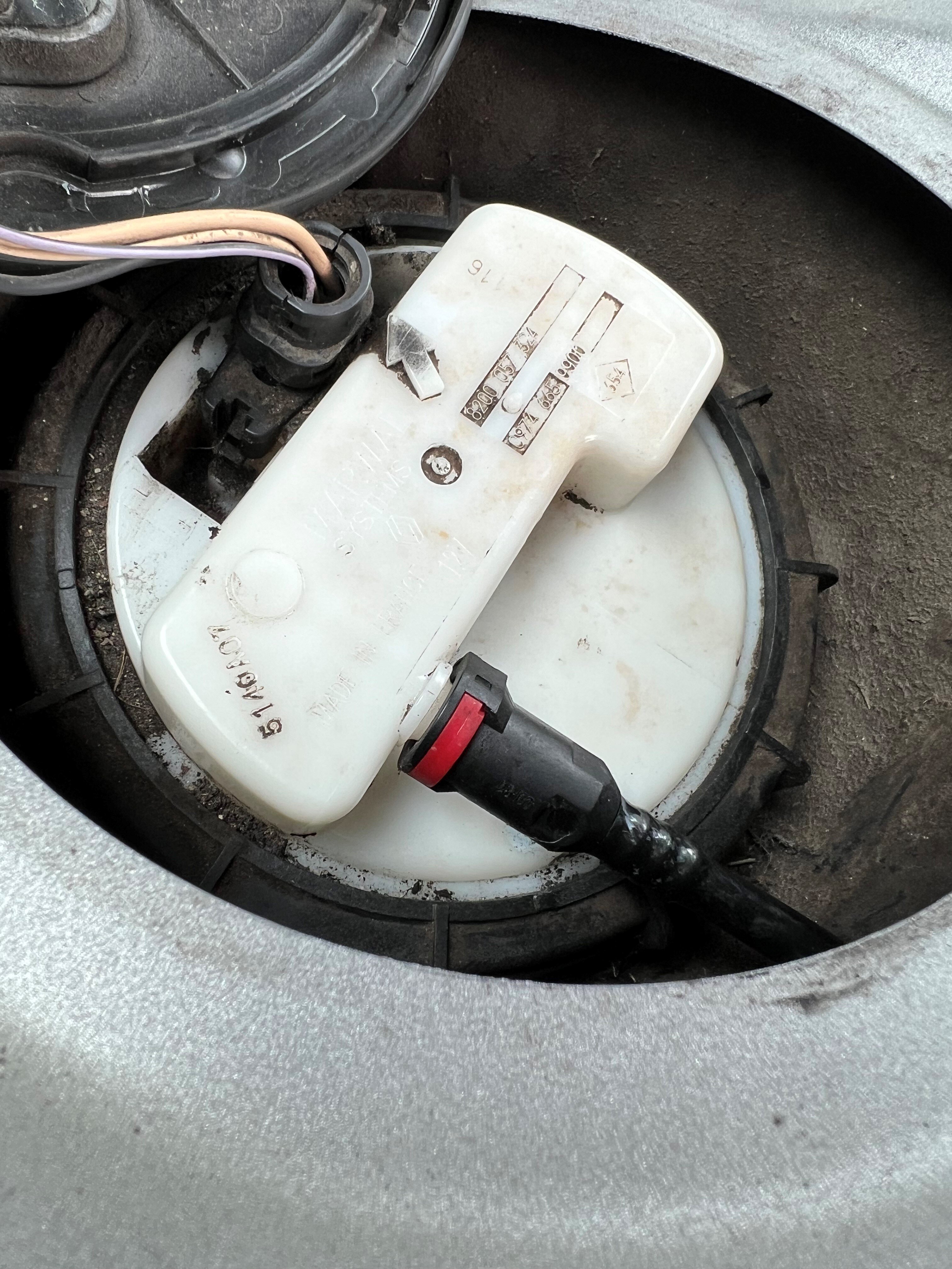

Loosen fuel tank bolts for for a bit of manoeuvrability so you can pull the new hose through

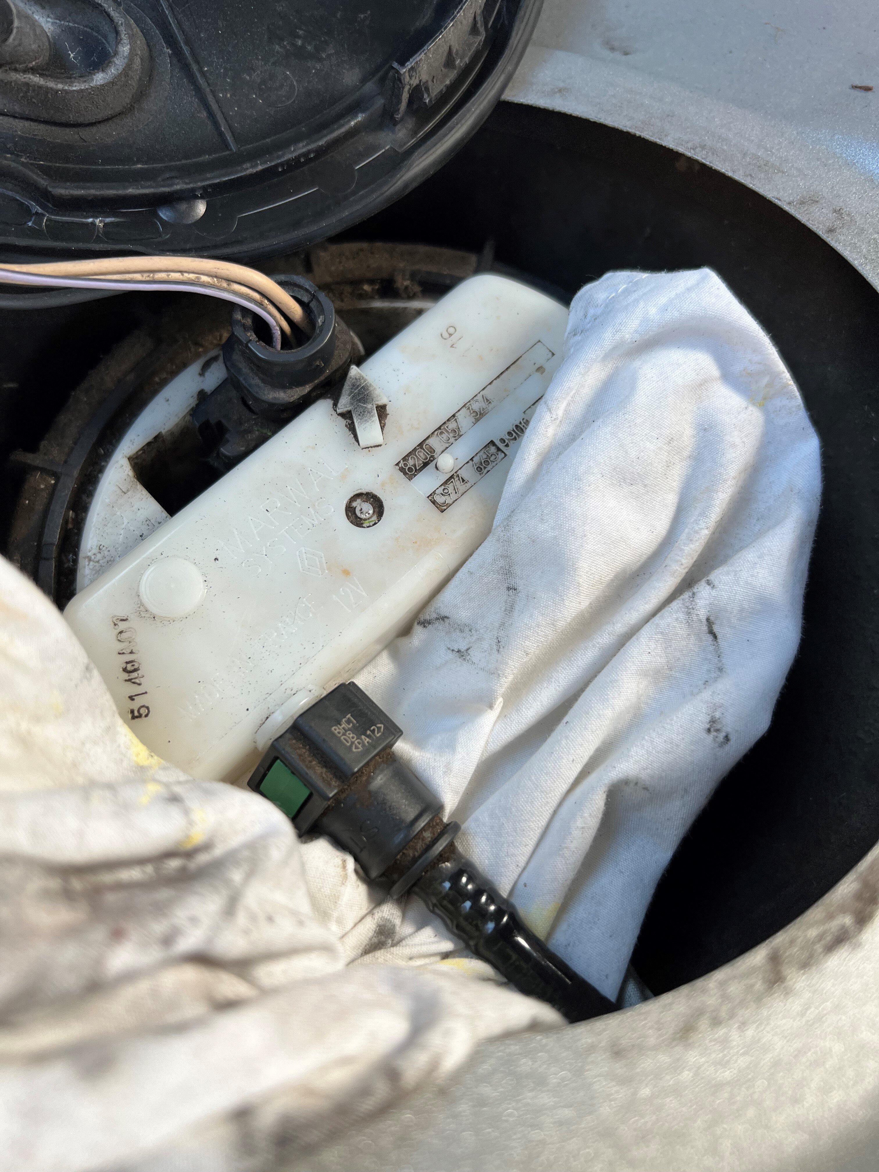

New hose connected to hose leading up in to engine bay
New hose with red clips in sitchu' under rear drivers side passenger seat

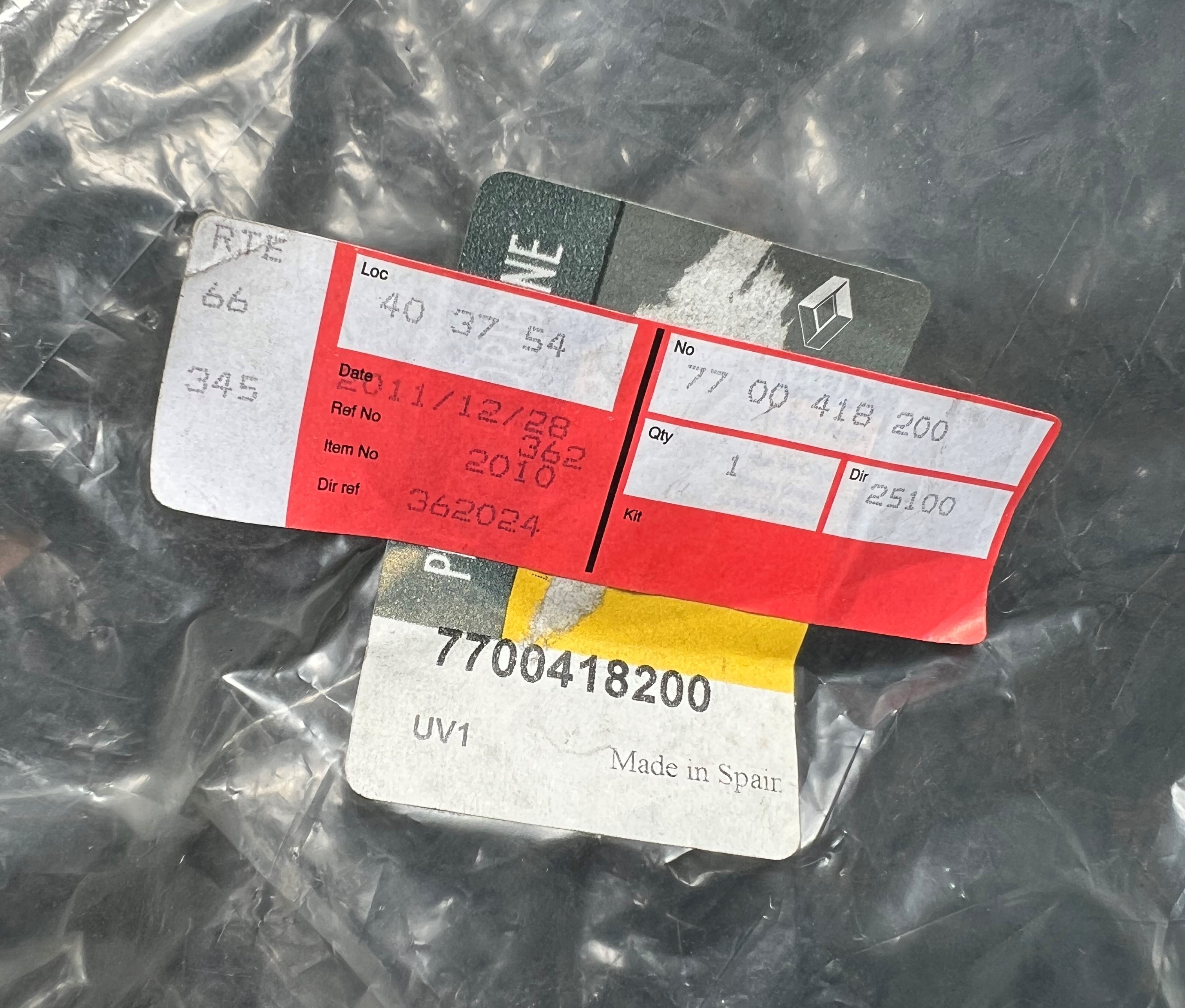

Part No.
