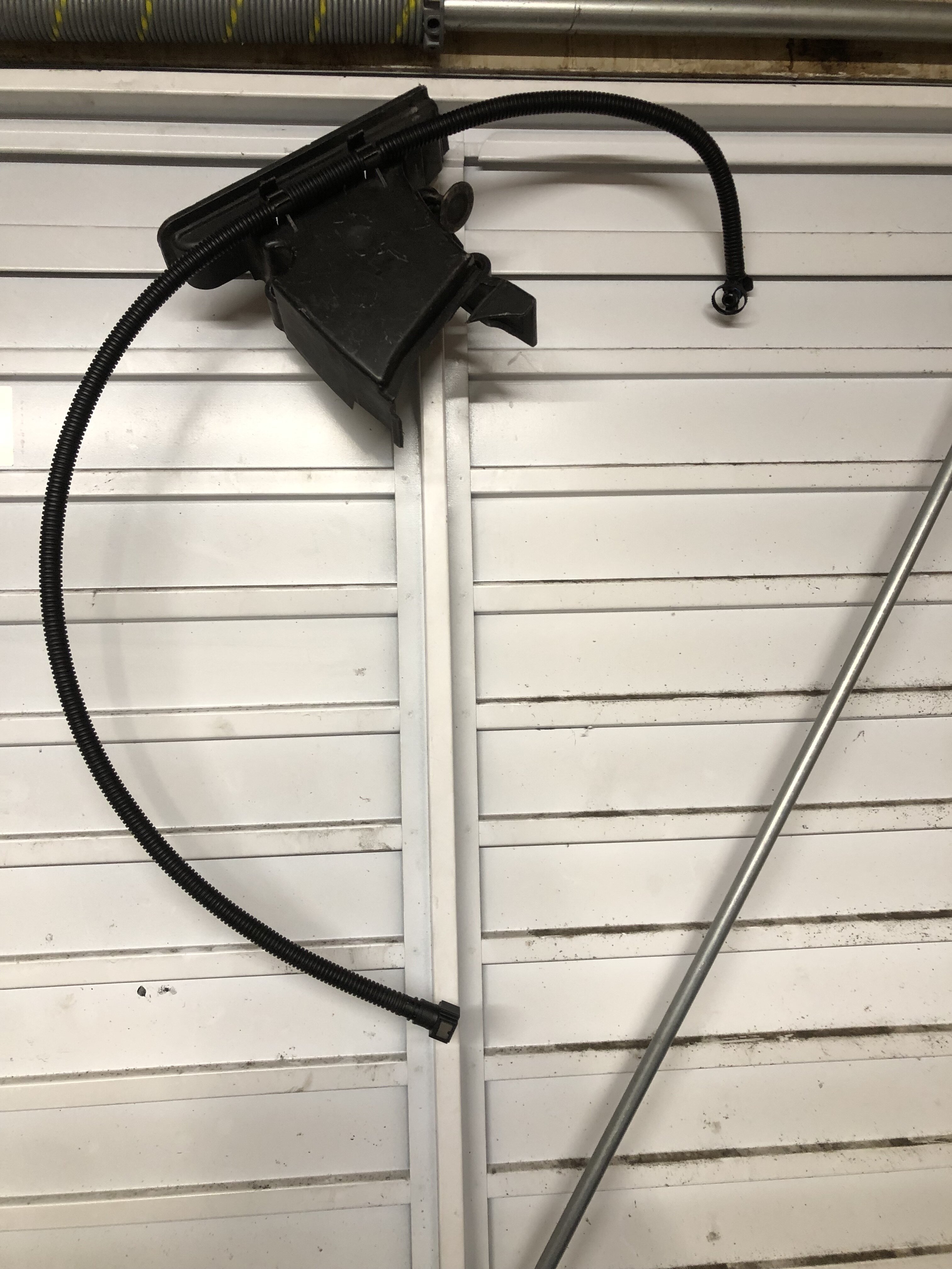

Just a heads up guys and gals , I make these fuel lines from the fuel rail to the connection under the drivers floor / subframe area .
I’ve made the first one and will undergo testing very soon .
Not sure if anyone has seen my repair fuel pipe before , but having 1 customer send me a message saying that my pipe didn’t fit , I was shocked and so went on to the next level of supplying the full length “first section” fuel line.
Any questions PM me and I’ll be happy to chat and answer any question.
