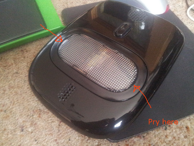

Hi wanting to replace my bulb, got the right bulbs and everything just wondering how I take it out? It's not like the standard clio one where has 2 separate bulbs it's just the one and to turn on it's like a door switch, any ideas on how to remove it? I've taken it off but no access through back? Any ideas cheers
Not sure if they are different but on my nonsport you just take the unit out, disconnect the cable and they bulbs are in twist-out holders. Can't really miss them, quite similar method to the front indicator lights (if you've ever changed them)
