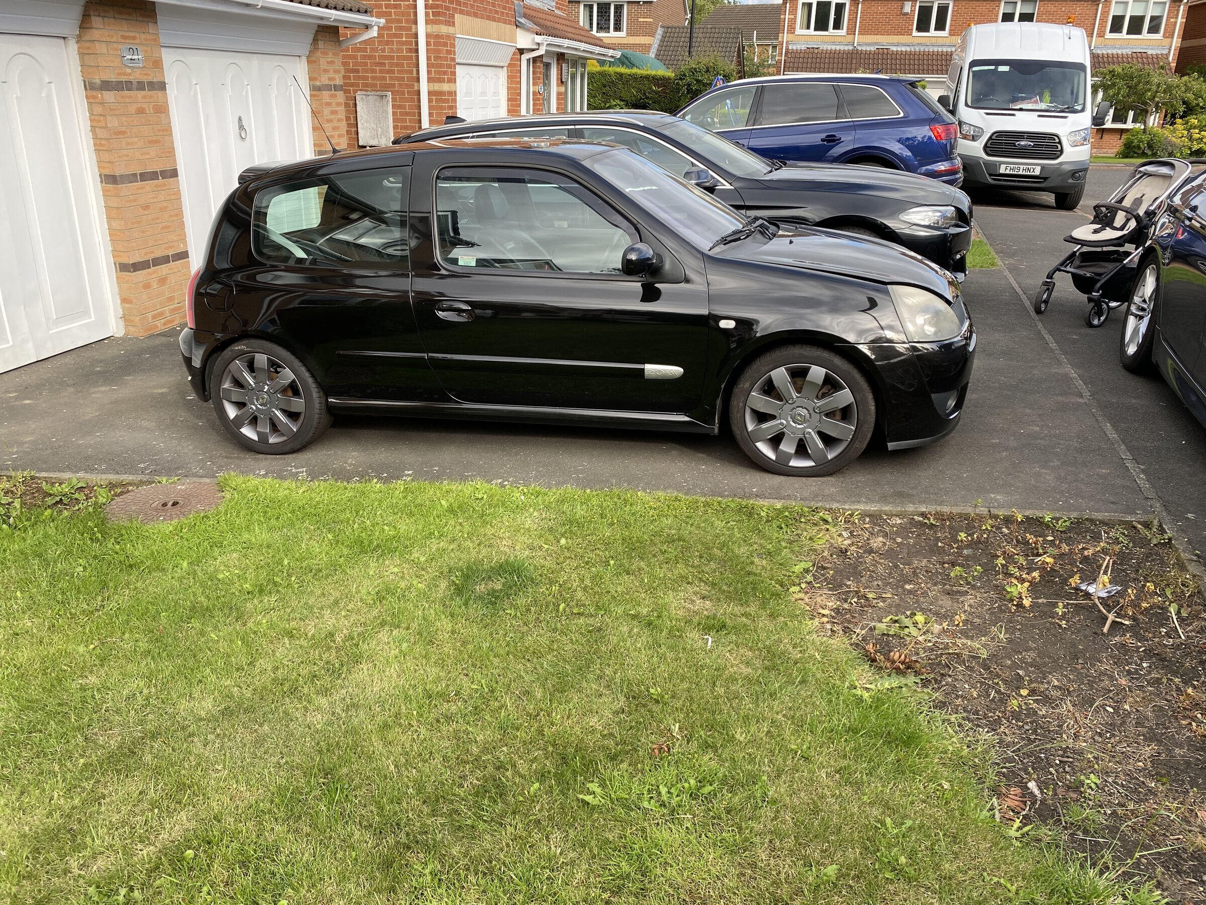

Anyway, many years ago I purchased a 182 that looked like this:
Then around 3 or 4 years ago it went into hibernation in the garage and spent a long time looking like this. Sometimes it had more sawdust on it, sometimes it had less. Sometimes it had more things stacked on its roof, sometimes it had less. Anyway, you get the idea

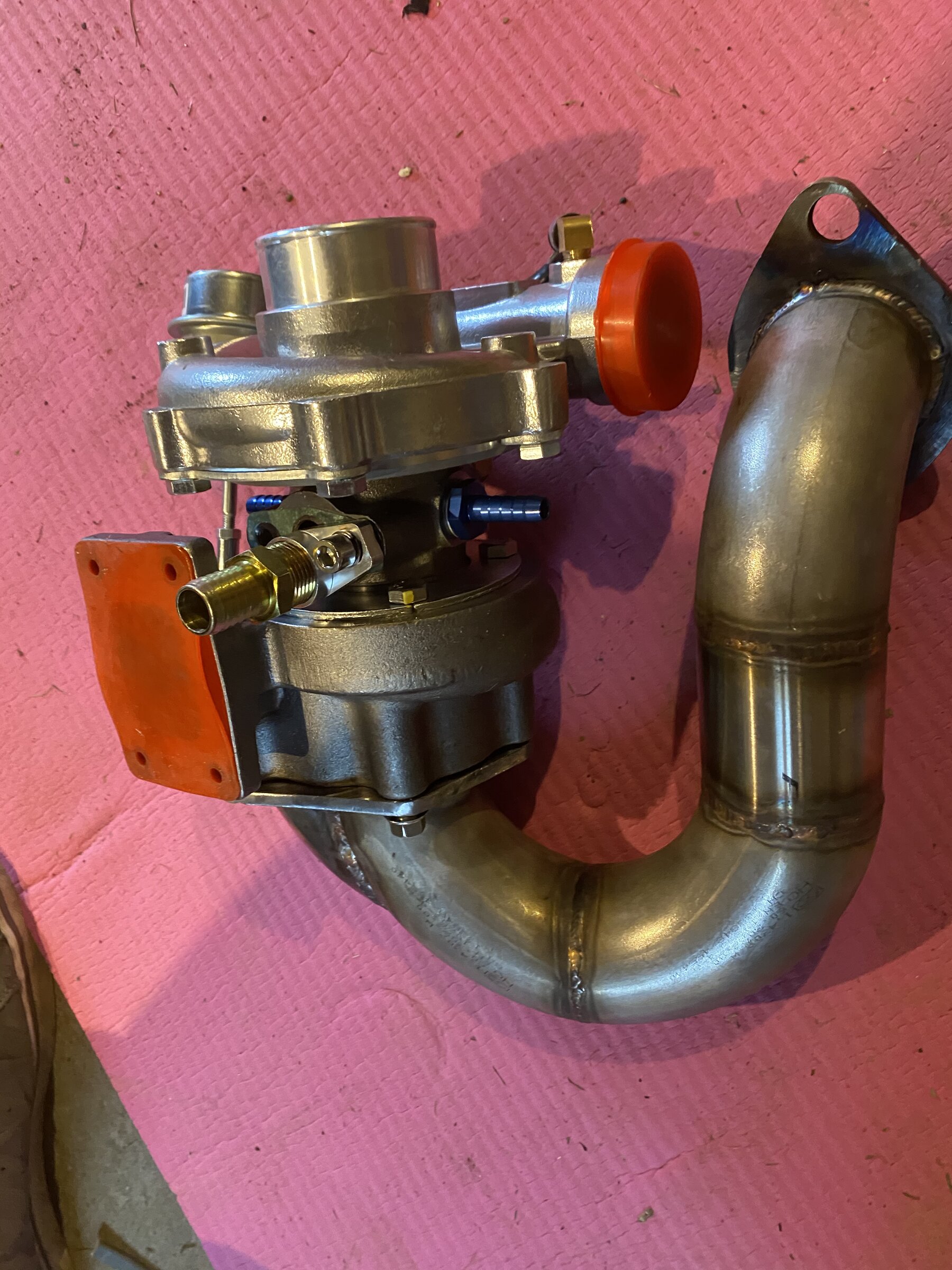

Then at some point I started collecting turbo bits. Last week I ended up with this:
So at some point the above turbo and related turbo’y bits will be strapped to said 182. Not going for anything wild so around 230bhp will be just nice. Then once it’s all done it’ll probably go back in the garage and repeat the cycle of being covered in sawdust and children’s toys 👍

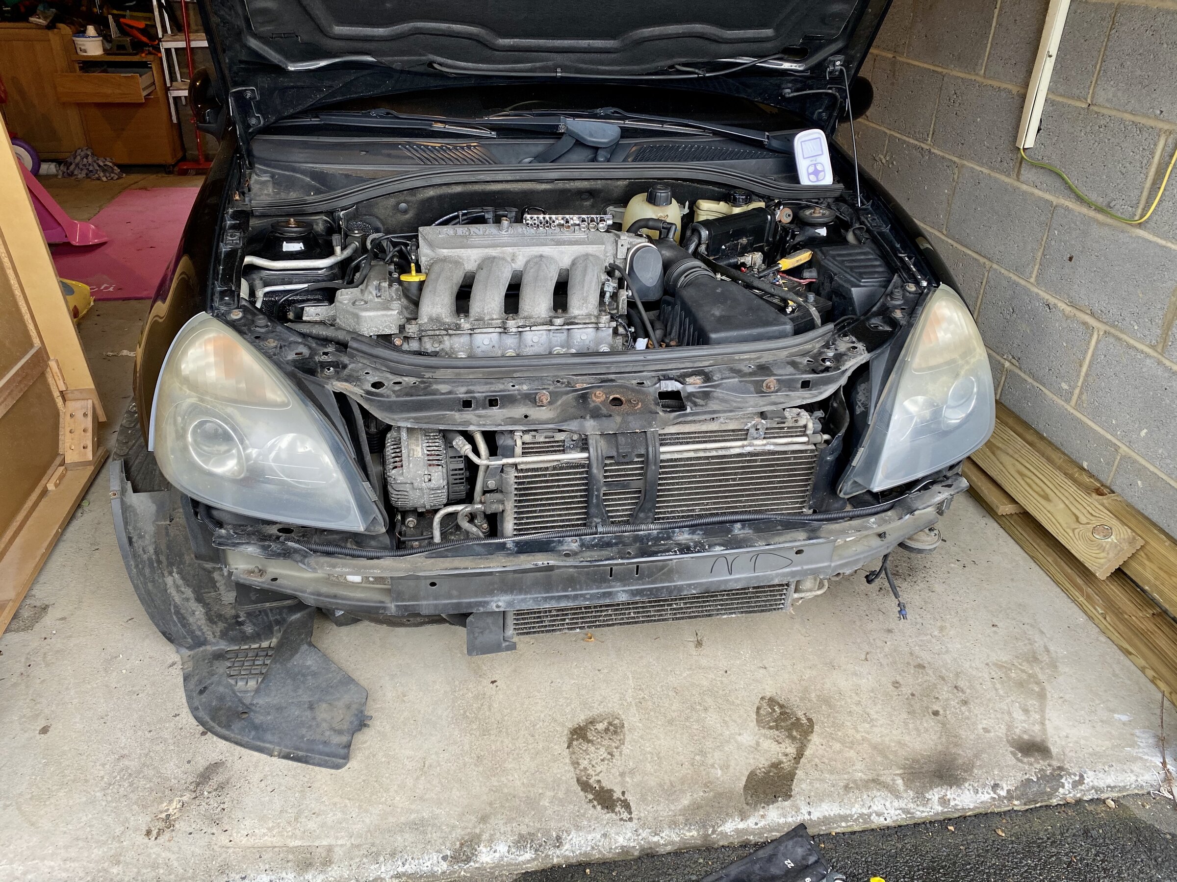

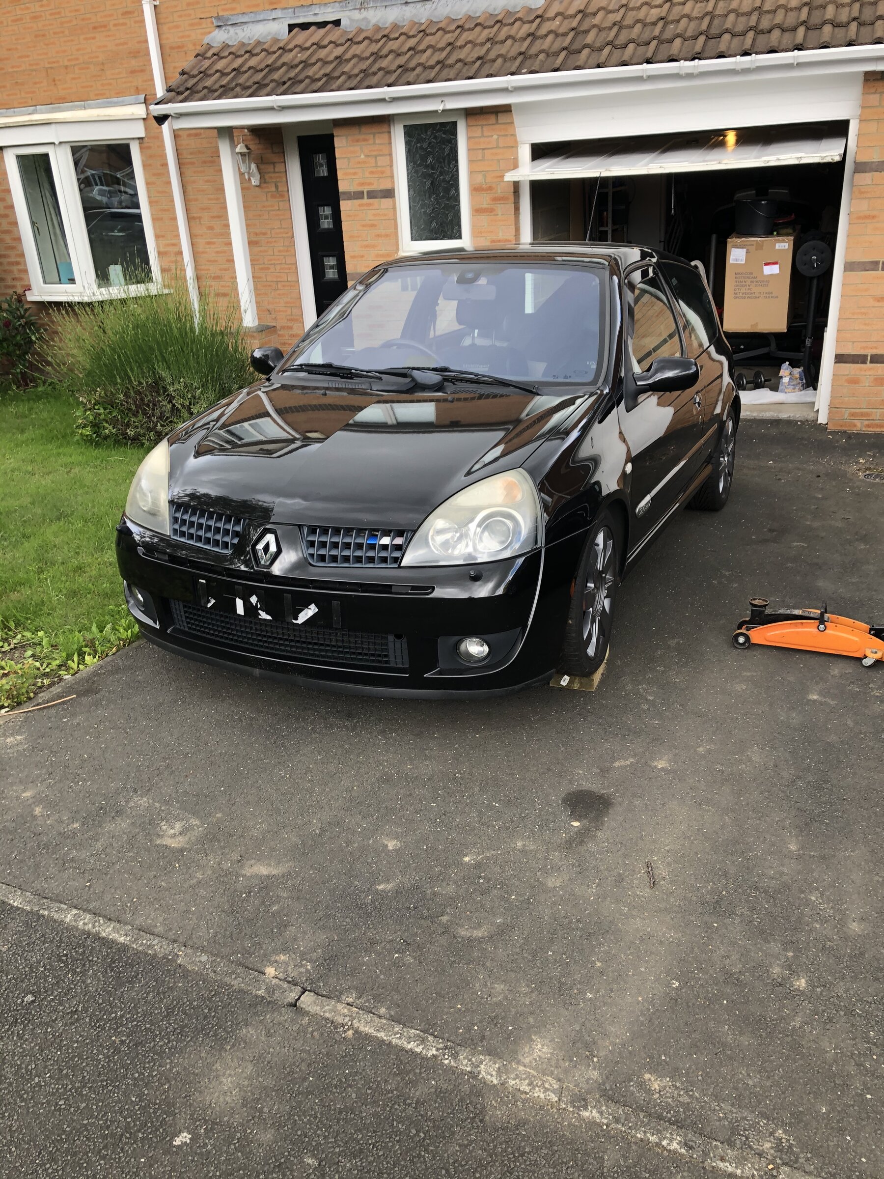

I pulled the car out of its little house. Quick rinse and it looks great, all be it a bit wonky
A

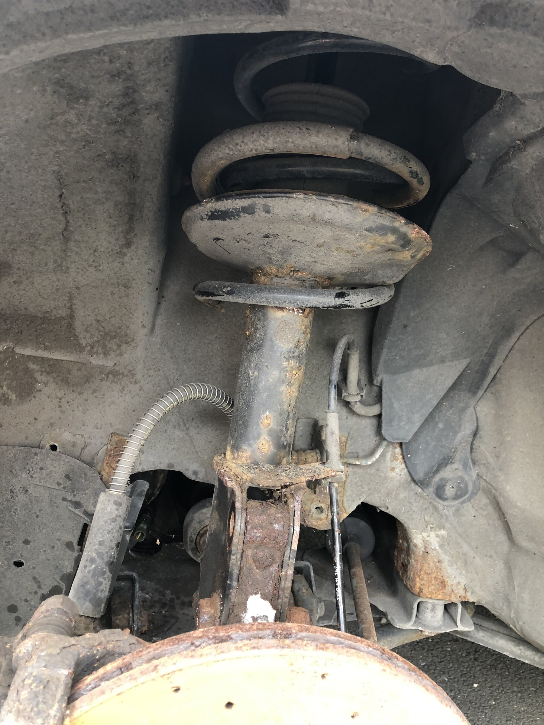

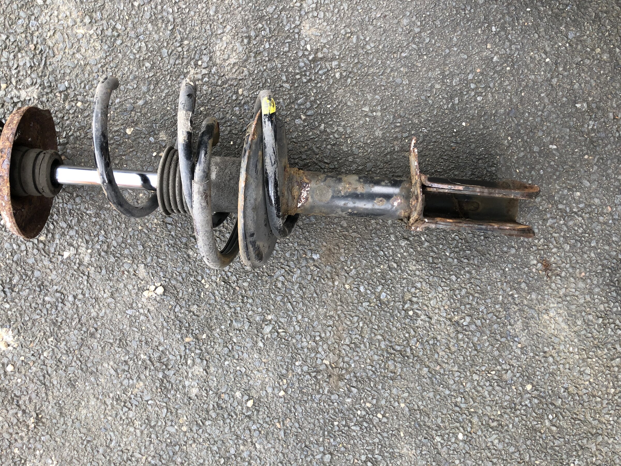

Whipped the wheel off, problem is pretty obvious
a
Front spring is totally snapped. Suppose that makes perfect sense on a car that hasn’t moved for years 🤦‍♂️. Back 2 are also gone. It’s an easy fix though, fitted a new set of eibach lowering springs and jobs a gud’n.
Or at least it was until I started on the drivers side and snapped my 21mm spanner. Did the sensible thing and threw it over the back fence into the forest behind the house and went inside in the huff for a beer. Cocked up a bit though, was a Halfords one with lifetime guarantee which turns out doesn’t apply if you’ve lobbed it over the fence 🤷‍♂️. Anyway, that’s a job for next week

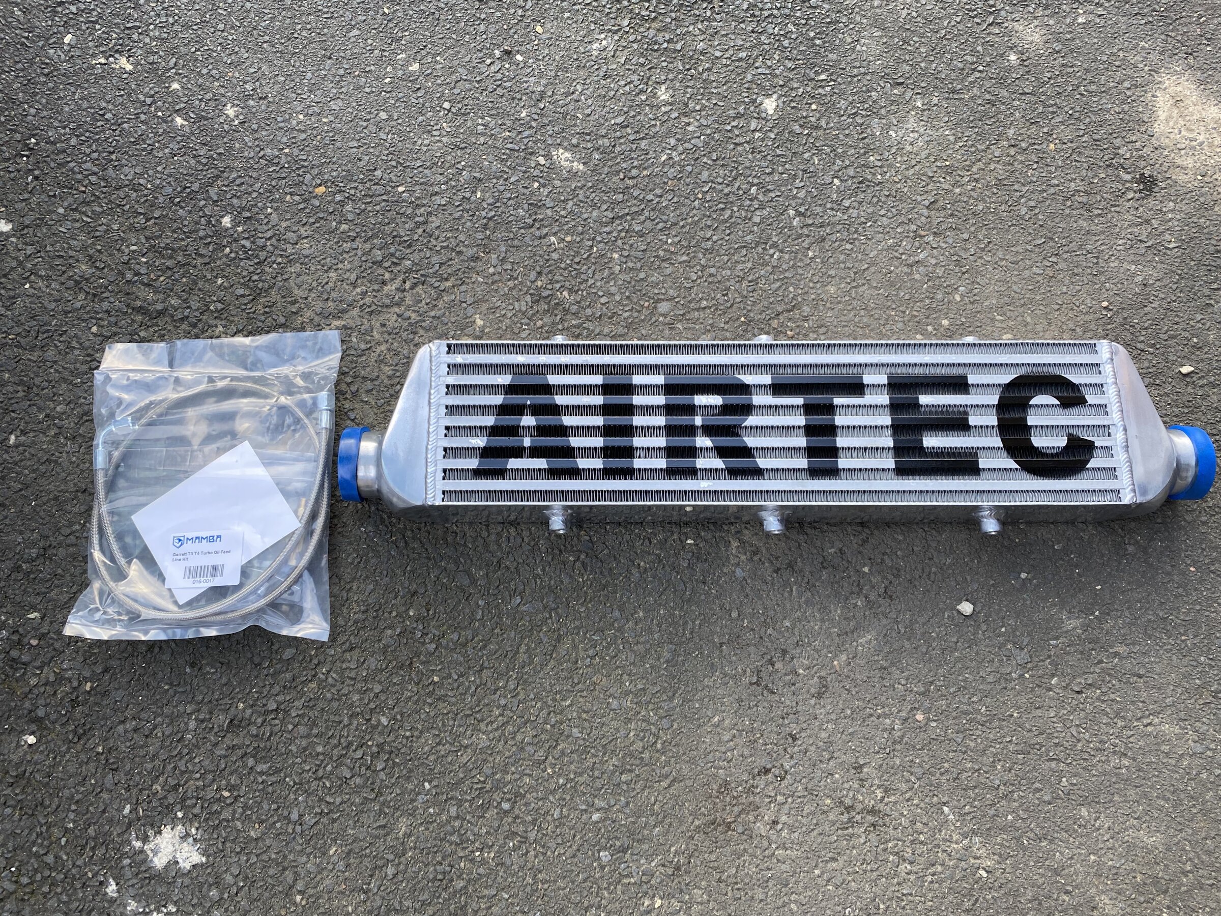

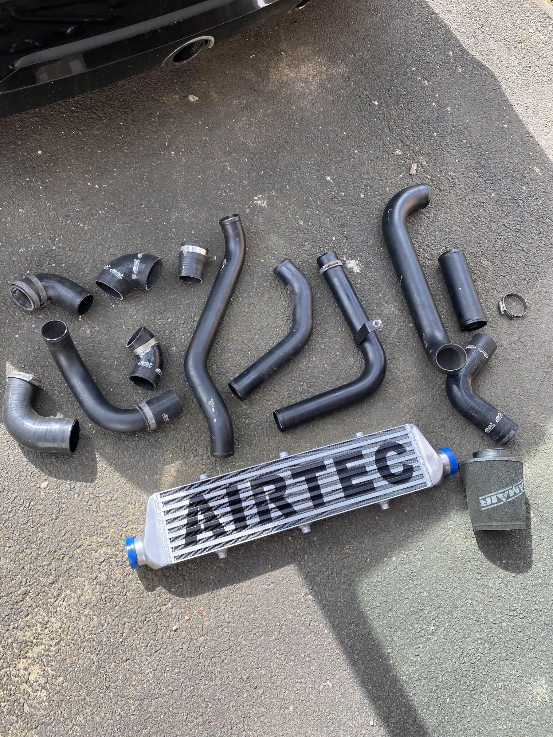

Also the postman brought me an intercooler and oil feed kit. Downpipe and boost pipes are due this week at some point so I’ve almost got all I need! First plan is to get it through a MOT, get the belts done because I’m fairly sure the timing is out and then get cracking!

In more interesting turbo related news... I now have intercooler pipe work. Managed to get a 2nd hand ED kit for pennies. The pipes don’t fit the intecooler so need a couple of increasers but no issues there. Got literally no ideas what goes where and how it all links together so that should be a fun day to fit it 🤦‍♂️.

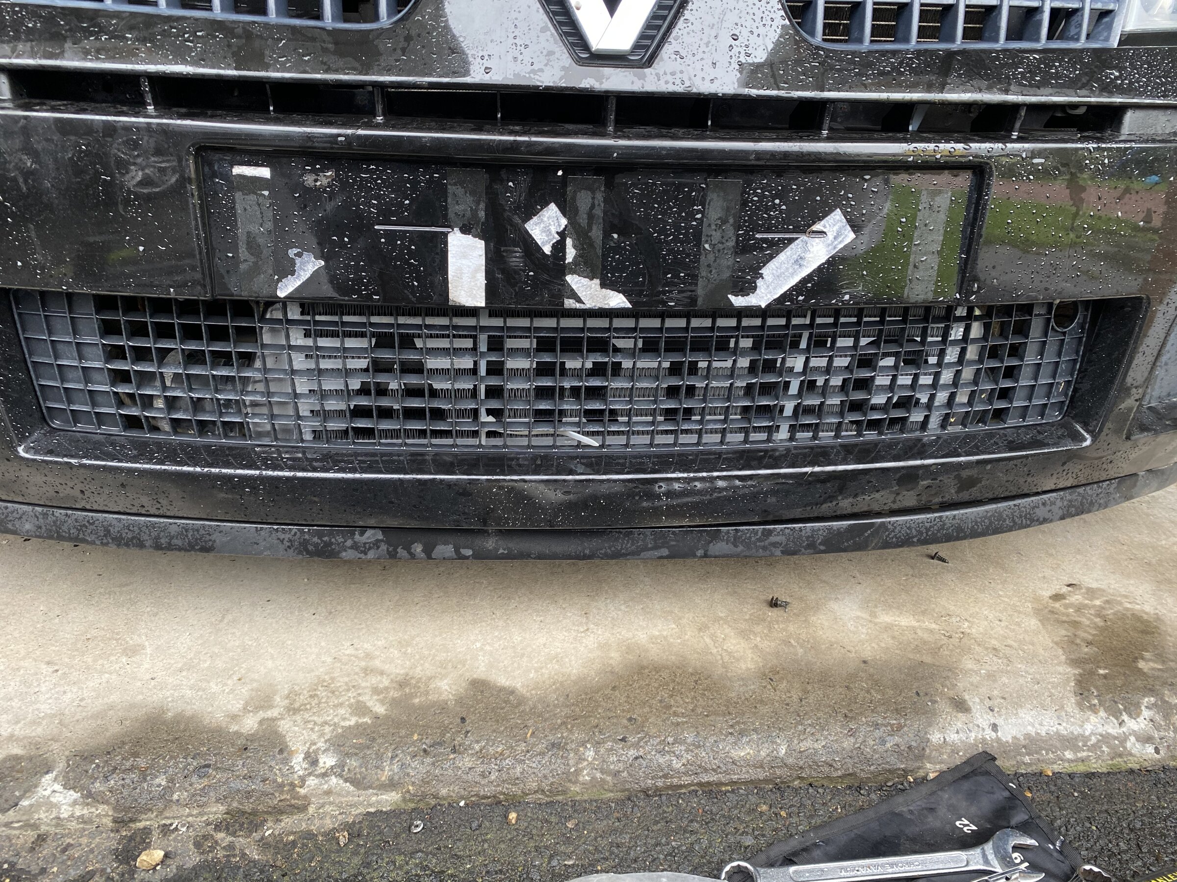

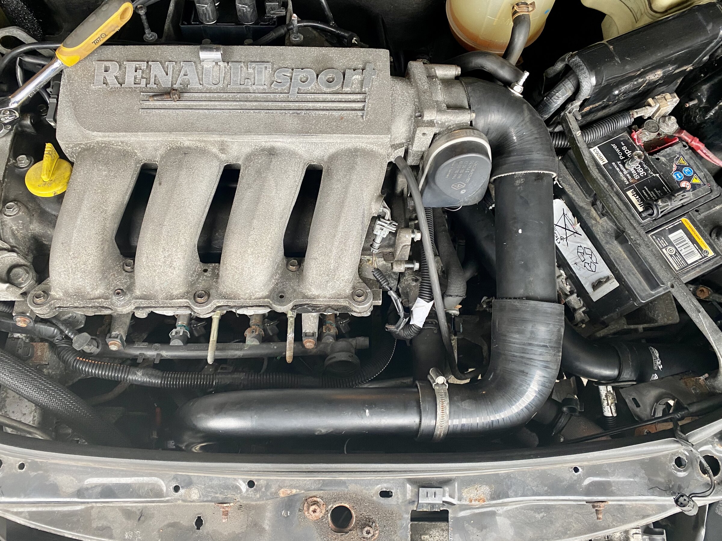

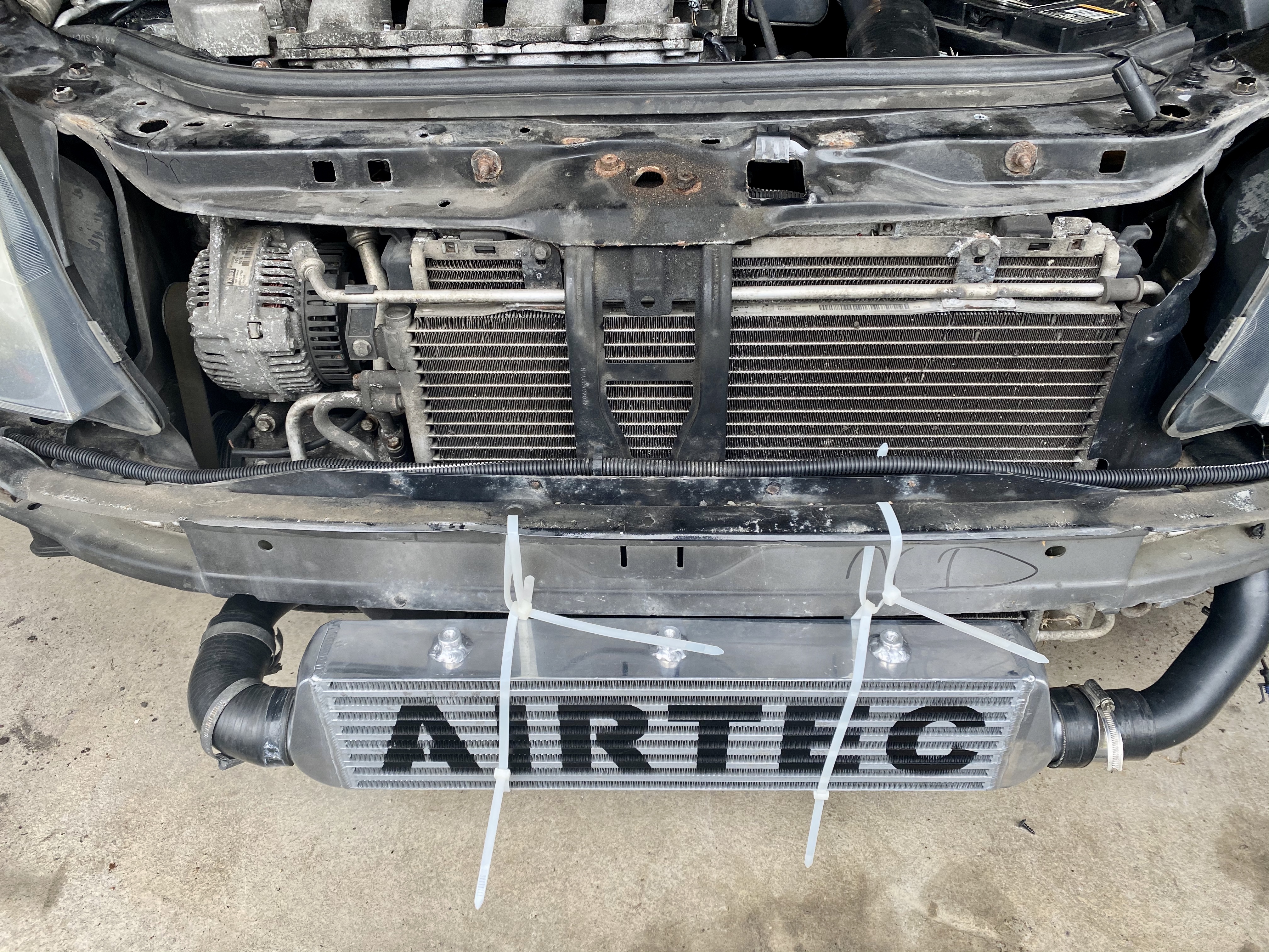

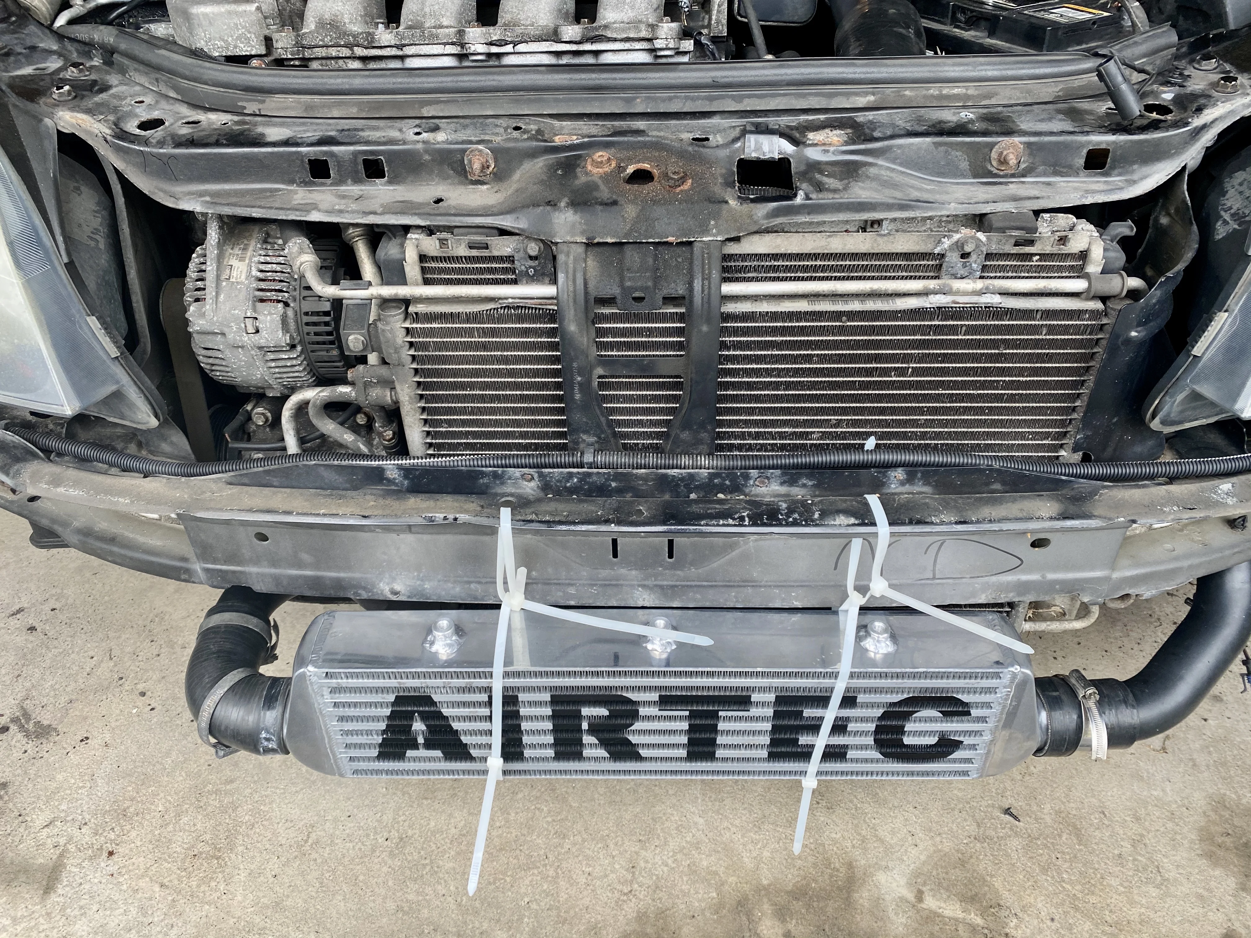

Bit of an update. Decided to get cracking a bit and the mess of intercooler pipes seemed like a good place to start. All the bumper screws were a total mess so just ripped it off. Some of the arch liners might not be very well any more 🤦‍♂️

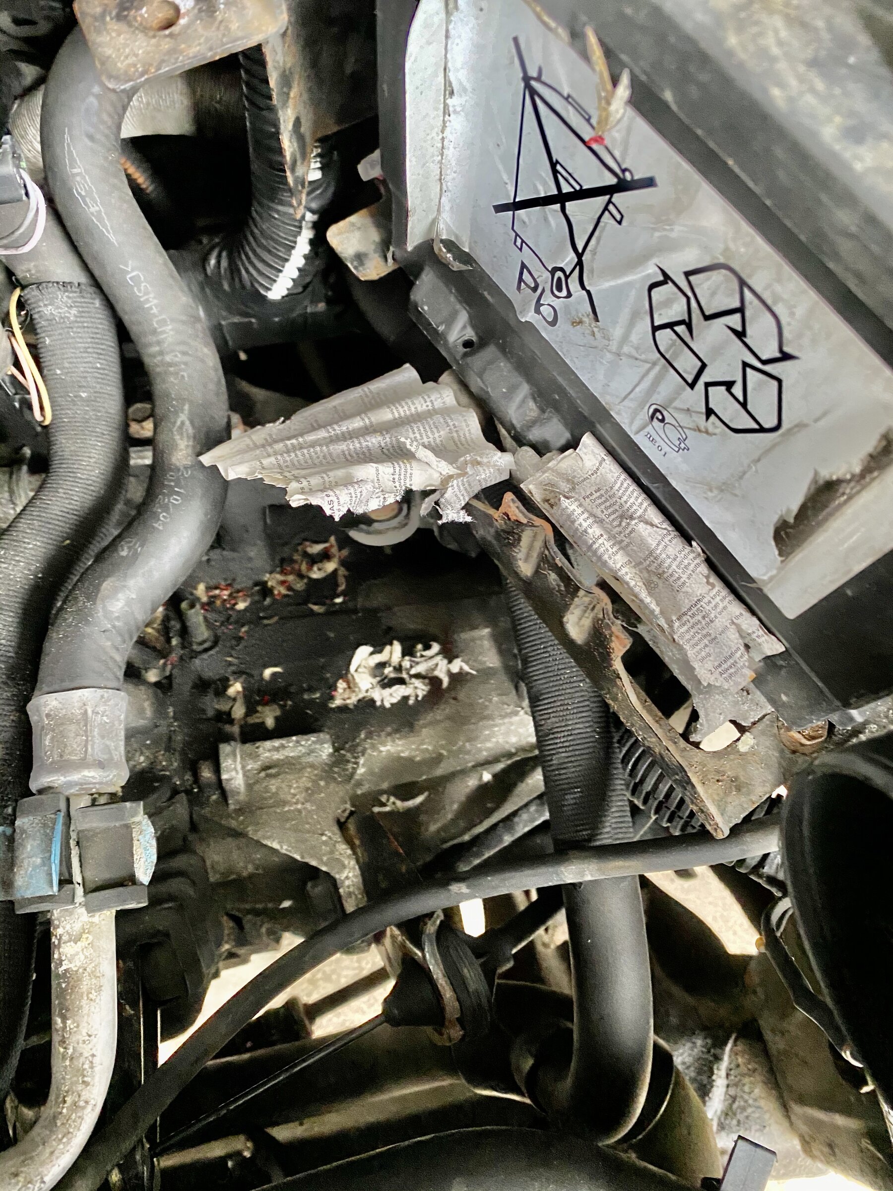

pulled the old air box out and I think I’ve had a mouse living in there at some point when it’s been parked up haha! That can only spell good news for French electrics 🤔
Some world class cable tie engineering to get things mocked up. So pleased I bought a proper kit cos there’s no way I would have ever figured that out!
Bumper kinda fits but needs trimmed a bit

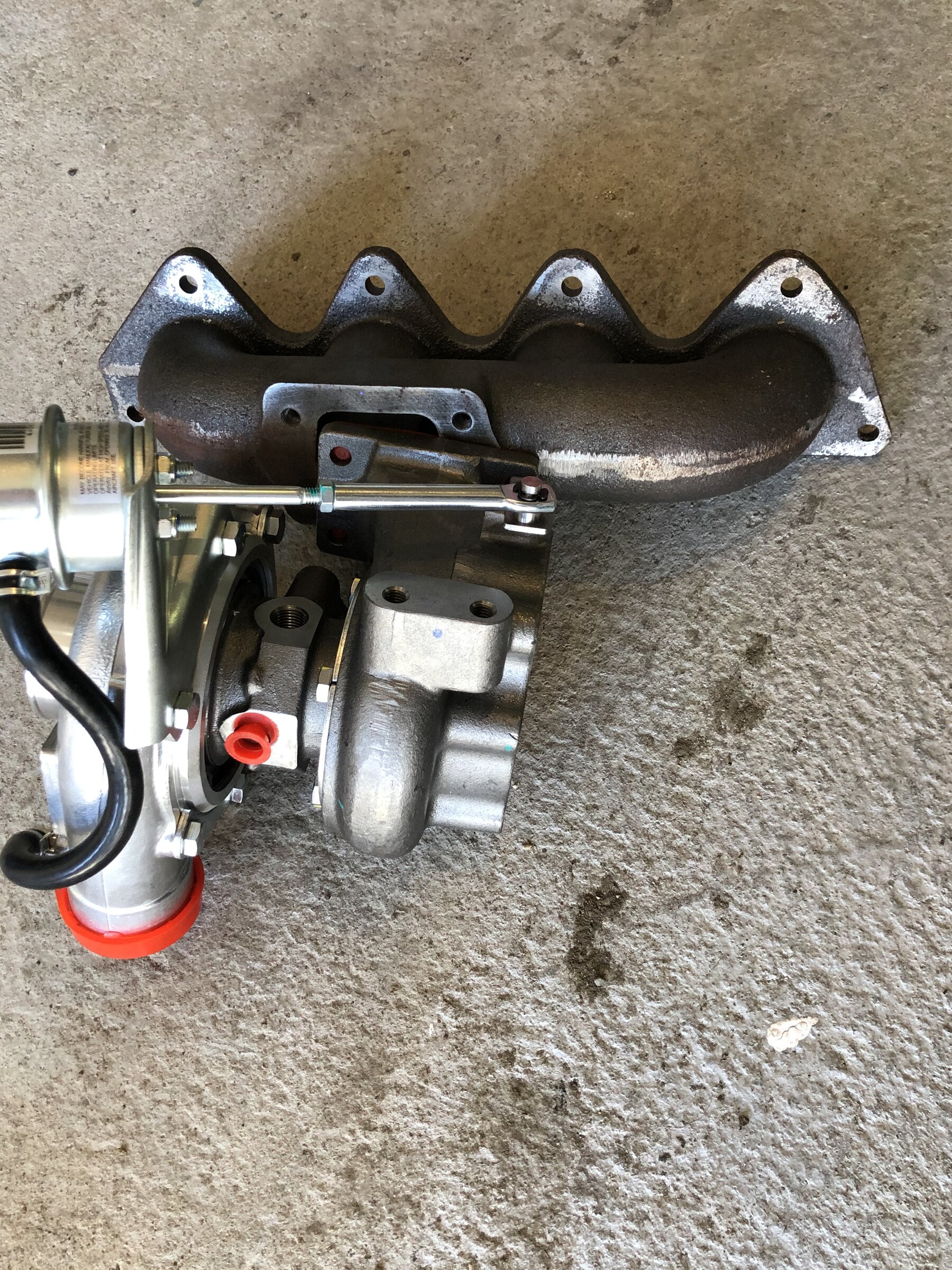

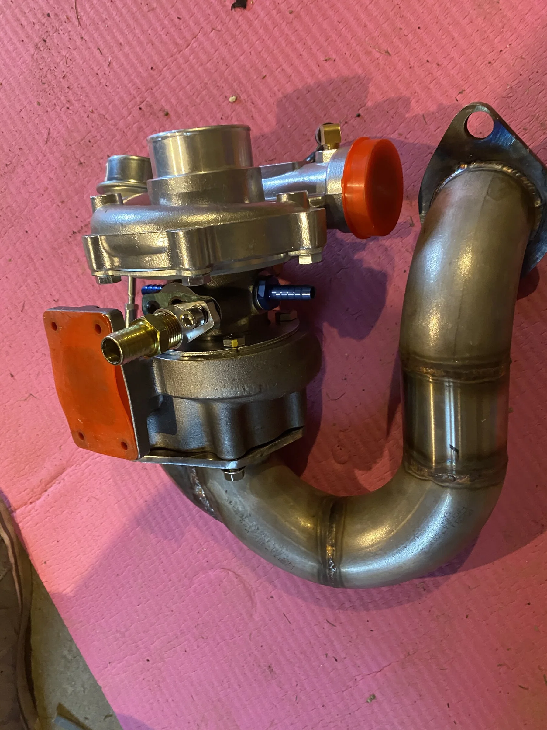

Downpipe has also finally arrived but my turbo is backwards so the next job is to flip it 180 so the downpipe doesn’t go straight into where the boost pipe lives

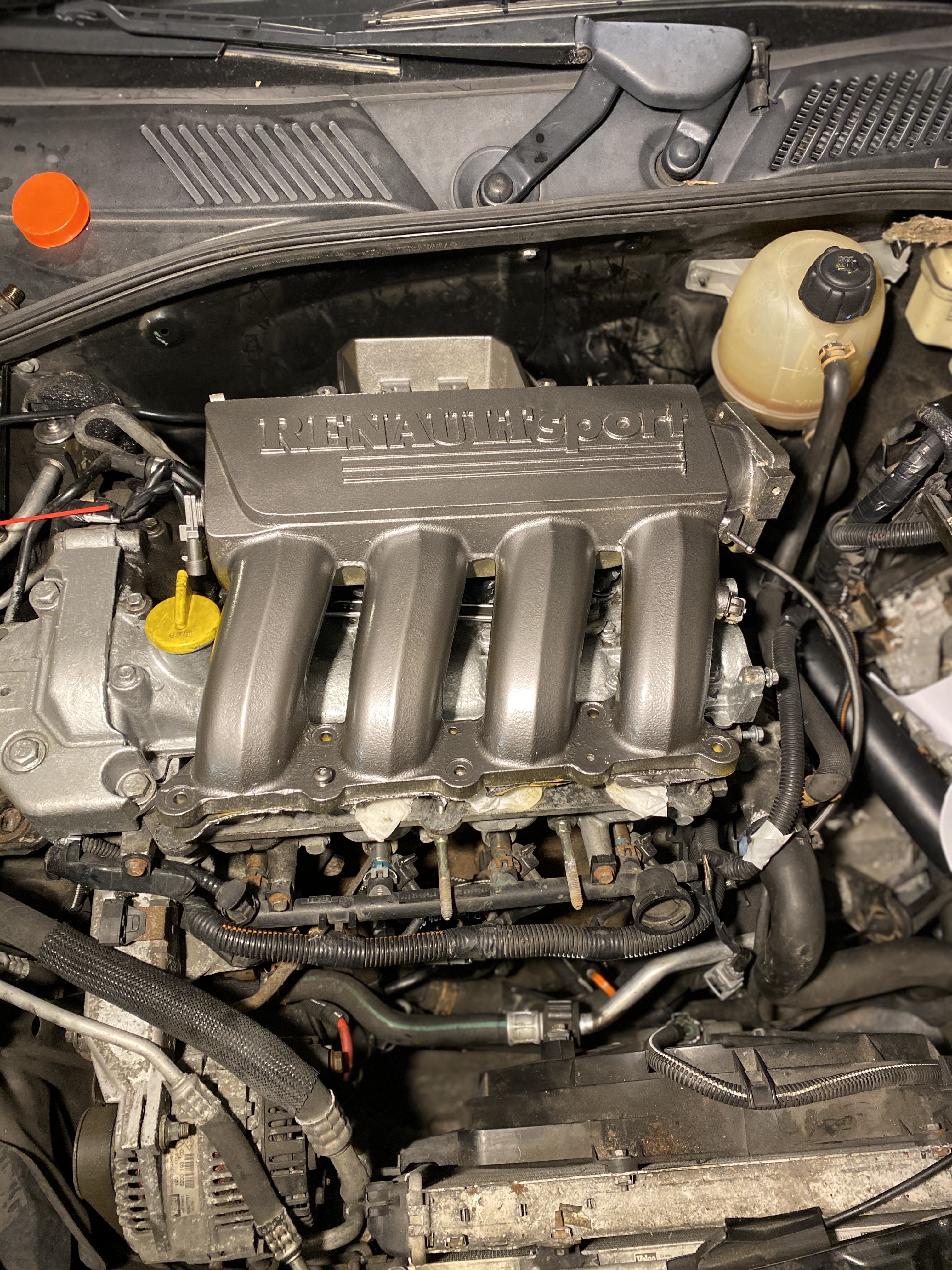

Boring update so no pics. Stripped off the inlet manifold and all it’s associated crap, pulled off the old heat shield and spongy stuff and took the head bolts and studs off on the exhaust manifold. Handily whoever fitted the manifold only put 5 nuts on and only did the easy to access ones so saved me some work! Plan for the rest of the week is to get the oil return drilled onto my new sump then at the weekend drop the subframe, remove the old exhaust manifold and fit the new sump with the oil return. If I get time the turbo might get it’s first fit.

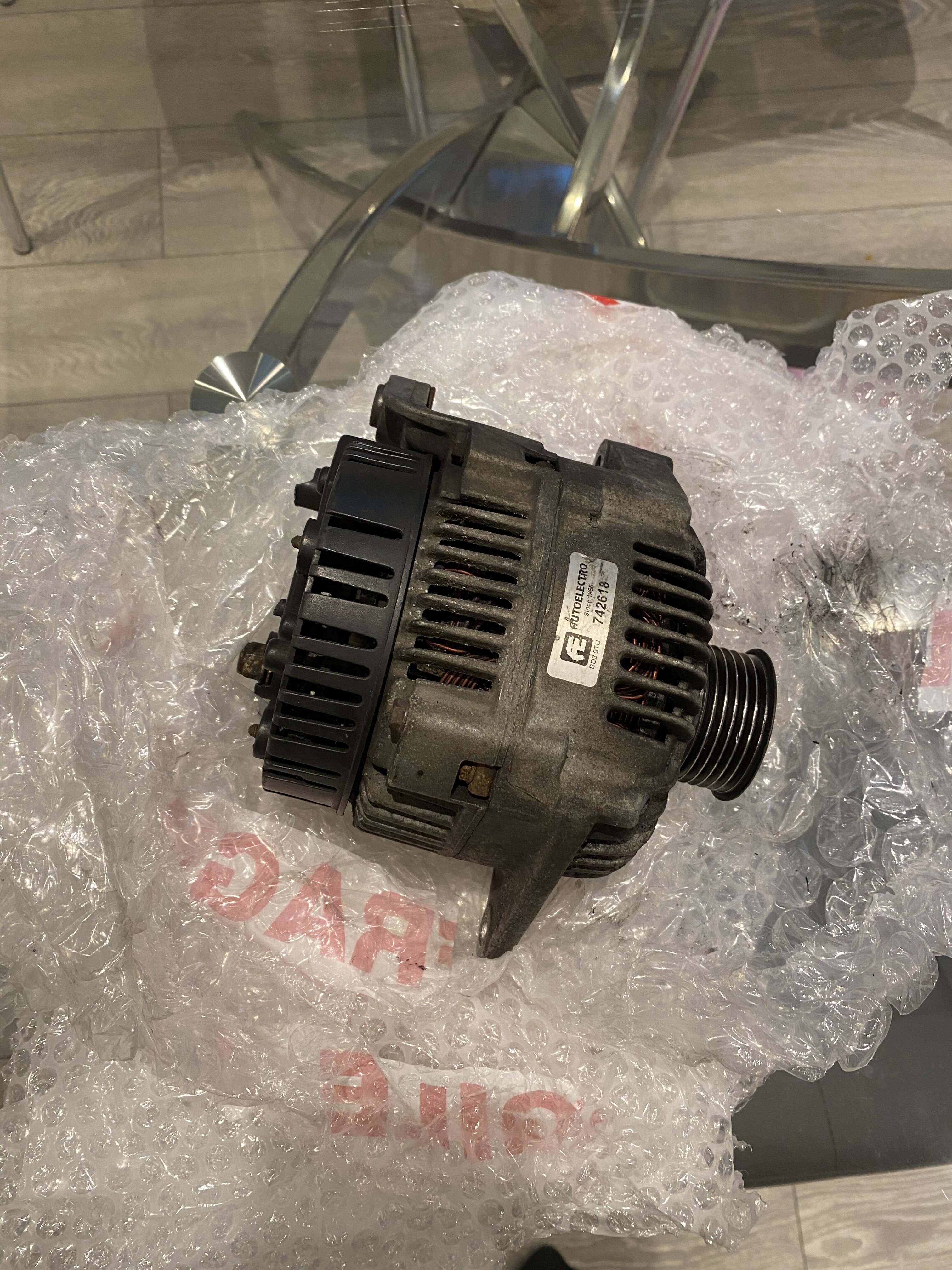

I’m in need of an alternator. The engine bay mice have totally bollocksed my current one which smells a lot like fire when it’s running. I still also need to source an oil feed that fits my turbo and the efi parts boost control kit. I’ve given up hope of sourcing a ph1 fuel setup and failed miserably at my attempts of making one from a ph2 rail so I’m going to use the current setup and pay them to custom map to suit.

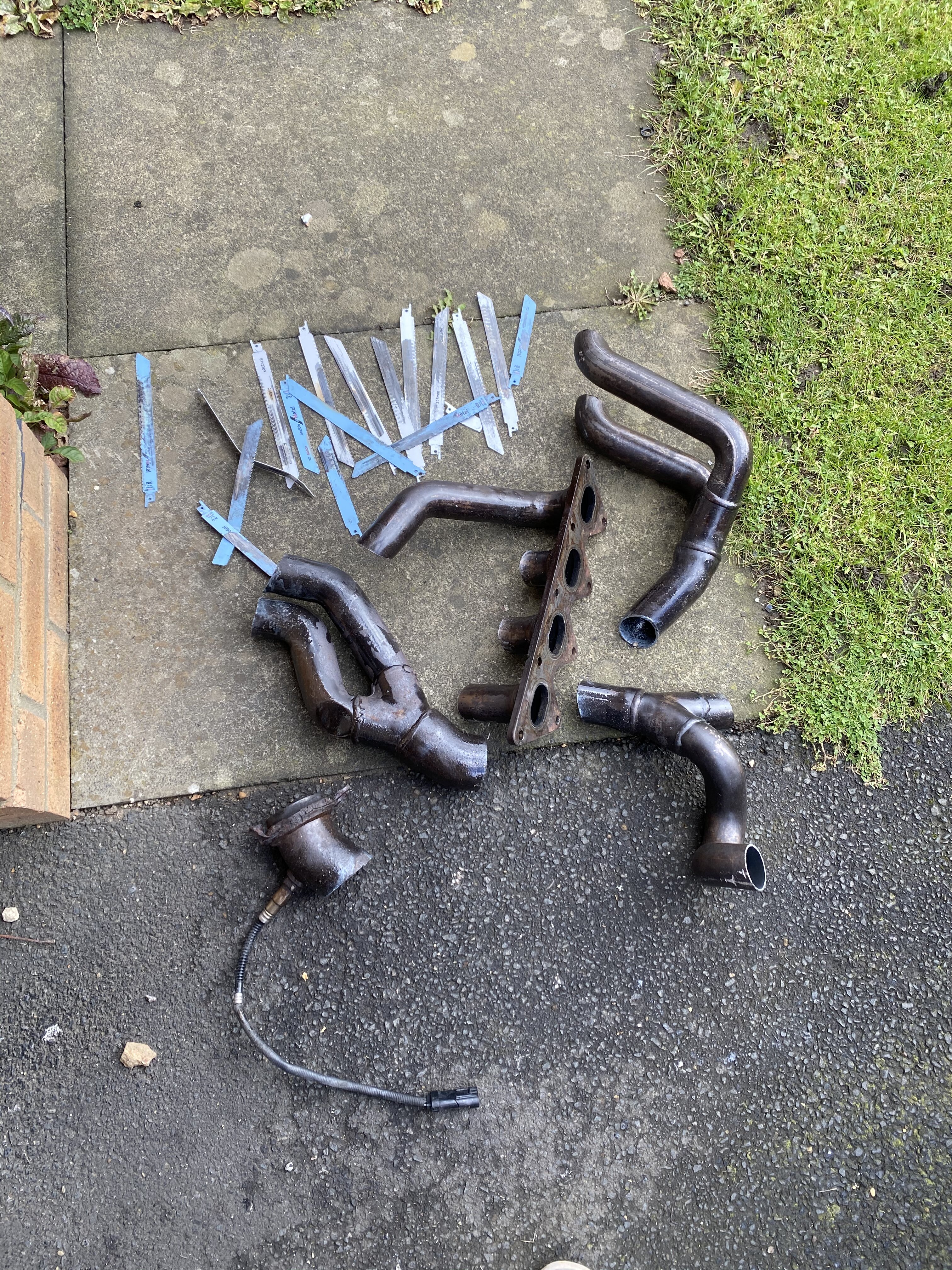

Bit more progress today. All the subframe bolts decided to be arseholes and spin so decided to chop the manifold off instead. Wasn’t the easiest of jobs and went through a million blades but it’s done

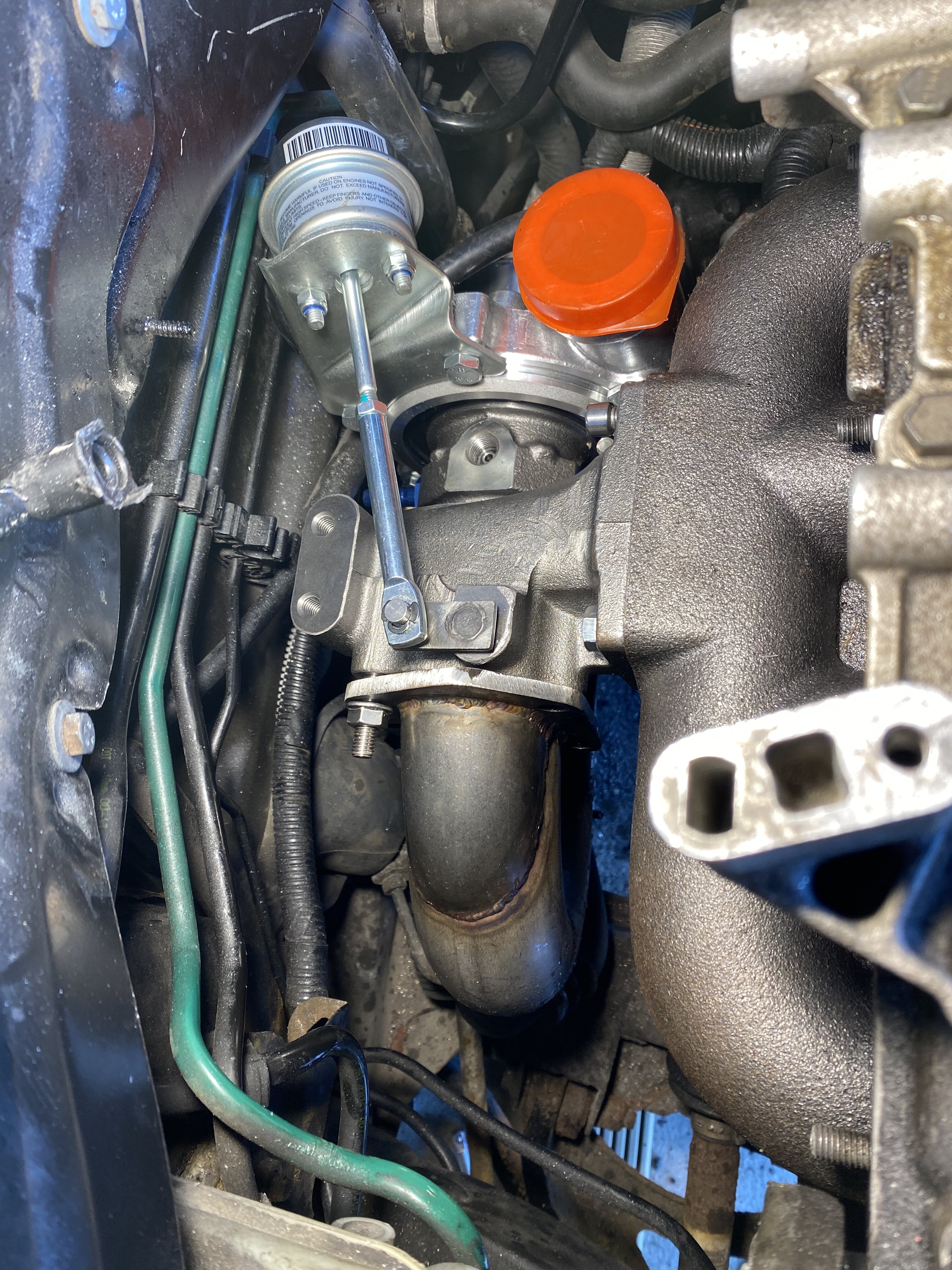

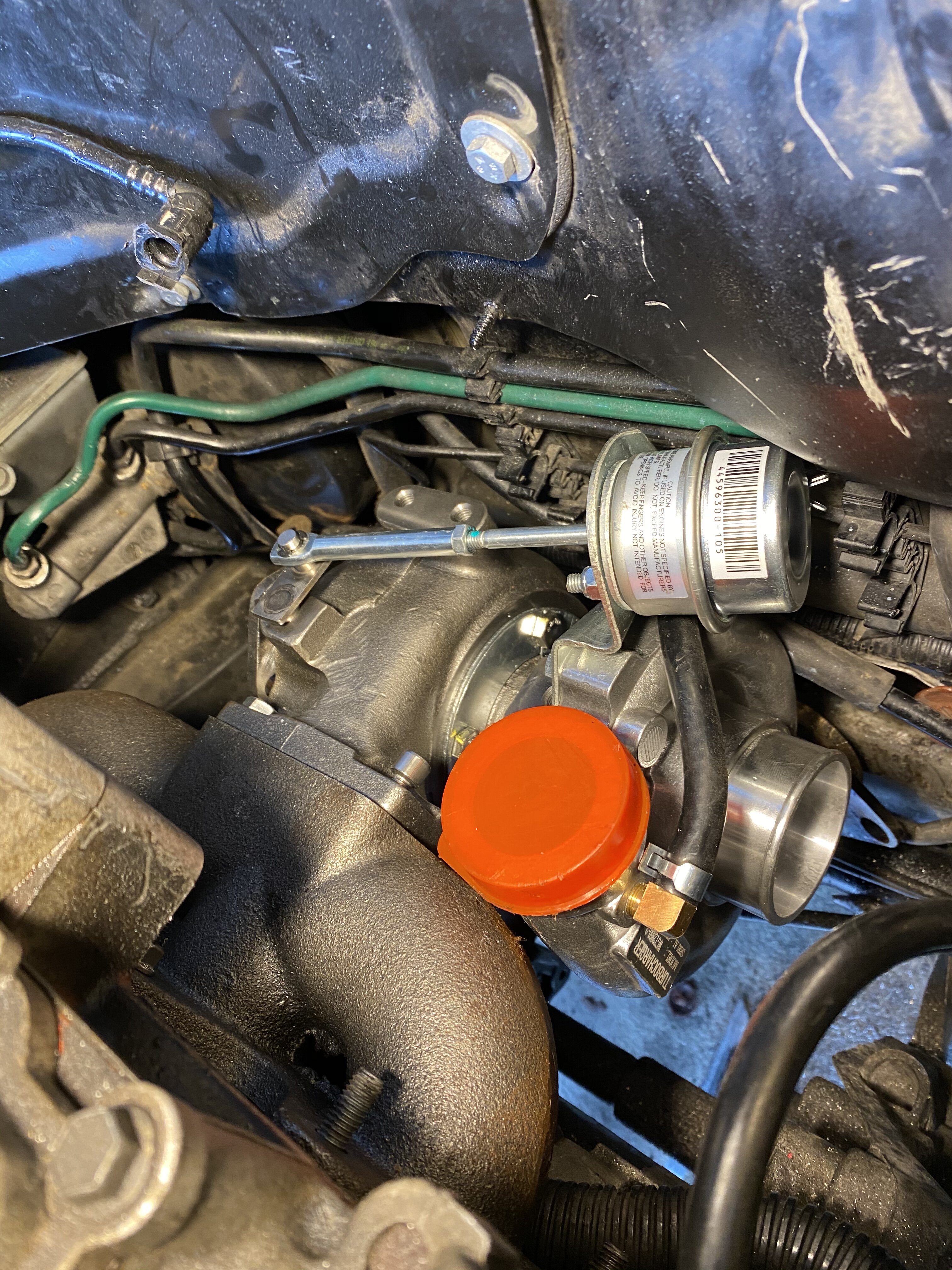

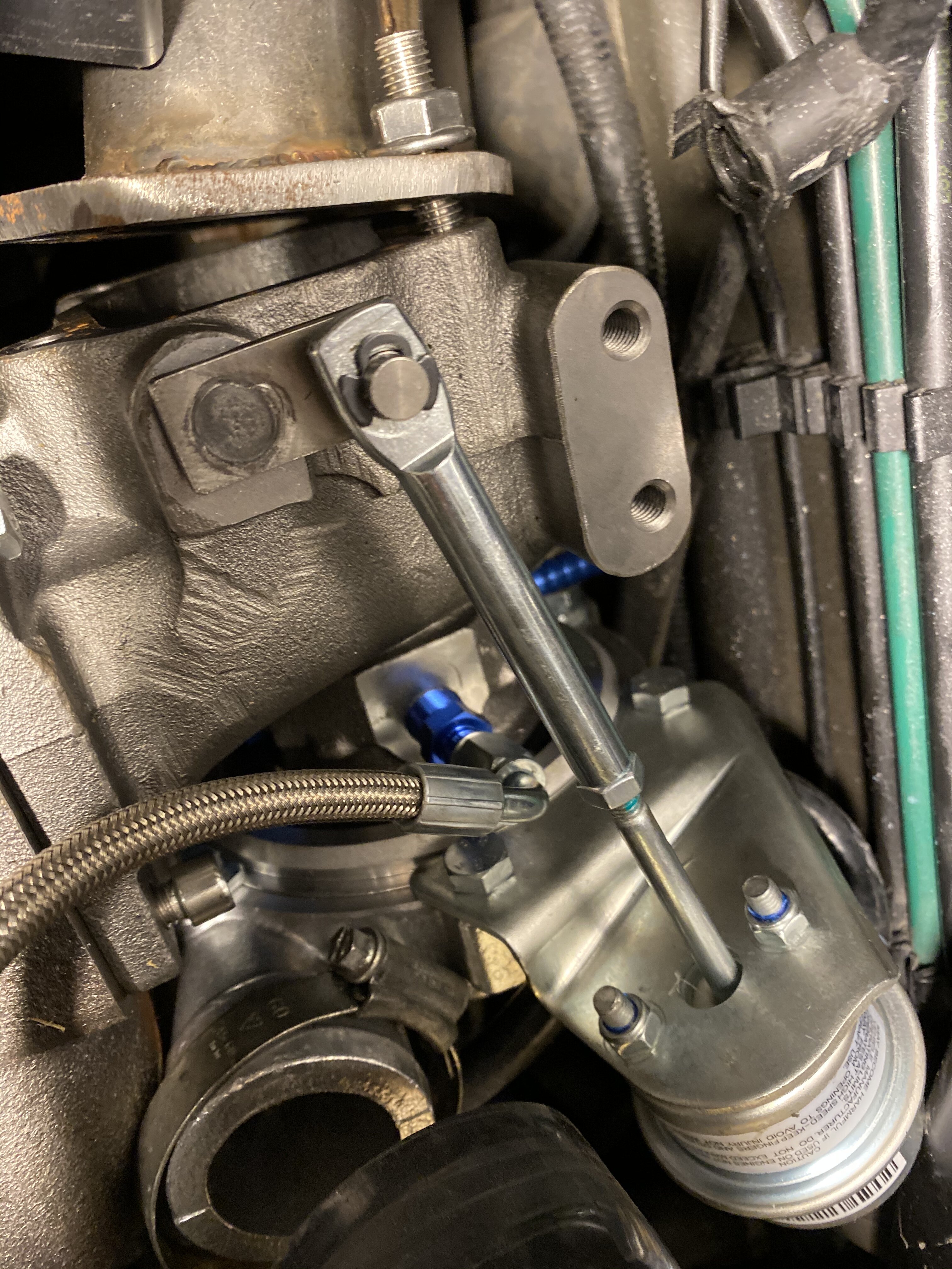

With that off I could trial fit the turbo. Jesus it’s tight back there!! The actuator is mega close so I’ll edit that bit of metal behind it with a hammer and it’ll be fine. Downpipe links up perfectly and heads away to the tunnel but looks like it might catch on some bit of the PAS. Couldn’t see what it was from above but it needs be I’ll live with it. It’ll all be heat wrapped so won’t be that bad down there.

yep, COVID isn’t China’s only export to Steve’s house this year. Ran one on my Astra for a bit after I went through 2 VXR turbos in the space of weeks and it was spot on. As long as you’re not aiming for 600bhp and loads of boost they work fine.
Also, the car hasn’t moved for 3 years. Don’t want to bring it back out and hate it having ploughed £900 into a Garrett turbo
Will you be mounting the intercooler under the crash bar? Should give you plenty of room for the bumper then.

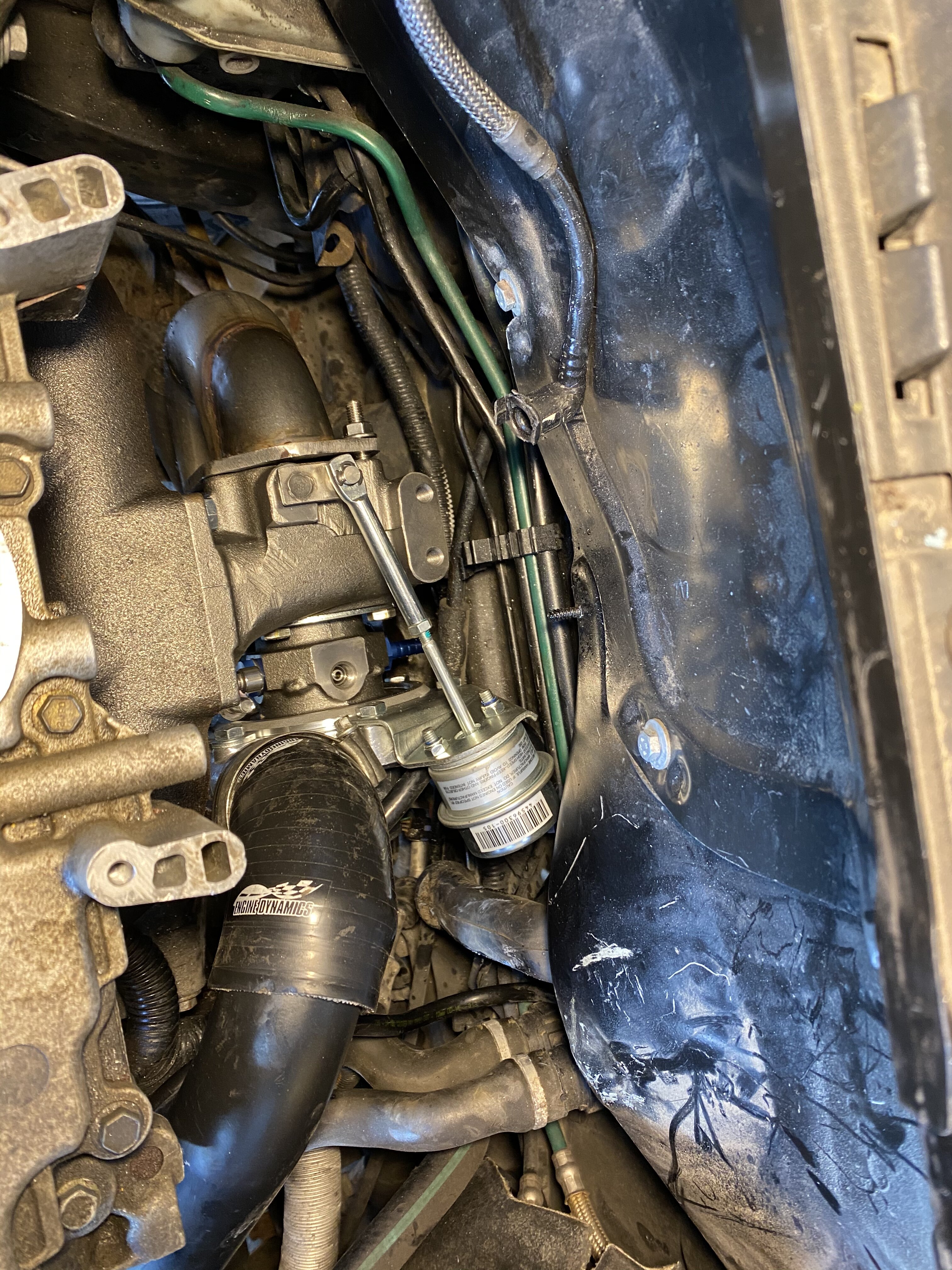

Yeah, I’ve dropped it back since the pic earlier when it was just cable tied on. The bumper goes on no bother now. It’s slightly off centre to make it work with the clamps etc but it’s about 15mm out so unless you measure it you’d never tell

That actuator is not ideal there, I’d modify the bracket or order something else.
Also did you manage to get the subframe bolts tightened back up?
It’ll be fine. I’ll just hammer the bulkhead back a bit and all will be well. The actuator can’t really move from there, the next notch takes it right over the middle of where the boost pipe goes. They never actually loosened, they just span so all seem tight still
Postie dropped a new(ish) working alternator off today so hopefully that’ll get rid of the issues the current one is causing where it’s drawing a voltage all the time, smells of fire and makes the car cut out when its connected. I’ll get that on this week at some point with a new belt. Also been looking at my 225 injectors and they appear to be non-genuine. They have no deka logo and matching serial numbers. They are brand new so I’ll fit them anyway and check egts when it’s running to see if they are doing what they should. If not I’ll source a genuine set

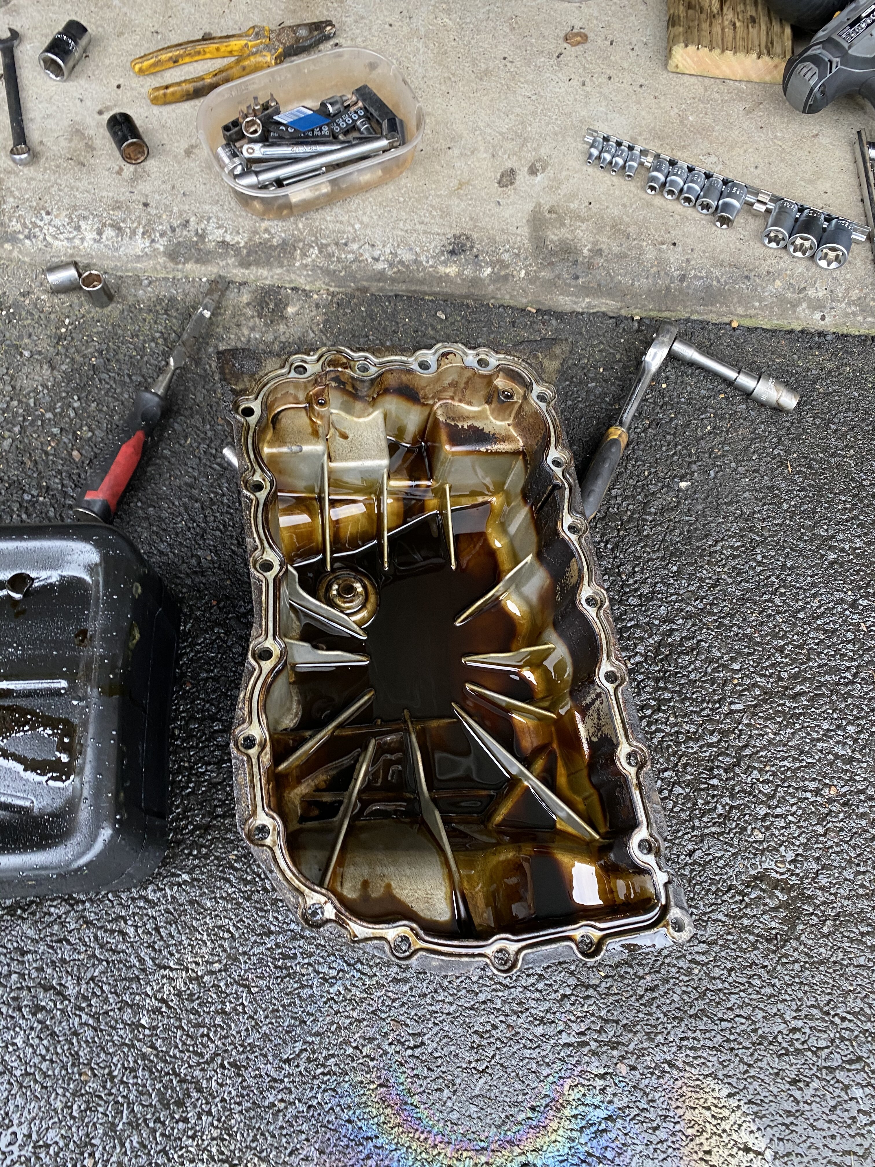

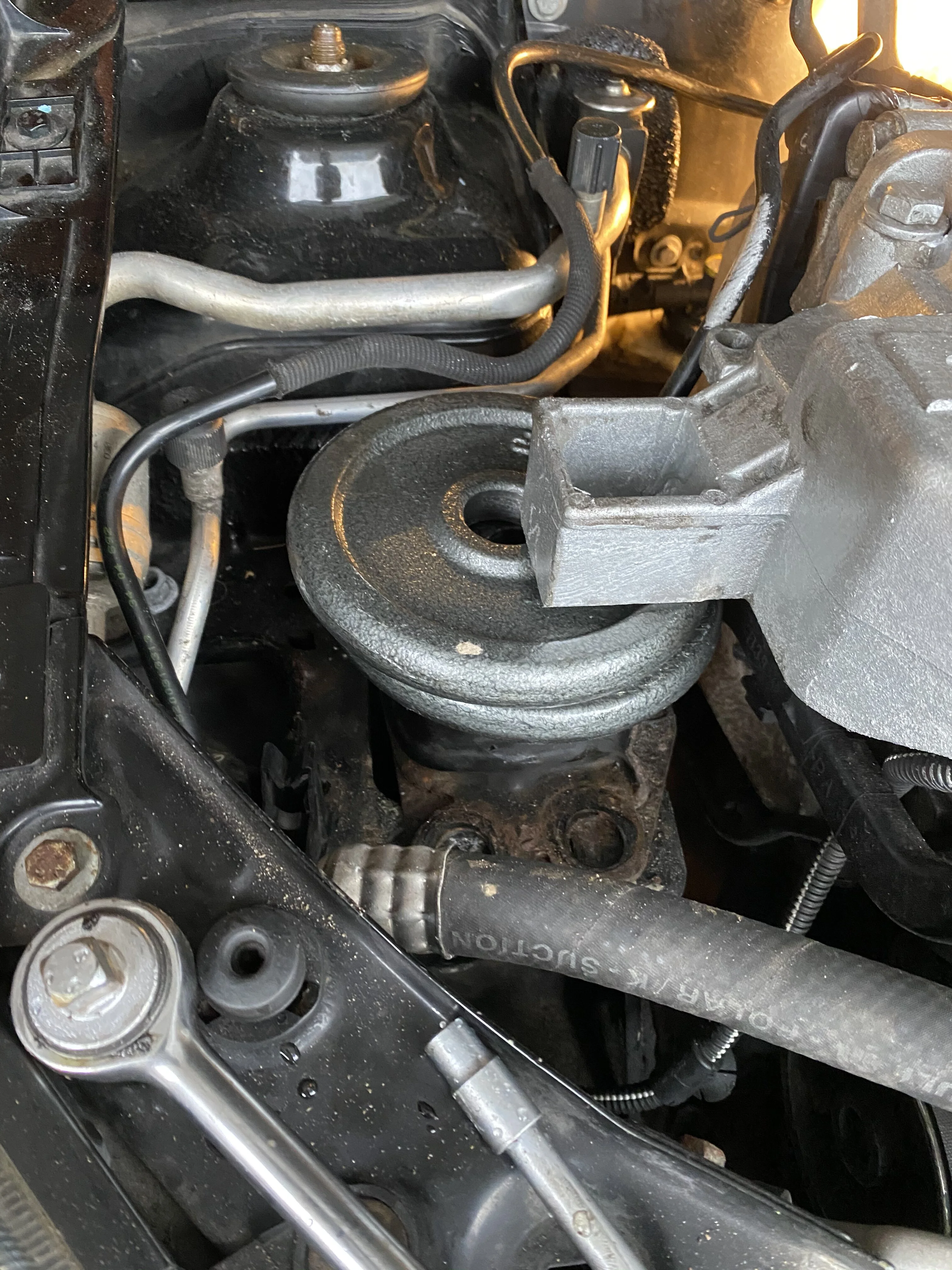

No pic update today. Started to get the sump off. Removed the top engine mount, dog bone and box mount and jacked the engine up as far as it would go. Got all the accessible bolts out bar one which drilled out pretty easily. I need a E8 on a 1/4 drive as my 3/8 was too fat for the holes on the box side so that stopped play. In the meantime I’ve clocked the turbo again slightly to get a bit more space for the coolant lines and the actuator now sits slightly further away from the bulkhead. The downpipe is still very very close to the pas setup but there’s not really anything else I can do about that given the hot side is fixed in place in relation to the manifold. Just gonna have to heat wrap it to death and hope for the best. Last bit was a lick of paint on the rocker cover and some paint on the inlet manifold. Was going to go the Rover grey that pretty much matches the wheels but the wife liked the colour of the yellowish filler primer so may end up going something along those lines instead. I’d half hoped to make it look almost factory in the bay but given she’s not complaining I’ll probably go yellow 😂. More on Wednesday when I’ve got a half day

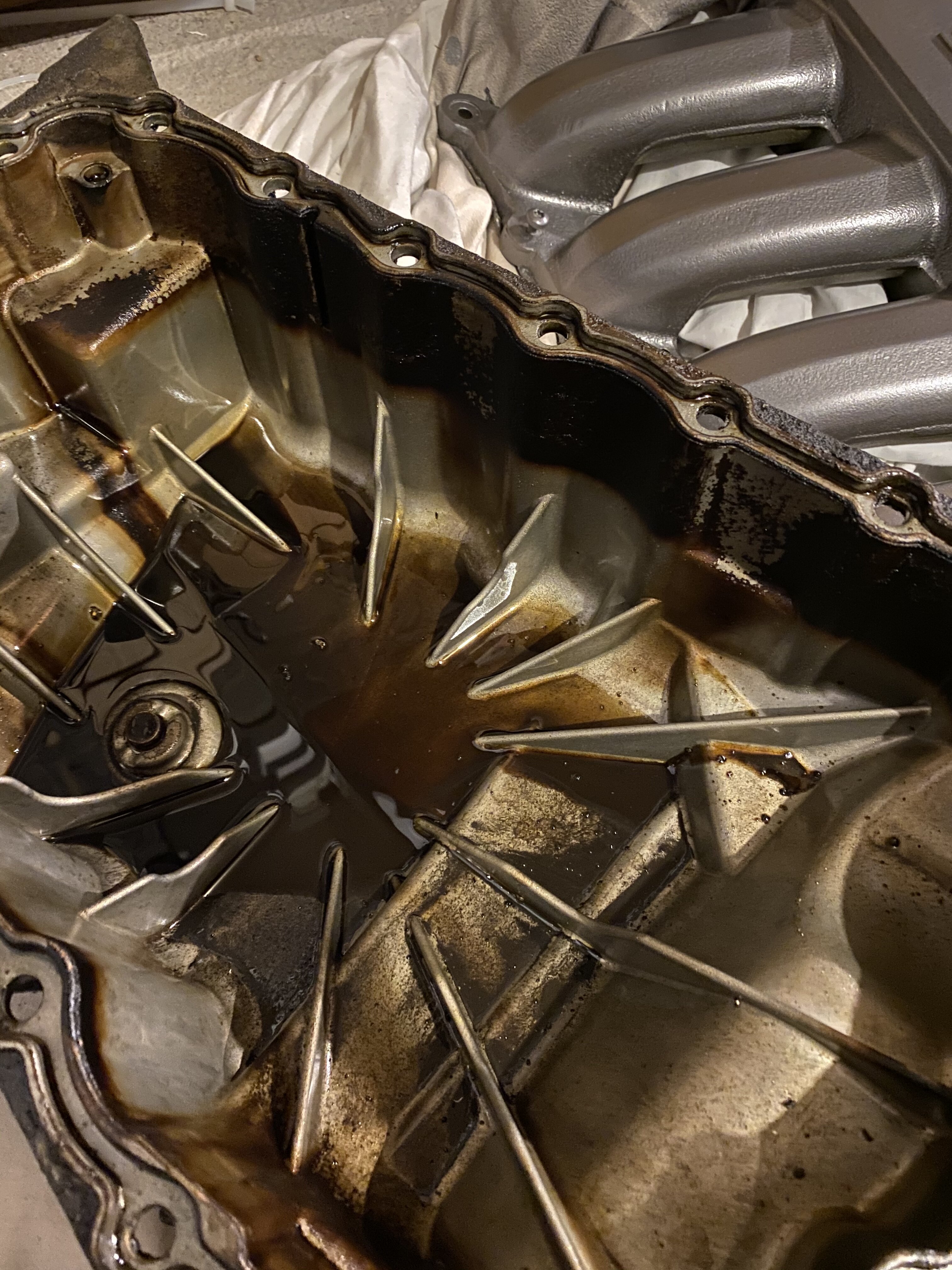

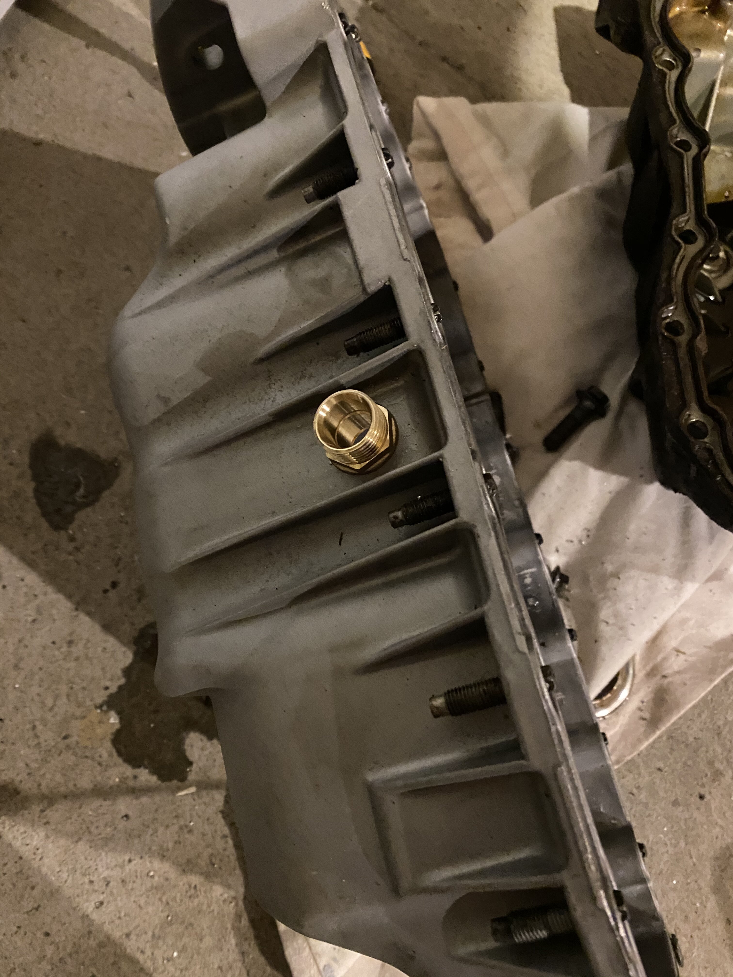

Bit more done today. My 1/4” drive eTorx rocked up so got the sump off. Jacked the engine up and chocked it. May have improvised a bit with a couple of the wife’s parasol weights 👌
Sump came off fairly easily once it was up and the last of the bolts were out. Minging job, got s**t everywhere but needs must. Got the new sump tapped with a 1/2” thread for the return so I’ll get that back on at the weekend. Also

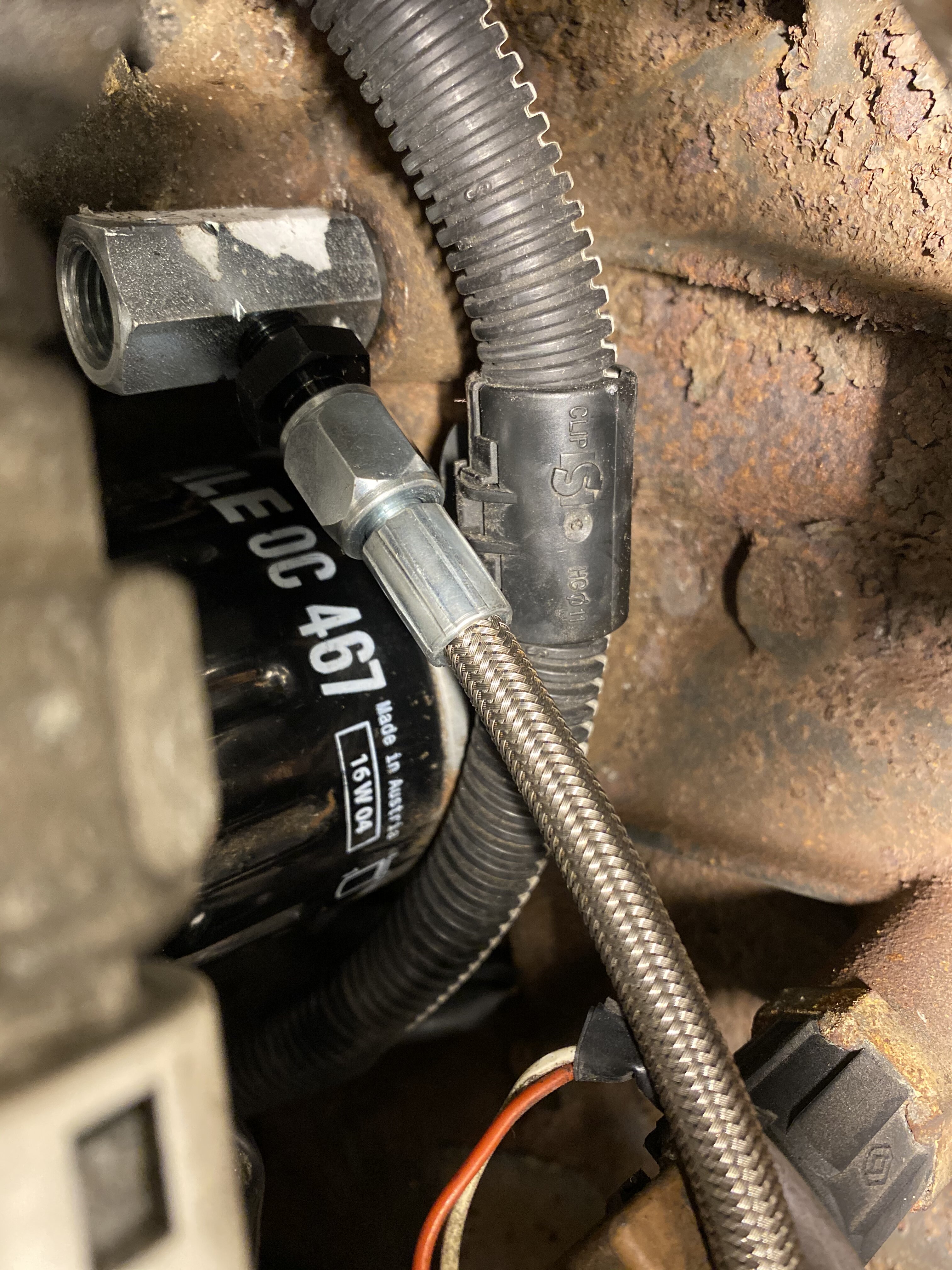

Finally managed to find an oil feed for the china special corona turbo. Bought basically 1 of everything I could find in a 1/4” thread and one of the 6 in the packet worked. Handily as they weren’t labelled I’ve got no idea which one it was. T is m14 in/out for the oil sensor with a 1/8”npt to 4an for the oil hose. That then goes to a 4an to some random 1/4” thing at the turbo end. The hose length actually makes for quite a neat routing and fitment
I’d also painted the inlet over the weekend so plonked that on the top to see what It looked like. Have to say I’m pretty happy. Gonna do the letters black and spray the boost pipes the the same colour with black bends

I forgot to share the oil return the other day. I’ve tapped it into the sump. I know a lot of people say to use that flat bit on the block but given the engine is in situ that wasn’t a feasible option. Tapping a sump on a bench is a much easier job. You can see the oily tide mark on the old sump where the oil level sits so the rerun sits miles above that. I’ve also finally sourced the illusive phase 1 fuel rail and regulator. It’s coming with fuel lines too but I don’t really like them running behind the turbo so will probably stick with my original plan and make my own running down the box side and under

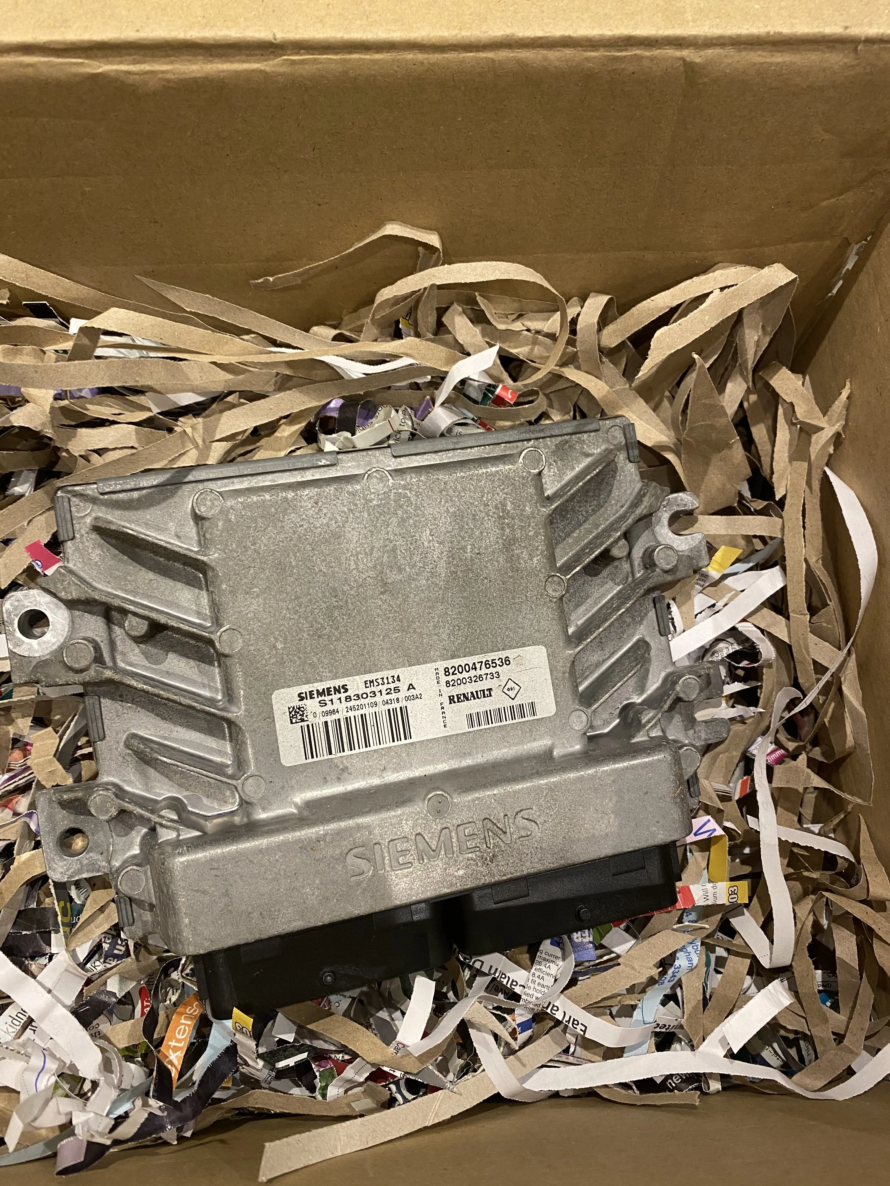

Today I’ve whipped the ecu out and sent it off on its holiday to EFI Parts. It’ll come back mapped and with their boost control kit sometime soon

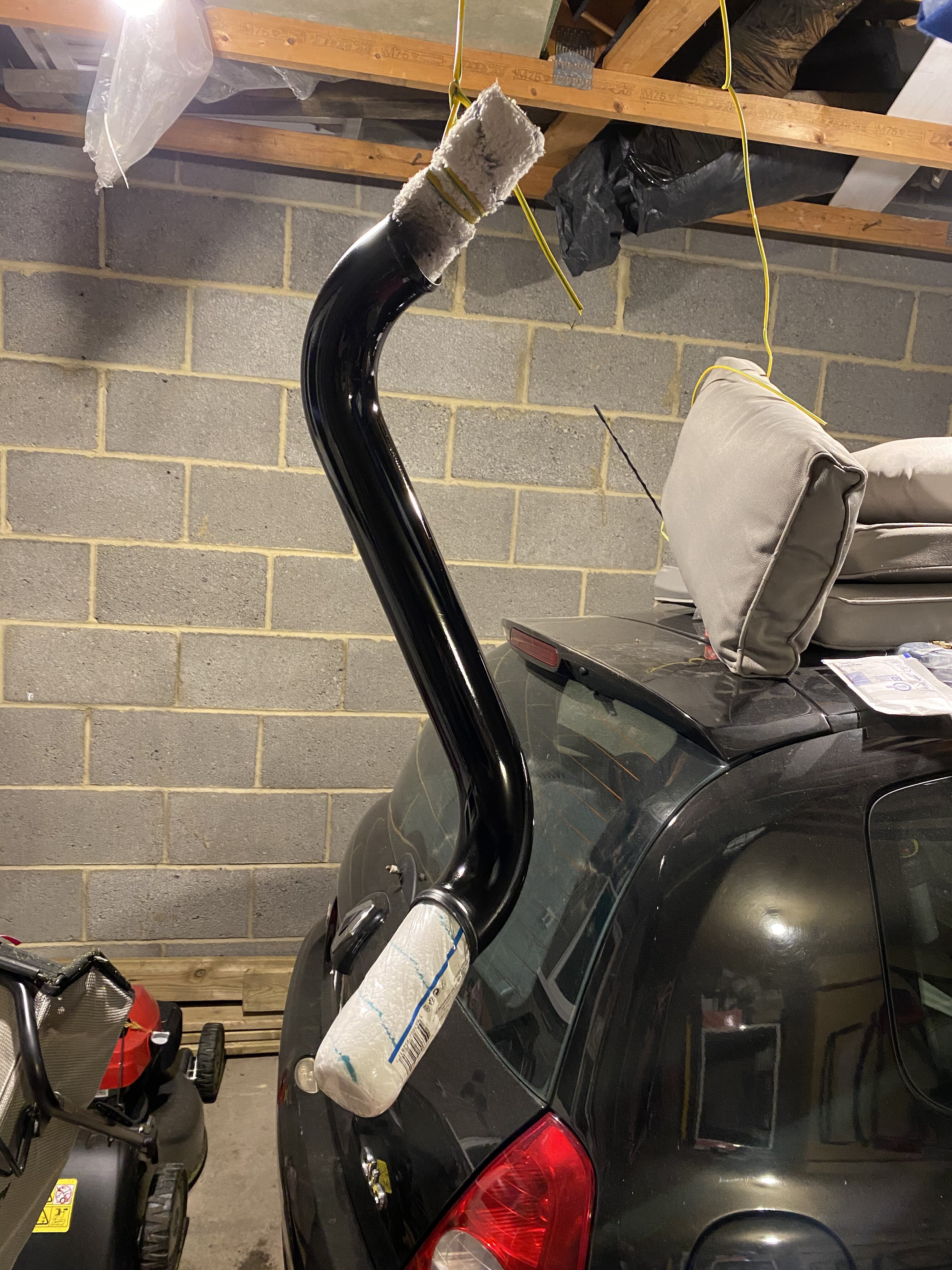

also started painting boost pipes. Can’t decide whether to go gloss black or grey as per inlet so done one of each. Always end up having to get a bit imaginative when drying them haha!
