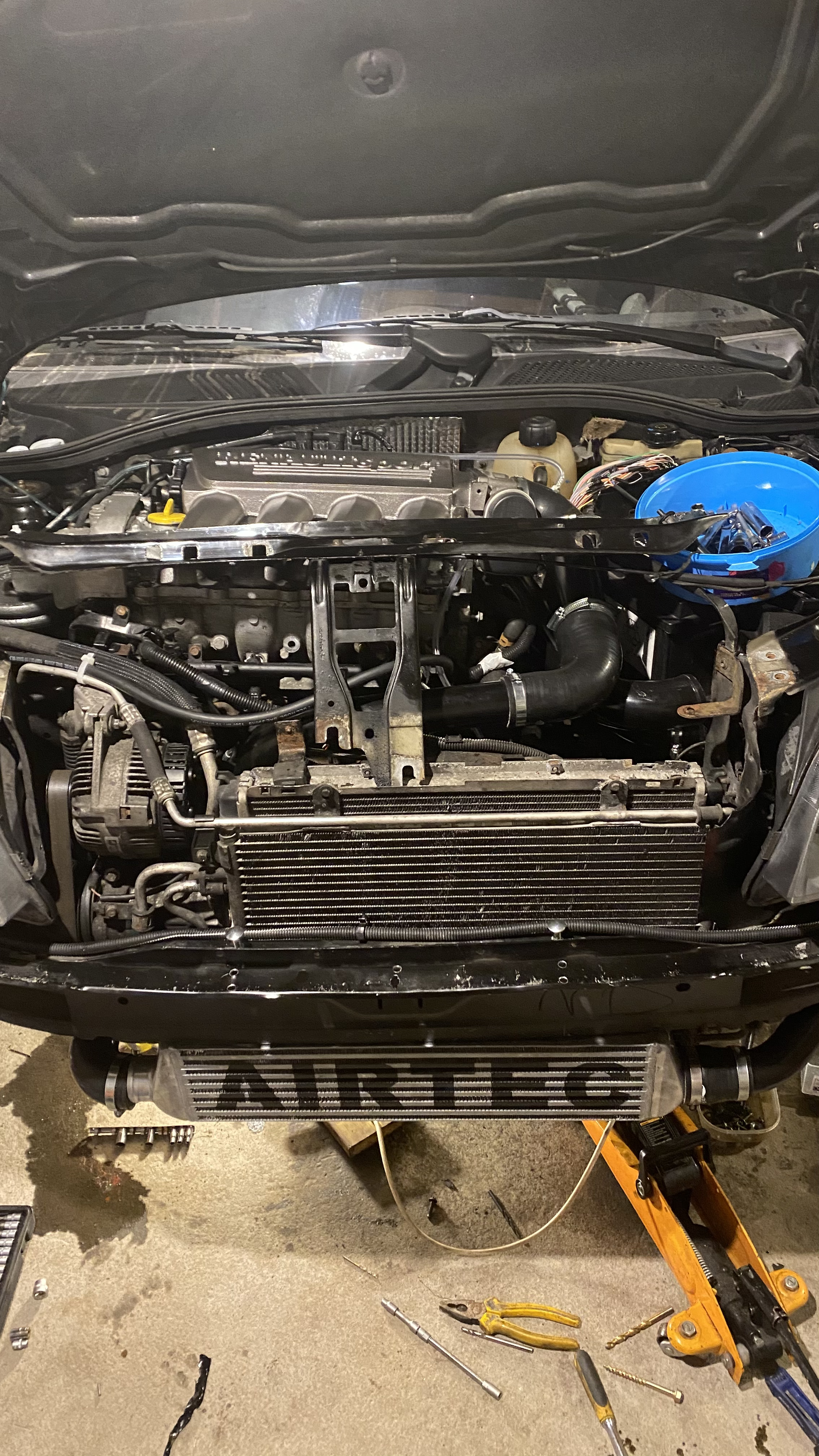

Busy again today. Seems like 1 step forward and 2 back some days šŸ¤¦ā€ā™‚ļø. Front end off again. Iā€™d got all but one of the sump bolts out. One rounded going back in so knew it was going to be a ball ache should it ever have to come off again. It didnā€™t disappoint lol

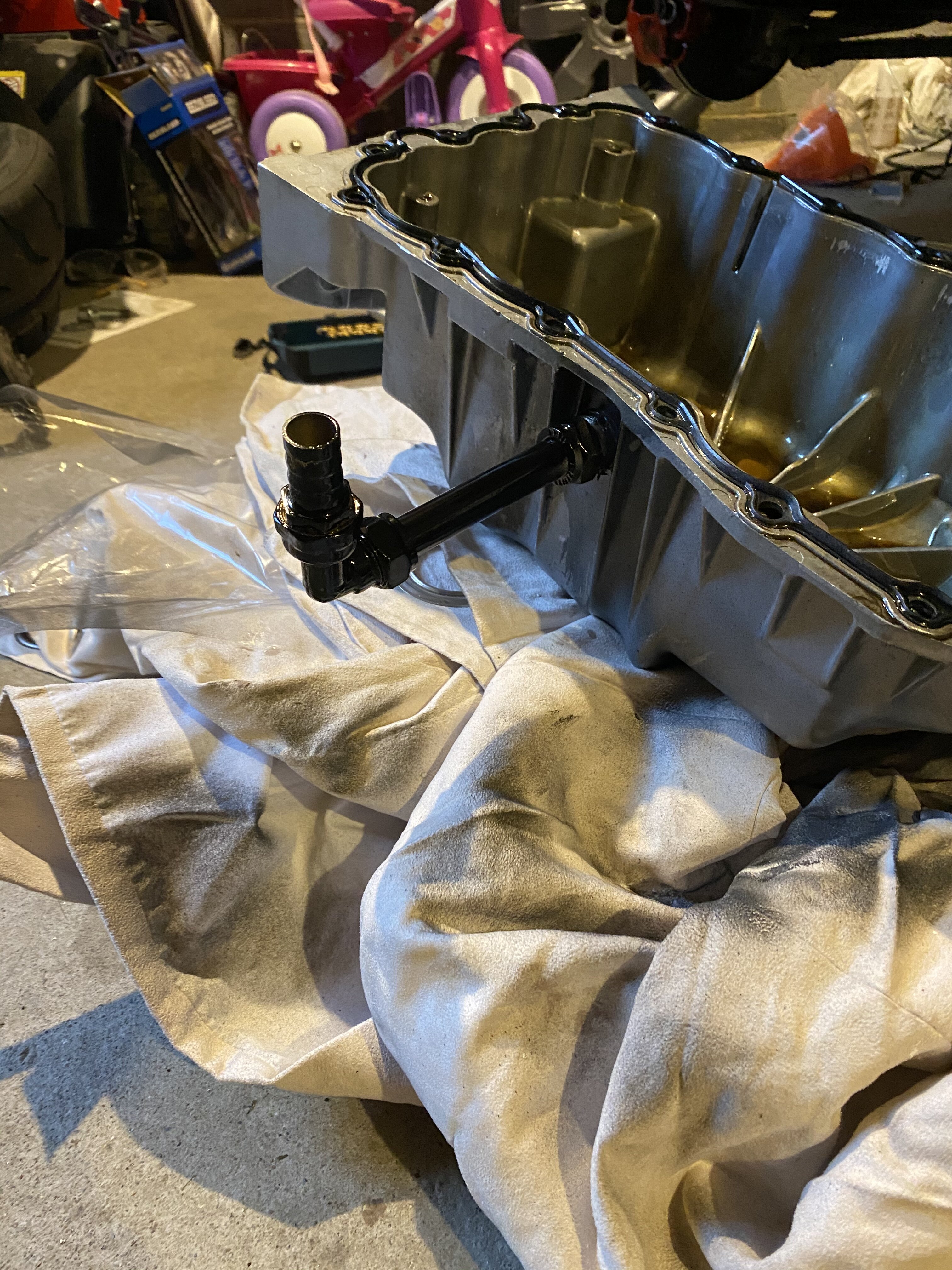

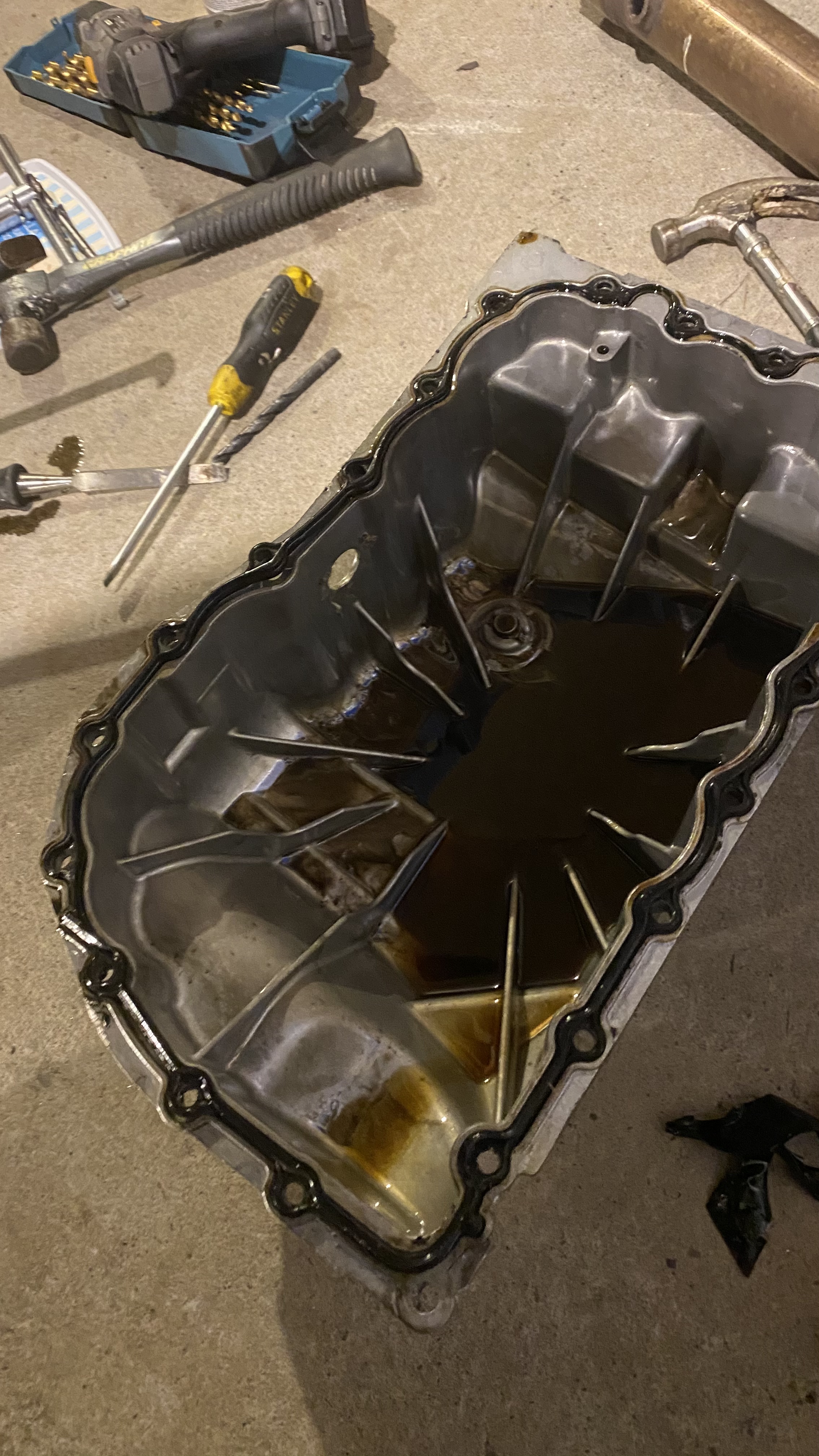

Got that drilled out fairly quickly and the sump off. Turns out Iā€™d just done a shite job of the return. No idea how/why but the whole lot was only finger tight. Iā€™ve tightened it all up and put new seals in and filled the sump with old oil to leak test it. Iā€™ll leave it overnight and see how that goes. Photo of said sump below:

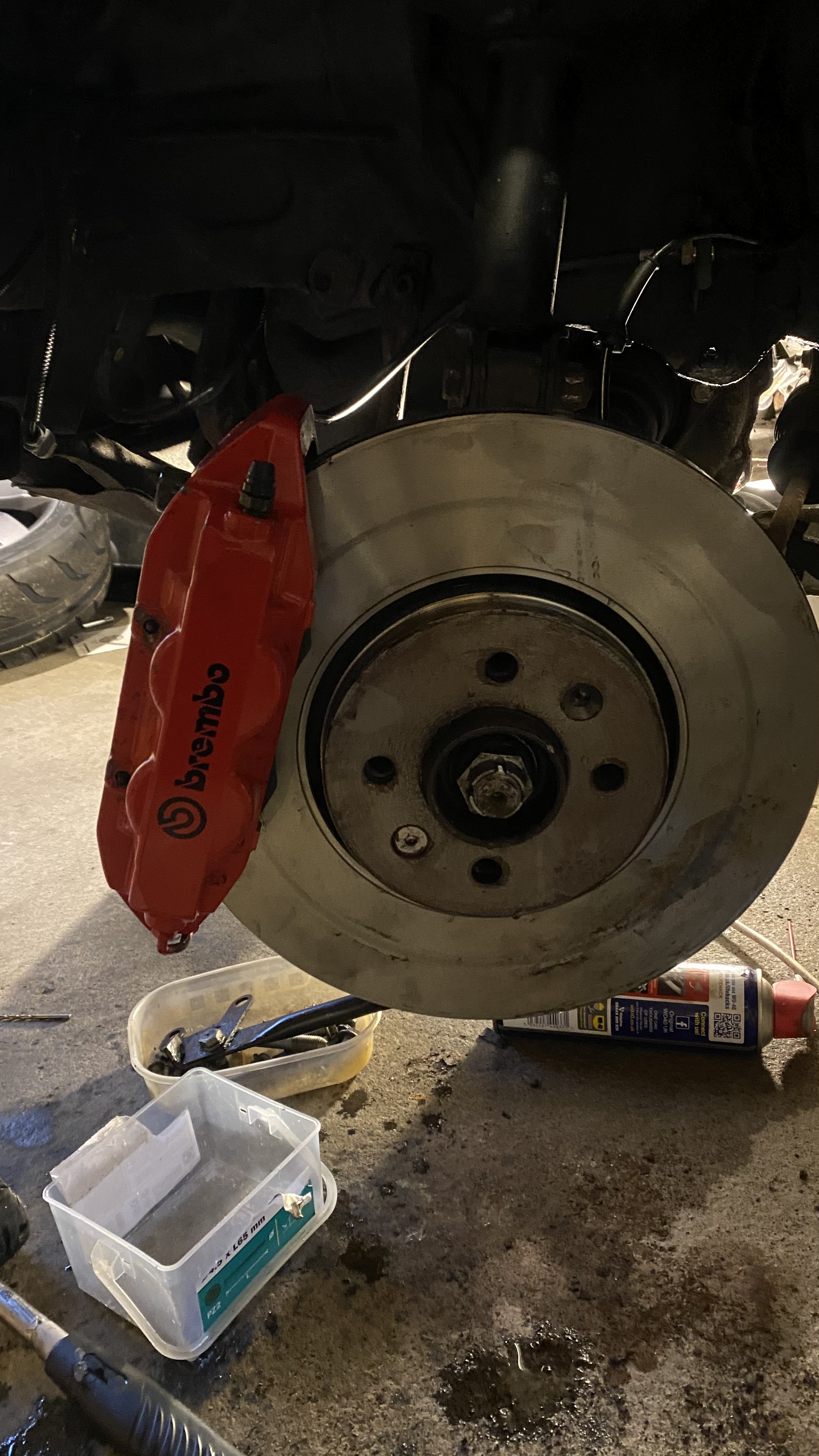

Then last up was my other schoolboy error... put the brembos on the right way round and bled them again. Had a little splutter of air and the pedal is now rock hard. Seems to have done the trick so well happy with that. Thanks for the help on that one šŸ˜Š
last question for today... are the sump bolts M7? They are total shite and no doubt itā€™ll have to come off again so Iā€™d prefer to use some normal bolts rather than the E8s. Plus they are 3 quid each which blows my mind. Can anyone confirm the size or have a link where I can get some alternatives?

They are M7 bolts. You can find on ebay some titanium ones with "normal" hexagonal head. But I cannot anymore find them.
I use anti seize on them and torque to 17nm at most

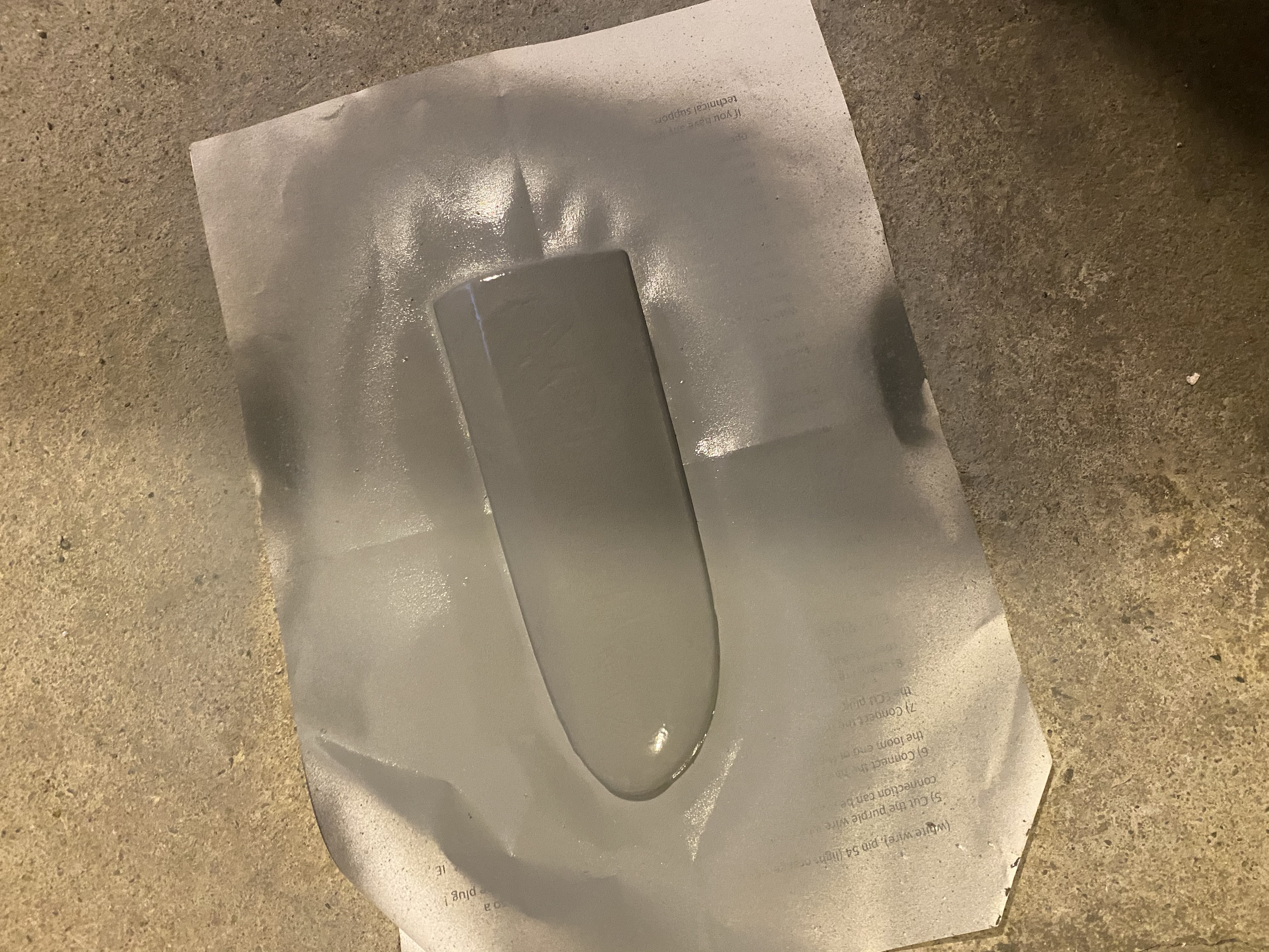

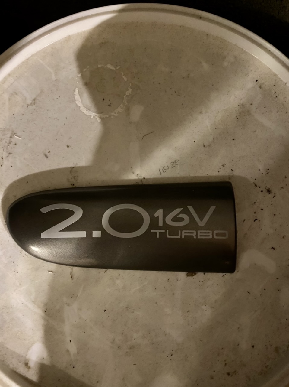

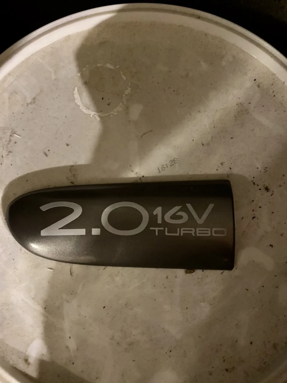

Iā€™ve got some stickers ordered and hoping the end result will be something like this.

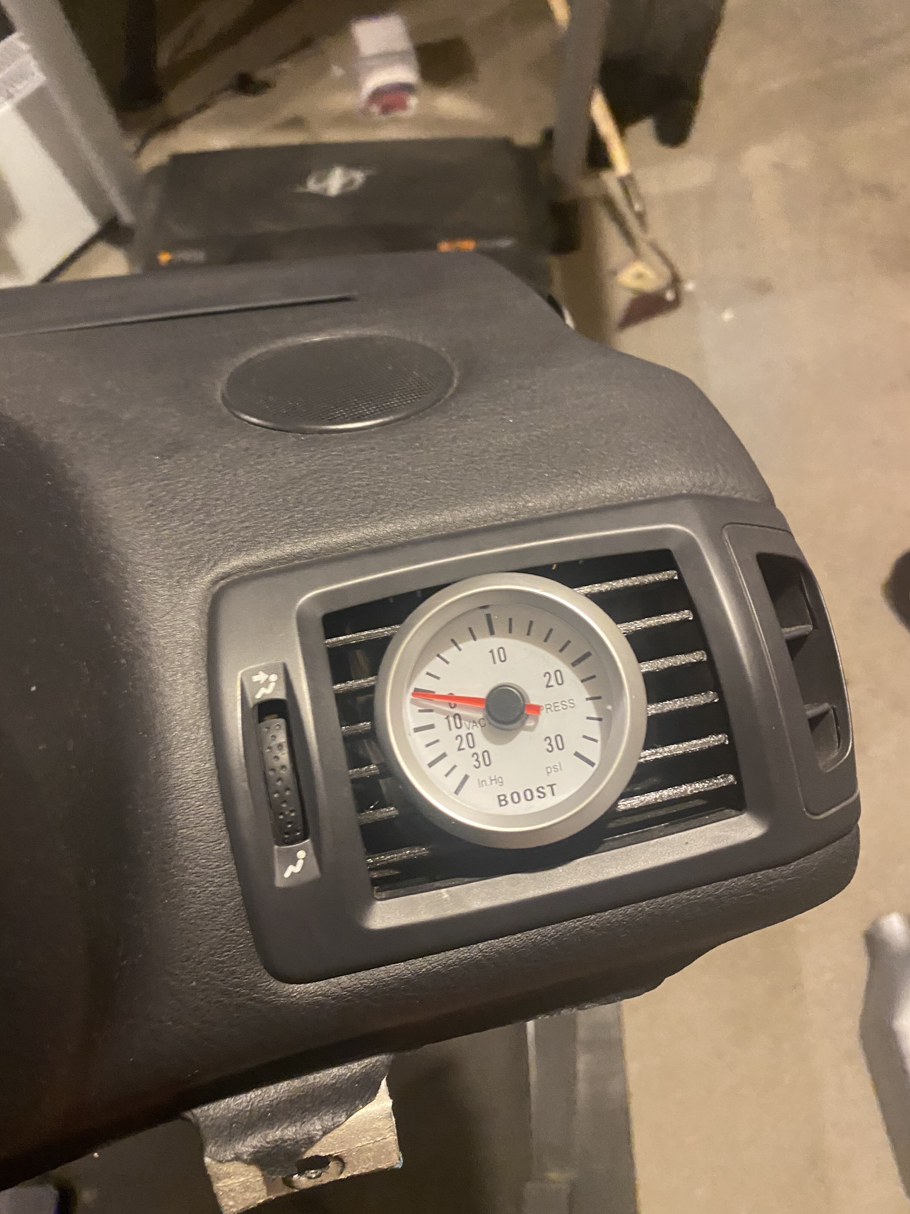

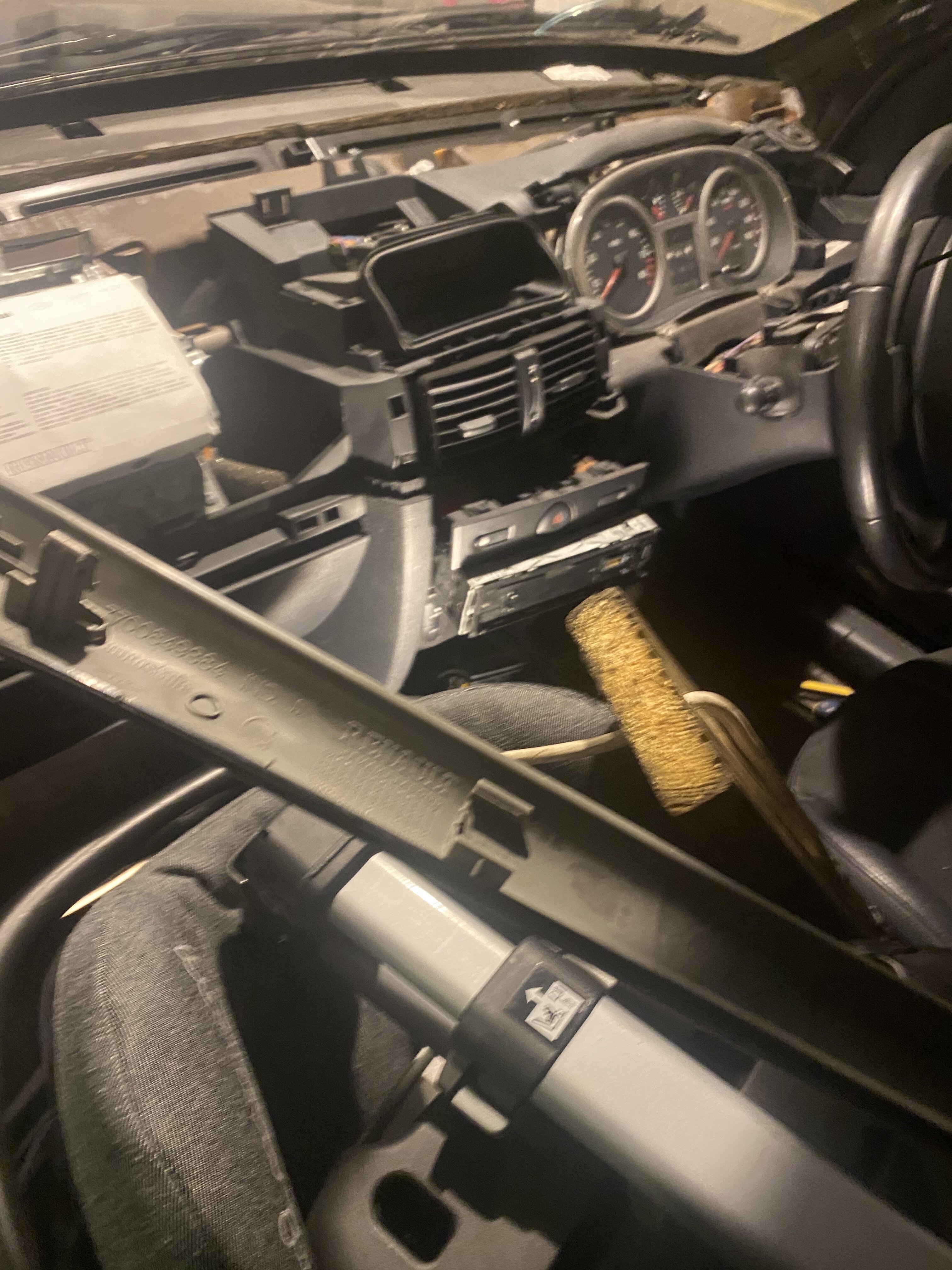

Next in line was the boost gauge. Whipped the dash top off

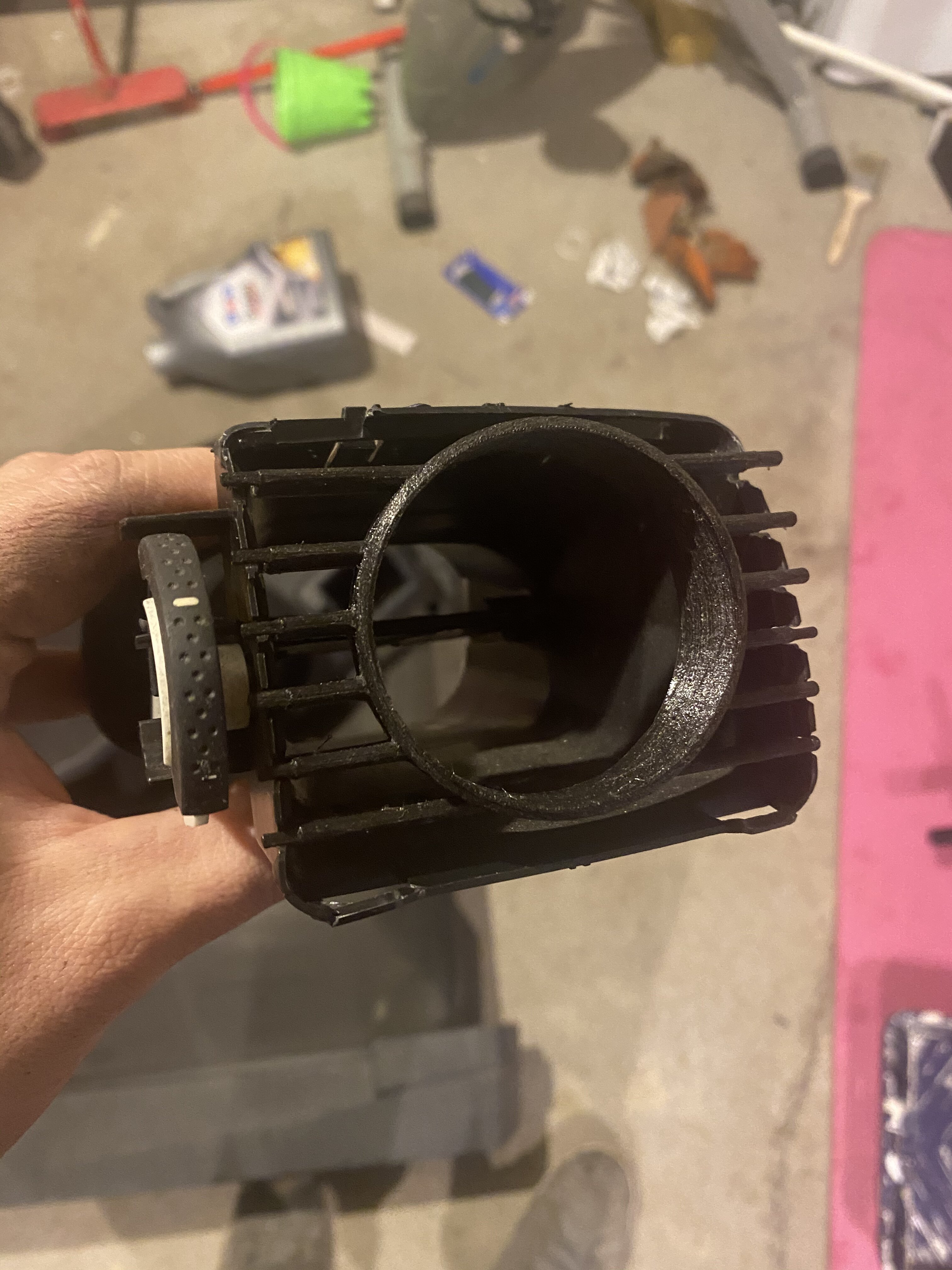

Popped the drivers side vent out and put the 3D printed slats in
Then fitted the gauge. Just need to find somewhere to bring the boost feed through then I can get the dash top back on

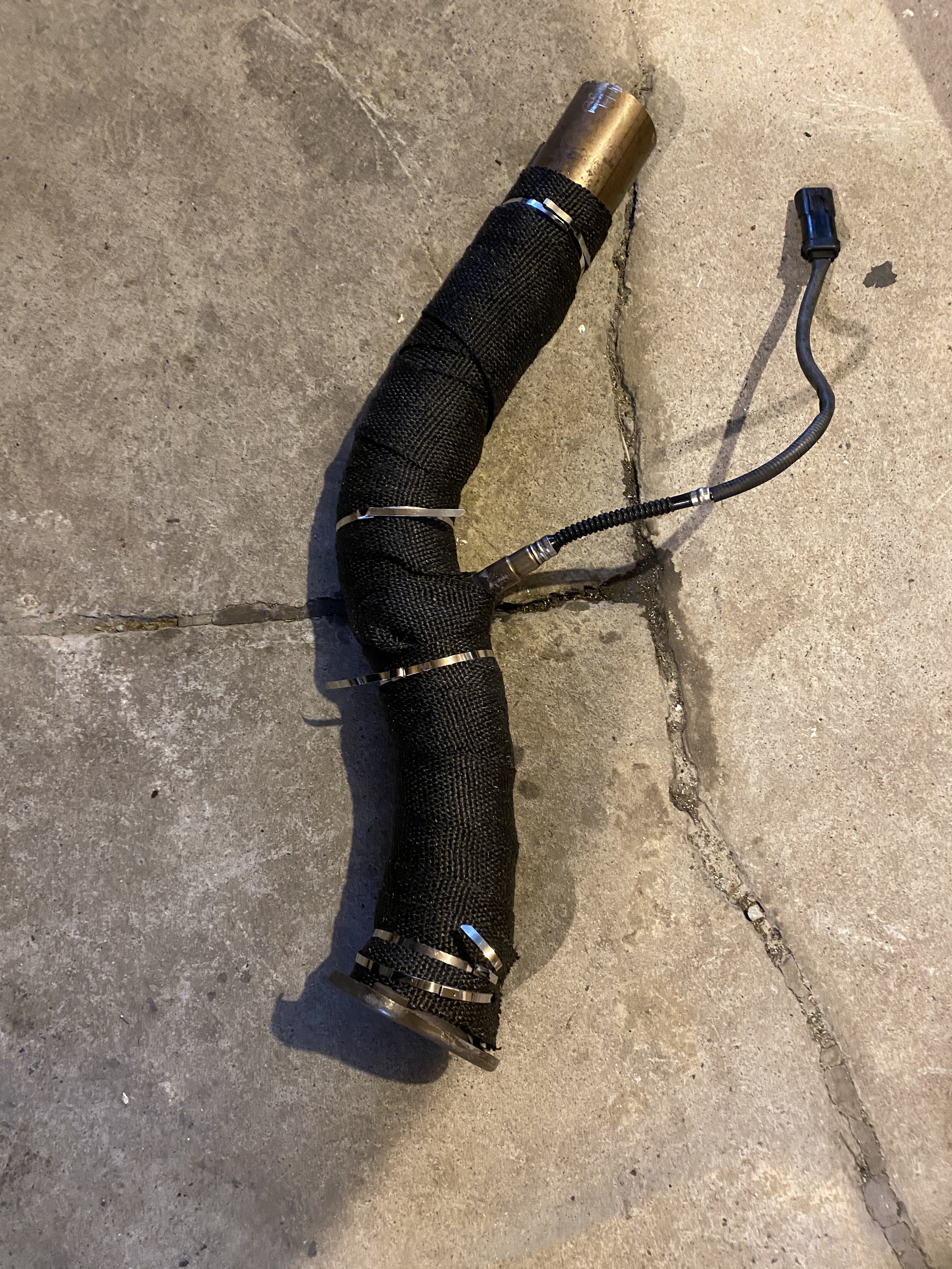

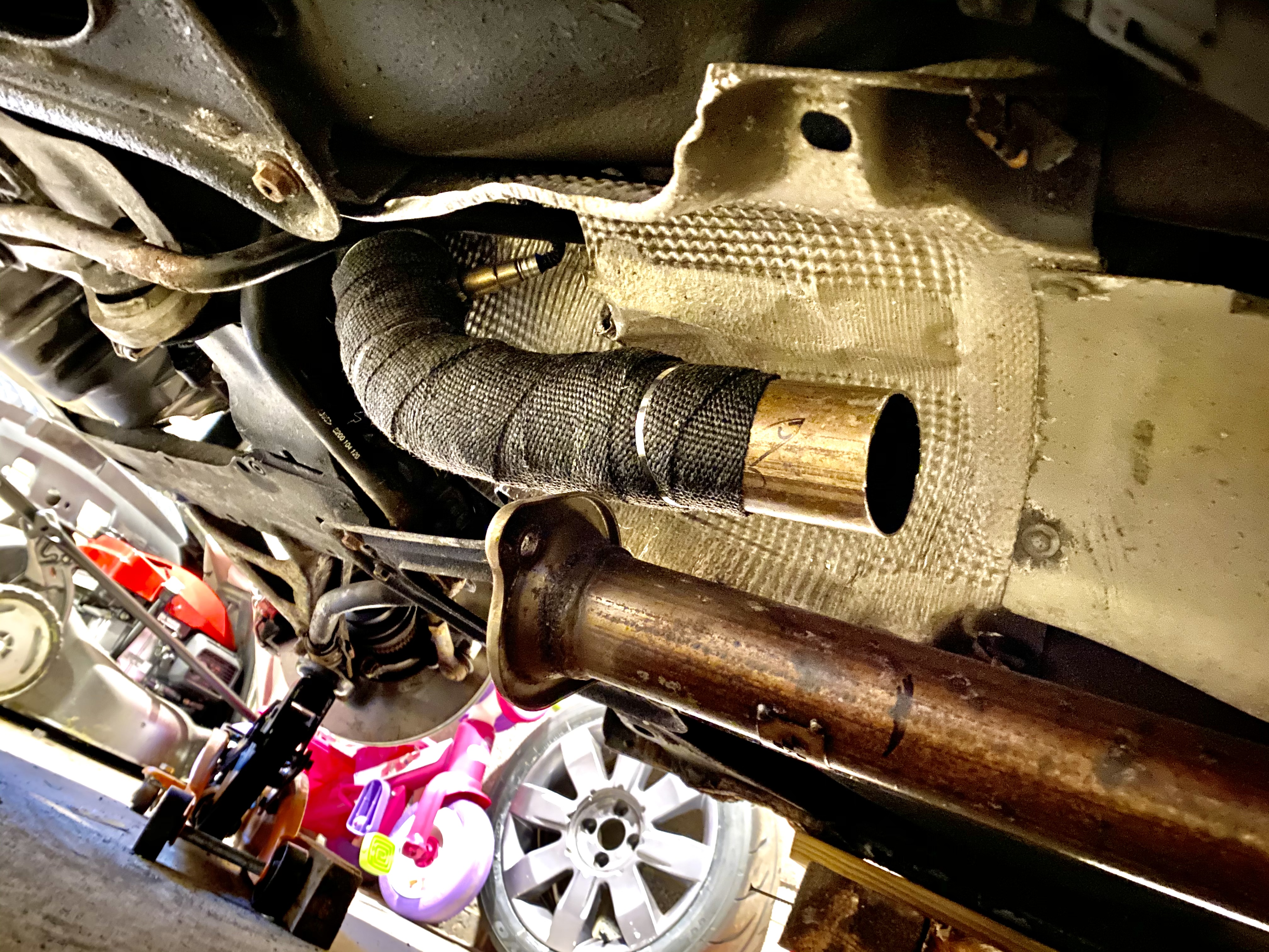

My exhaust fittings arrived today so got cracking. Started off by heat wrapping the adapted 172 decat
Then got it lined up and tightened. What an absolute ball ache of a job it was to get the bolts and springs all on. Not sure what awkward french bloke came up with the design but if the threads were literally 5mm longer or the flange an inch or so in each direction it would be so much easier. After much swearing I finally got them on. Then getting anything on to tighten them was another challenge. Got there in the end and they seem tight enough but Iā€™m sure Iā€™ll find out when I start it. Itā€™s now sat nicely in place. Just need to chop the 182 down to match and then stick the sleeve over and jobs a gudn

Last bit for today was rebuilding. Got all the boost pipes back on and lined up, the ecu back in place and plugged in. Then refitted the slam panel and front bumper. All the fluids are now in so gonna leave it up in the air tonight and check for leaks in the morning. Hopefully all is well. This is where it was left to tonight... the end is very close

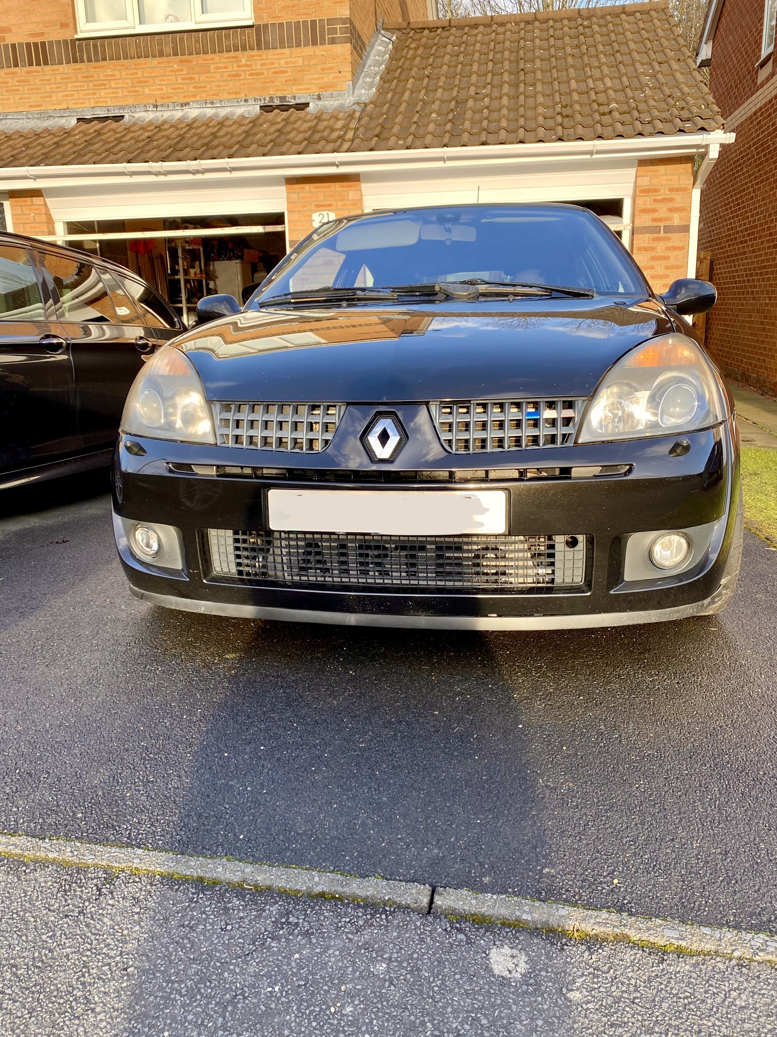

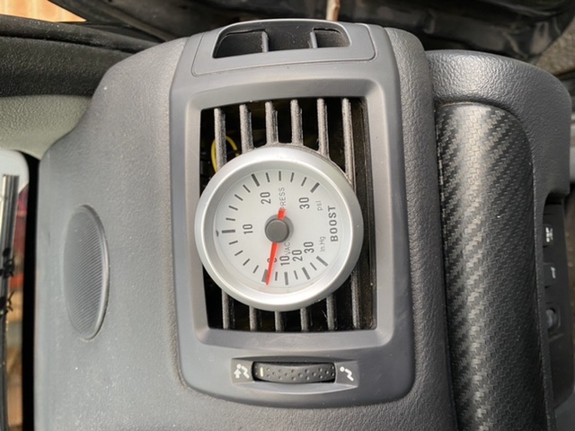

  Clio 182, E46 M3
Found the key!!

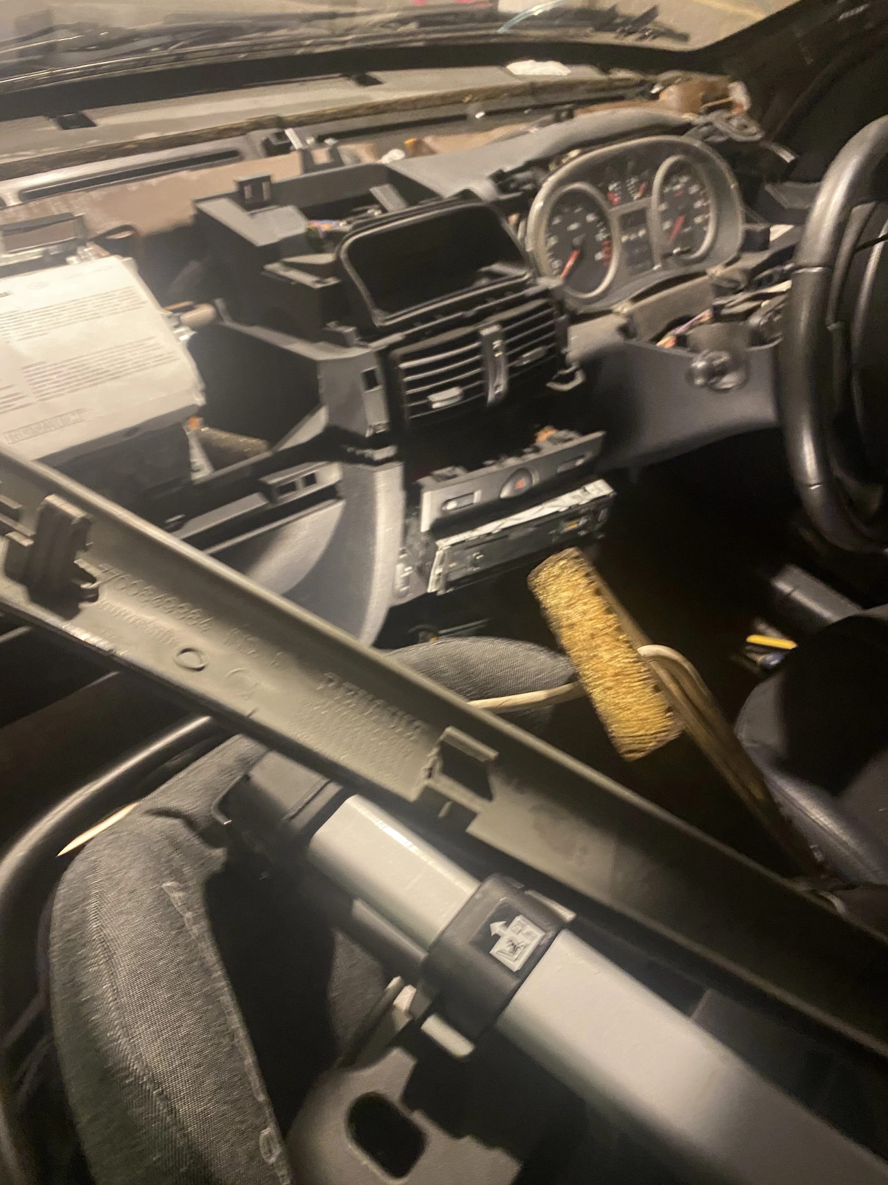

got it out onto the drive so I could properly open both doors to get the dash top back on. Ran the line for the boost gauge through the grommet under the pas bottle. Doesnā€™t look too bad I suppose

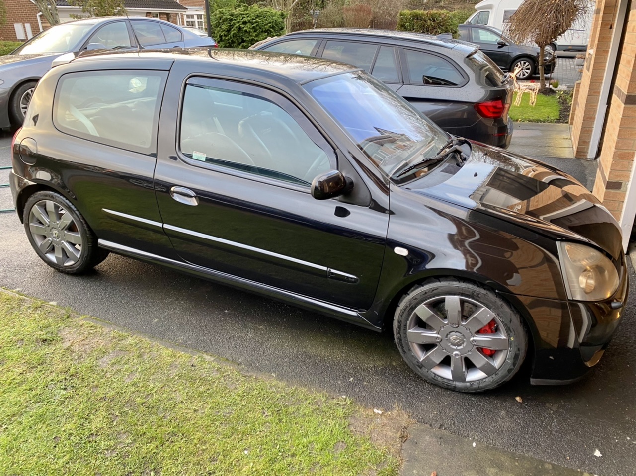

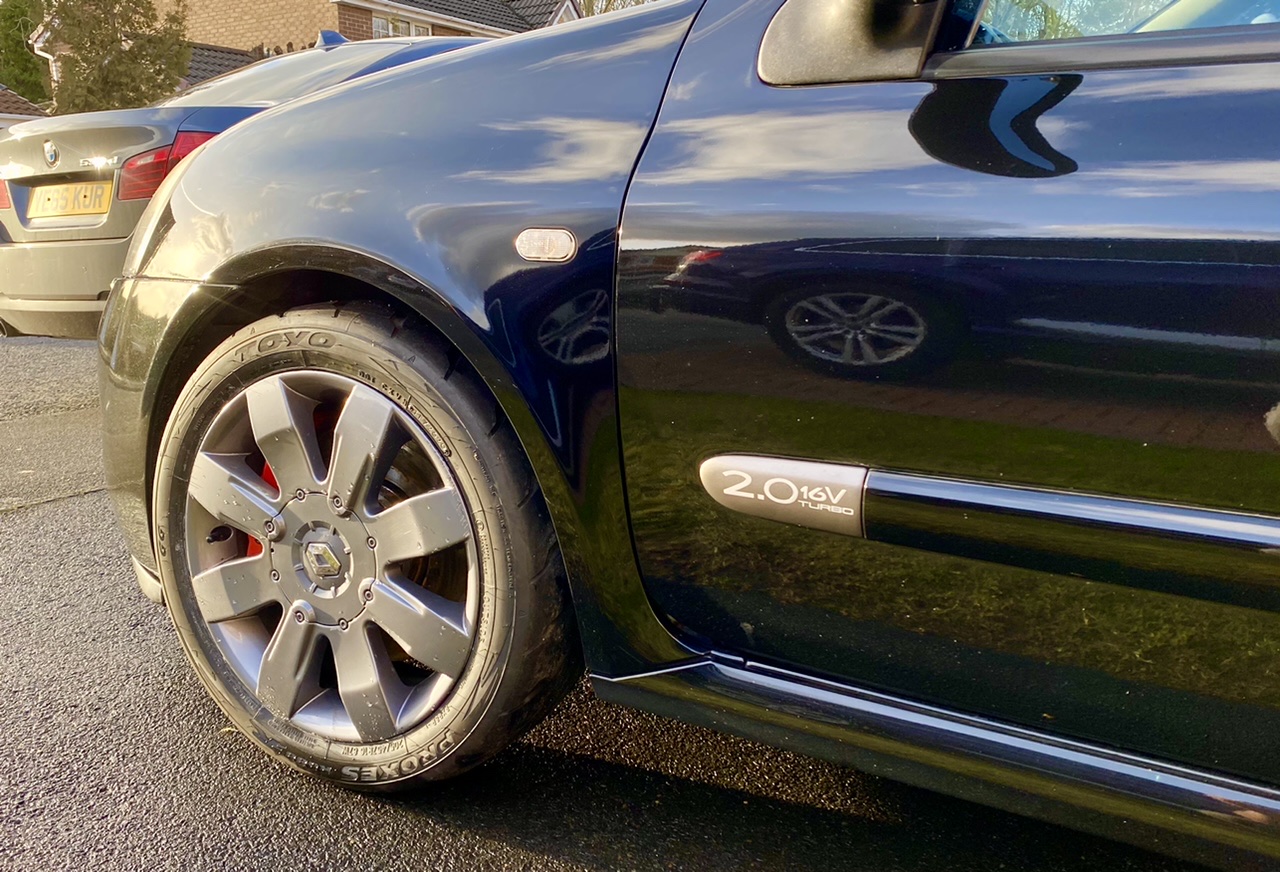

I then gave it a quick wash and it came up brilliantly. The front bumper is a bit stone chipped and could do with some paint at some point but aside from that itā€™s pretty good

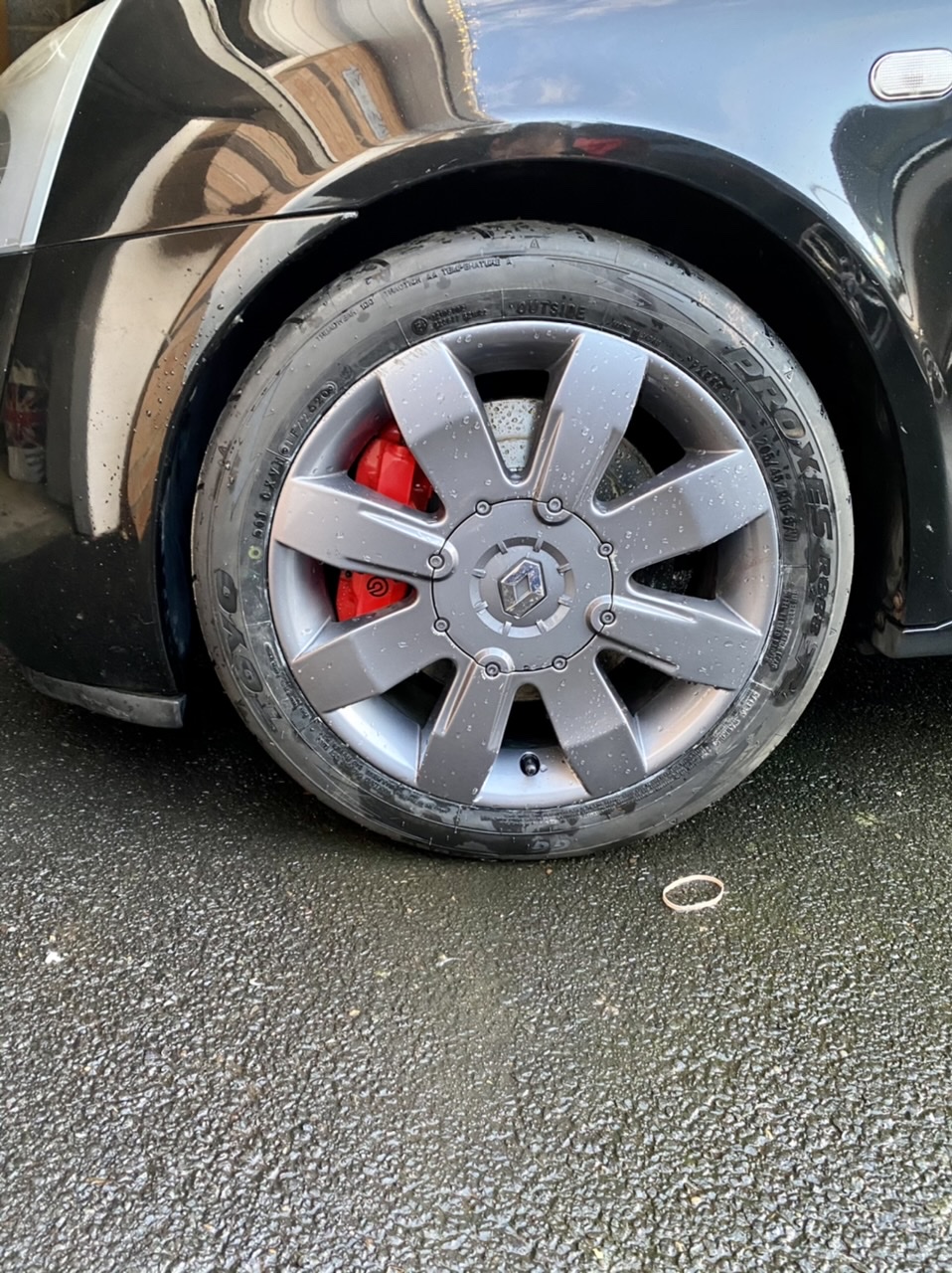

and the brakes look massive under the wheels šŸ˜Š

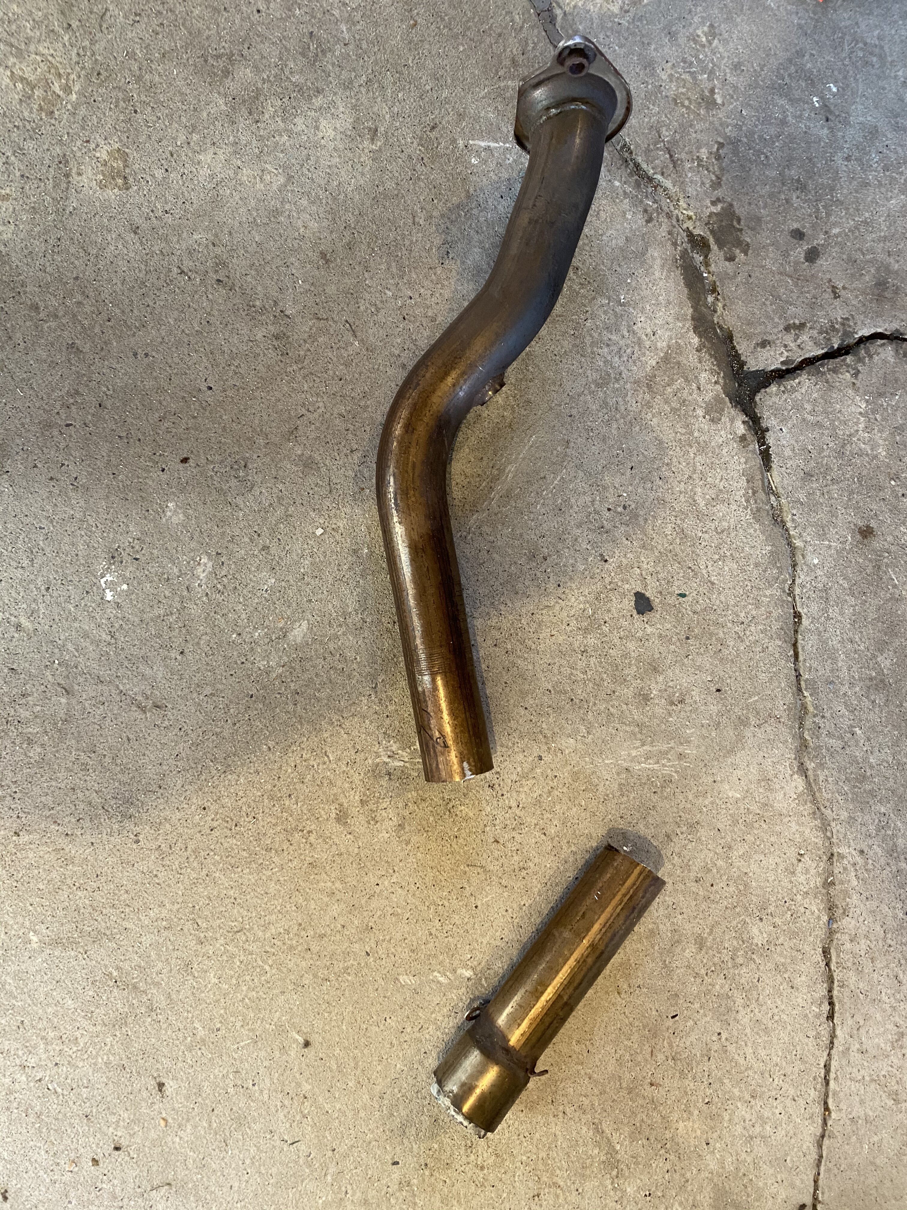

The exhaust needs some TLC as Iā€™ve knocked it off the back hangers. Tried to sort that today but snapped my 1/4ā€ to 3/8ā€ adapter trying to take the mounts off so that stopped that fun. A cable tie did the job well enough for now.

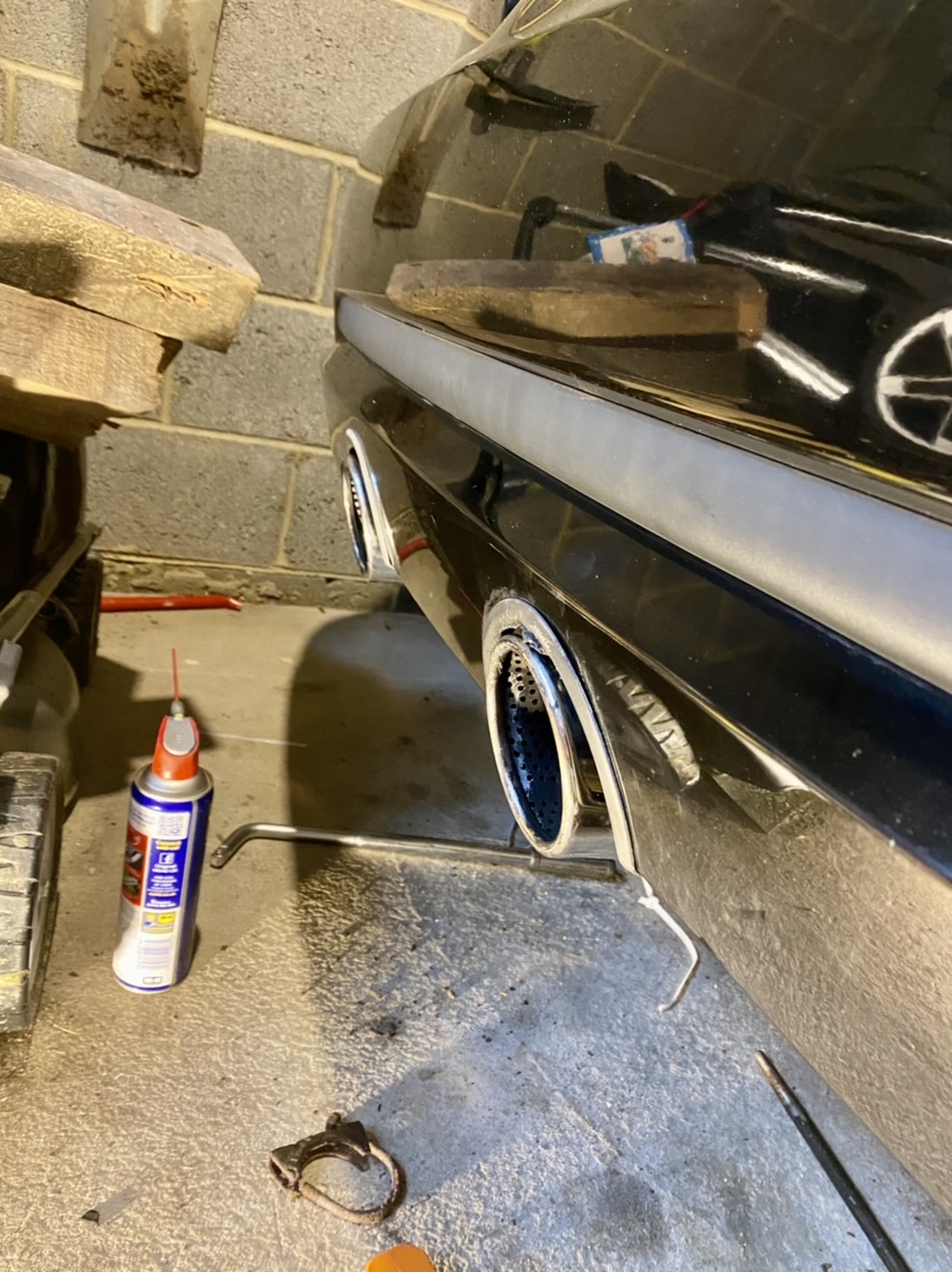

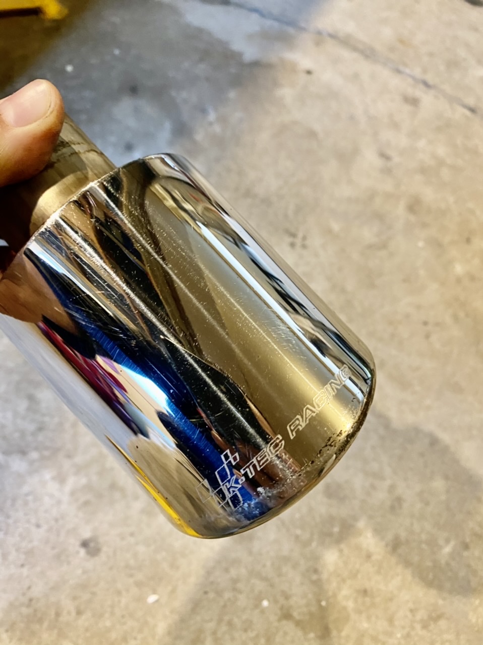

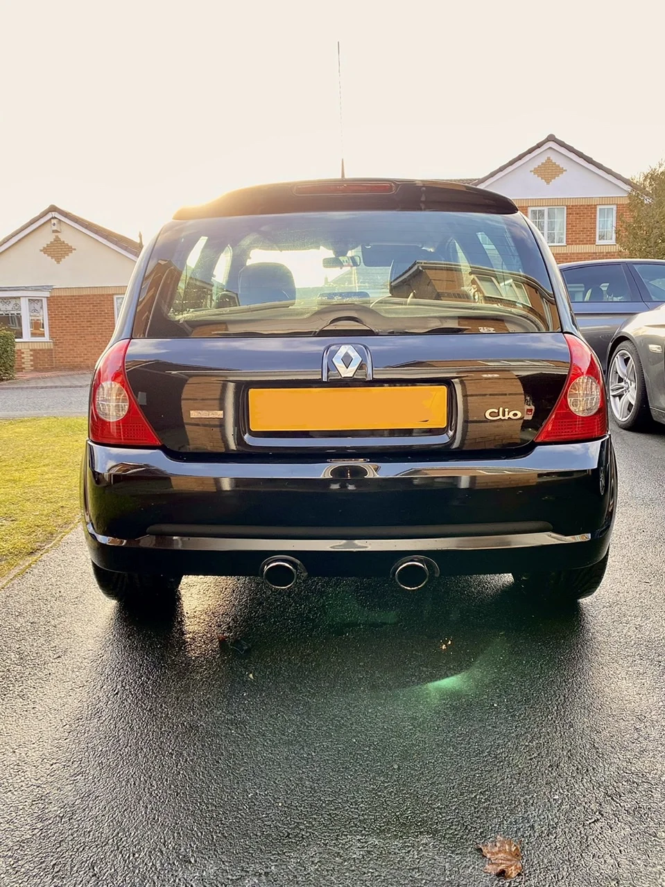

Had a free afternoon again today so finished a few bits off. Started by swapping the lambda sensors. Old one looked a bit shitty to be fair

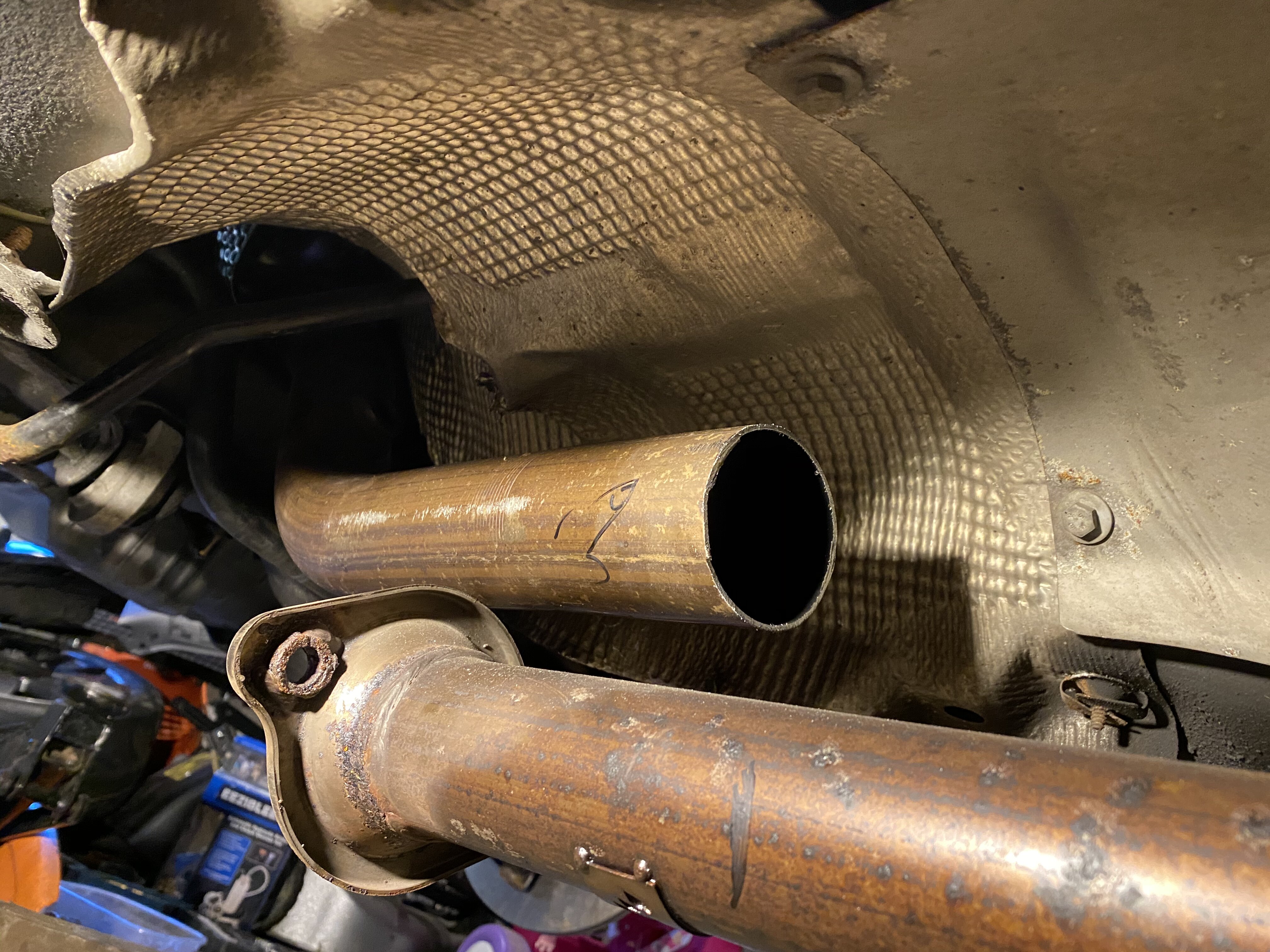

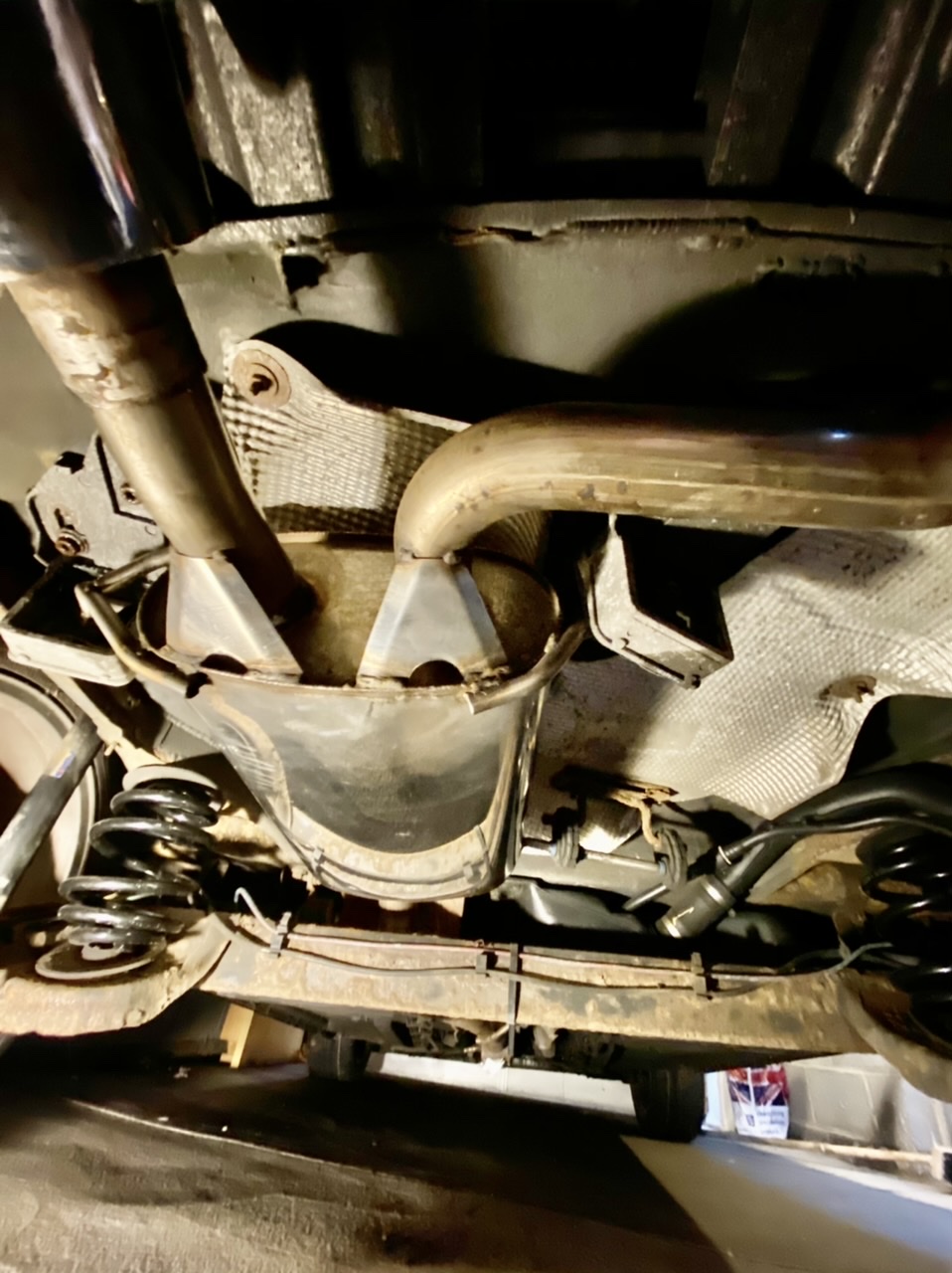

next up was getting the exhaust back on its hangers. Mid section went on fine, then it was the turn of the back box. Underneath is pretty decent and even the heat shields are ok. Rear beam needs a lick of paint at some point though

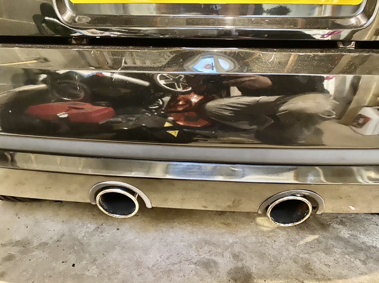

The tail pipes came up really well with a quick wipe down. Iā€™ll clean them up properly with the drill polisher when I get a chance
Iā€™m really pleased with how itā€™s all lined up this time. Itā€™s better than it was sat originally and about as close to perfect as itā€™ll ever go with the Renault hangers

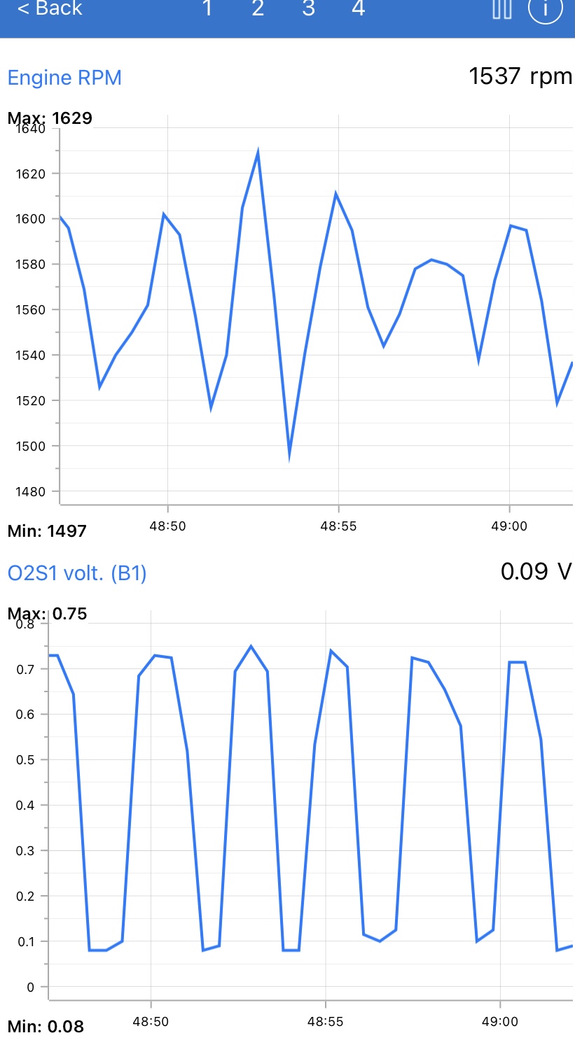

A quick read up shows these as likely causes:
  • Faulty Pre-Catalyst oxygen sensor
  • Faulty wiring/connections
  • Short or open ground in the wiring
  • Blown Fuse
  • Engine coolant temperature sensor is not operating correctly
  • Faulty Power Control Module

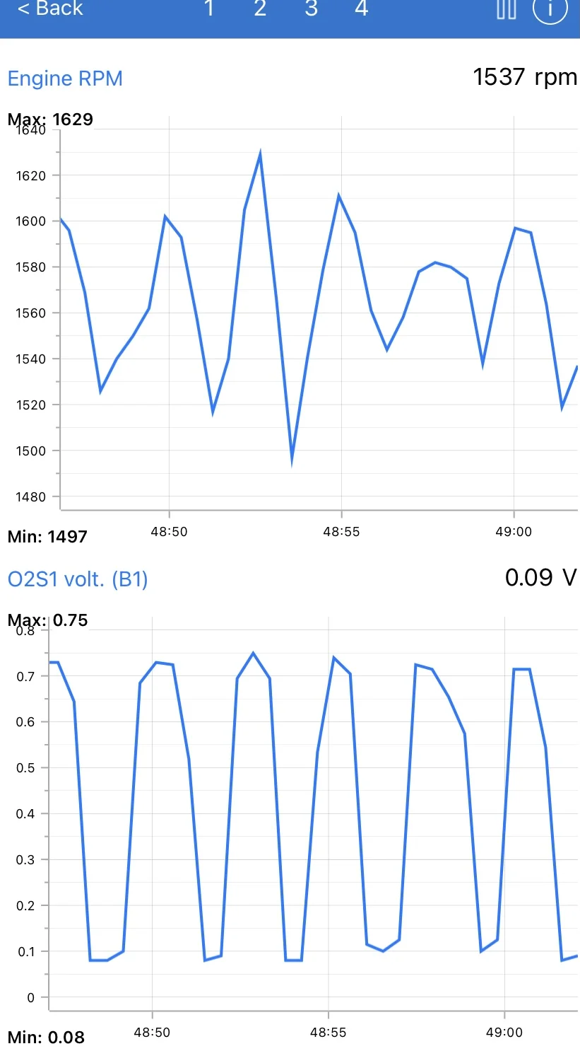

  • Blown Fuse
Iā€™ll have a check of the wiring and make sure itā€™s all ok. When I ran the car without it plugged in when I fired it up with just the downpipe on it was rough as sticks and has improved with the lambda in so itā€™s def doing something. Coolant sensor is new so donā€™t think itā€™s that but again Iā€™ll check it out
Have you checked the earth wire at the back of the gearbox, think it is on the same section of loom as the lambda wiring.
It seemed fine when had a look. Iā€™ll give it all a good clean up and make sure though šŸ‘

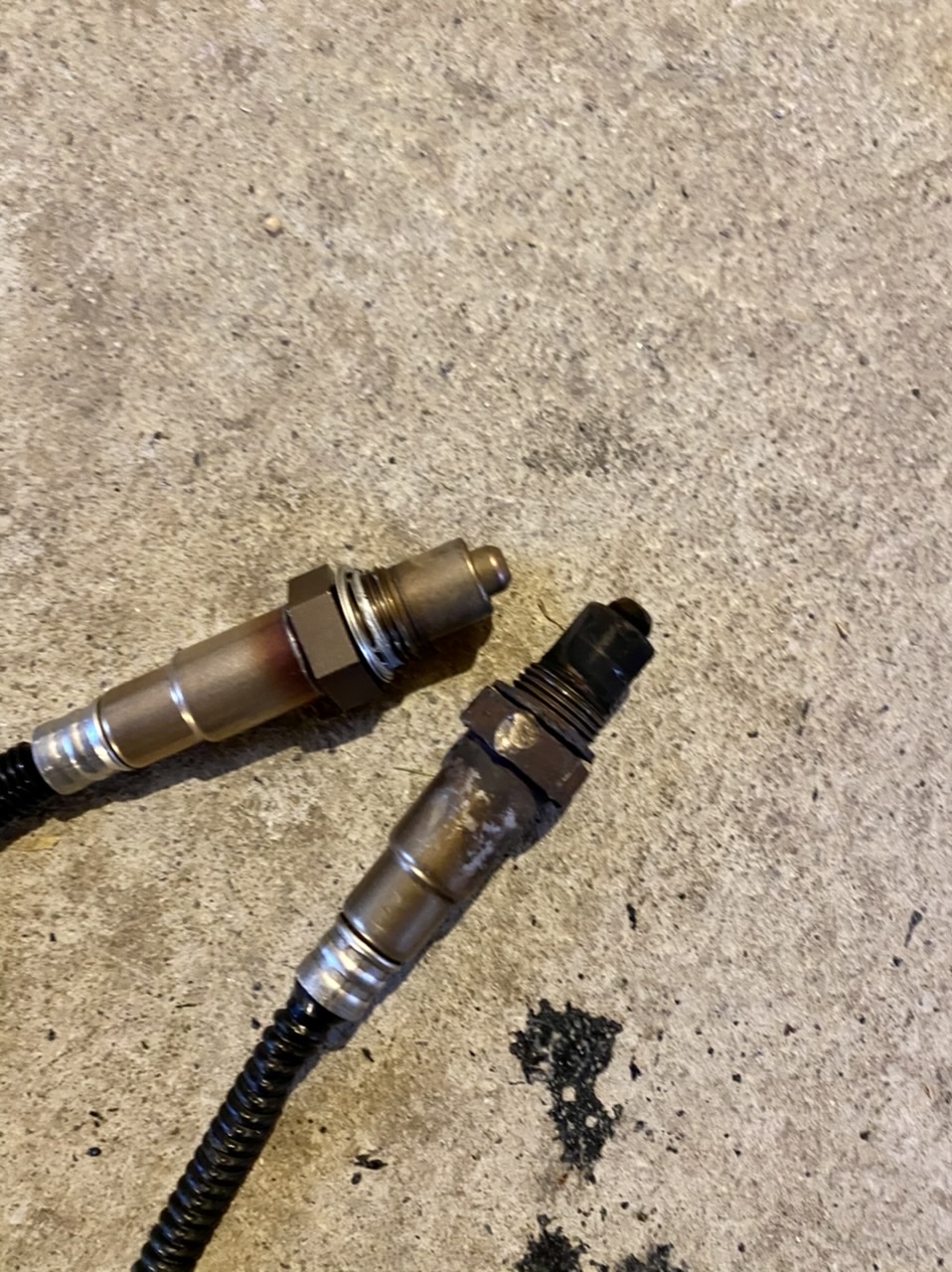

Today I bought ANOTHER genuine Bosch lambda sensor and returned the first one I got. This one was slightly different and had the clip that sits in the subframe so Iā€™m not sure just how genuine the original was.
Anyway, the codes are now gone and all is well in the world. Iā€™ve still got a bit of hesitation when first reviving but to be fair it just needs a good old run out to sort it now. The lambda graph with the new sensor is below:

Please excuse the exhaust blowing itā€™s tits off, Iā€™ve ordered the wrong size sleeve to join the 172 and 182 sections. Thatā€™ll be sorted this weekend.

Still got idle issues but som stickers turned up today which made me very happy. They may not be to everyoneā€™s taste but I like them. Massive improvement over the thoroughly terrible condition the bullets were in

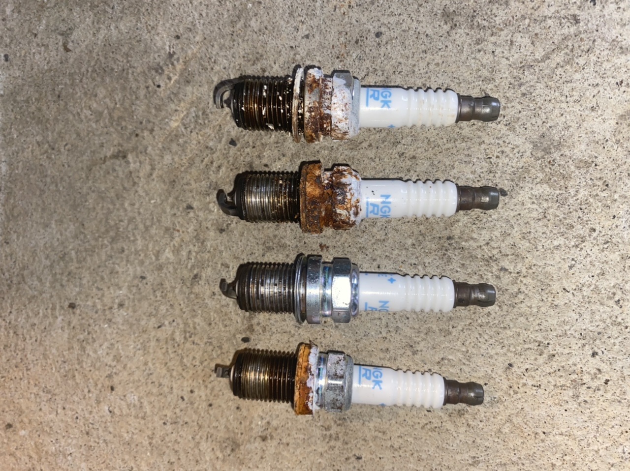

The misfire saga continues. I ordered some new plugs and leads which turned up today so got them fitted. Total pain in the arse having to split the inlet every time you want to do anything.
I checked the gaps on the new plugs which were all spot on as expected. The old plugs looked a bit worse for wear. Amazing how bad they are considering theyā€™ve barely been used!
Got it all back together. Iā€™ve also got a battery cover arriving this week which should help tidy the bay up a bit
fired it up and itā€™s still exactly as it was! This is the issue that took the thing off the road in the first place! Itā€™s changed as parts have changed but still there. Itā€™s fine under load up the rev range but low down it totally flat. The vid below shows what itā€™s like when revving. The only other thing left to change is another coil pack but that was brand new and covered no miles too! Is there anything else obvious I could be missing?
