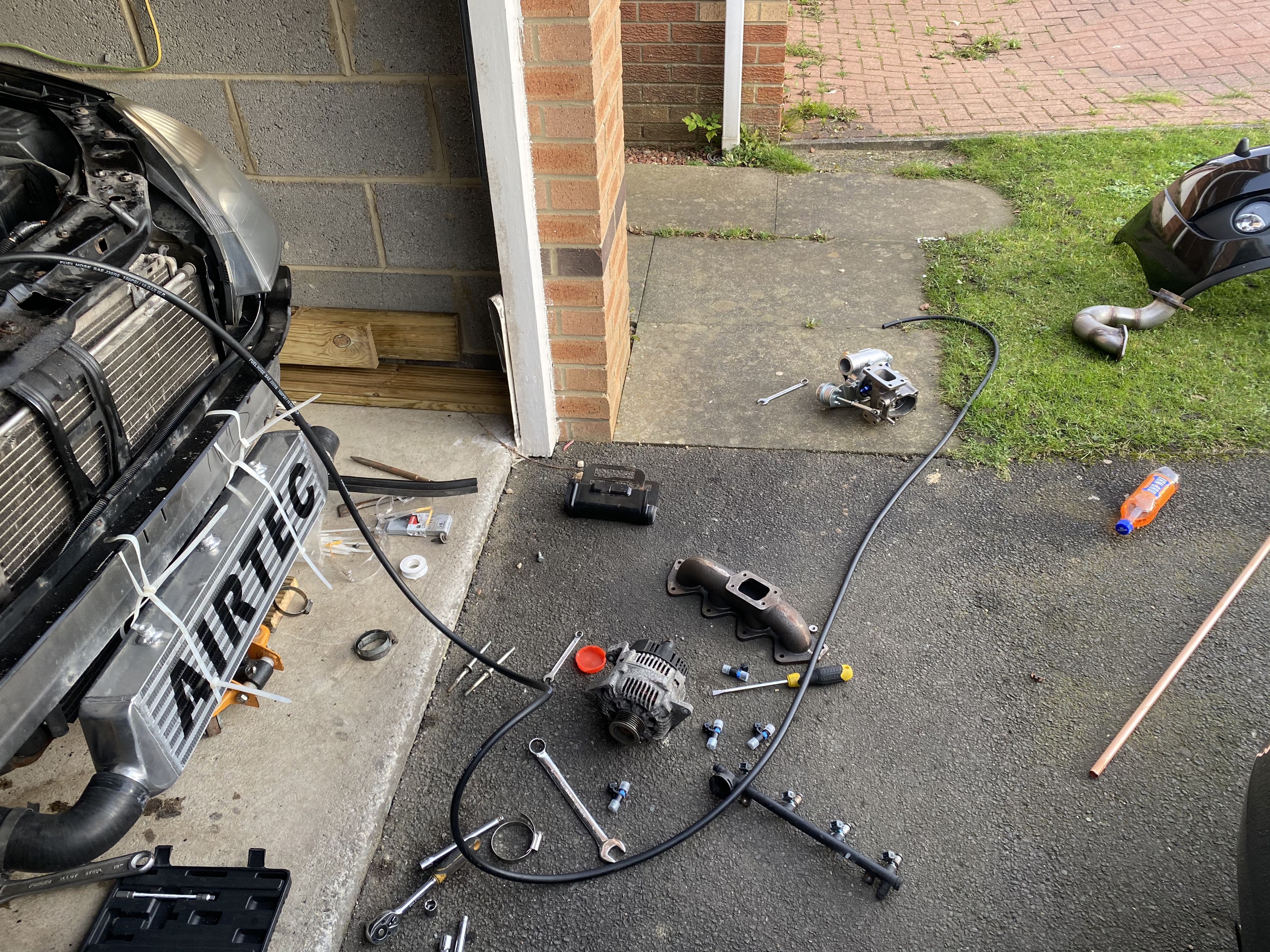

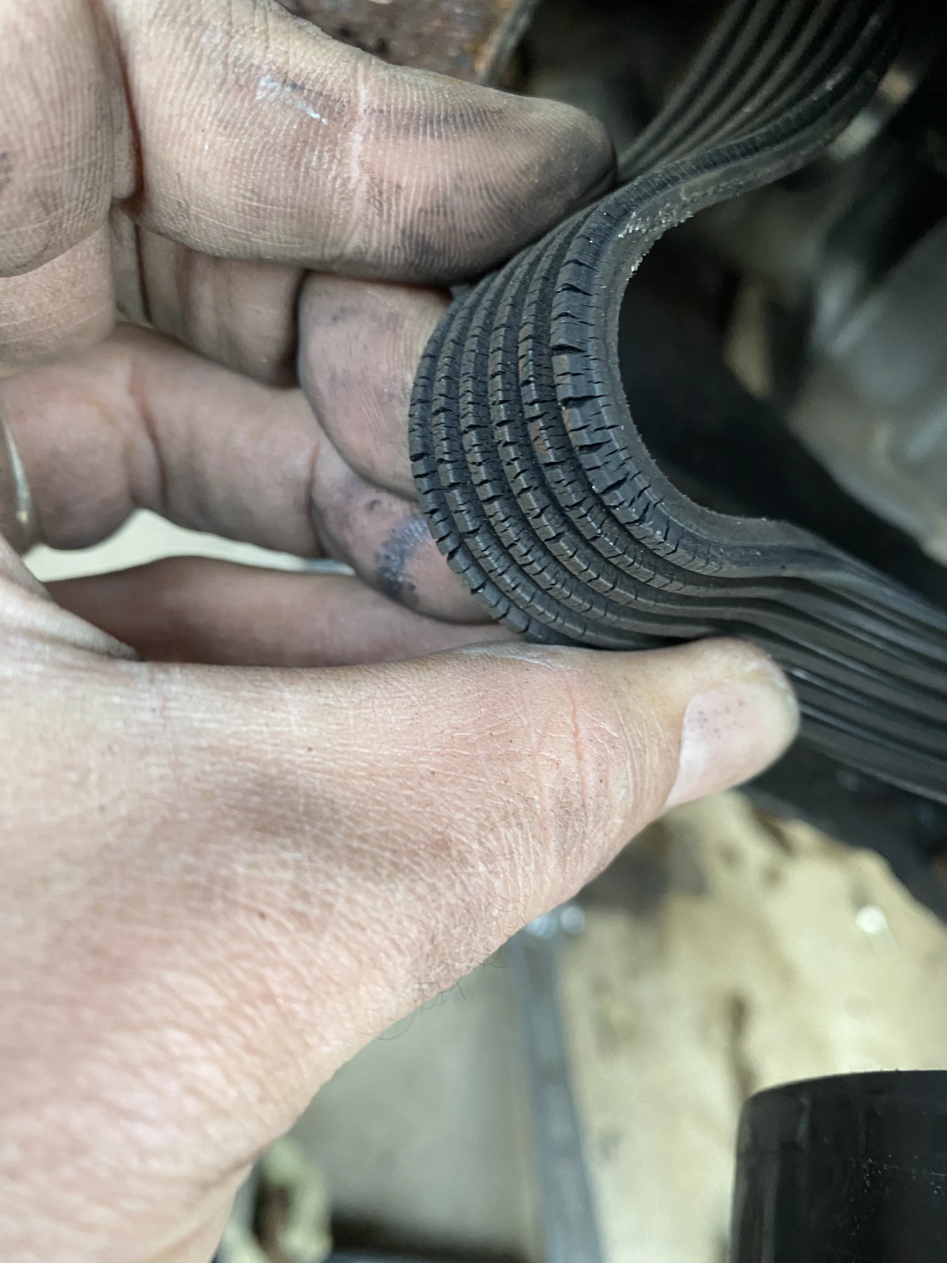

Bit more done during little leg’s nap time today. Fitted my new(er) and working alternator. Belt is in dogshit condition so that’s top of the list to get changed.

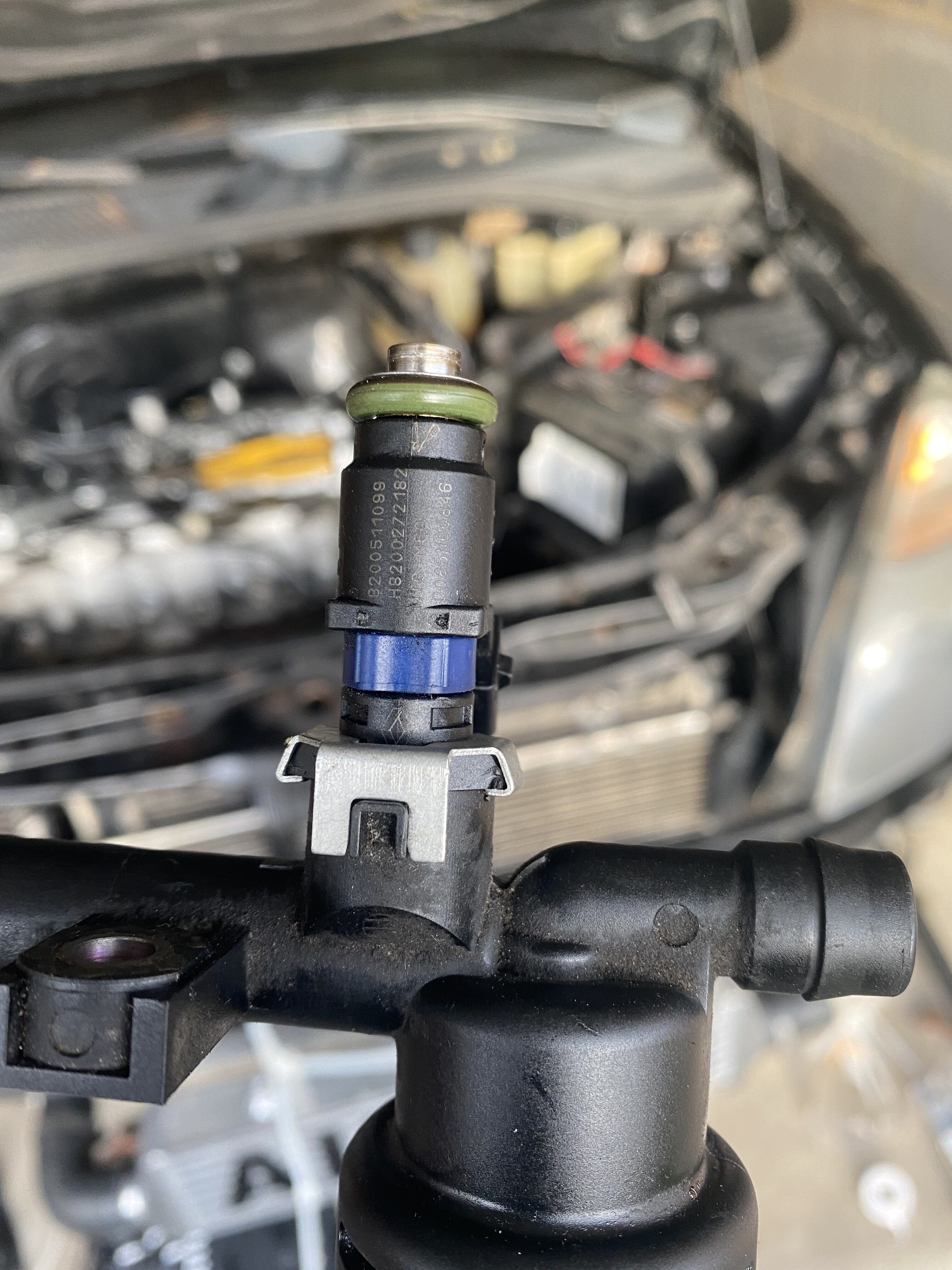

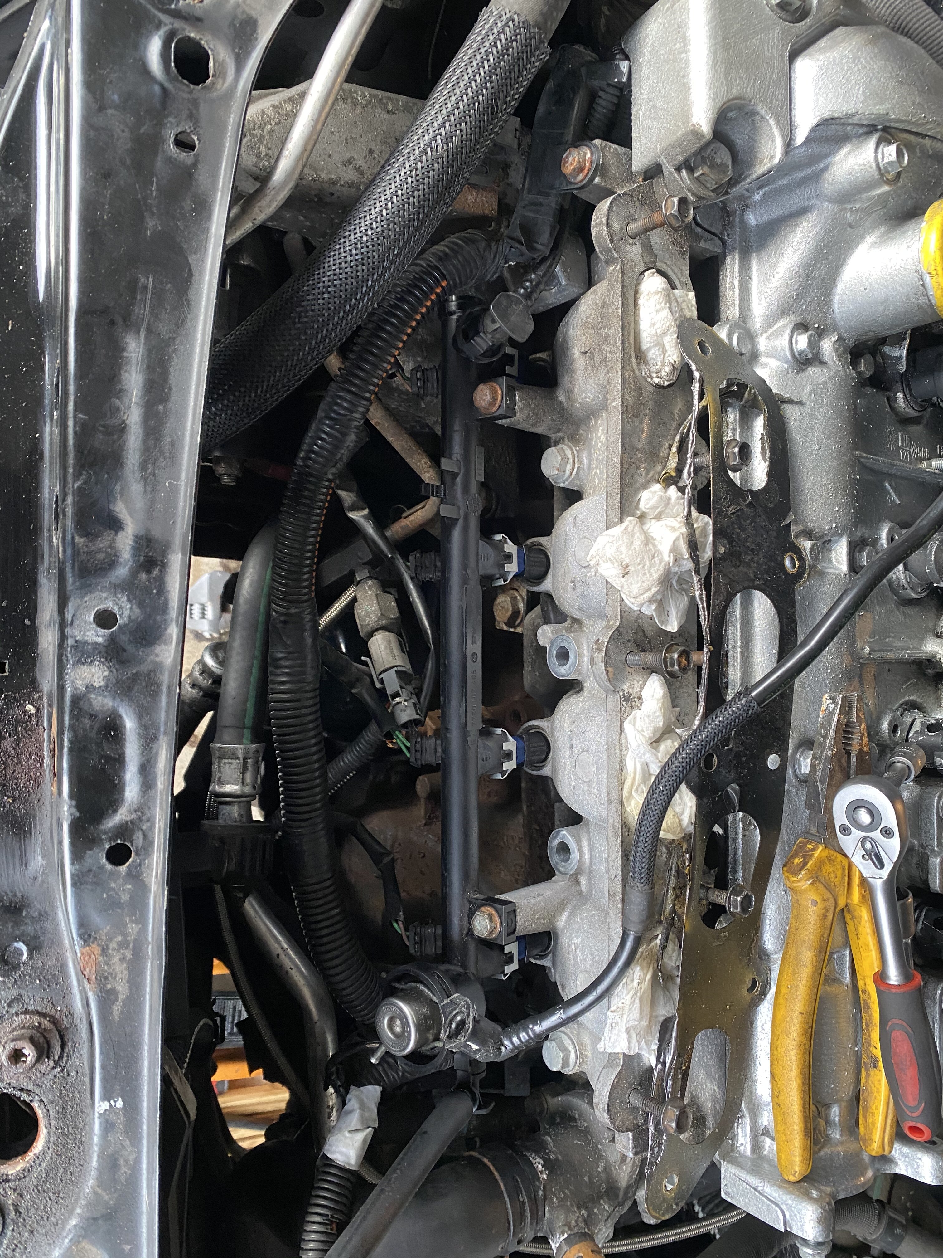

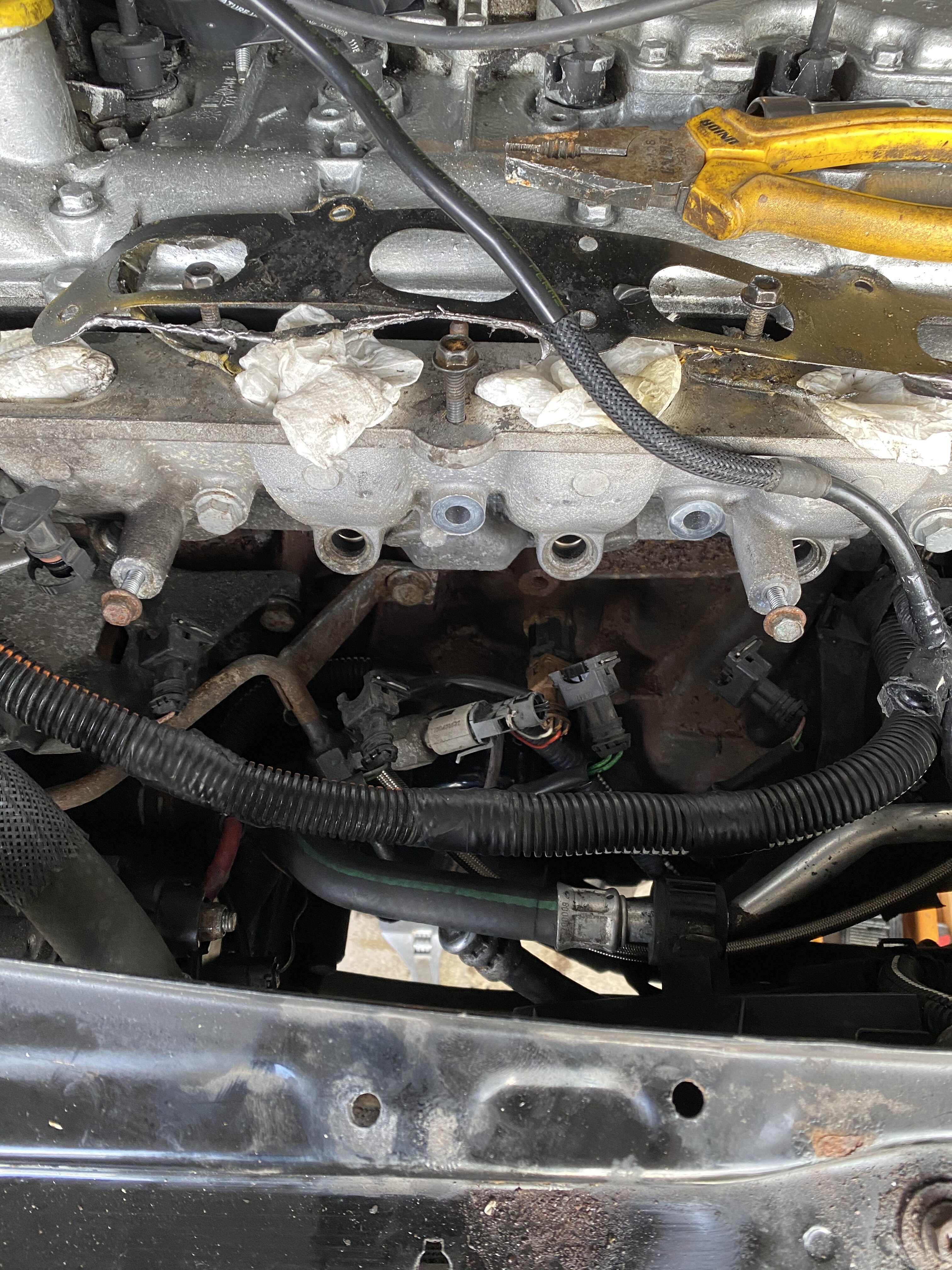

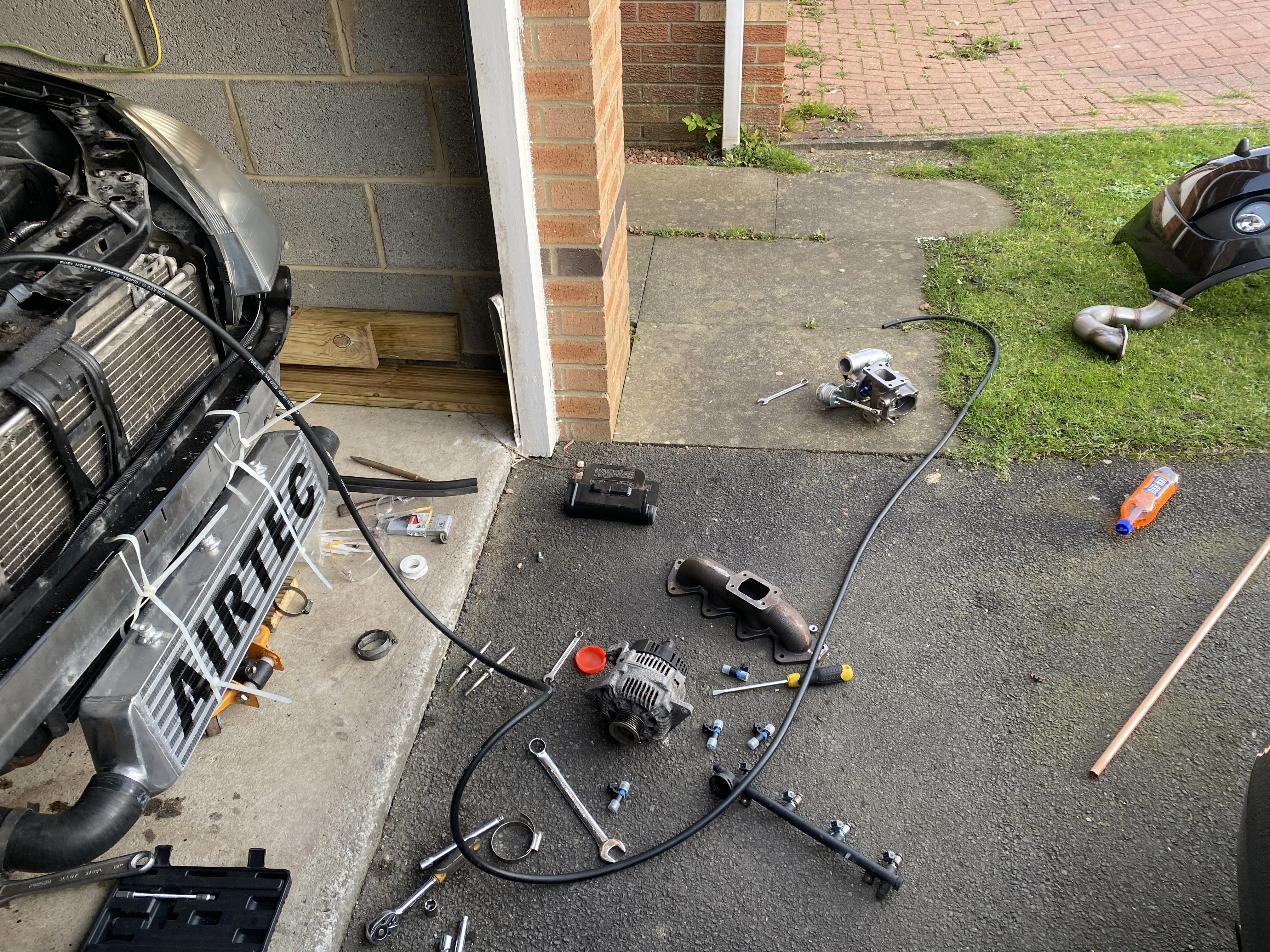

Next up was swapping the fuel rail and injectors. Old one off. I’ve also removed the studs that hold the fuel rail guard on but they are massive. Do they also hold the lower inlet on or am I ok to bin them?
New injectors in the rail. Had a slight panic cos the new ones didn’t have clips and the 182 ones didn’t fit. Then remember the dodgy eBay fakes I’ve got which did come with clips. Swapped over with much success 👍

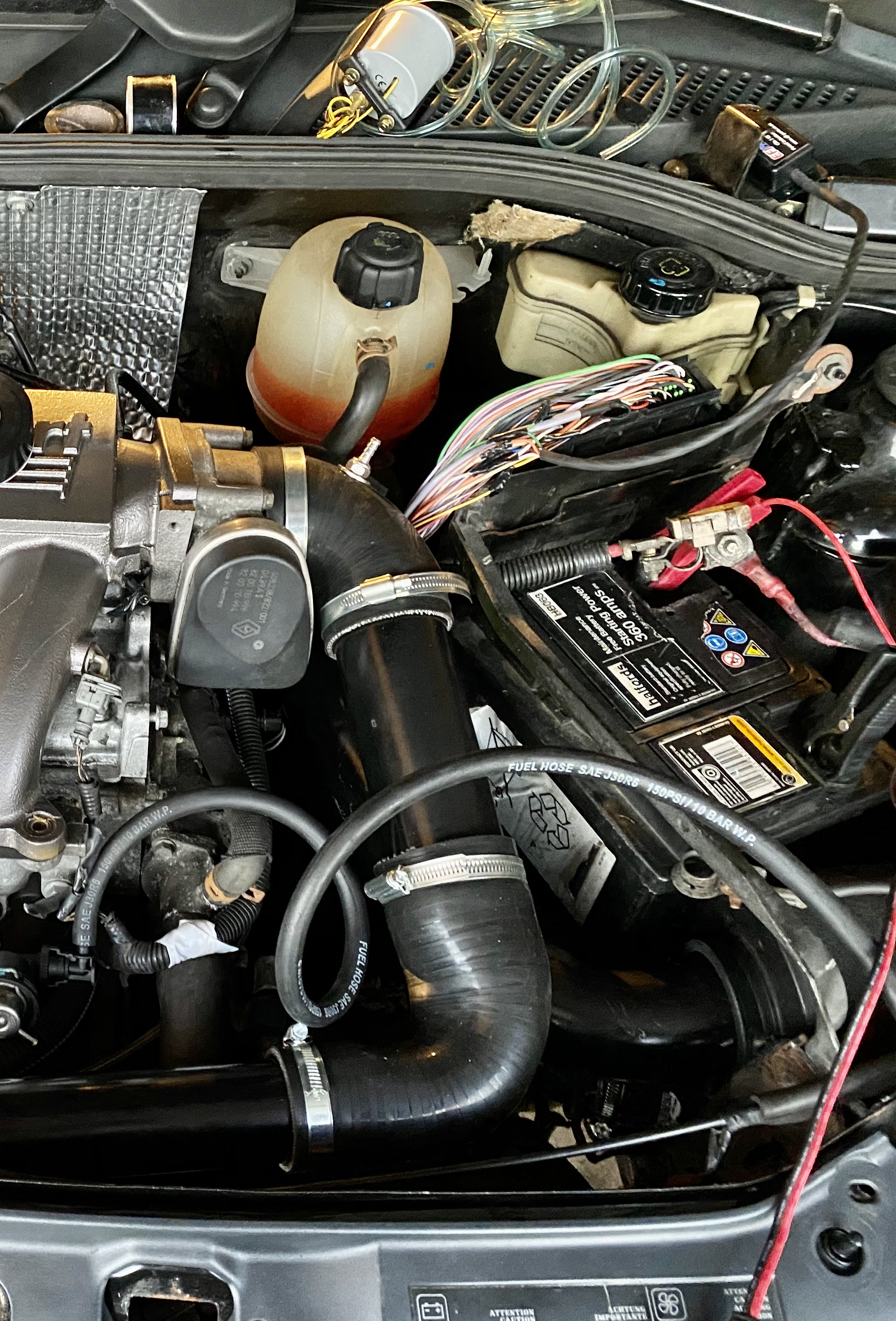

All fitted back up with return line on
The car is too close to the garage wall for my fat arse to squeeze in and run the line so for now it’s like this. I’ll throw it in a Gerry can once everything is fitted so I can spin the car round

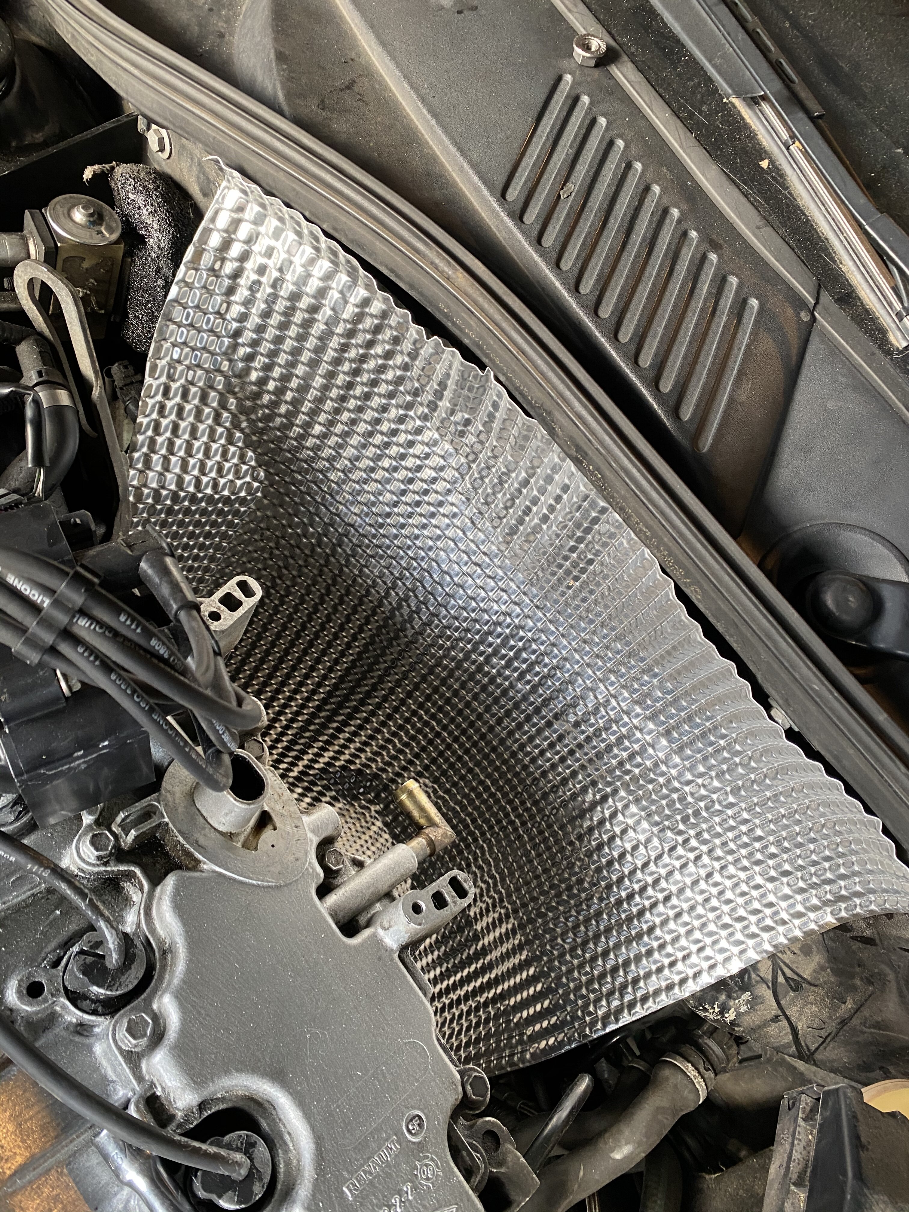

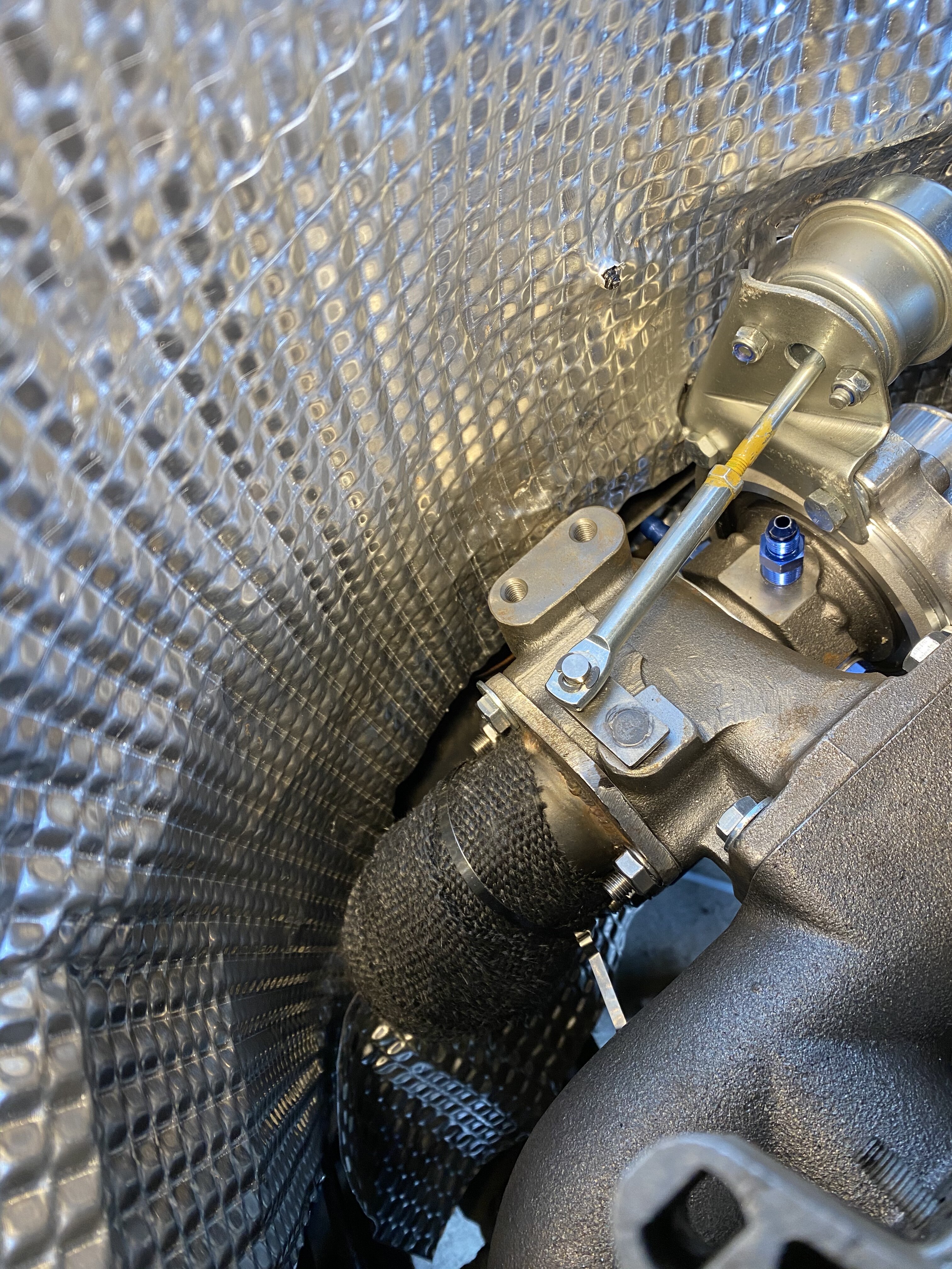

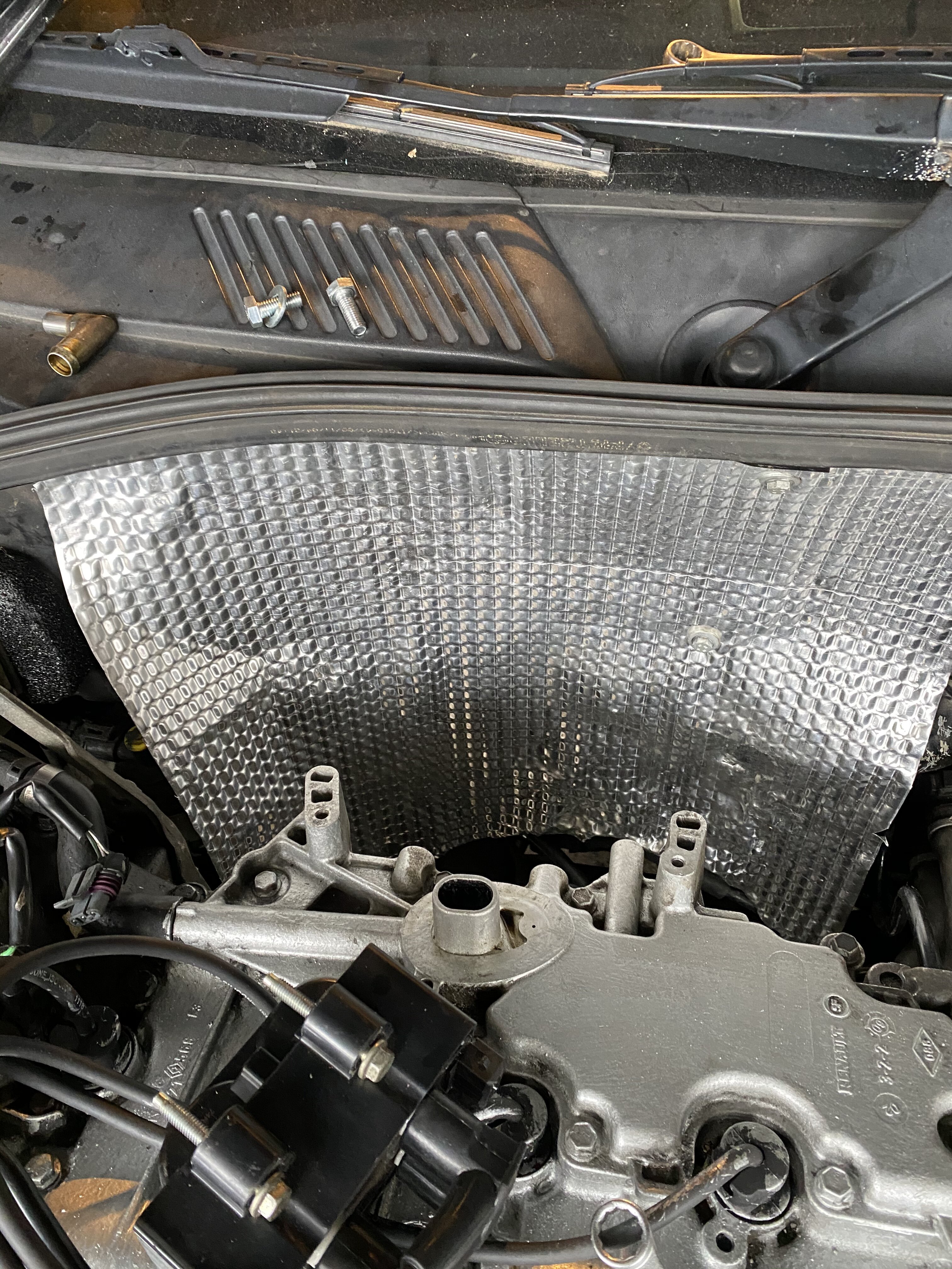

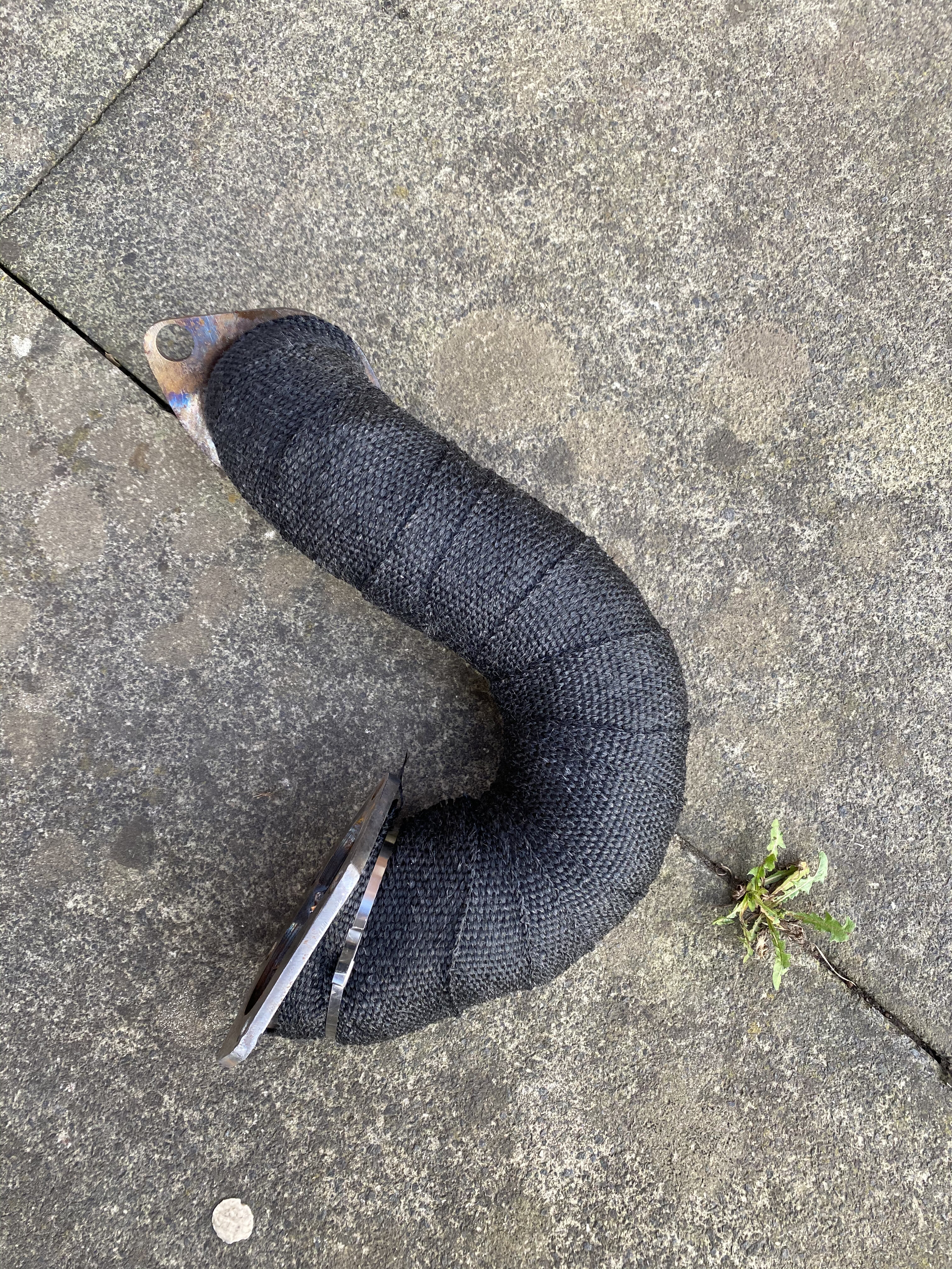

The last bit was some heat management. Few laps of heat wrap looped round the downpipe and heat shield v1 in place. Much, much, much mote
Busy busy day today. First job was to sort the heat shield. Much swearing, hammering and chopped fingers later it was pretty much bang on

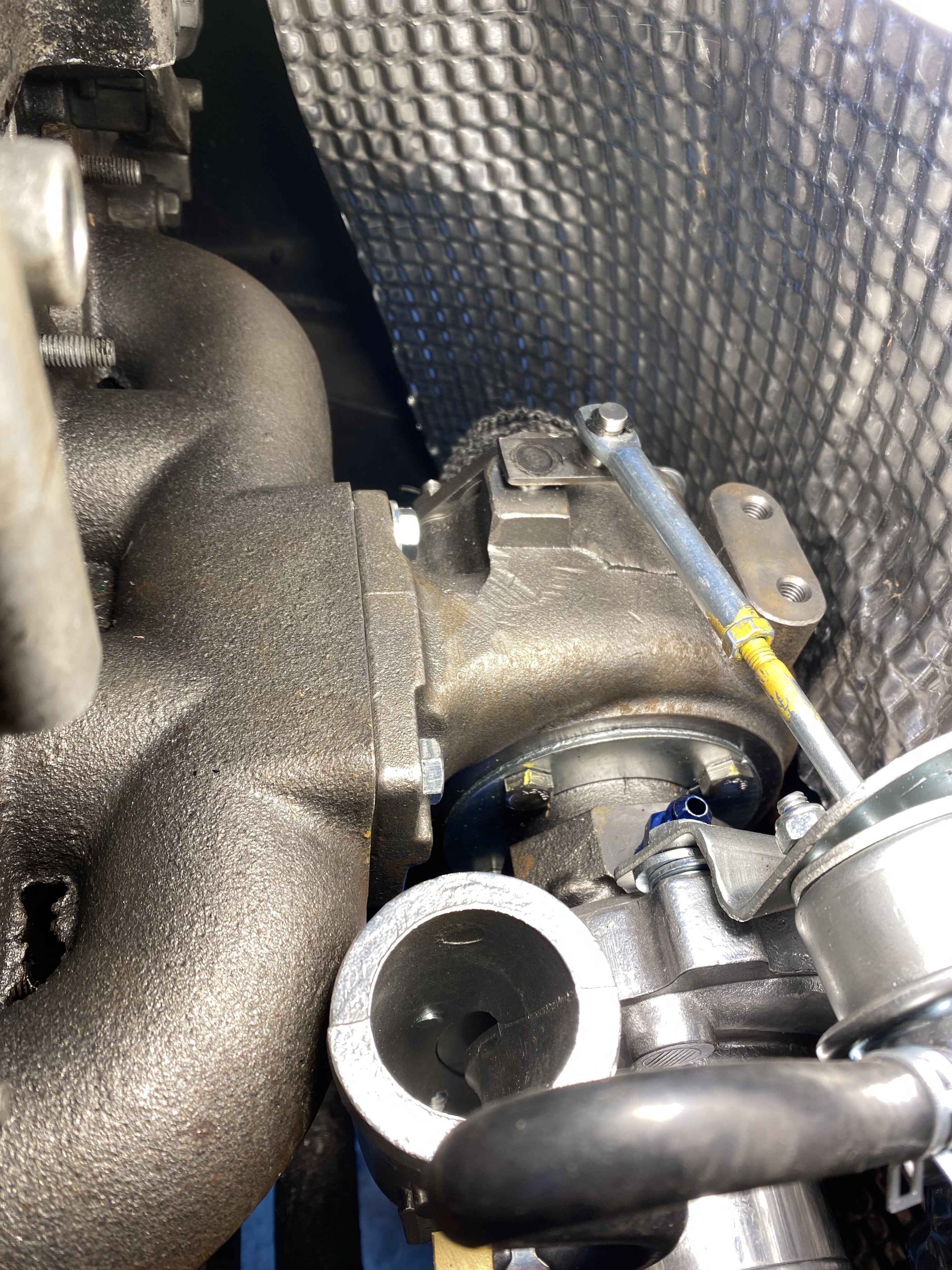

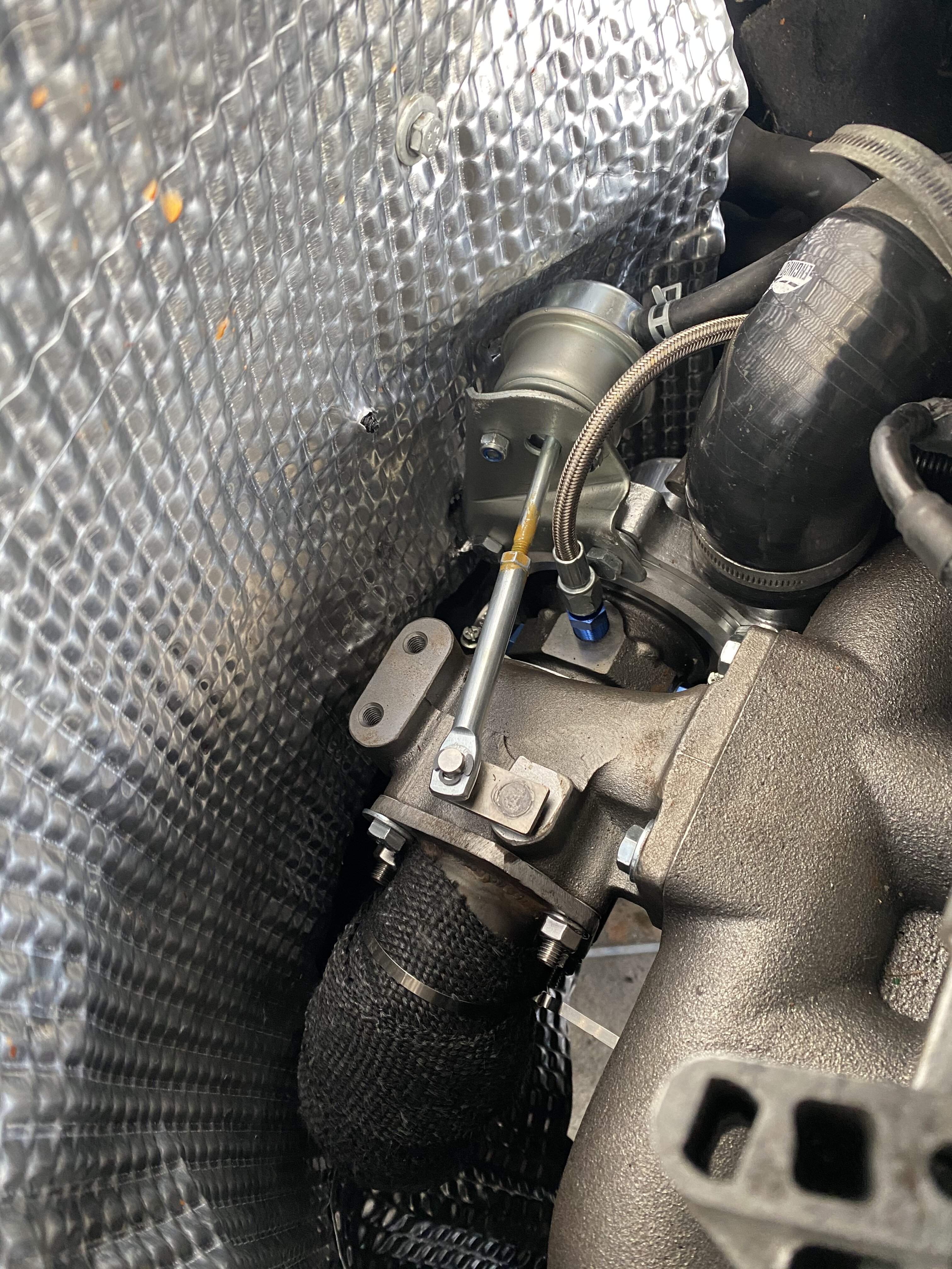

I started mounting the turbo and tried to attach the downpipe and couldn’t get it to line up. There was a bracket near the pas lines that wasn’t attached to anything in the way. Popped that off and it was still hitting something so stuck a bit of 8x2 down there and bashed the hell out of everything. I then went for plan B and attached the downpipe to the turbo first after I realised I wouldn’t be able to get to any of the bolt holes. This time much success
Then the oil and coolant lines went on
It’s mega tight down there and I had to modify the alternator bracket a bit to get it to go but it’s in. Next up was the intercooler and boost pipes. After a bit of trial and error I got the hang of where to mount it. The holes in the cross member are in the perfect place to cut a hole in the bottom and drop a 150mm bolt down

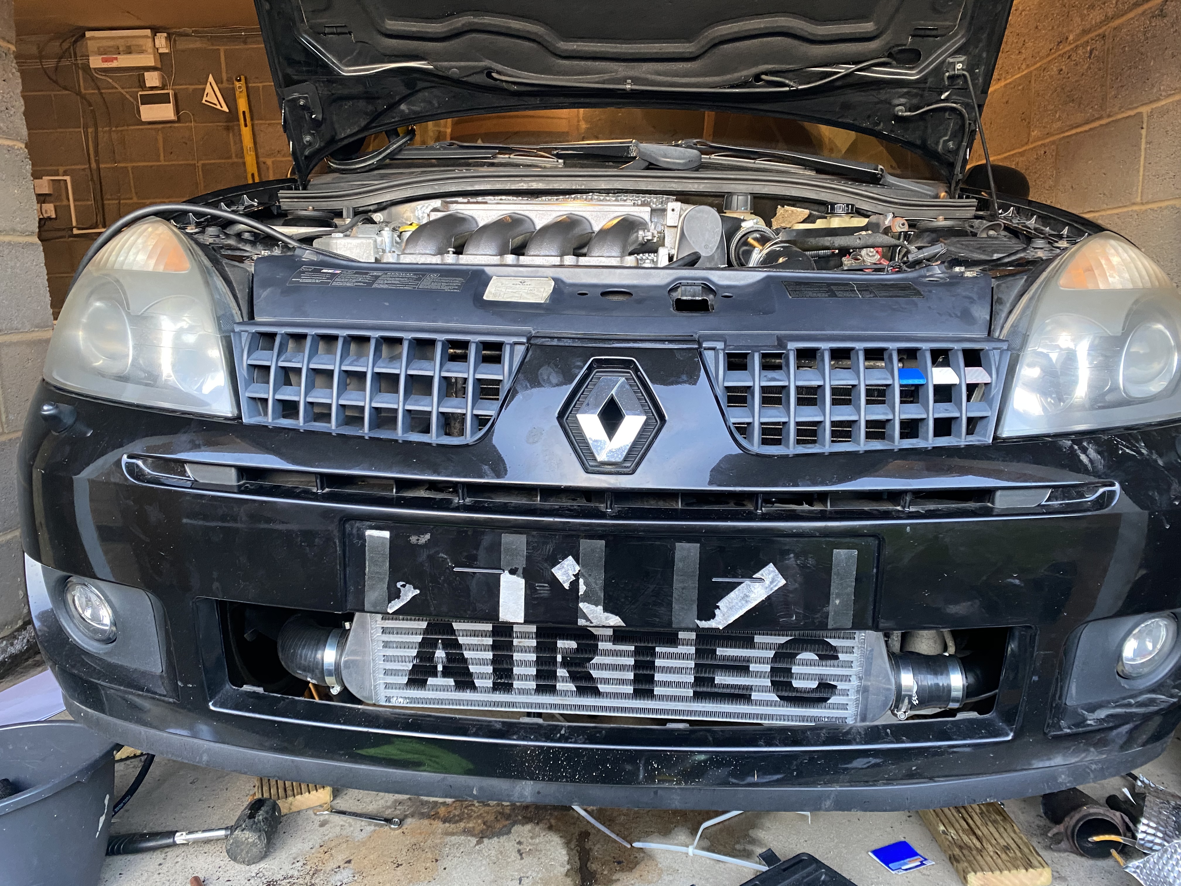

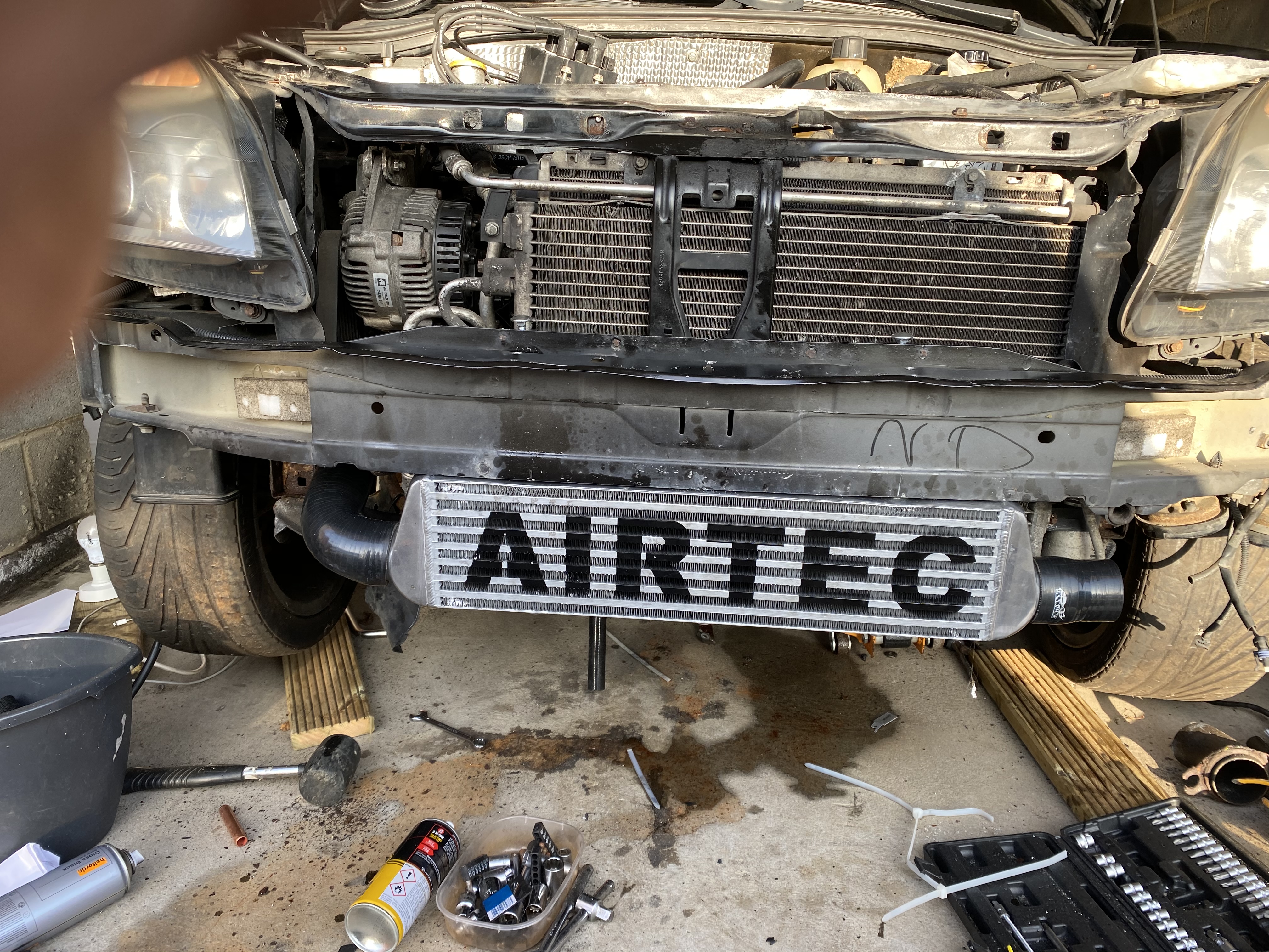

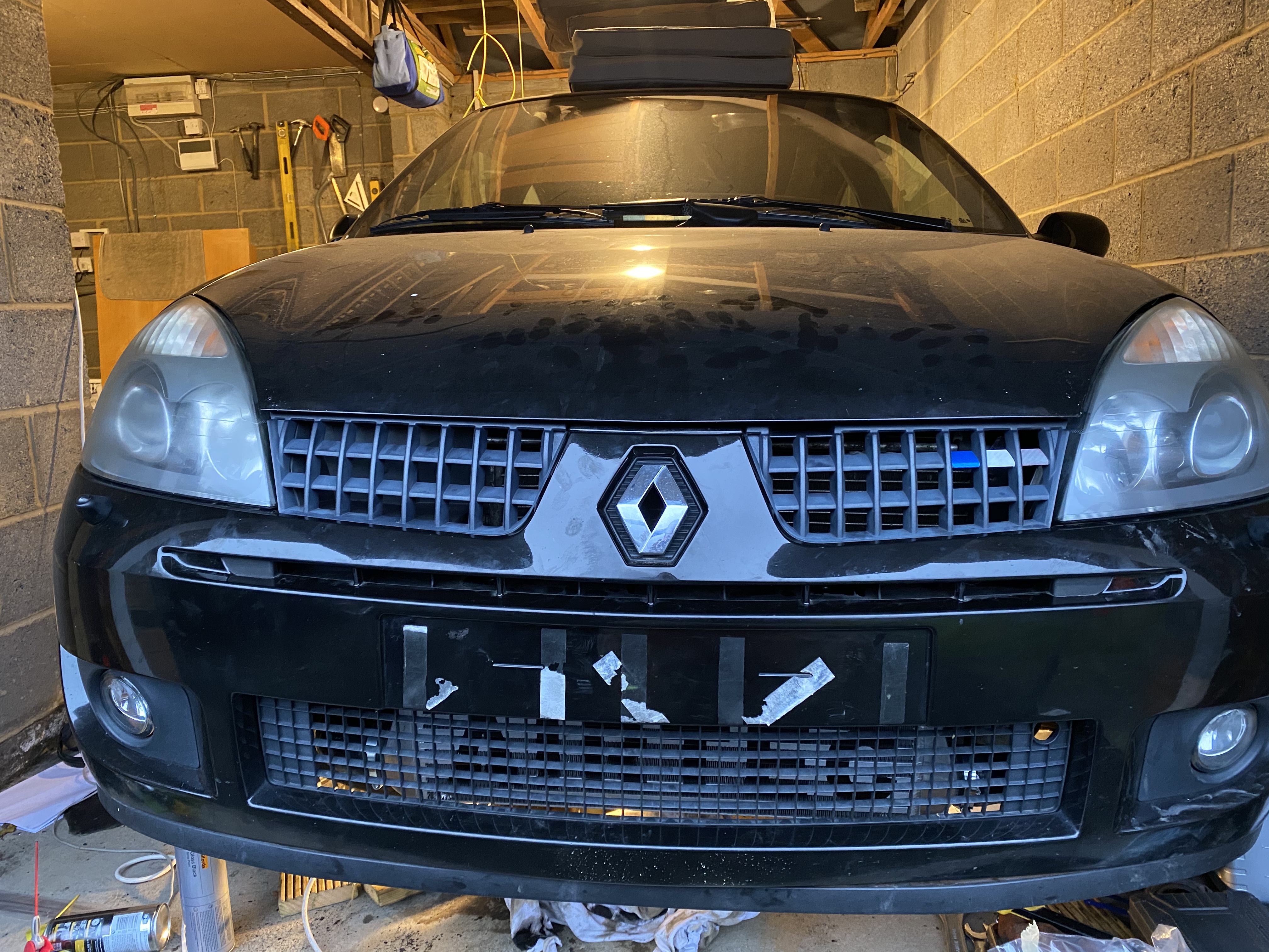

With that done the front bumper went on nicely. May or may not add the grille back in, can’t decide as of yet

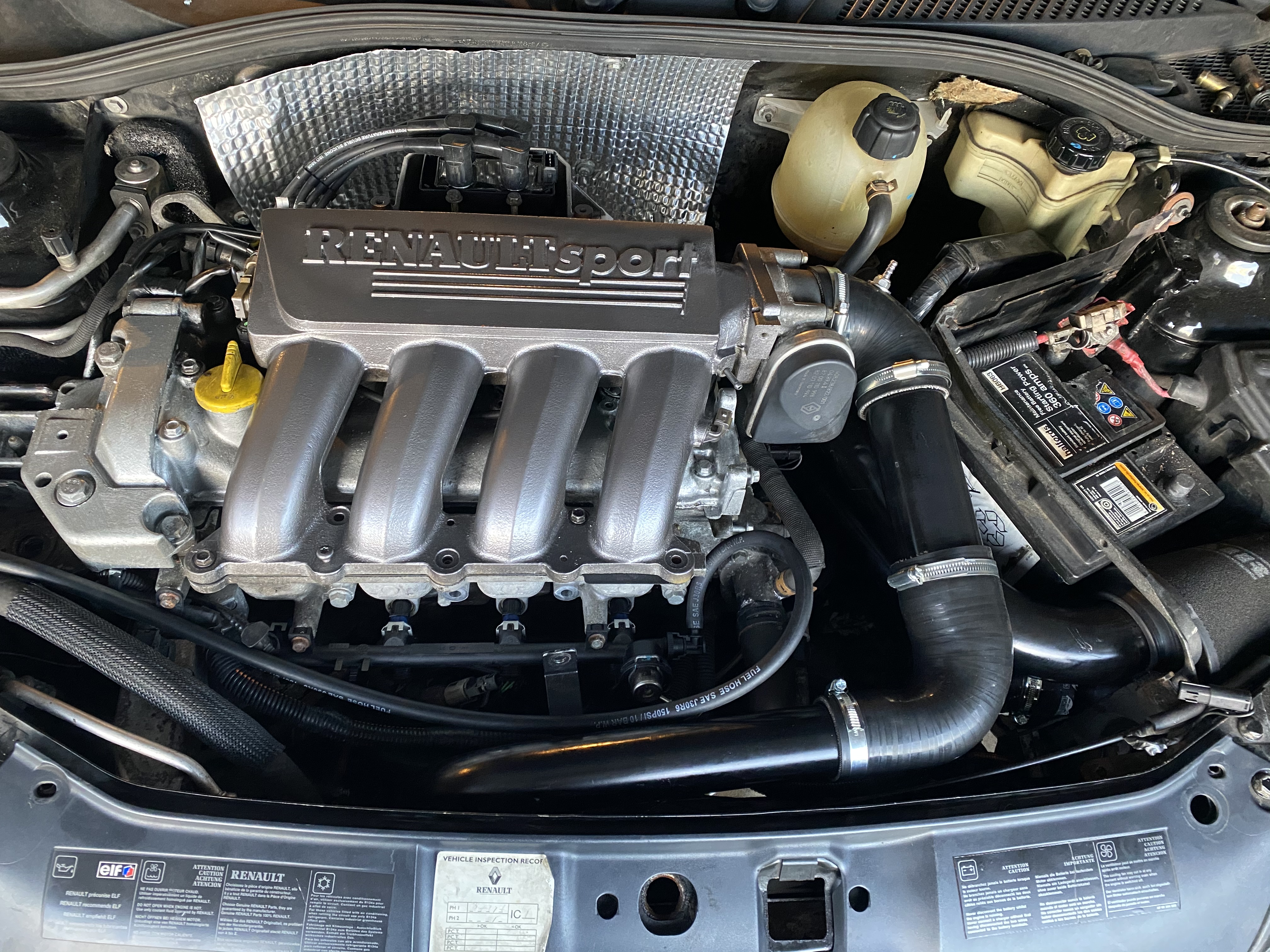

And the rest of the pipe work went in and the inlet back on
That’s it for today. My ecu is still with EFI getting a base map put on or it would have been fired up and leak checked this afternoon. Pretty hard to start it without the ECU! The last bits left to do are to order a 63mm bend for the turbo to air filter pipe work as that’s gone missing somewhere then just check all the bolts again to make sure.

Do you need anything to limit the oil pressure to the turbo on the clio turbo conversions?
Some people say yes, others say no so I’ve gone in the middle. The fitting from the T goes to a 1/8” NPT rather than a 1/4” so restricts it a bit but still allows decent flow. Only time will tell I suppose 🤷‍♂️

Not on a journal bearing turbo which I believe this is.. ball bearing turbos need a restriction
Yep, this one is a journal bearing.

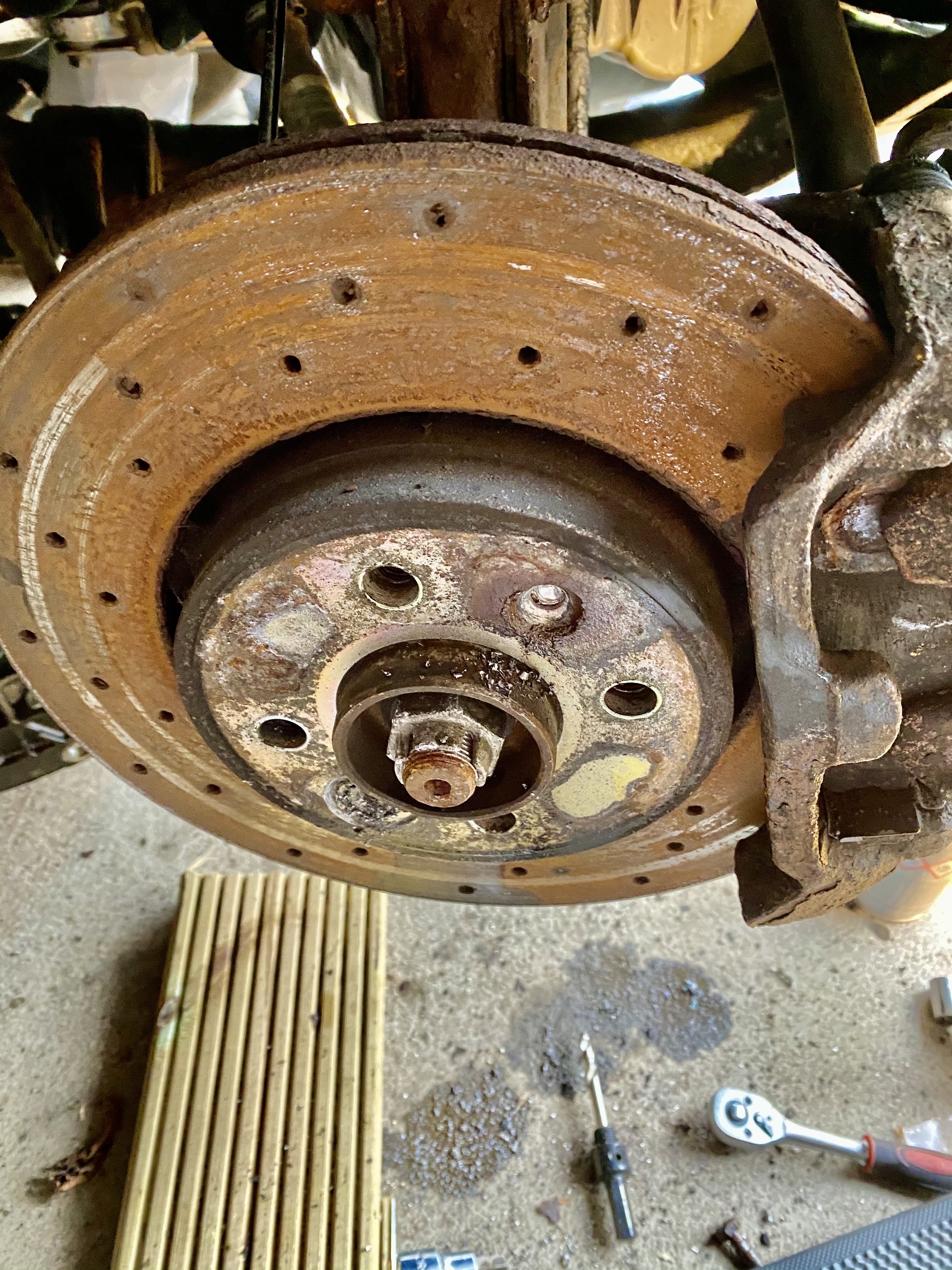

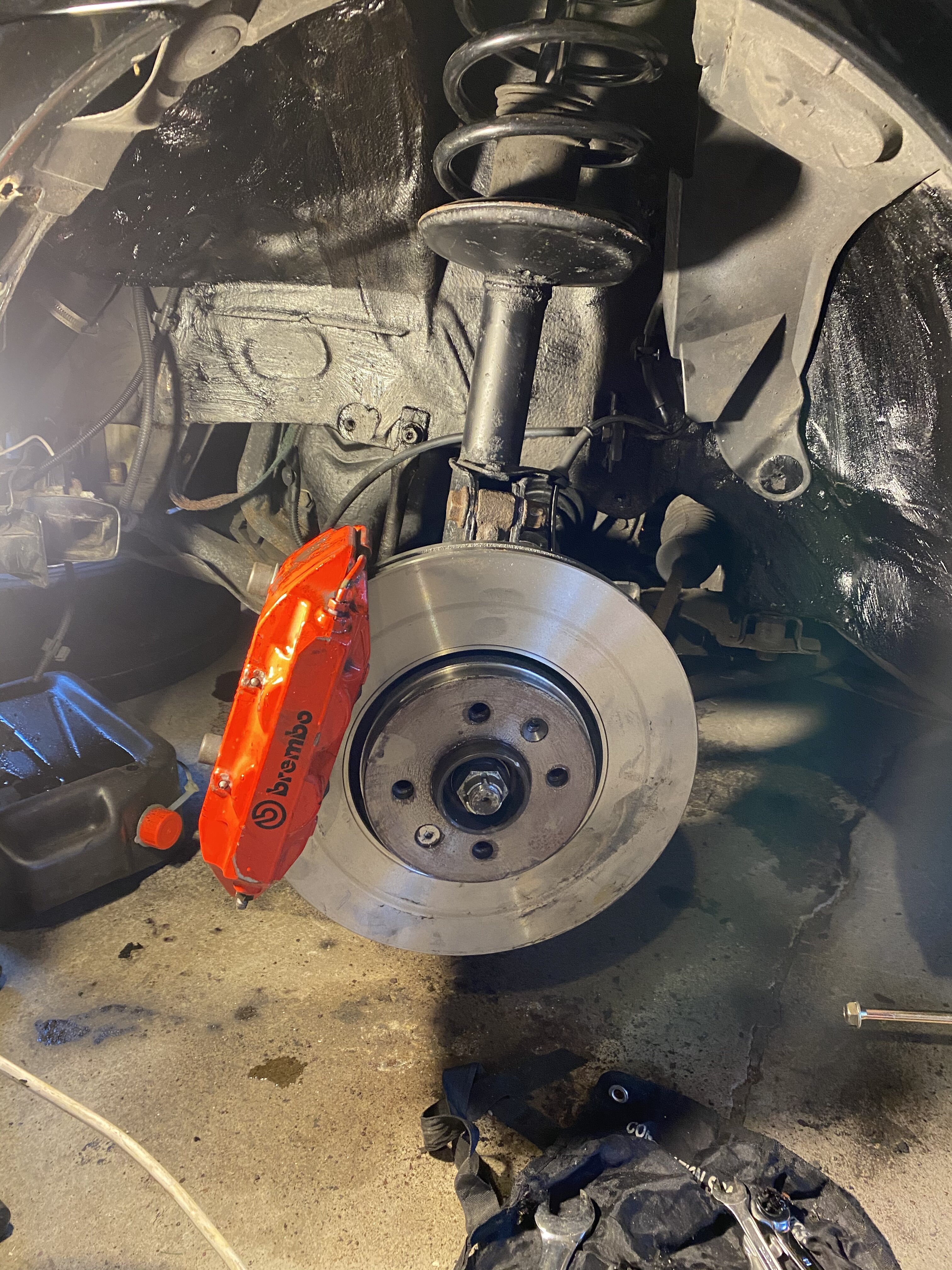

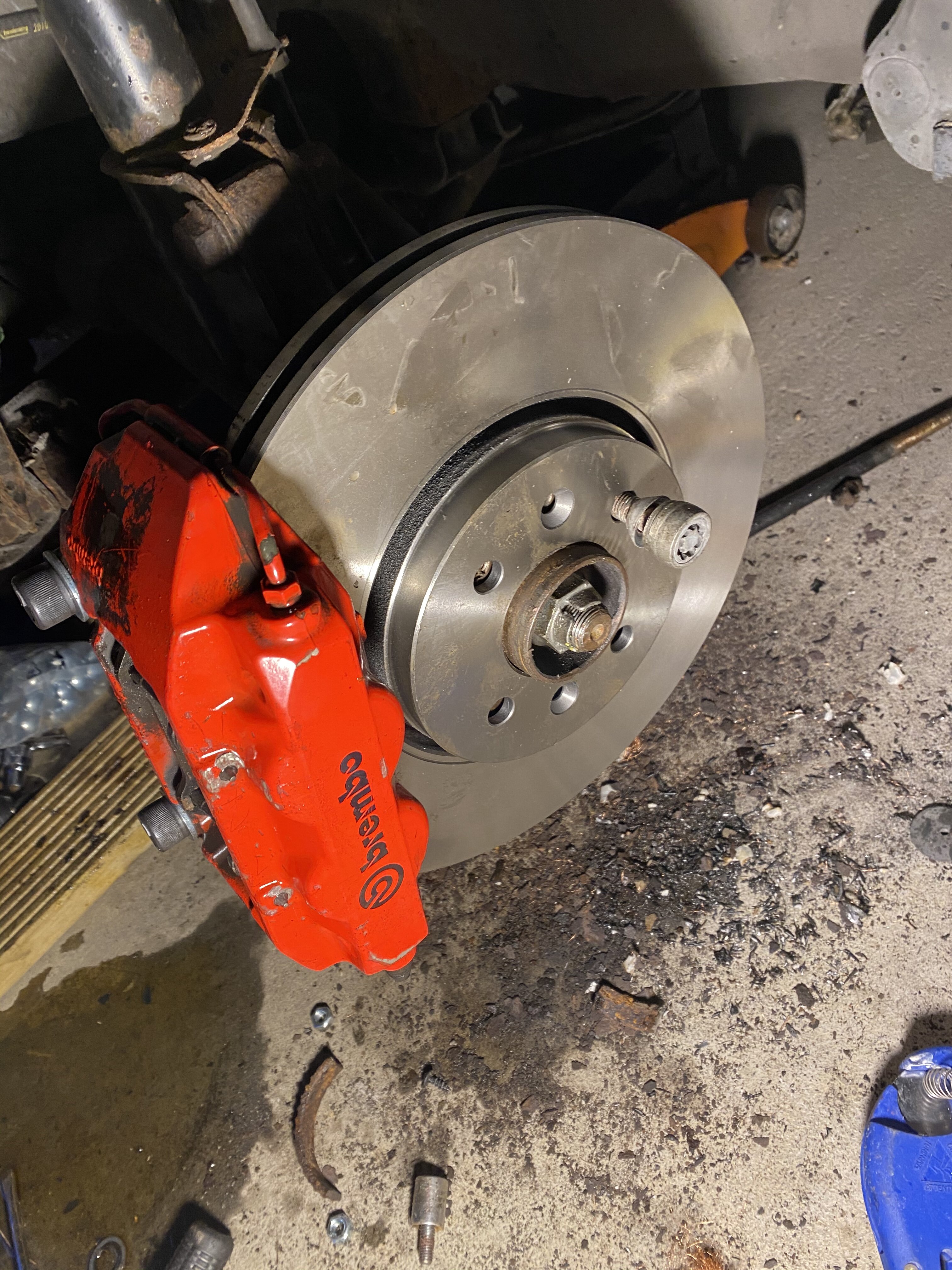

My ecu is still on its holidays at EFI so decided to make a start on the brakes today which was predictably, a massive ball ache.

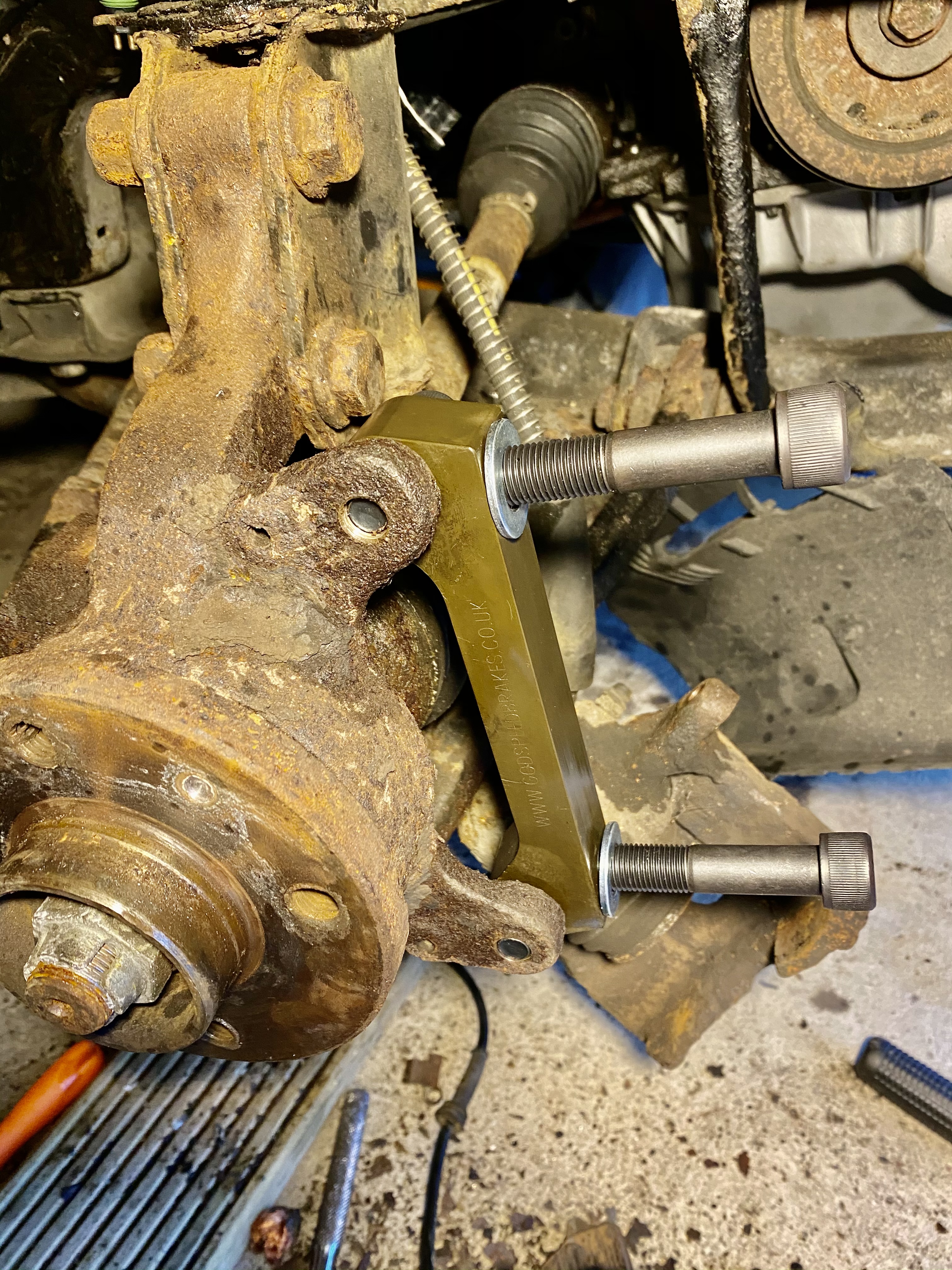

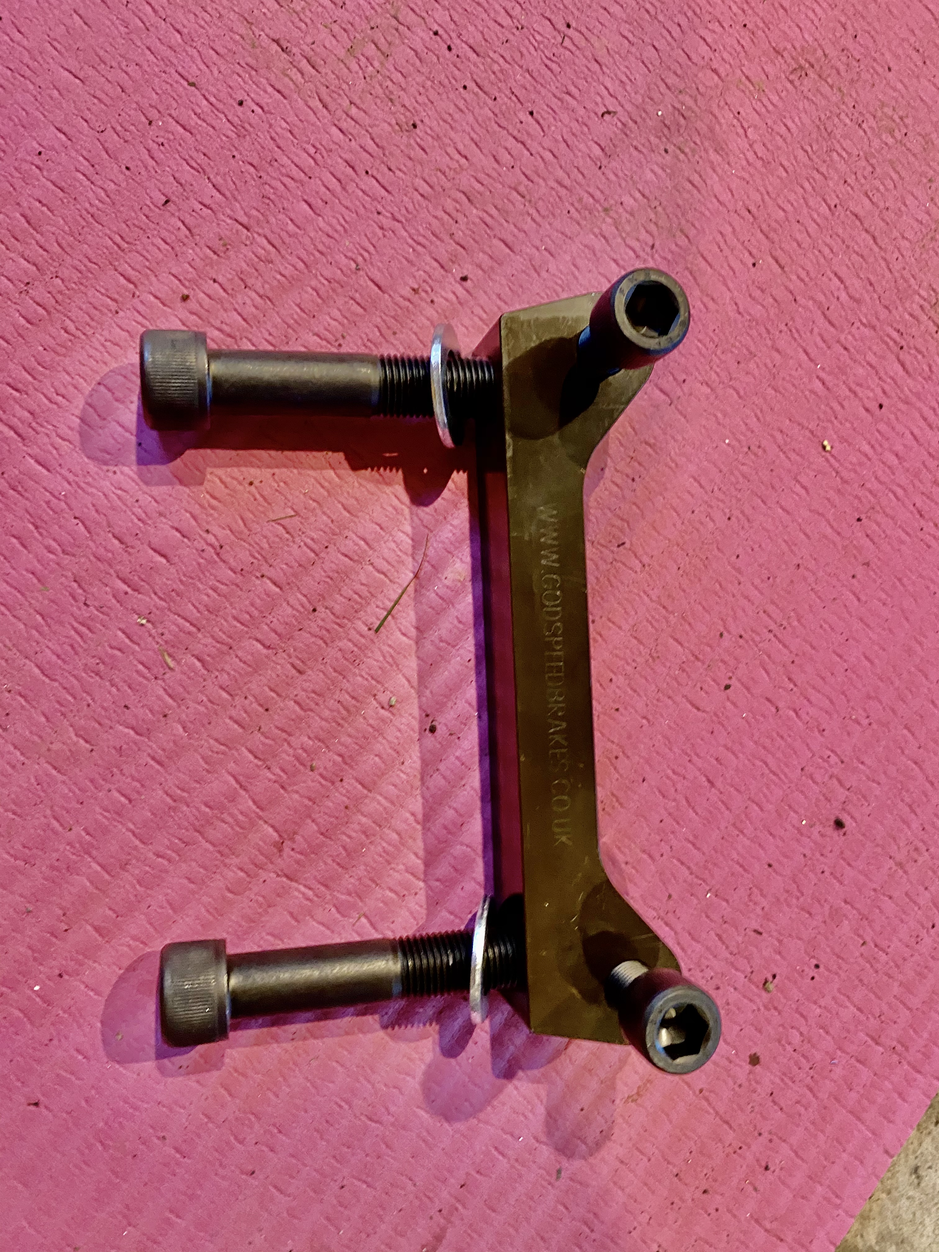

The brembo calliper adapters arrived. I’d looked at the PMS ones but didn’t fancy remortgaging the house for 2 small bits of metal so went with some from godspeedbrakes instead which came recommended. First impressions are they seem very well made but time will tell

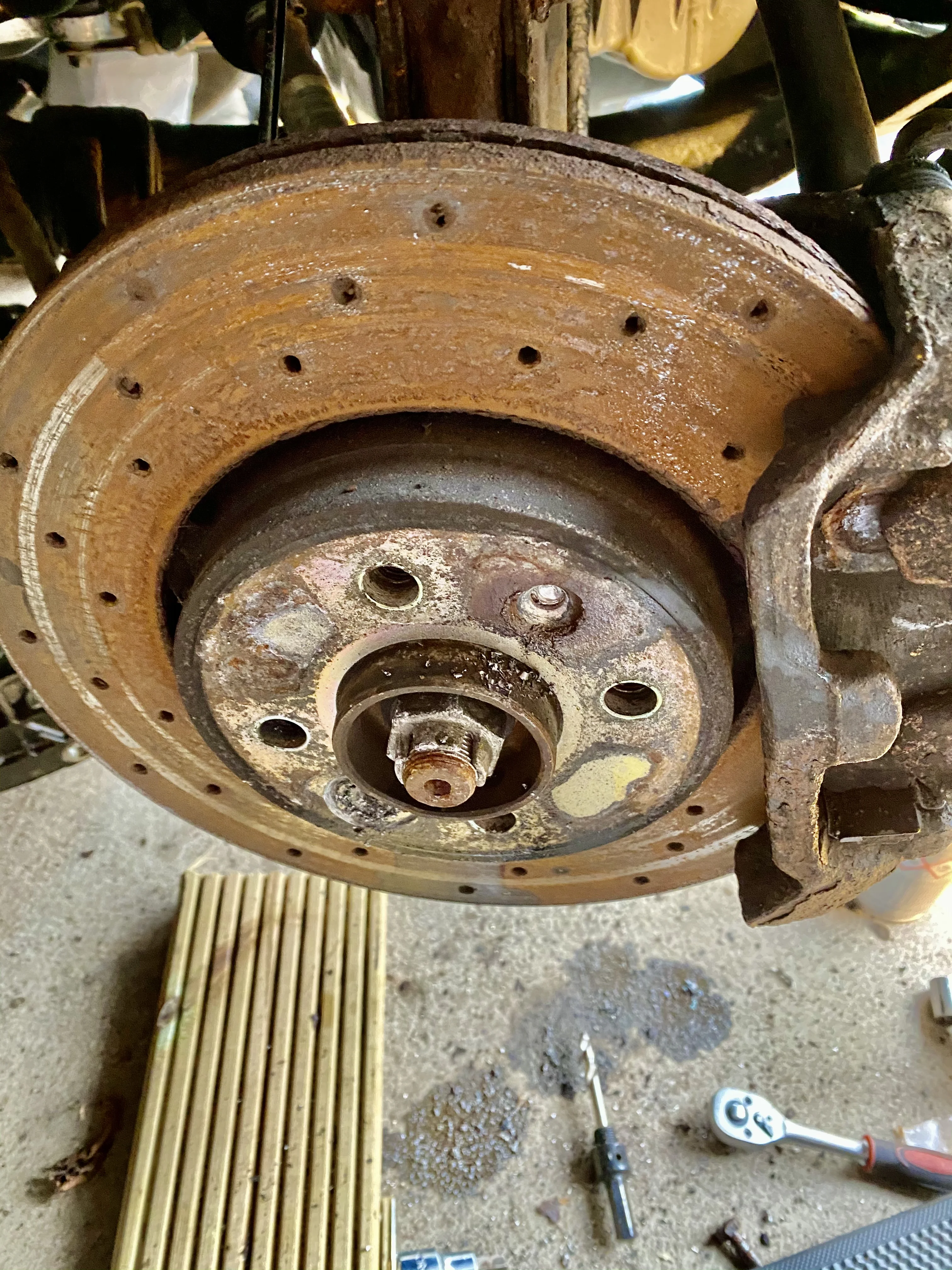

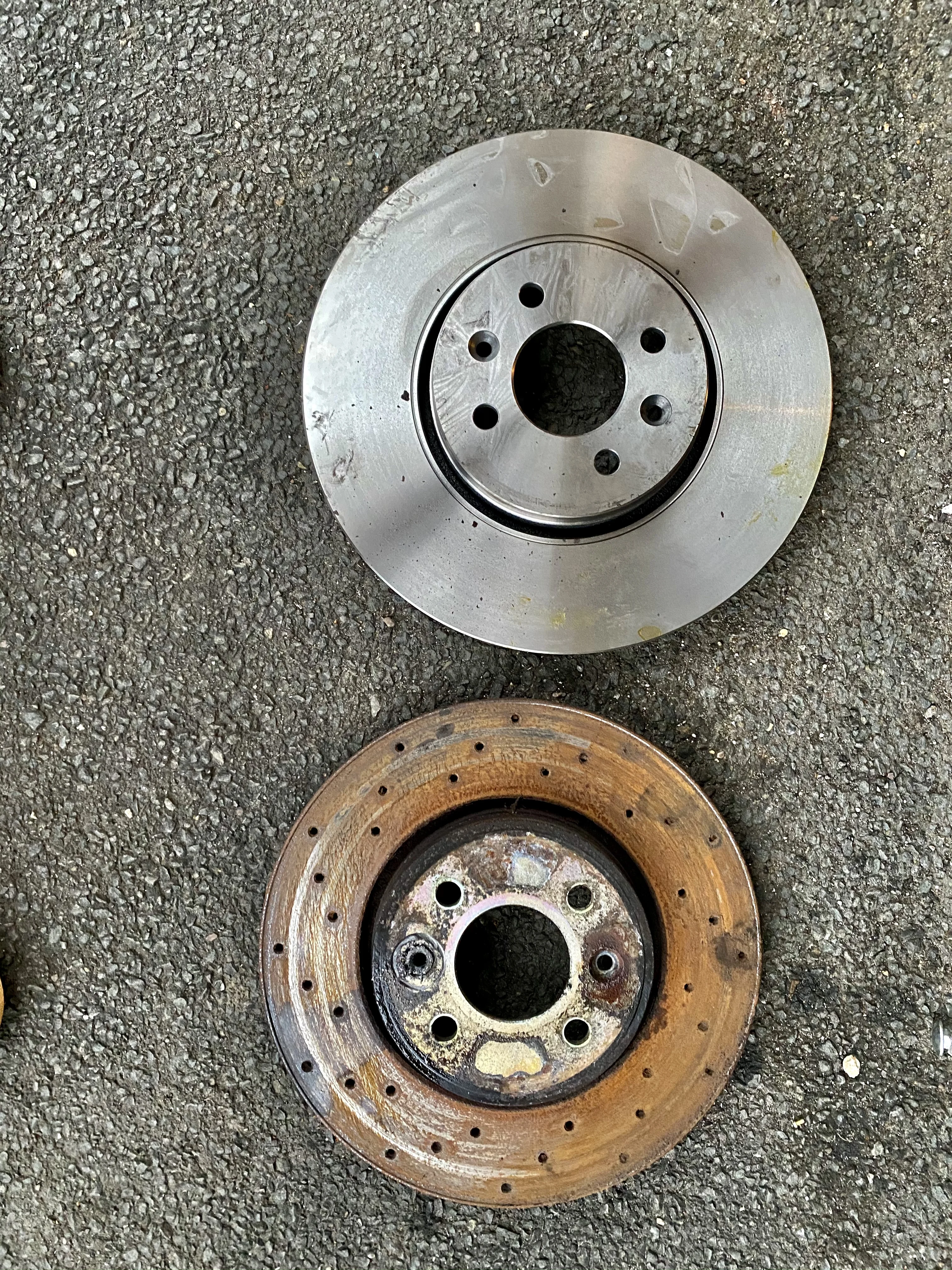

First job was to remove all the old stuff. Both disk screws gave up within seconds so needed drilled out. Must be made of cheese because a fairly blunt bit obliterated them in seconds. Rusty, yum 😋

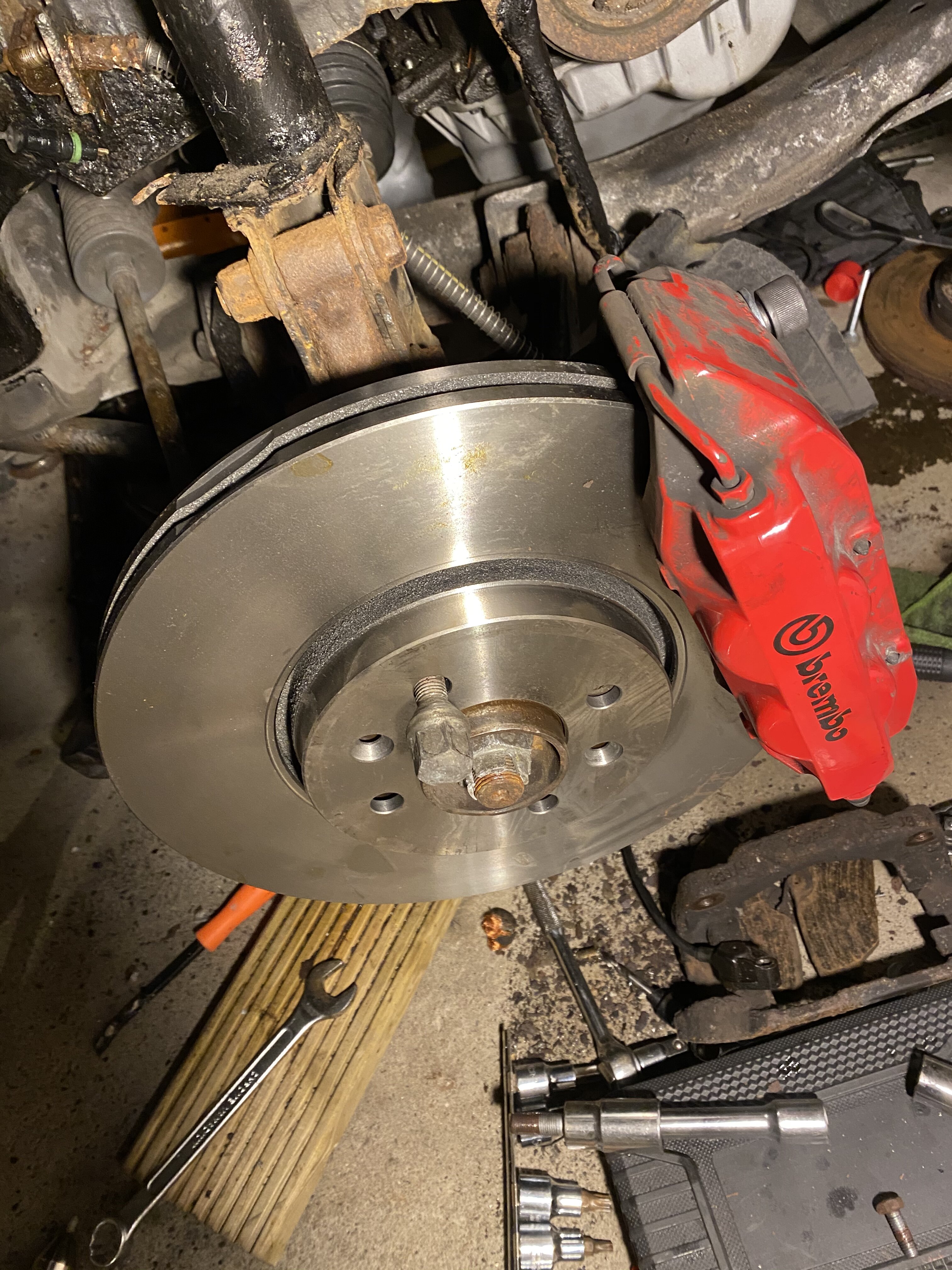

The calliper bolts needed the big bar out to help move them but came off with little argument. Brembos aren’t here yet but the brackets are so thought it would be rude not to test fit. They align absolutely perfectly. Precision is spot on. The hubs are minging too. I’ll wire brush them down at some point and get them painted up but that’s a job for a different day. If I didn’t hate track rod ends so much I’d put new ones on
last bit was the abs sensor. The car has had an on/off fault for ages with one of the front sensors. Couldn’t remember which one so decided to do both. Absolute shite of a job. The bolt died so got drilled and the sensor was basically fused into the hub. After much hammering I got all the remains of it out, only to spot the new ones from euro car parts aren’t the same. The ends are different and the plugs are male rather than female so back to the drawing board there. Also the brake lines are totally dead so going to have to cut them away from the pipe that joins to the car. I’m just waiting to see what I get with my braided hoses to work out where best to cut. Anyway, last delivery of the day rocked up, some scenic 300mm disks and brembo pads. Old vs new side by side. Isn’t much difference really.

Just make sure you fit them right:))
Try to find some smaller head screws there. Those megane oem ones are a bit too tall and can hit wheel.
yeah they are massive. Apparently they do go on though so I’ll see when I try the wheel on. If not they do standard head bolts that are a bit flatter. Clearly when fitted properly they’ll be significantly less finger tight too 😂

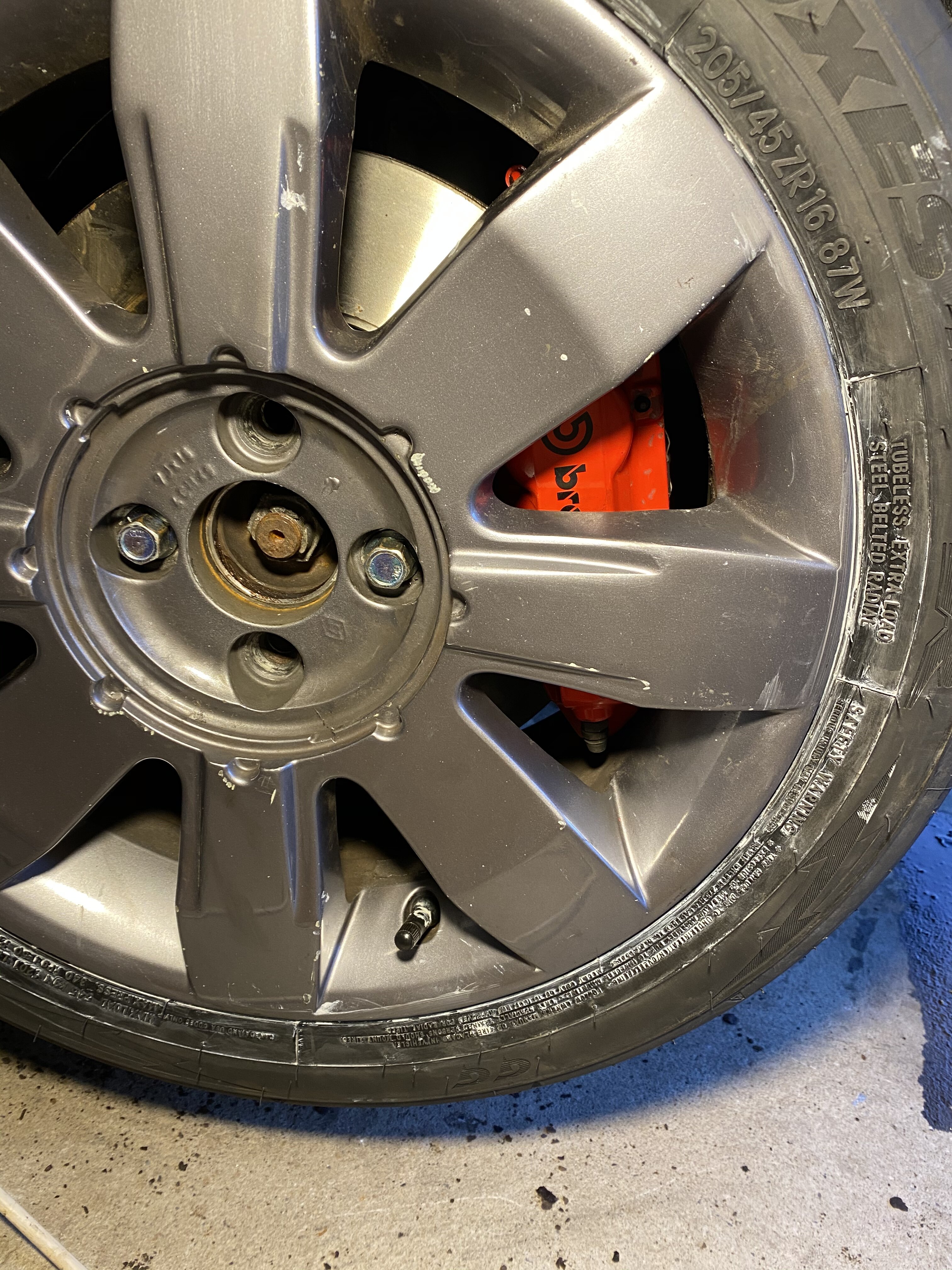

I trial fitted the other brembo today. As per the other side the abs sensor disintegrated. Looks like the reason for the fault on that side was probably down to the ring which fell to bits when I took it off. The abs sensors I’ve got are wrong so need to source some correct ones as well as a new ring.
Most people say you need to run spacers on the standard 182 wheels but they seem to clear the callipers, all be it very tight. I’ll need to source some different calliper bolts though as the massive heads are catching the inside of the wheel. Tight as a fish’s arse! No way a wheel weight will ever go in now lol
View attachment 1506083Most people say you need to run spacers on the standard 182 wheels but they seem to clear the callipers, all be it very tight. I’ll need to source some different calliper bolts though as the massive heads are catching the inside of the wheel. Tight as a fish’s arse! No way a wheel weight will ever go in now lol
I use the recesses behind the spokes to fit wheel weights.. it can be done well, sometimes need to put half the weight each side of the balance point depending on how it works with the spokes.. then when c**k on, I little smear of sealer to give some extra security around the weight...
5mm spacer is perfect, otherwise the calliper will get scuffed if anything gets in the tiny gap
perfect! I’ll go with 5mm then. Can’t wait trying to explain that to the tyre fitters 😂😂. I’ve got a set of r888r’s to go on so that’s gonna be a joy!
You got any suggestions for the bolts? Can I just use any m12x1.25 with a hex head to get the clearance on the rim or do I need something specific?
perfect! I’ll go with 5mm then. Can’t wait trying to explain that to the tyre fitters [emoji23][emoji23]. I’ve got a set of r888r’s to go on so that’s gonna be a joy!
I go with the PMS stud kit.. only bother with front studs, (never had a rear come loose) leave the rear OEM bolts. That way you have a spare set for the front [emoji12]

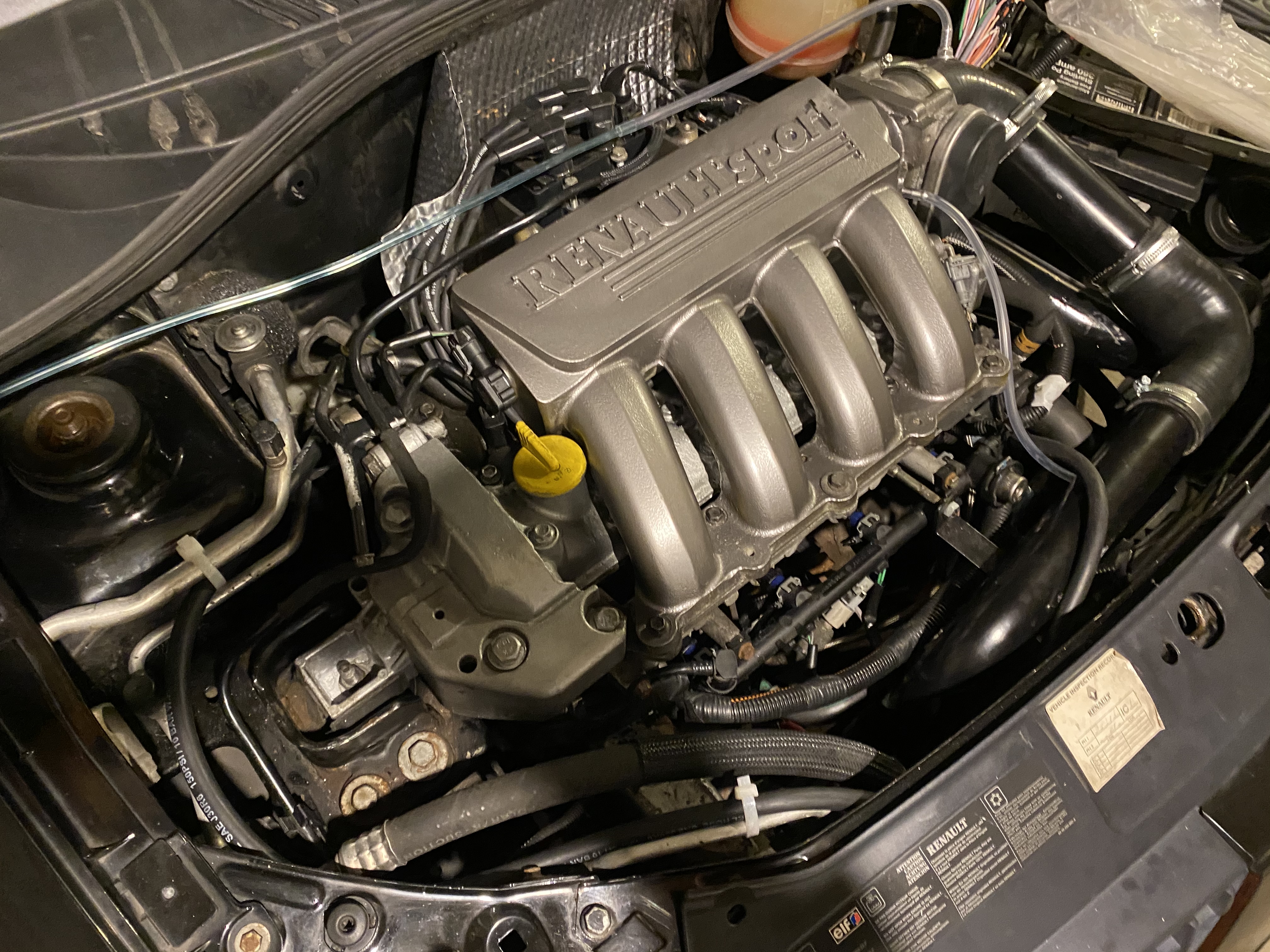

Boost control gear and ecu turned up from EFI Parts today so got cracking with getting it fitted. Chopped and spliced into the ecu loom:
next up was the ghetto fuel return 👌
Then cranked it a few times with the coil pack unplugged to build up some oil pressure. Plugged it back in and it fired up first time..... with a 3.5k idle 😂😂. Clearly something not right but looking at the photo it looks like I’ve not blanked the port to the accounting valve so that’s the first port of call to sort. Job for tomorrow now though

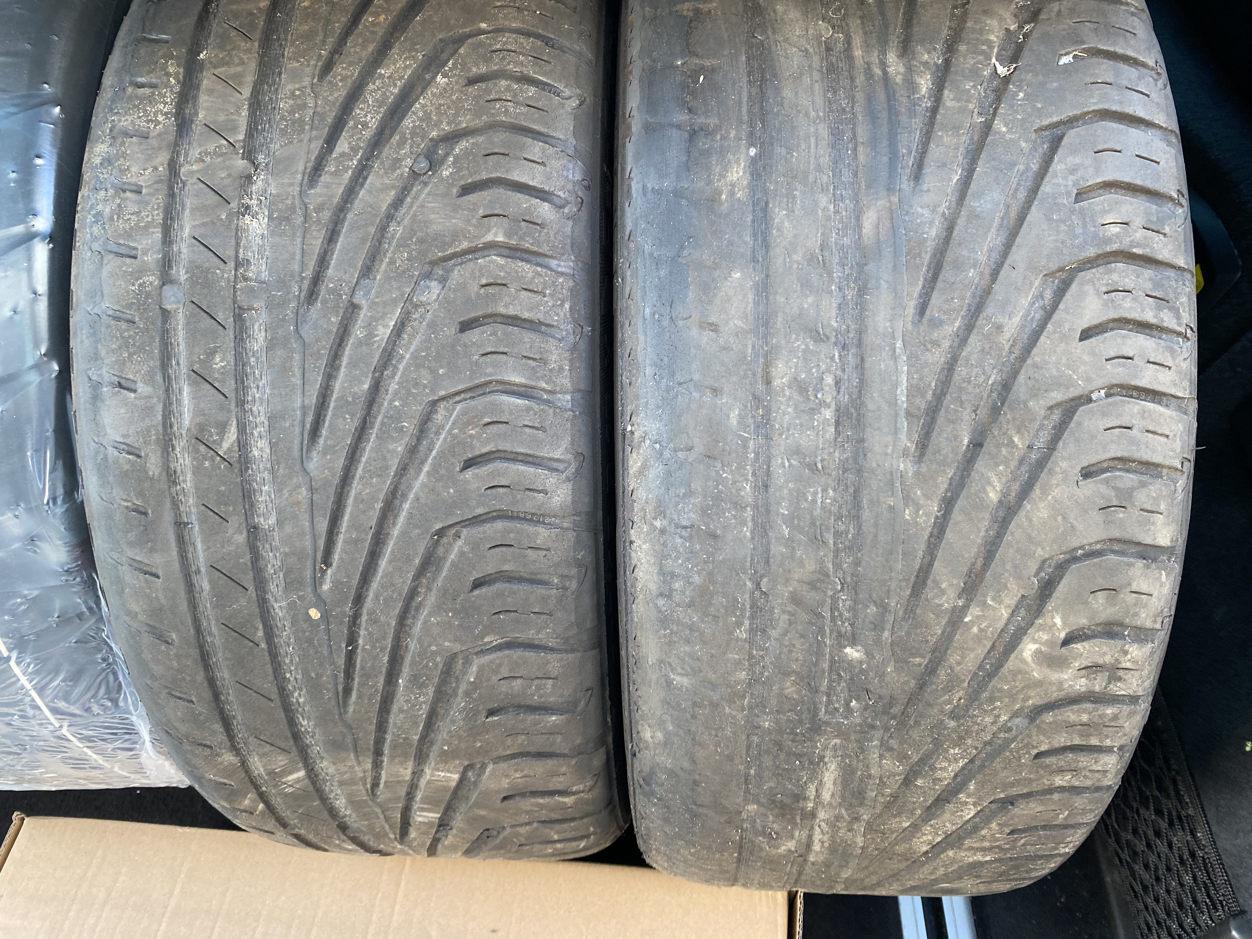

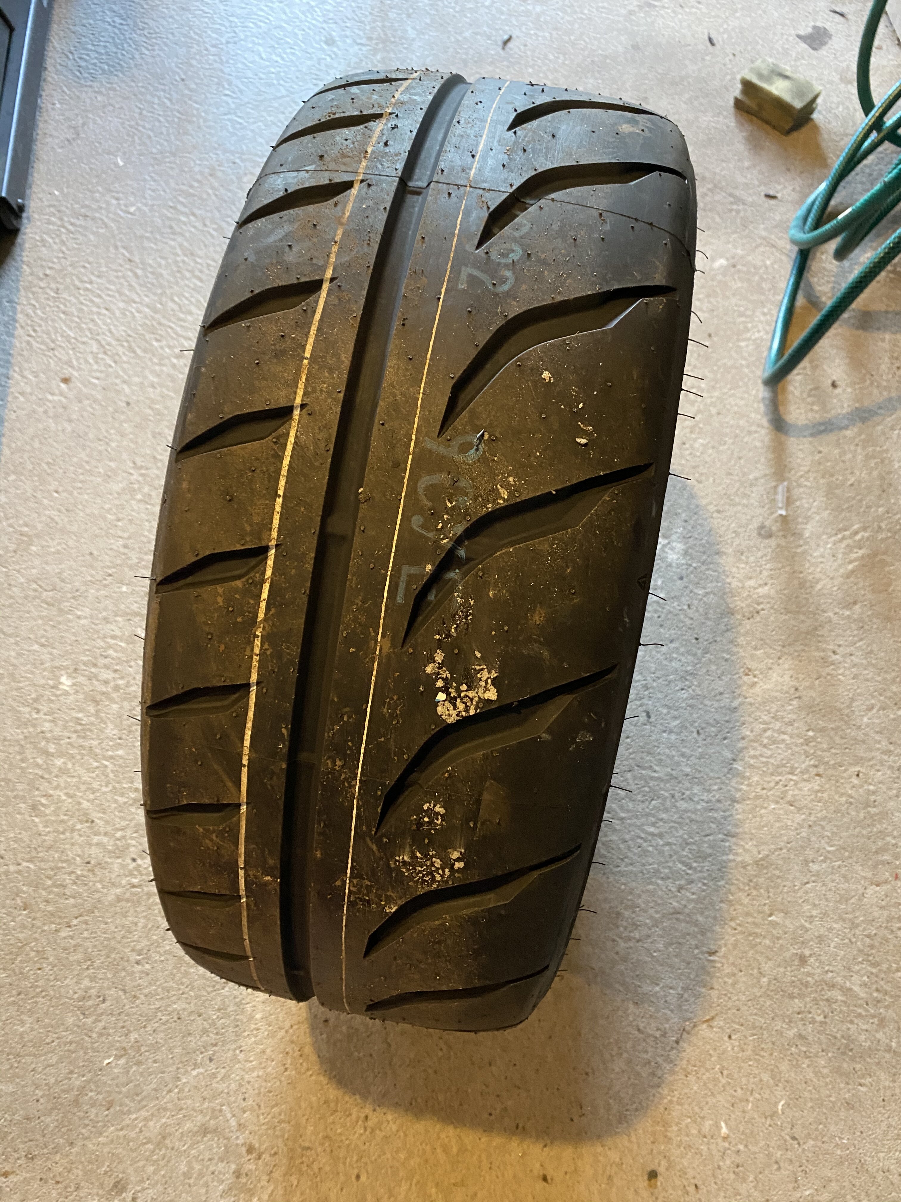

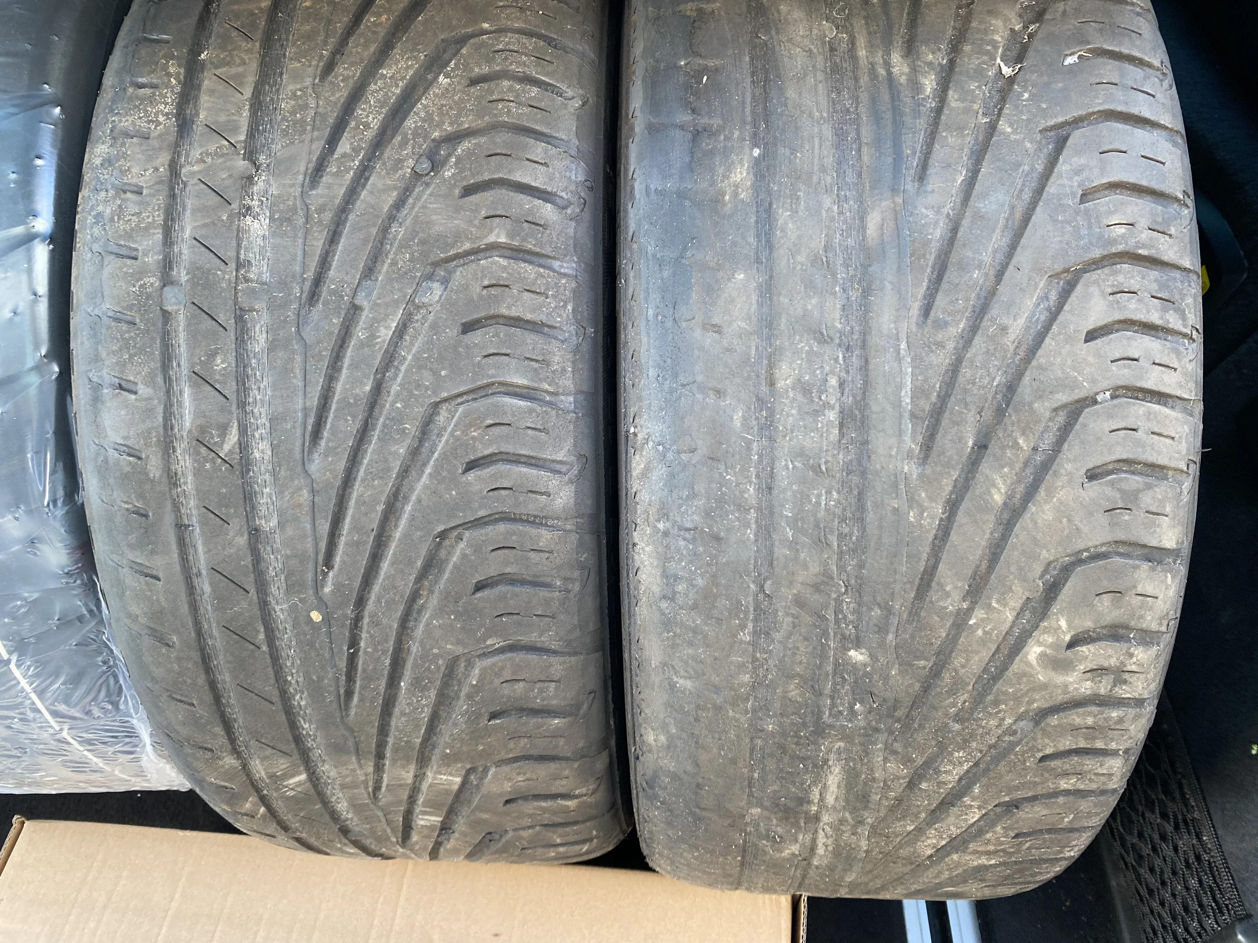

Some progress today. Got my new tyres on, the old rainsports look like they’ve been warm a few times on the drive to work 😂
New r888r’s on. Could well be s**t but there is no sexier tyre in the world

Personally I think the AR1 pips the R888 on looks because of the rim protected edge.. but after using both I find the R888 a better option, better wear!
Hmm yeah they are pretty nice too. I’ve never used these ones before. I ran the old R888s years ago on my Astra and really liked them so I hope these are decent. When it was a daily years ago the RS3s were great with it raining 3 days out of 5 up here but when it was dry they lacked any feel and always seemed that the side walls gave too much and rolled. Now it’s only ever going to get wet when it’s being washed these should be much better

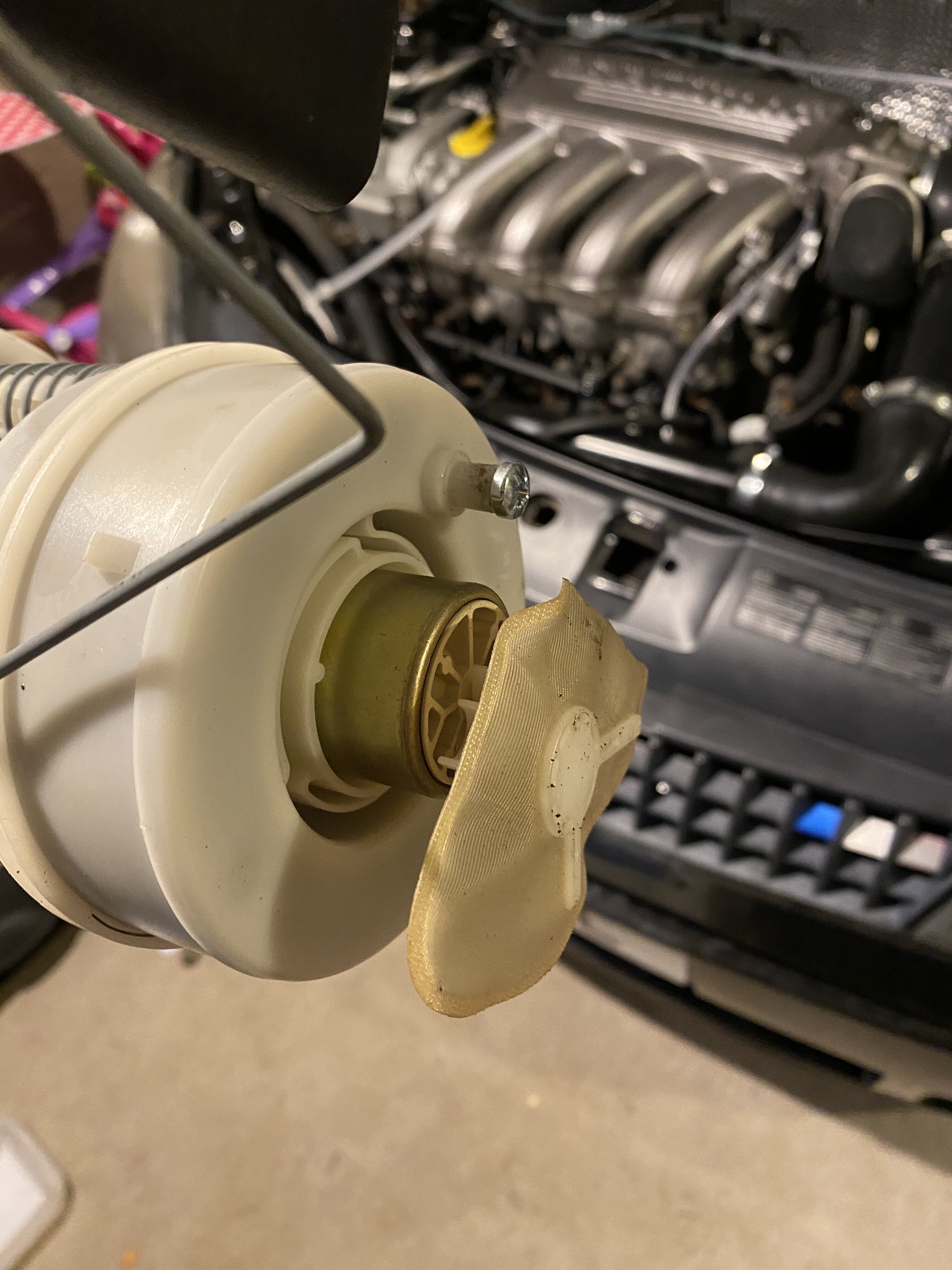

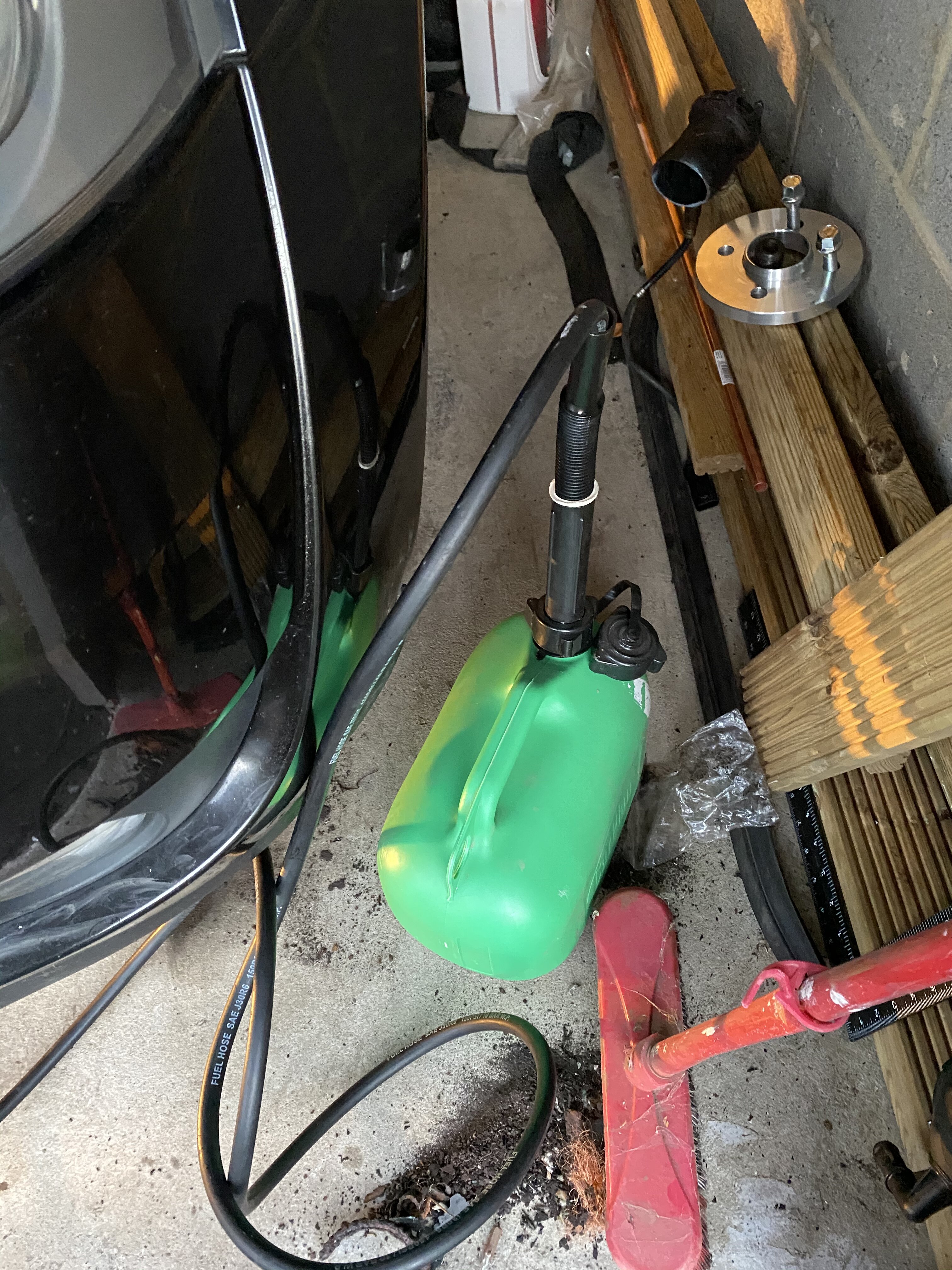

Did the fuel return today after some great advice from the good people or ClioSport.Net. Ran the return line along to the drivers side and tied it to the currently defunct ac lines to make sure it stays up and out the way of the belts. It then clipped nicely into the existing fuel line clips and up to the tank. I’ll tidy up the engine bay side over the next couple of days

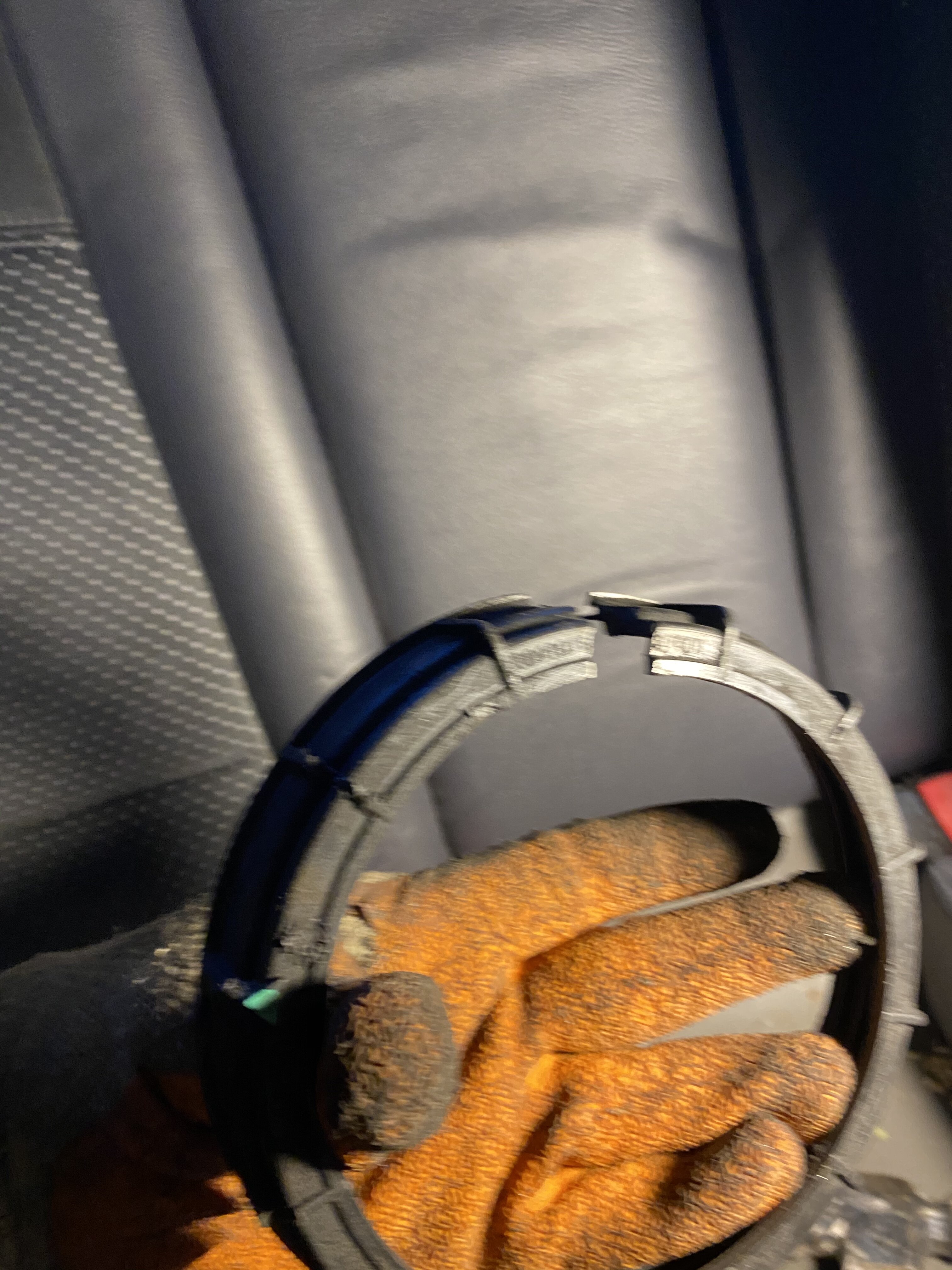

Next up was the fuel sender. The retaining ring was a t**t and wouldn’t come off. Nowt a big screwdriver wouldn’t sort 👍
Got the sender out and drilled a 8mm hole through the top to accept the barb for the return. Then stuck a m5 bolt into the hole for the fpr to block it off.
I got it all back together but by this point I was so off my tits on petrol fumes I didn’t take any more pics. I then became one of “those people” who put their Christmas decs up in November. It’s been a funny year 😂

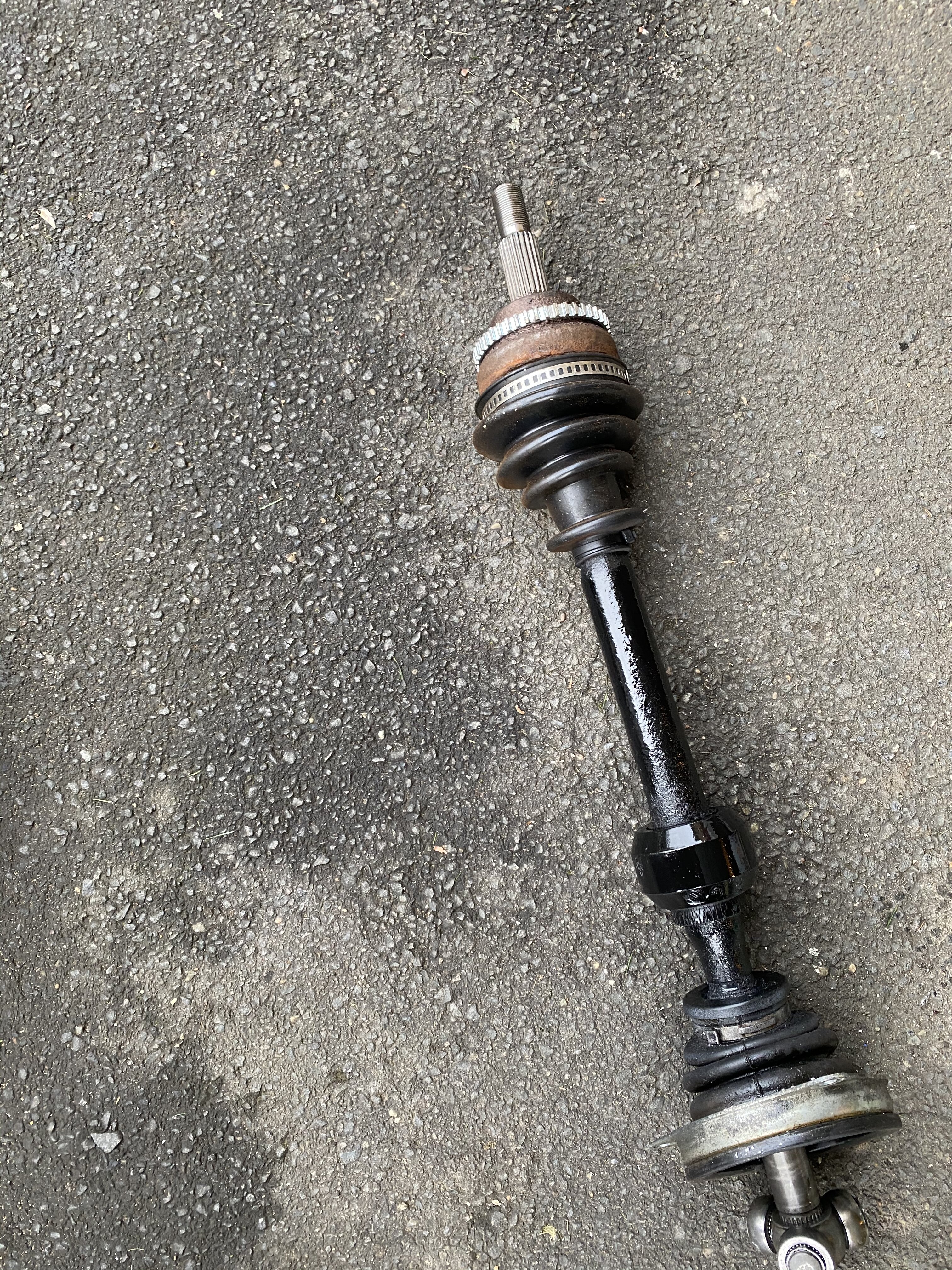

Some more work done today. I noticed last week one of my cv boots had spit so popped that off and replaced it. Stuck a new abs ring on there too
Got it all fitted back in and gave the arch a quick clean and lick of paint. Badly need to do the plastics now but that’s a job for a different day

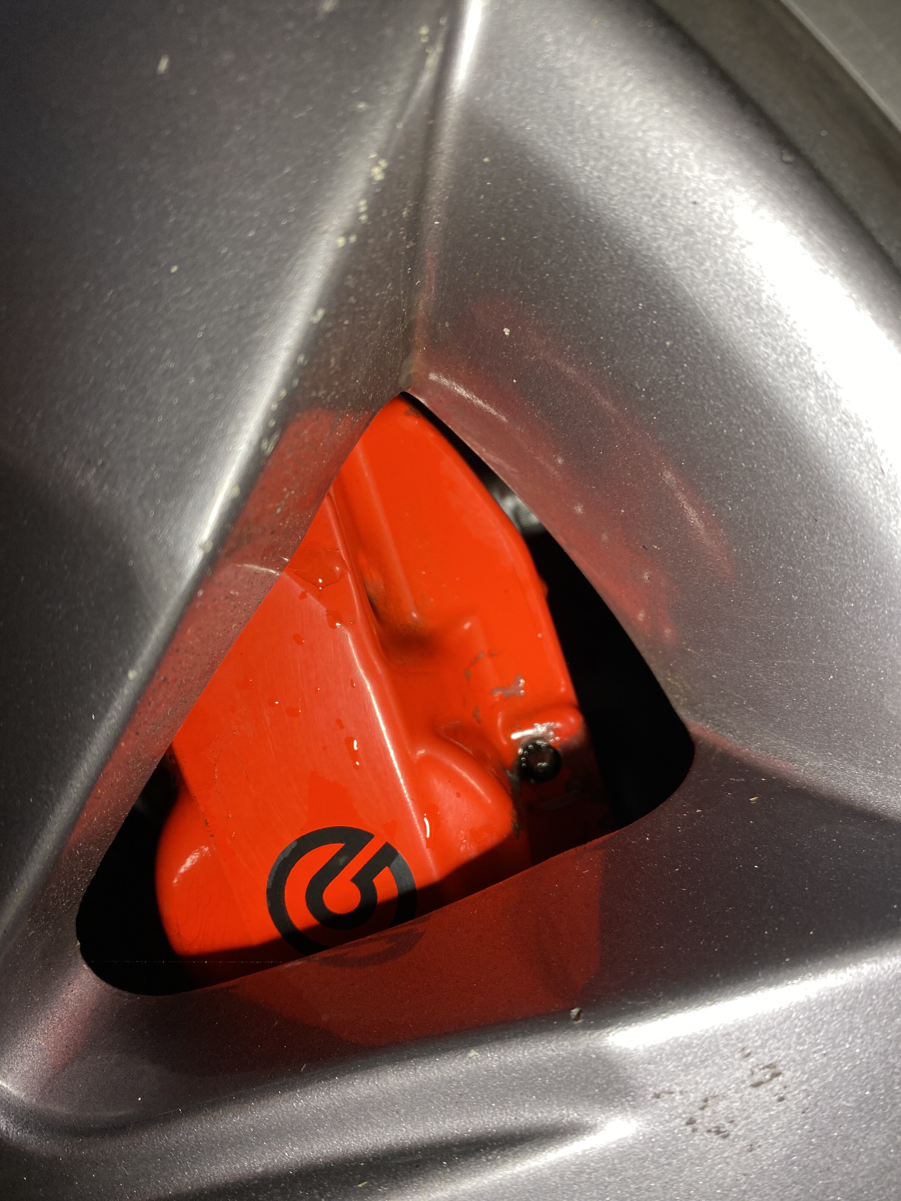

Tried bleeding the brakes again today. Used the pressure bleeder and got a s**t load of air out and lovely clean fluid. Still not right though cos the pedal will go completely to the floor still and the brakes only make a vague attempt at grabbing the disks (slight improvement on no effort after bleeding attempt 1). All I can think is I’ve let the fluid get too low when changing the lines and got air in the abs pump. Is there any way to bleed that off?
Your calipers are on the wrong side. Bleed nipples face up.
They are already a pita to bleed, but this would make it even harder.
FFS! You are very right. That’s not going to help. Stickers won’t be the way I want them now though haha

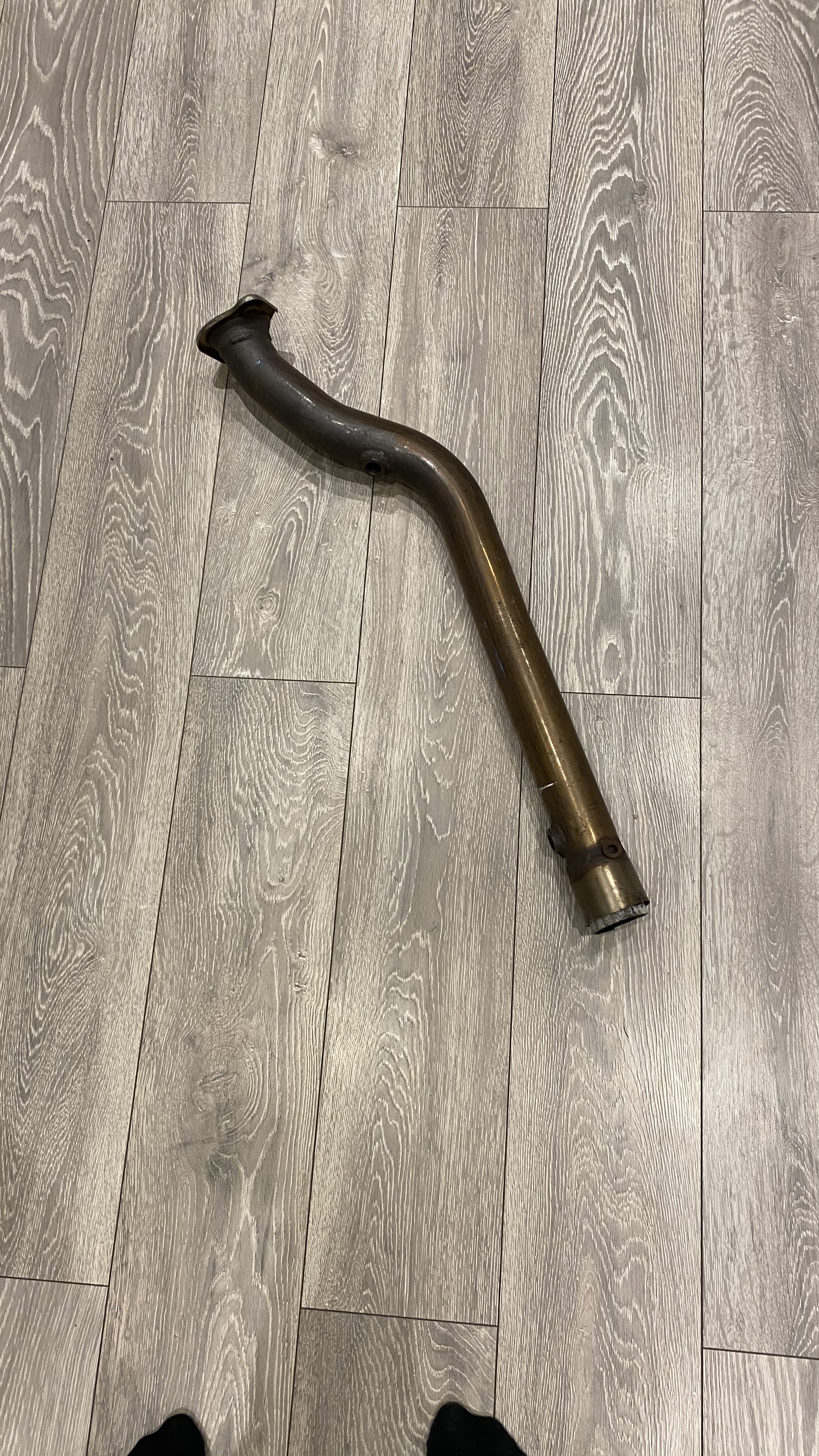

A missing link arrived today; a 172 decat. Gonna chop it down and chop the flange off the 182 decat then get a sleeve welded on to link it up. Seems like a better option that the stupidly priced link pipes and will get me moving. At some point I’ll get a 3” turbo back made up but I love the way the current KTR janspeed tips sit in the back bumper. Little bit of toe in the pic for those of you who like that kind of thing too 😉
