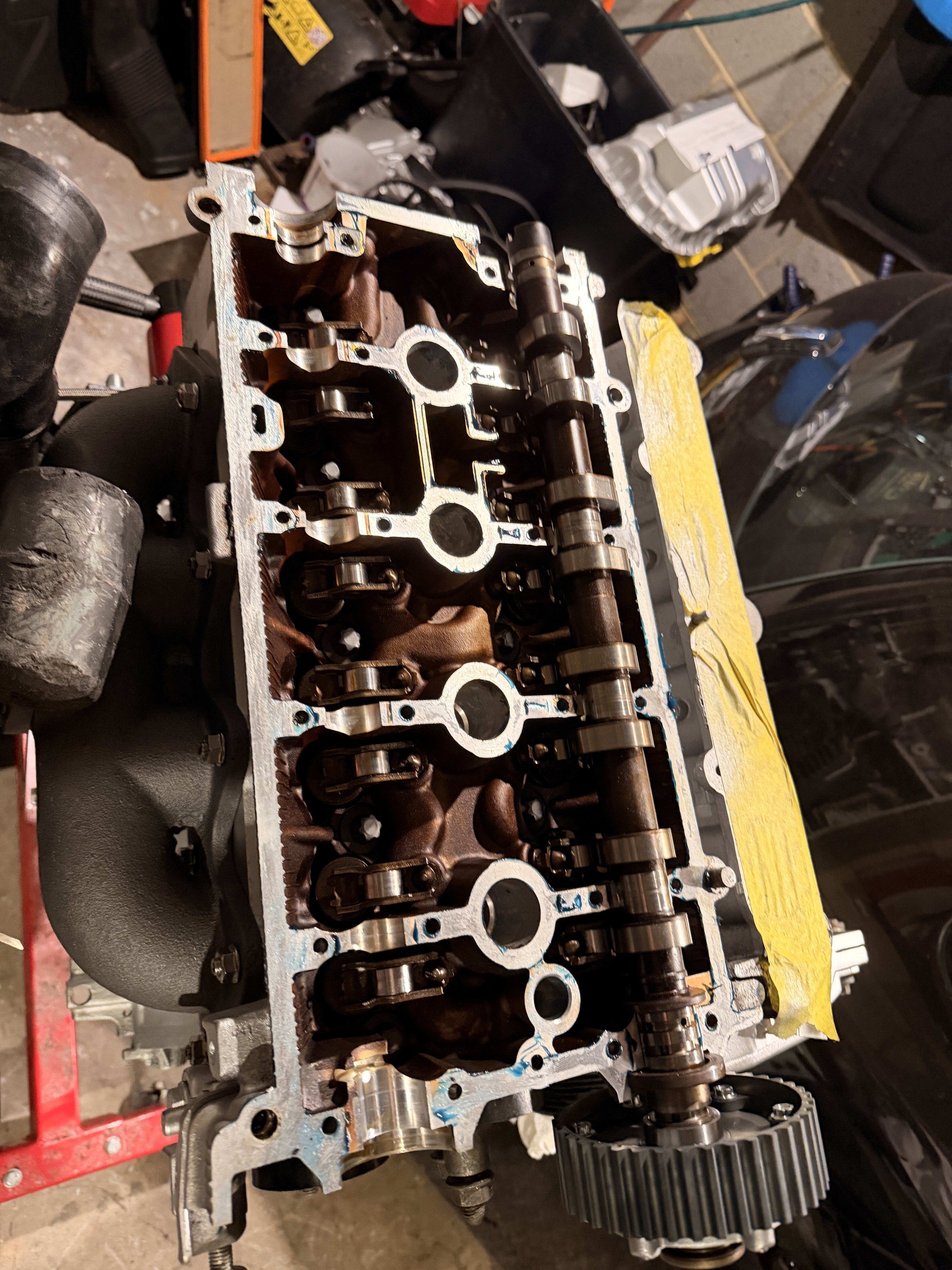

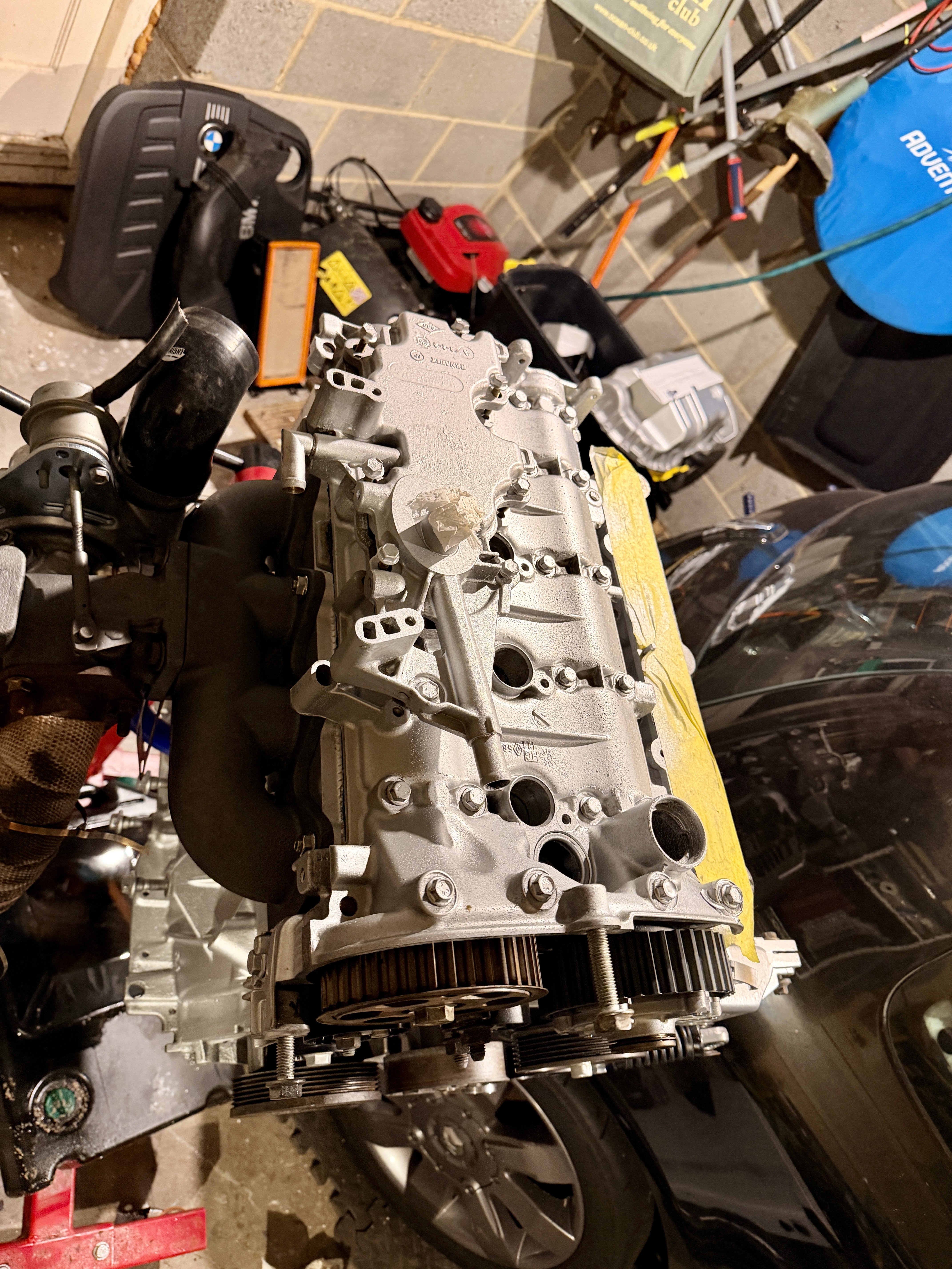

I had a bit of a panic tonight that I hadn’t put any assembly lube or oil in the head when I refitted it. I might have been being a bit dramatic but don’t really care.
Popped the rocker back off and then dumped a s**t load of oil in. As per the manual, I also submerged the hydraulic stops in diesel to re-prime them. Although it’s probably a bit of a waste of time given how long it’ll be sat but it beats them being bone dry like they were.
I did spot that I’d put the cams in the same way, so both valve sets would be open and closed at the same time. That would have given some lols come timing it up so not a totally wasted exercise.
Rocker cover back on, torqued nicely and sealed again. Somehow I lost the gasket for the oil breather plate. The one that came with the gasket set is a rectangle shape one which makes sense given that this engine is from a 172 cup and not a 182. Manual says to just seal it with that stupid blue or red s**t so will just do that instead.

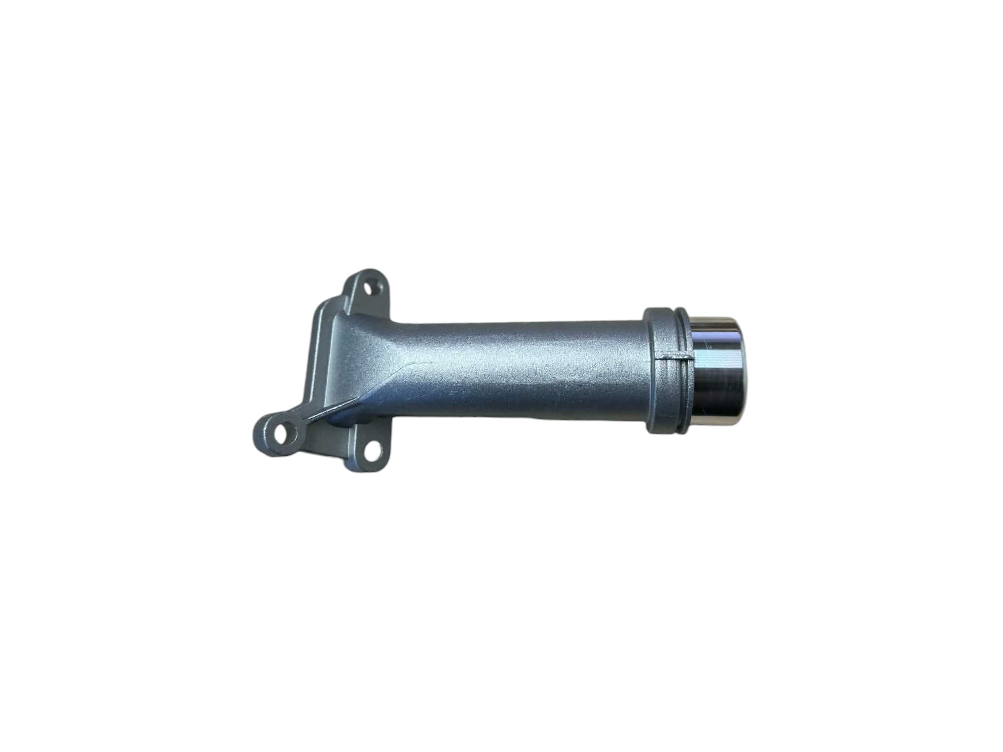

No sign of coolant pipe still but had some free time so got cracking with removing the old one.

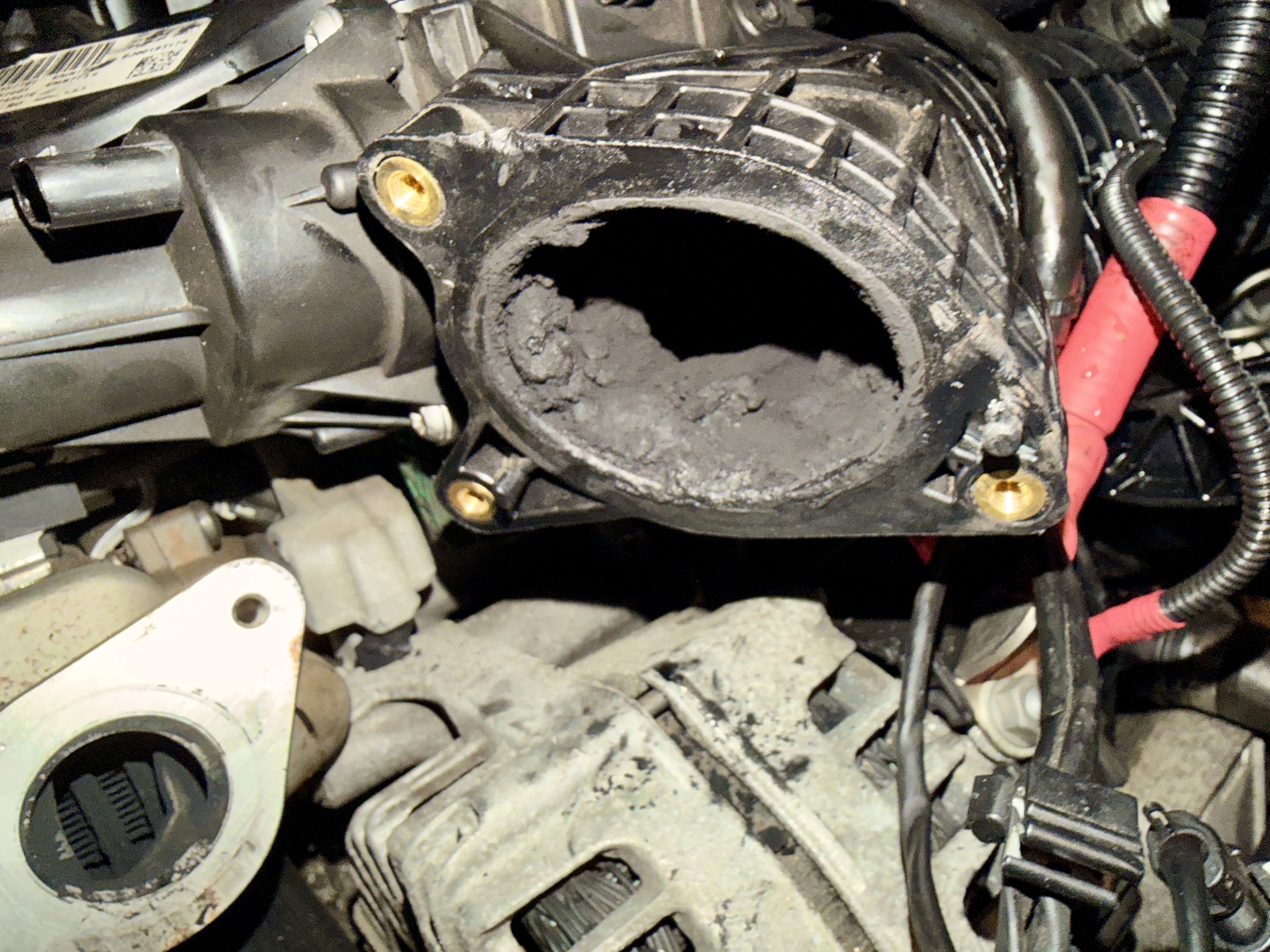

s**t job with so much shite in the way and everywhere. The plan was just to loosen the manifold and move it up enough to get the bolts out. First part of inlet popped off
That’s nasty. I’ve got no idea how it still runs 🤣
Actual manifold is the same
So yeah, gonna have to deal with that. I’ll have to take it off properly and swirl flaps can go at the same time. My go to for any cleaning is always petrol which whilst a bit flammable is always really good. The front half is sat in a pot of fuel so will see how that looks tomorrow.

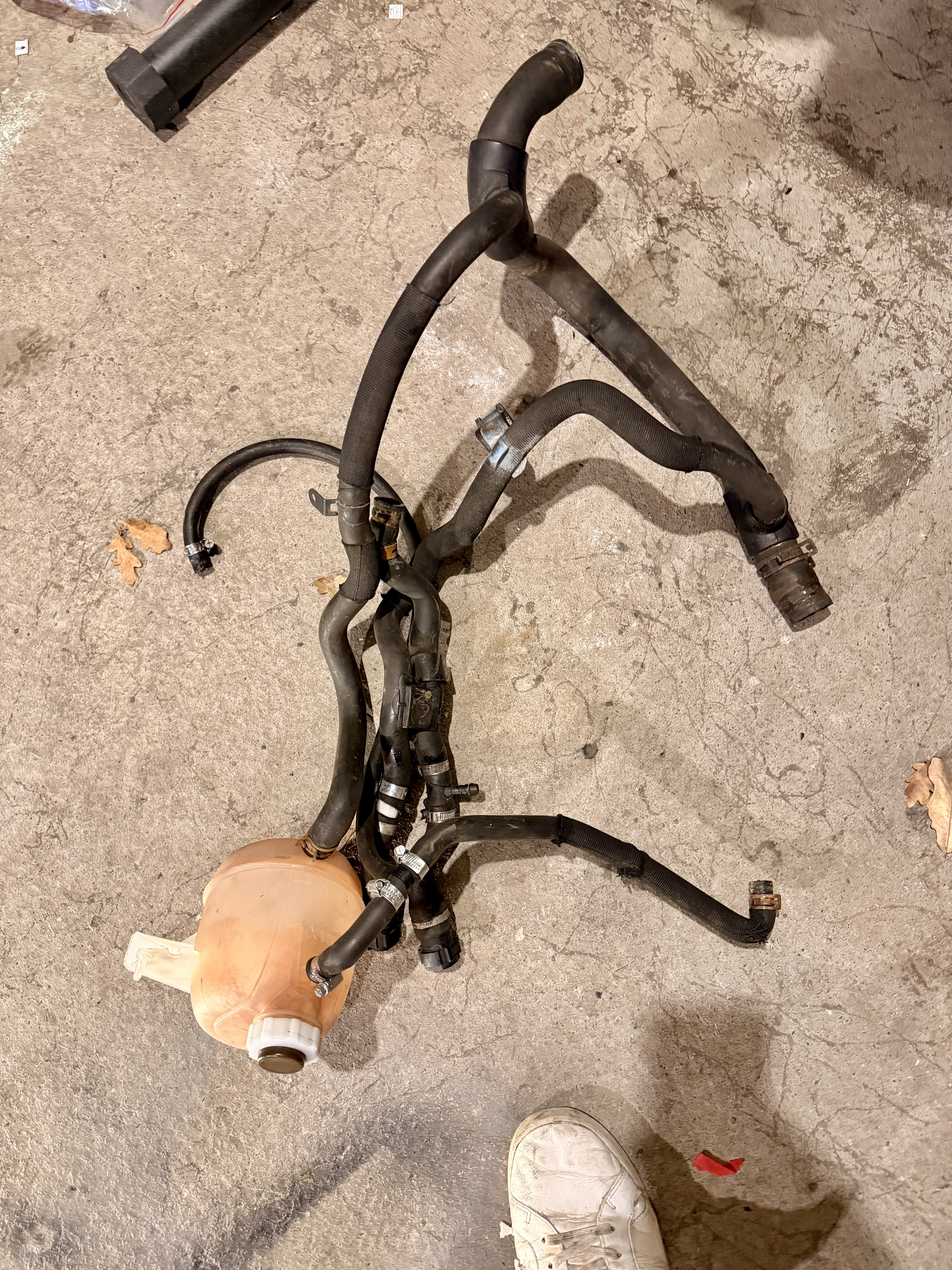

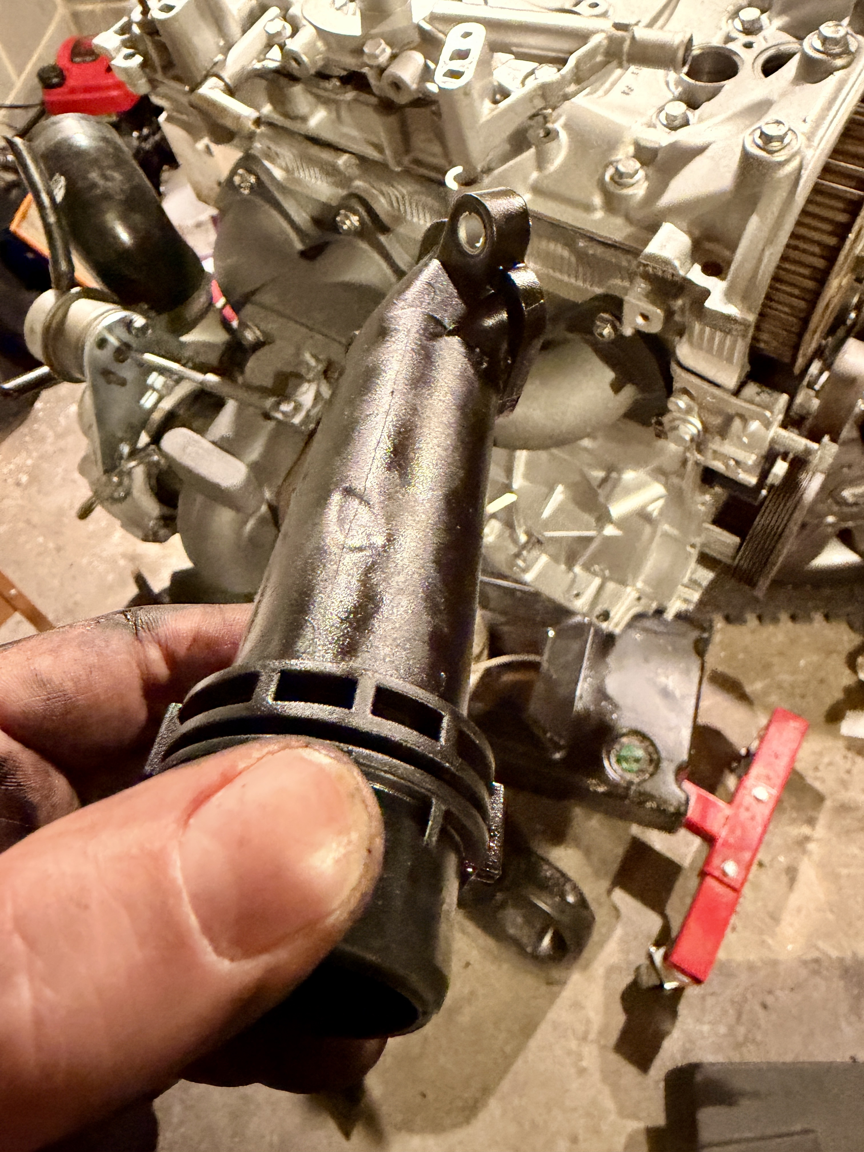

The pipe came off and it has split front to back along the entire length. It looks like a joint in the pic but it’s not. No wonder it was pissing out.
That was job done for today on that. It has made up my mind that it’s going in the new year though. I might have to try a m340d and see how that feels compared to the 5. No doubt a lot faster but can’t deal with losing too much of the comfort! Definitely going to try for an estate again too provided o can find one.

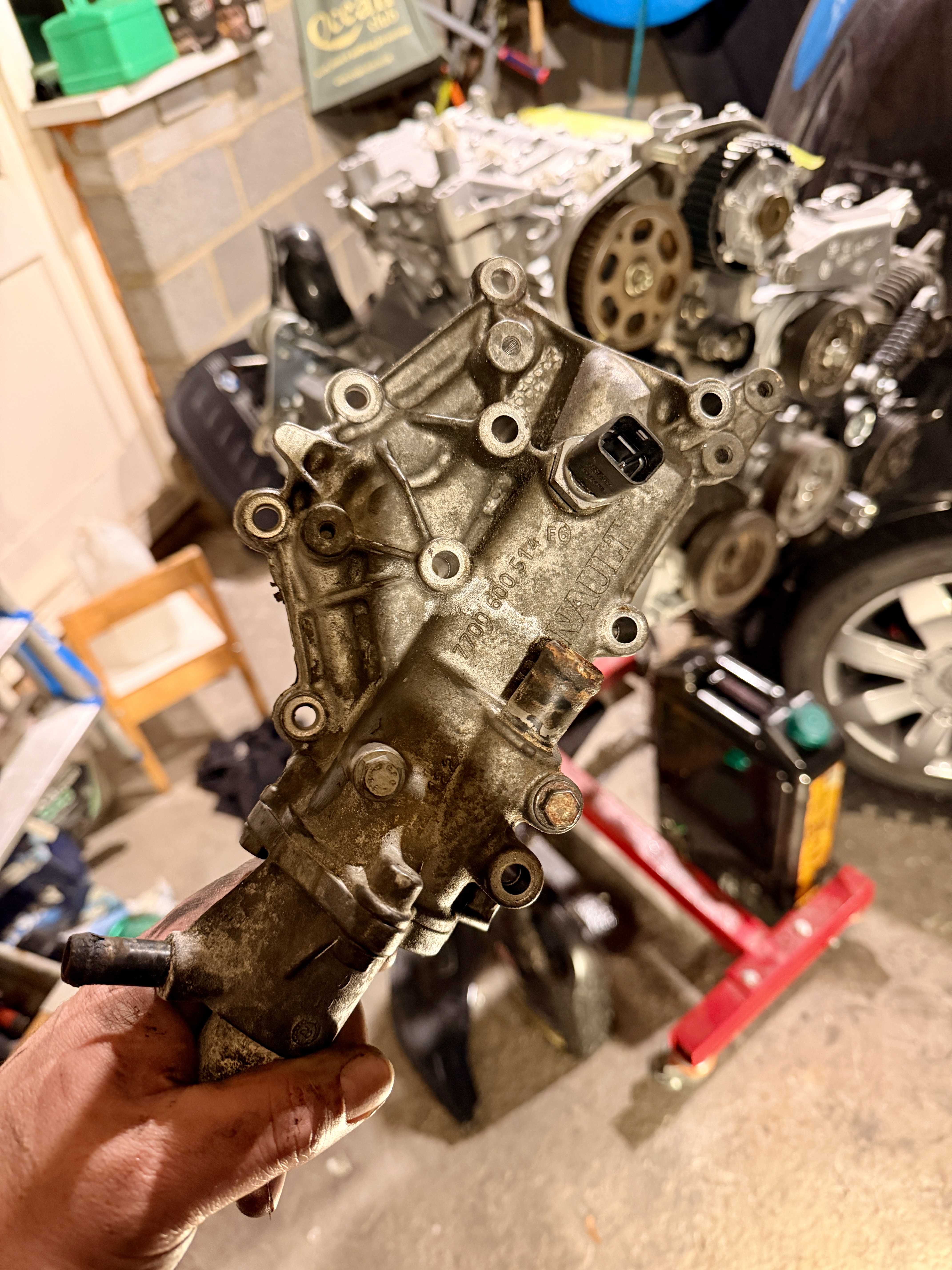

Still had some time left so attention back to the Clio. I had lost the thermostat housing so had a good hunt and found it under the car. It hasn’t been cleaned but wasn’t too bad
I also need to sort out this absolute abomination. There are loads of silicone hose sets online so I’ll replace with some of those. No idea what brand is what these days so I’ll just pic a middle price one and see.

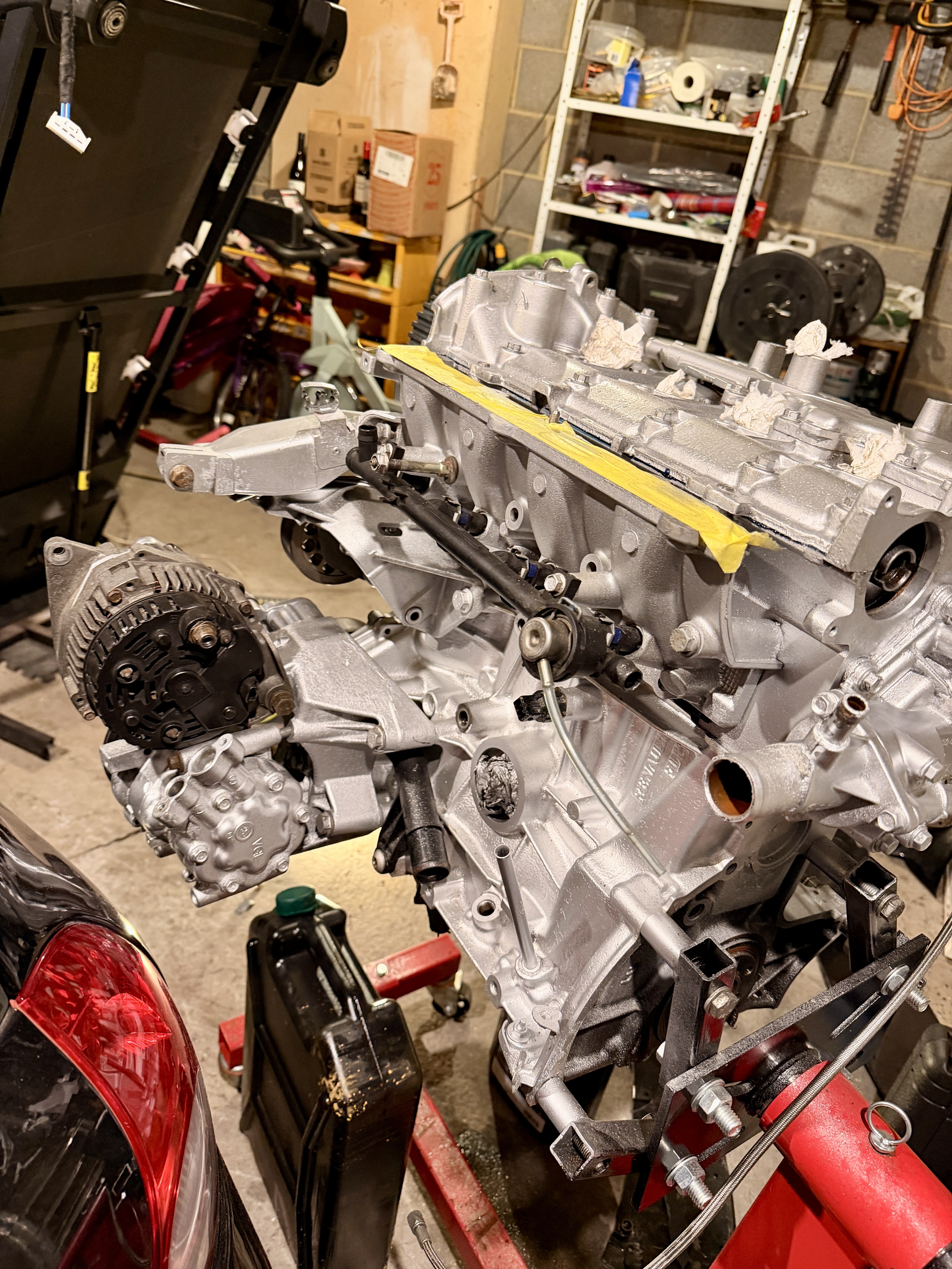

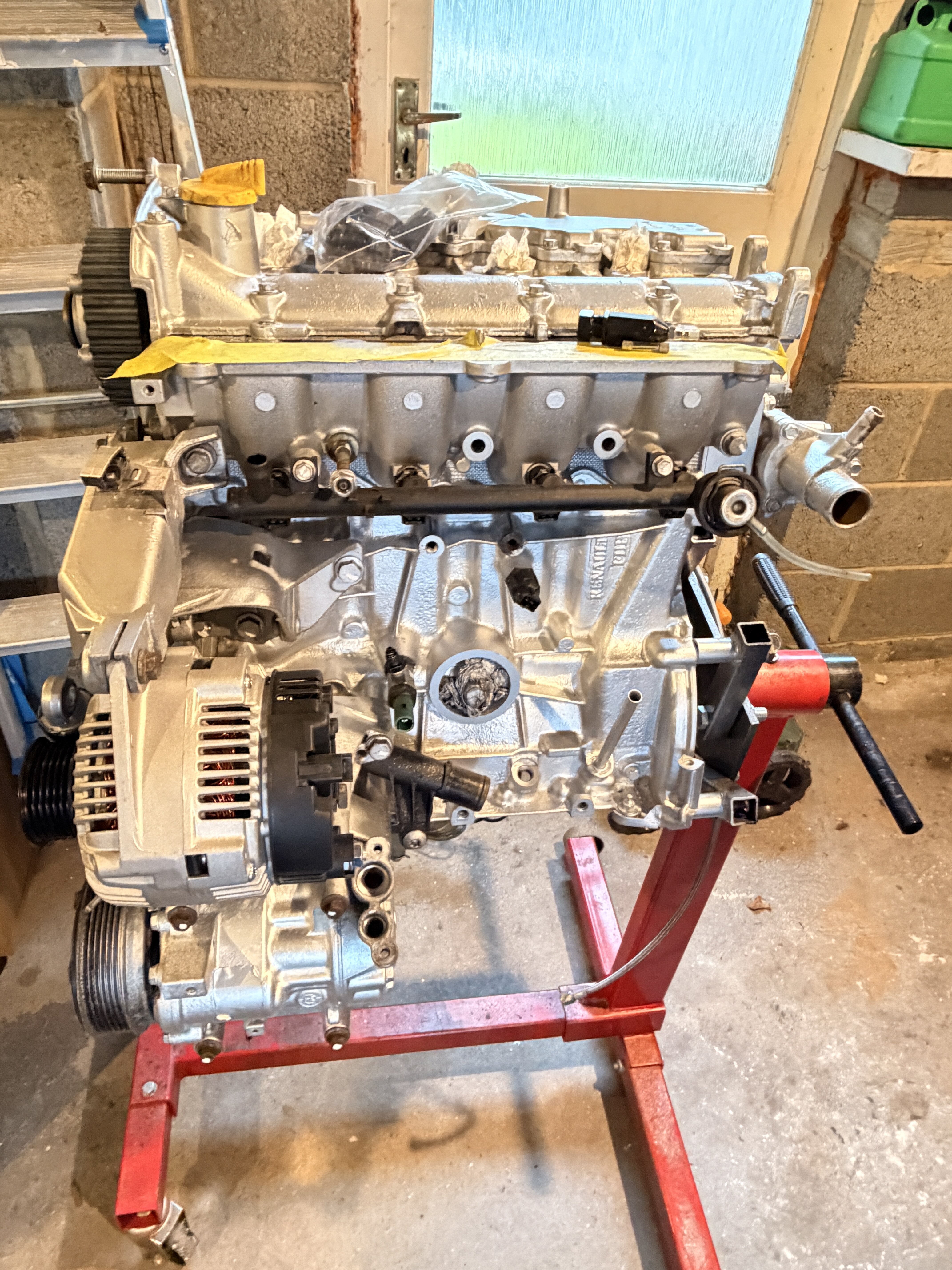

Quick lick of silver on the thermostat and it’s on. Aside from a new alternator that’s the engine built and ready to be timed up. After than it’s timing cover on, sump on, clutch on (need to order), box on and back in. Seems a shame to fit it because it looks awesome!
I might be wrong as hard to tell in pic, is the exhaust cam 180 deg out? Looks like the d is at the top and inlet cam at the bottom?
Engine is looking good all freshened up
I really need to pull my finger out and sort mine. Wouldn't bother with the 340d, next door to us at work had one and chopped it in instantly against an 840d said it was so small and just overall naff compared to his 530d. Then he went and chopped the 8 series in against a 540e estate for a tax write off🤣
Good shout. I can’t tell either and it’s too cold to go back out. Will have a look tomorrow 👍.
I did have them both the same way ( all valves open at once) and swapped it round yesterday so I think it’ll either be right or both 180 out. Pistons are all sat mid stroke in the bores so can spin them without drama if needs be

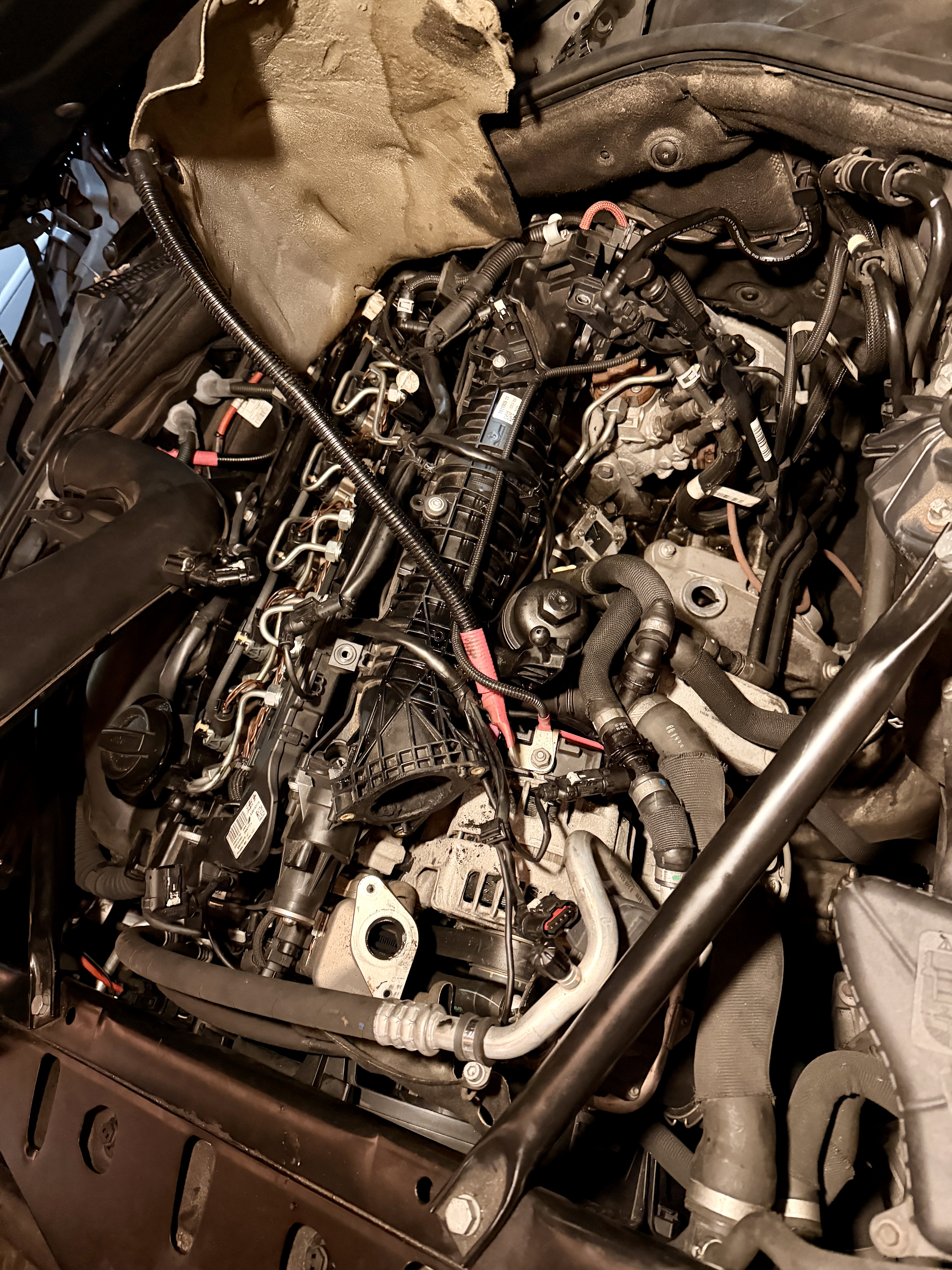

Did some 5 series’ing today.

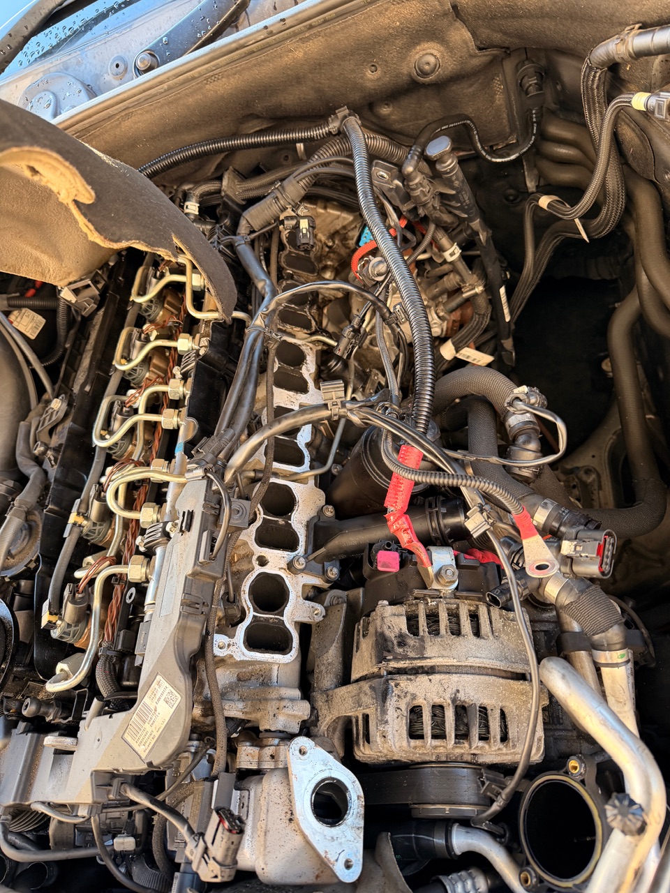

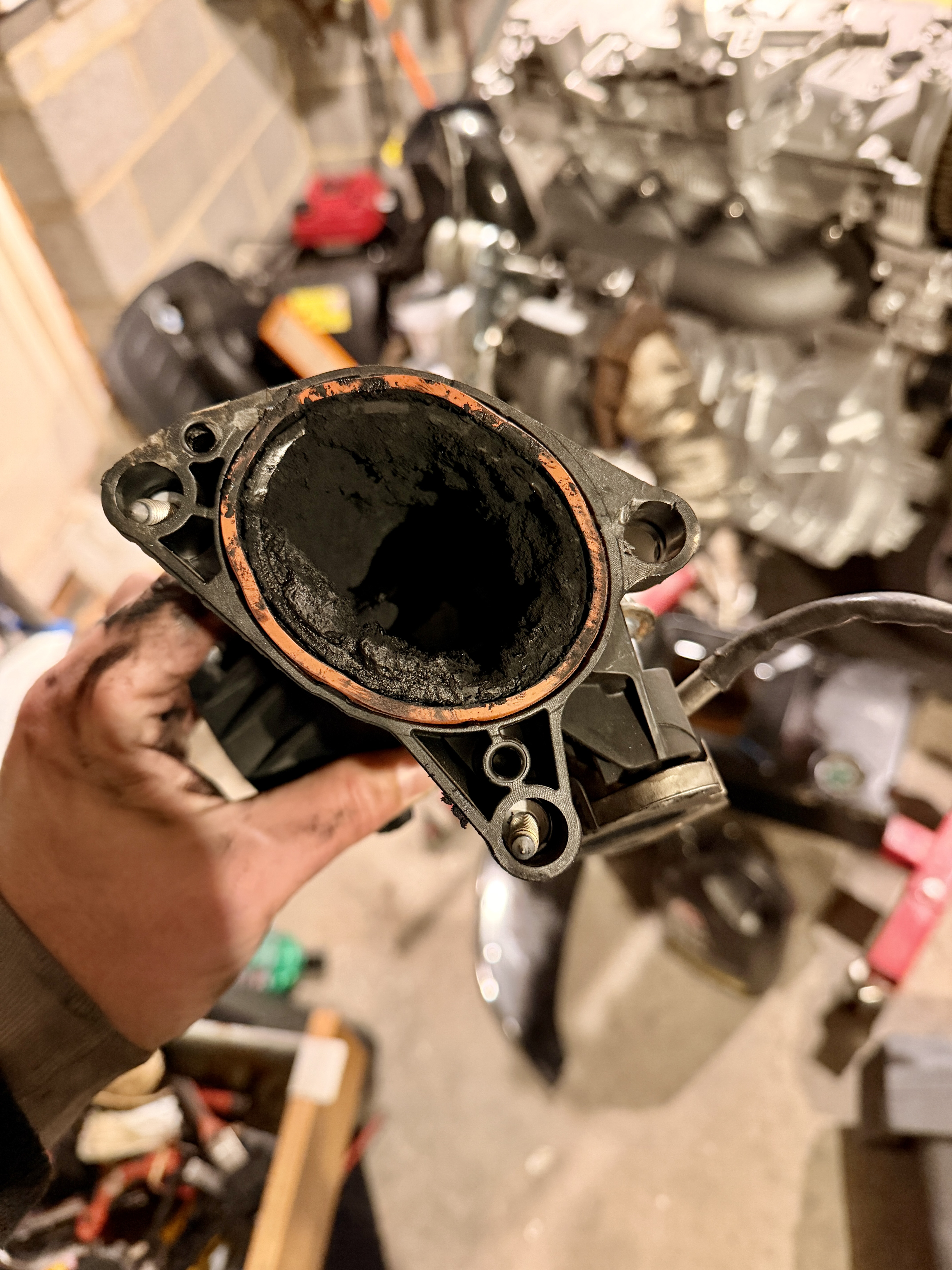

Started by finishing the removal of the inlet manifold. Such a f**k on with all the wires running across it.
As with the previous pics of the first bit, this was also massively coked up with more of that beautiful thick oily/tarry mix. Excuse the really odd contrast settings, it’s the only way I can get the inside to show properly
Carb cleaner didn’t touch it so I scraped most the chunks off with a screwdriver and jet washed the rest out. It came up pretty well
Then when putting it back together I spotted I’d pulled the wire out of one of the plugs that goes to the alternator which was highly sub optimal. I thought I might have still had the engine loom from the 5 series I broke but it’s only the interior one I’ve got.
That left one option of repining it with some new wire. Plug stripped down to components
Then back together with a new length of wire
I then soldered that onto the remaining length of pulled out wire and sealed it with a bit of heat shrink.
No more pics but that was it back together. Honestly, what a difference after cleaning all that up. The idle is much smoother, it’s much much quieter and as far as a mapped 530d goes, it was absolutely flying on the test drive. Throttle response is better too. It’s a completely different car. I’d highly recommend any of the 30d people on here to do the same. It’s a s**t of a job but well worth doing!

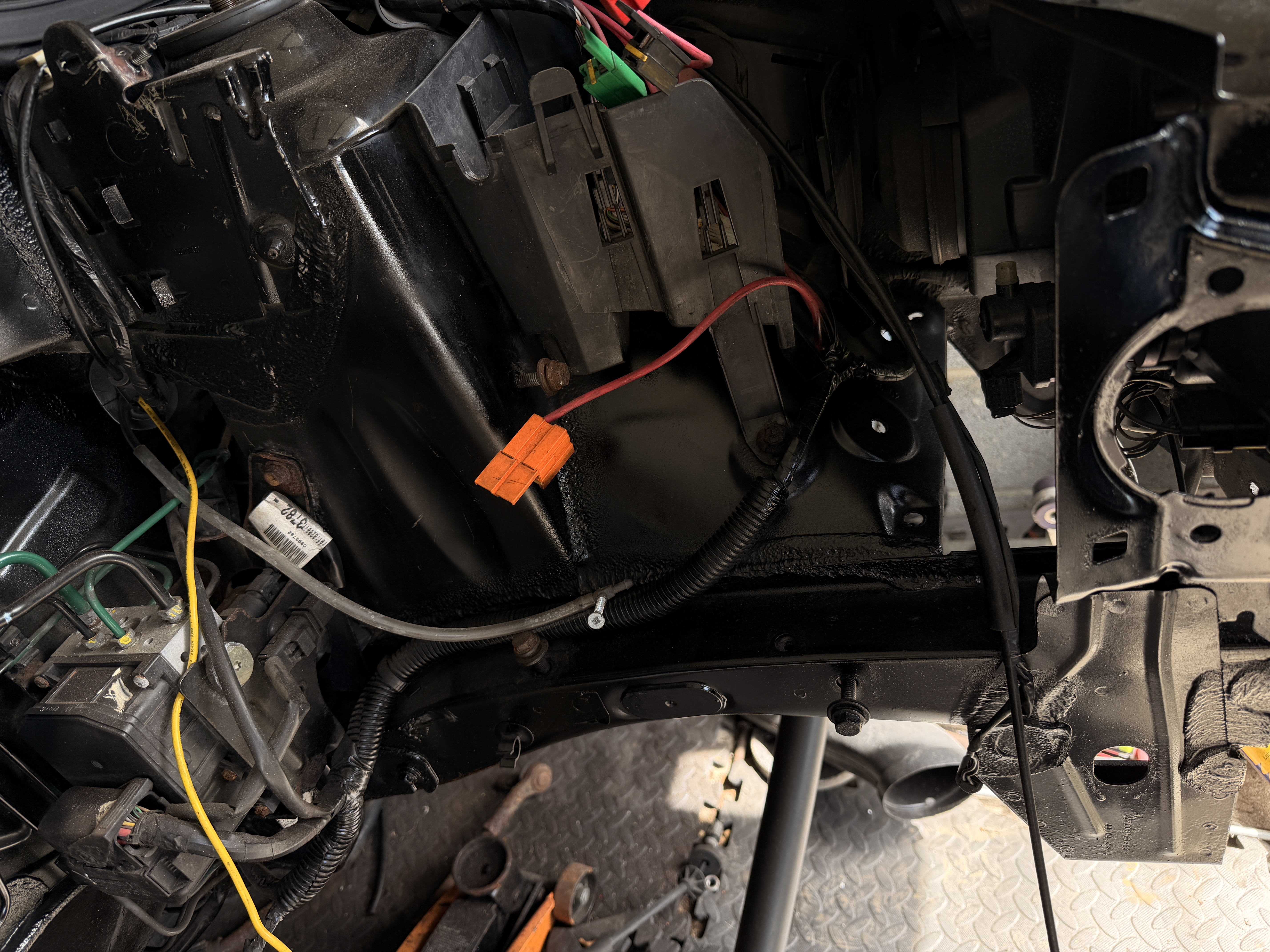

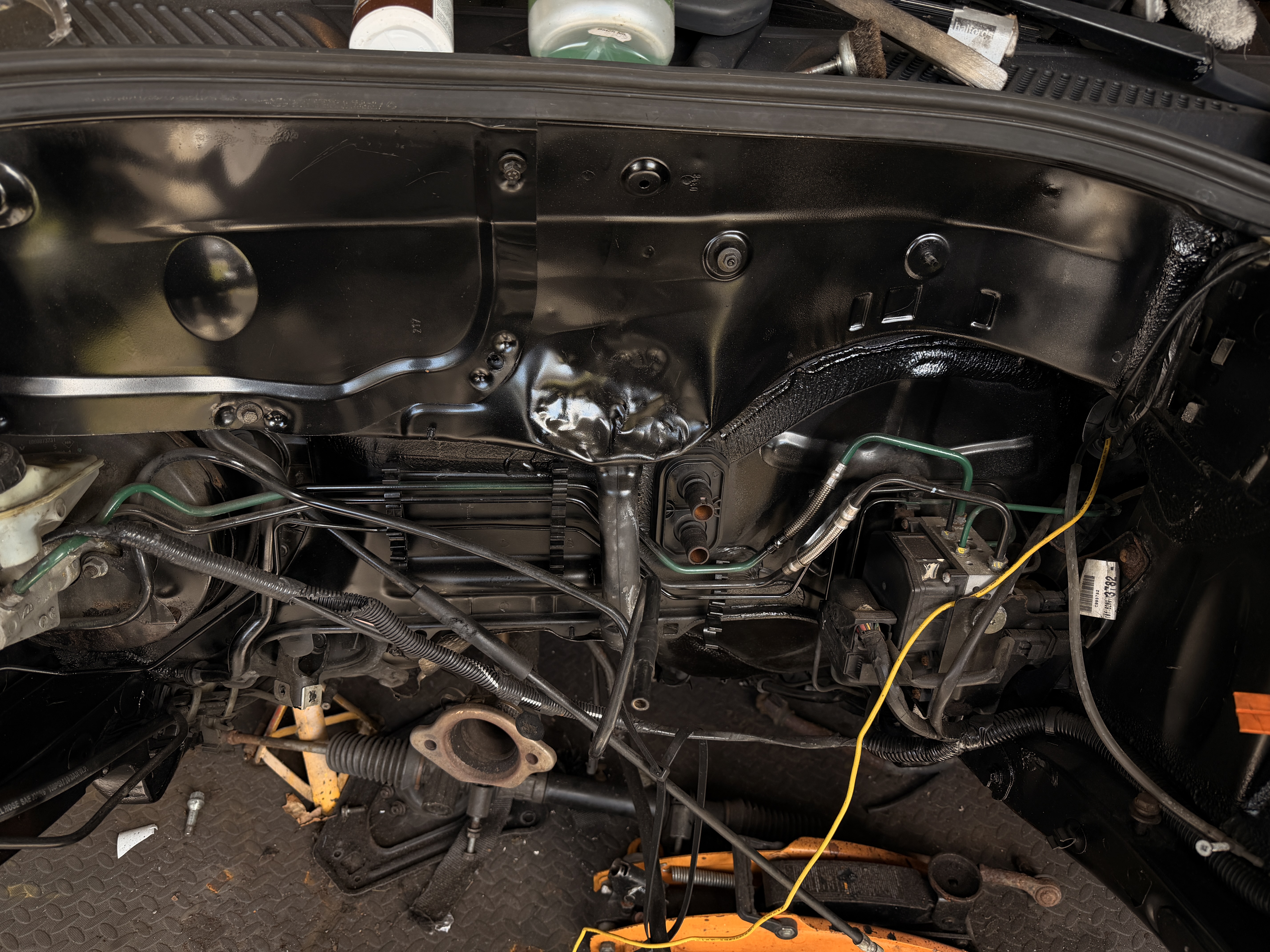

Whilst I was there I put a bit of black on the bits of the bay that were in primer. None of the rust that was there has come back through so my rust treatment and anti rust primer have done the job nicely. I should probably finish painting that wall too.

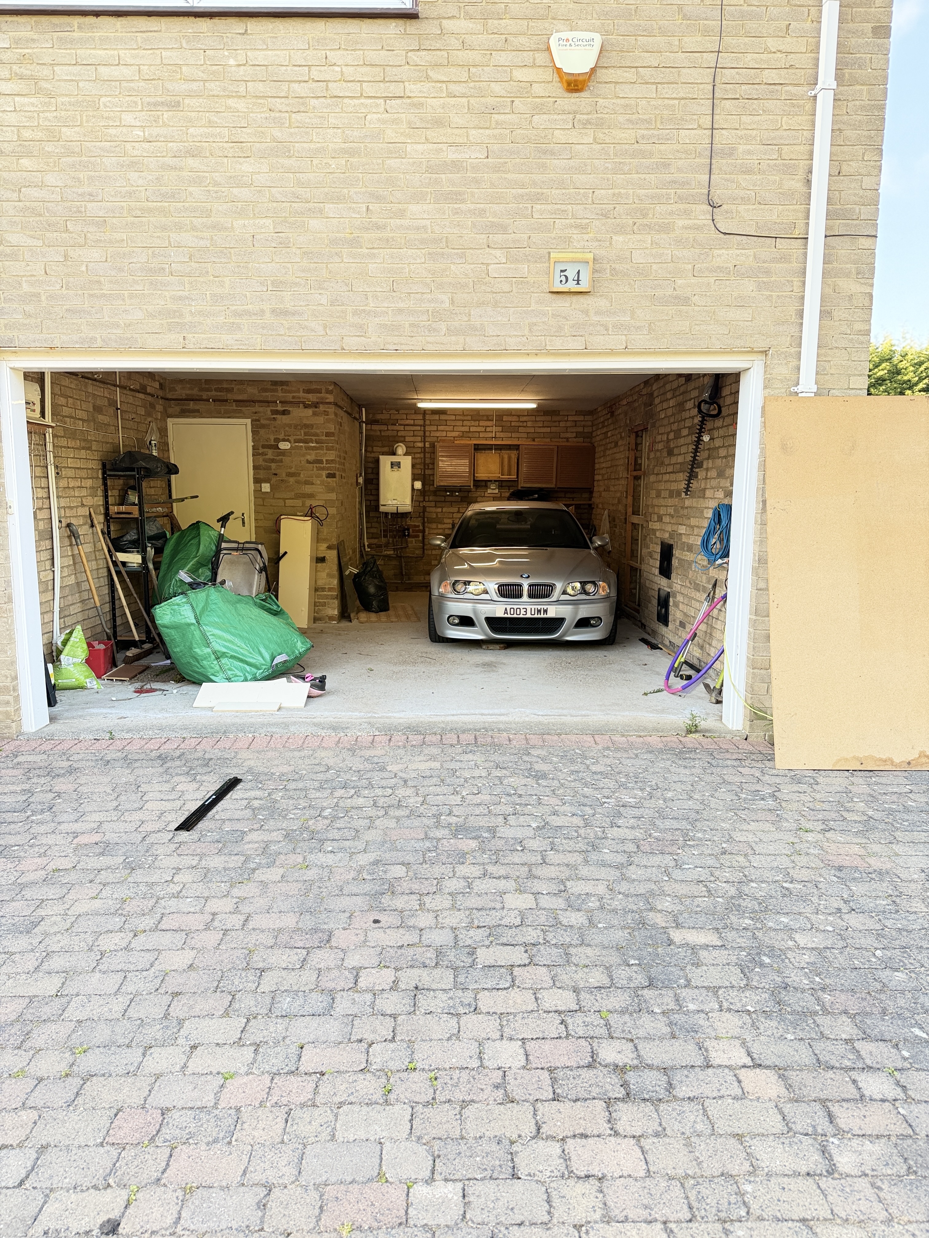

On the plus side, the M3 now has a house all to itself. That garage will be converted to a snug (that will be quite big and not that snug) with a new 6m x 6m garage built on the side of the house. Got to make the most of my £1,003 a month council tax bill!
It’s also still not had its MOT after it expired at the start of March because can’t be arsed to book it so should probably do that at some point too.

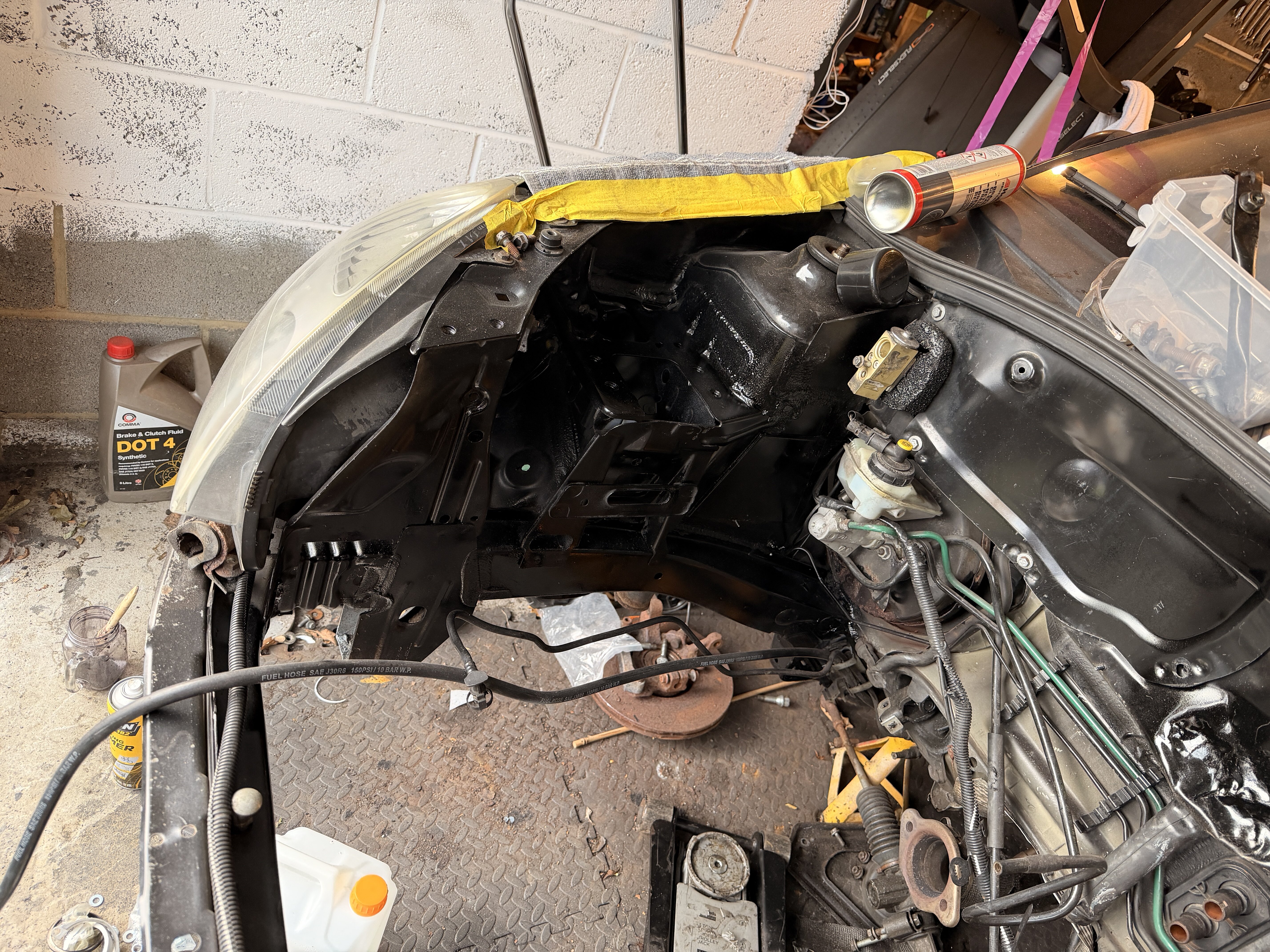

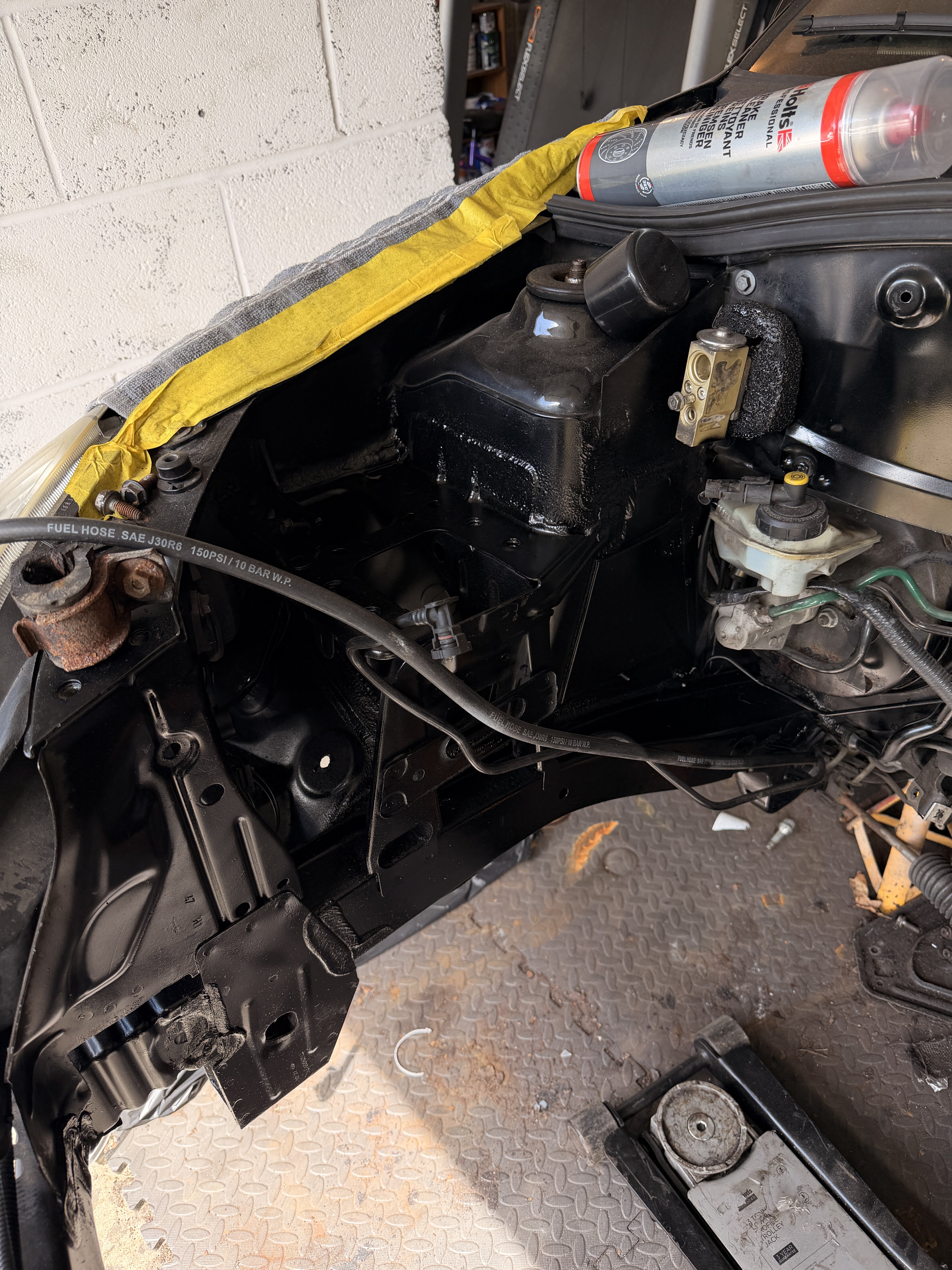

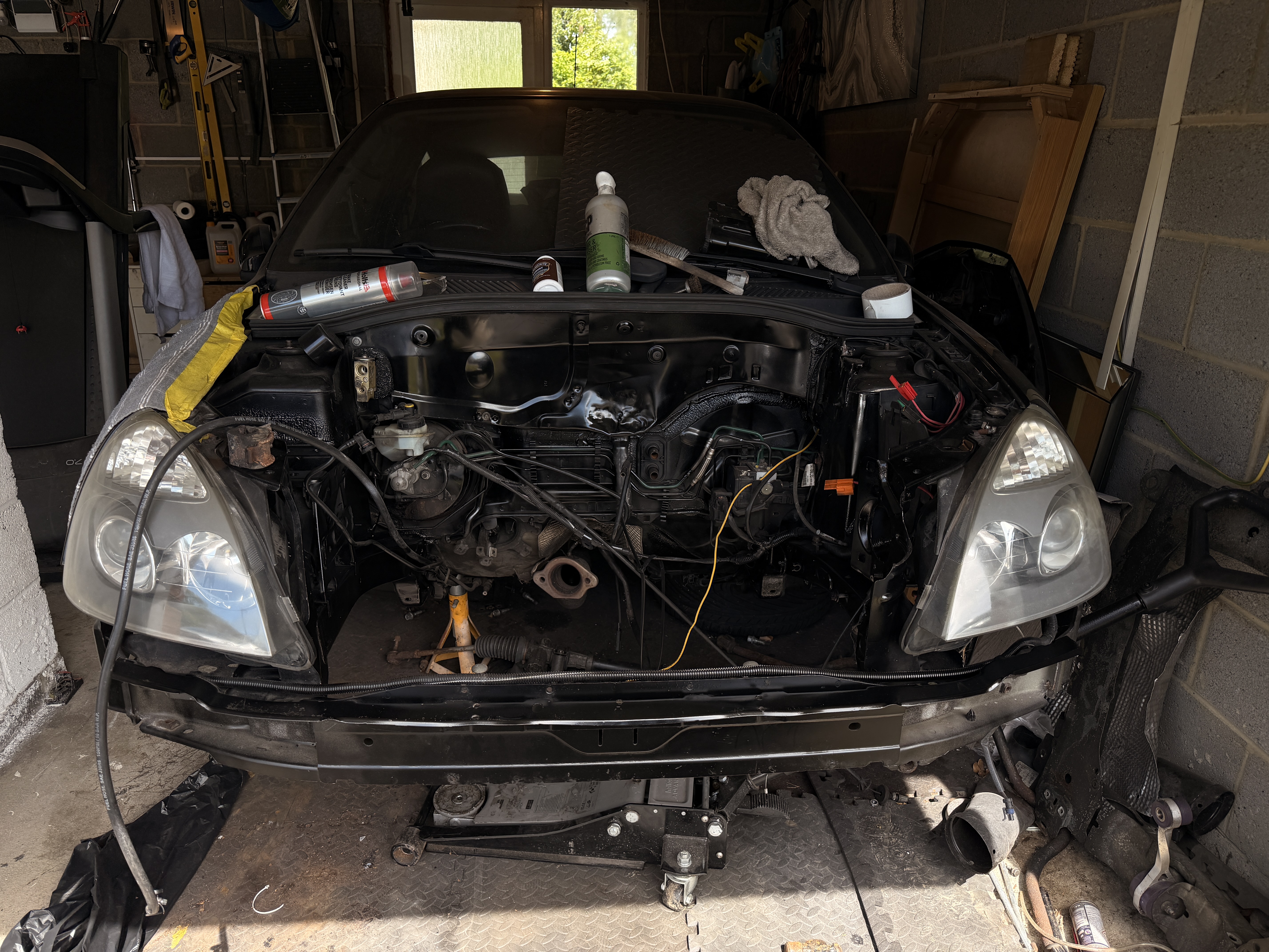

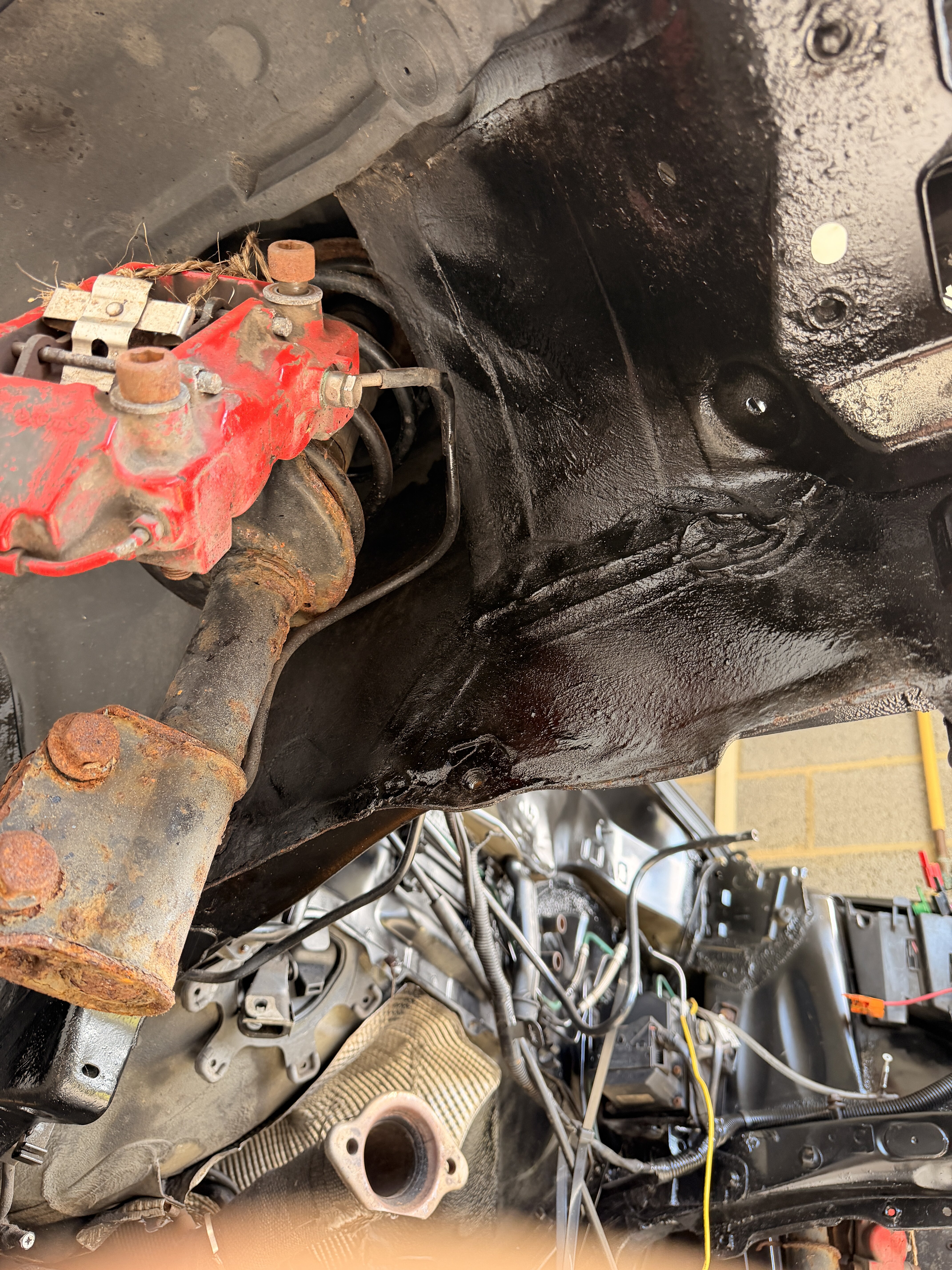

I did some painting today. I’d left some bits in primer which isn’t great so eventually finished them off. Is it concourse? No. Do I care? Also no. Much better than it was and at the end of the day, it’s an engine bay! I may have painted bits of the odd brake line here and there in the process but such is life.
The crash bar needs another coat but
Also did the underside of the inner arches. The shock looks like it’s been in the sea. I’m not convinced sitting in an unheated garage does a car any good.
Aside from that I’ve tidied up so I can see the engine again. I’ve got a lull in house related activities so hopefully I’ll have time to get it back together now.

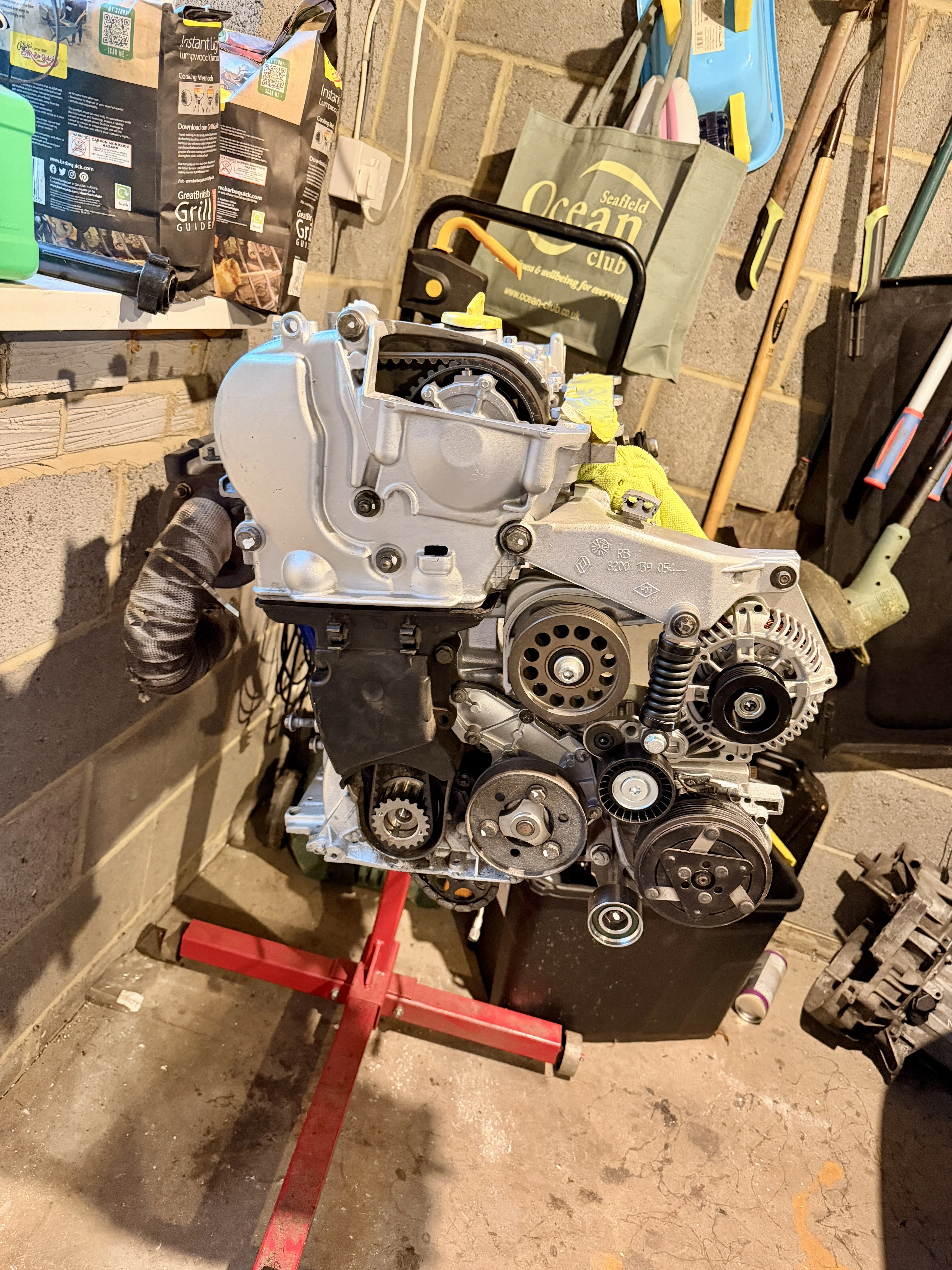

I did some Clio’ing tonight.

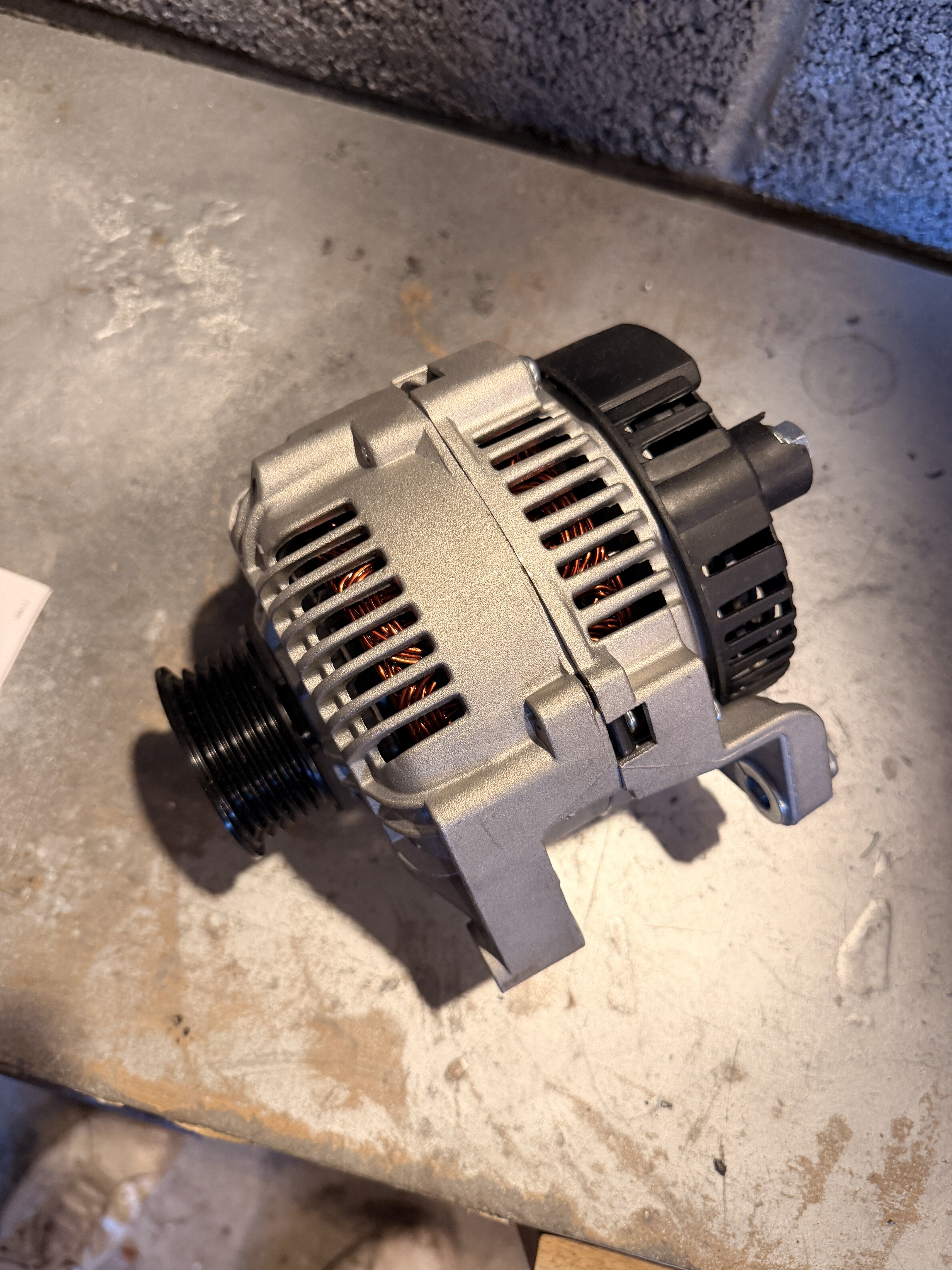

I had an offer pop up for an alternator so bought one because A - the old one was broken and doing that thing where they draw from the battery when not running and B - the old one was minging. New one is shiny, yay!
However, unlike the current one, the b*****d thing isn’t threaded for the bolt. I checked my stash of random bolts and have nothing long enough in the right width so I’ll have to do some googling to see if I can work out what should be there.
It’s been so long since I started putting the engine back together that I’ve forgotten what’s torqued and what’s not. I know all the rocker bolts are but couldn’t remember the rest.
I reprinted the engine manual and spent some time marking up all the bolts as I torqued them. AC pump is now back on too, but I’m now at the point where I can’t go any further until it’s timed up. This is where it’s at now

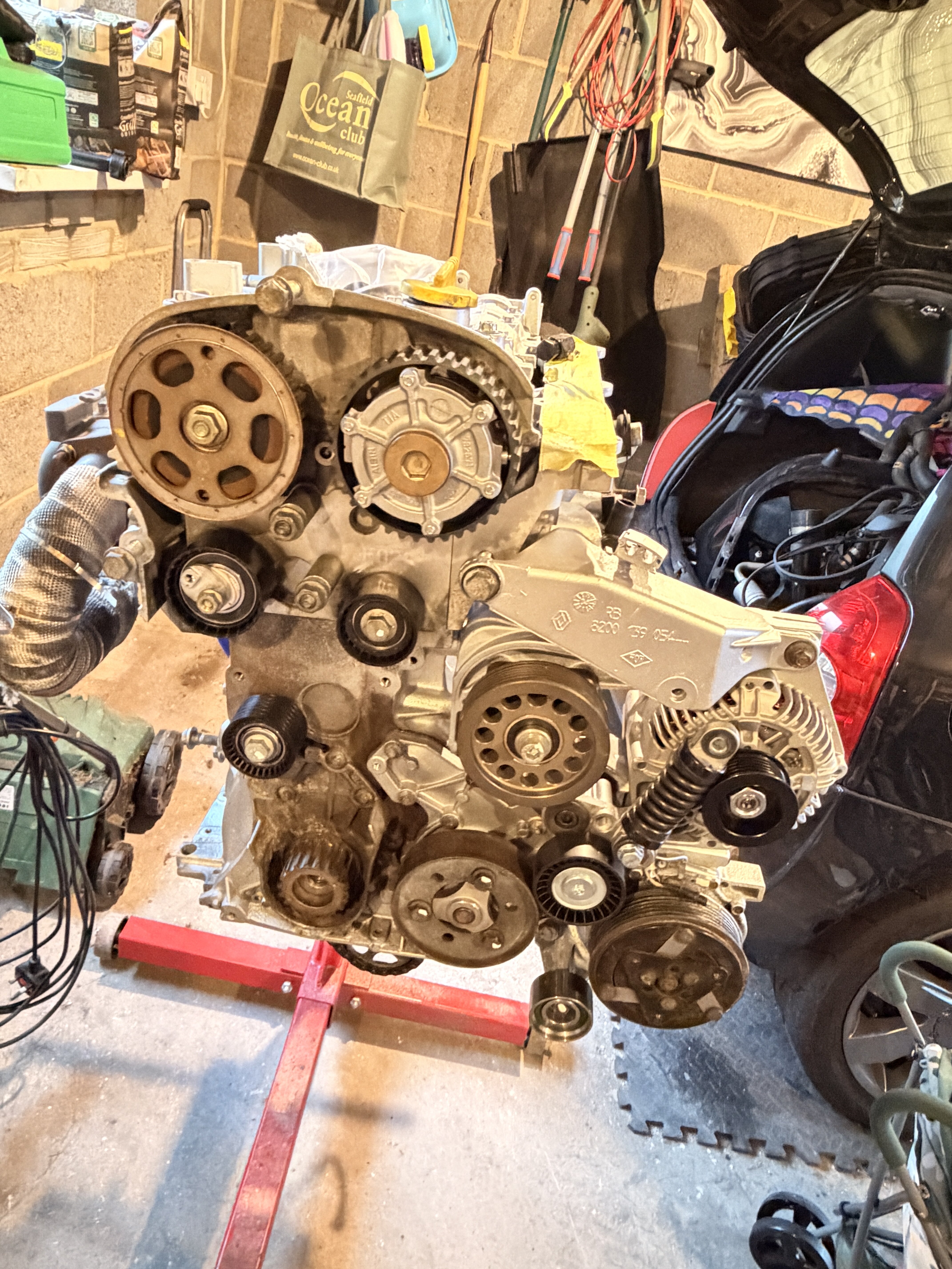

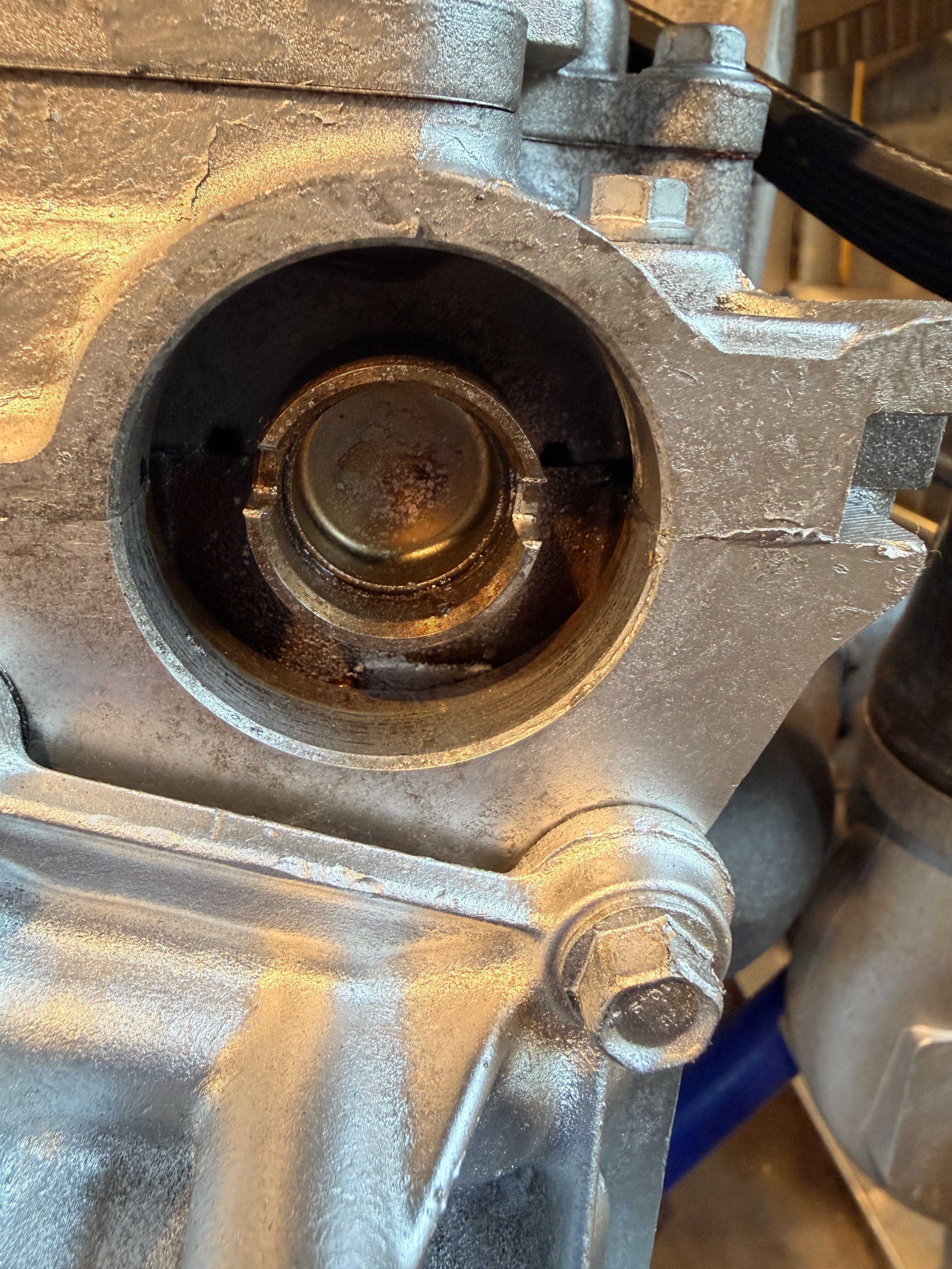

I also had a moment of panic about the cams so checked them and they both appear to be the right way up

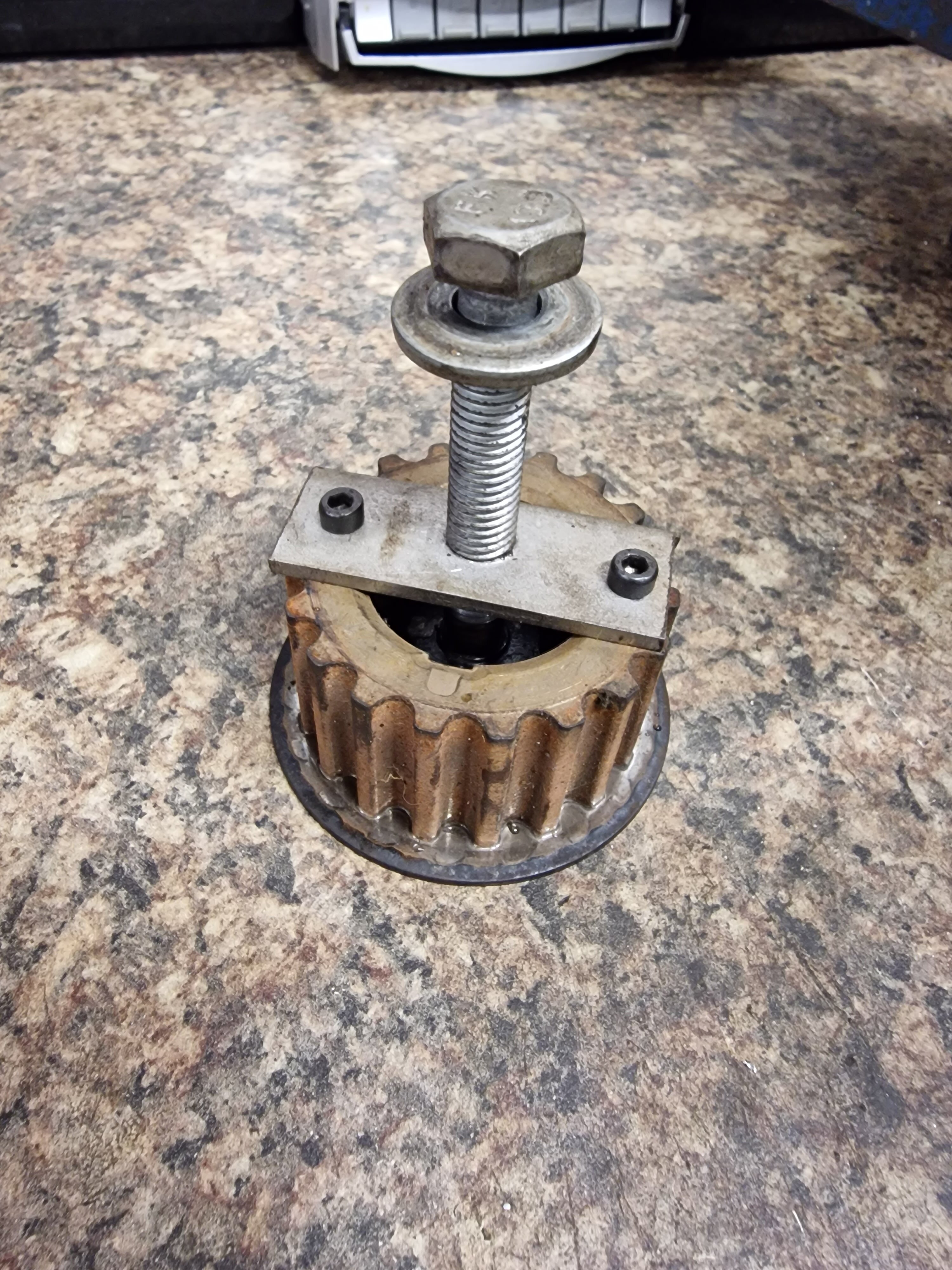

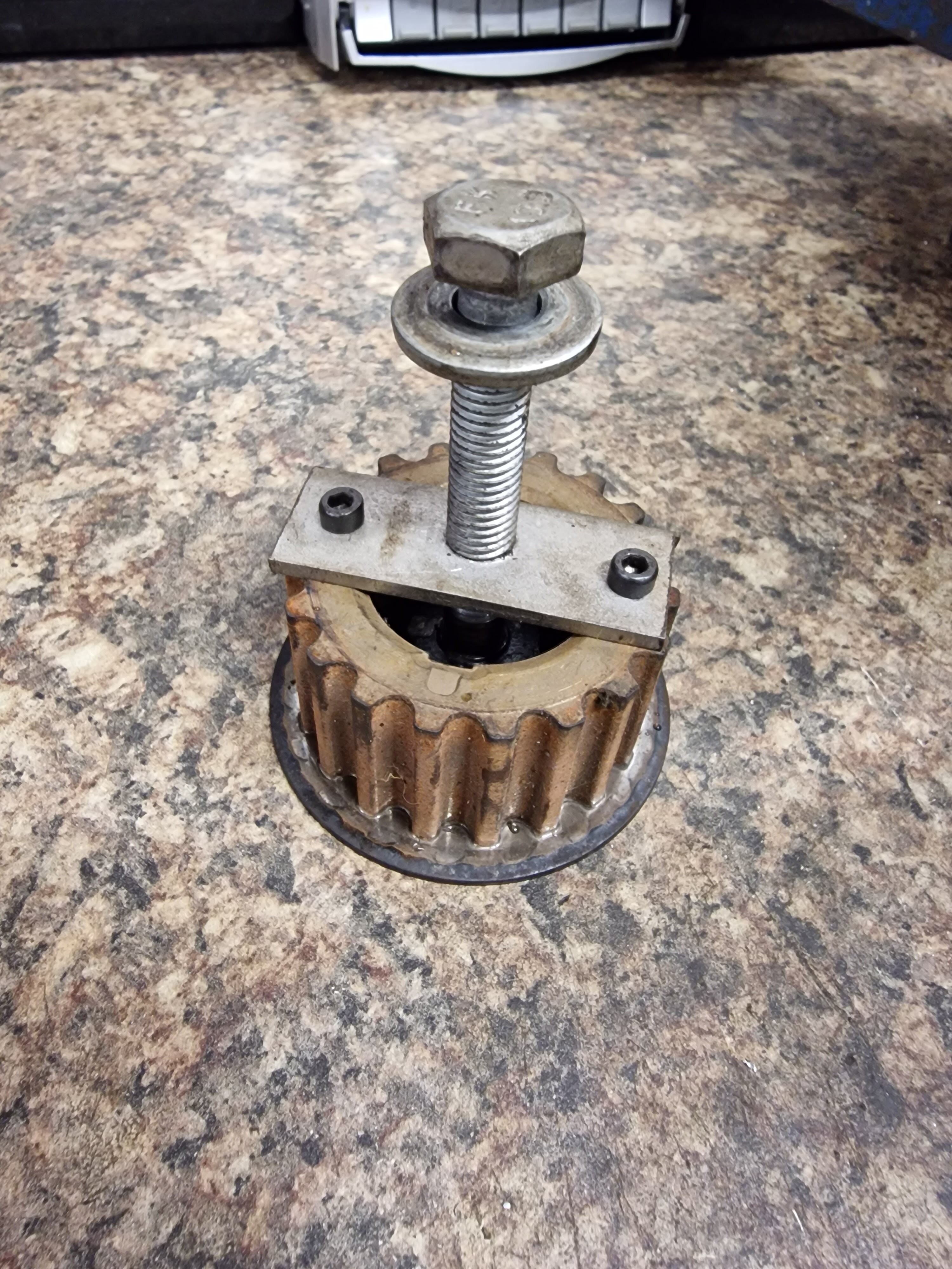

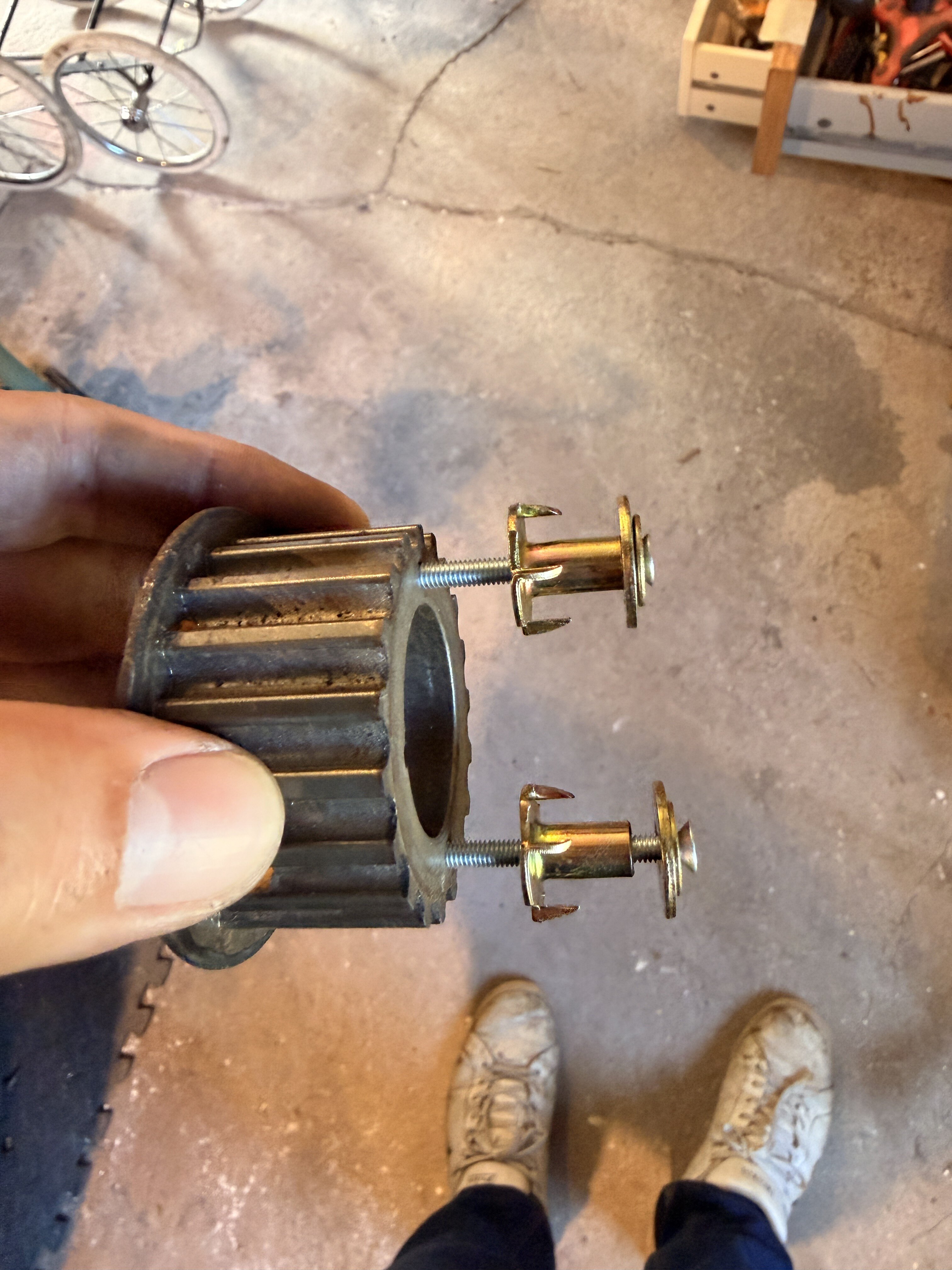

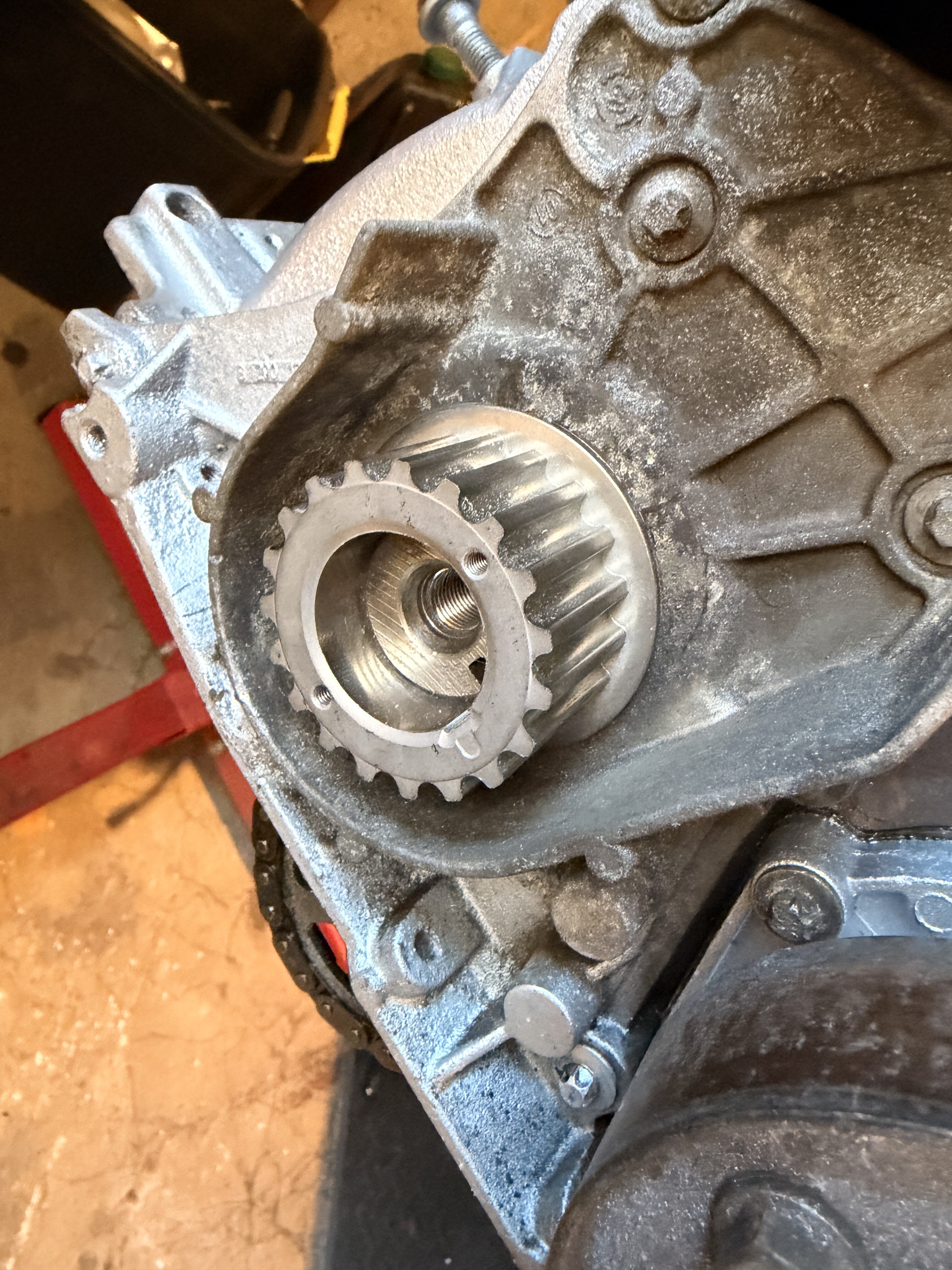

One question though - I’ve got a keyed crank pulley to go on. How does the old one come off? I assumed it just pulled off but it’s got no intention of moving anywhere. Is there a tab or something in one of the holes to release it?
You sure the cams are correct? Little D to the bottom on each? One looks off but hard to tell by the pic.
Knock something like this up to get crank pulley off.View attachment 1791965
Agreed, one looks like its 180 degrees out.
Yeah, 2nd pic looks wrong way round on the photo. I can’t decide if I’m bong eyed or it’s the pic 😂. I’ll check again
@Brigsy - genius. I’ll knock one up. I’m sure an old actuator bracket I’ve got must have holes in about the right place for a nice bodge special
Does the Clio crank always have the notch for the key way but they just use a notchless pulley from factory?

As per Kyle below. The notch is there but the standard pulley doesn’t have a matching nubbin for some daft reason. When I phoned Andy at engine dynamics for the rebuild parts it was about 40 quid or something daft to get the keyed version. VS £2k worth of engine bits it seemed like sensible maths and just some added peace of mind. Hopefully it’ll make timing it a bit easier as once it’s all locked up that bottom pulley won’t move like it can with the standard one relying on the tension from the crank pulley holding it in place. It doesn’t appear to be the easiest of engines to time so anything that helps is a positive 🤣
All of the F4R cranks have the slot for a key
Renault just chose not to put one in there apart from on the Meganes 😂

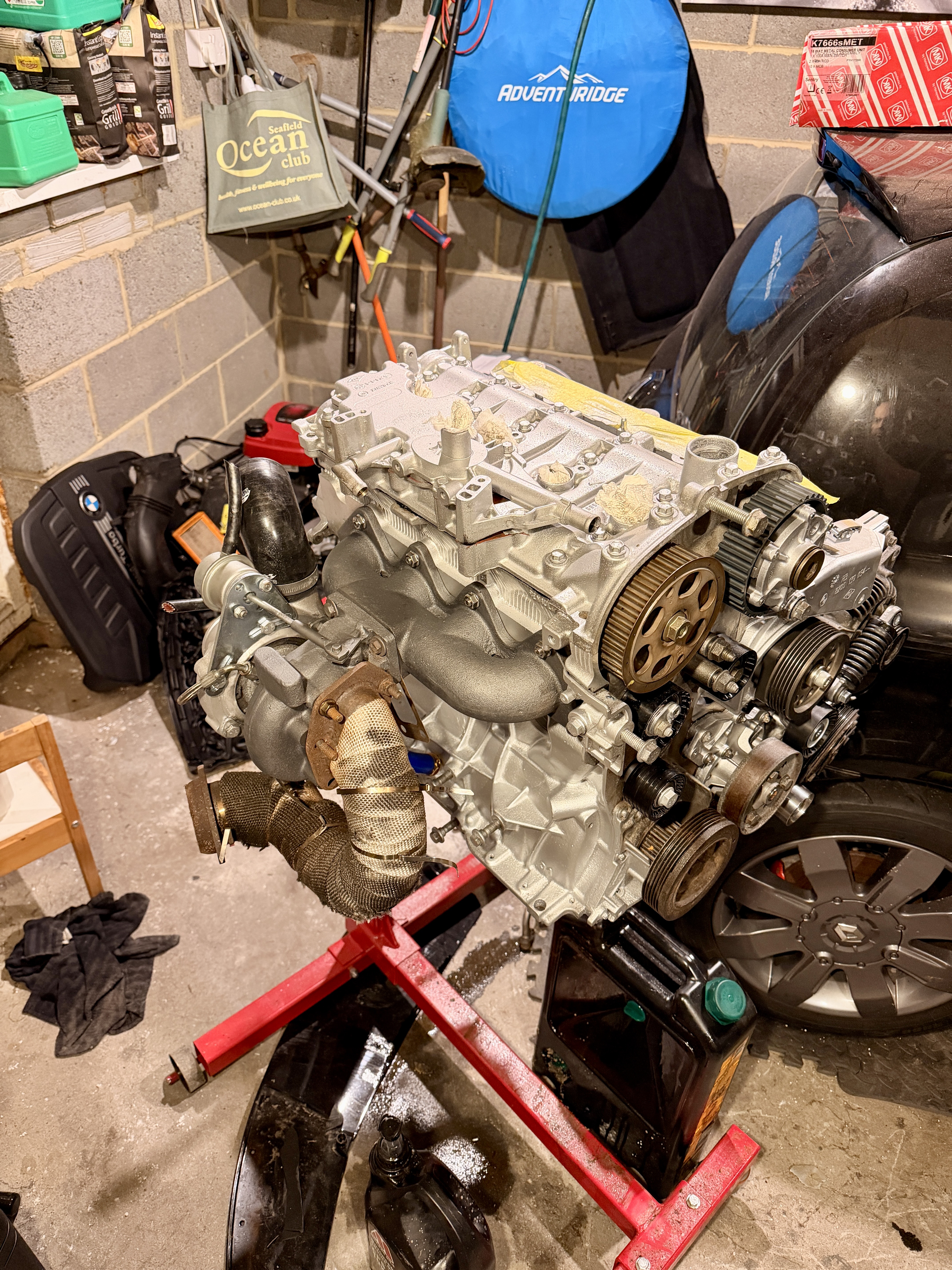

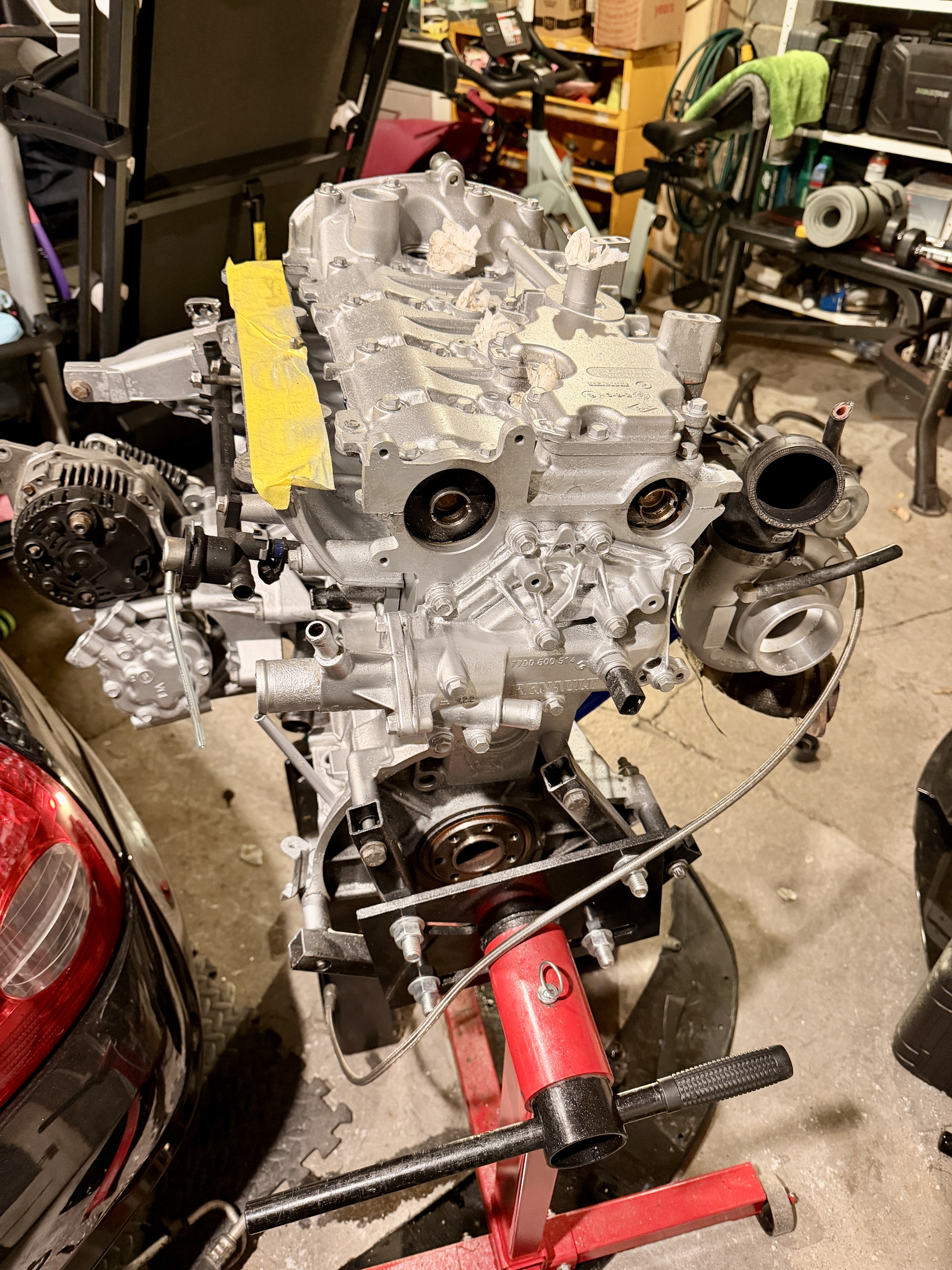

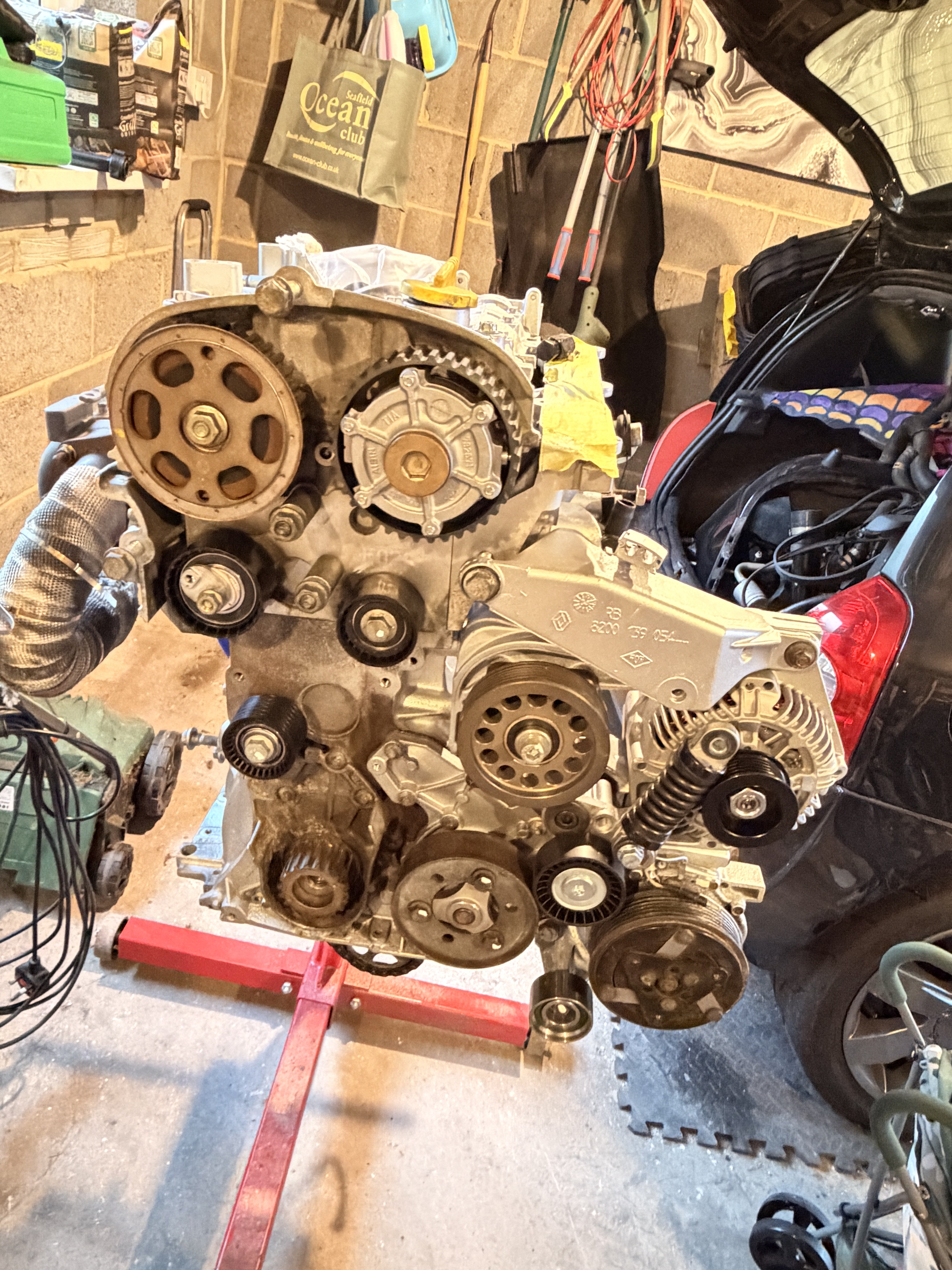

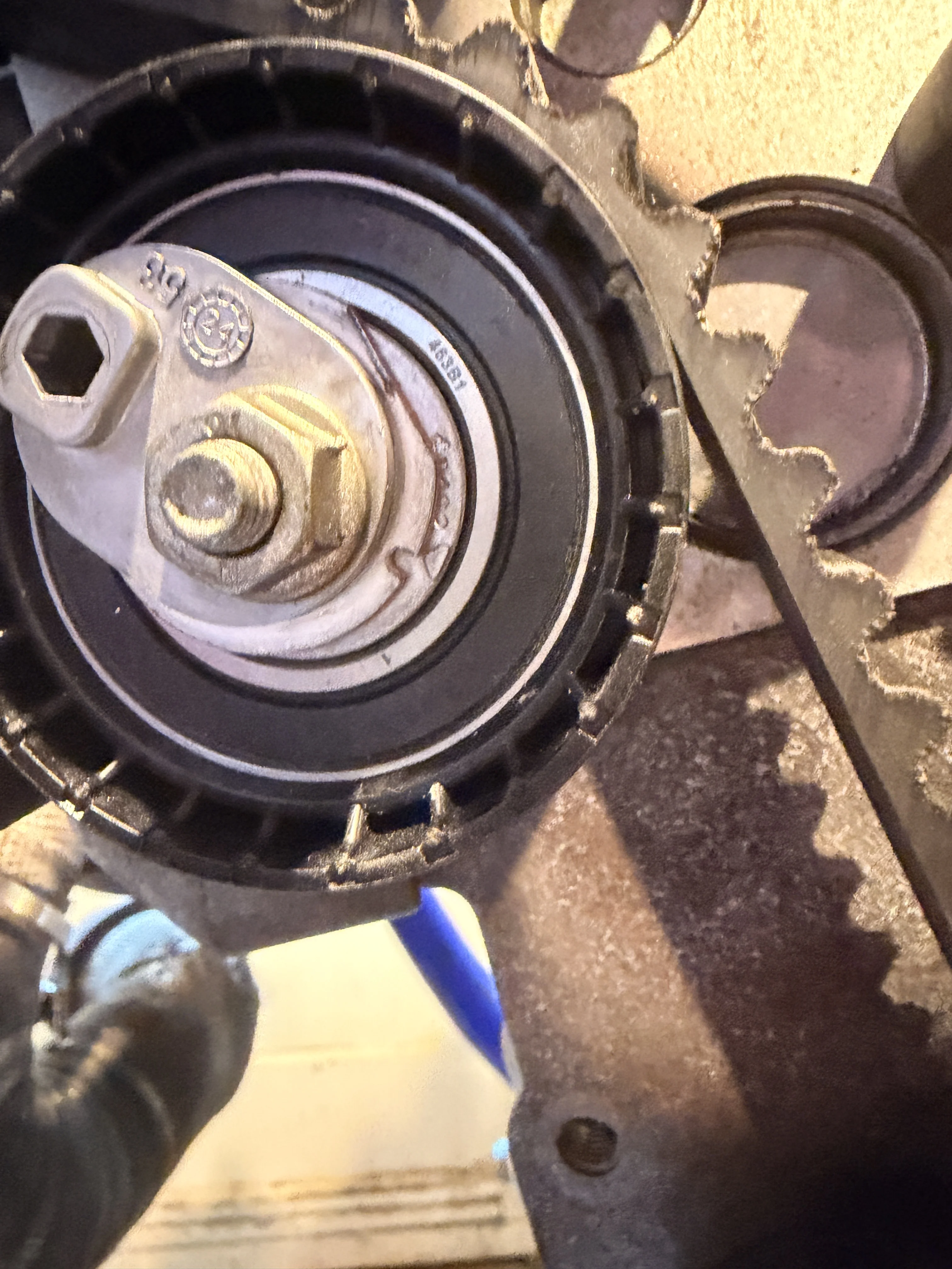

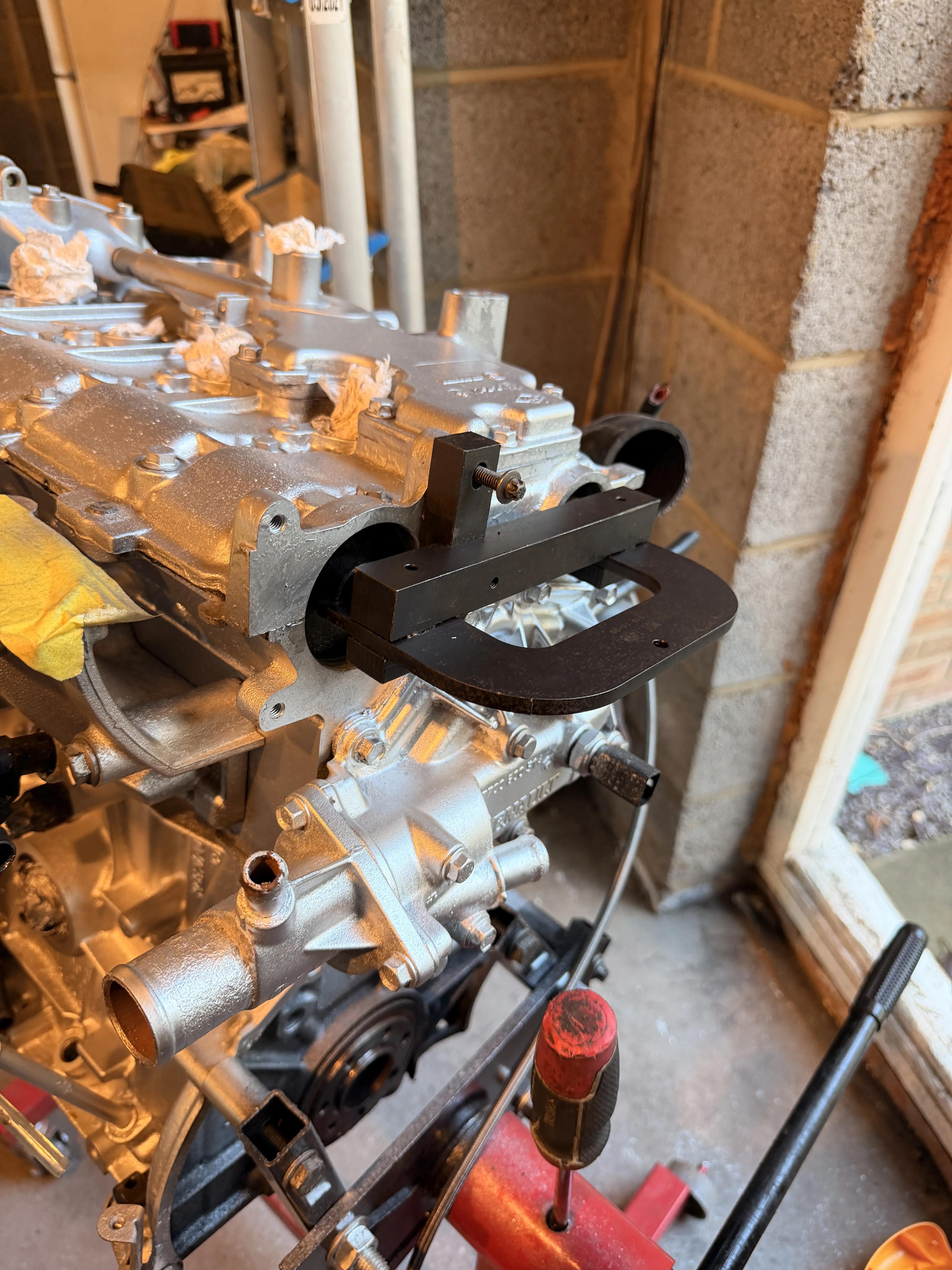

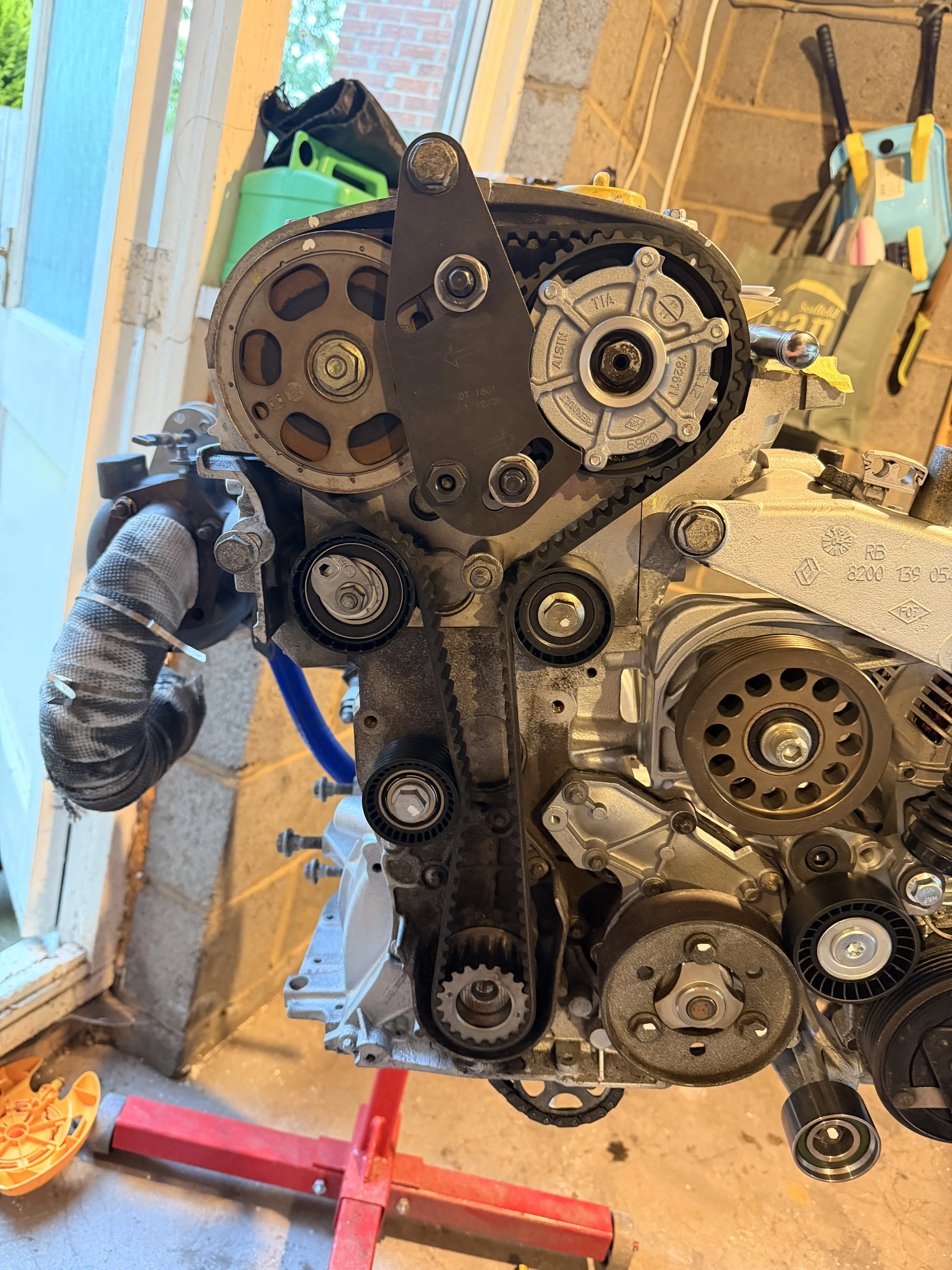

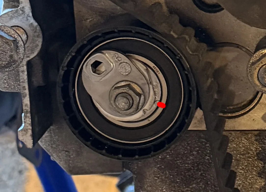

Thanks to the legend that is @MAXRUNDOWN loaning me some timing tools, I started setting the timing on the engine.
Making sure the crank is locked properly is a nice easy job when you can just spin it upside down to check.
Cams locked. Note the OEM screwdriver holding the engine stand 👍
Belt on and pulleys locked and tool torques to spec.
On attempt 1 the cam locking tool wouldn't quite slot back in perfectly. It needed just the slightest of downward pressure on the inlet to get the exhaust to slot in. So that was it all back off and on again for round 2. That time it went perfectly. Couple of revolutions of the engine and it's all moving freely and the tool slots back in each time the cam grooves come back to horizontal.
And that was the end of that. I've either lost or not ordered a new nut/bolt for pulley/dephaser so couldn't lock it all down again to use the new hardware. They should arrive at Renault on Monday so can hopefully get it all set and the sump on early next week. I still think the sump bolts I've ordered may be too long. I've got 25mm but think I need 20. We'll sharp find out next week.
Then just need to decide on a clutch, get the engine onto a crane and I can get the clutch/box attached and into the car.

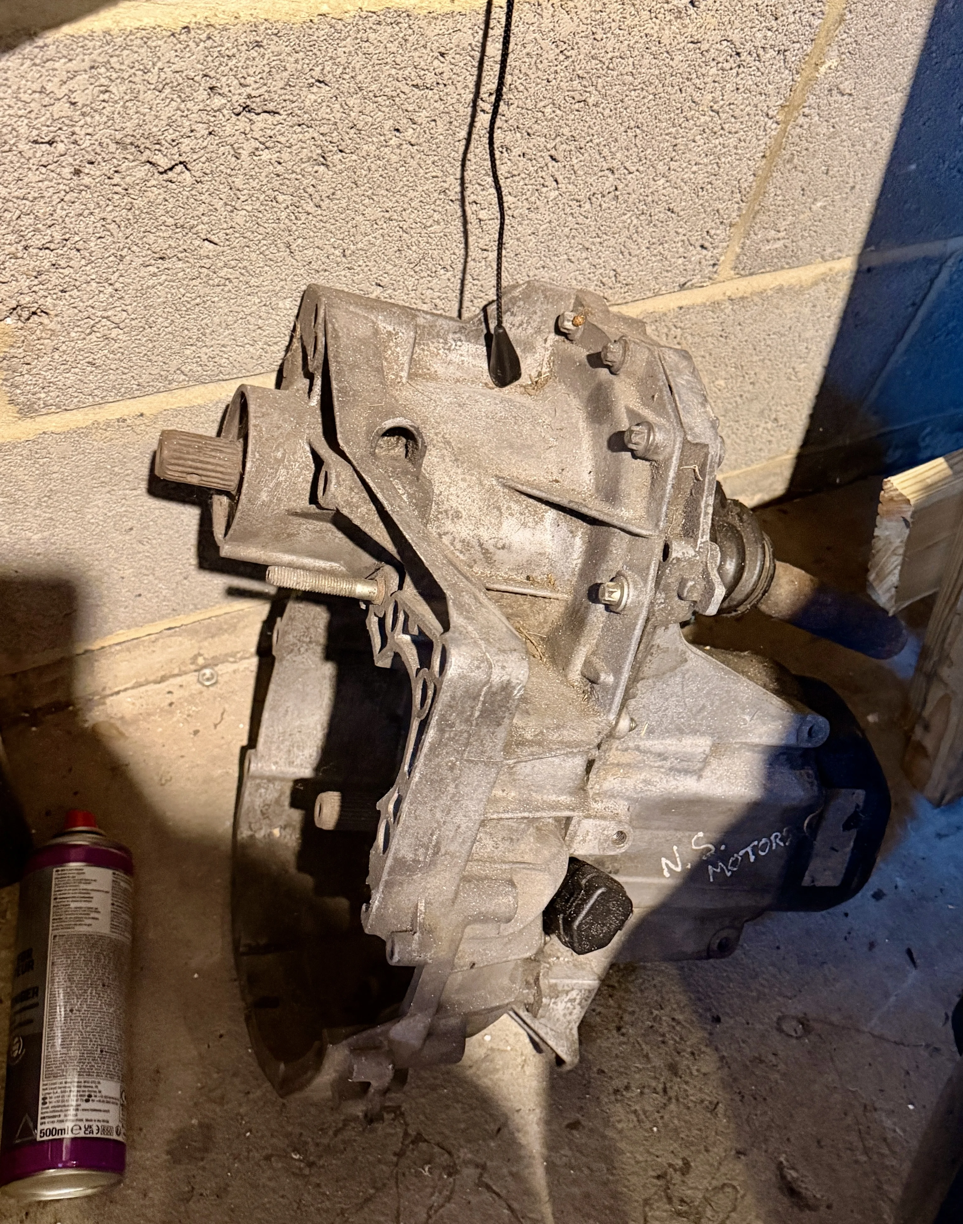

Allegedly my gearbox came from a DCi and has only covered 50k miles or so. It's been sat in the corner of the garage for a good few years and is still sealed with the original driveshafts cut off to keep the oil in. What's the bets that when the shafts come out the box oil is sparkly and chunky 🤣

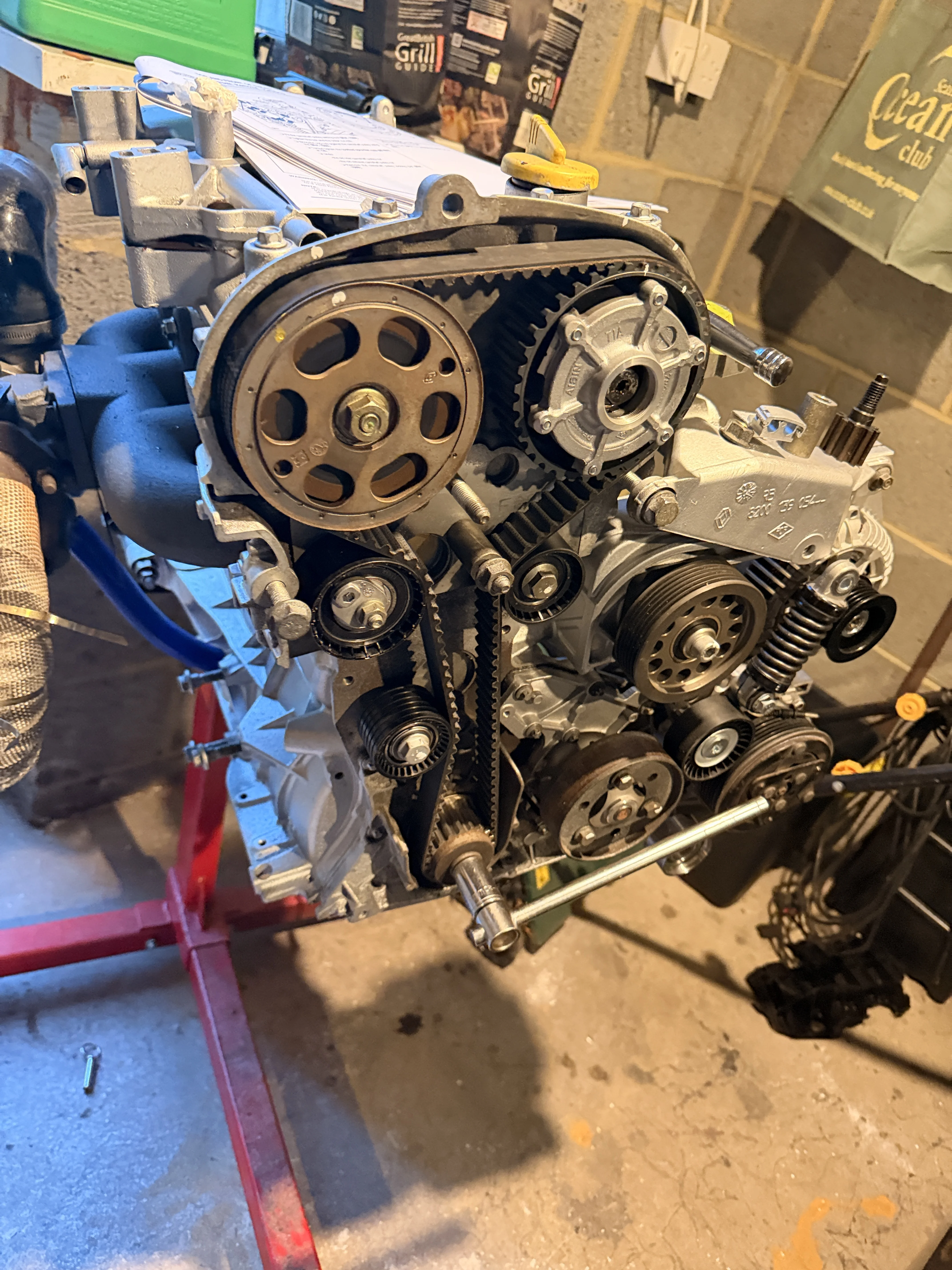

Timed up and covers back on. Went to do the aux but then remembered I’d somehow bought an alternator without a bolt thread. I couldn’t be arsed to start hunting through my drawer of random nuts/bolts so sacked it for today.
I thought timing it was pretty straight forward but they keyed crank def helped. It’s just made more awkward with the floating pulleys. That being said, I can see it being an epic f**k on with the engine in situ.
I dug the box out too. Need to get that cleaned up now. I can’t wait to set the linkage 🙄

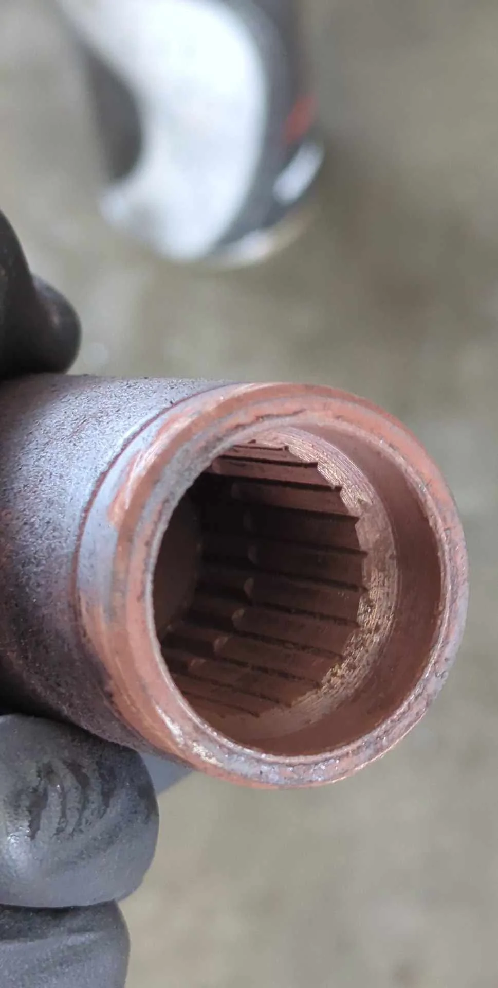

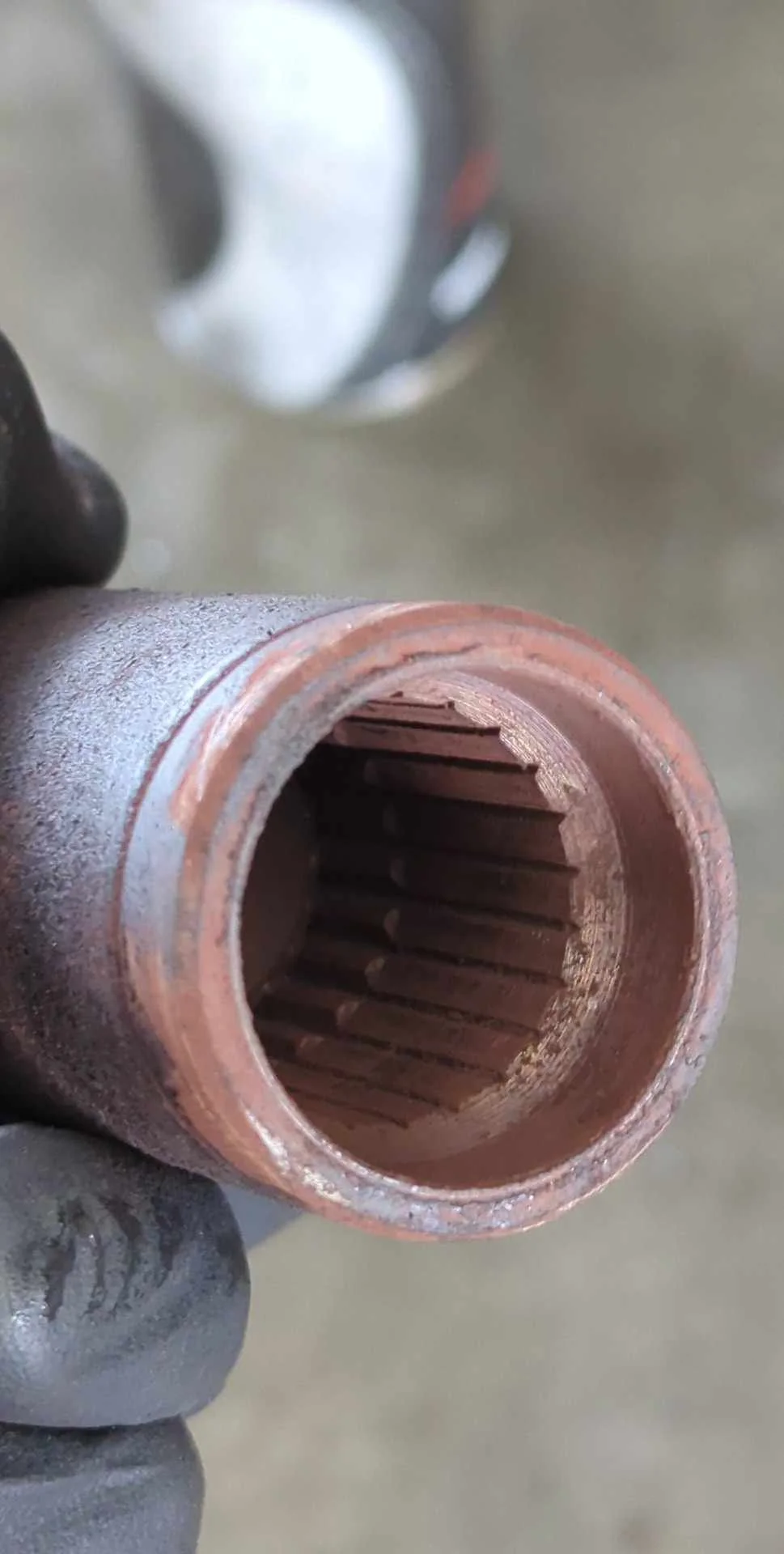

Output shaft splines on that box don't look to clever.
Do you think they'll hold up?
I ended up cheesing the ones off on the driveshaft sleeve that sits on the output 😅
There’s one way to find out! I’ve just looked back and I got it in 2021 so it’s been sat on my garage floor for just over 5 years. The for sale thread said it’s been sat on the sellers garage floor for 8 years before that. It’s had a long line of proactive owners 🤣. It’s a box with a circlip diff so I’d imagine that will just ping off and sacrifice itself to save everything else.

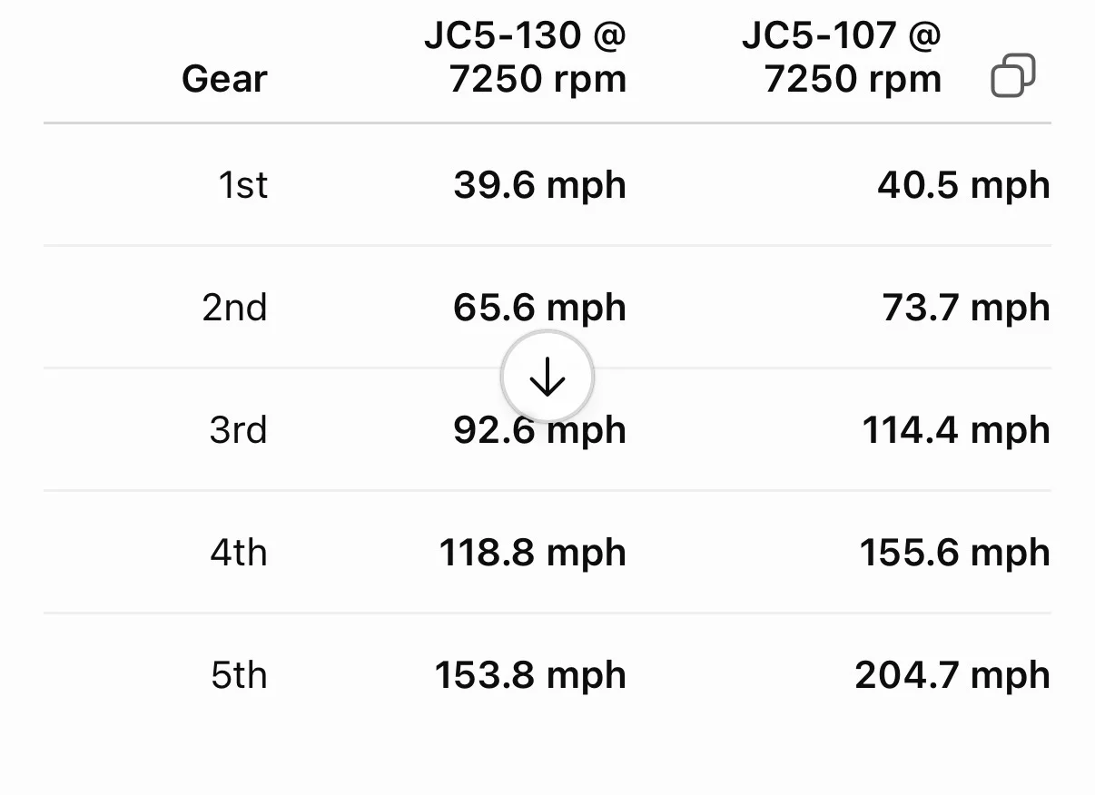

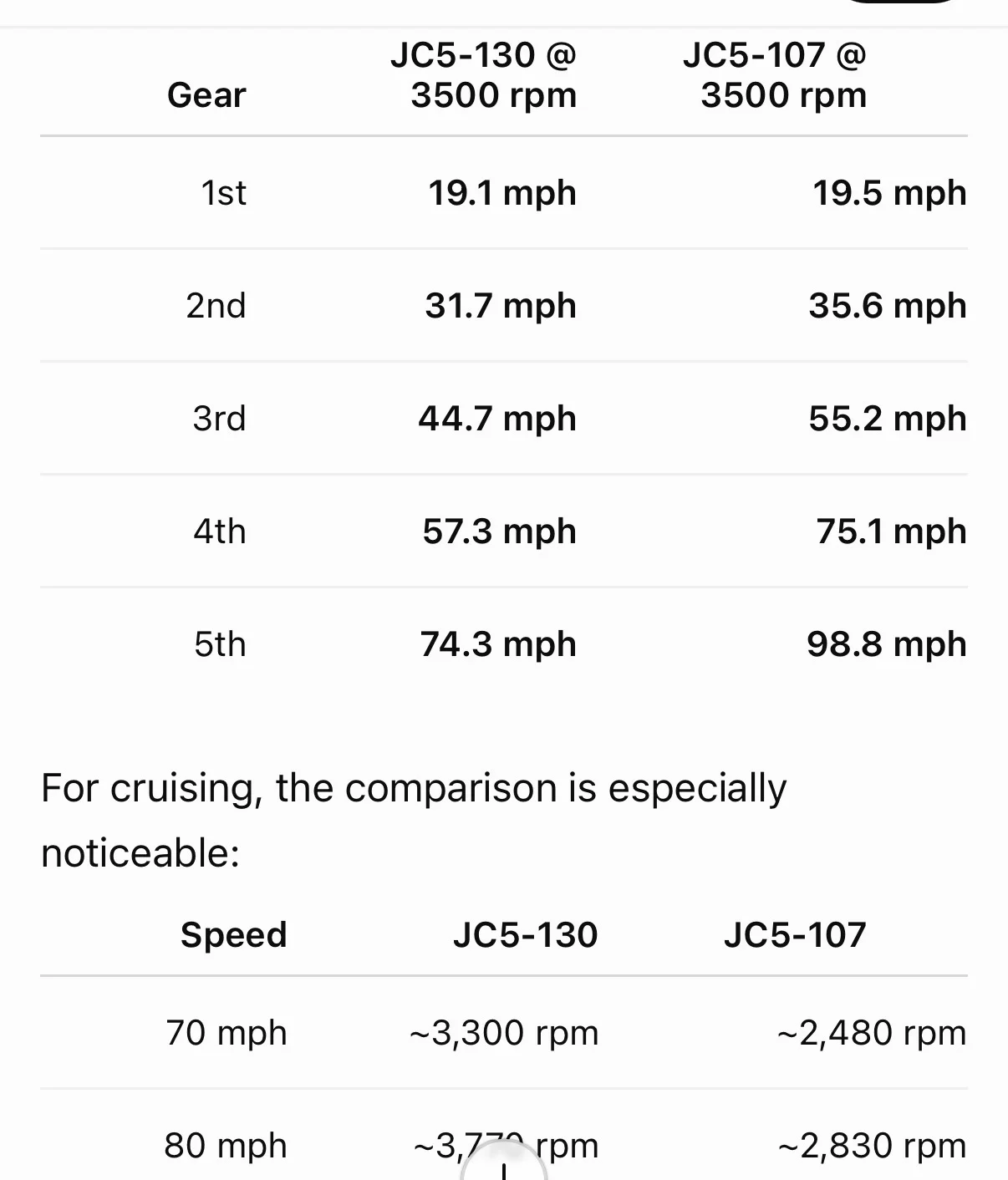

The box is an experiment tbh. The JC5-130 wasn’t quite right for boost. It was always in the wrong place in the rev band for me. It might be different for other people but all the roads I like to drive round here I’d end up holding high rpm in a lower gear (fine when it was N/A) or too low a rpm in a higher gear. It just rattled through the gears so quickly all I seemed to do was shift up or down. The new one is a 107 so the table below is the comparison. Theoretical 200mph top speed 😂😂
If I like it I’ll buy another one, get it rebuild and fit a diff. If I don’t, I’ll go back to the list and find a different one. Just going to be trial and error until I’m happy I think.
Diesel ratios are good for turbo, Haswell ran it on t trophy years ago. Still blew up the same sadly🤣
They are service consumables. Swap with every oil change 😂.
The last one must have done about 6k miles but all be it there’ll be a lot more power this time once it’s mapped. It gave plenty of warning though. I thought it had a slight diff whine but it was actually the bearing on the input shaft gently eating itself.
That an old Megane diesel box, the 107?
It is I believe.

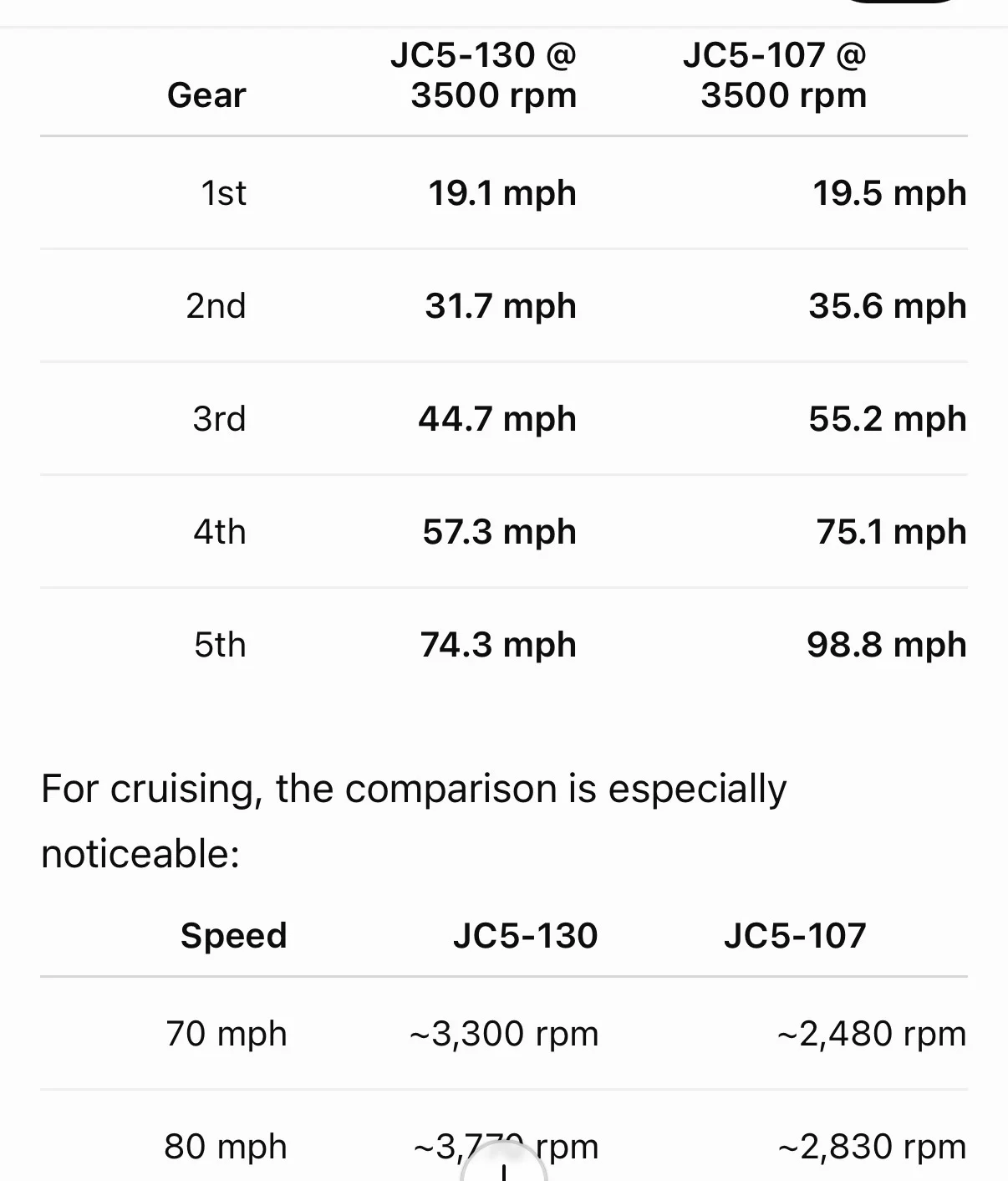

The biggest difference will hopefully be where it comes on boost. The speeds in each gear seem a much nicer match for what I want and it’ll be nice not doing nearly 4k rpm at 80.
I’m still tempted with a JR5 but can’t quite work out what level of parts bin wizardry I’d need to get the shafts to work
