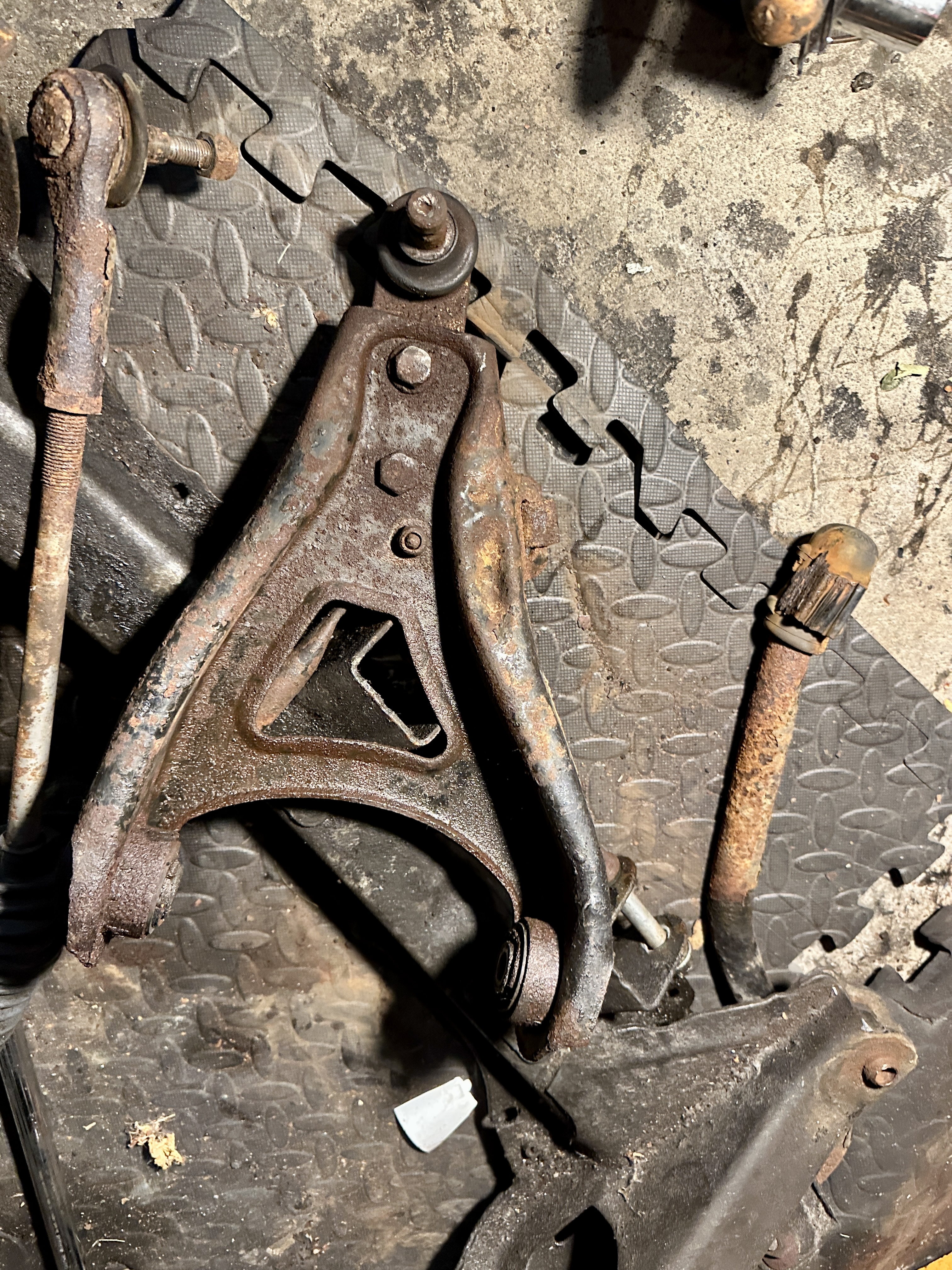

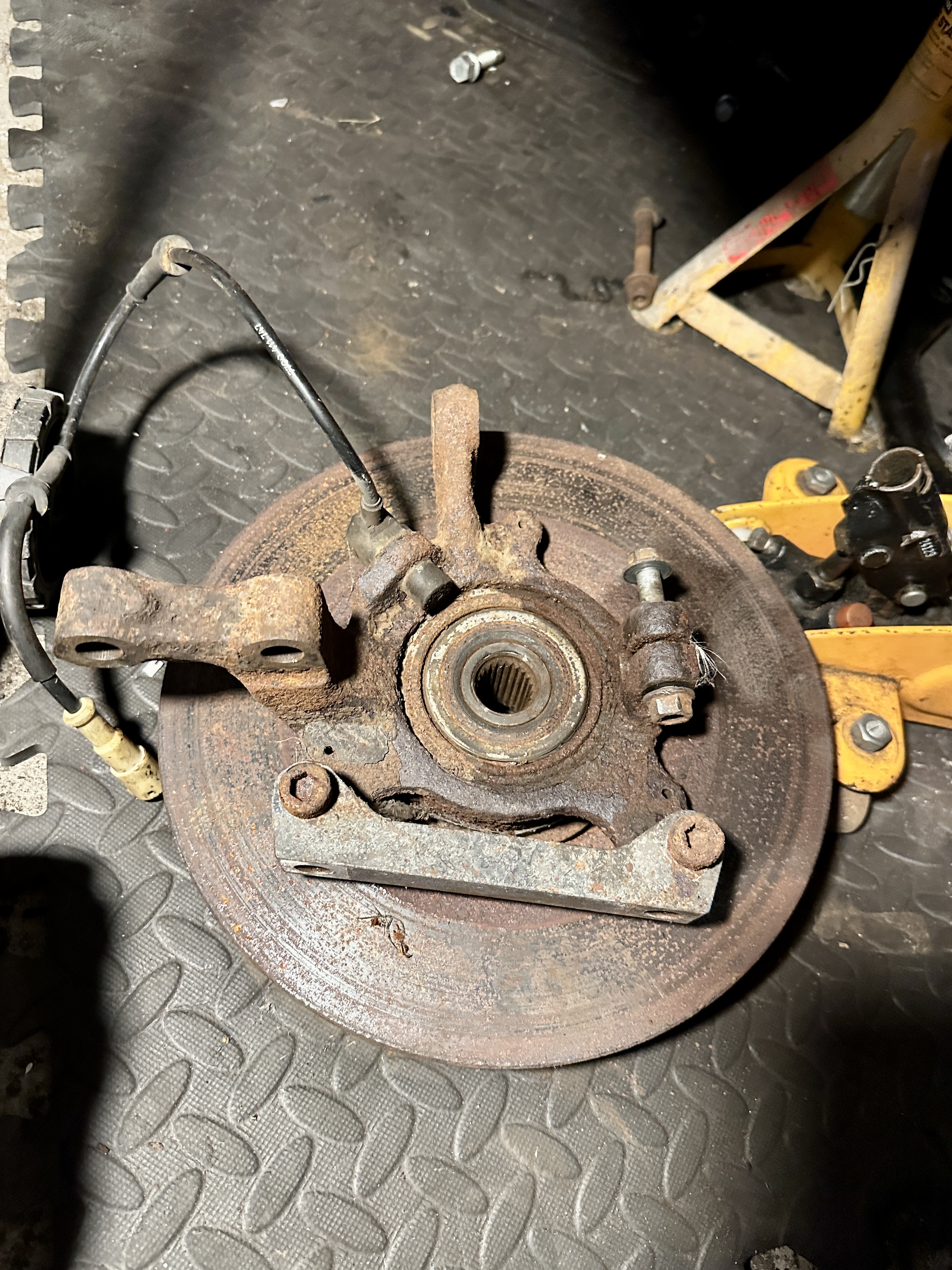

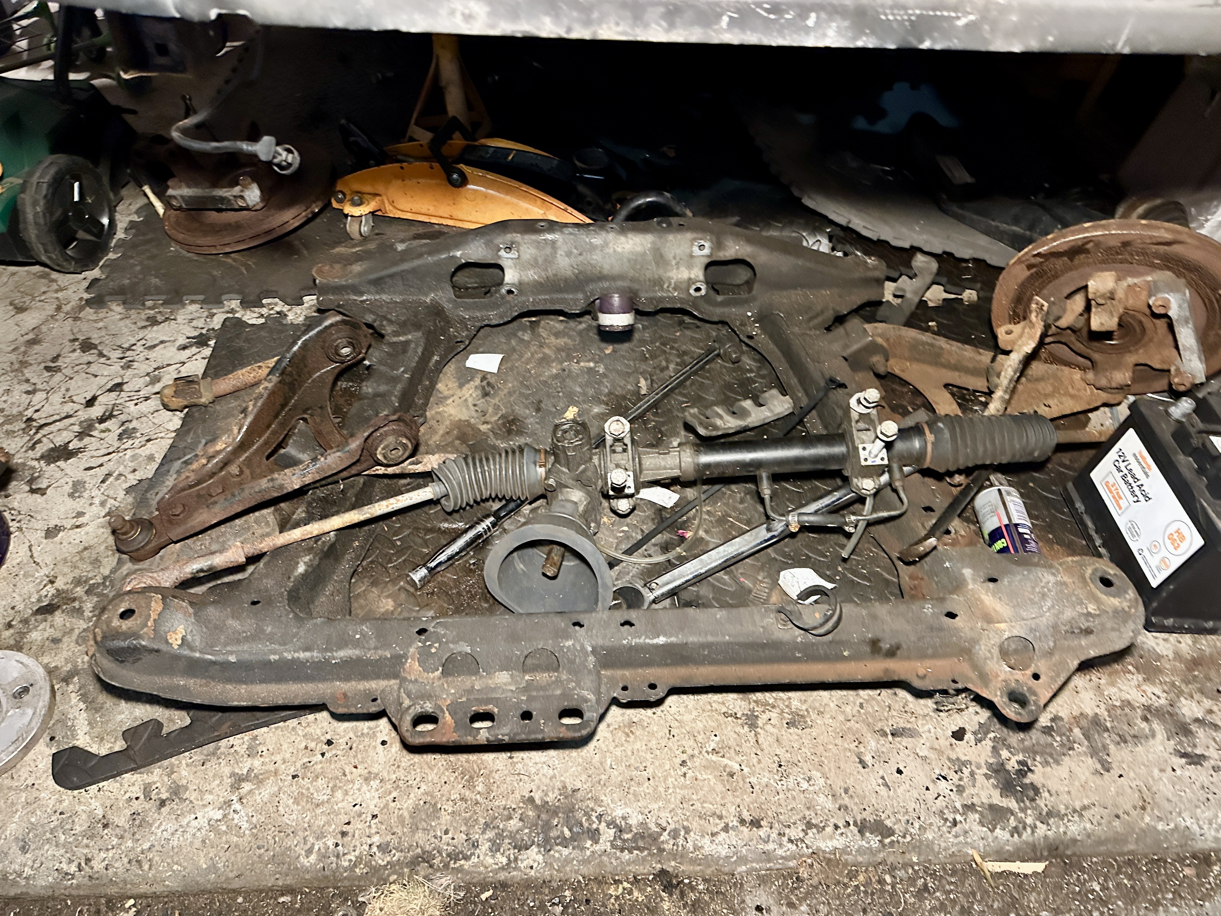

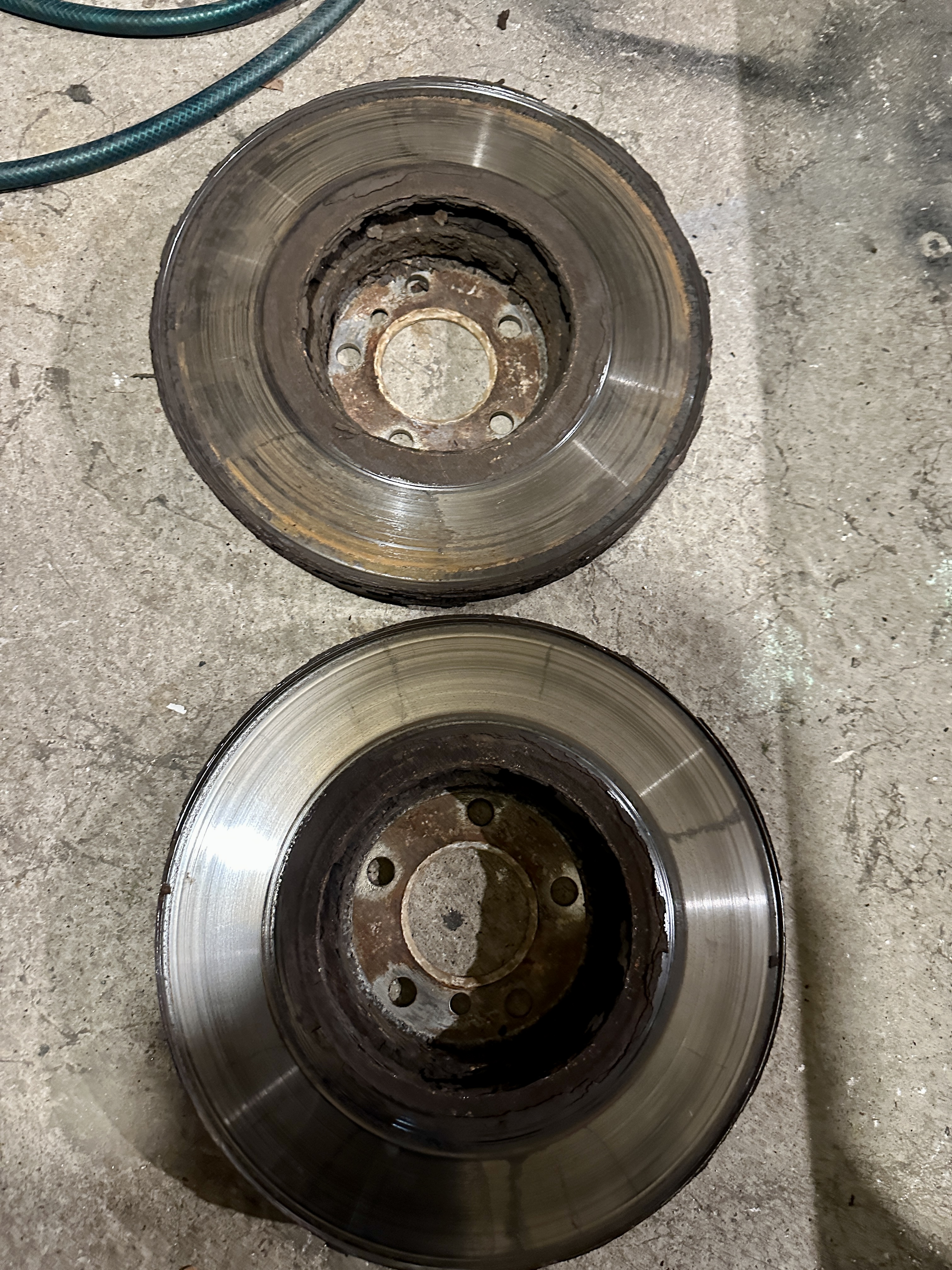

Plan was to strip the subframe. The whole lot is minging so needs stripped then sent for blasting and powder coating.

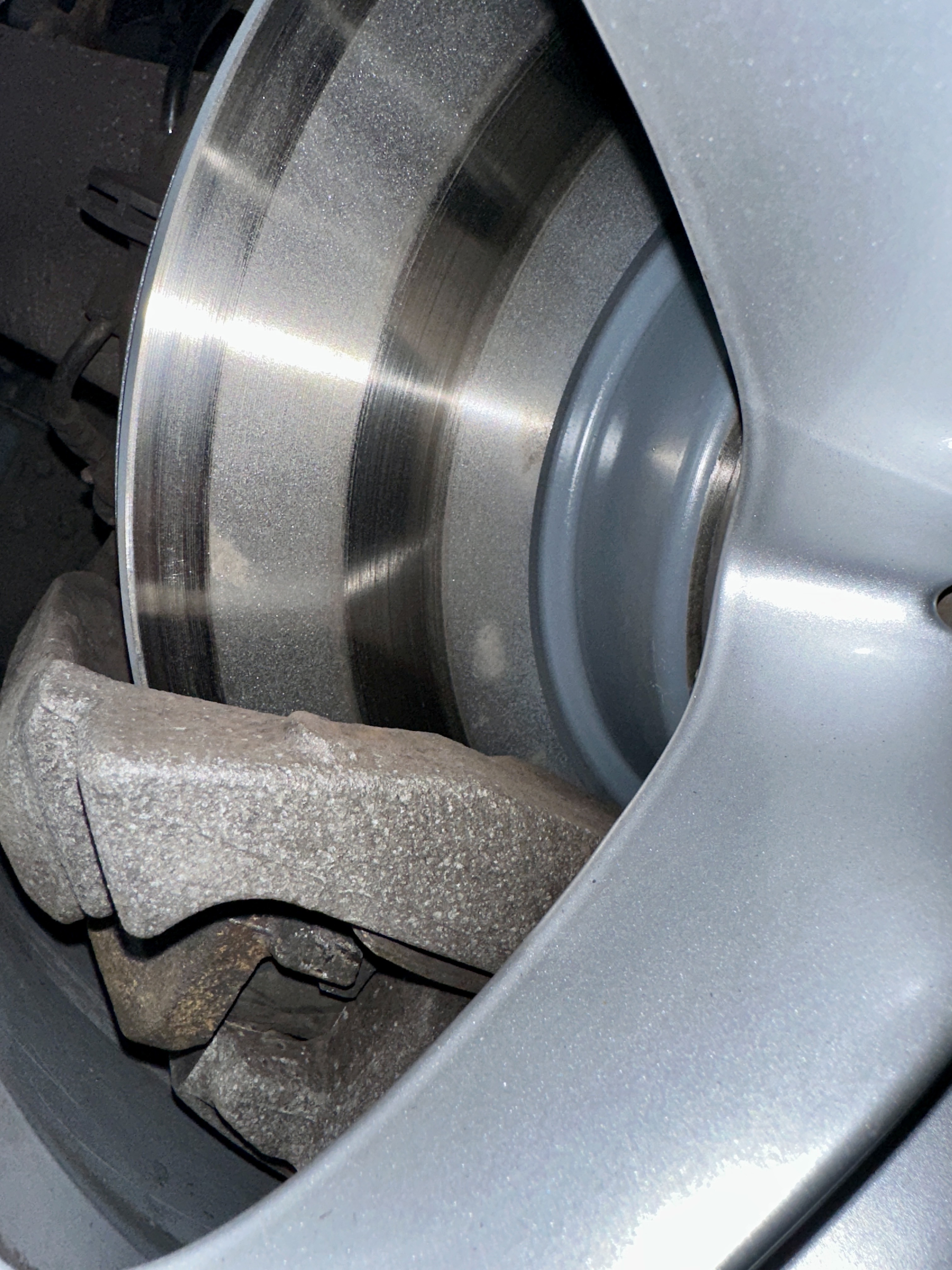

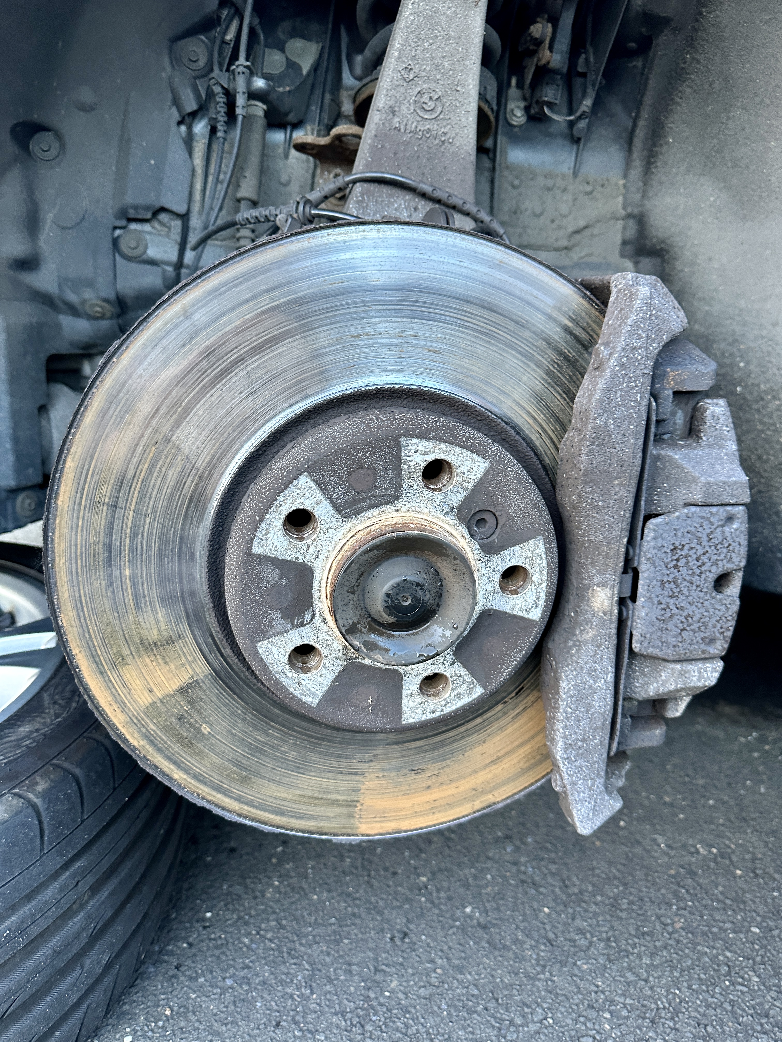

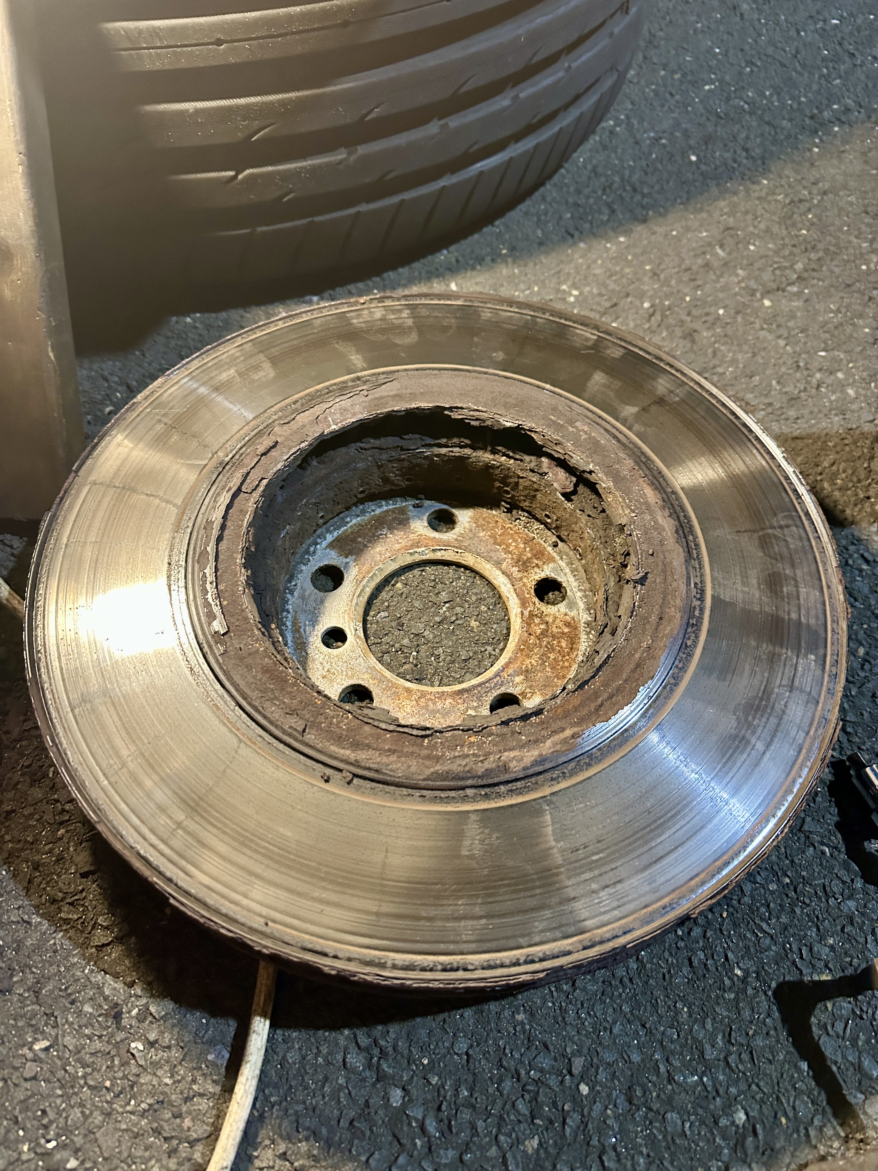

Disks and hubs look like they’ve been in the sea.
Wishbones look like they’ve been in the sea
Subframe looks a bit less like it’s been in the sea

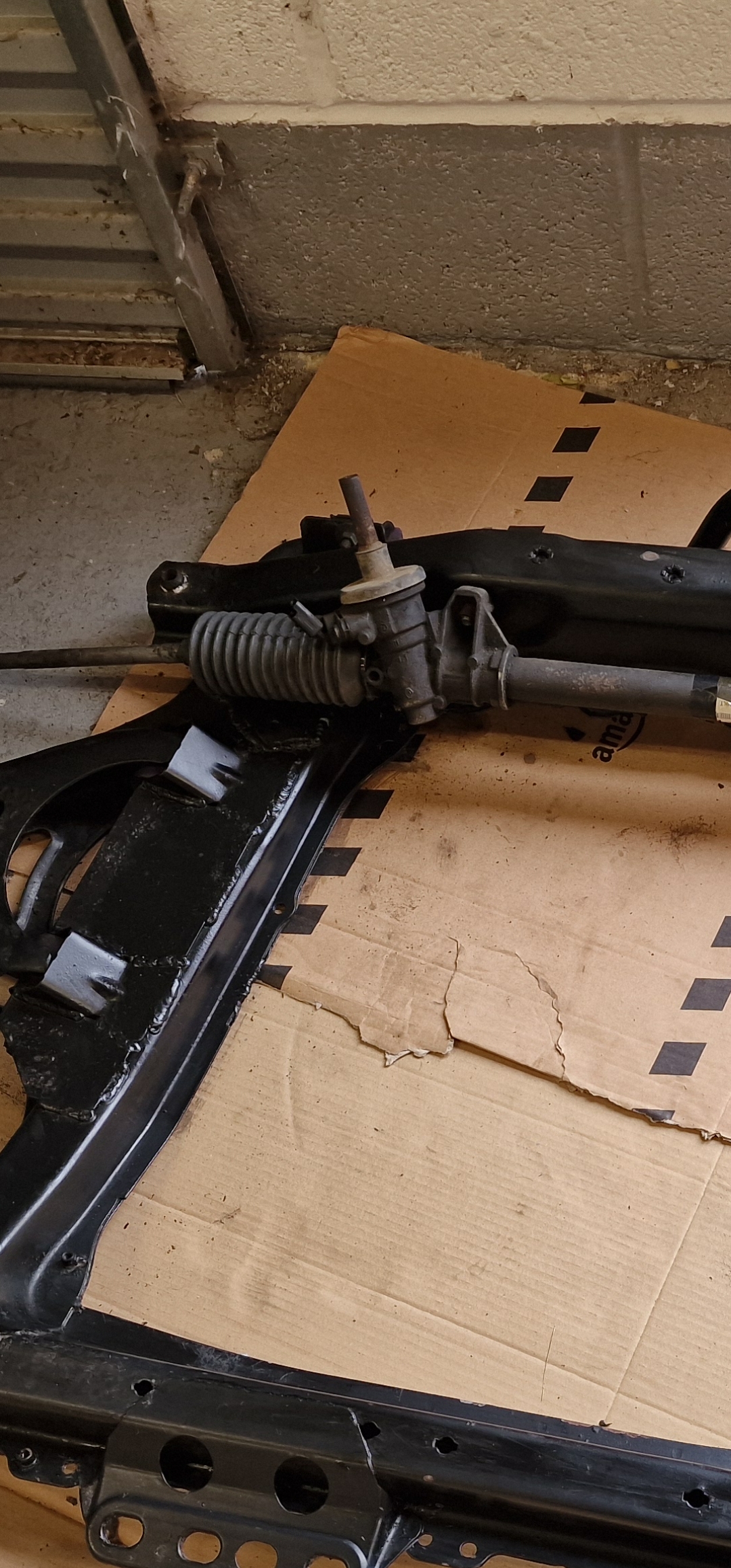

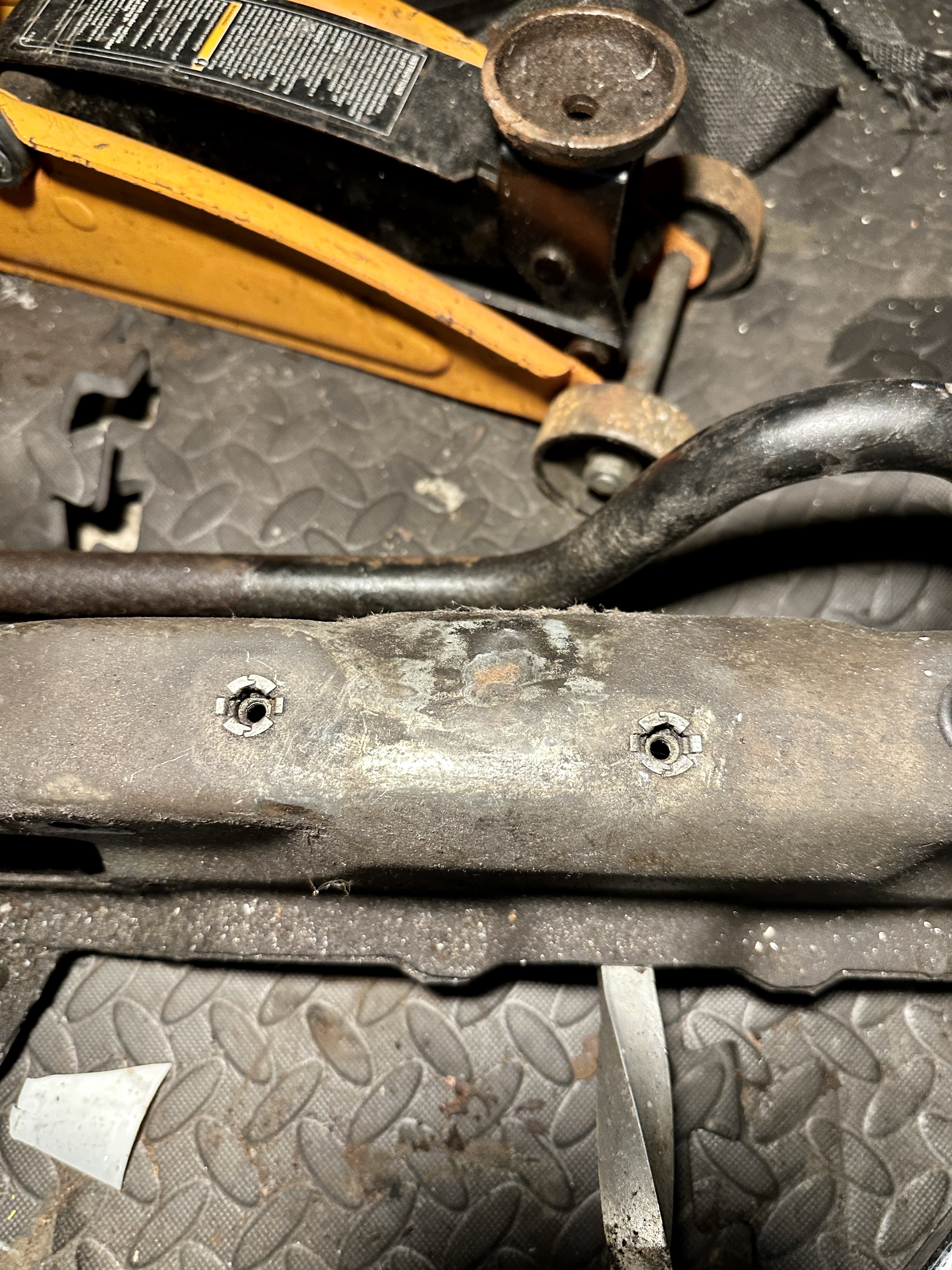

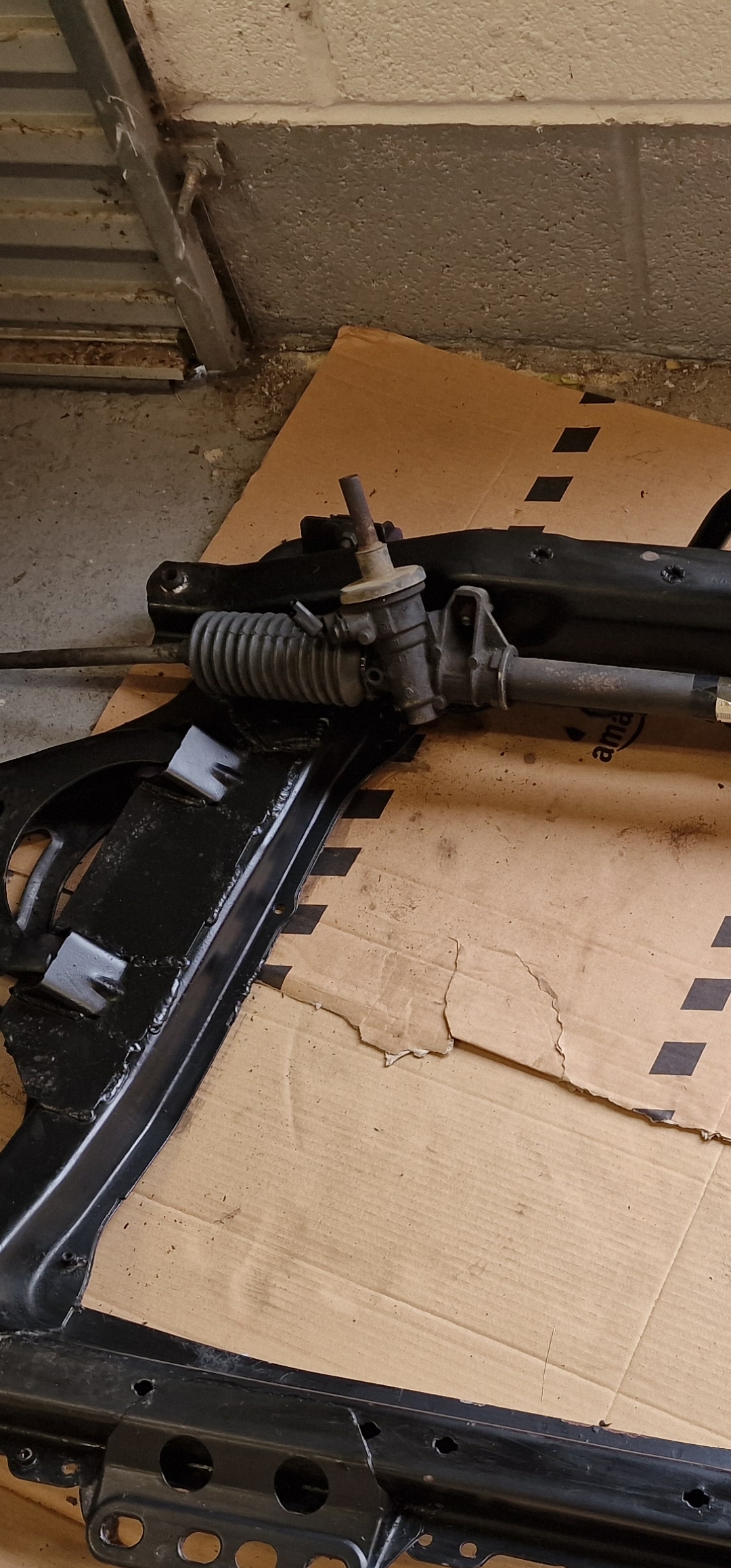

I took the steering rack off. You can see on this bit where the downpipe has been hitting it on that sticky out bit and also on that bolt head. Does the DCi EPAS rack have this or is it different? It it does I’ll swap the rack, if not I’ll just grind it a bit.
It’s also been hitting the subframe a bit. That’s an easy fix - I’ll just edit it with a big hammer.

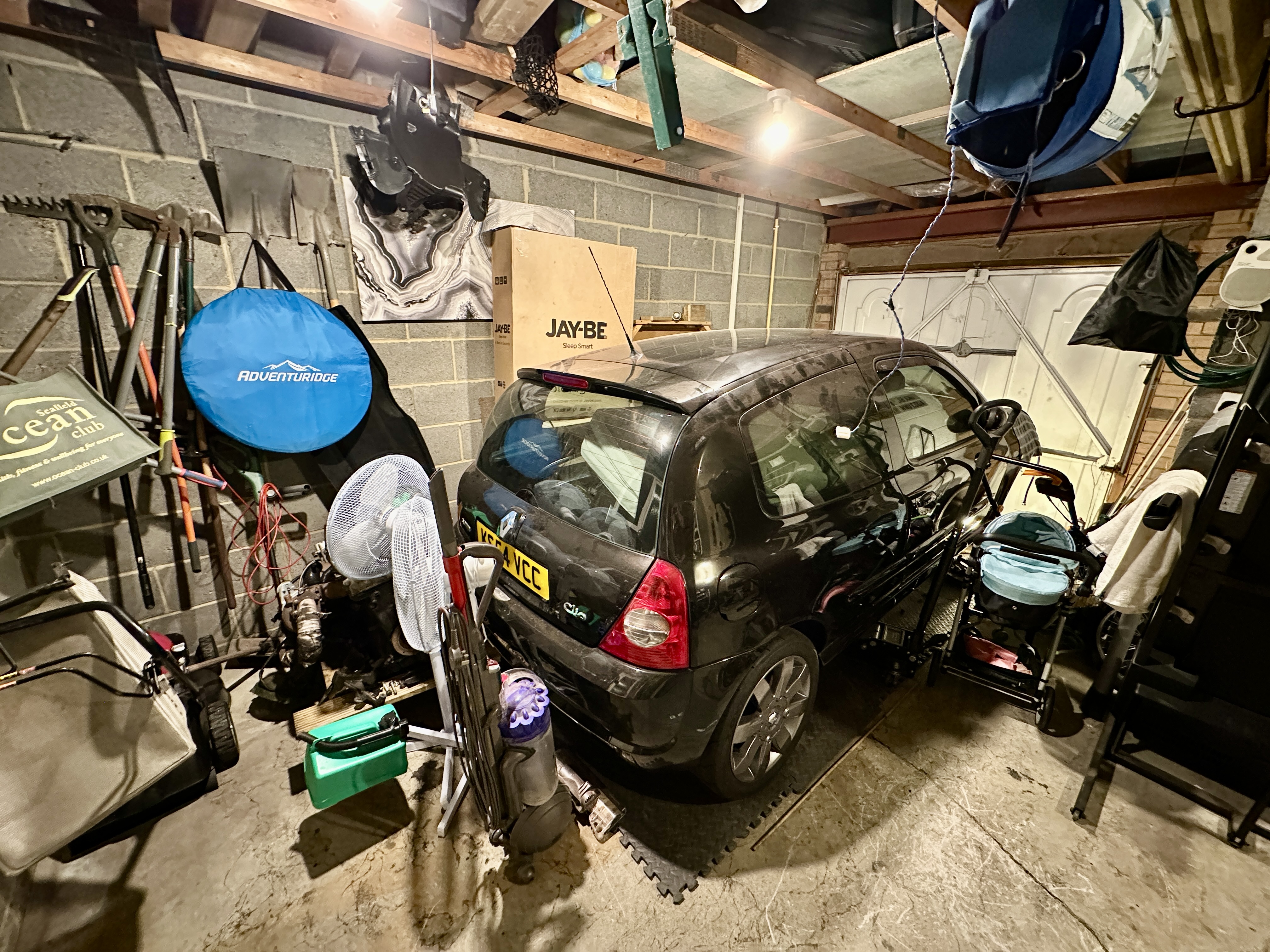

I had also tidied the garage a bit at the weekend too. It’s still surrounded by shite but at least I can get near it now!

Just stick a thicker head gasket on and have done🤣 The dCi rack does look smaller, I'd send a picture but I can't find any on my phone
We have but not sure we settled on how much thicker. It’s a ropey guessing game if I guess wrong 🤣.
You haven’t got a rack in stock amongst the 261555156253 bits of Renault have you?
Dci rack for ref. Shoud give a bit more room, and solid mounted compared to the bushes on 172 rack..View attachment 1761833

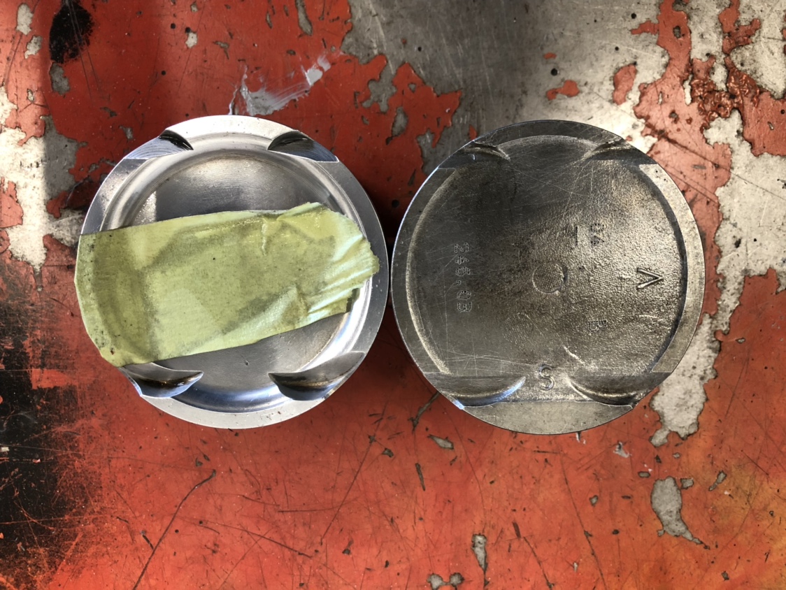

Cant see no machining required on 250 pistons to be fair in 172 mate. Whats reason behind it? Same block height as 250 iirc and no protrusion.
Look similar to meg2 pistons with valve cutouts so shouldnt have a problem with vvt activated.

I think the machining idea came from @incy-spider 's build. He Had the 250/265/275 pistons machined to match the exhaust ports of the 182 ones.
Shamelessly stolen pic below. Machined piston on left, original 1x2 on right.

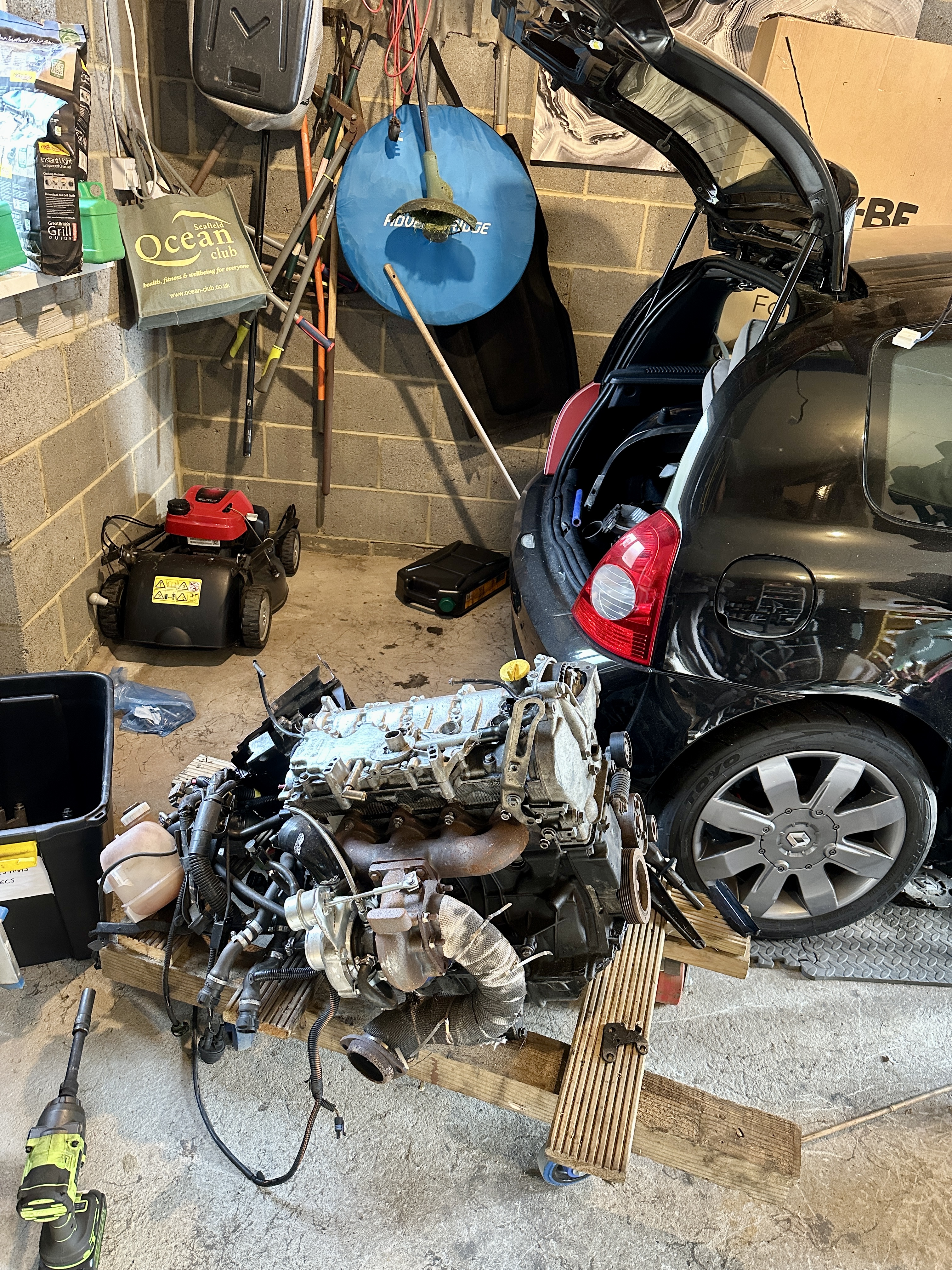

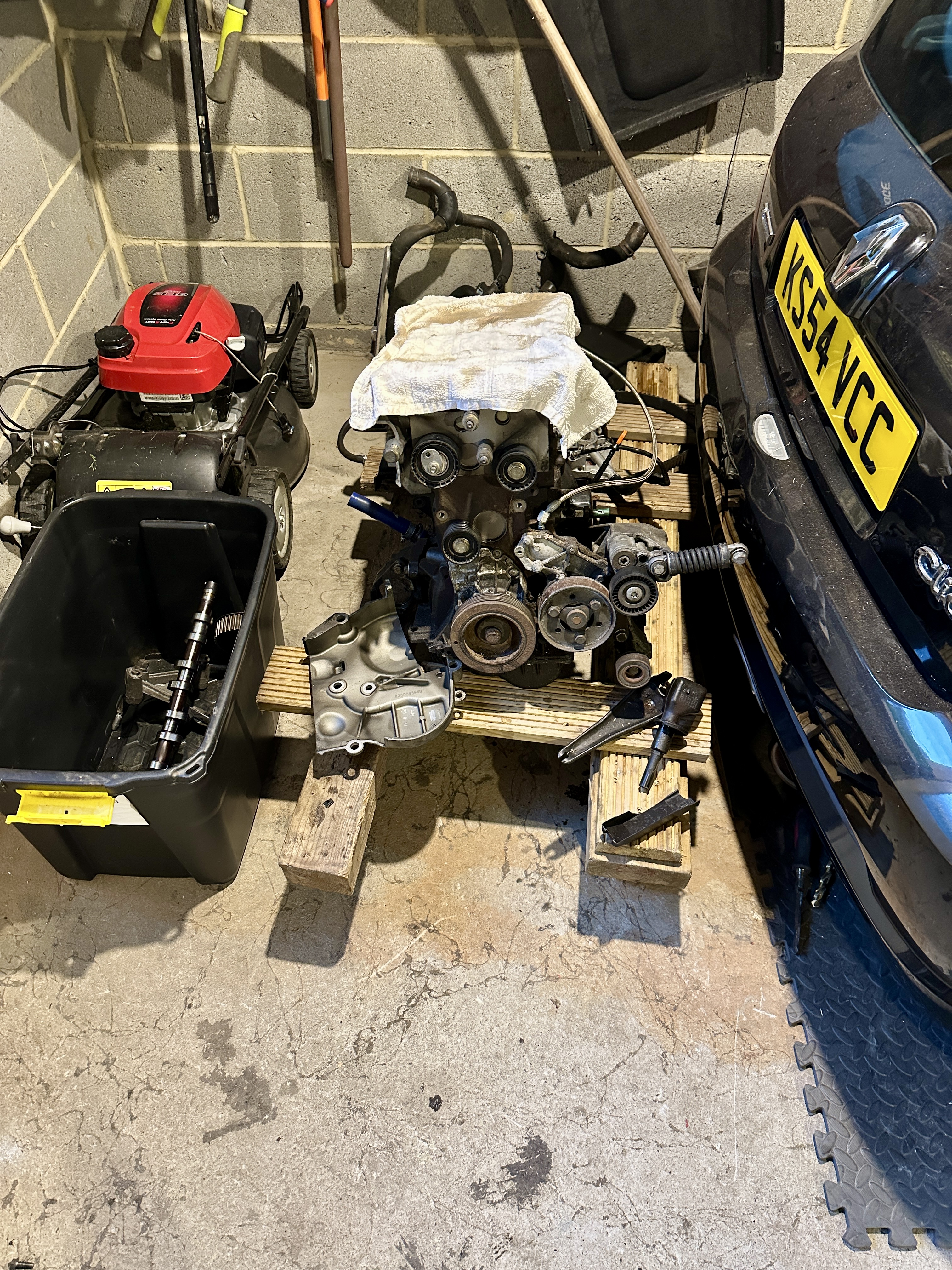

I had a free afternoon today and it was warm enough so went and hid in the garage for a bit.
I was bored of subframe related activities so booled the block out from its corner on its ultra high tech engine stand.

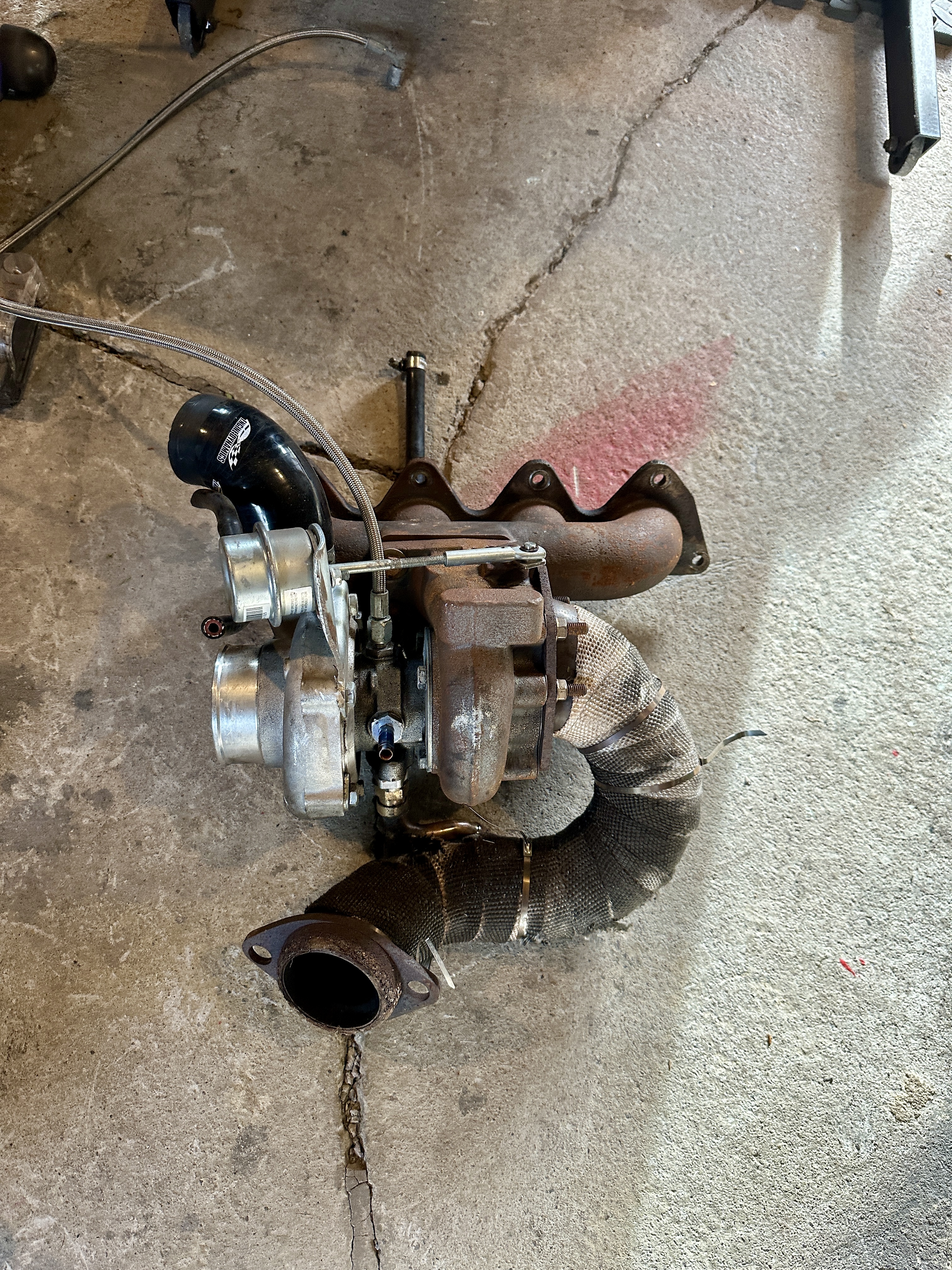

The plan was to strip it down and see how far I got. Wuhan whistler / Tommy Tisher off.

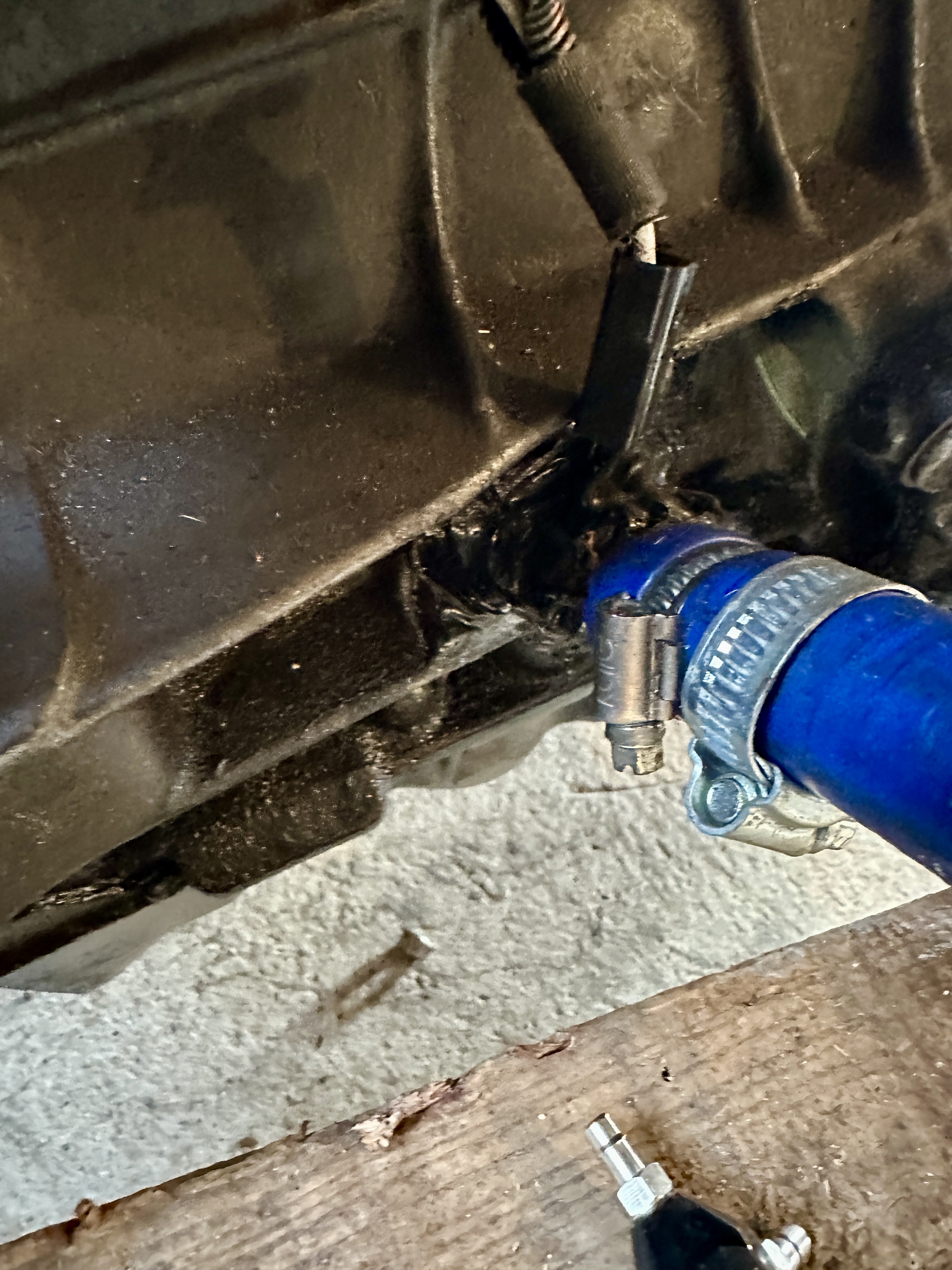

I need to redo this return as it’s a bit of a bodge. It’ll be a doddle with the engine out and plenty of room to work in, instead of being folded backwards and working blind at some obscene angle with the engine in place.

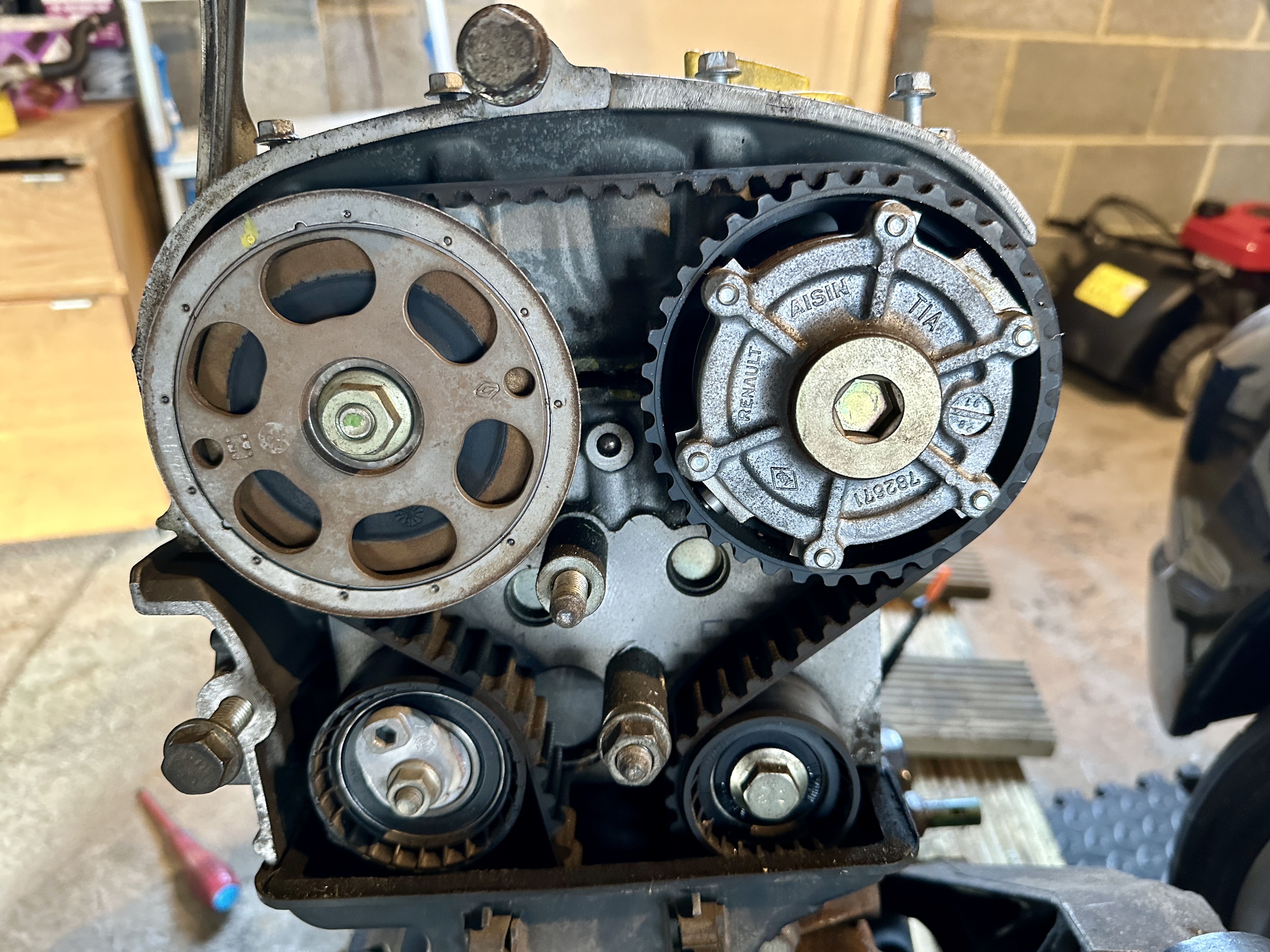

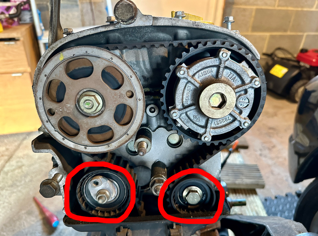

With that off I started to take the rocker cover off. Popped the timing belt cover off first. I’m convinced the timing has always been slightly out on this engine. It was a replacement after I spun a bearing on the original and it was always miles slower than the original. That was one of the reasons why I took the huff and abandoned it in the garage for a decade in the first place.

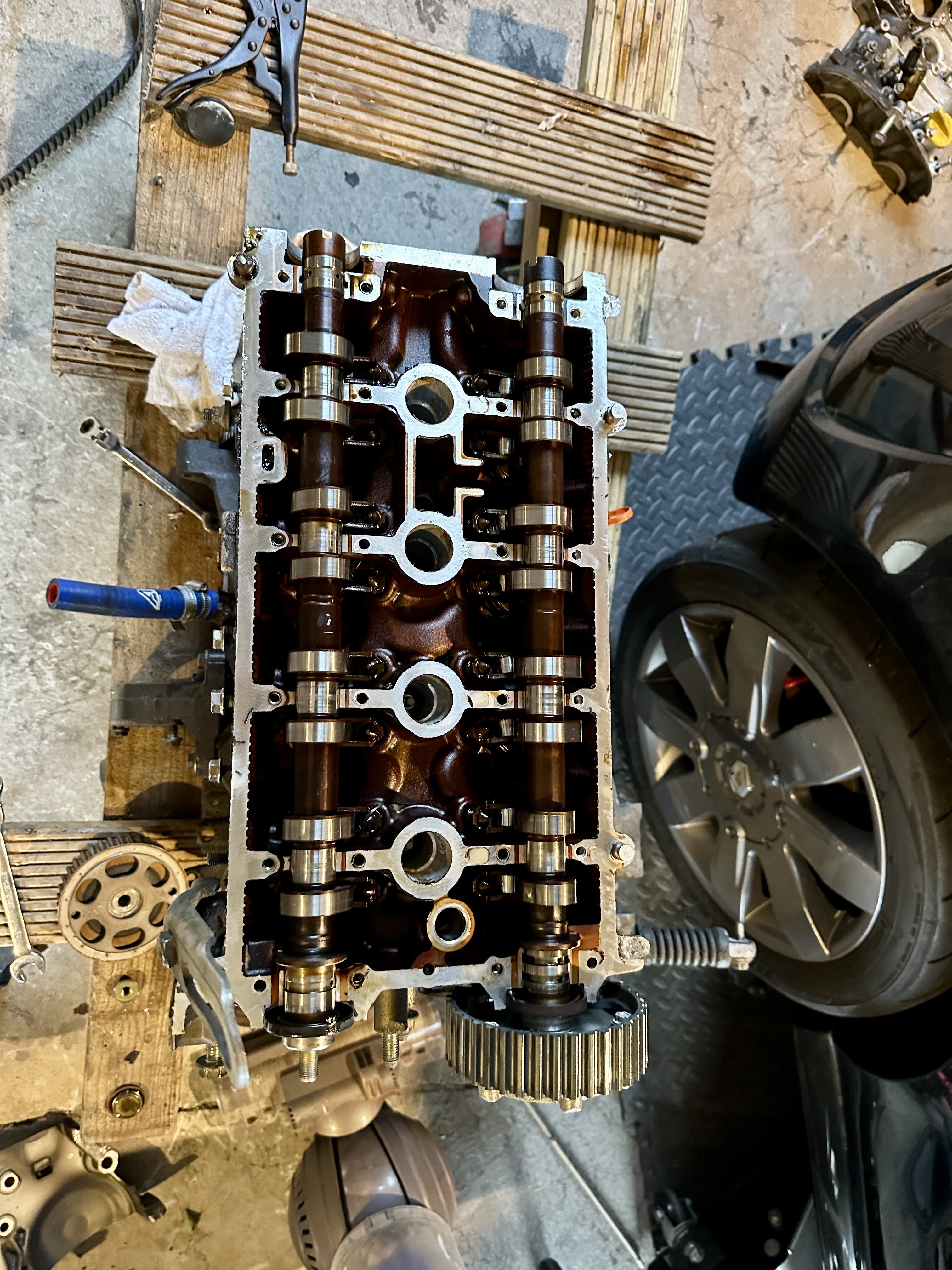

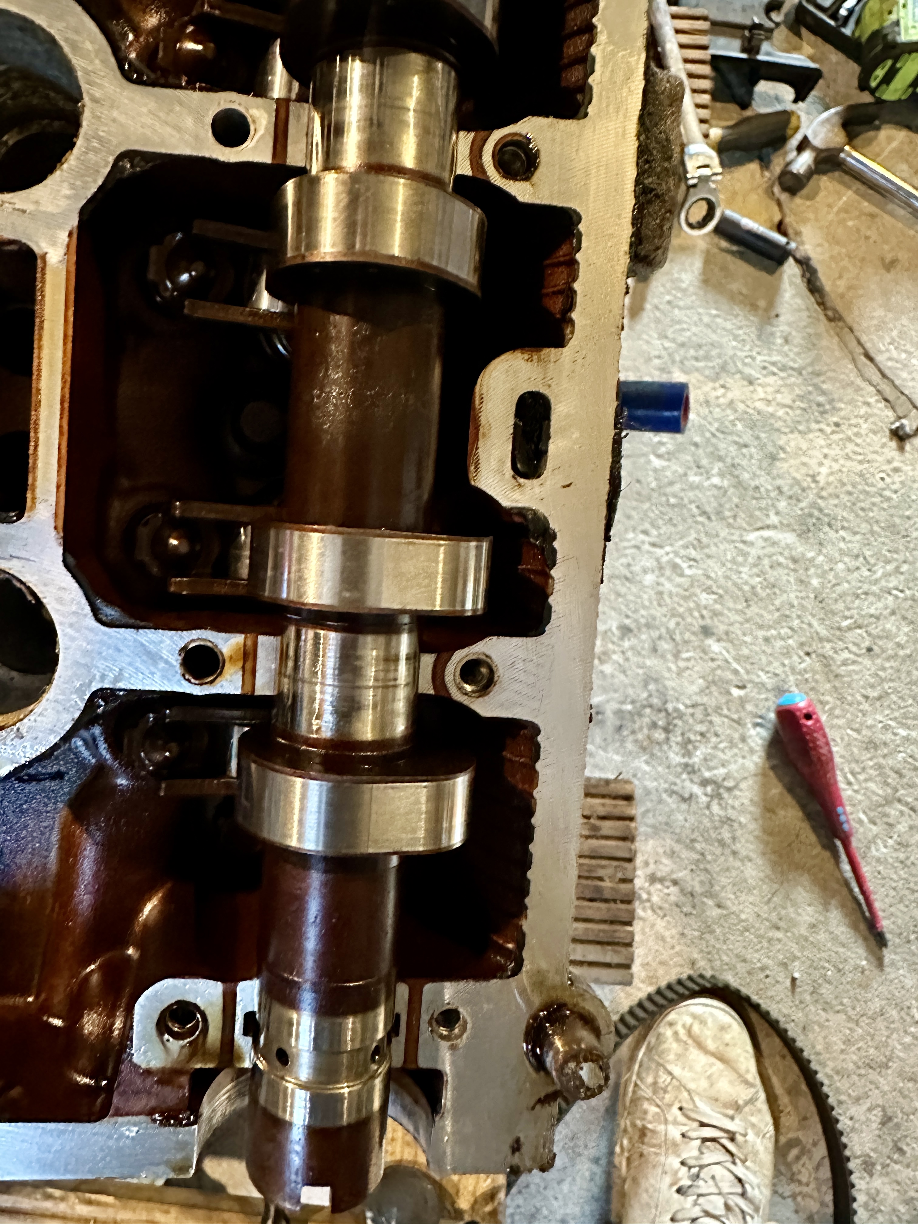

The the rocker cover came off, but only after undoing the cam pulleys. Bit of a stupid design and I very much see now why people say you can’t just pop the rocker off to paint it!
Cams look ok. There’s a few marks on them but nothing I can feel so they’ll be going back in. Mileage on the engine is about 90k (+/- 5k either way)
I popped my 10 year/30,000 mile old cam belt off and as expected it’s perfect. Just more proof that the 5 year interval is a con. It always has and always will be the aux belt that’s the problem - as I’ve shown twice in this thread with badly perished belts that were relatively new. I might even re-use it just to see how many people I can trigger 🤣

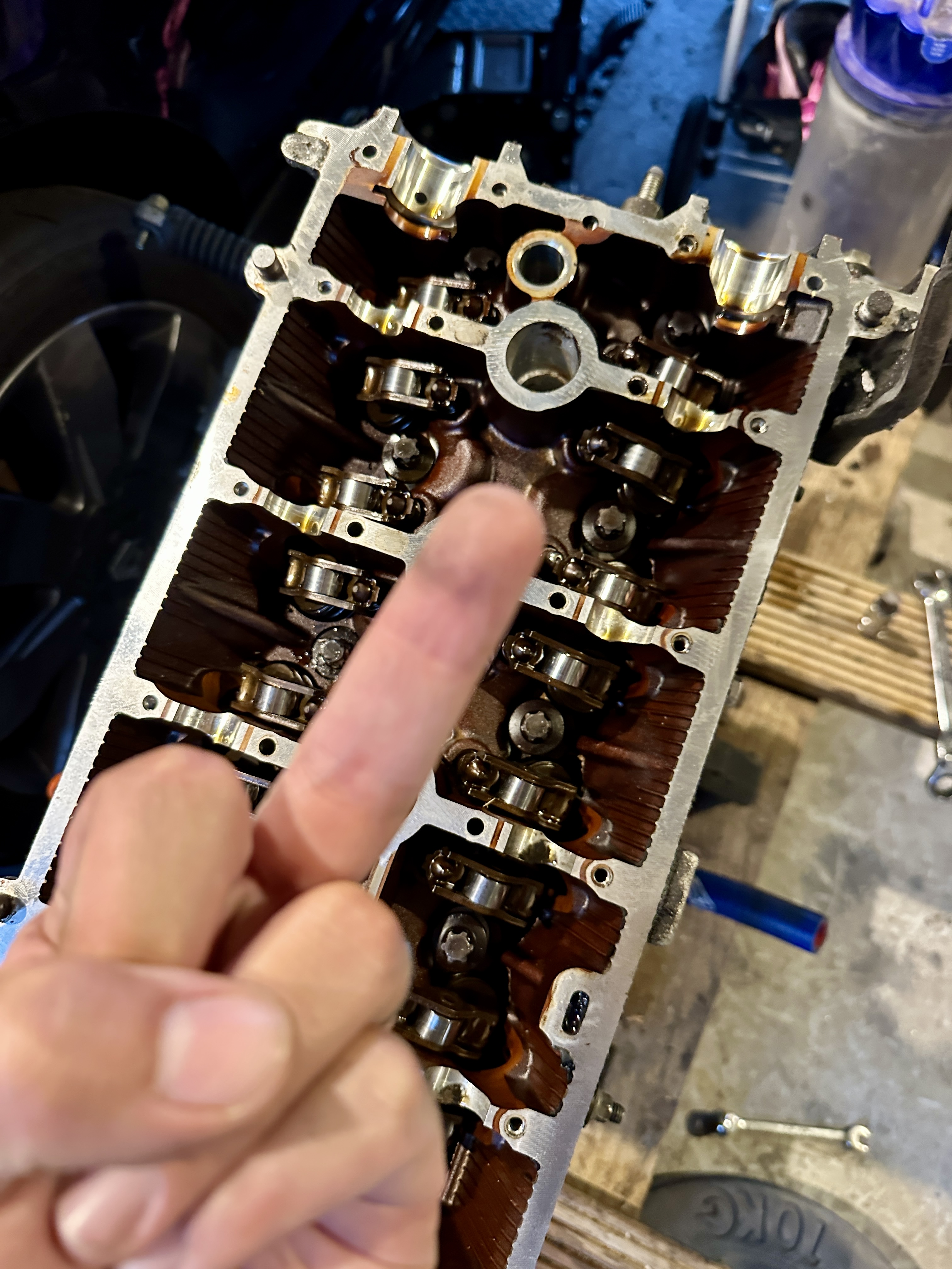

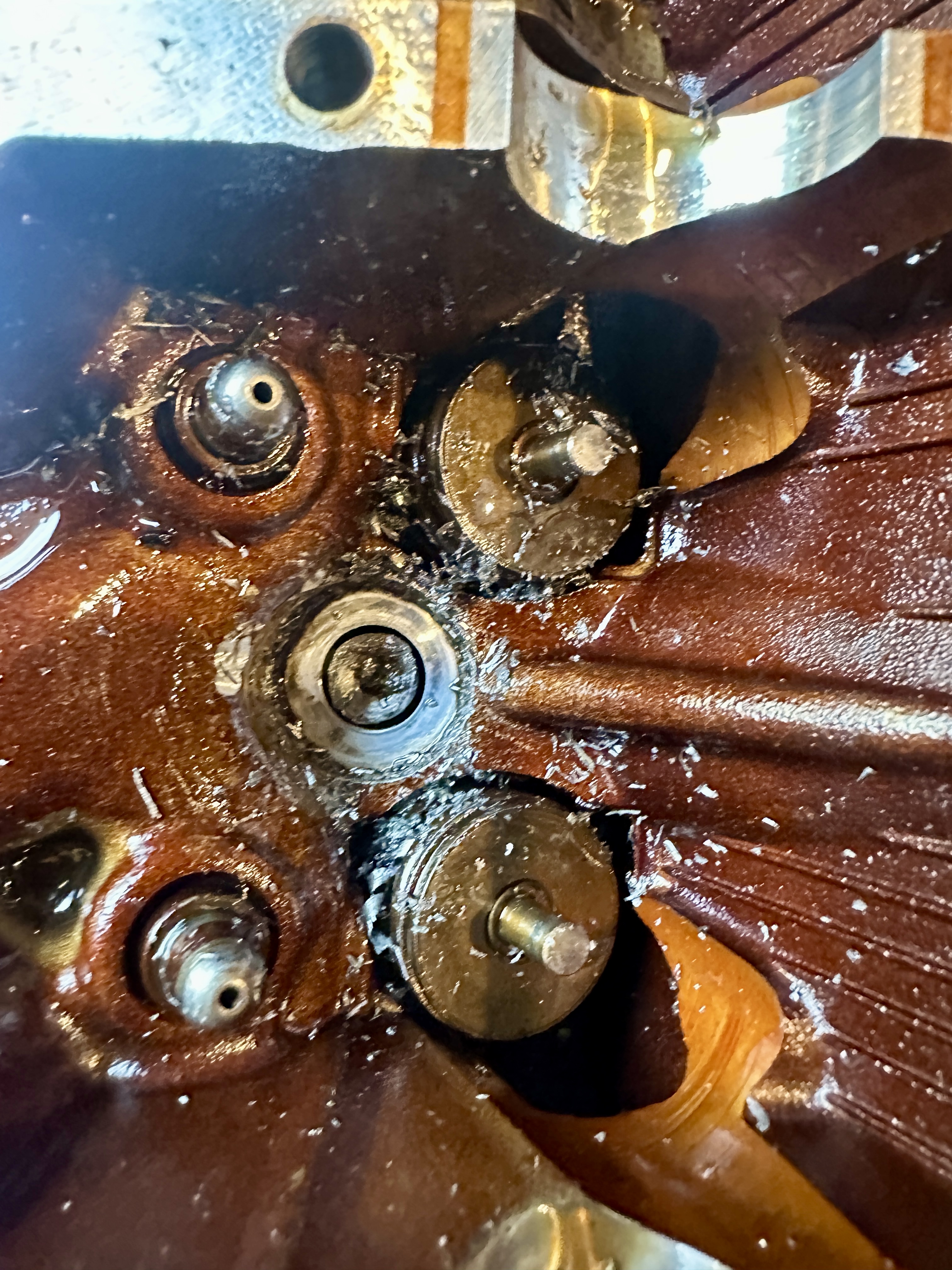

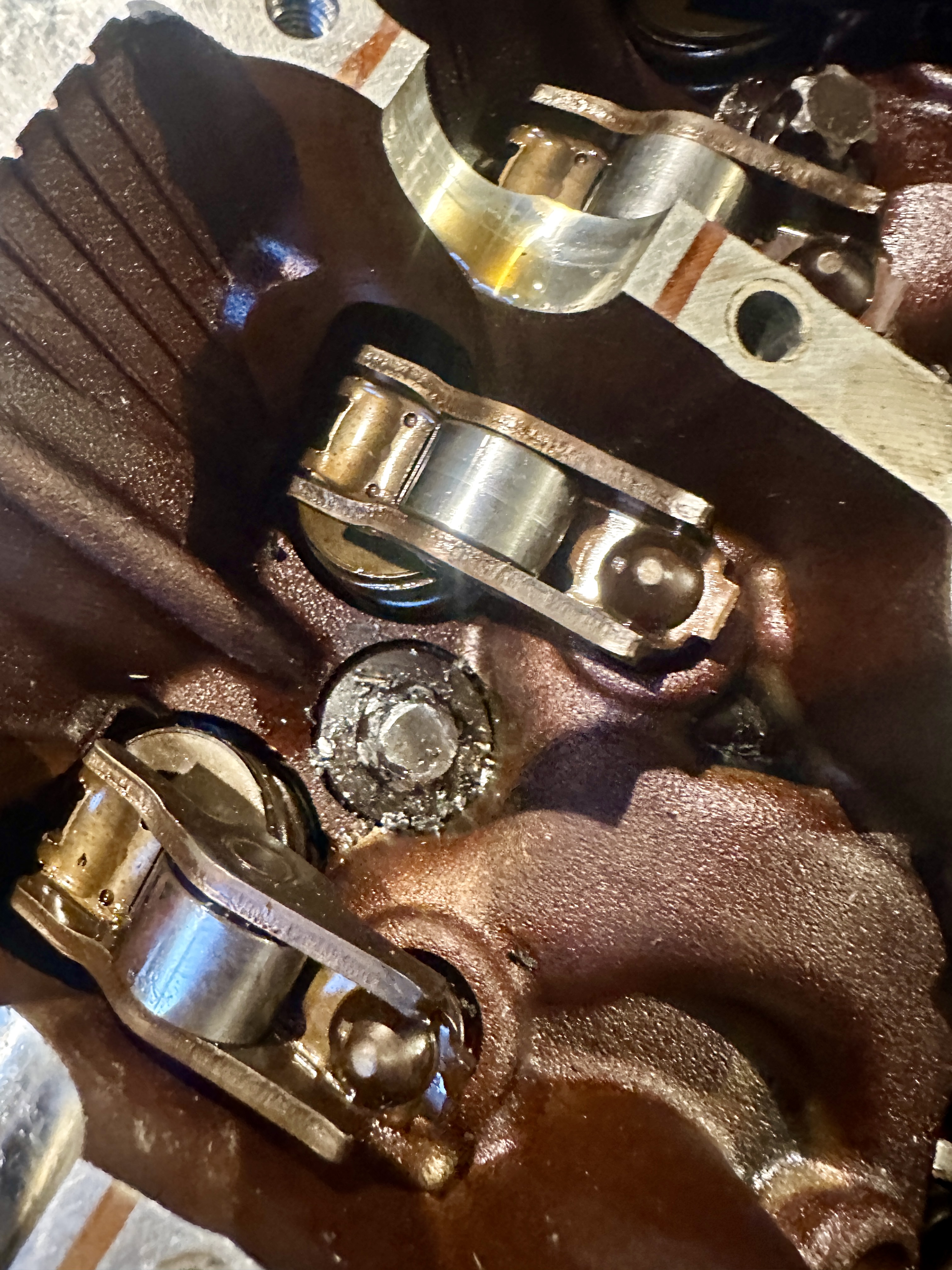

Then it was head off time. All the head bolts came off nicely until one didn’t. The absolute c**t.
I bashed a couple of smaller sockets over it but none would bite hard enough to not pop off as soon as a bit of pressure was applied. So that’s good, isn’t it.
Only one thing for it. Swear a lot
The arsehole is now back in its corner where it belongs.
I’m not really sure how to tackle the bolt. I’ve done smaller sockets so kinda exhausted that option. Next I suppose is to consider drilling it but I can imagine that being an absolute nightmare. I did consider tightening it until it snapped, but I can guarantee it would either pull the thread out or snap level with the block and totally f**k me 🤦‍♂️

been there done that, drill the head off, easy really. small bit down the middle then keep stepping up (y)
You’re right. I just need to not be a fanny and crack on with it.
Saving grace is that it’s only one. Just had a look and all my metal bits look fucked so will order some this week. Ironically they are all fucked because they were last used to drill out pretty much every single sump bolt when they rounded off too.

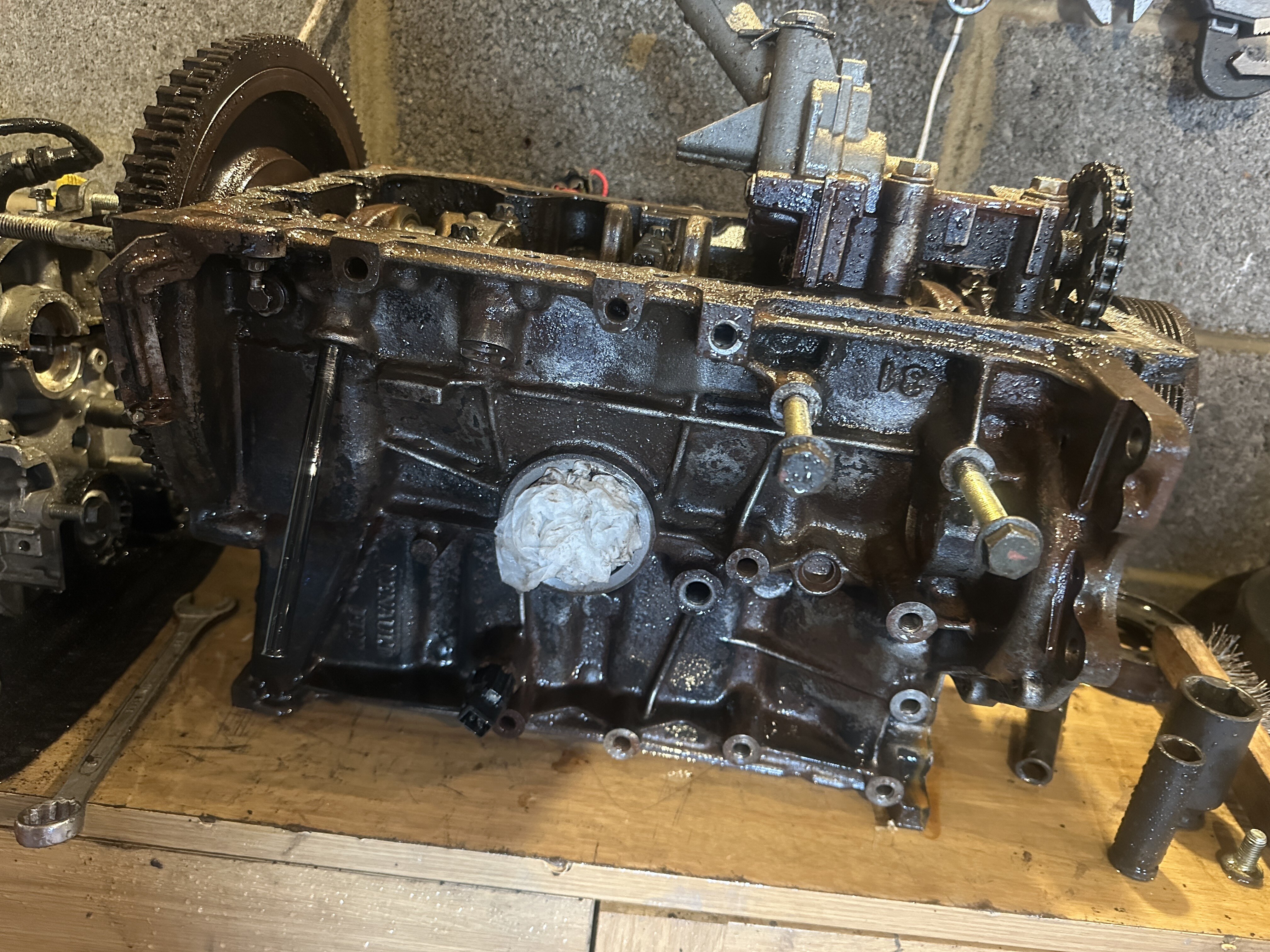

Bit more done tonight. Not sure I believe it myself either.
I had a sit down chat with myself last night and told myself to stop being so soppy. I bought some decent drill bits this afternoon and got on with getting that head bolt off. You weren’t wrong @Adey. - absolute doddle.
It’s a bit swarfy. Got most of it with a magnet and the rest will blast off later.

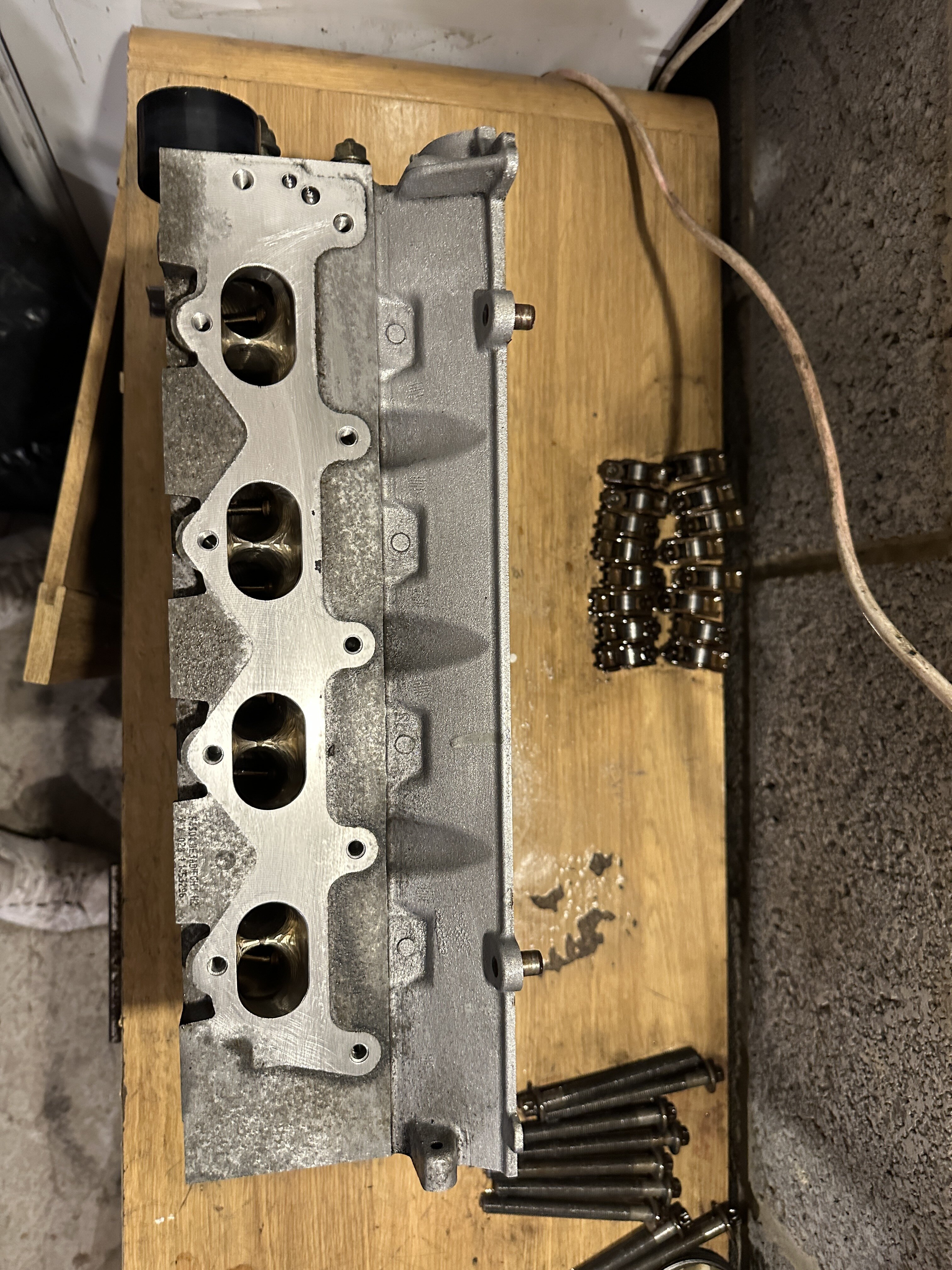

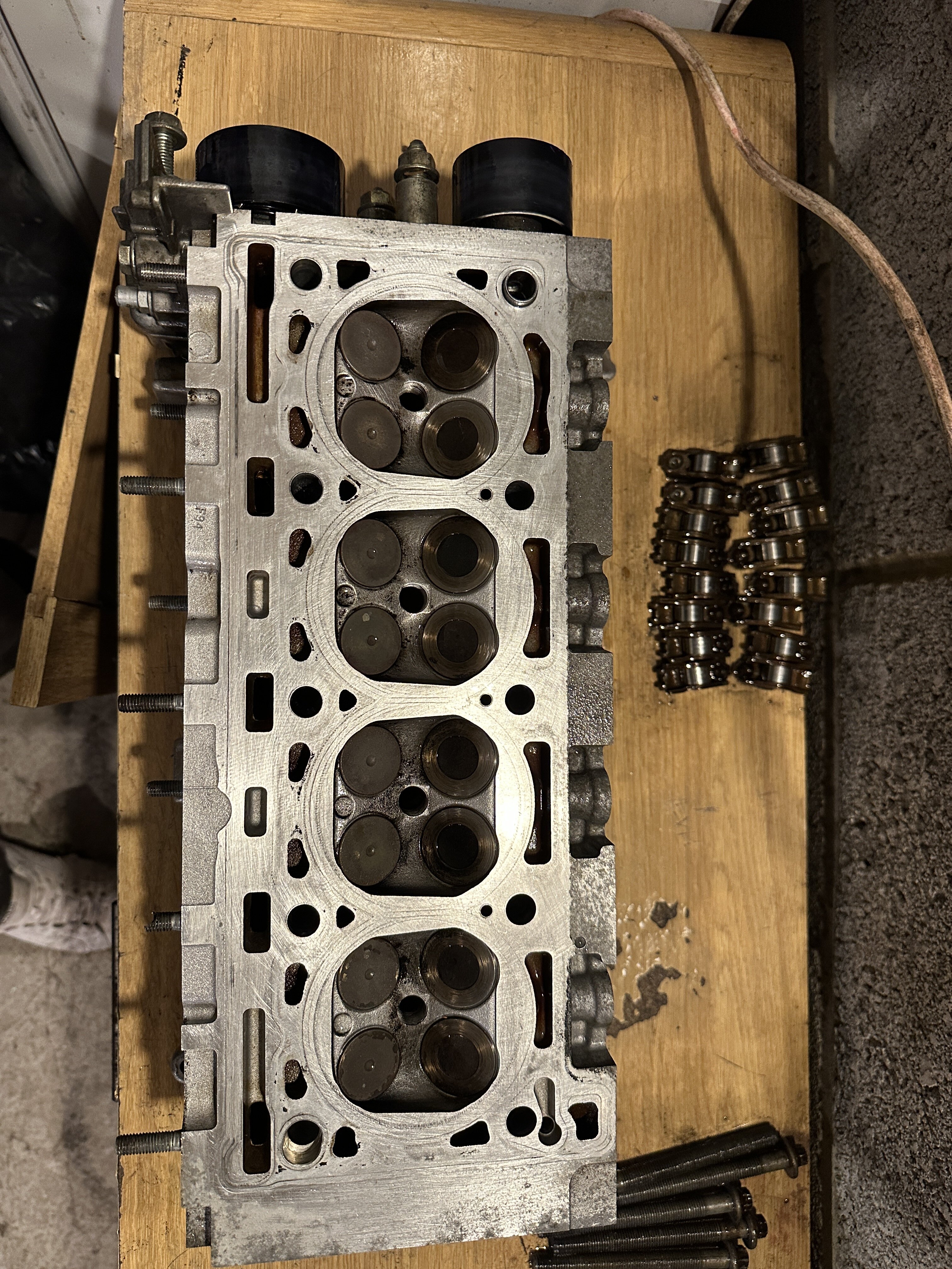

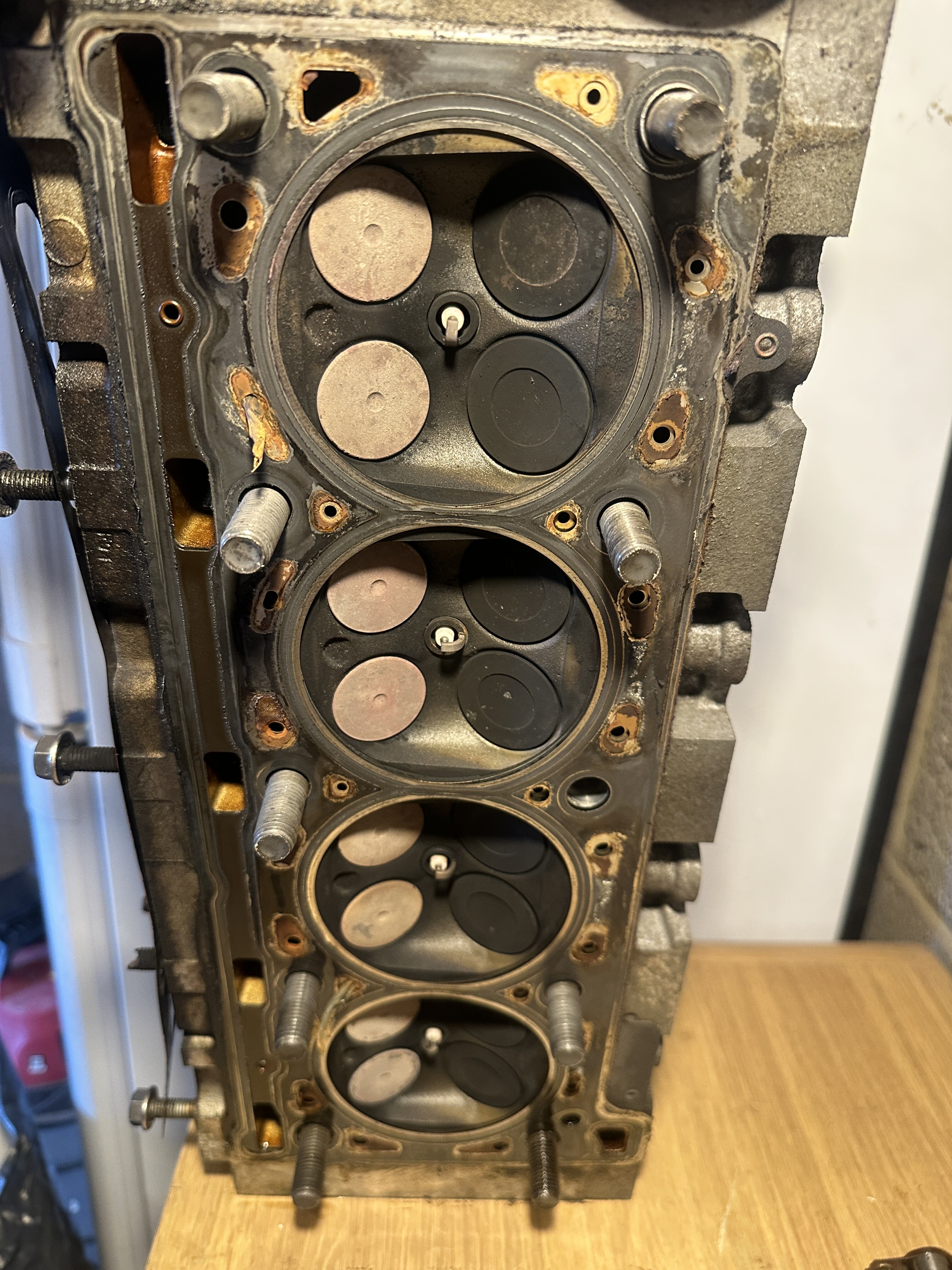

Head looks pretty good to be honest. I had considered upgraded valves and springs but looking at that I won’t be bothering. That’ll be going back on exactly as it is. Some of the water ways are a bit scabby so I’ll clean what I can see

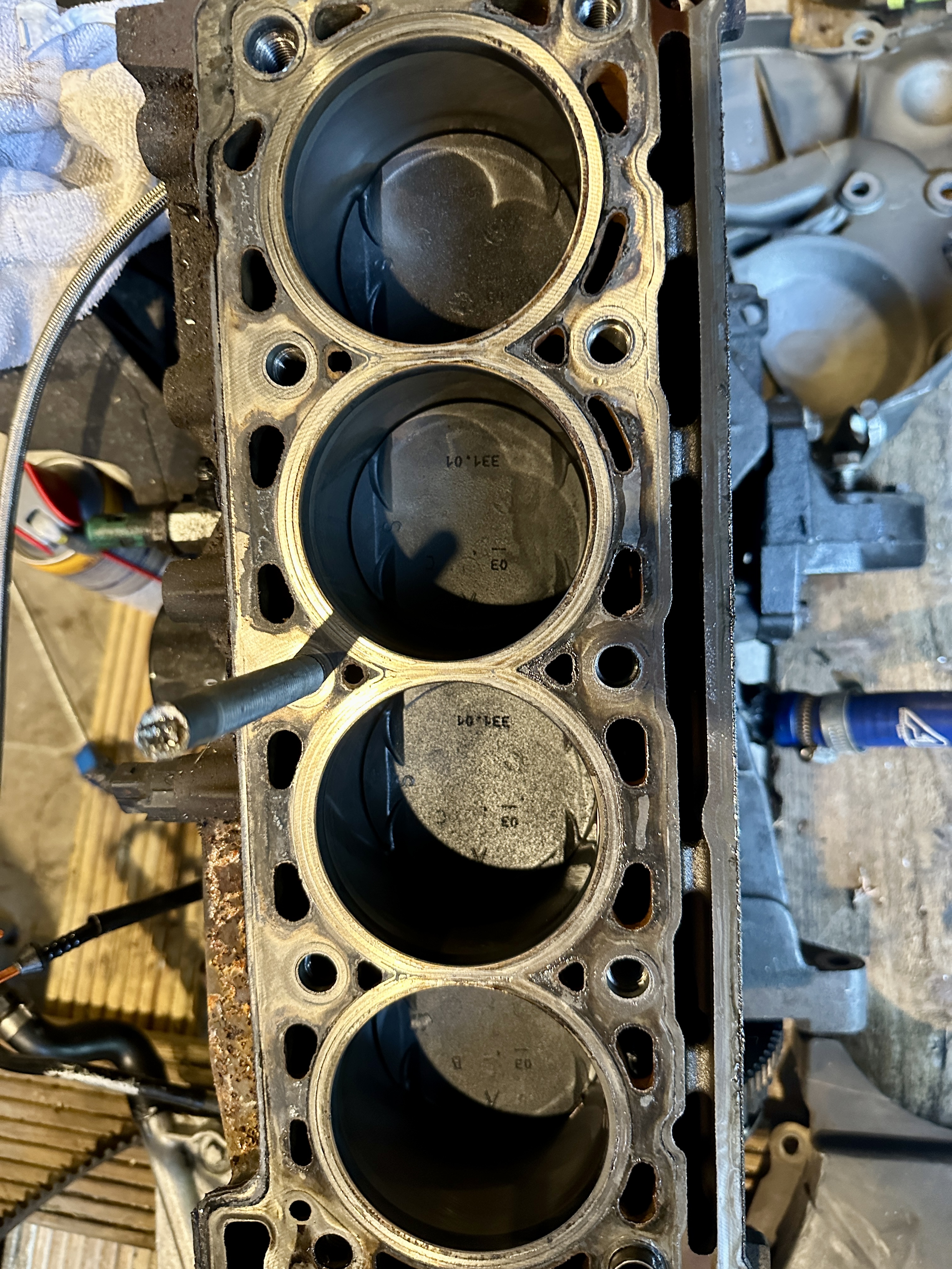

Bores look good too
Much nicer than the ones on the shite N57 I stripped last yeat

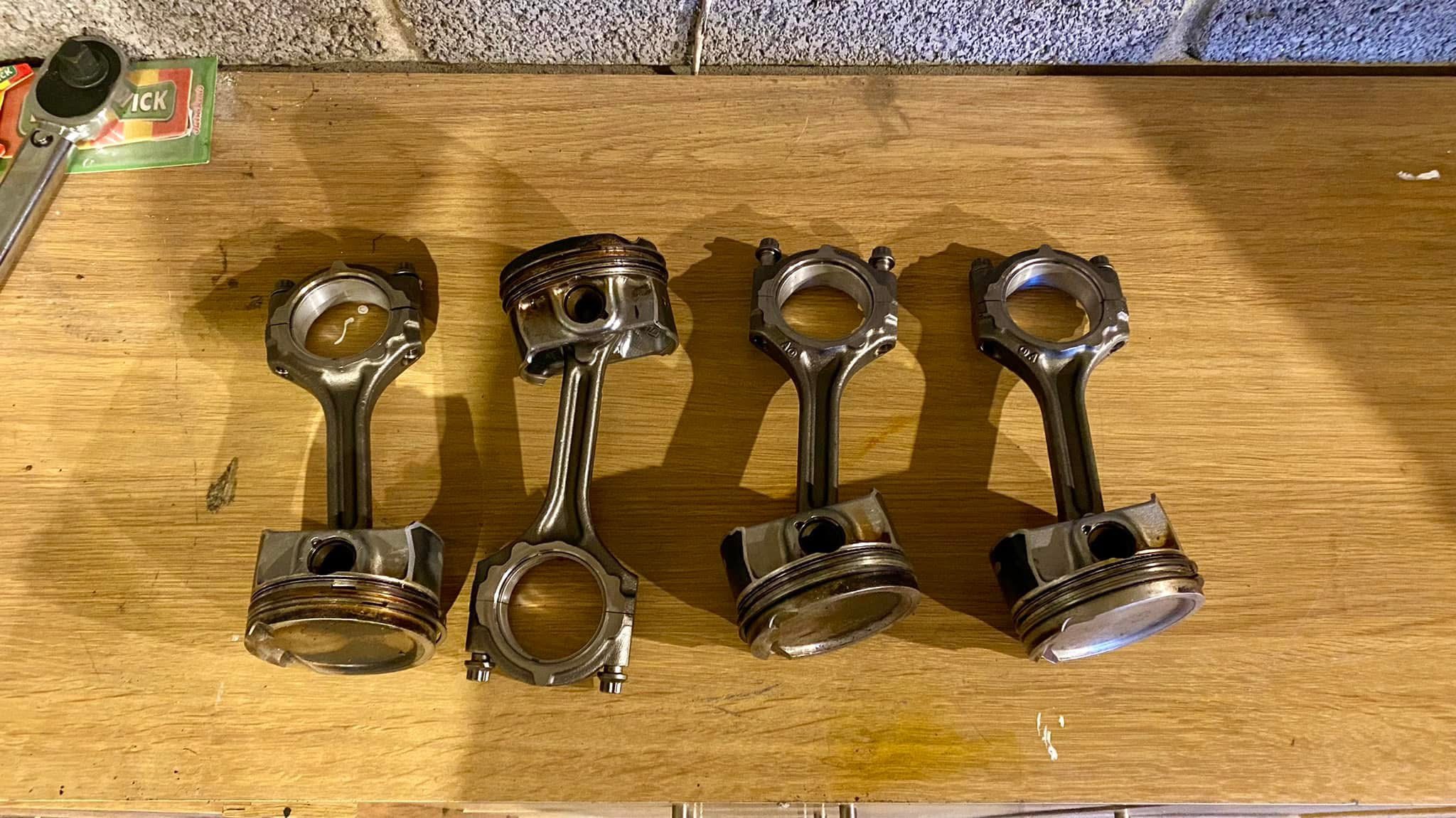

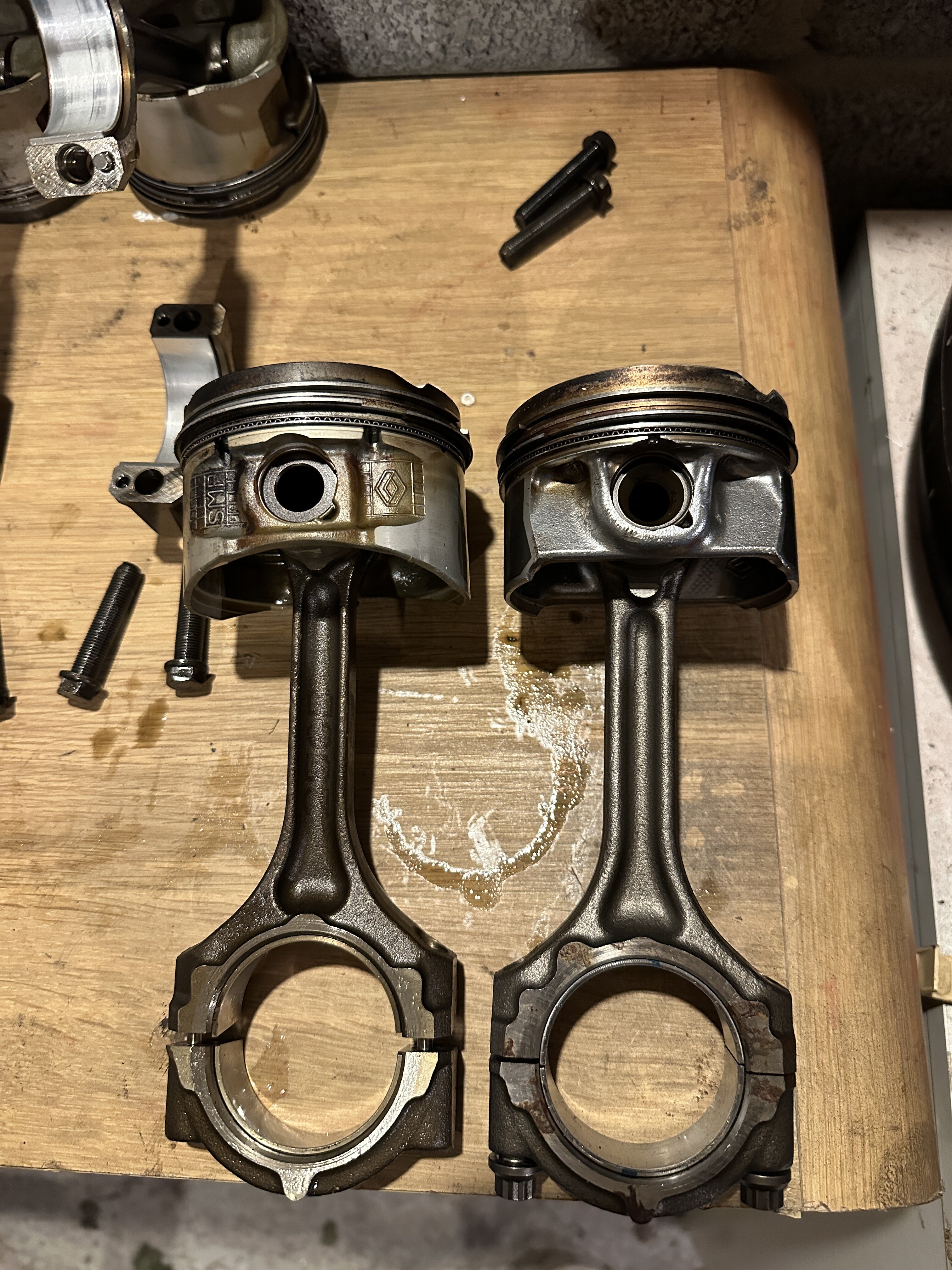

Old pistons oot. Crank looks tidy.

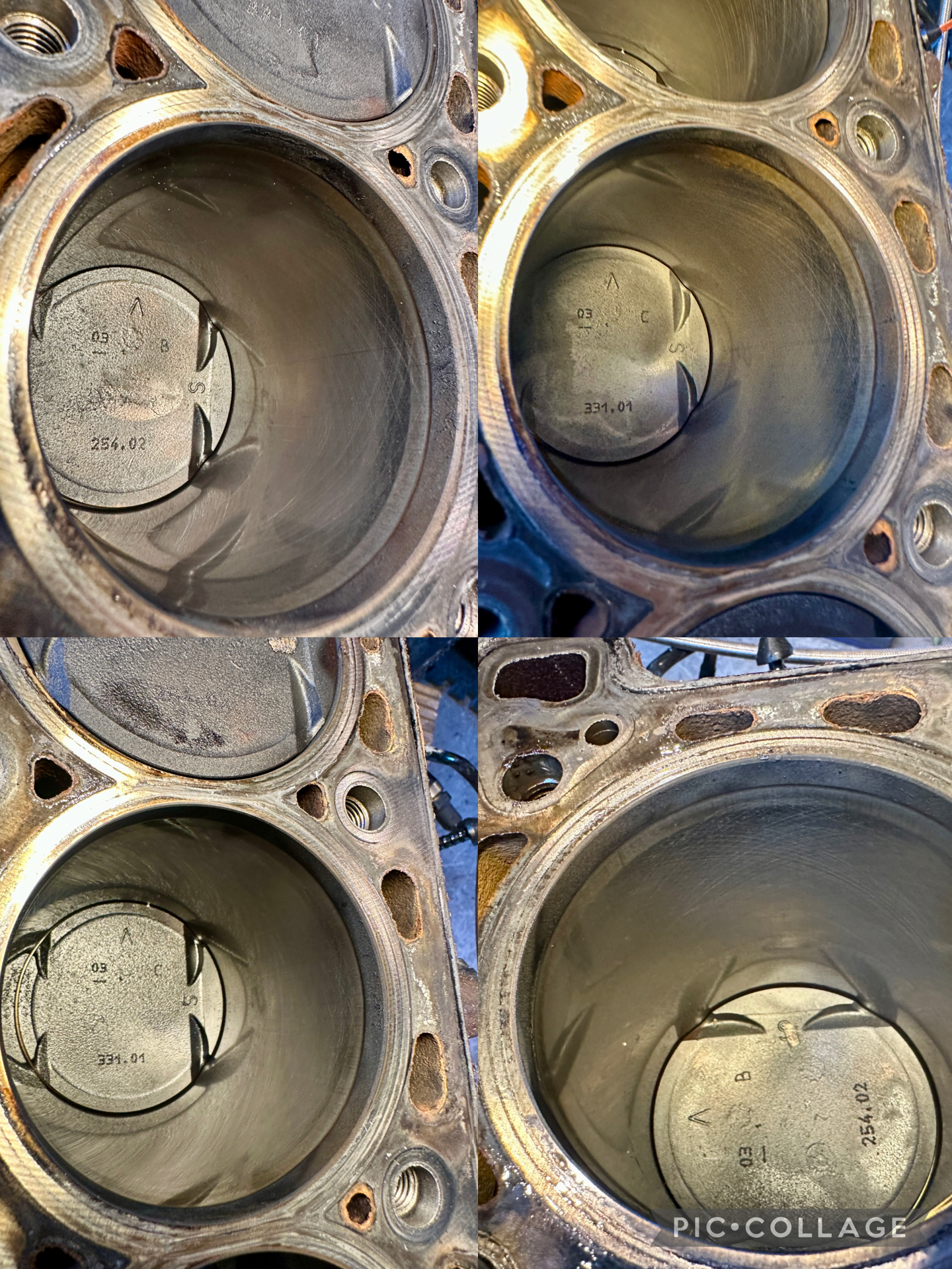

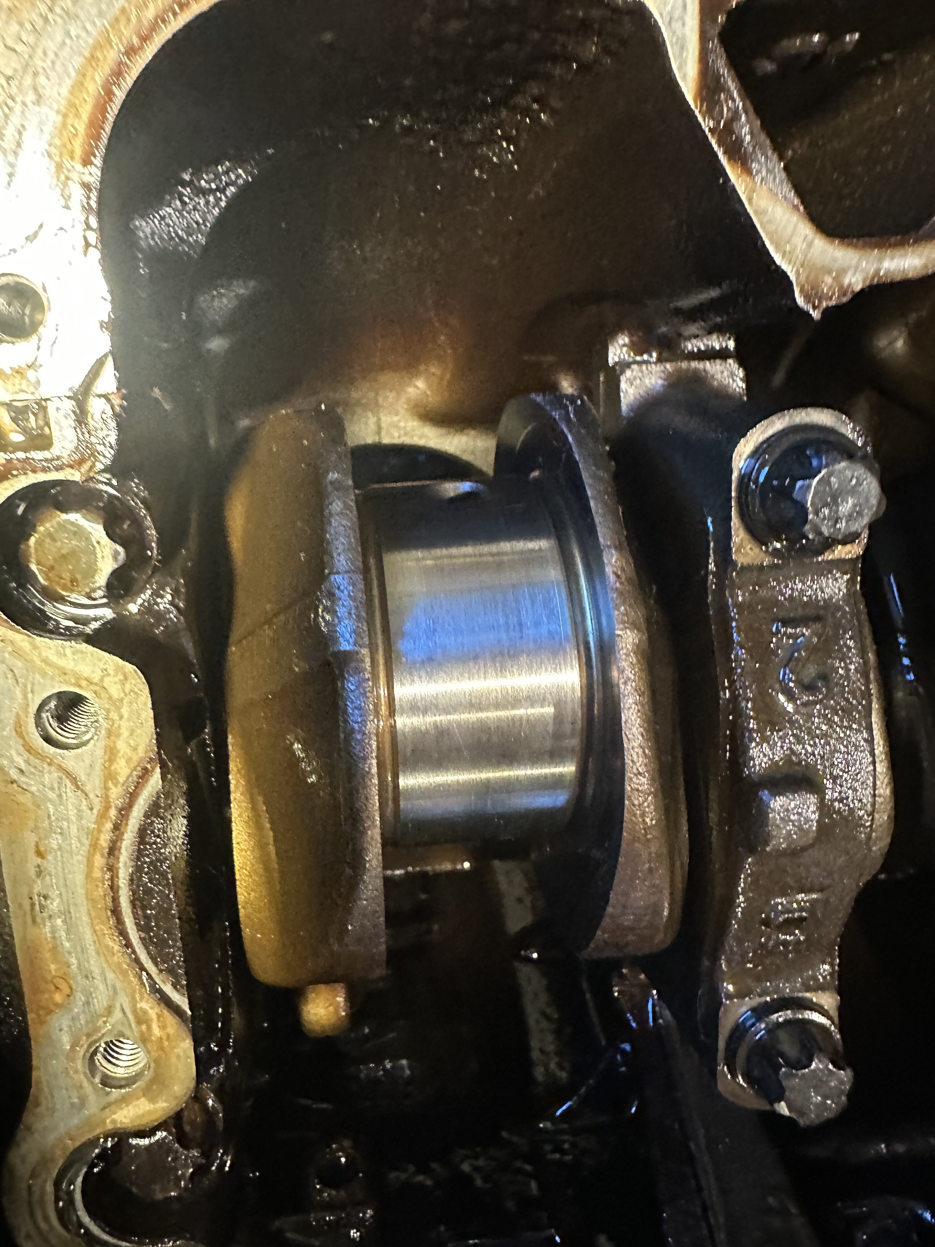

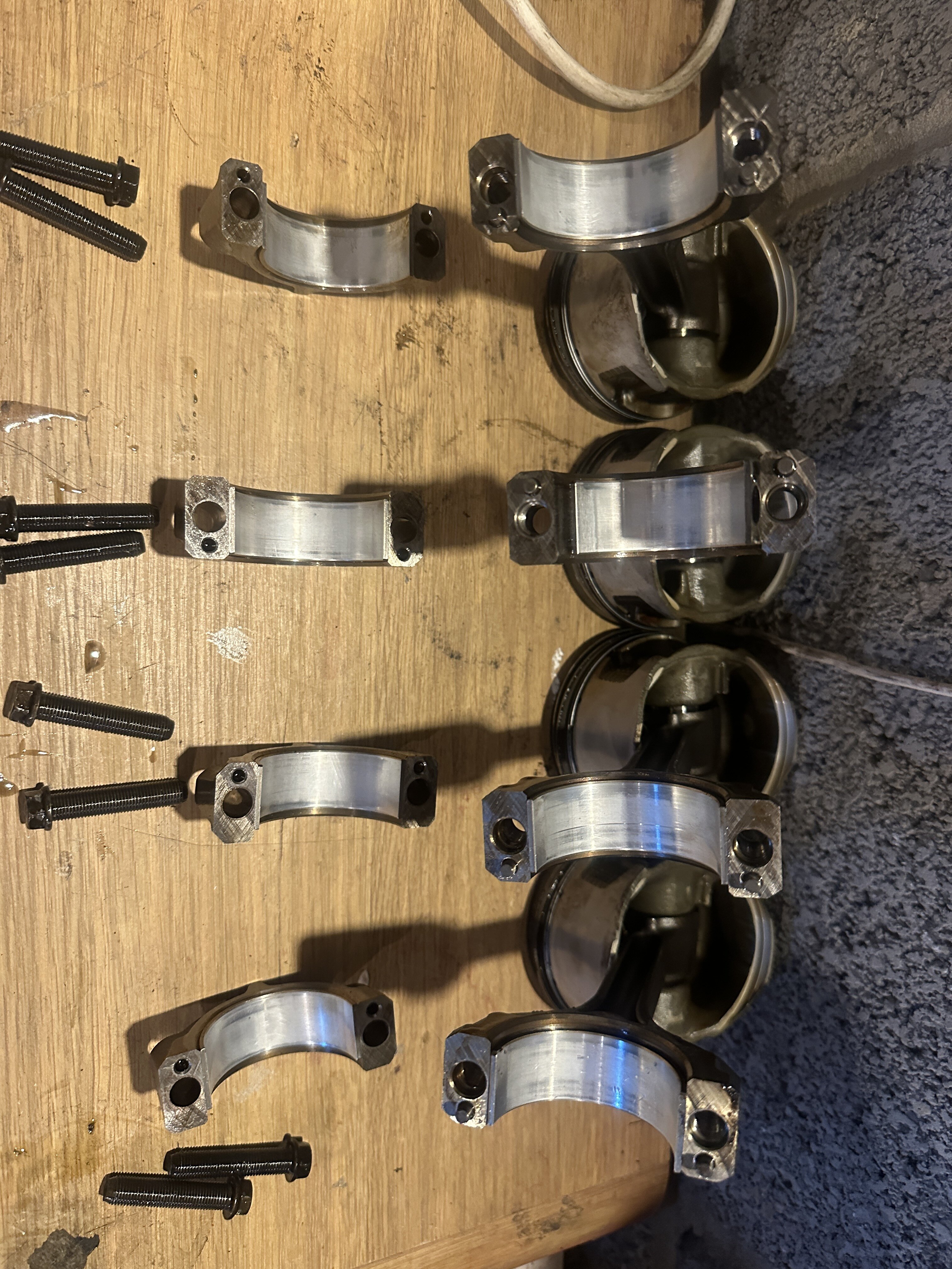

Pistons, rods and caps. There’s some wear on the bearings but not much to write home about. Again - I’m happy enough with how it’s held up.

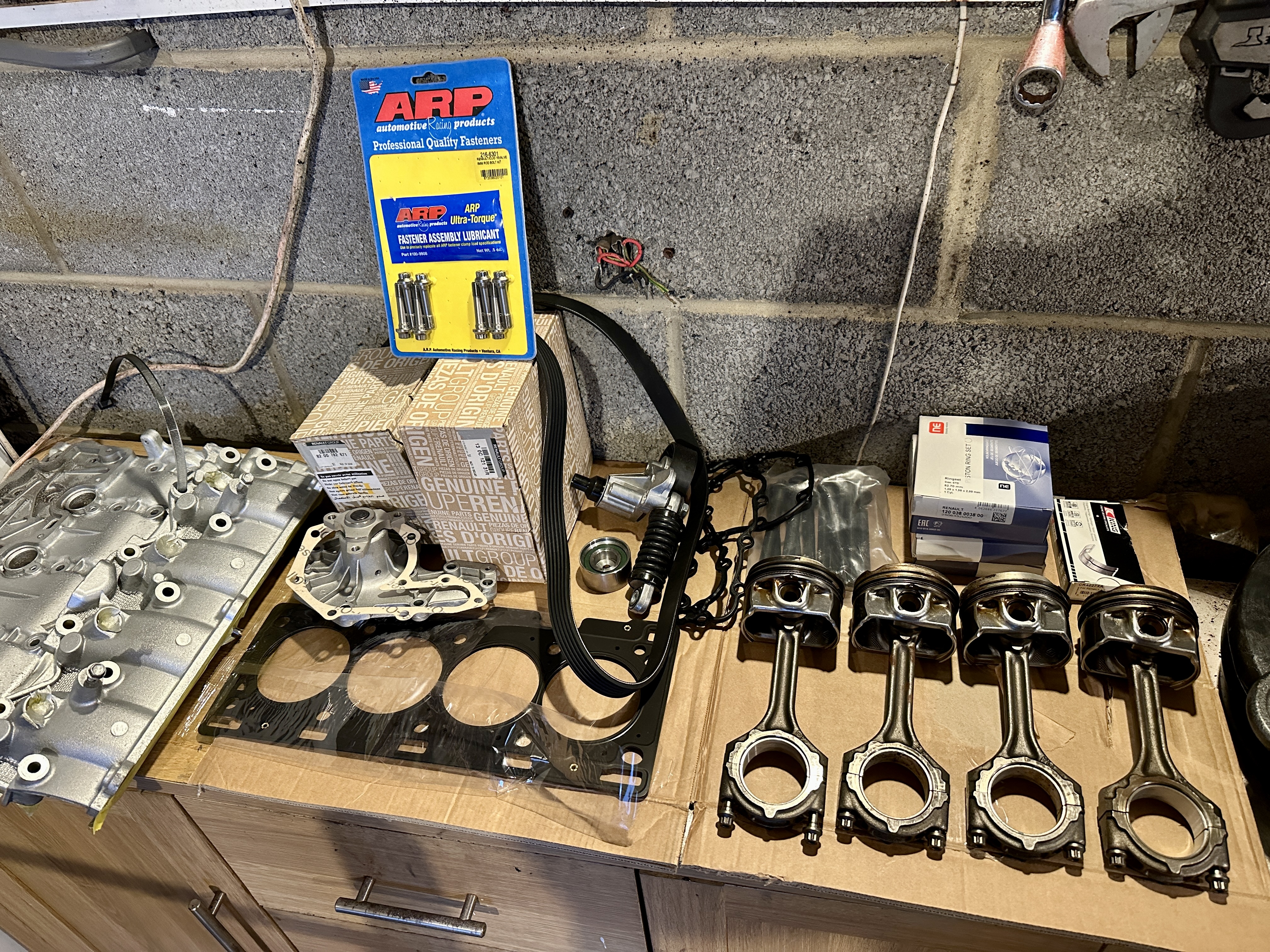

And this is a side by side of what’s going in, 182 on left and the new ones on right.
So that’s it for now. The new pistons have got rings and bearings on them. Am I pikey enough to recycle them - absolutely. However, I’ll be sensible and swap them for new.
Give the rod bearings and the condition of the rest of it, is it worth taking the caps off the mains and swapping those bearings? I’d prefer not to remove the crank so more than happy just to stick the new pistons in and send it.

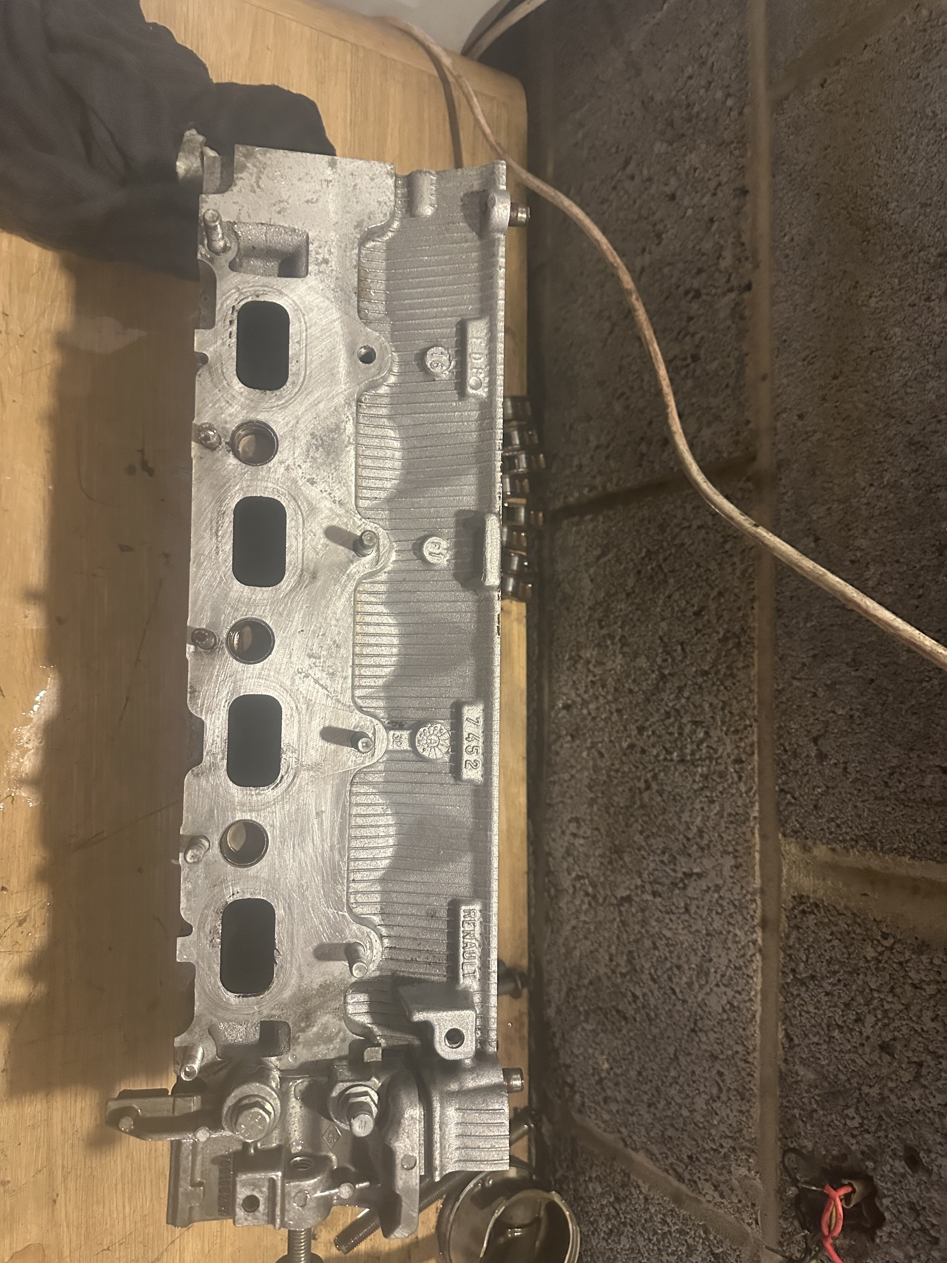

Gave the head a quick clean tonight. Nothing sophisticated, just a scrub with a brush and some degreaser/brake cleaner. Came up ok.
Plan is to paint the whole engine silver - I’d prefer black but silver will make oil leaks much easier to spot. Although I think I’ll get quite a lot of the stuff vapour blasted. The rocker cover, inlet manifold, engine mounts, various brackets for alternator etc will all come up better that way and I can then always just paint them anyway depending on how they come out.

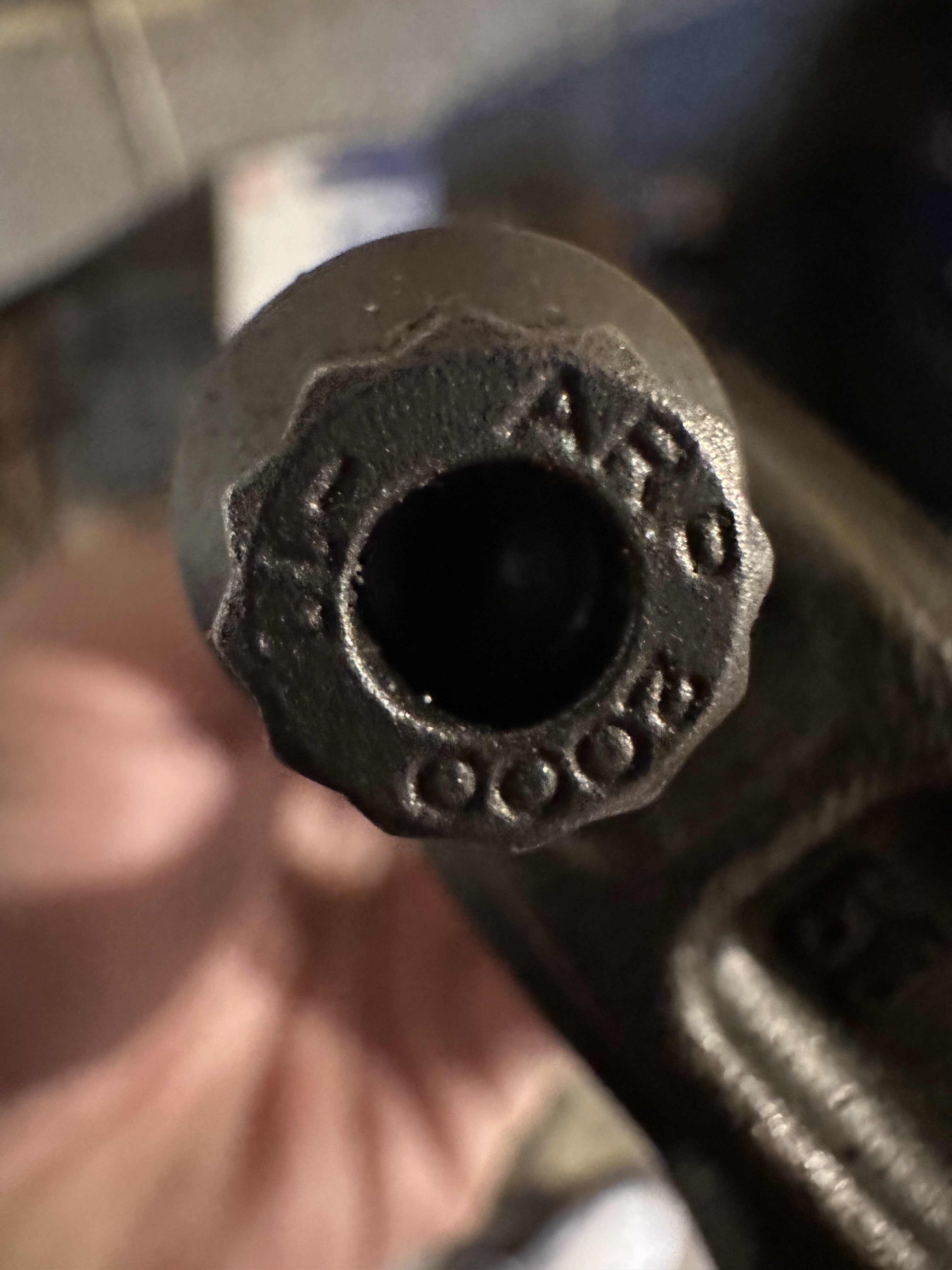

  • Rod bolts - are they single use or re-usable? If they are reusable I’ve got a set so will use them again. If not then what brand/from where? If they are single use can I torque them to check specs with plastigauge or do I need to use another set. I know on the Z20LET which was the last engine I built, you could torque them to spec, take them out and check clearance and then re-use them torqued to spec again. Is this the same?

Id leave the oil pump and mains, I've also used second hand rod bolts with no issues. Plasti gauge is good for checking clearances (y), stock new head bolts were fine for the thicker HG too

I’m going for
Standard main bearings
ARP rod bolts
Meg RS3 piston rings
Standard headbolts
1.5mm head gasket
Aux belt kit
Sump gasket
Keyed crank pulley
Dephaser pulley
Rocker cover gaskets
Waterpump

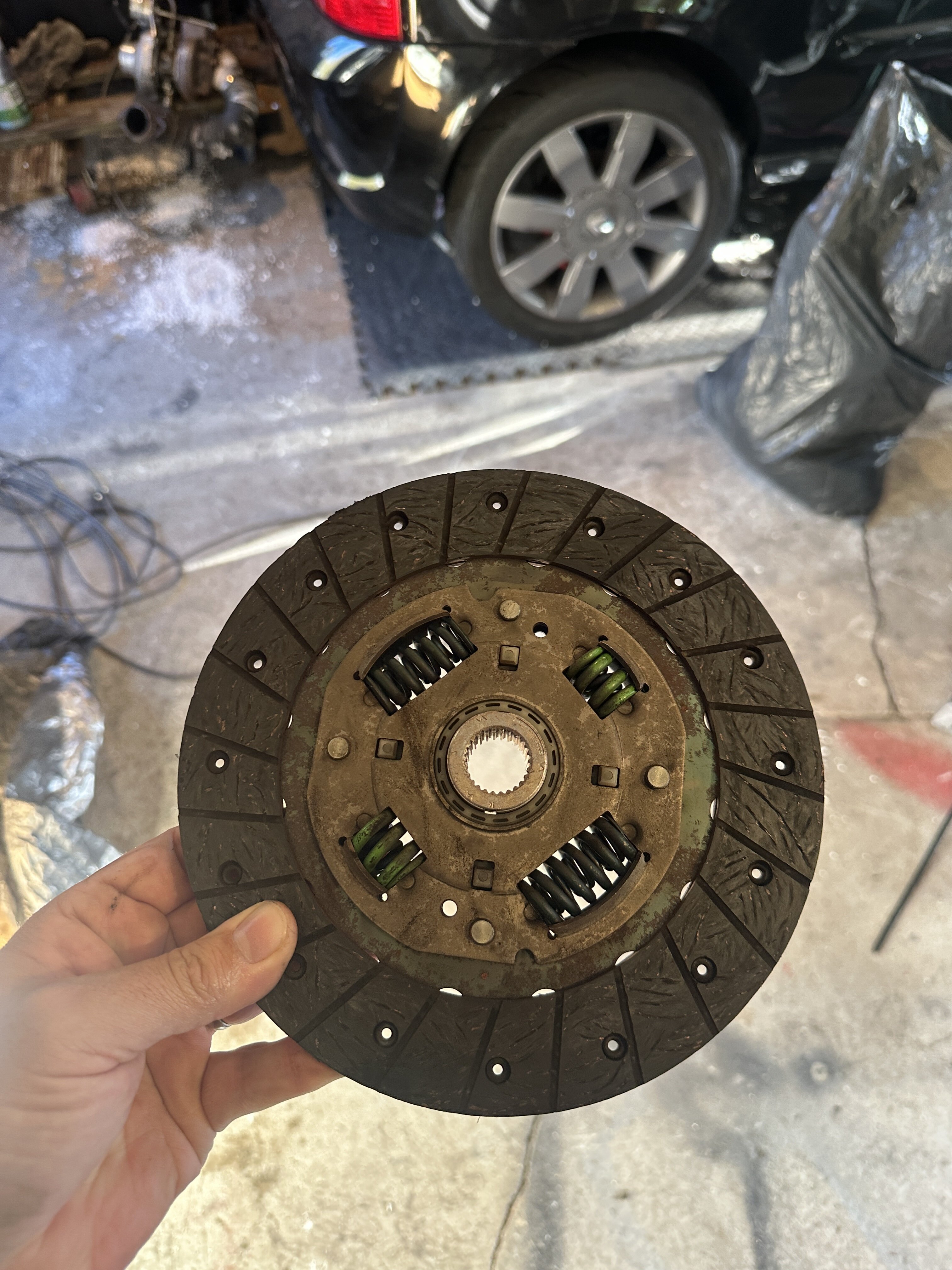

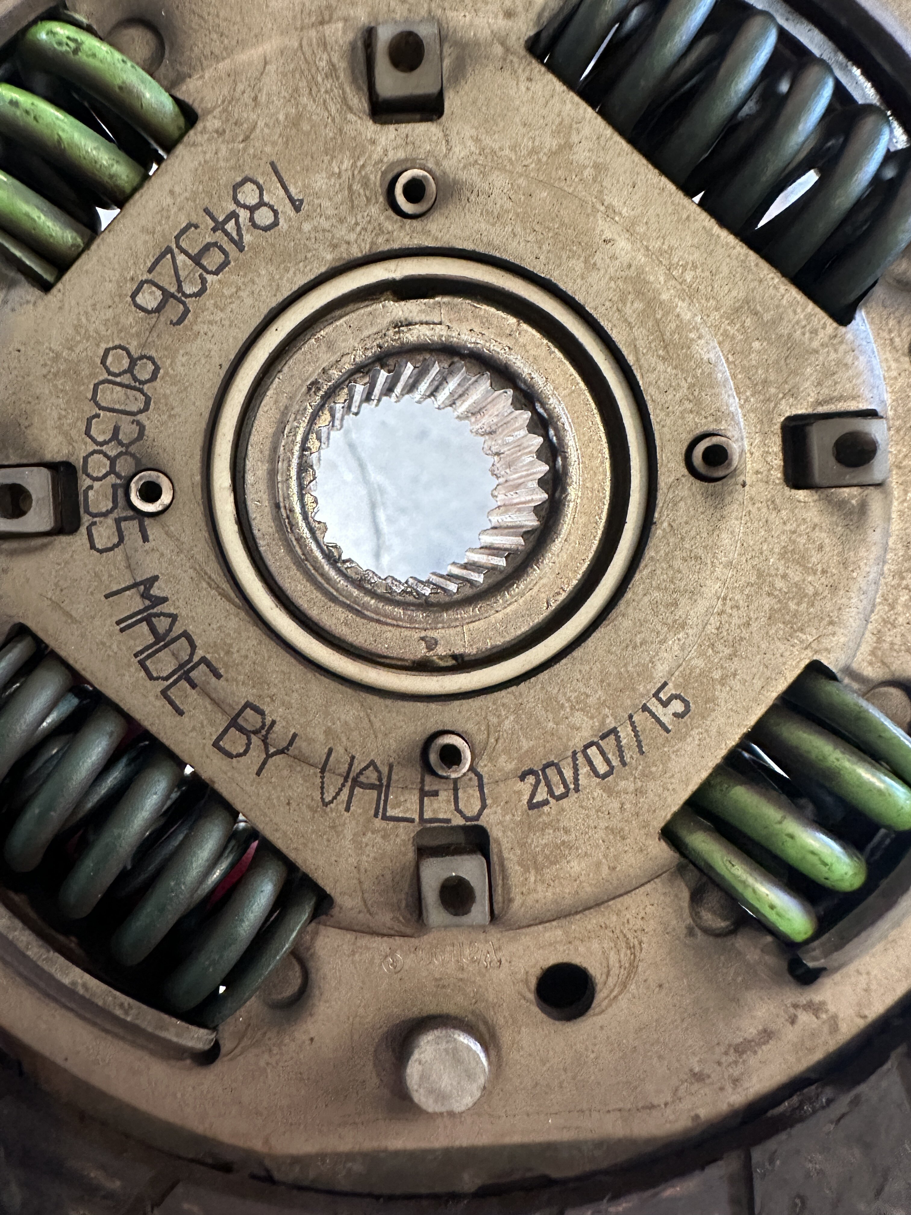

The clutch was still on so took it off. It looks reasonably new
That’s because it is. I don’t remember having changed it, but looking back over receipts it was replaced when the engine was swapped in 2017 so has only done about 5k miles. That was on the list to change but it’s been fine on low boost so may just reuse it

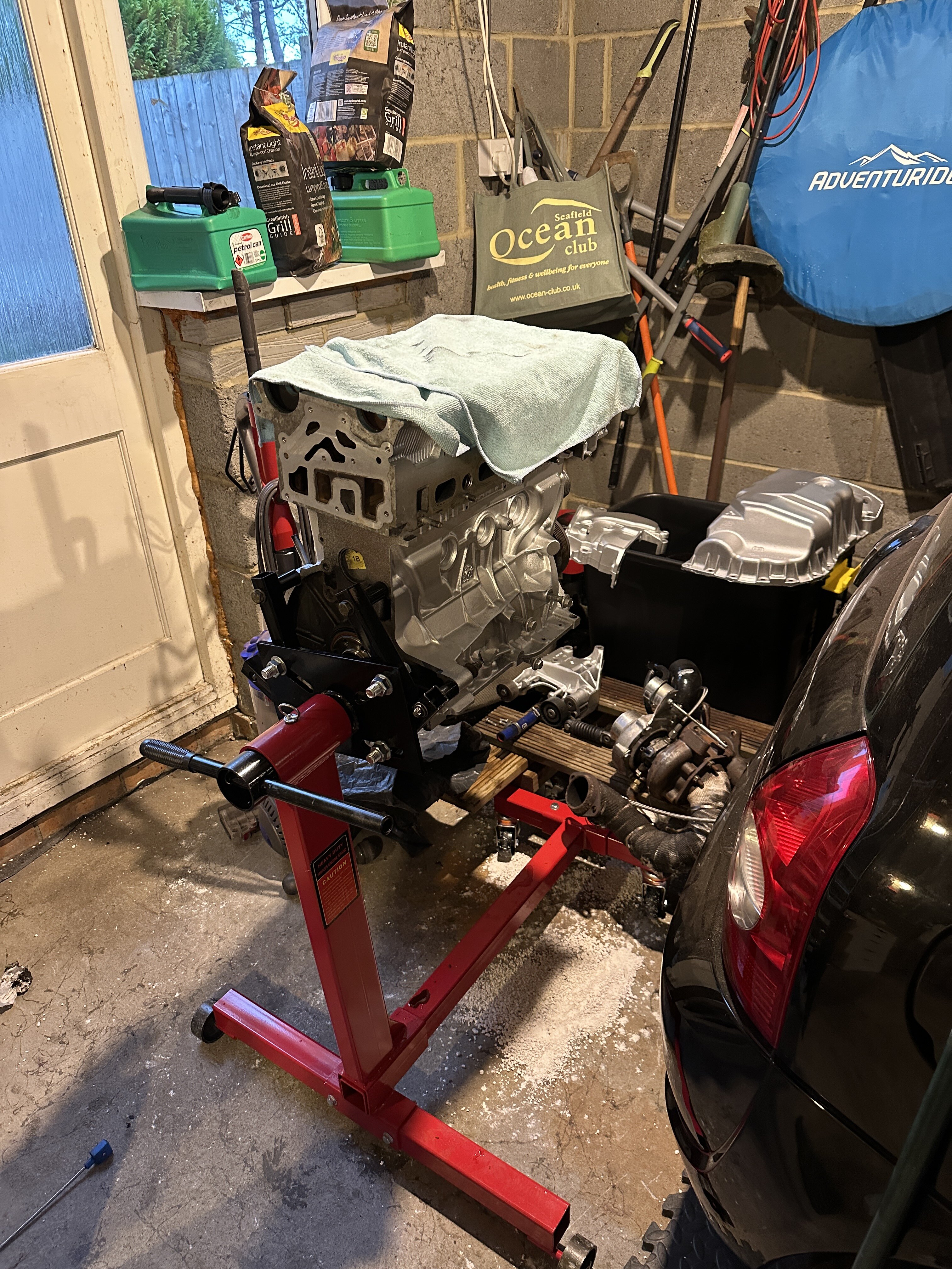

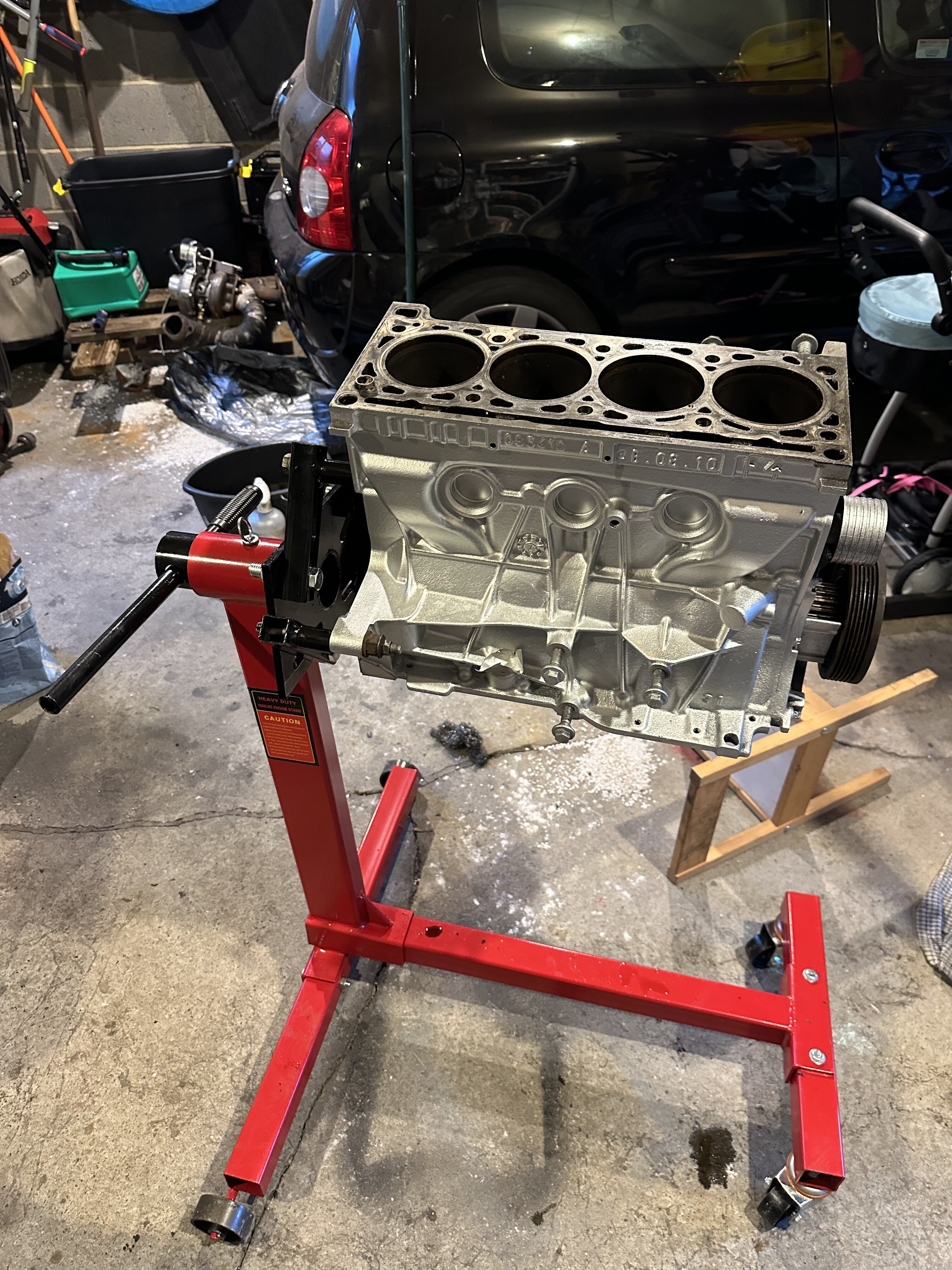

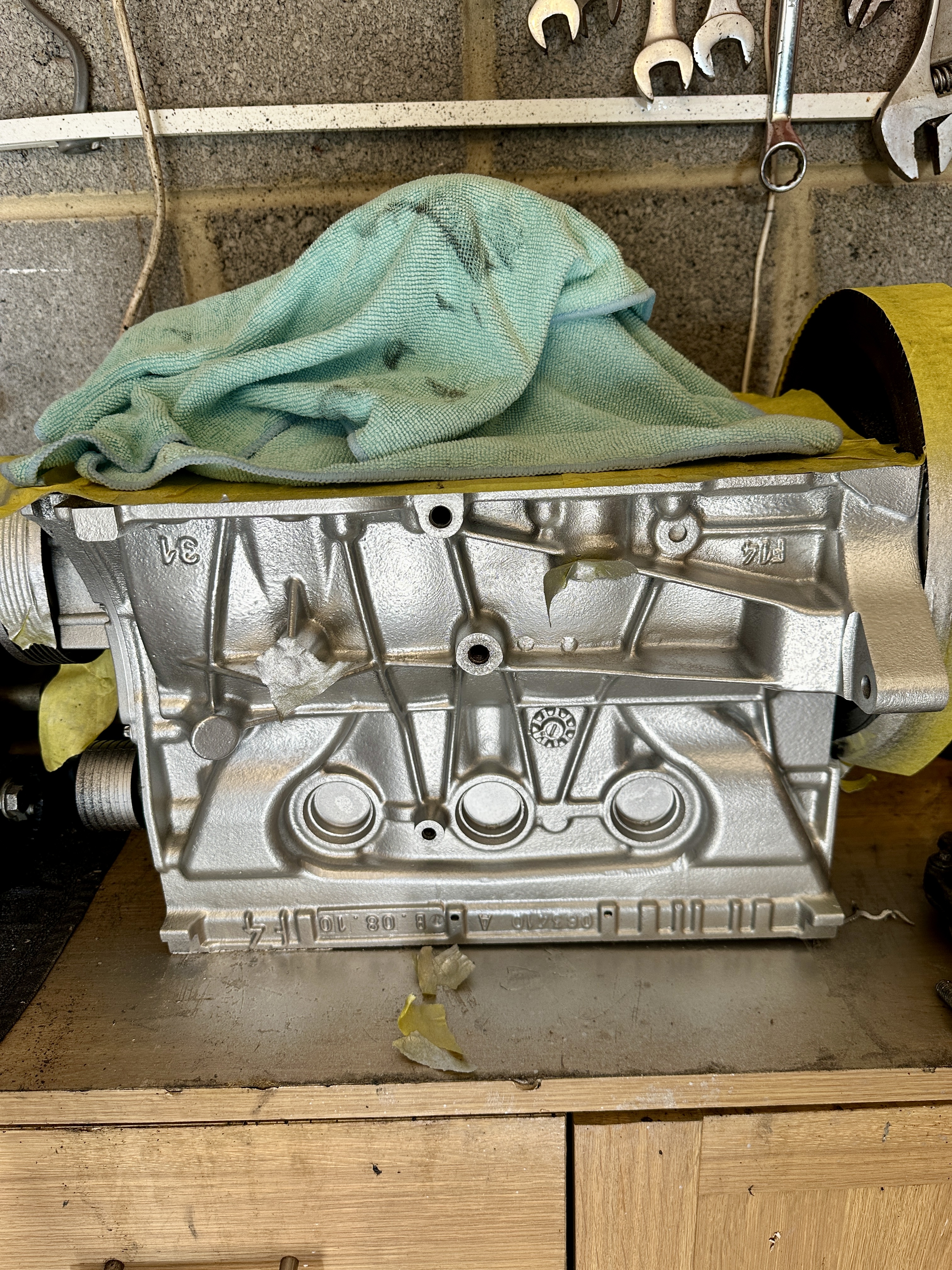

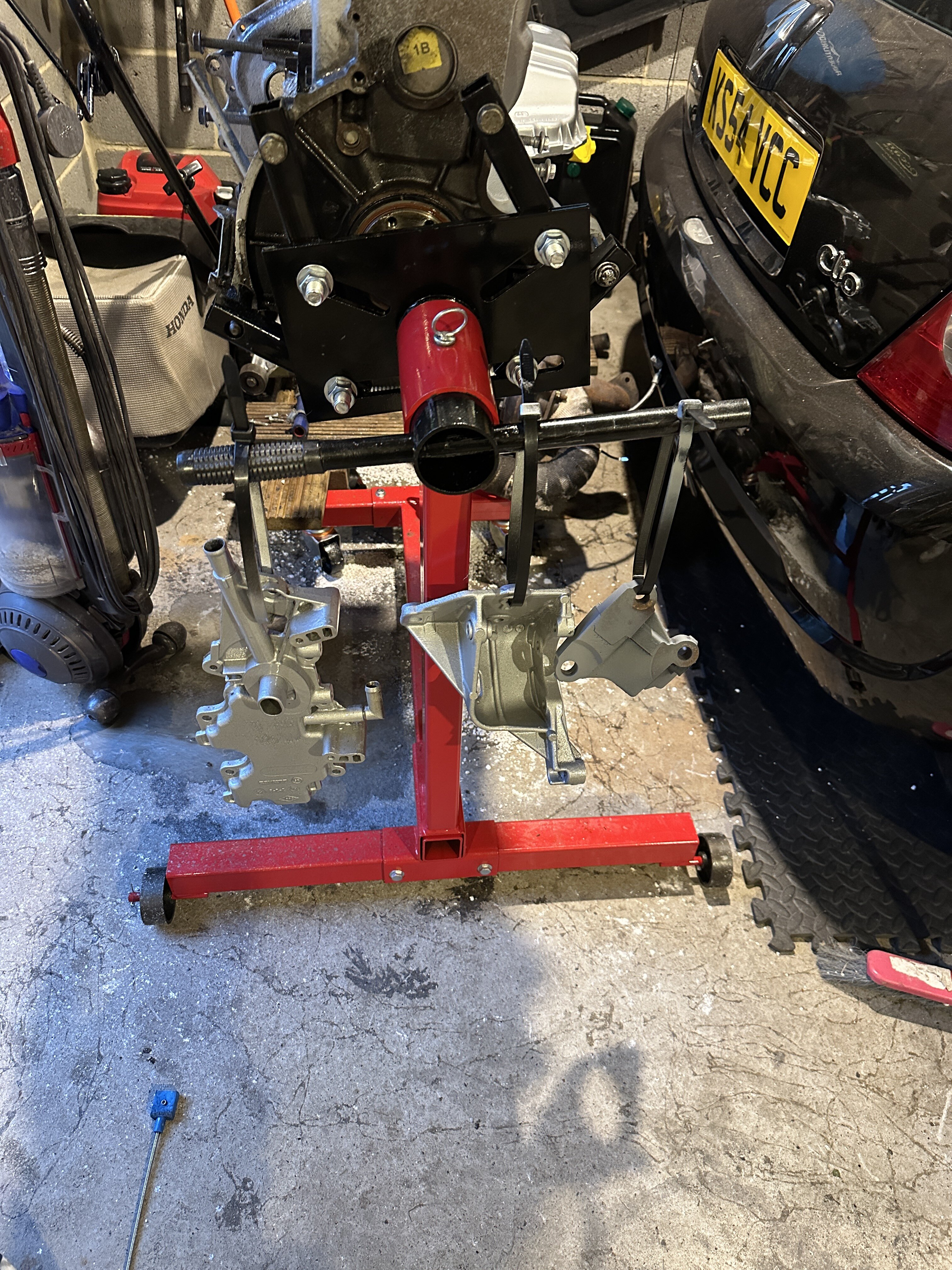

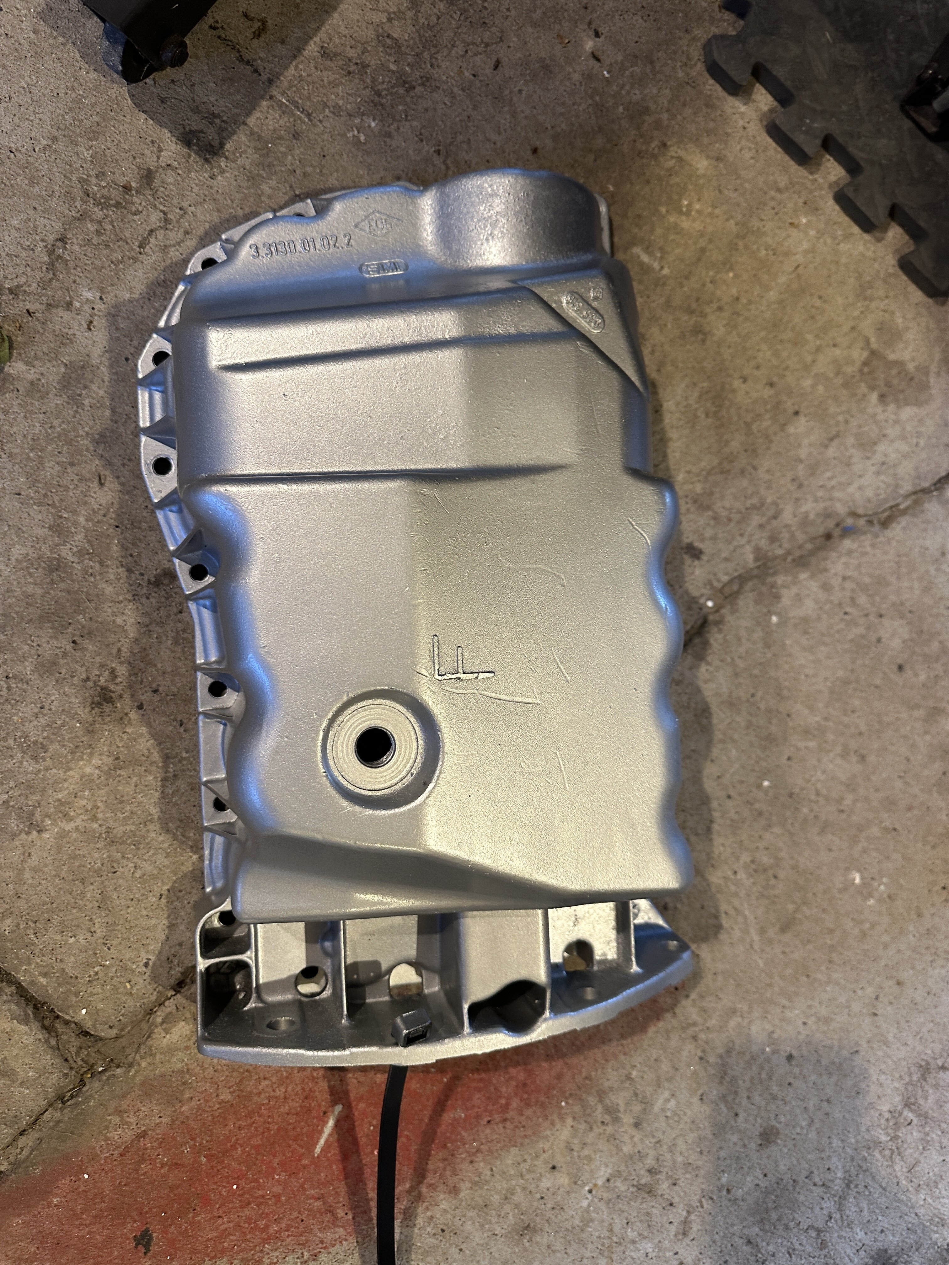

I cleaned the block up a bit more and got some VHT paint on that and the sump. The front of the block is still a bit rough so might need some attention but is what it is. Still better than it was!
I’ve cleaned and painted the engine mounts, timing belt cover, various brackets etc. I’ll see how they come up but may end up getting them blasted instead.
I’ve also ordered an engine stand as there’s no way I’ll manage to build it back up without one. It’s just too heavy to easily spin about on a bench.

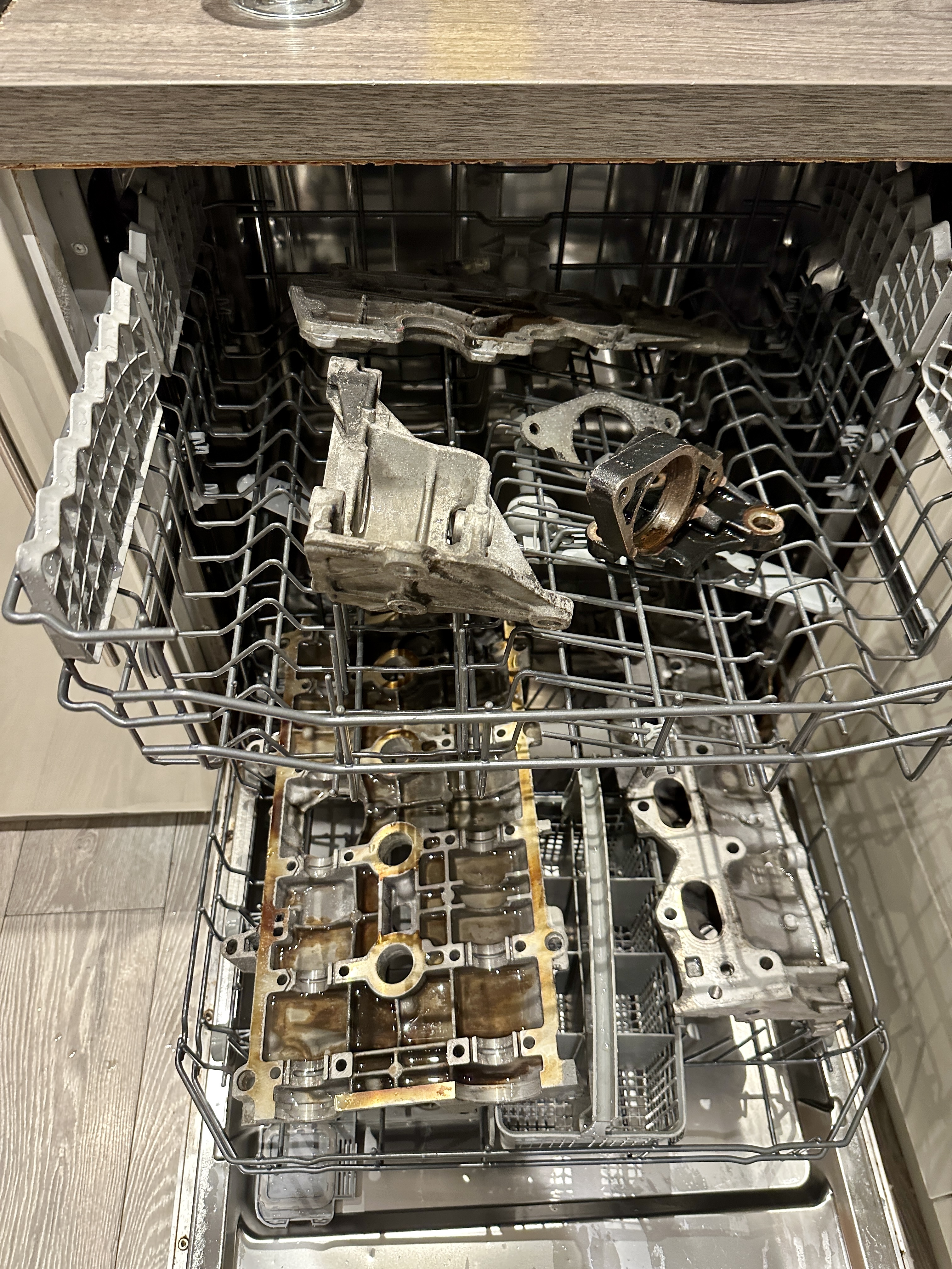

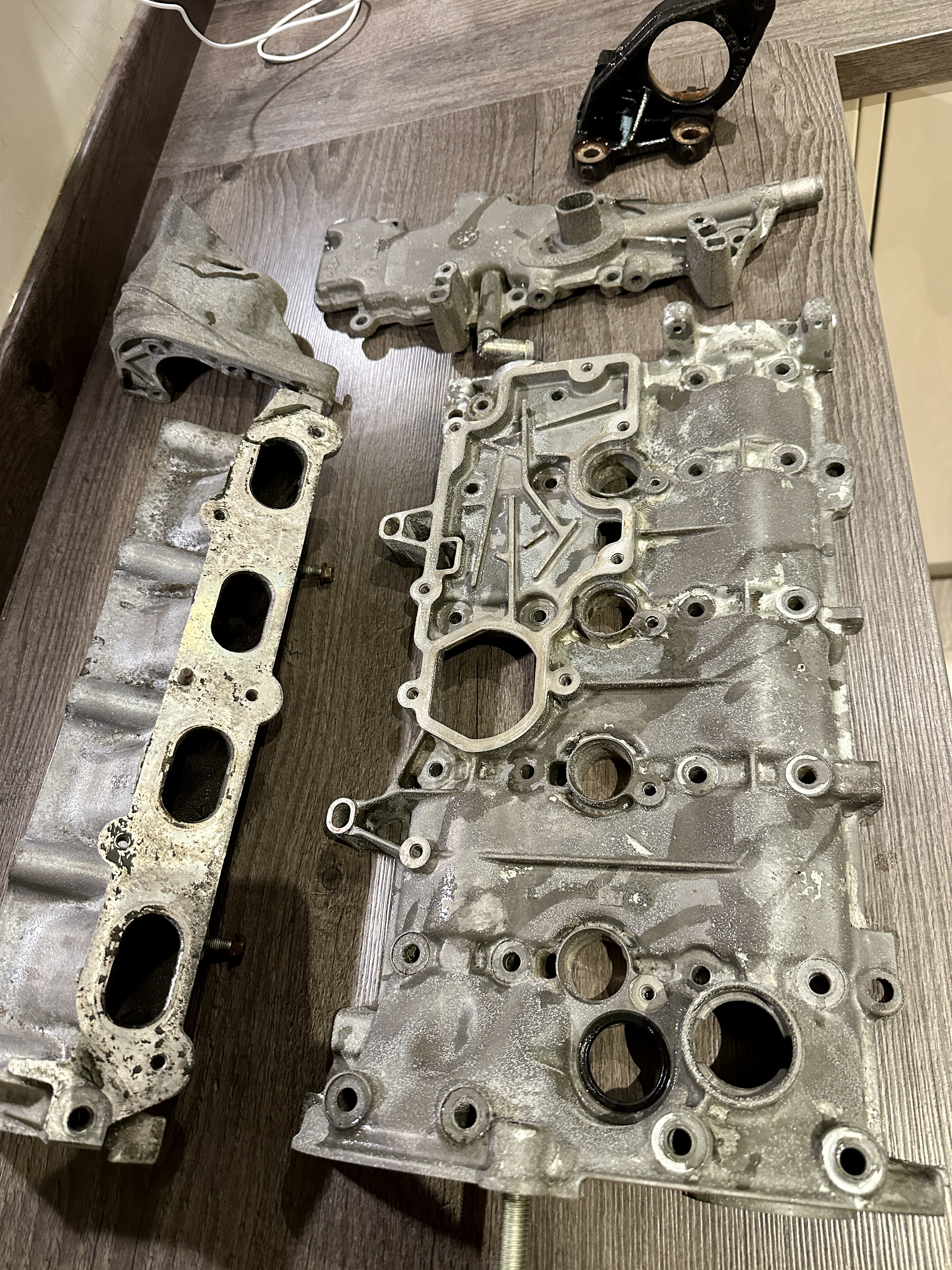

Nowt exciting tonight - just more on the cleaning list. The rocker cover had previously been painted (badly) and luckily most of it blasted off with a jet wash. The rest came off with a wire wheel. I ran out of degreaser and brake cleaner so bashed it in the dishwasher - as you do. Top tip: throw a handful of coarse sea salt in the bottom, SMALL drop of fairly liquid in there, and washing powder where the tablets normally go. Results are always cracking
And I would have got away with it had I not missed this bit of driveshaft mount holder thingy on the top shelf. Wife is fuming.
I’ve ordered the stuff to redo my oil return. Original is a 22mm hole with a m22 tap. Should have been a m24. So I’ve ordered a tap, ordered a m24 x1.5 to m18 reducer, then a m18 to 16mm barb for the hose. Got a couple of crush washers and a nut for the inside so hopefully that’ll be enough to get it sealed nicely this time. I need to think about the turbo out but that’s something I can work out once the block side is done.

I'd be replacing all the bearings and seals while I was in there, same for oil pump, chain etc..
I've got a dial bore gauge and a set of micrometers if you want to measure your crank and bores
Yarp
  182 Turbo, E46 M3
I may well take you up on the offer for the crank. I’m happy with the bores for now but that might change when I check the new piston rings 😂.

Some things arrived today. First to drop in was an engine stand.
It was only a cheap eBay job but it’s actually really decent quality. The steel is thick, there’s no flex in it, the welds are good and it’s nicely powder coated. I could t quite believe it.
What a difference though. There’s no way I’d get it back together without one and with hindsight it would have made stripping the block 20x easier.
That’s now booled nicely back into its corner
It also comes in handy for dangling bits of painted stuff on too.
Then all the gear from engine dynamics arrived. This is the collection of loot ready to go.
Although in a key message for attention to detail, I definitely should have checked the rods. They already have ARP bolts so could have been reused and knocked 130 quid off the bill. Oh well.

No Clio crack this weekend unfortunately as it was the 5 series’ turn for some love. There was still no sign of the pads but it was undriveable with the brake judder so went with the disks anyway.
I started at 4pm and vastly overestimated how much daylight I had left 🤣. Only took about an hour though, so could have been worse. Pads are a doddle to drop in so not bothered about doing it again.
I’ve said it in the M3 thread too, but the BMs are great to work on (aside from a million undertrays with a billion screws). Everything is well put together, comes apart as it should, and goes back together as expected. Chalk and cheese to the Clio!

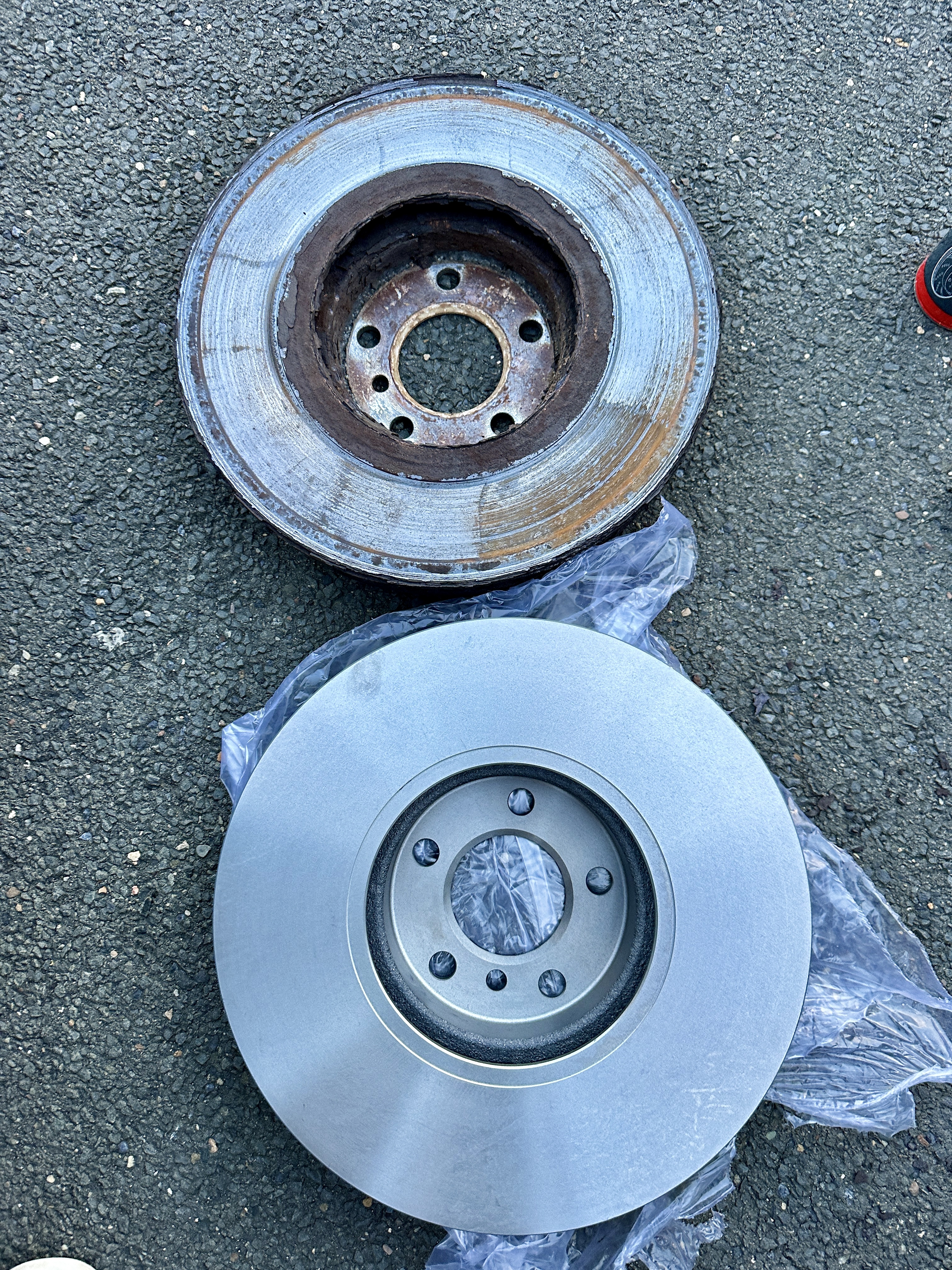

Old disks don’t look too horrendous from this side.
However…. Don’t let that fool you. Quite embarrassing really. However, at 116k I’ve had my moneys worth.
Old vs new. You can’t see it from this side but the new ones have the centres painted too - hopefully they don’t end up as rusty and clean up better
Driver side was same story
And that’s the 2
I went for fuel and what a difference. It doesn’t rattle my teeth out under braking any more 🤣. It still scrubs up canny. I keep thinking about black grills, a splitter and lowering it but then I remember I’m a grownup and not from Bradford. I also regularly think about going up to 19s but it rides so nicely on the 18s.
New disks feel good though, even if it is only using 2cm of the disk 😂
