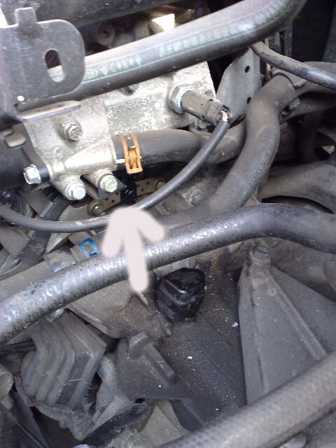

Piece of piss mate, take the airbox out and its atop the gearbox;
(this isn't an F4R but its in the exact same place) From memory its two 10mm bolts!

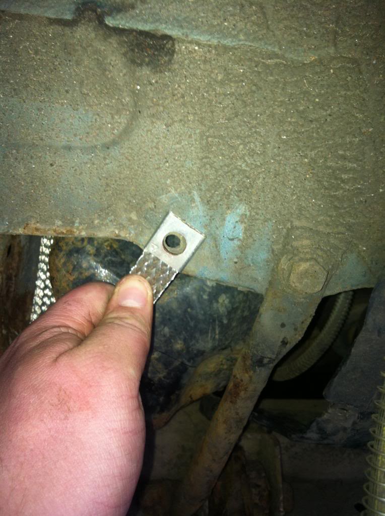

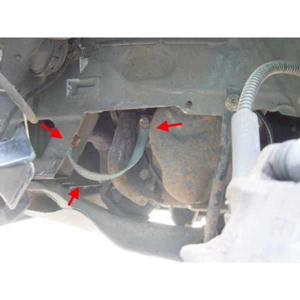

There are two earth straps, one on the gearbox and one behind the nearside arch liner. A faulty one caused me no end of grief on my old exclusive! It sorted about 3-4 issues all at once!
Nearside earth strap;

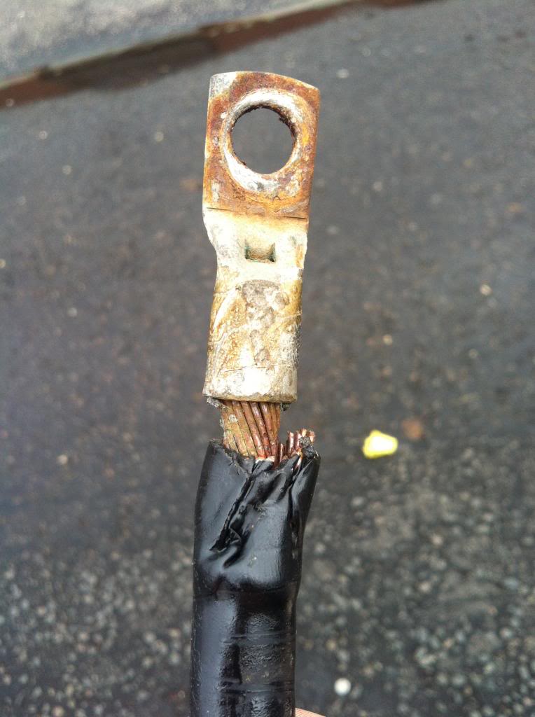

Just replaced it with a Renault genuine one, heres why;
And then;
I'd have a go at wire brushing the terminals rather than replace it first buddy! Won't do it any harm and they're only £16 in any case!
