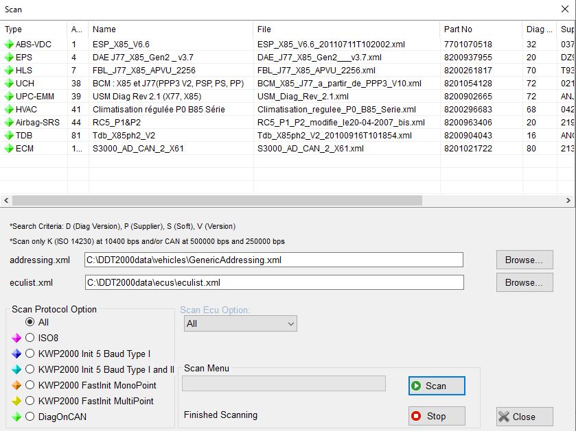

These are the my ECU "types" when performing the full scan to find the .xml files that relate to my cars info.
I've been through all of these and have not found anything to do with clutch depress to start or similar.
With the Renolink software do you have to open an .xml file or is there some kind of auto connect / find function?
Looks about right. I just scan for ecu i need usually using the above menu, double click on the ecu in the list and straight in. Full scan takes too long.

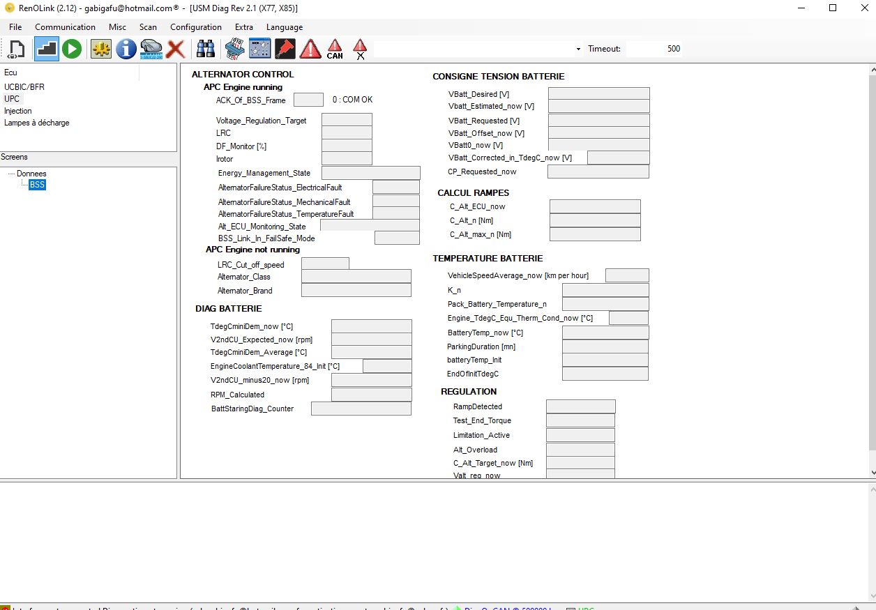

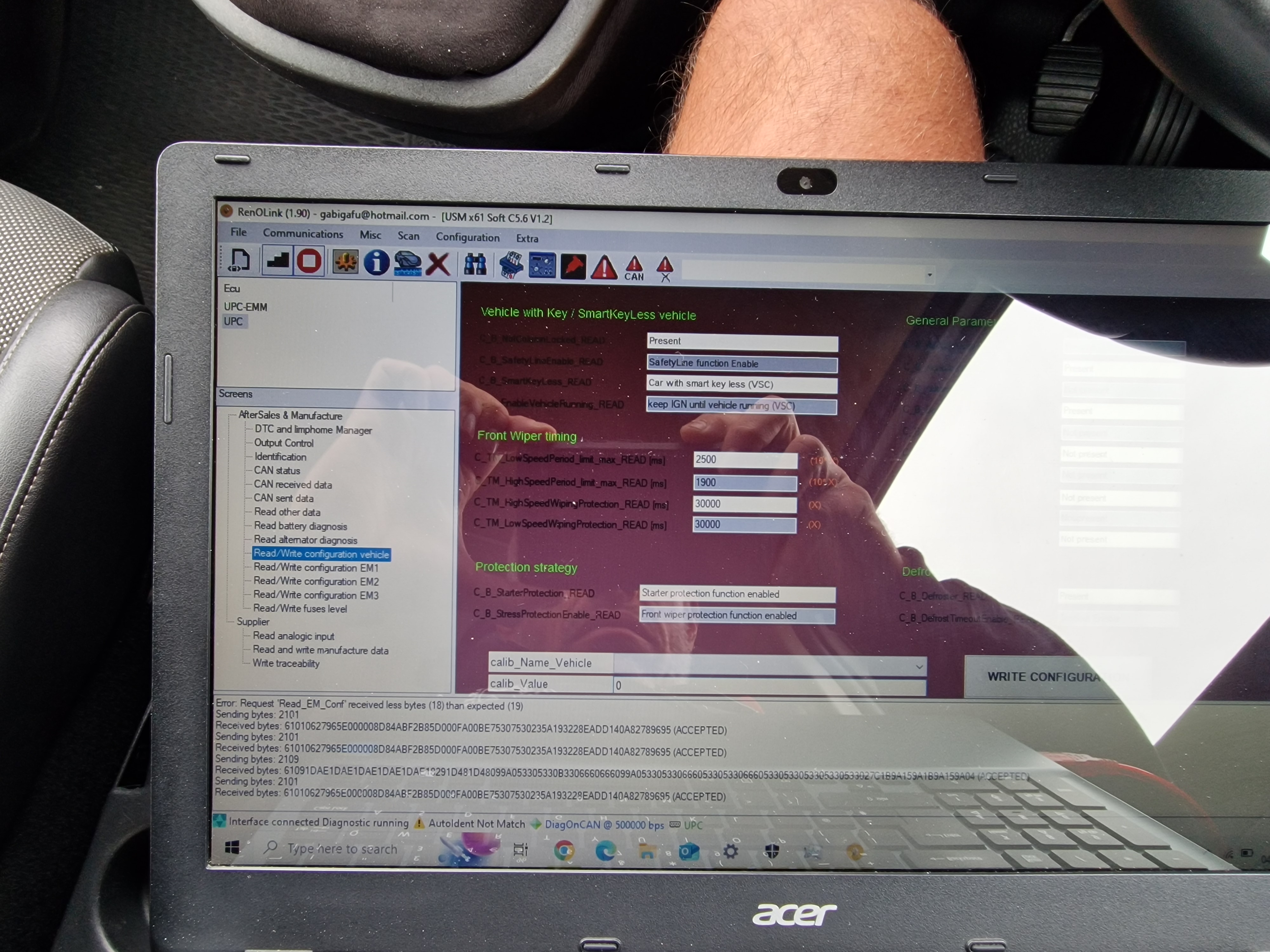

Just had a quick look on my kangoo which is similar, and there is options in the upc for key/keyless. Look in that area it might have what you need.
Under Clio III / UPC(EMM) / USM Diag Rev 2.1 (X77,X85)
I had a much more limited menu compared to your Kangoo one unfortunately. The image below I'm not connected to the car but shows what I have under UPC.
