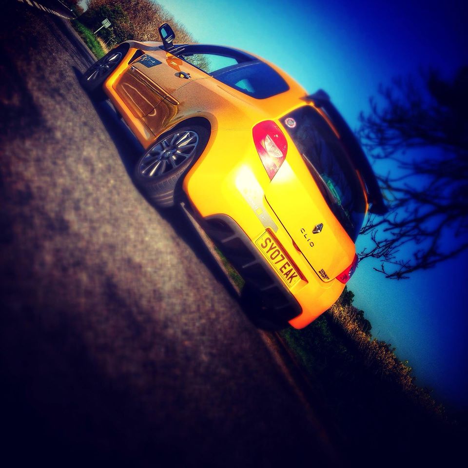

it looks nice, but i cant see it until Wednesday night..
  Listerine & Poledo
the right colour.
with the wing and (actually relevant) stickers.
Buy it, buy it now

wouldnt you say just over 90k is about right for a 2007 plate car, 12 ish for 8 years, haven't seen it yet so will see, i know there's one on ebay for 6999 which looks mint, this one is just over half that..
The mileage may be about right for the year, but what @R-Sport Cars LTD is getting at is that there are lots of parts that will be tiring out and need spending on.
Problem is, that colour, that edition, is perfect. Clios just went downhill afterwards.
Besides, who's to say that any car you buy wont have a shopping list of issues to contend with
