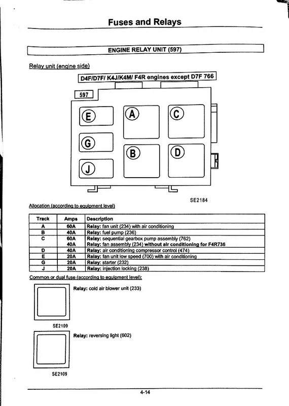

Relay J controls everything.

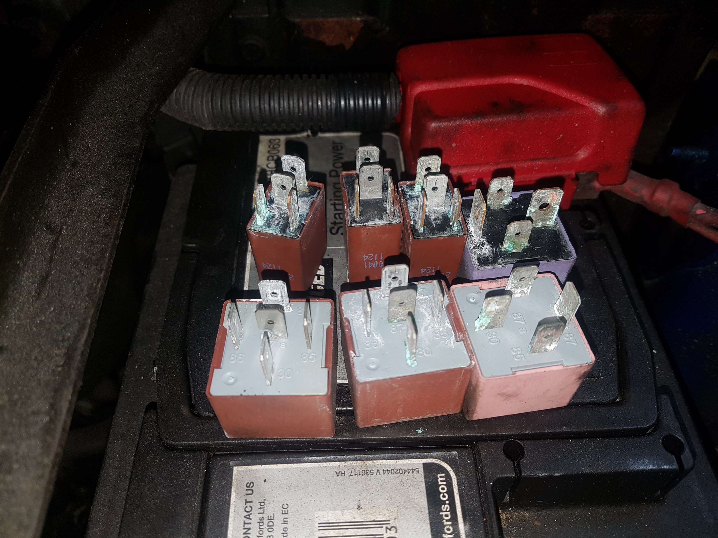

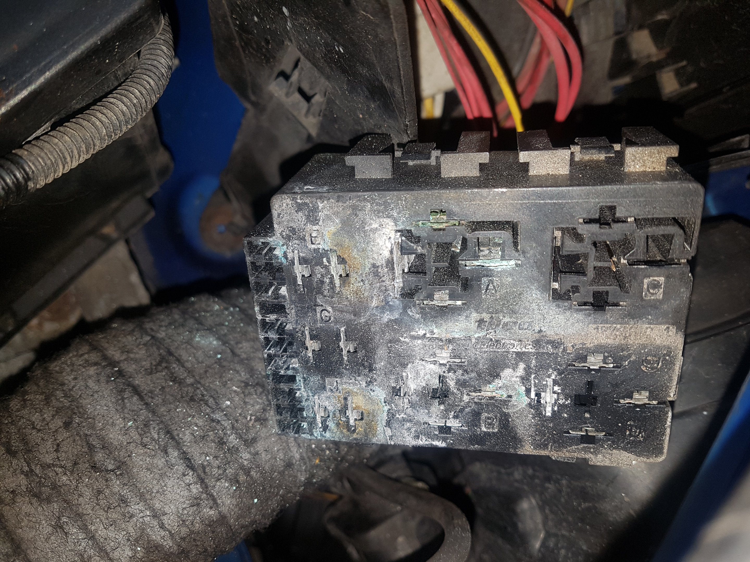

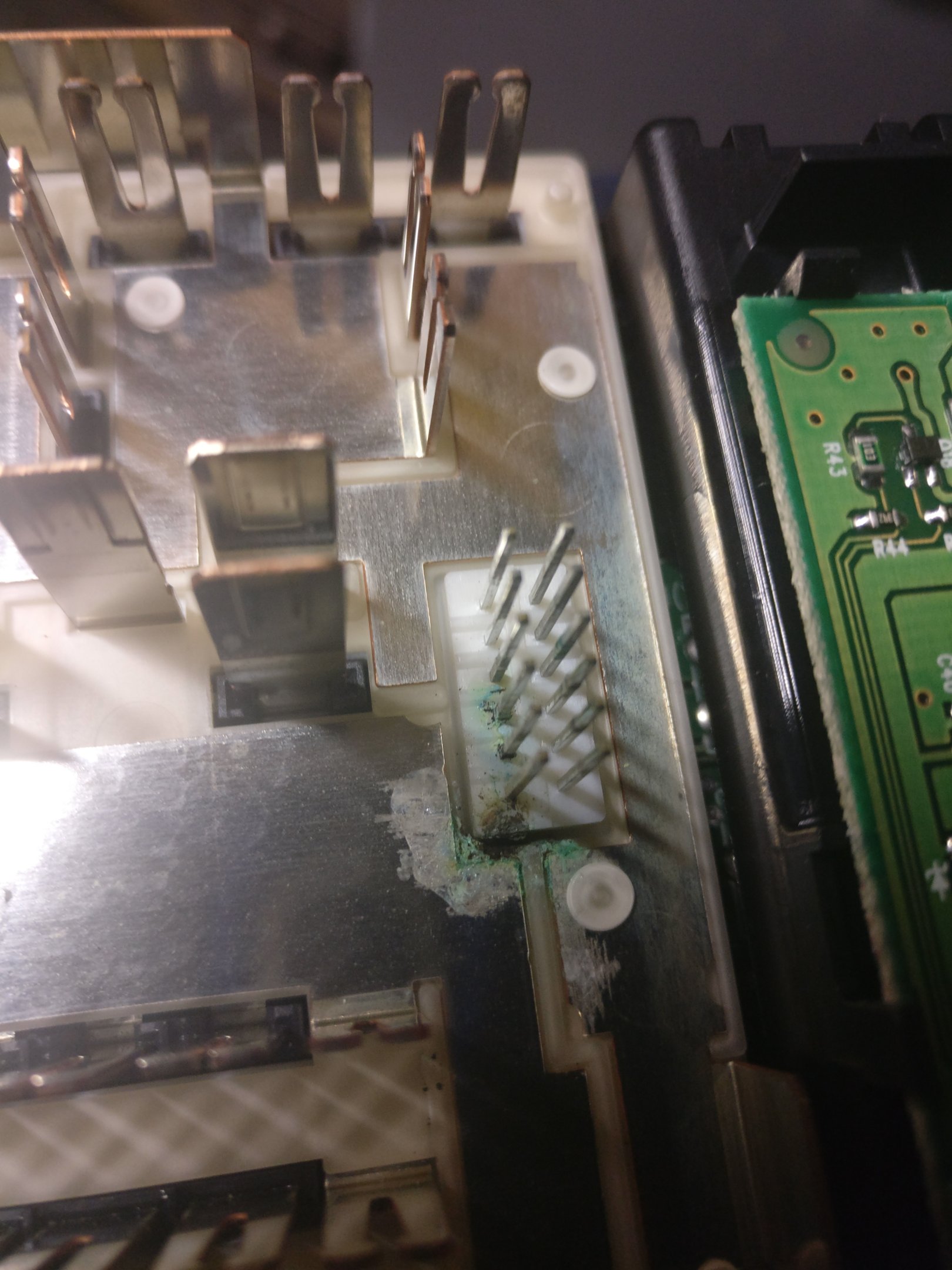

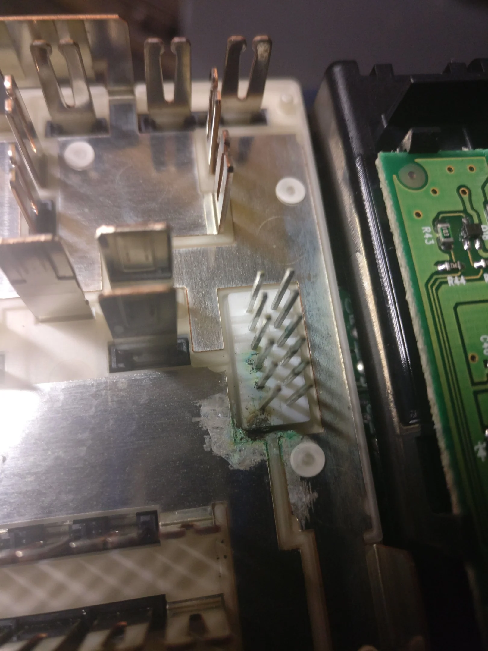

Ok, an update.
I've had the under bonnet fuse box off and stripped it down and found the following corrosion. Does anyone think this could be the root of all my problems?
I couldn't go any further into the circuit as it felt like the white plastic was gonna snap, but surely the green corrosion/oxidation can't be a good sign?

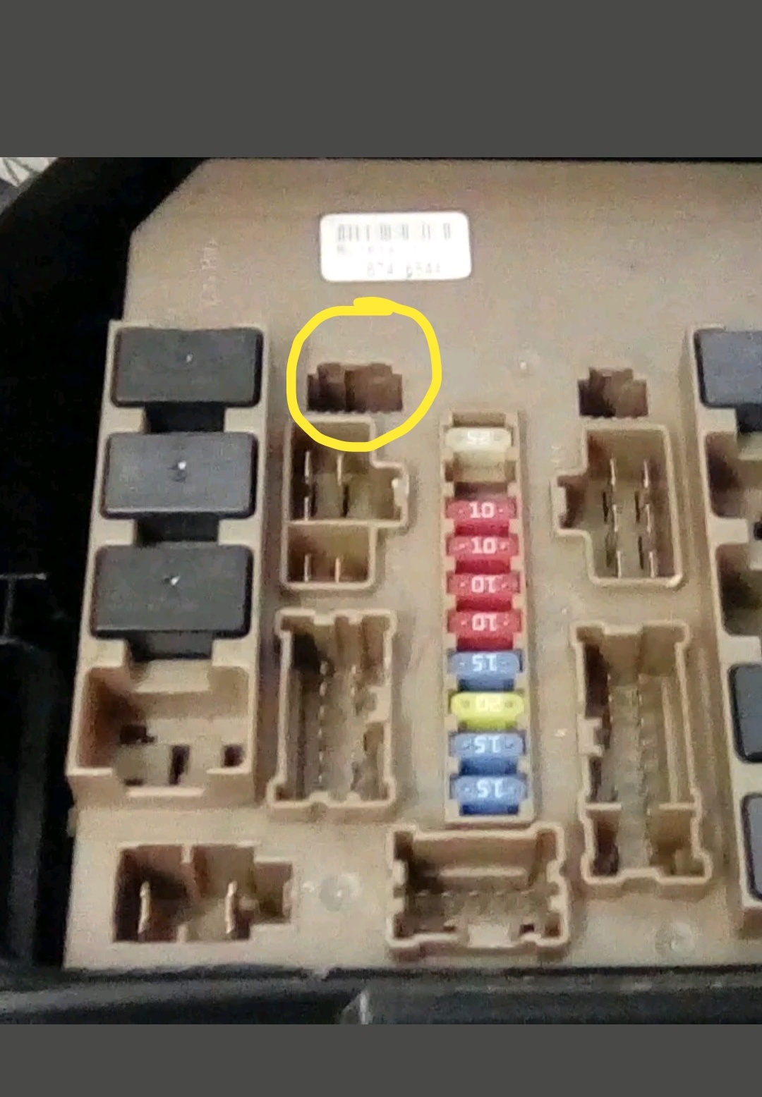

Anyone know, on a Clio under bonnet fuse box, what this plug hole controls, it's a 12pin connector (highlighted in yellow see attached pic) one of the wires on the connector is corroded, I am curious to know what this controls on the car.

Last update
I replaced the fuse box and the wire that appeared to be corroded. Did not make a blind bit of difference. Same issue, car still not starting.
