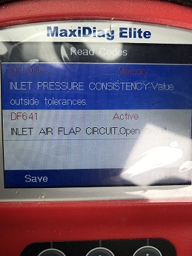

my wife has a 0.9 tce and shes having some real issues with idle revs not wanting to be settled.
if car is sat still the idle revs will jump from around 800rpm to 1500rpm and it will go up and down over and over.
driving the car its fine intill you stop at traffic lights and the same happens again.
iv cleaned the throttle body and thats not fixed it.
im getting these codes DF1058/memory
and DF641 active.
dont know what else to really do any input would be great
thanks
So it's saying that the inlet pressure consistency is outside tolerances?
And the inlet air flap circuit is open?
Sounds like it might have a leak in the air intake system??
