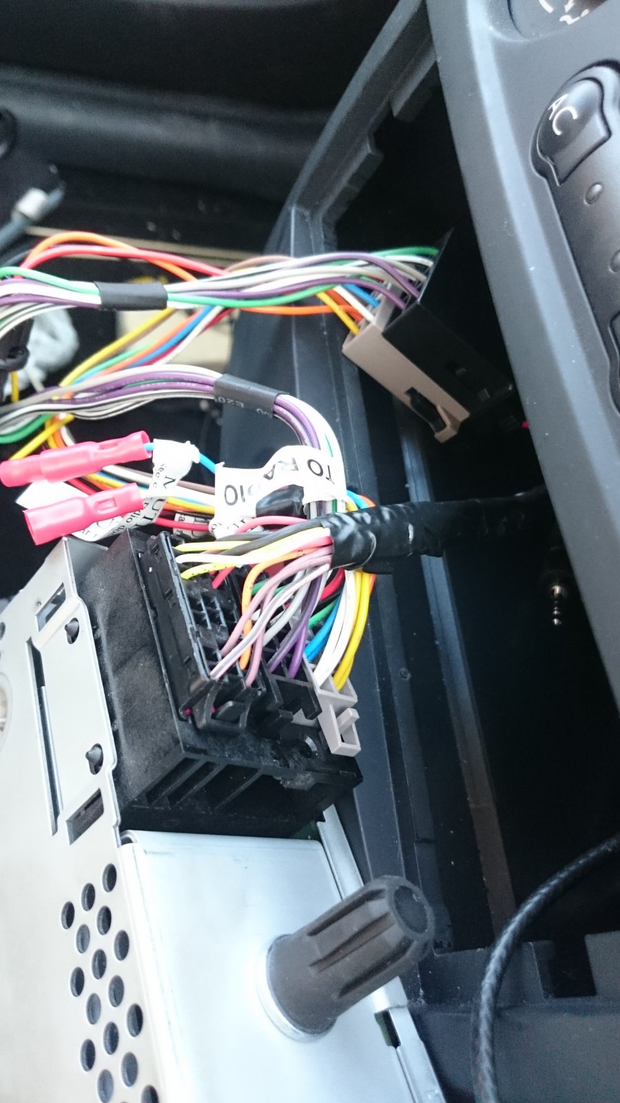

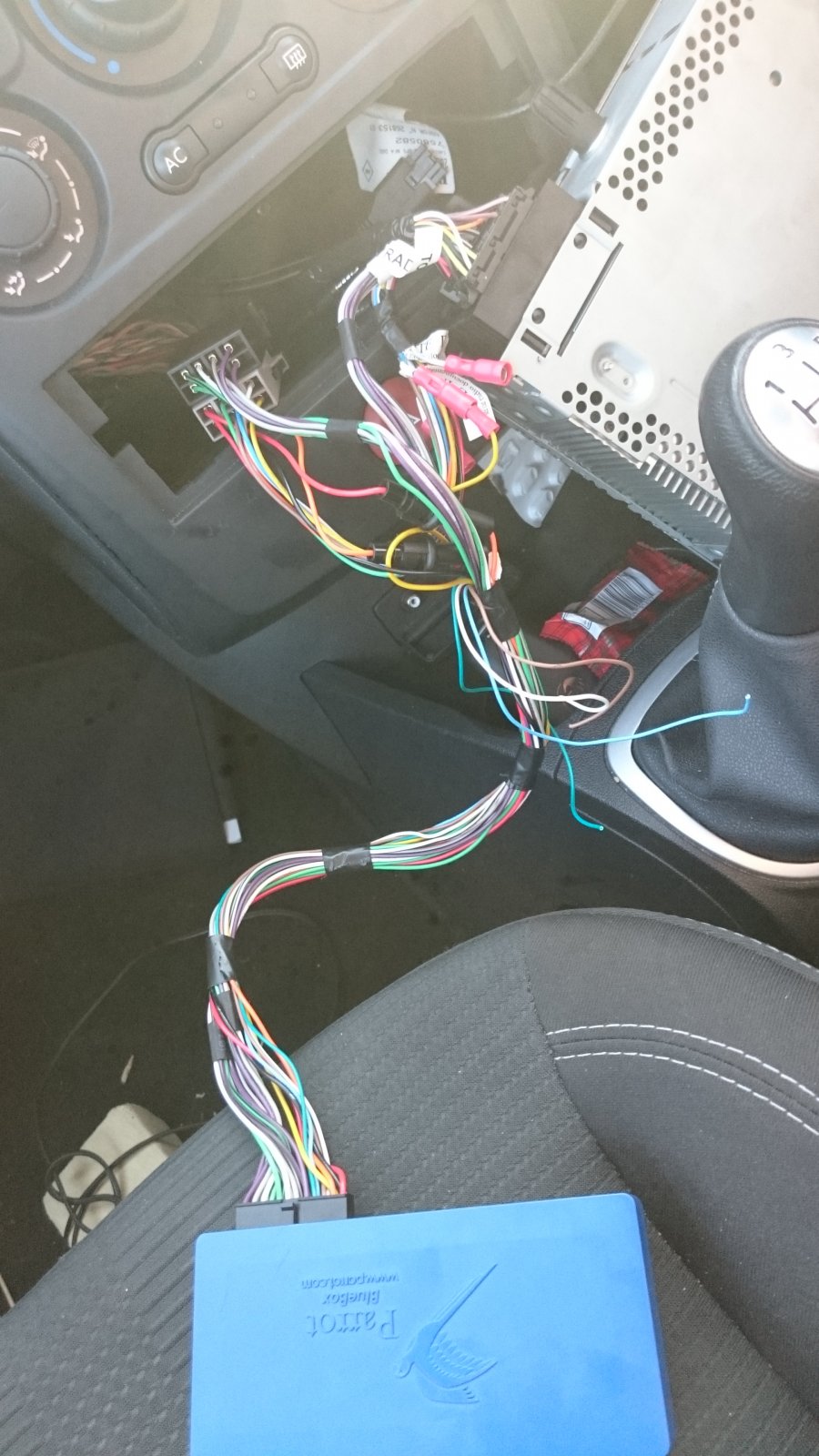

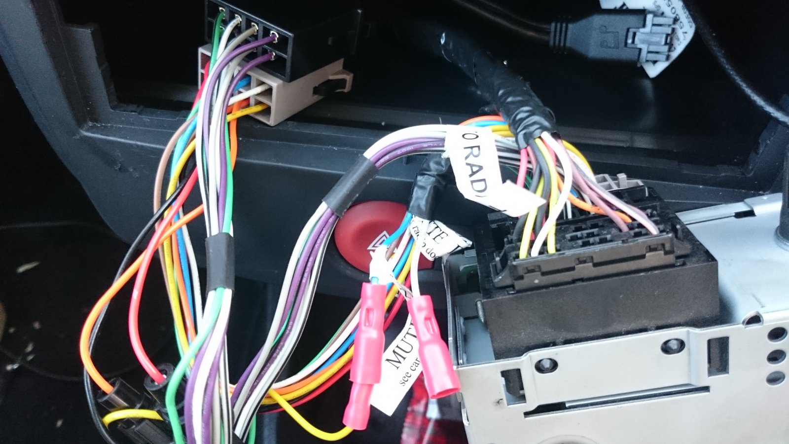

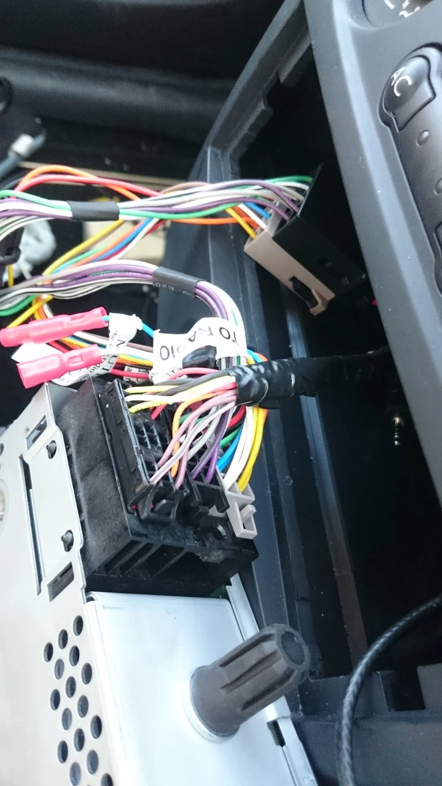

Hope these help (microphone/aux cable have just been disconnected, but presumably don't make a difference).
Can you take a photo of the setup mate? (The wiring)

Been a while since i was fitting these but iirc the clio 3 will need an ignition feed run to fuse box/ cig lighter as it is canbus, easiest way to check is multimeter on orange and red - red should be constant and orange should be switched,
On the note about the sat nav/muting, I vaguely rememeber speaking to renault about this when i fitted these for a well known car/bike retailer ;) - and they advised that there was no solution fitting an aftermarket handsfree kit in a sat nav equiped vehicle unless its in-built factory kit. That said you could try calling autoleads/connects 2 if the mute doesnt work right after u get it going, both tech depts are brilliant from my experience
On the note about the sat nav/muting, I vaguely rememeber speaking to renault about this when i fitted these for a well known car/bike retailer :wink: - and they advised that there was no solution fitting an aftermarket handsfree kit in a sat nav equiped vehicle unless its in-built factory kit. That said you could try calling autoleads/connects 2 if the mute doesnt work right after u get it going, both tech depts are brilliant from my experience

Yeah just ignition feed, there will be a constant from the radio loom, if the constant is on orange then swap the inline fuses on the parrot loom (these just twist apart) then run a new feed to the fused side of the parrot loom - if this make sense,
I think the fuse box if behind/below glove box on clio mk3's (?), easiest way is to use a piggy back fuse, or depending how accessible the rear of the cig lighter is just tap off the ignition feed from there
