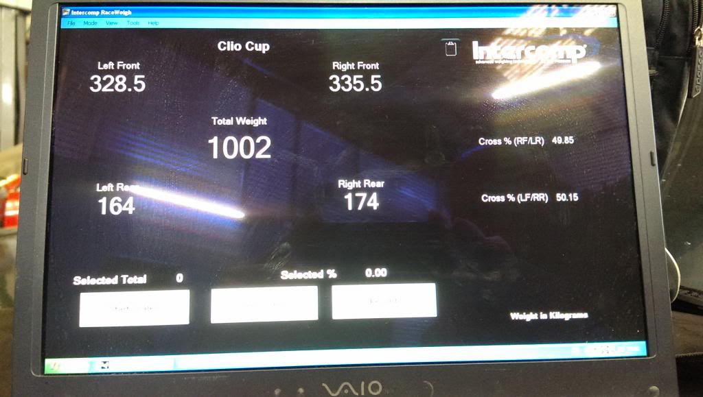

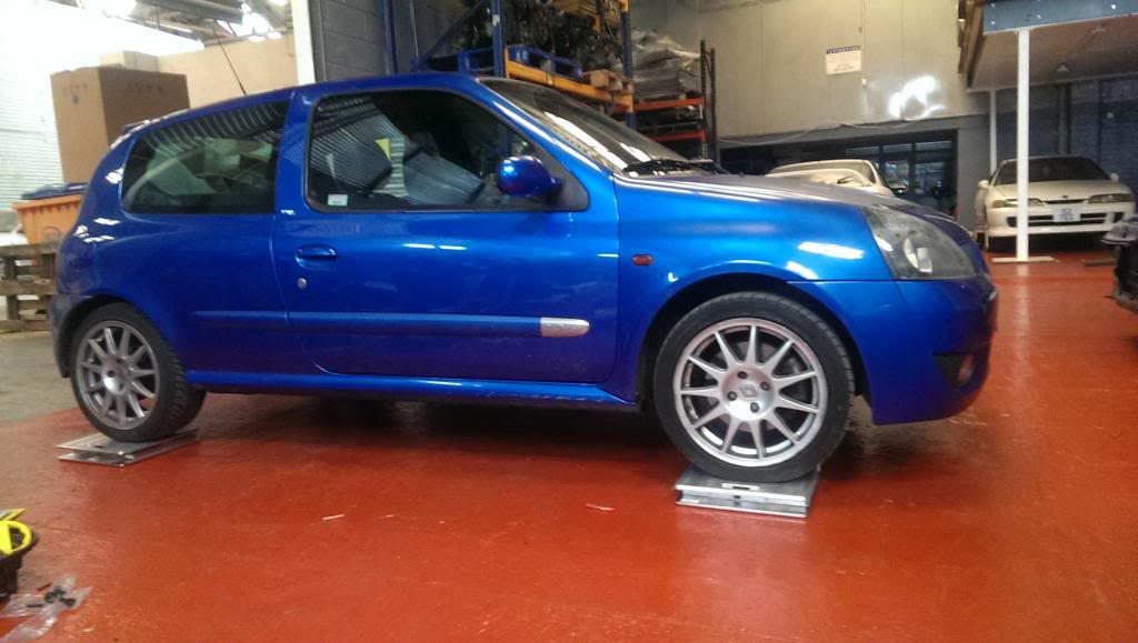

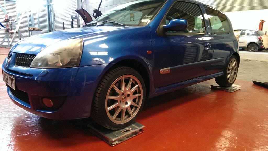

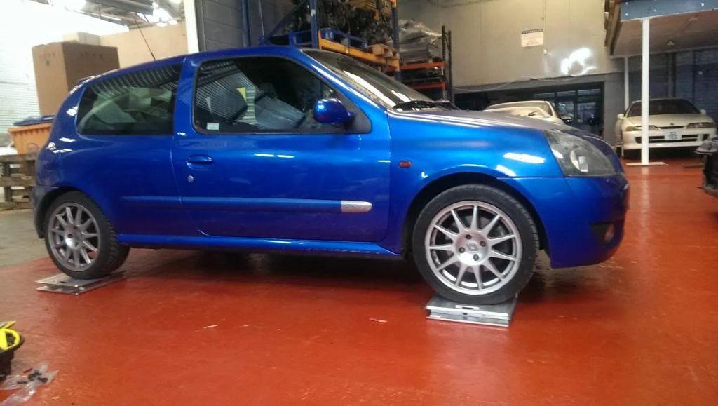

Just thought id post these pics up of my cup on the corner weight pads at work ;) ....... It was 1002kg with no spare wheel in and 8th of a tank of fuel :) .... i was impressed with the weight distribution , it was nearly a perfect 50/50

yeh i was surprised with how light it was ,,,,, i put a stock honda itr dc2 on and that was 1100kg with no spare wheel and no fuel init haha

basically you need adjustable suspension and you add the weight of the driver to the car before you adjust the suspension to get a perfect 50/50 weight distribution
imagine carrying all your shopping on 1 arm, silly idea right? same idea with corner weighting basically, you "balance" the car so all 4 corners get their fair share (its a bit more complicated than that, but that'll do!)
I'm going to sound really dim here but does that make much more difference than an 'average' tracking ( track focused )?
This is why my front left wheel always used to lock way before the right one in my 172 Cup?
Makes sense, throw in 75kg for a driver and there's serious righthand side bias!
its always gonna be heavier on the drivers side the weight distribution is measure cross axle eg front left wheel to rear right wheel
