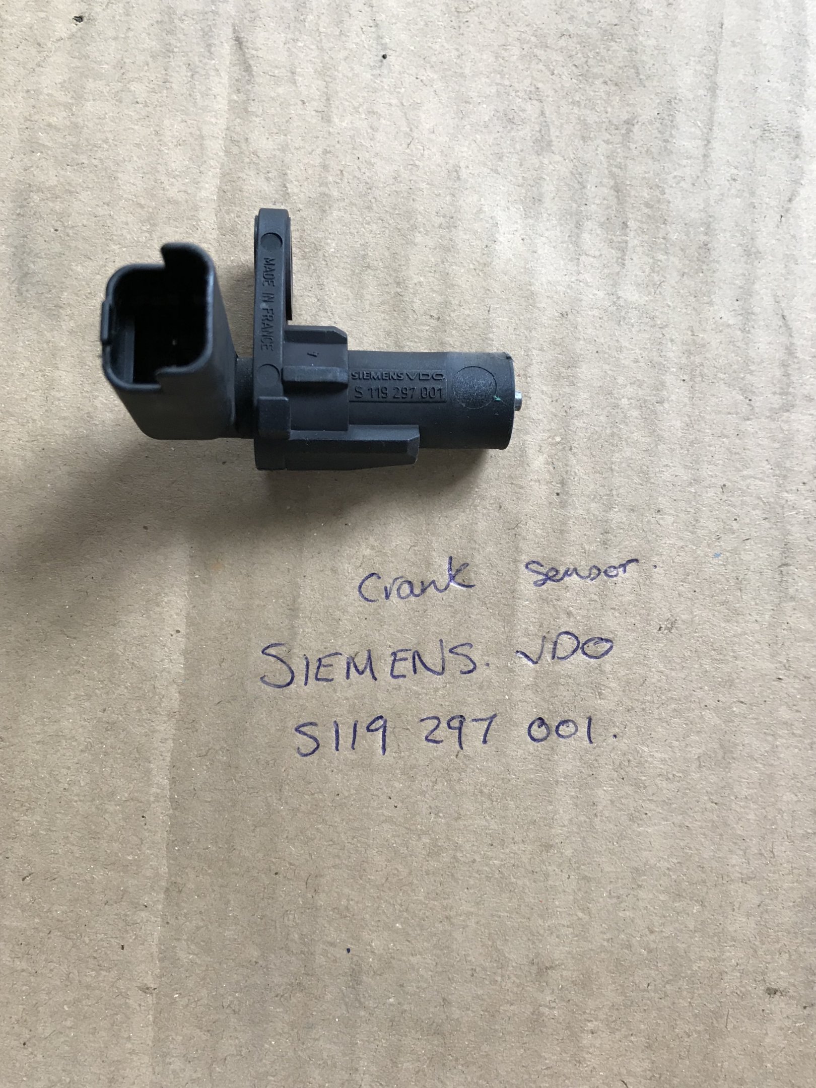

I’m pretty sure the crank sensor is the same mate, but there’s 2 types from memory. The plugs on the mk3 are also the 3 prong type.
Put a pic up and I’ll confirm on the crank sensor.

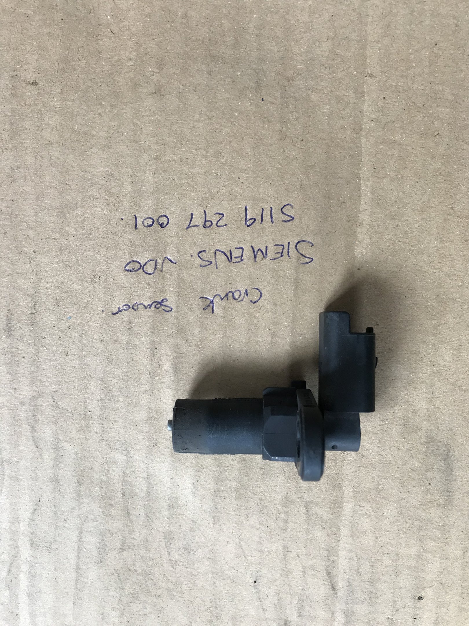

This is the one in it currently

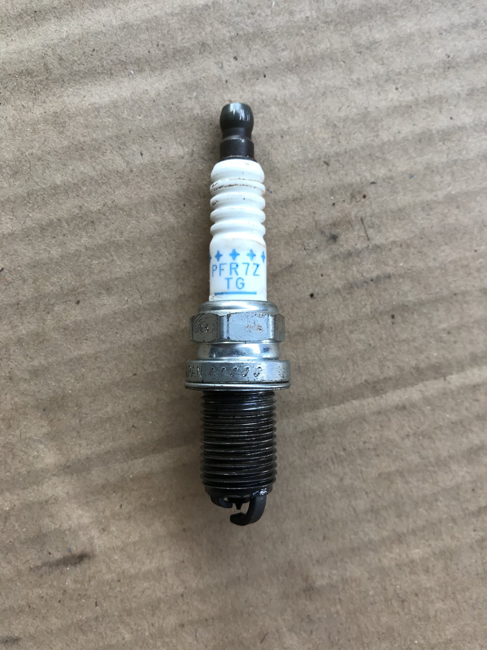

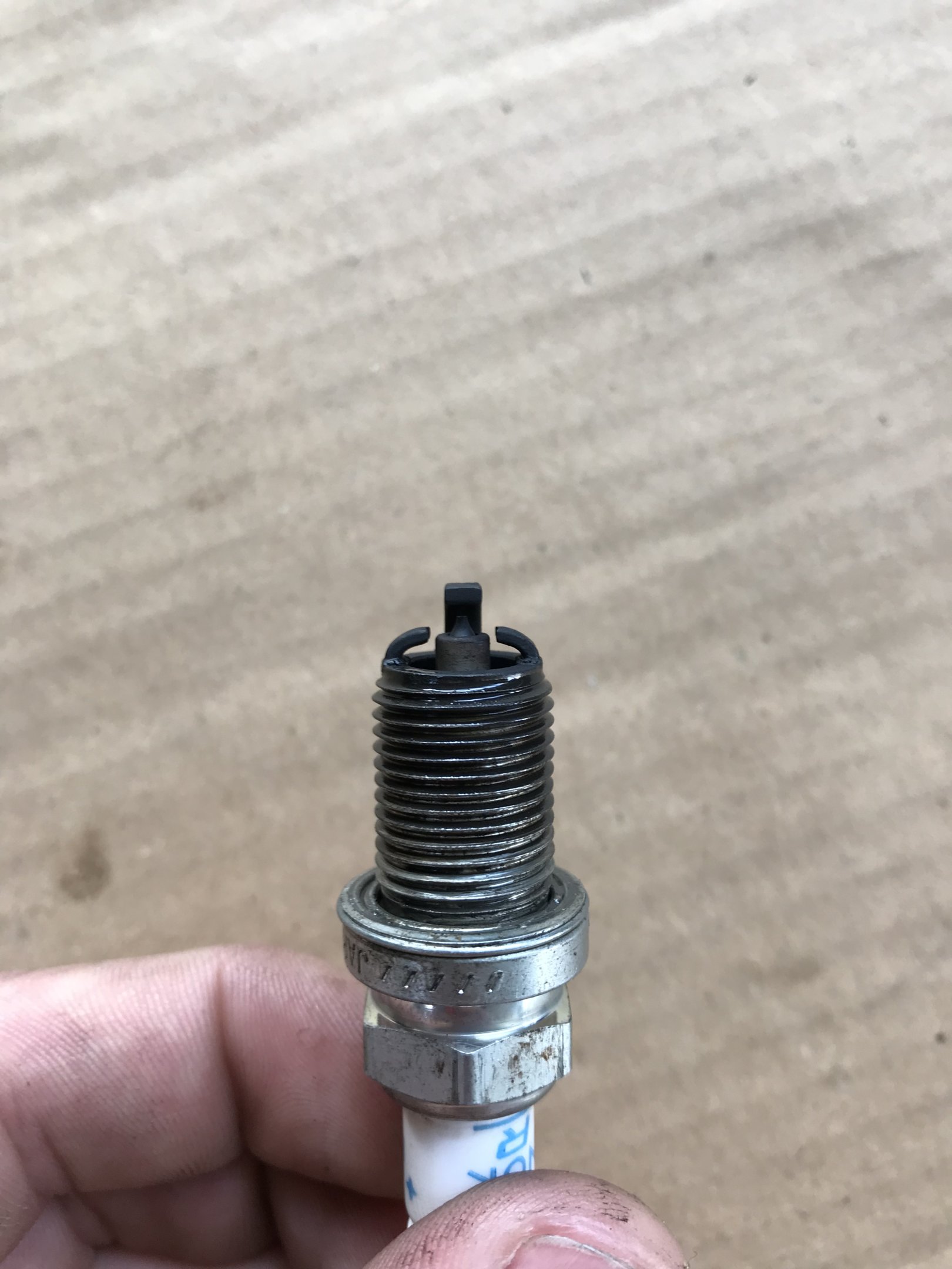

So I am ok to put the standard mk3 rs plugs in it ? What I will do is take one out and reference the number on the plug before ordering

@NorthloopCup thank you very much mate, yeah I would be surprised if they ran too many different engine parts to a standard car because the engine is pretty close to a standard road car if my readings are correct, I will just double check the numbers on the plugs and get some ordered if they match.
  Clio 220 PH2
The old gal lives again cleaned the crank sensor up for now unit we winter store the car, new plugs in and a spit of a flame out the exhaust and she’s good
