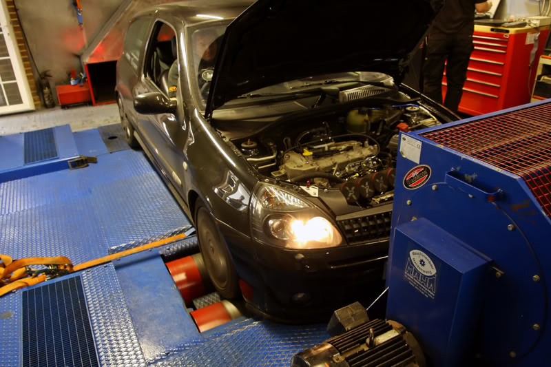

on the rollers :D

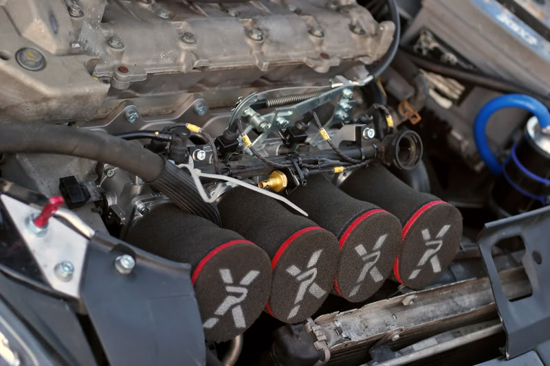

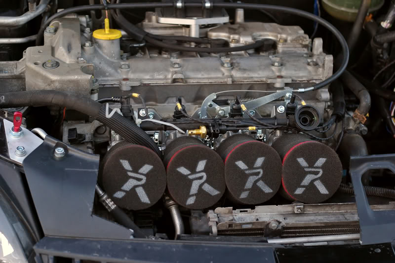

all in and running sweet as a nut! many thanks to andy from GDI and sean/paul from K-Tec racing for the help and sticking with the car! i know we had a few niggles but we got there :) just running shy of 180bhp ATW
  Clio Sport 172 ITB
the reason i went for ITB's is because IMO its one hell of alot more usable on track without having to look at a LSD. also u cant beat the sound! there is alot more headroom for improvement with more wild cams and also going high comp (which i will be doing in about a years time)
