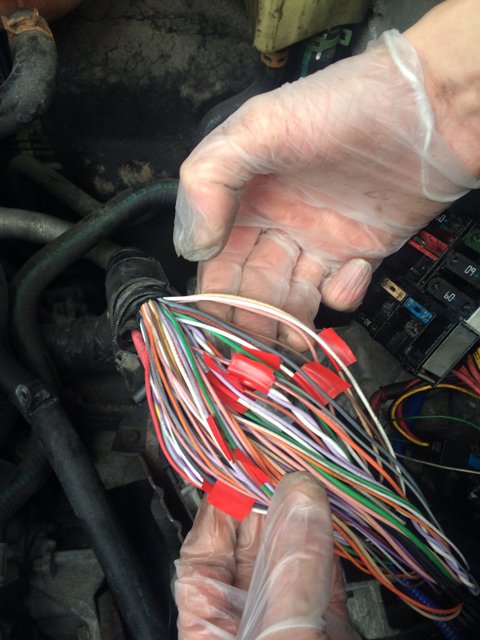

In some cases (like mine) it can be wiring problems (my loom sliced itself in 12 places)
All the tagged wires were damaged on mine
