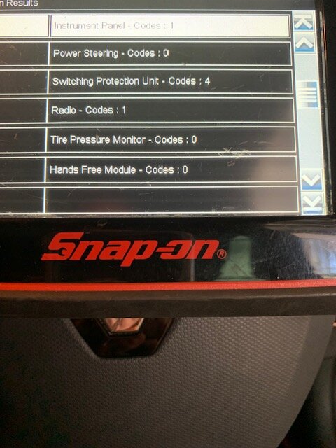

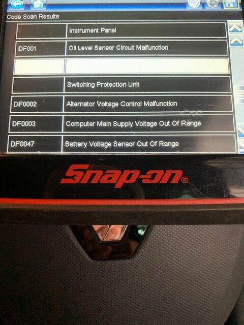

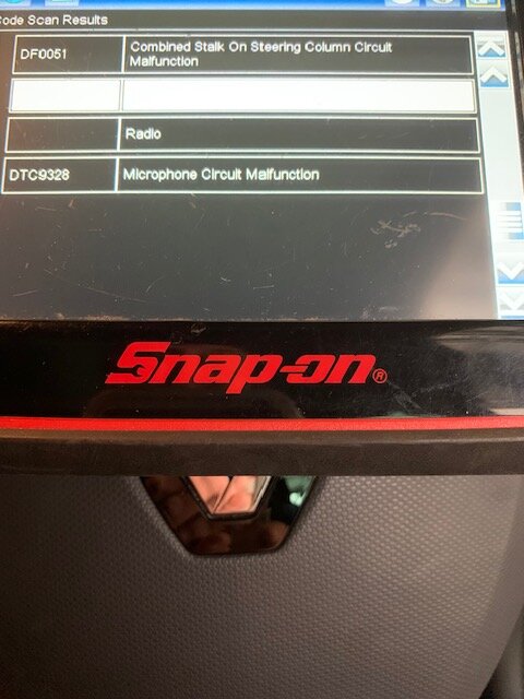

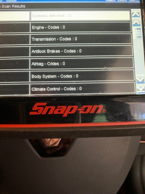

Does anyone happen to know what these(Below) error codes mean/potential fixes? Should I still buy or just skip this car altogether?
DF001 - Oil Level Sensor Circuit Malfunction
DF0002 - Alternator Voltage Control Malfunction
DF0003 - Computer Main Supply Voltage Out Of Range
DF0047 - Battery Voltage Sensor Out Of Range
DF0051 - Combined Stalk On Steering Column Circuit Malfunction
DTC9328 Microphone Circuit Malfunction
The company that performed the pre-purchase inspection is State Roads. The guy that inspected the car was trying to set me up with his mechanic brother to fix these issues, is it possible he just pulled out a few wires to make it look like it needs to be repaired before purchase? I don't want to be too much of a conspiracist.

We’re the fault codes cleared, take the car for a drive and see who’ve codes stay? I’d bet the battery has been low at some point and it’s thrown a lot of those up that aren’t actually faults.

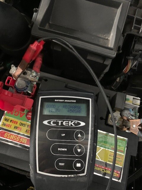

I think you're right. One of the picture the inspector sent me showed the battery voltage at 11.7, meaning it's discharging.... probably just going to get a new battery.

They could easily just be due to low battery voltage. Just a code read is fairly useless for issues like that, they should reset them and see if they come back.
Misfires or other more serious codes are different. Not sure how good the inspection was if they didn’t even stick a proper battery tester on it!
ETA there’s an alternator code there, so if the battery is low too then it could be that, but a basic multimeter check with engine running would show if it’s trying to charge.

Mk4’s are notorious for throwing up numerous red herring fault codes if there’s a minor blip in voltage. Clear them and see if any return..

He did do a multimeter check(11.7, see below, but he didn't mention that it could be what's causing the errors. He just tried to peddle his brothers business.. Pretty sure it's just the battery.

Typical renault, stored previous codes prob related to low batt voltage. If eml is not on and everything working ok would not worry, get the place to put a new battery on it

Ah, that is a battery tester, so it should give an indication of whether the battery needs to be replaced or not. It’s saying good/recharge so doesn’t look like it needs a battery.
It’s either just been sitting for a while or isn’t charging - but I’d hope they’d be able to tell you if the charging system is working ok or not.
The seller has said it's been sitting there for a while, rarely used because they have another car. I honestly think that's just the problem.
