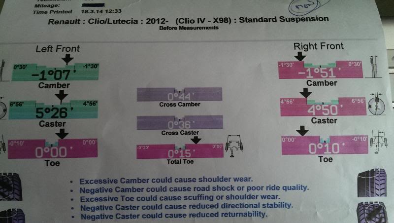

my dealer says my car is fine but i am sure some think is bent on the right side car pulls to the left when steering wheel is level. when i had the car it had to have a new alloy on the drivers side down to some damage on it.
its back in now they recon they have done the tracking but they not fixed the camber and caster ? they say it may not have been checked right at the place i took it in to i think they pulling a fast one.
But the car doesn't have adjustable camber as far as I know. Adjusting the toe would make a minor difference to camber and caster but not as much as needed.
Did you get a before and after geo report. Assume the above is before.
Cars to naturally pull to the left slightly so if you fall asleep at the wheel you don't go into on coming traffic.
Assume thats a before - had a nightmare with my mk3 pulling to the left and numerous retracking set ups and eventually found it was a big nail in the tyre (more like a bolt oddly) - new front tyres and problem solved
