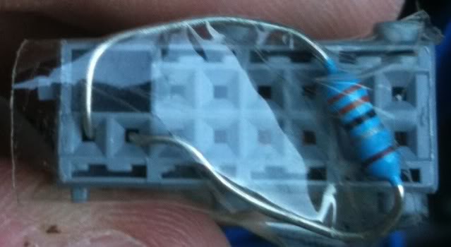

I know another airbag post i have had a search on the forum but not found what i needed, I have 2004 clio which failed its mot on airbag ! I have soldered the seat airplug wires bypassing the plug also have had the ecu sent off and cleared, Now i have 3.3 ohm resistors but i am stuck on fitting them as the pretensioners have 3 wires ? orange, blue & black, I thought the resistor goes in the orange & blue wires ? Unfortunetly i am running out of time for the mot. :(

Resistor bridges the pink and orange wires.
Like so:
Thanks for the pictures,I have to admit i have cut the connector out completely dont know if that will make much difference.
