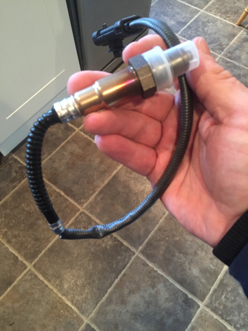

Had it on a code reader and showed o2 sensor 1 and also put the management light on so I'm guessing that's the culprit.
Does it only run rough when the engine is cold Jim? Like first thing on a morning etc
Shortly after I got my Clio the pre-lambda sensor was goosed and whilst on the cold map it would run rough as f**k and sound like it was misfiring on idle and then all of a sudden it'll run fine.

Kind of. It was hardly running yesterday and today it was fine! I'm confused by it all but that's the only fault that's showing. I checked the injectors and they seem fine.
If you run it first thing tomorrow with the engine cold, just see if it idles rough and if it does it should only be for around 5 mins or so. If it idles fine then it might not be the lambda

Just ordered a Bosch lambda from euro car parts for £55 so we'll see if that solves the intermittent rough running issues.
leeds_182
North Yorkshire & Humber
Delivered today! Can't argue with that service from ECP!
