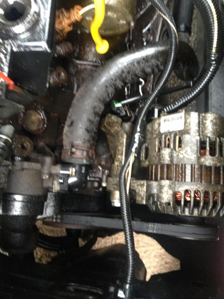

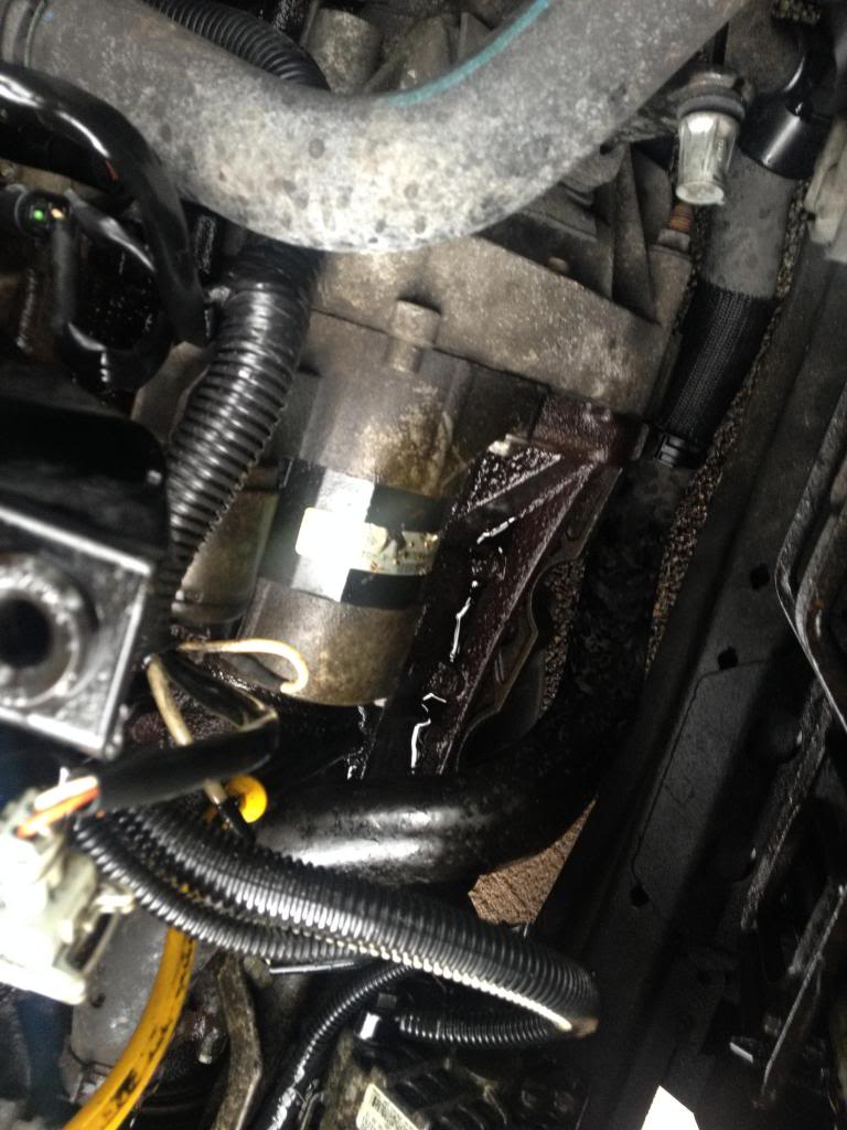

Hi, I have an oil leak on my car that has covered half the engine bay, it on the bonnet behind the bumper all over the alternator and pooling at the front of the engine, I have take it to 2 different garages, and neither can locate the oil leak, I was wondering if anyone had any similar problems or could point me in the right direction

I live in sheffield and I run the car when it's up to temp, but you can't see it, it's really annoying I've been told it's the rocker cover but could it be that, surely that would be all over the engine bay if it was! I appreciate the help guys and gals!!

I'd get a new aux belt fitted either way as yours appears to have a split.
Yeah I noticed that the belt had split, gunna see to that on pay day! And the inlet manifold was taken off when the rocker cover gasket was changed, I'll check all the bolts thanks!
I tightened the bolts up on the inlet manifold and there is only a little but of oil coming from there now, but now it seems to be coming from behind the engine because the firewall and top of the engine have a thin layer of oil on, thanks
