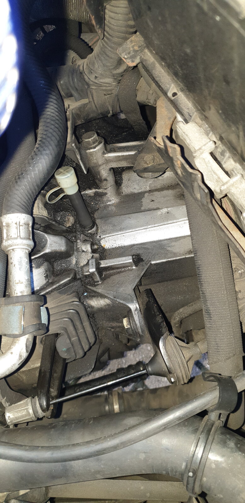

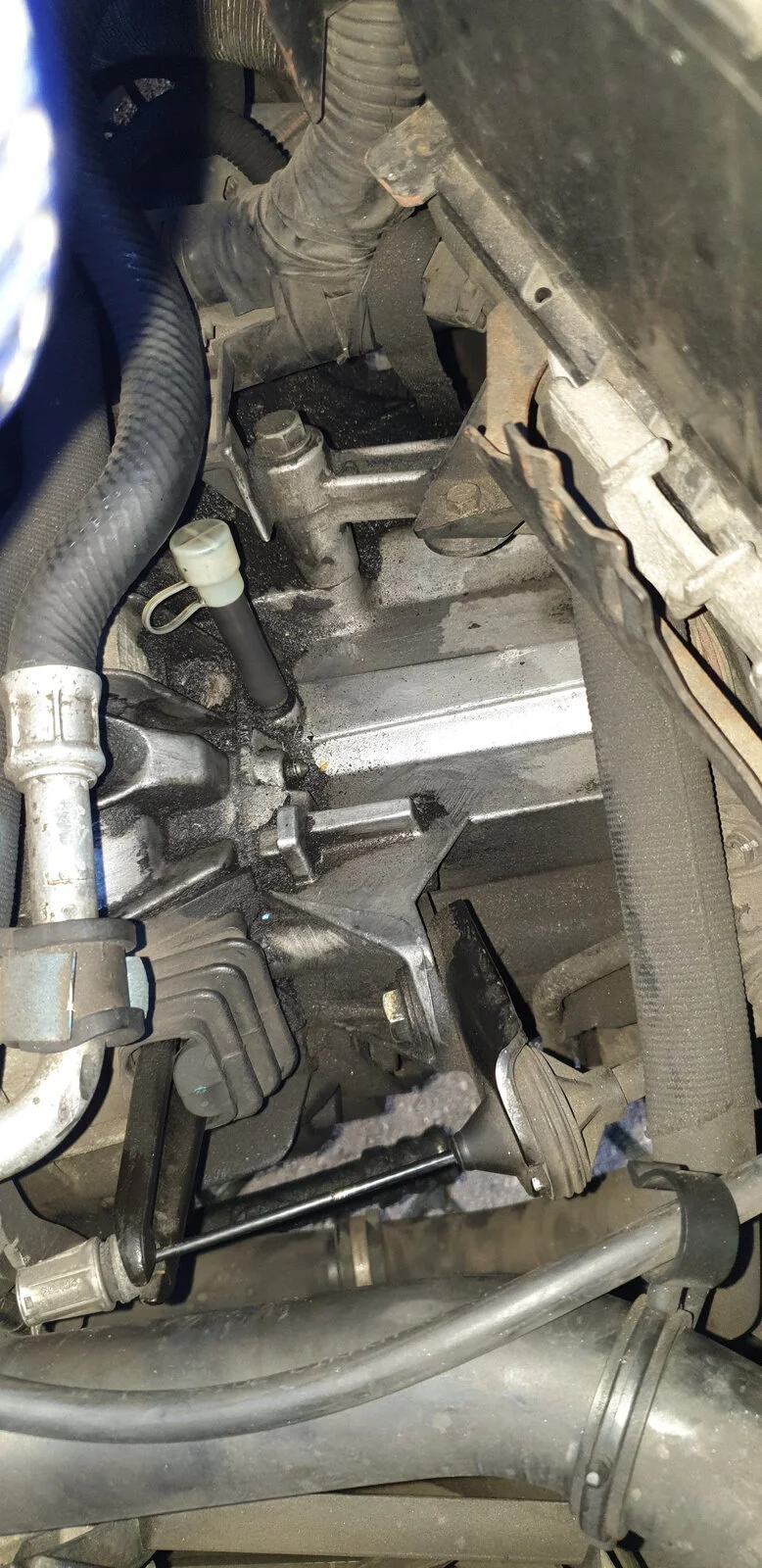

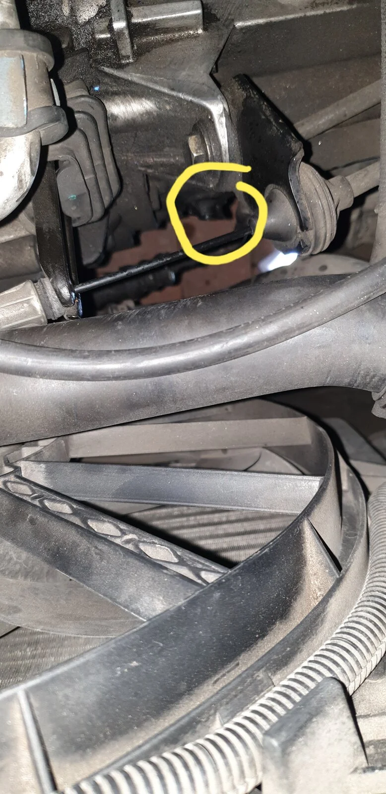

wana change the transmission/gearbox oil in my 172 cup.
in the picture the little rubber tube with plastic cap is that where i put the new oil in ?

This is the second post about where to fill the gearbox oil .
Have you read the other thread . ?
Its literally behind this hose

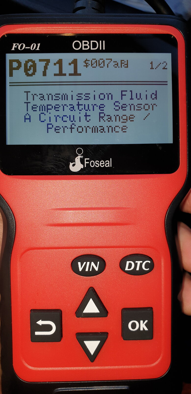

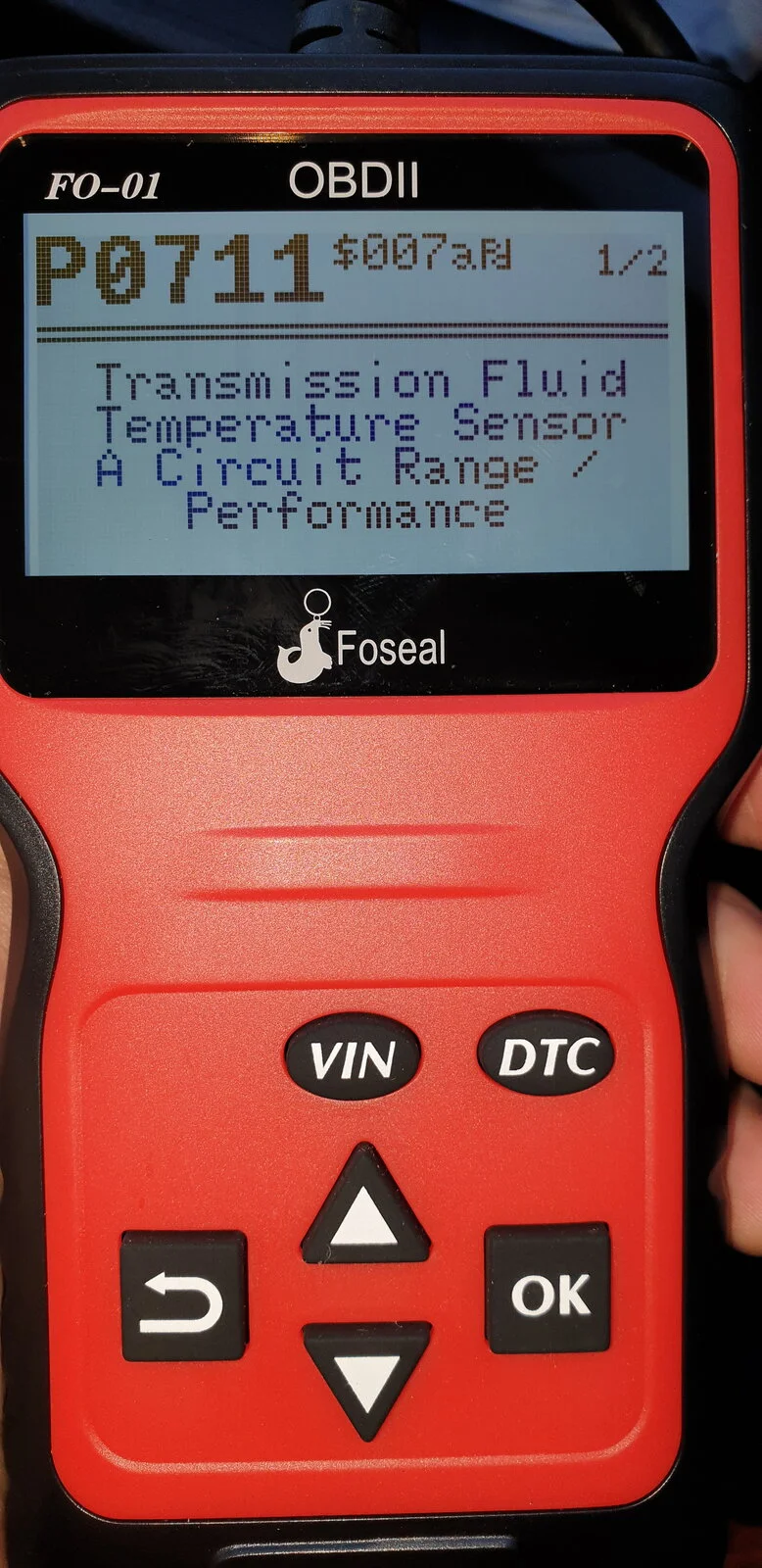

if i change the transmission oil will it sort this error code out. if not where abouts is the sensor.
thanks keith
Do you have any other issues with the car? If not then that error can be probably be ignored.
did have a misfire but changed coilpak and sparks and ht leads. runs so much better now.

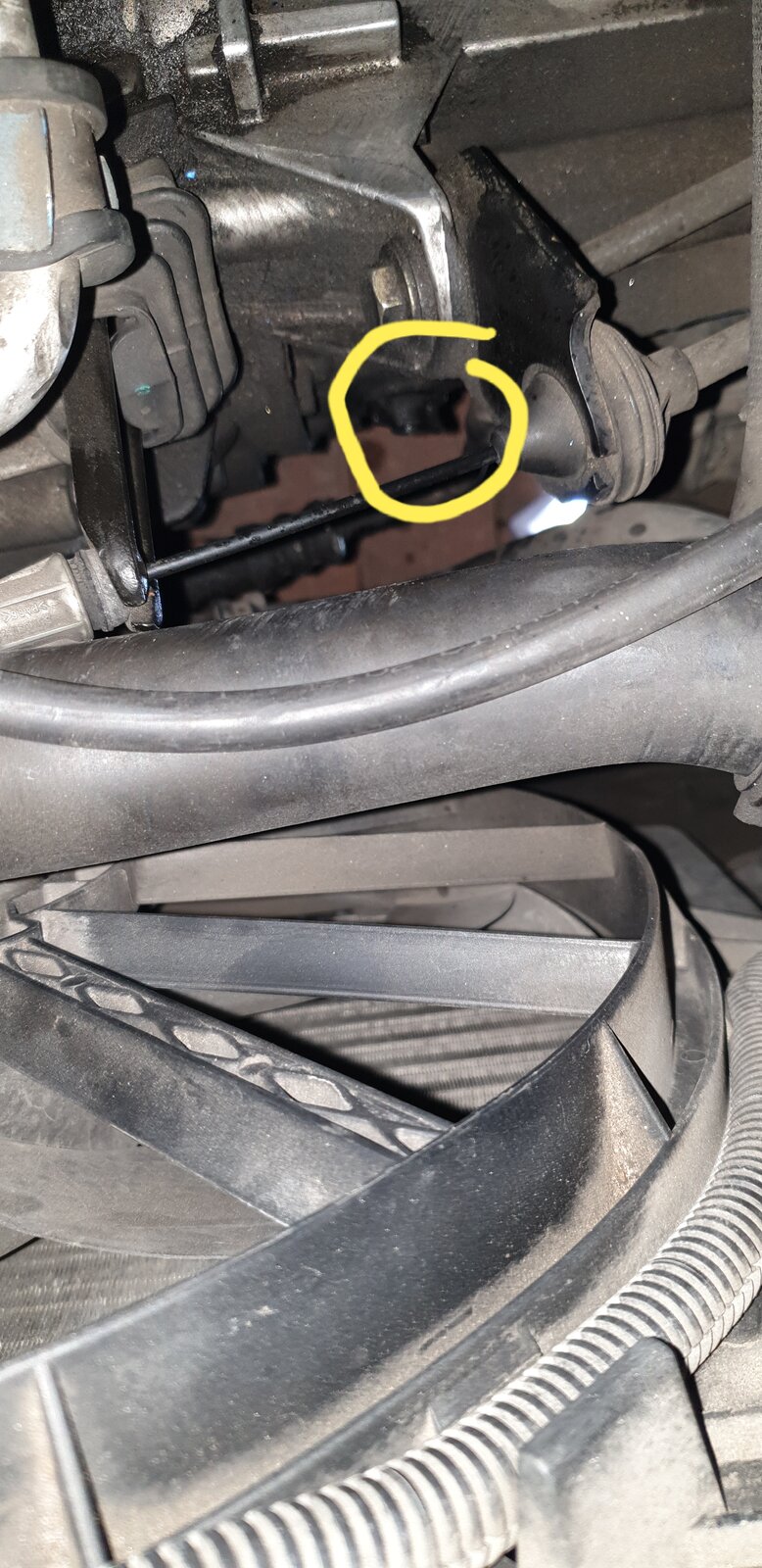

right ive found the plastic refill gearbox cap.
how do i put 3litres of oil into the gearbox without the oil coming out?
surely the refill cap should be on top of the gear box?
any ideas?
thanks keith
Drain the box, then refill through that hole and when it starts to dribble out you have filled it to the right level. Make sure the car is flat and level obviously.

Drop kick that generic obd reader into the bin, that code is nothing to do with the 172 gearbox

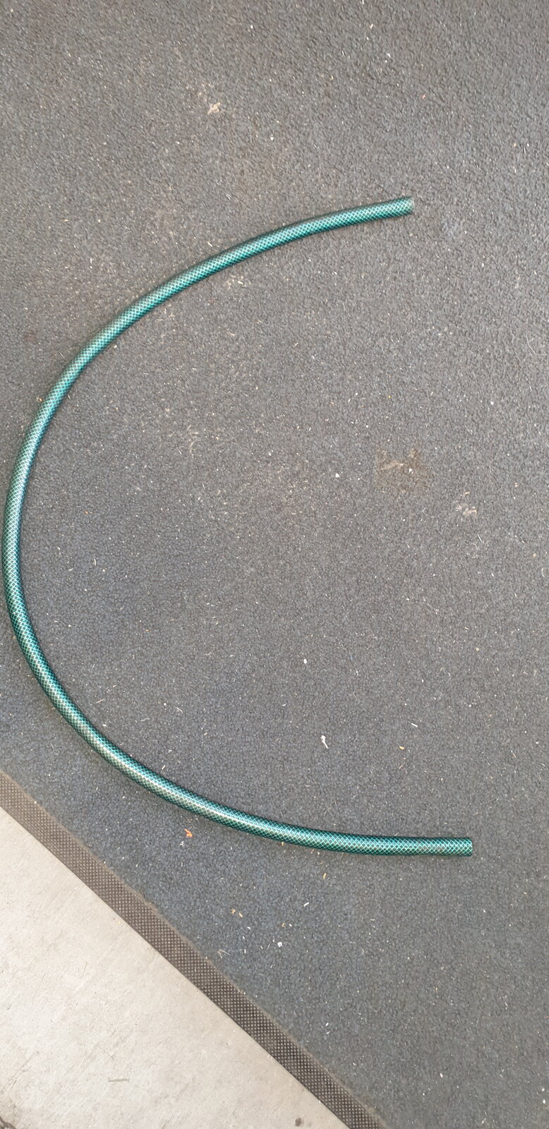

Exactly this, drain the fluid, then use 50cm standard garden hose pipe with a funnel wedged in to it. if the funnel is too big for the hose then put the end of the hose in a cup of boiling water for a minute to soften it.
Get ready with some rags to catch the over spill when pulling the hose out of the filler hole, or just get the plastic butterfly plug back on super quick.

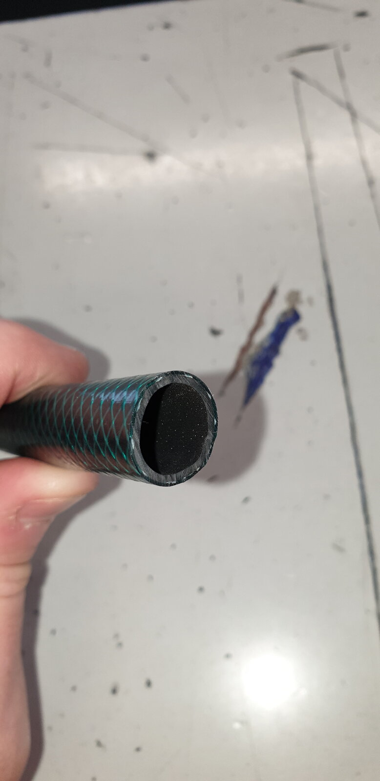

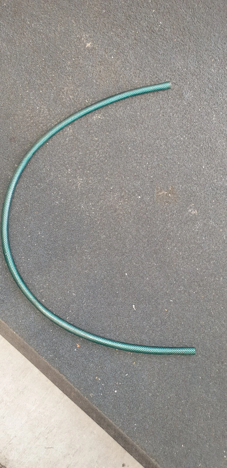

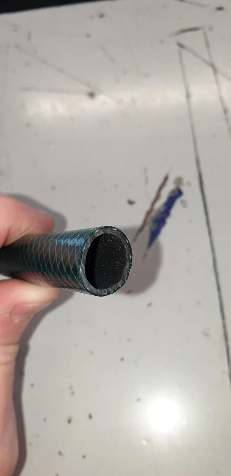

i have a 90cm hose with about 15mm end.
which i will stick the funnel in the end will this be ok

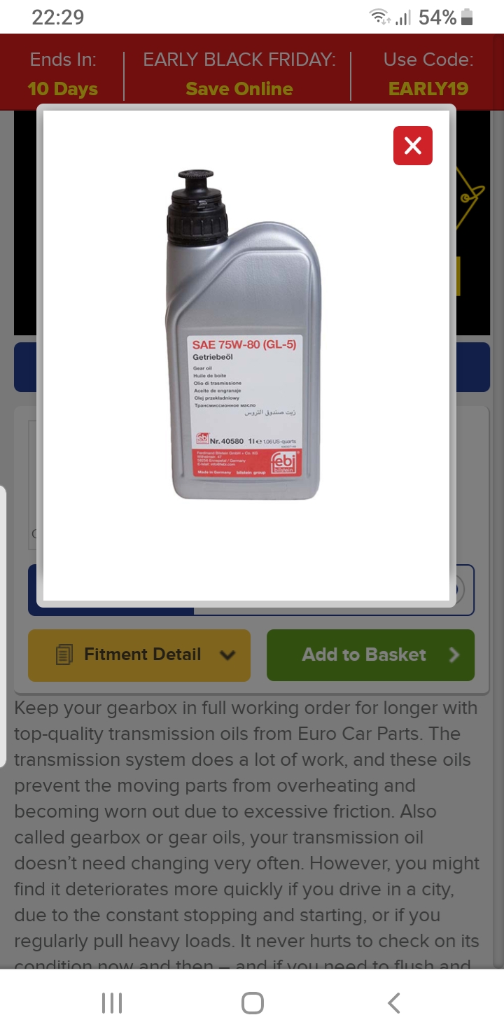

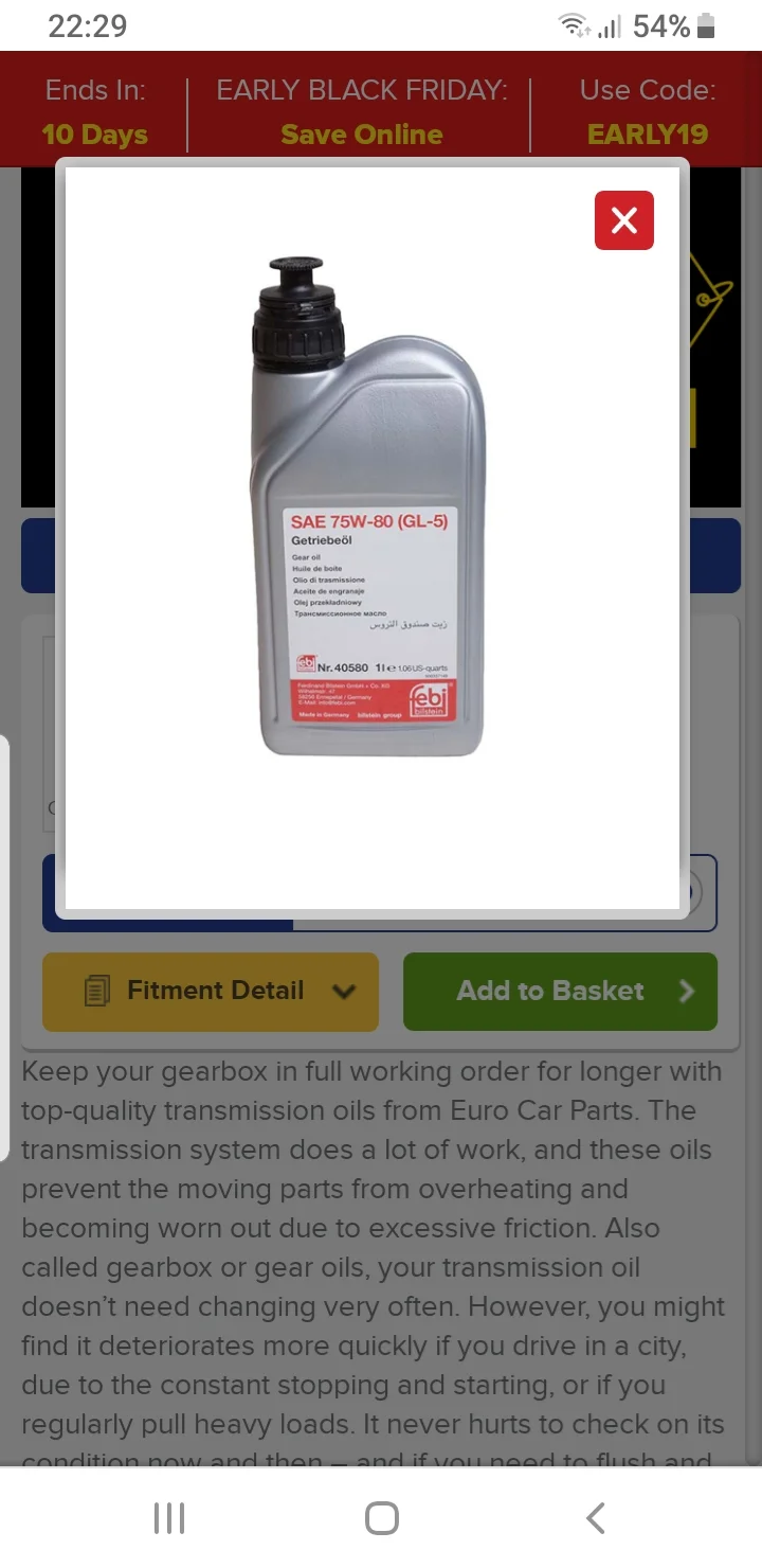

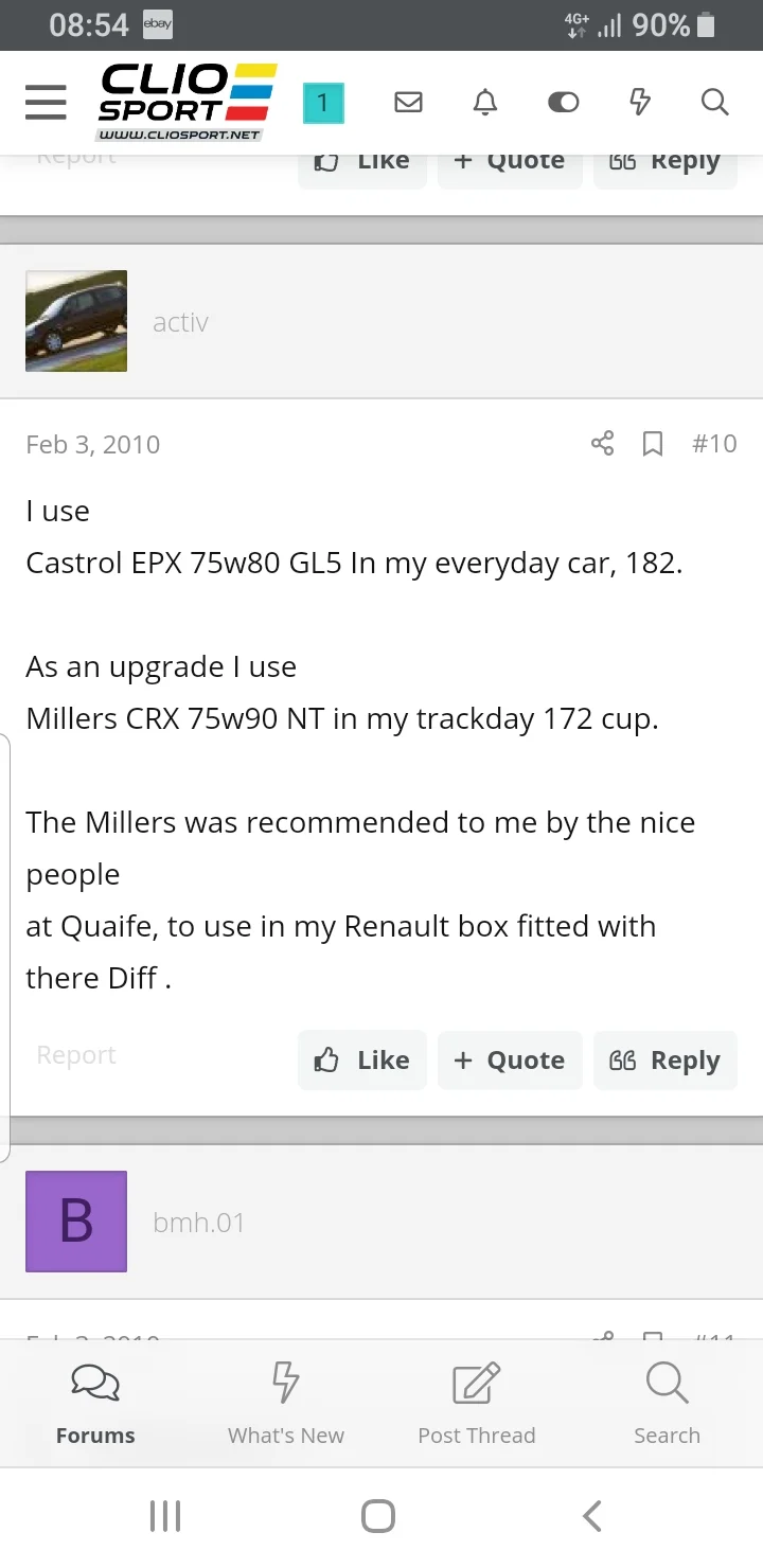

just brought 3 litres of the 75w 80 gl5
from euro parts for my gear box oil is it right because they told me it was.

Still not GL4 though, search “GL4 GL5” on the forum.
Apparently GL5 is slippier, which isn’t good for the synchros and it’s got additives which corrodes the brass.
I wouldn’t use it and just get the correct oil, just as @bloke has suggested as first comment in both threads:)

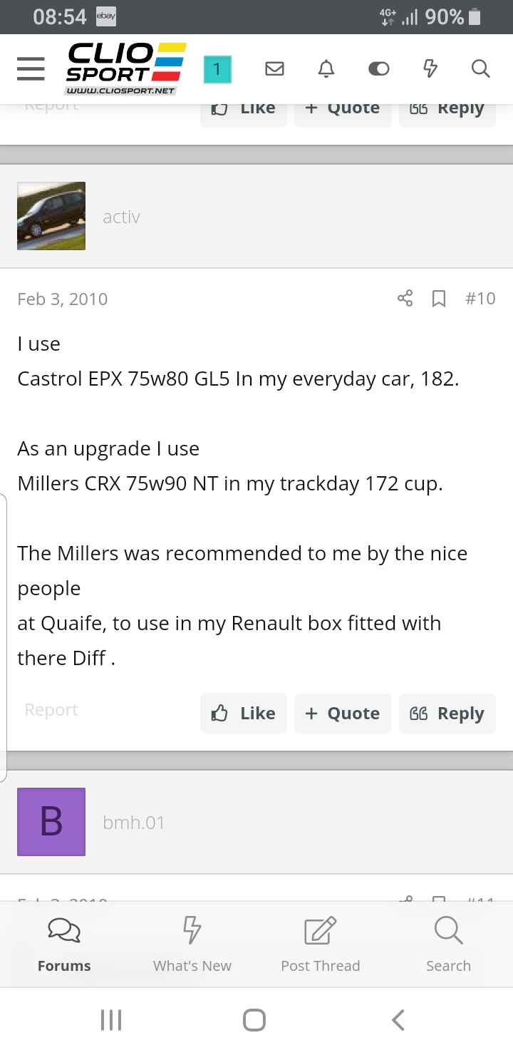

just going to use the 75w80 gl5 as people have used it before.
surely its gotta be better then the old oil in there now as not been changed in 10 years.
