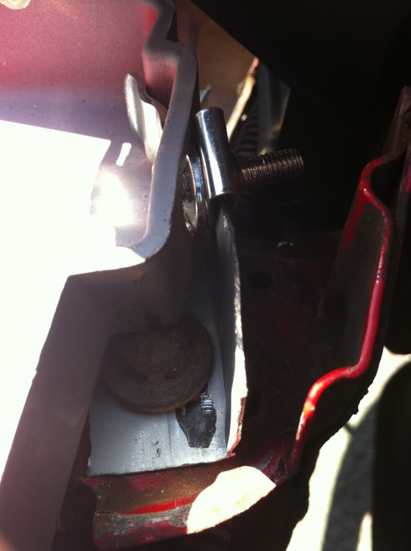

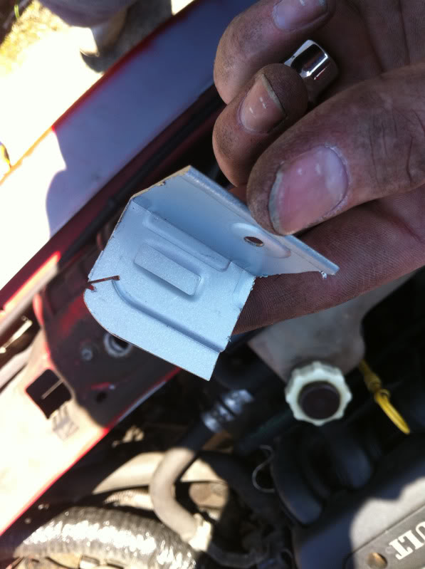

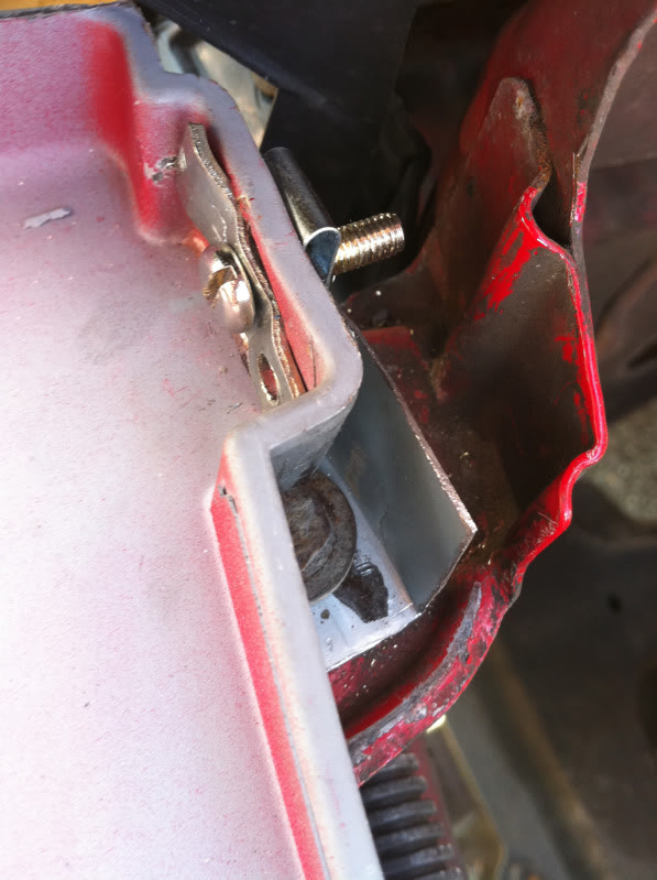

Mines a 172 Rep but the PH1 - Was a rather fun project to put the bumpers on.. A lot of swearing was had! Had to make small brackets as well for the front bumper to bolt too under the central vent under the bonnet
Made out of a Hard Drive bracket
Just havent put the side skirts on yet :p cba
