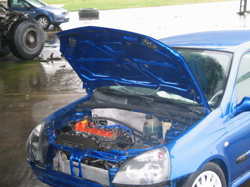

gives you an idea Bloooor
na, that pic is from about 18months ago, it was clean because it was a photoshoot for Track & Race Car mag
(bonnet and slam pannel had just been done)
Looking at that I think you could angle the bodies so that they stuck under the slam panel.

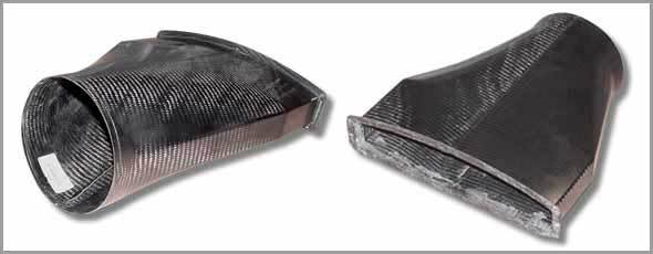

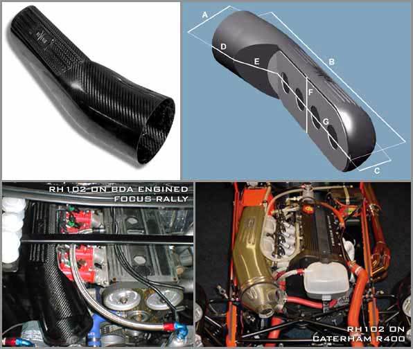

You could use an airbox over the bodies so you arent sucking warm air off the back of the rad and get a cold feed into it from the right hand side above the radiator. No cutting of bodywork or bonnet pins required.
An airbox like this

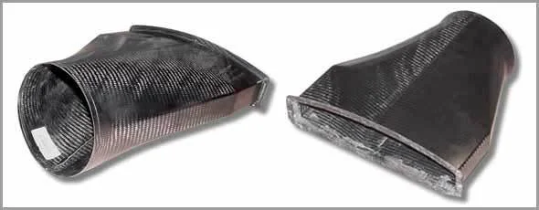

Position this above the rad to pick up cold air to supply the airbox.

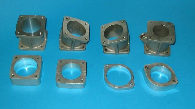

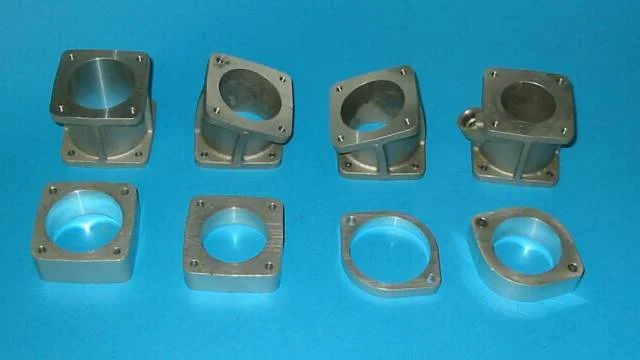

Jenvey do some angles so you can bend the inlet downwards.
I have looked into this and think its possible but you need aircon removing and a custom rad as per the Yozzasport car. Not a cheap solution but space permitting you get a longer inlet length and colder air.

Markm - that airbox looks funky, who sells that as my filter is fucked pretty much and wont survive another de-greasing I dont think.
£400!?!? f**k me sideways, I think I'll have one made from plastic and save myself some cash... or get another foam one for £30 lol
