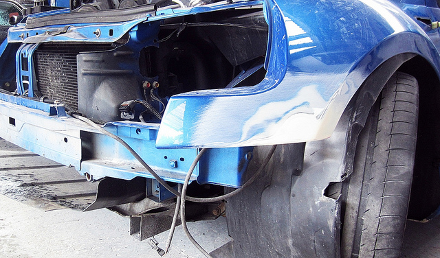

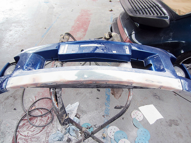

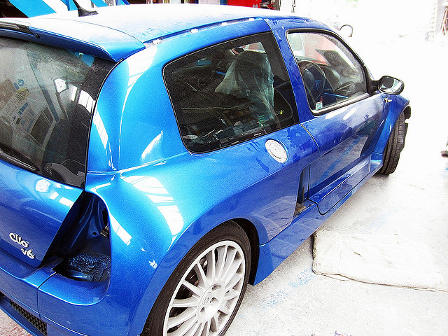

Restoration? Maybe not the right word. Ignore the state of the place it was a bit messy last week but I hope the pictures speak for themselves about the quality of our work.

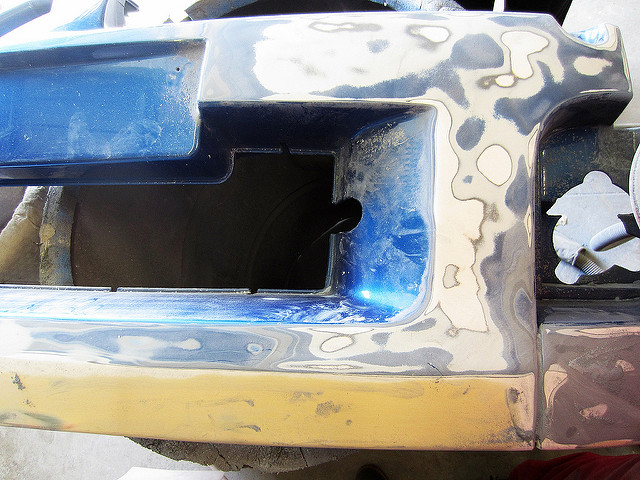

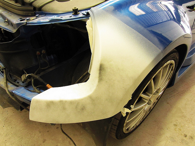

No at this stage I would say that the job went from bad to worse, initially it was in for complete stonechip removal and any light repair, as you'll see from the pictures it didn't quite go to plan and an extra 2 days work ensued. I've a good mind to send the bill to the previous bodyshop, utter cowboys.

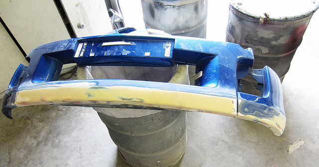

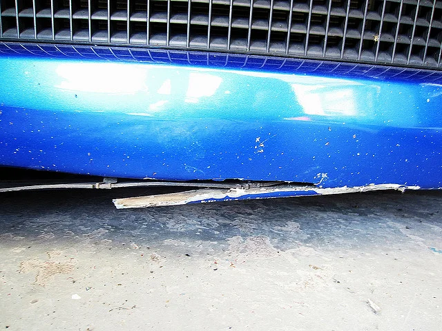

Now in the ideal world you would replace a bumper if it was badly damaged, especially like this, sadly the bumper even if it was available would be £1000+ sadly they are no longer available so we work with what we've got and make sure it's done to the highest possible standard.

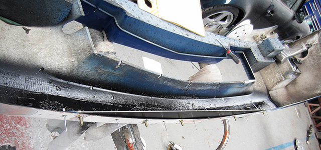

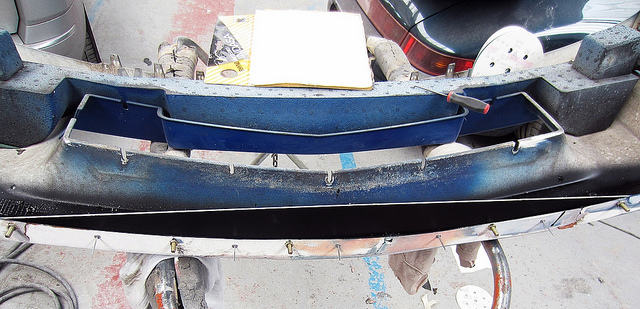

The reason the above happened is the previous bodyshop had repaired the bumper and fibreglassed/filled over 2 existing screws that go through the bumper into the massive air guide. They had also painted the bumper on the car, another ridiculous decision in those circumstances.
The piece of metal you see is brand new Aluminum, cut and shaped to look OE and follow the bumper and air guide perfectly. The added strength was a must at this stage as the repair work done before hand was actually falling off in our hands. Rivets would stay in place, bolts were simply for strength when repairing and bonding. Also helps check for any cracks or holes in the filler/fibreglass work.

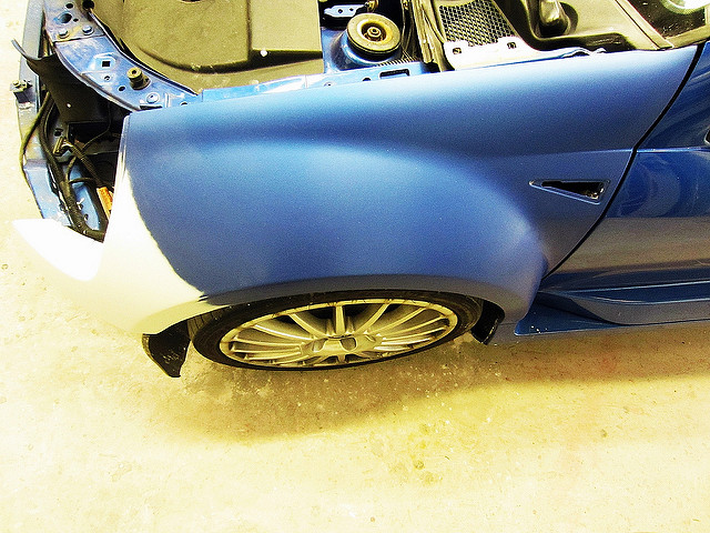

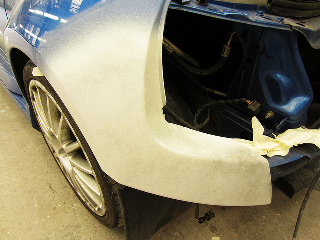

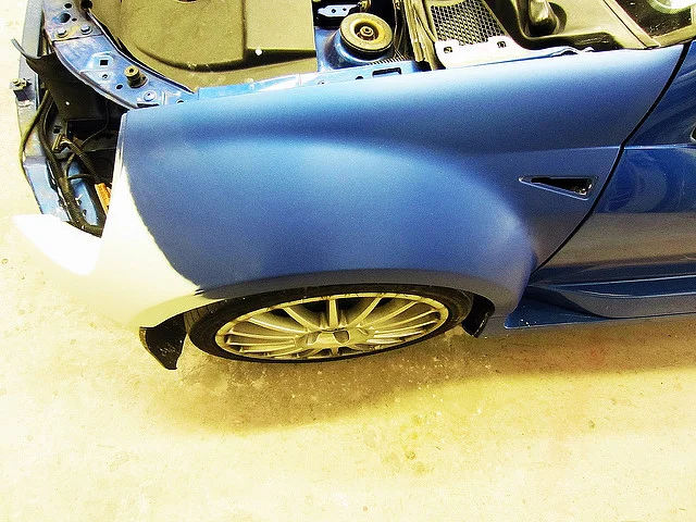

The previous bodyshop had also missed a small crack on the N/S wing which required extensive strengthening due to the bumper mounting points...

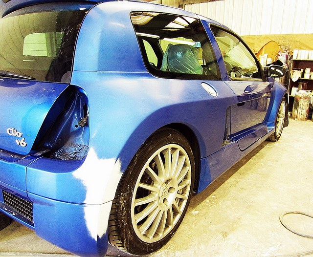

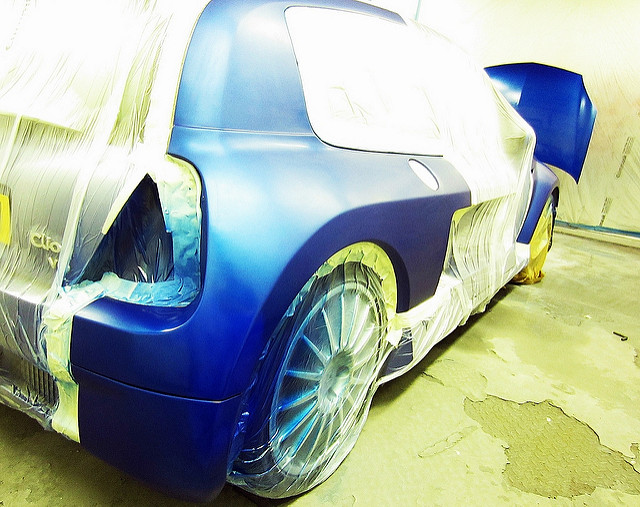

A light scuff at the rear also painted whilst on site...

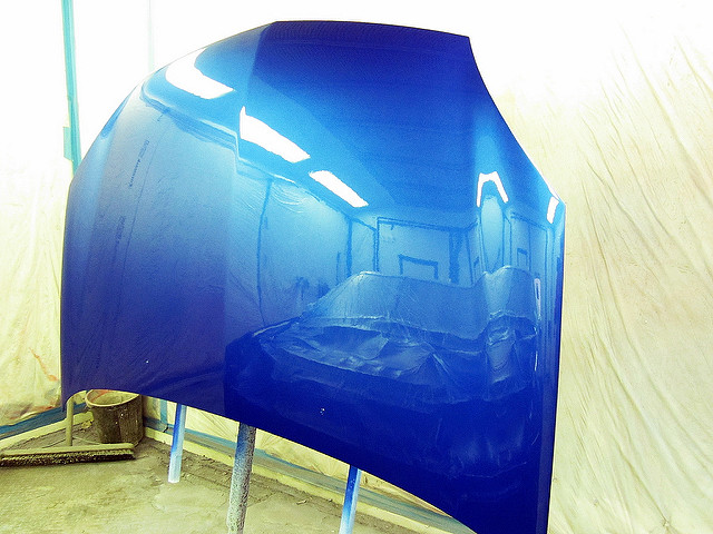

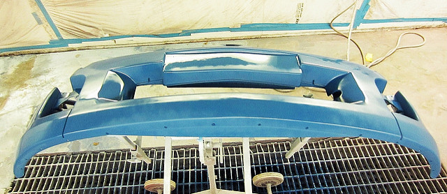

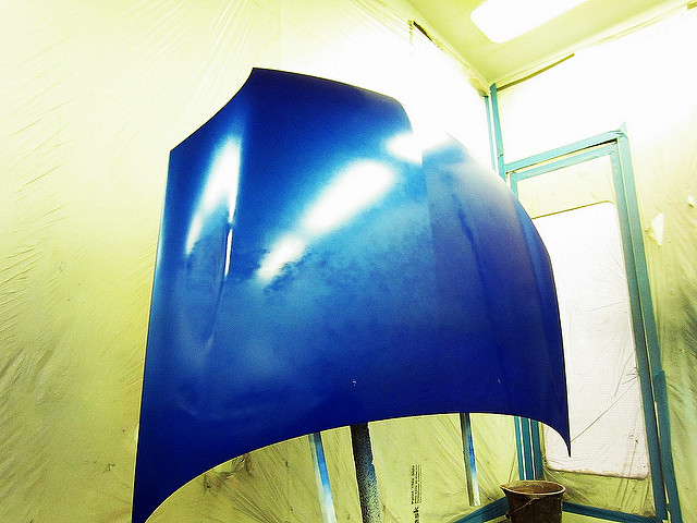

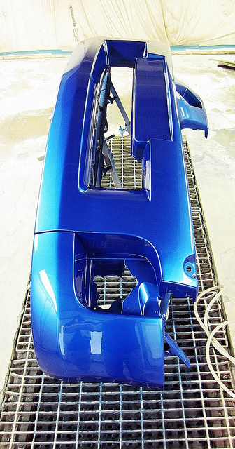

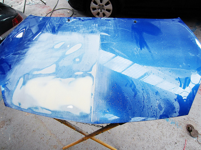

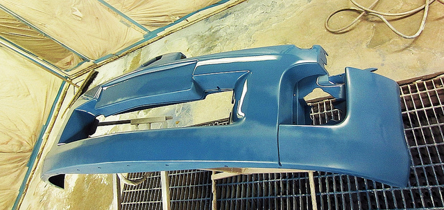

Another thing we do when doing front ends for stone chips and similar is remove all previous paint where possible, bumper and bonnet (leading front). The more paint that is on the car the more easier it will chip, I think the bumper had about 5 layers on it. My paintshop foreman was over the moon with that task.

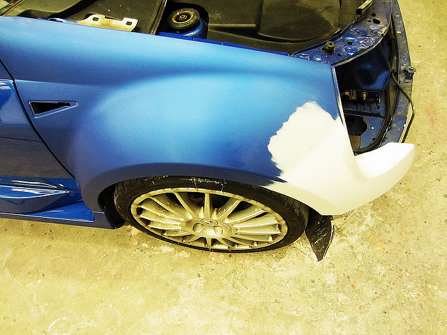

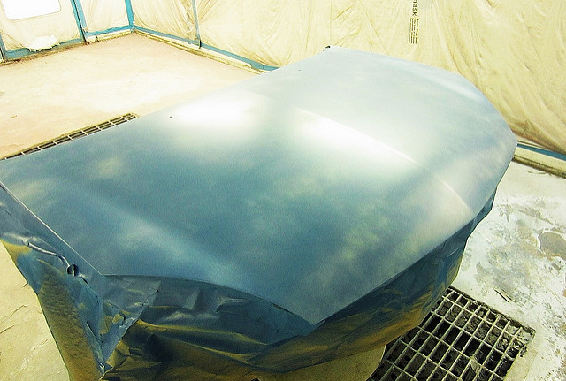

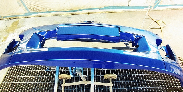

Body coloured primer used on bonnet and bumper. Both these parts baked then hand flattened after priming for the flattest finish prior to actually prepping and painting.

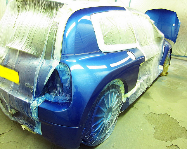

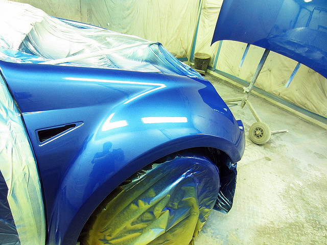

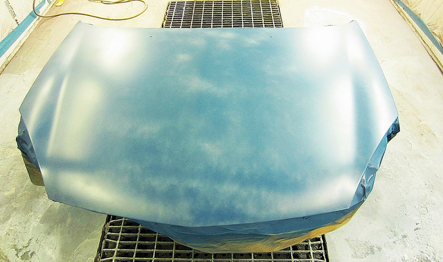

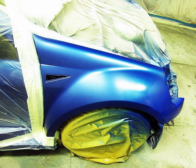

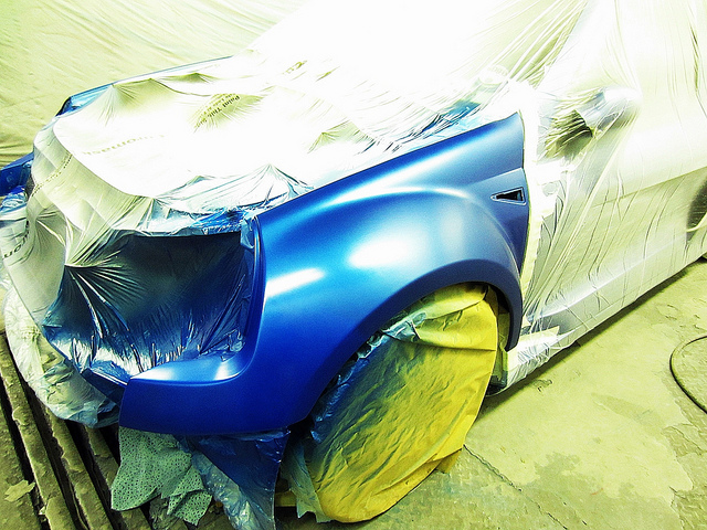

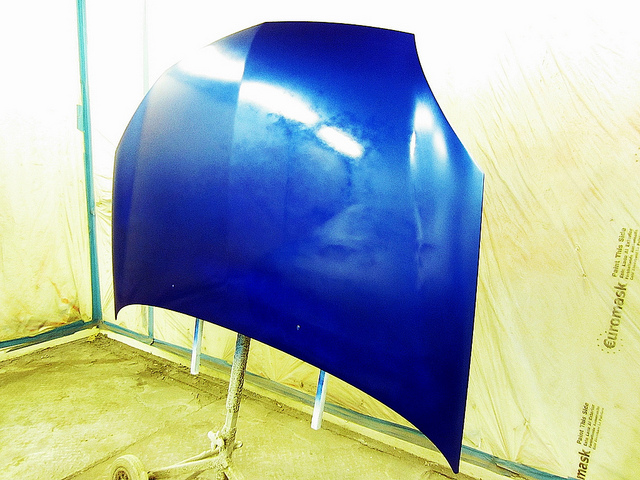

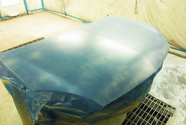

Application of basecoat before lacquer, note where the actual "blue colour" is applied. Never the full panel in this case.

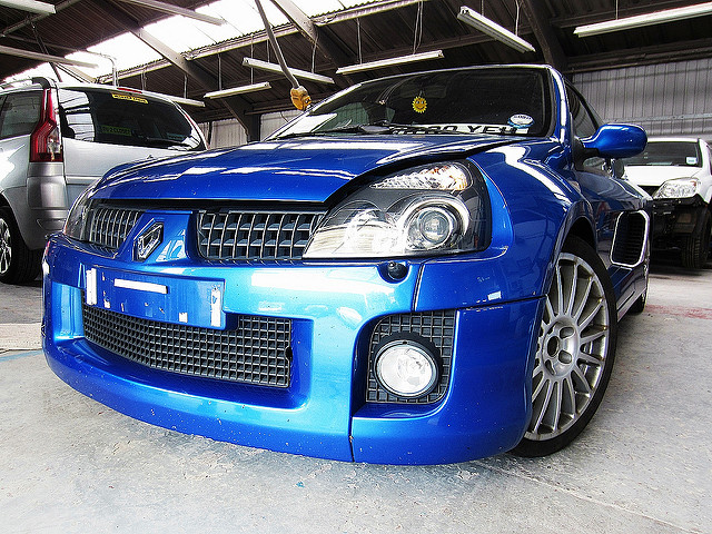

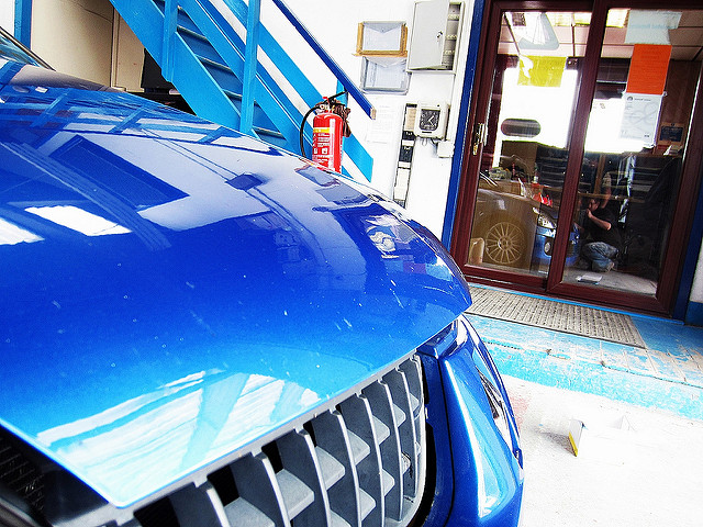

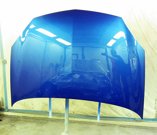

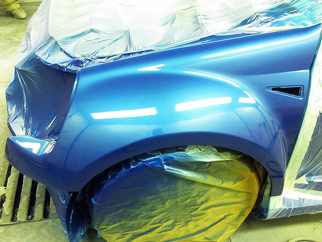

And finishing coats...
Thanks for looking guys, just a little insight into what actually goes on when you leave your car in the hands of a bodyshop.

Surely if the finish was genuinely poor then it would be poor after the clear? It's also not meant to have a "finish" from the basecoat especially when "blending" a bonnet like we have. Keeping the original colour at the top edge to edge with the wings.

Forgive me if I'm wrong, and I probably am, but with metallic paints (I assume this is metallic?) shouldn't you be spraying the panels in the orientation that they are on the car?
for example you've sprayed the bonnet with it upright, shouldn't it have been sprayed when horizontal?
I've not idea what you're talking about mate. Do you mean why is the bonnet not laid flat?
It's a bit different if the bonnet was on the car but 9/10 times you'd never leave a bonnet on a car as it'll just lie flat to gather crap.

Now I definitely have no idea what you're talking about. Are we talking about the direction the paint is applied? If so it's side to side. Always.

Gally what I mean is, taking the bonnet as an example, and I'm assuming you sprayed it whilst its vertical, shouldn't you have sprayed it lying horizontally? I.e as it sits on the car, but not on the car
apologies if its not making much sense lol
Gally
No you wouldn't mate. As my earlier point, that's mental.
Jaff.
How? Just curious as I've always been led to believe that you should always spray metallics/pearls In The orientation they would be on the car, so bonnet horizontally, doors vertically etc. because there's a risk of getting them slightly off colour if you don'tdon't
Rob
Am I correct in saying you just want to apply flat to the panel, at 90 degree's or as close as possible to that, you just don't want to spray at like 3 degrees across, right?
I'll put it a different way. If the bonnet was laid out flat, isn't there more chance of dirt and crap being able to land on the larger surface area? It's quite a big deal.
The application of the product is exactly the same no matter where your painting or what angle the panel is at. Not sure what you guys have heard or been taught but you're kind over complicating it.
Funny to hear outsider thoughts on how they thought people painted cars.

basically what he was saying is if I wanted my meganes bonnet repainted (Monaco blue (metallic)) then make sure that when I take it to them off the car to make sure they paint it with the bonnet lying as it would be on the car (horizontal) to minimise the risk in a slight colour mismatch caused by how the flake would sit in the paint.
ive always thought this is far fetched tbh so who better to ask than someone who does it all day?!
edit: with the contamination point, shouldn't it be in a controlled environment anyway?

Of course you're likely to believe him, he's clearly on drugs but then again that's probably just what he's been taught.
If that's the case then the bumper should have been sitting upright opposed to lying down. Anyone painting a bonnet flat off the car is mental. I'm not sure if you can get your head around it but logically the application is exactly the same no matter what way the bonnet is lying.
