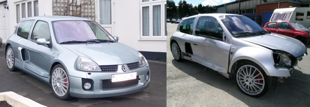

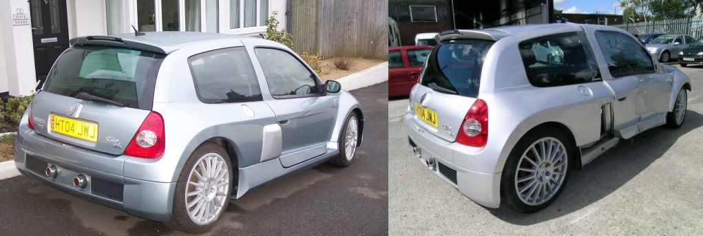

Just put the car on the road after 3.5 years of repairing as bought as a CAT D.

You've done a good job repairing that mate.
