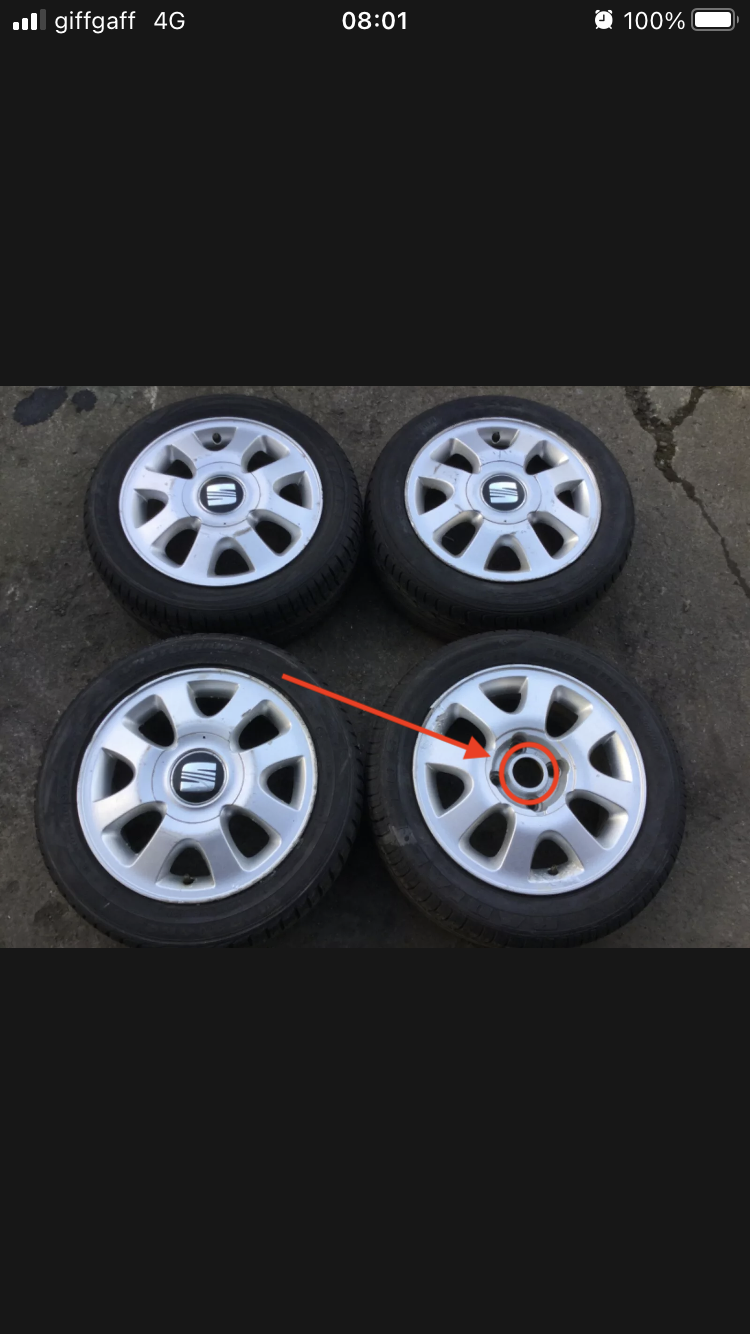

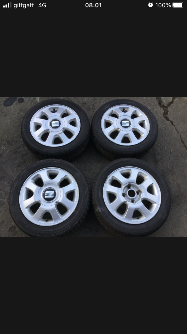

just got a standard Clio 58 plate 1.2 petrol, I’ve attached a photo of the wheels.
they go in a bit wobbly and when putting the bolts on it feels like they aren’t reaching into the hub? Hope this helps?

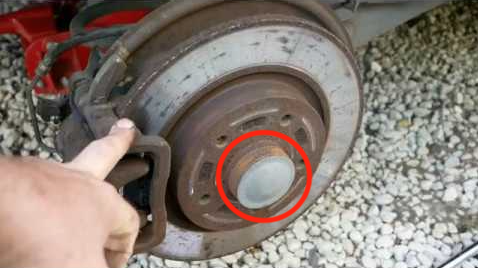

The centre bore (CB) of the wheel is probably too small for the Clio hub (Clio hub is 60.1mm).
Grab a ruler and measure the gap on the wheel (circled red), anything less that 60mm is a no-go I'm afraid.
