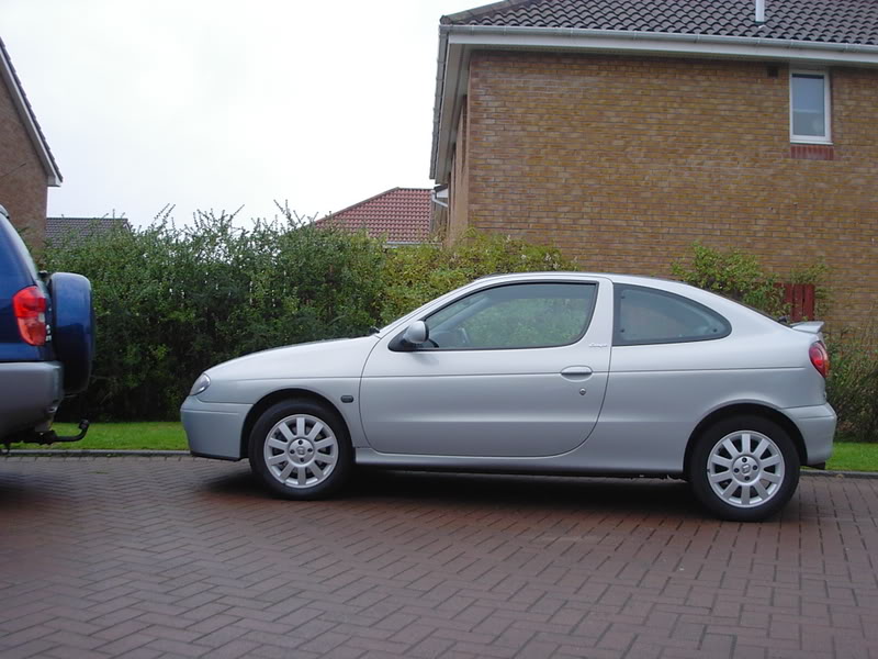

Do they look like this?
If so Id be very very intrested
  Clio Extreme 1.2 2002
no mate they look like this.
x1pbglk-vqL4Bst9CXqRpOmZtvQdrE9ssikpihyVY025cgZp7smkh487jJ1lBlg5enEveE7QfF51u6vSidIGmvniCxC2GL9yPCfBwkZ1Ey0XT6ICjERo9mXyWR8xg1LBh5ARVB6FhZCtZy1nzVJG1AD7zhf_ANP65ag
and this
x1pbglk-vqL4Bst9CXqRpOmZtvQdrE9ssikpihyVY025cho1vbpafJX-yjO2JMBLtIaiOBqhnz9sb16i8a6ODwSQRGpQ5OqNw9EWn9lV9q4SZn7G0hNEktgyjPdCnFmVX2HMuAljKZUGtnP1qCv9fdlCVscEfZt3rTB
I think they will look good on my car and with the size of the tyres give me a better ride. I just wanna make sure that they will fit my Clio before I buy them.
