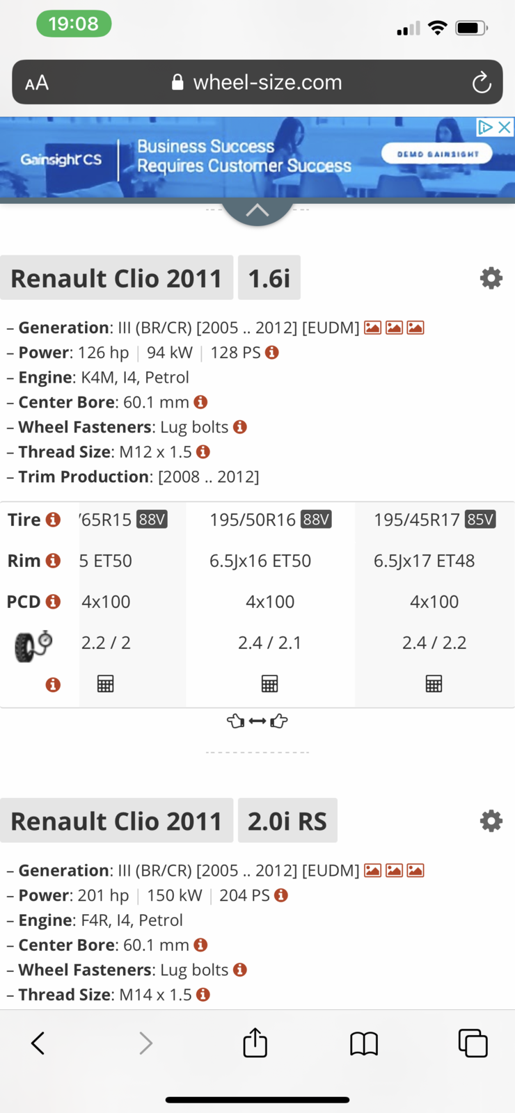

These are the stats of my car. The wheel I’m looking at has a 35mm offset.

ET35? They will sit further out by 13-15mm (ET50 or ET48 minus ET35) if nothing changes from your current wheels (diameter, width) but if the wheels you are considering are wider, half the extra new width will be added to each side of the rim, therefore half the extra new width needs to be added to the 13-15mm.
That screen grab says some standard wheel options are 6.5"x17" ET48, so 7"x17" ET35 are not that much different - they might be fine (in terms of not rubbing on bodywork).
Is the PCD of the new wheels the same as your current wheels?
Is the centre bore the same (or a bit larger)?
