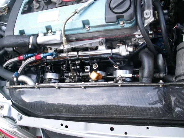

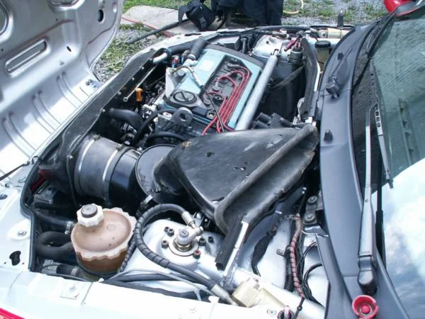

I do have some small problem. Taking a chance that my car being tuned up right now (again) I am thinking about gr. A intake. I have found some pictures and materials regarding such intake - but I do have small problem.
Look at the pictures below
accordign to gr. A renault sport book it seems that the intake should be installed to the engine as shown about
so why on some other pictures and projects this intake is installed and conected as shown under?
It seems that the intake goes in front of ITB
Please give me some information what is the correct way to do it. I though that having ITB we do not such intake?
  Audi TT 225
You can still add an airbox to ITB's, usually made of carbon fibre and its purpous is to ensure cold air is fed into the intakes because they sit so close to the engine.
What your seeing there is a carbon box around the ITB's connected to the airbox
Similar to this

p.s. when I do look at the above pictures it seems that these ITB is way to big to be able to close the hood. Was there any modification made in order to close it?
Do you have pictures of this car?
