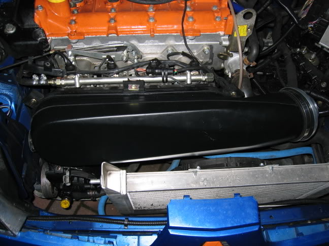

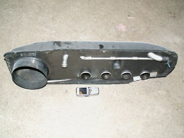

thanks, I think that Air Hornes will be not needed.
Does anyone knows where I could get such airbox together with air intake??
  Lionel Richie
pipercross sell something thats not as good as that
or you can try reverie - very expensive! my airbox was £700 from them!

  williams and trophy
and take those bolts out the pullies and replace with the domed allen bolts....the ones in the pic will rub on the inside of the cover.
lookin good btw.
  williams and trophy
the bolt heads rub on the inside of the pulley cover. the round head ones dont sit quite as proud, therefore they dont rub.

john's totally correct...
use the wrong ones and you will kill a head.... in a second or two
s**t, sorry guys if I take your time but we have all projects in poland with cat cams pulleys and we have never faced such problem. Does any one have any picture of such problem or where does it cost a problem??
