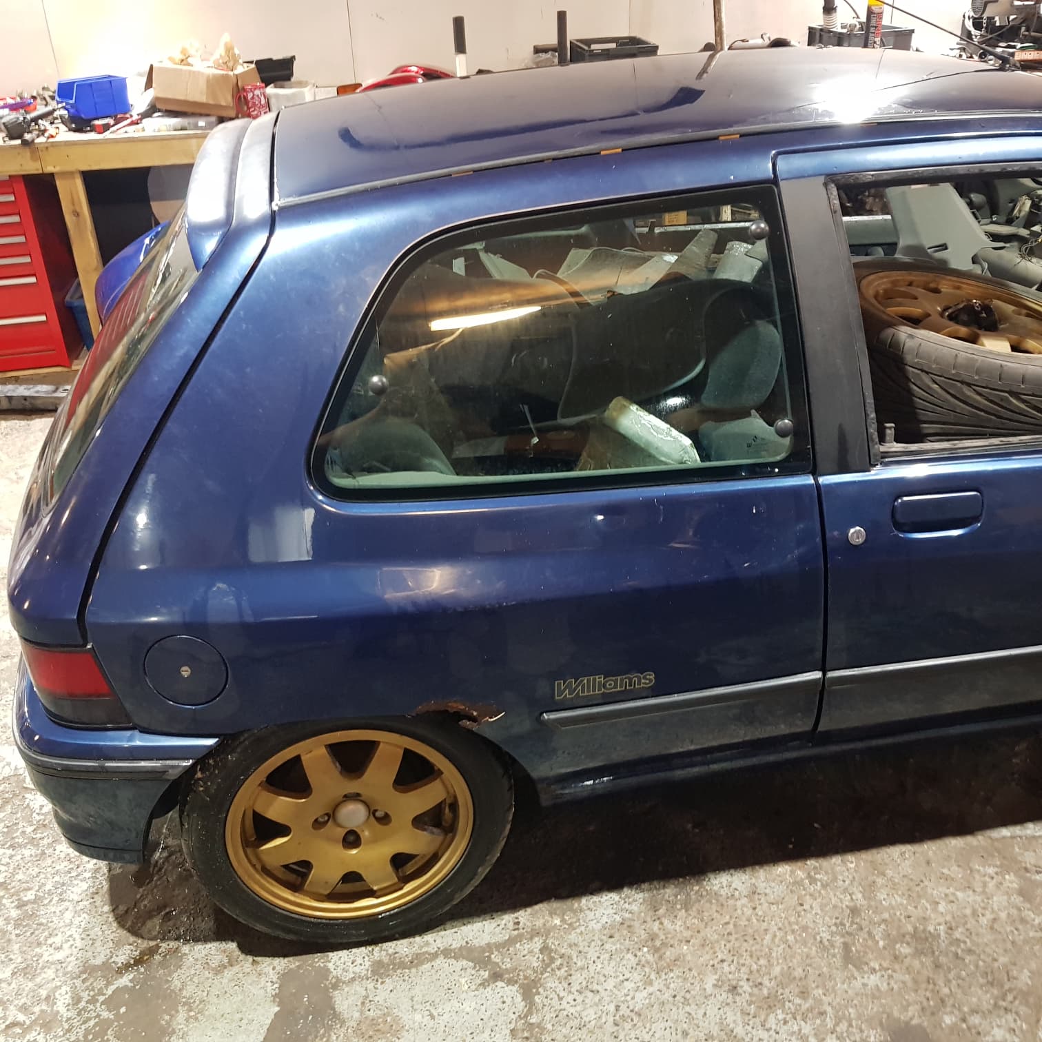

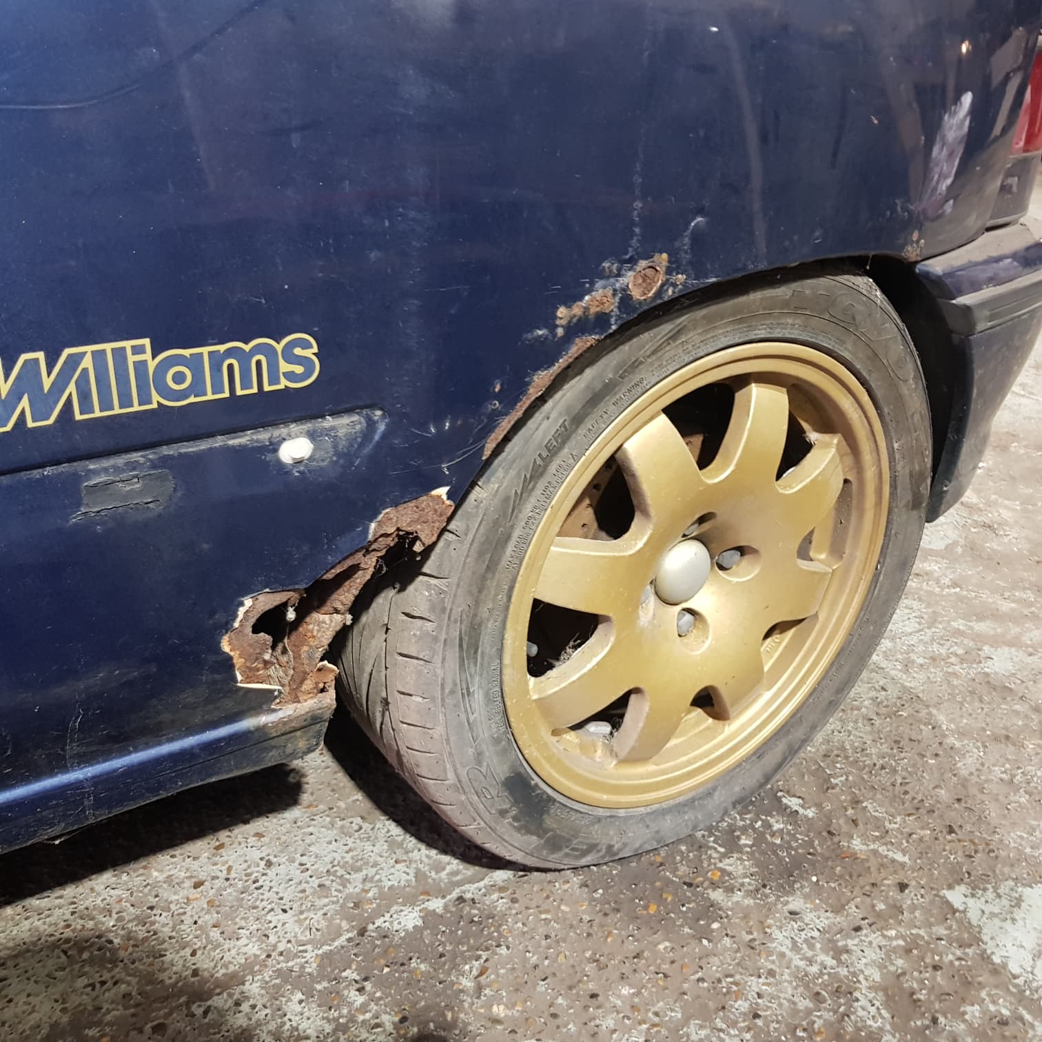

So this is the start of my build thread for my recently purchased Williams.
Not in the best condition but very few are these days.
The good side?
The not so good side.
I shall be picking it up in a few weeks but this has allowed me to start searching for parts. I have purchased sills and front and rear jacking points which will be arriving later this week. During my internet searching for parts I stumbled across the site https://www.boutique-bordanova-sport.com/. Any one here had any experience? They seem to have a lot good parts as very interested in picking up the rear arches.

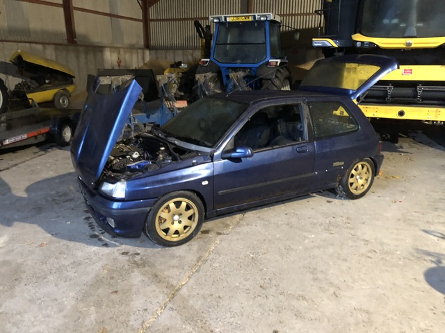

Yeah! I had been looking at it for a long time! I certainly did not pay the asking price for it.

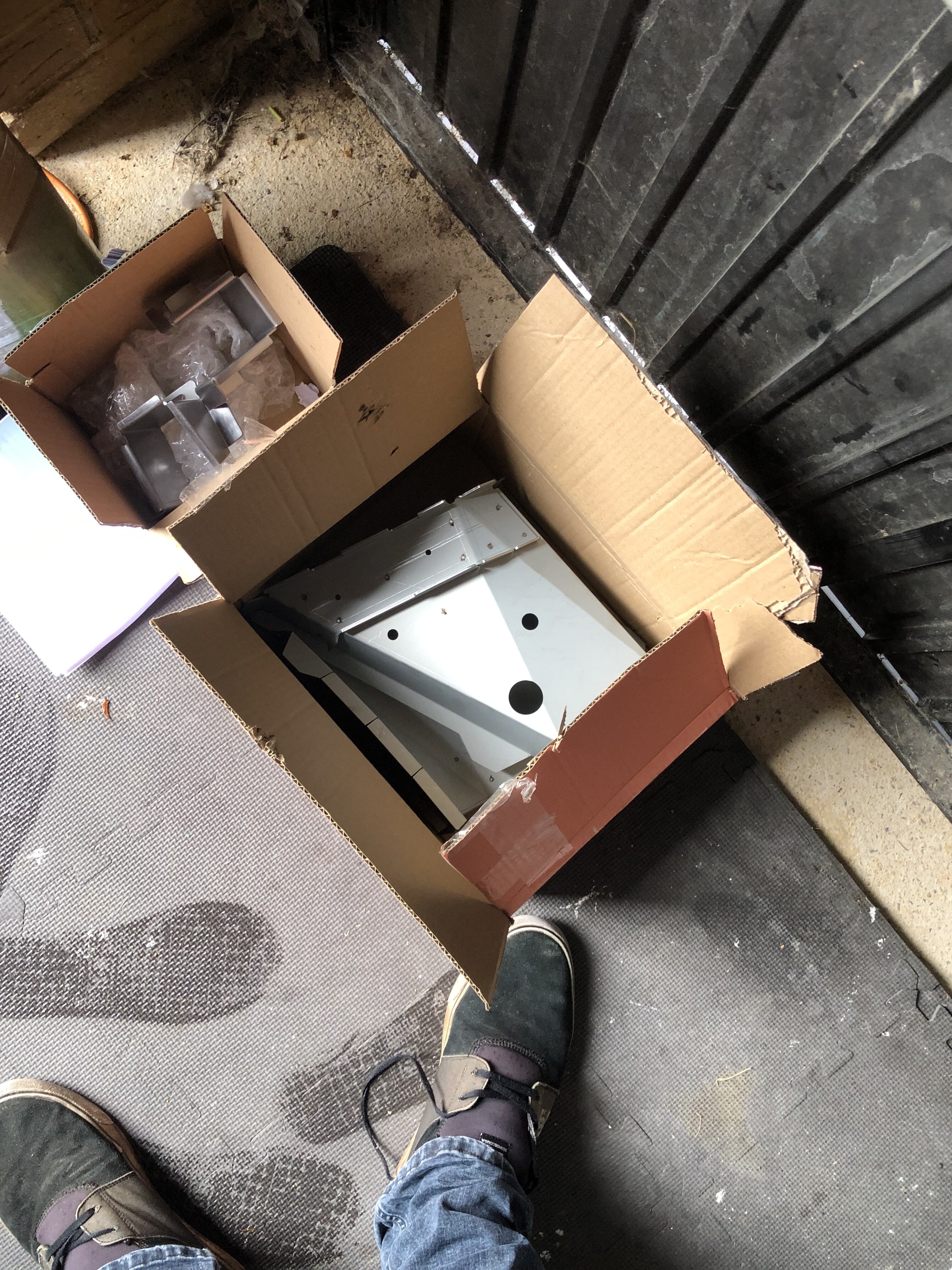

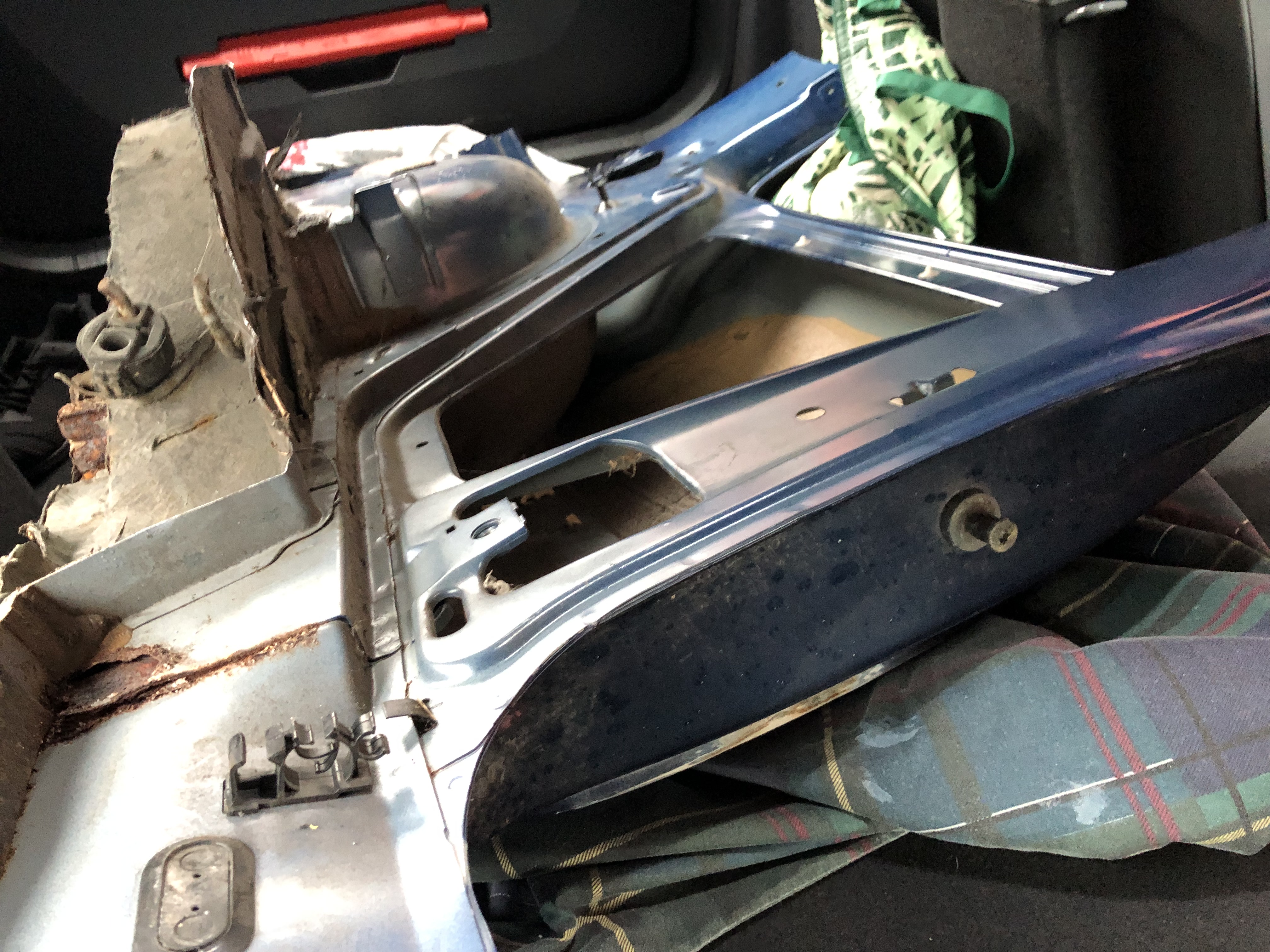

Picking up a passenger rear quarter on Sunday! 4 hour drive from Wiltshire to Liverpool so that will be fun!

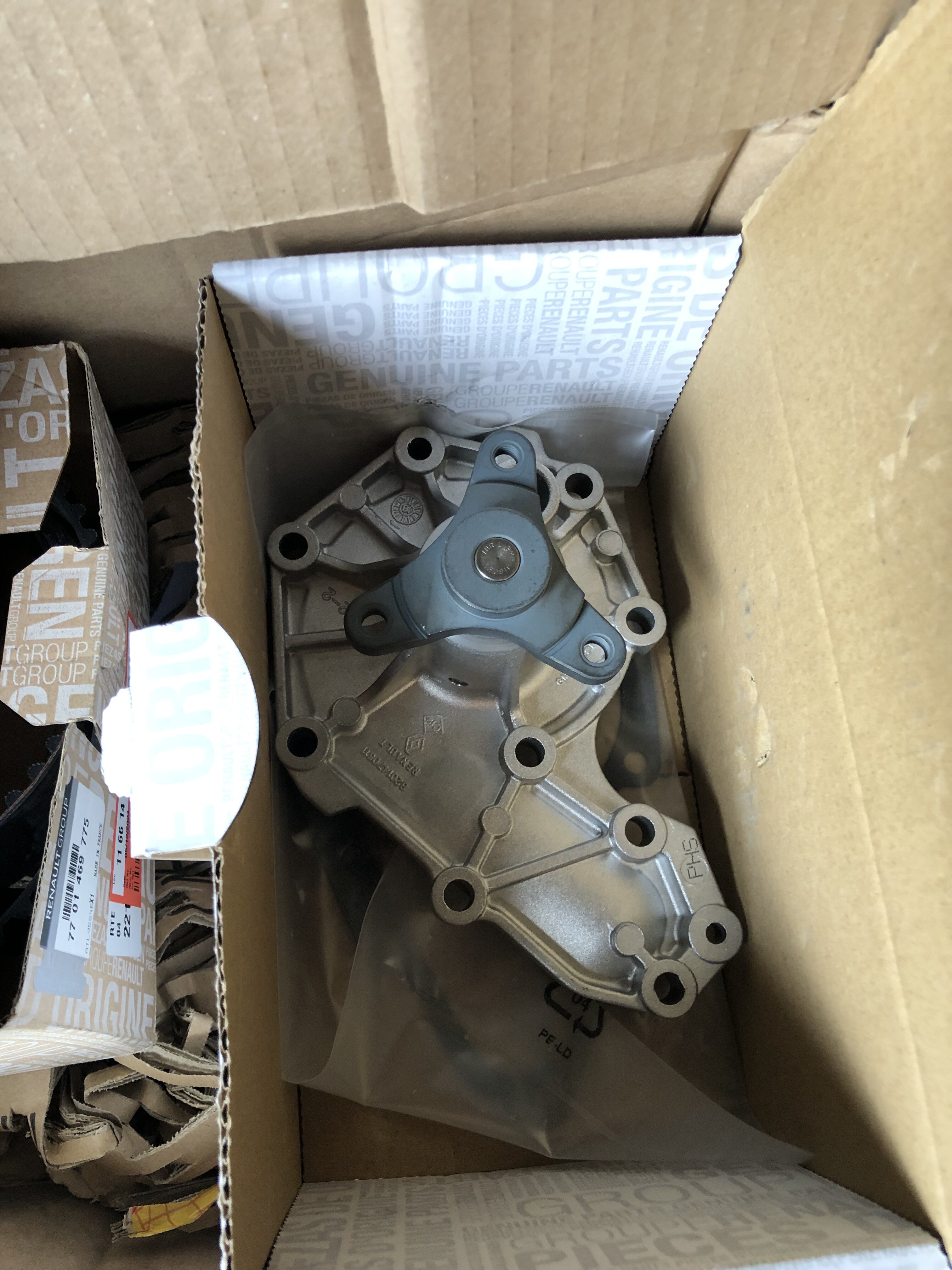

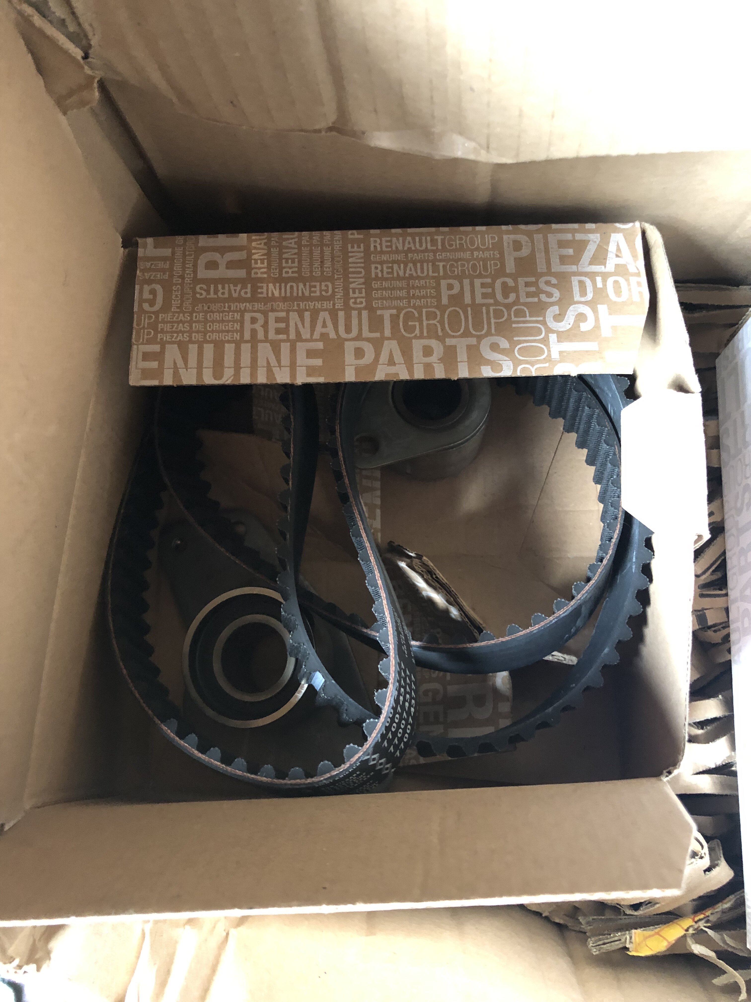

Today new Cambelt kit and water pump delivered!

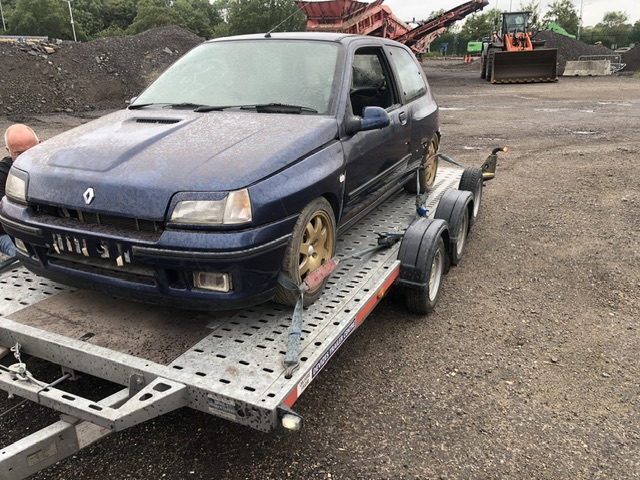

Pick the car up next Sunday. So another long day, with a journey from Wiltshire to East Sussex! It is closer to Belgium than my house!
Safely landed in its new home! 400 miles and a lot of different weather it has finally arrived!
Now the hard work of trying to get it moving. Then I will start to get the rot cut out!

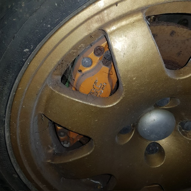

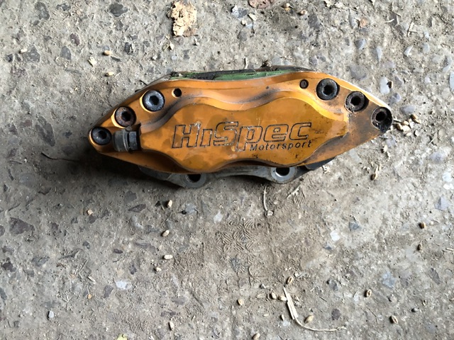

Also anyone have any idea on the brakes this has on it?
Bloody big callipers in there. Will be swapping them out the original items so not sure if the callipers would be of use to any one when they do finally come off?

It's a bit hard to tell but they might be bigger discs as well, standard size is 259mm and I think there were 4 different size discs available with the Hi-Spec caliper kits back in the day so measuring those discs on it will be useful info for selling the calipers
Personally- things like brakes I’d be keeping. It’s a proper kit and not a home made contraption.
No harm in venturing off OEM with stuff like that, they won’t hurt values of keeping it original.
So I have been thinking about this most of the day, and contemplating going down an OEM plus route. Taking gez 172s comments on board. I am never selling the car so value does not bother me in the slightest. Although if s**t ever hits the fan in the future it may come in handy.

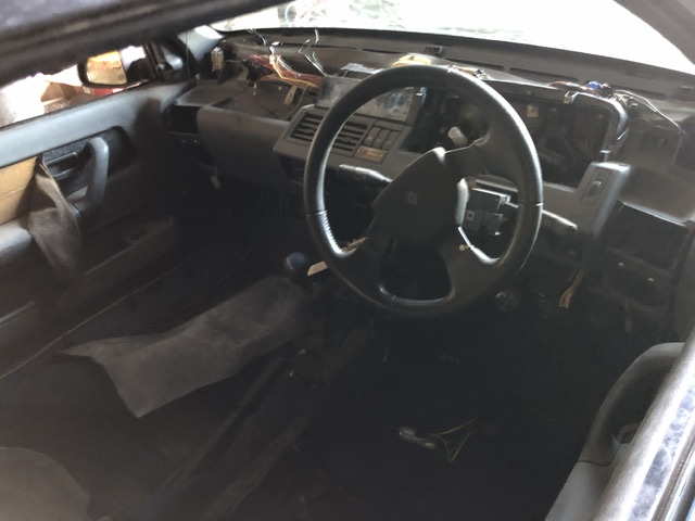

So first stumbling block, cannot locate the immobiliser anywhere. Dash is in bits but it is an elusive little bugger! All dash lights come on and can hear relays clicking but nothing.
So put the battery straight onto the starter motor, which does turn it but does not engage so we have a duff starter. Ordered a new one.
Not the best start but hopefully have the new part by the weekend so can fit and try and wake the damn thing up! Then time to tear it apart ready for rust removal.
Oh and have seen that the car is also on coil overs. Cannot see which ones but will give them a clean and see what’s what
There is an aftermarket one on the car. I have found the alarm siren/speaker but nothing else so far

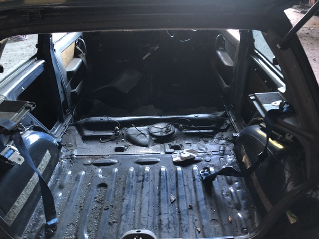

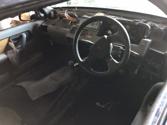

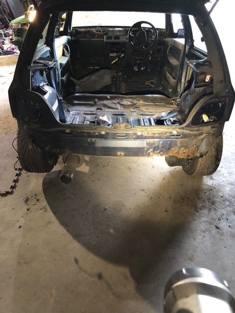

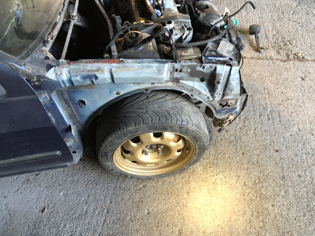

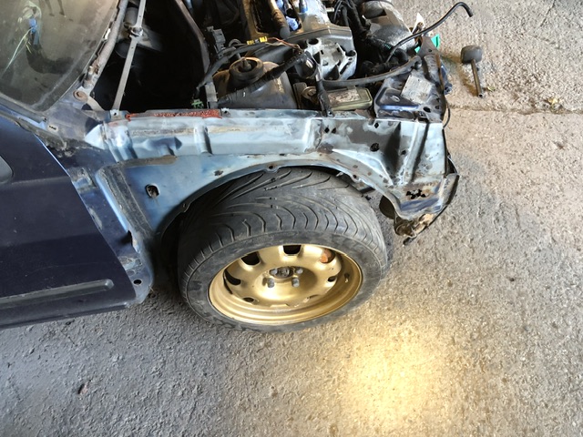

So the tear down has begun fully today. 2 days of stripping out the interior and pulling the front end off. All this in preparation for removing the engine next weekend!
And then a very large pile of bits
It does now look a tad sorry for itself but least I can start to see more of what I am dealing with.

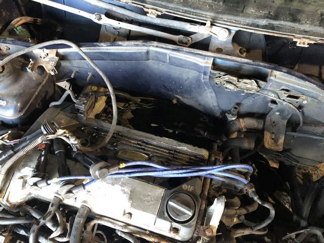

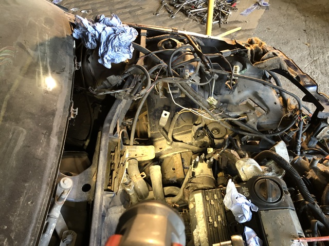

Radiator removed and removing all electrical connectors in preparation for engine removal.
Few pictures from the weekend just gone.
Looks like Stuart little was evicted!

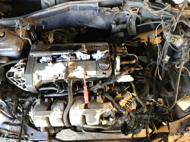

Only a few more connections into the block. Big issue we have found is we have been unable to turn the engine over by hand. We have poured some lubing concoction into the cylinders to see if we can free it up. Engine is going to be torn down but do want to have it turn over.

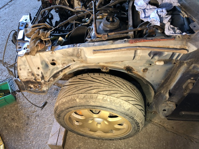

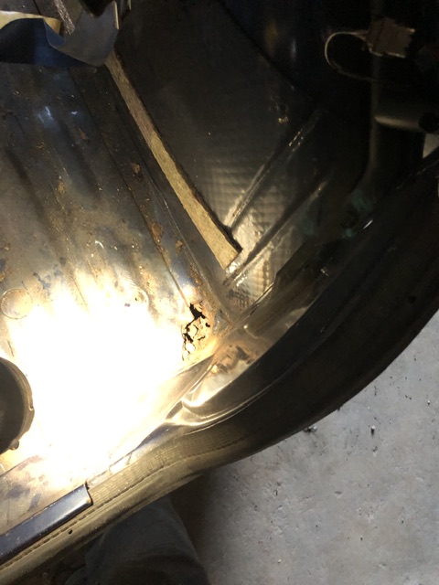

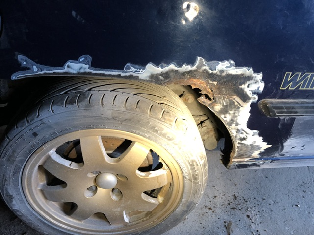

Took a wire brush to the front to tidy a few bits up. Just waiting on some rust converter for some spaces while shall be taking a Dremel to other parts to remover the worse parts.

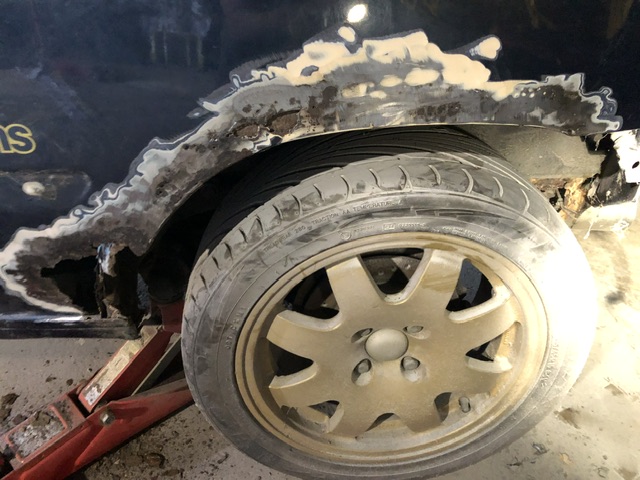

Also taken paint off the rear arches to see the extent of the rust. Can see the remnants of an old repair on the drivers side.

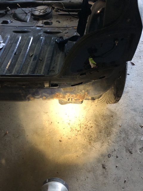

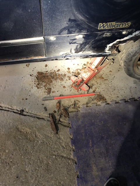

Rear bumper was a pig to remove. Ended up having to cut through the bolt on the right to finally remove. Looks to be a little work to do behind there
Also should really stop poking the sills. They are really bad on the near side!!

Have you removed the alternator belt to try turning it over? Only ask as I've seen seized up alternators, pas pumps and the tensioner pulley stopping them being turned over by hand.
Another thing I'd do is remove the rocker cover and the distributor then pour some oil all over the cams & lifters as they'll be bone dry with it being sat for so long
Not taken the belts off so May look at that as the alternator does look pretty bad. Shall see how things look this weekend but the next step will no doubt be removing the rocker to investigate further.

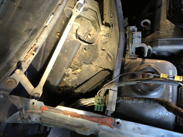

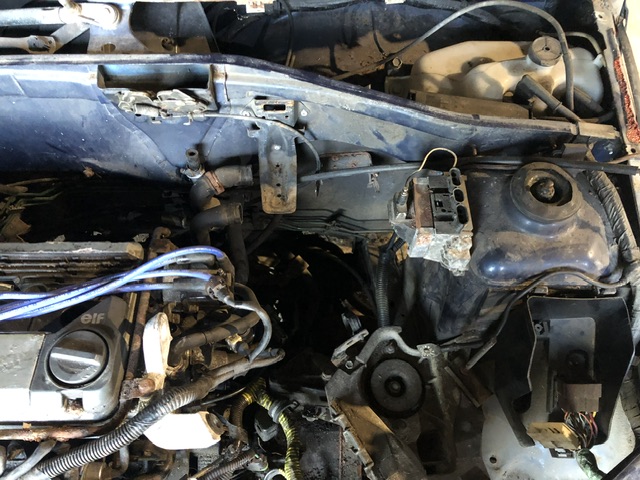

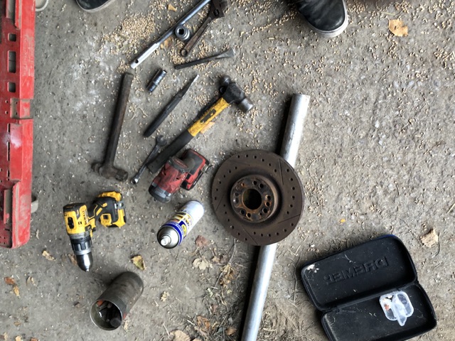

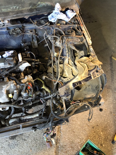

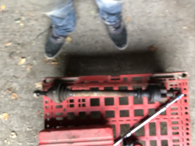

Pretty dull update this evening. Due to having to drill out rounded and sheered bolts. Wiring loom is pretty much off the engine. Just two more connectors, 1 being the lambda I think and the second is at the front below the inlet manifold. Cannot get my fat fingers in there.
Other than that brake disc and calliper off the drivers side along with the driveshaft are now off. Next weekend will get the other side done and then hopefully the engine will be pulled.
On a slightly less happy note cylinder 1 is still bathing in ATF so has not drained through. Still not been able to turn the damn thing over.

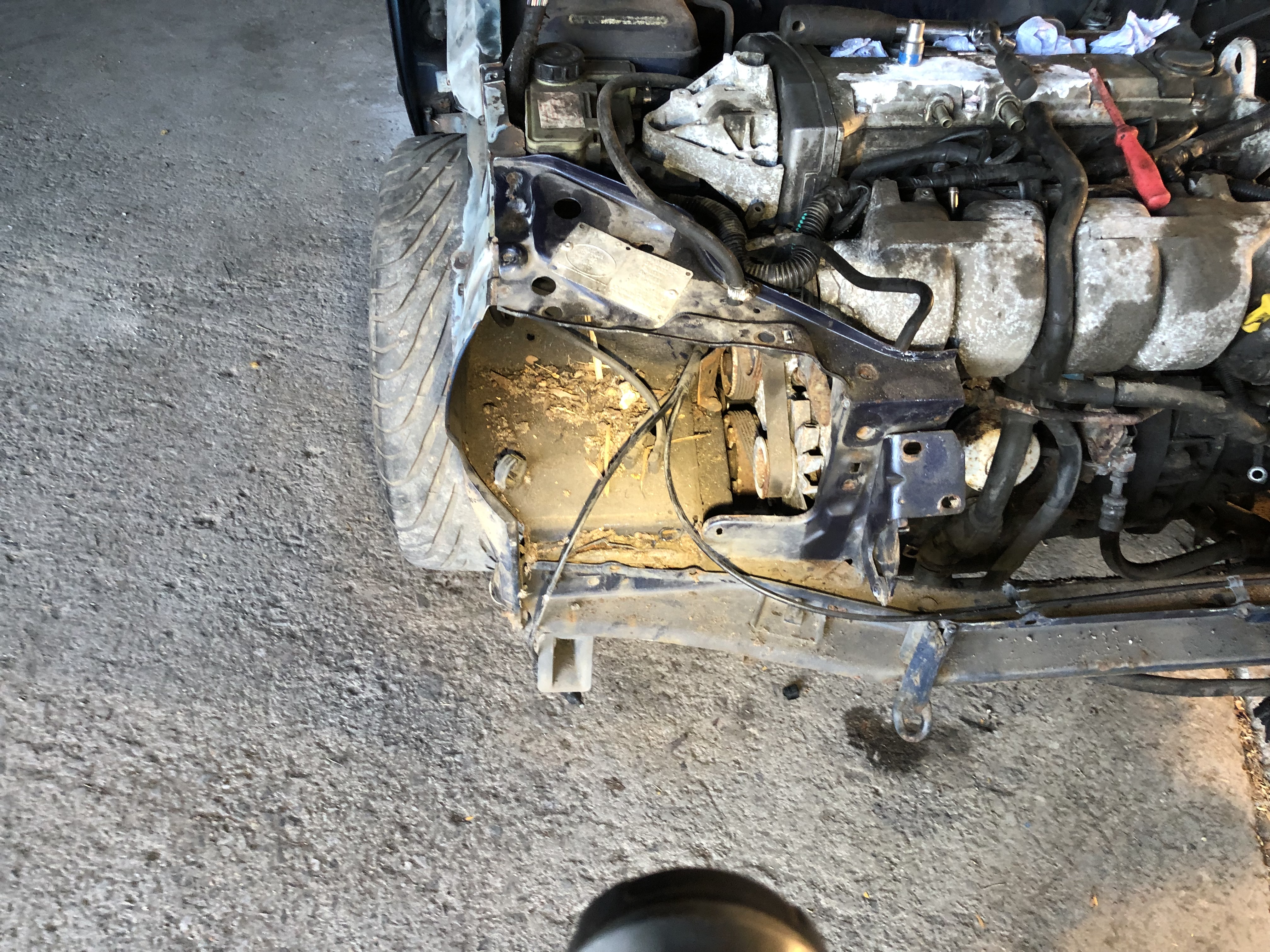

I have removed some bad rust from the passenger side front inner arch (forgot to get a picture). Picked up some sheet metal, etch primer and rust converter. Also ordered a new pneumatic air rotary cutter as I am hoping this will make cutting a lot easier. Will also look to pick up a pressing and hole punch tool for when I need to get properly into the metal work.
Kinda wish I'd seen this thread sooner to tell you that it's possible to remove the engine with the loom still attached to it 🫣
It's just 2 plugs in the relay box, rad/fan connections and a couple of earth connections to undo. The wiring bundle for the ecu just needs to be unclipped from the car and the whole lot including the ecu can then sit on top of the engine
