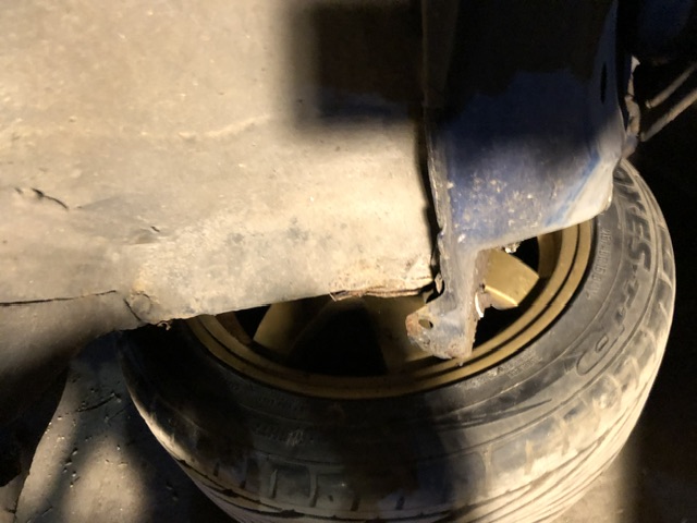

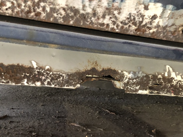

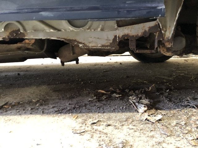

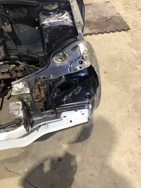

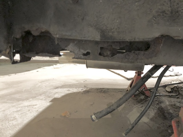

Have also found a large hole under the windscreen which I will need to fix. Spotted when I too the washer bottle out and saw a pile of rust sat there. So an extra hole to fix……..

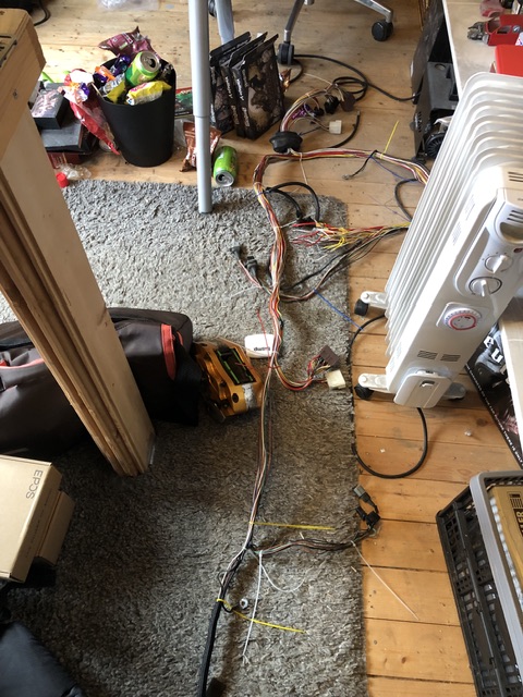

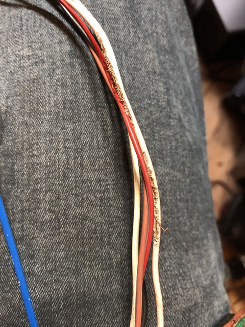

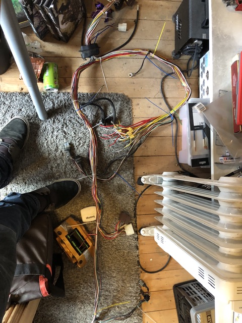

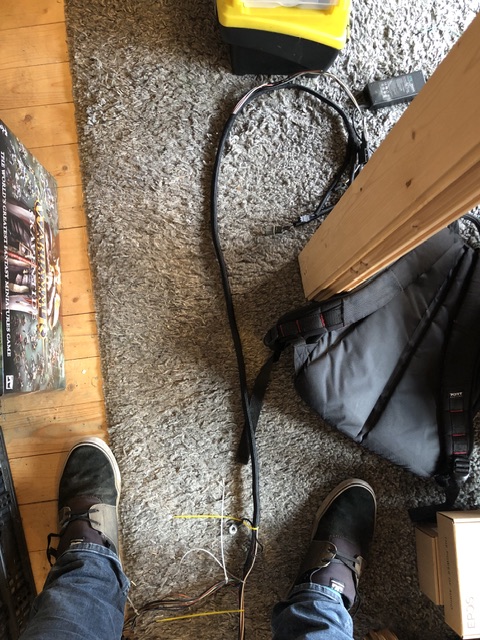

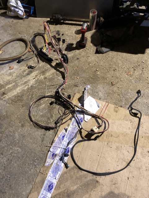

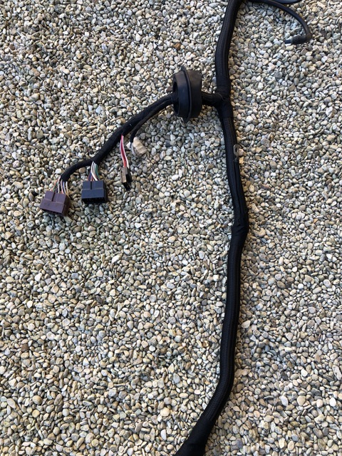

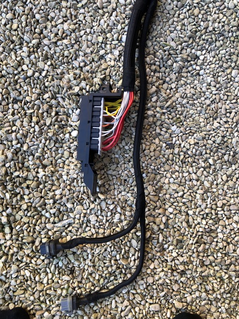

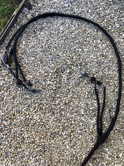

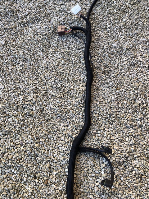

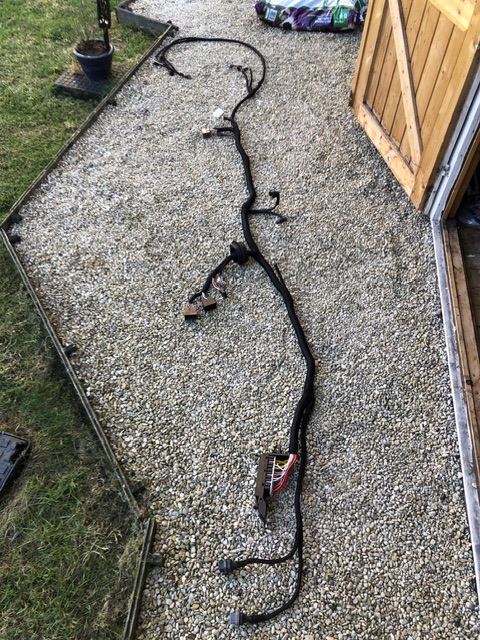

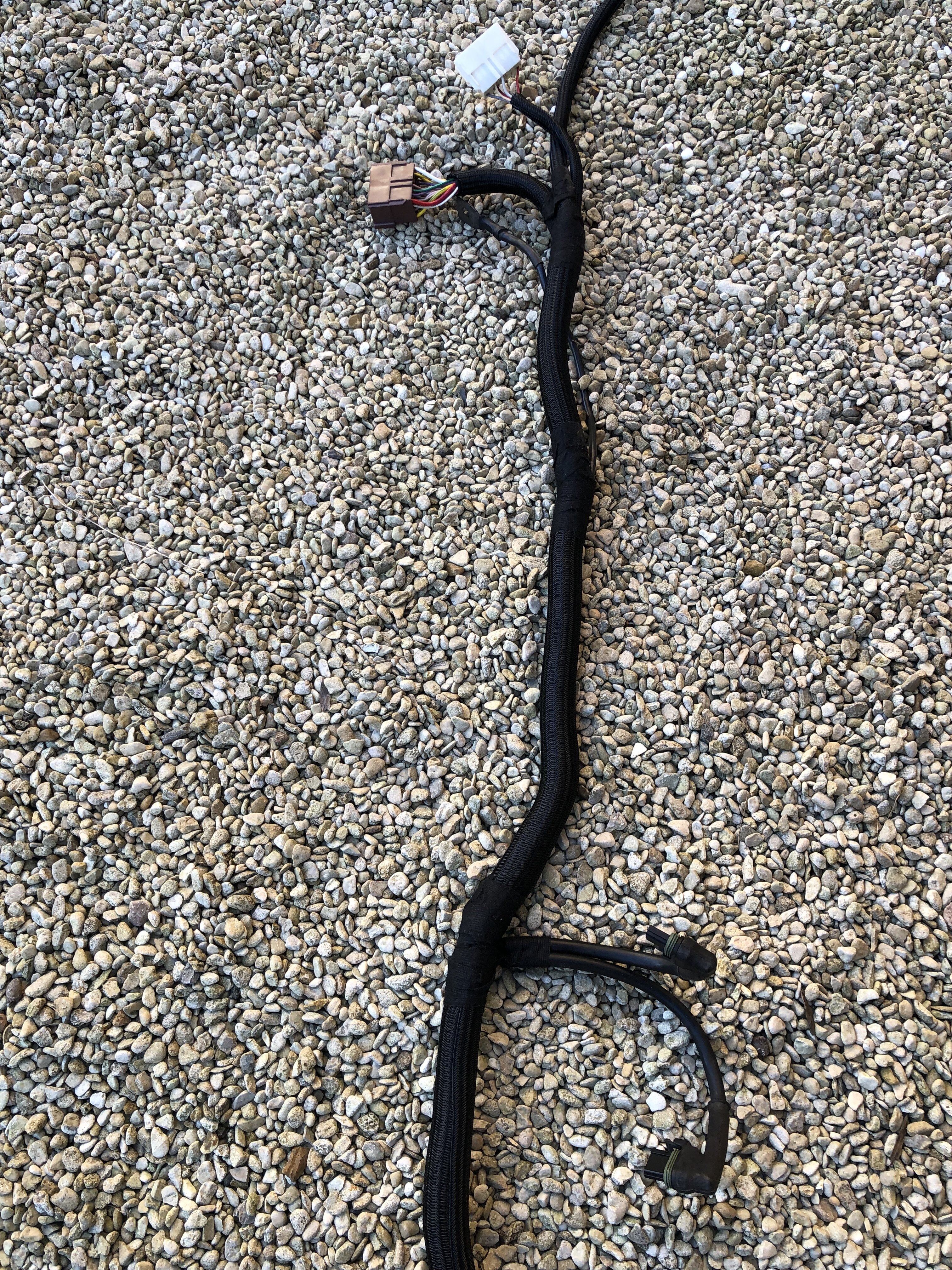

So been looking at tidying the loom I brought home.
Looks like Stuart Little was peckish.
Started to retake clean it up. Also gave me a chance to cut out the knawed parts and solder in new pieces.
Still a fair amount to do.
Excuse the mess I am a slob.
Also removed all connections from the fuse box to remove the mild corrosion from the connectors and to also clean the fuse box.

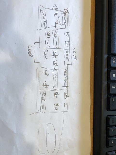

Dodgy diagram of wiring positions.

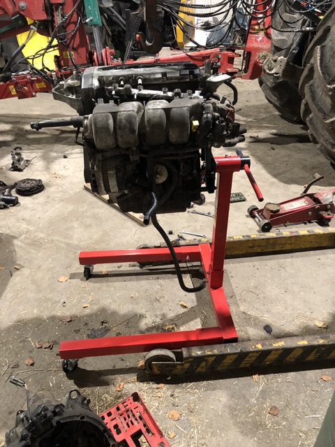

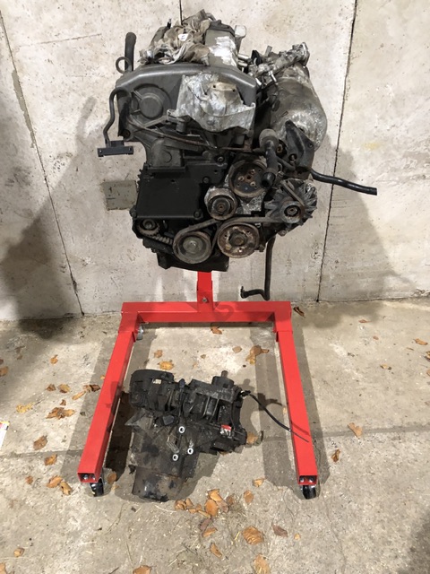

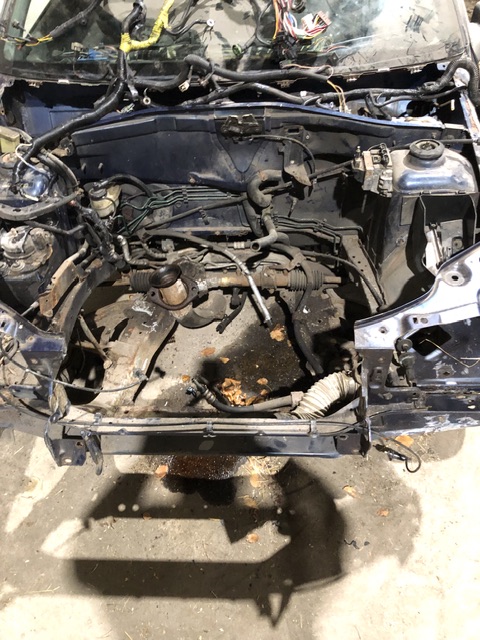

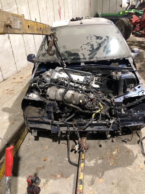

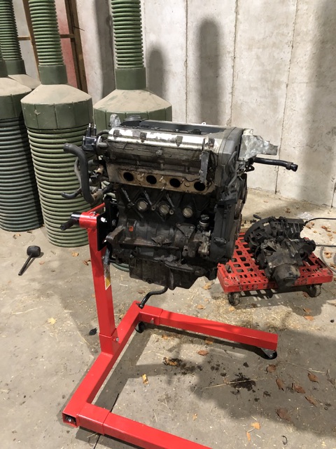

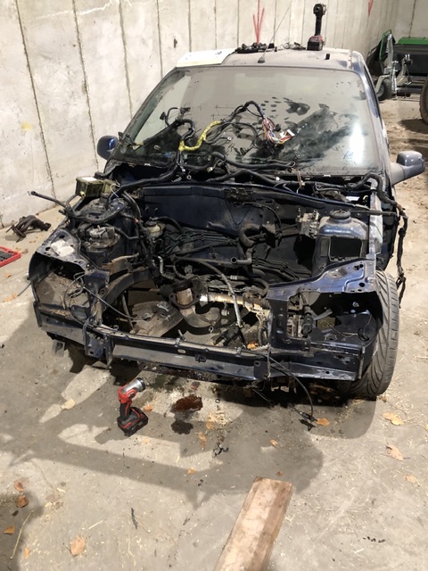

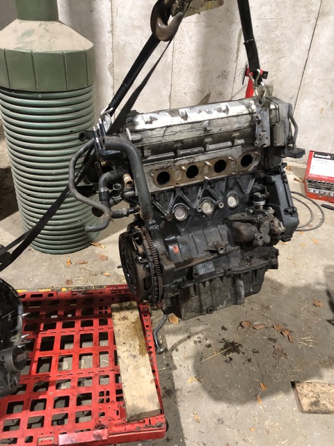

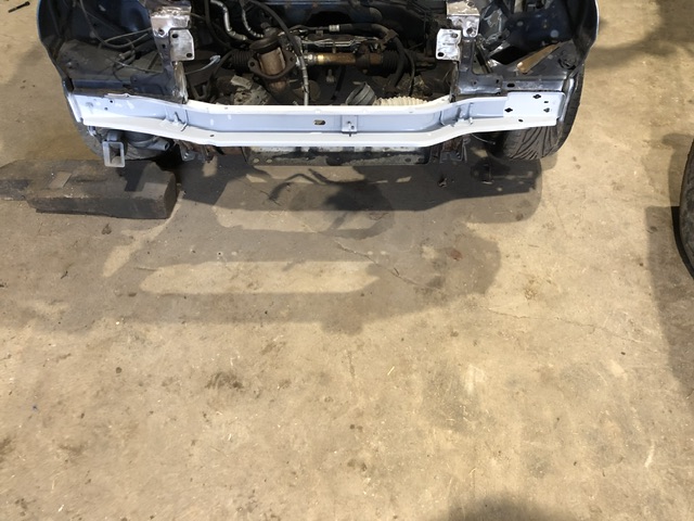

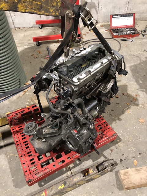

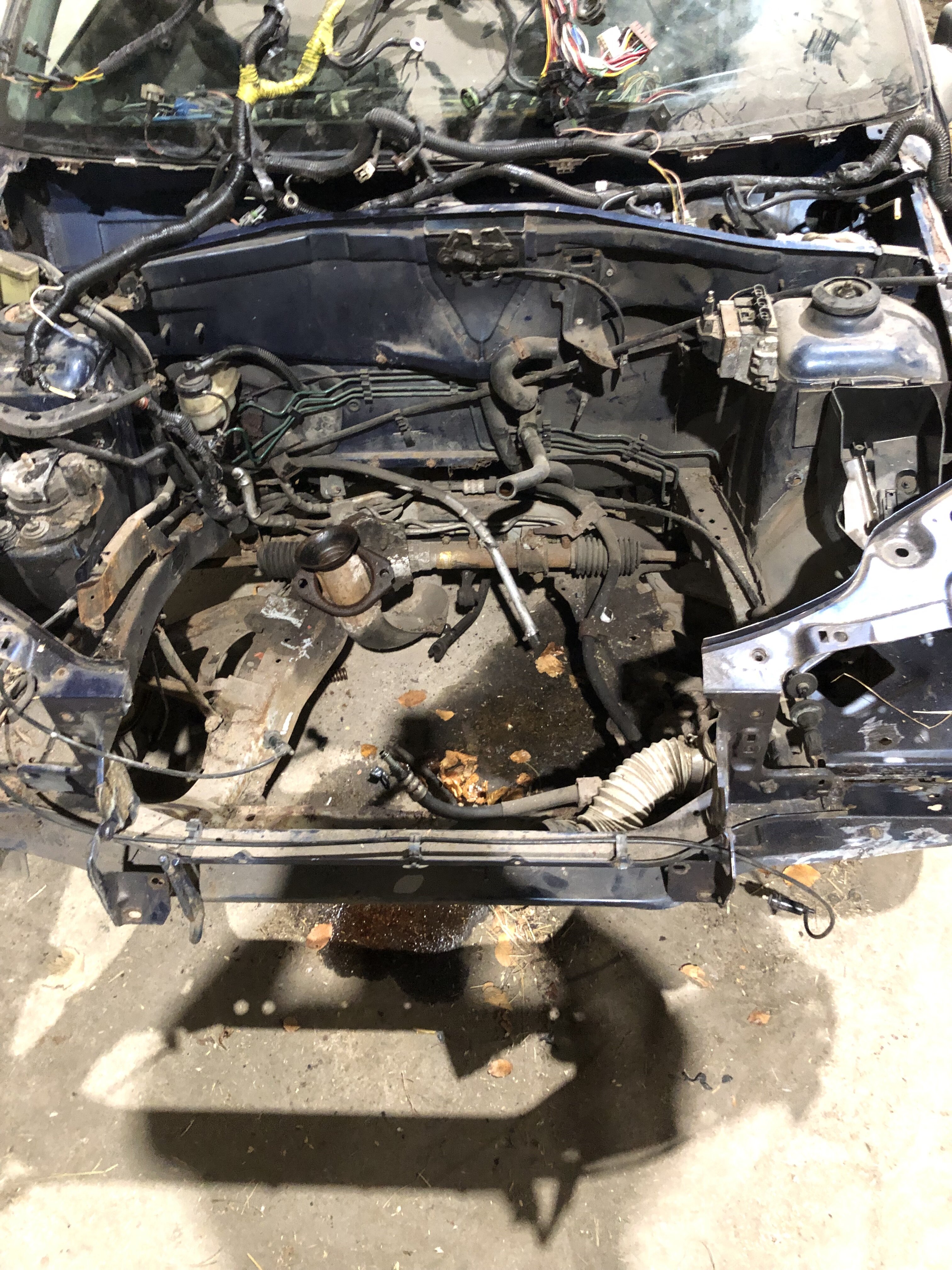

So been a few weeks but today was the day the engine finally came out!

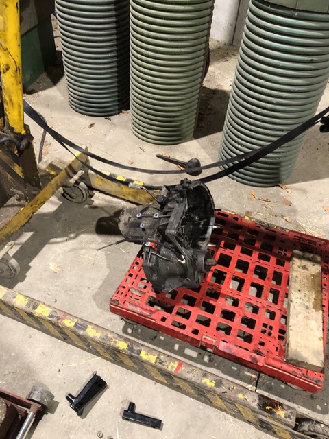

The gearbox was not the easiest thing to remove due to 2 annoying nuts underneath, but got there in the end!
And then mounted on the new toy!

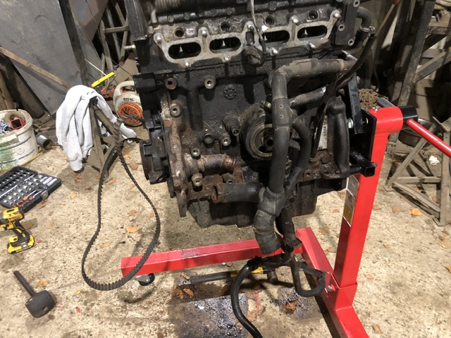

Strip down of the engine to start next weekend! Plus will need to jet wash the engine bay now as well too see what I shall be dealing with in there, although at first glance it does not too bad.

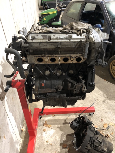

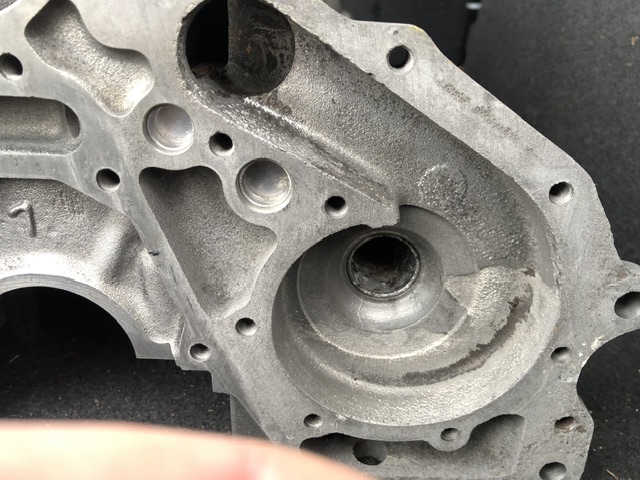

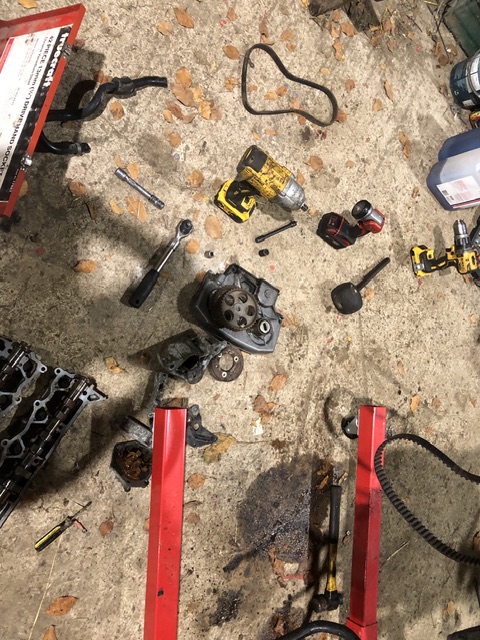

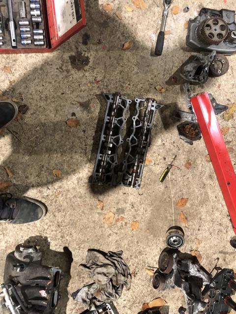

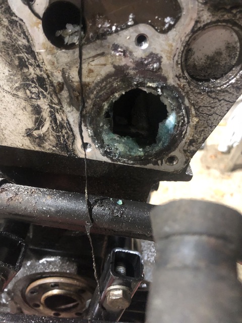

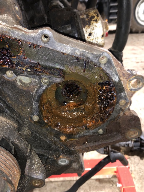

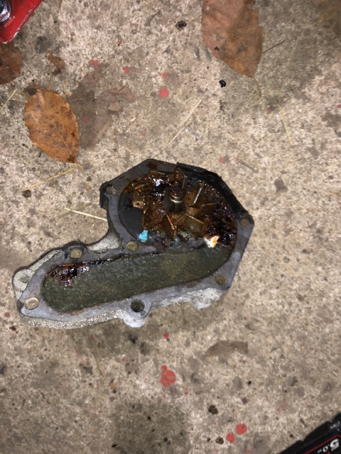

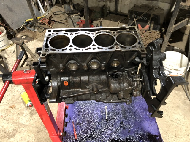

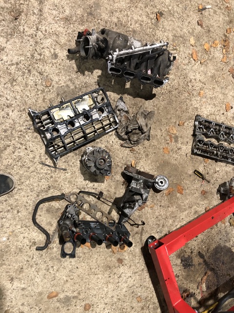

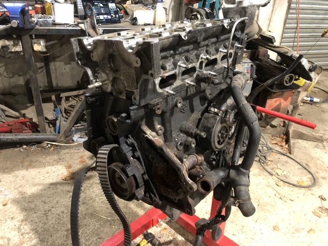

Strip down of the engine started. Not liking the state of the water pump nor thermostat housing!
This is not looking to great.
Thermostat housing.
I am a tad messy!

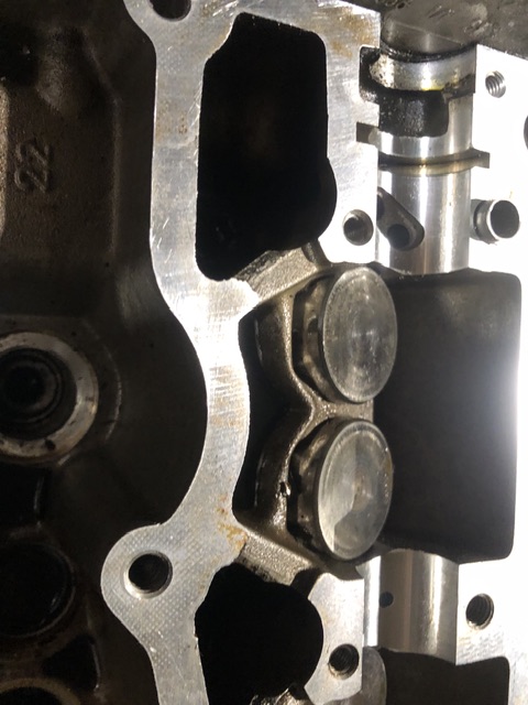

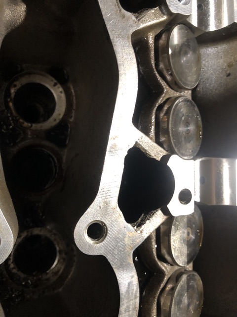

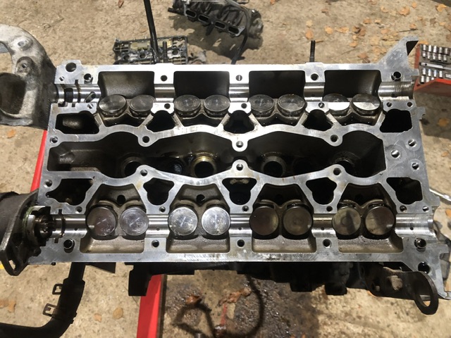

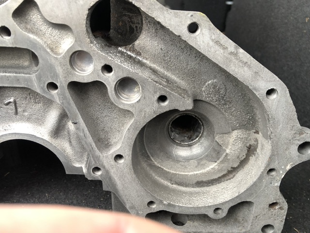

Also not sure if this looks right.
The step down between the tappets. Cannot find a picture of a head anywhere to see if this is normal.

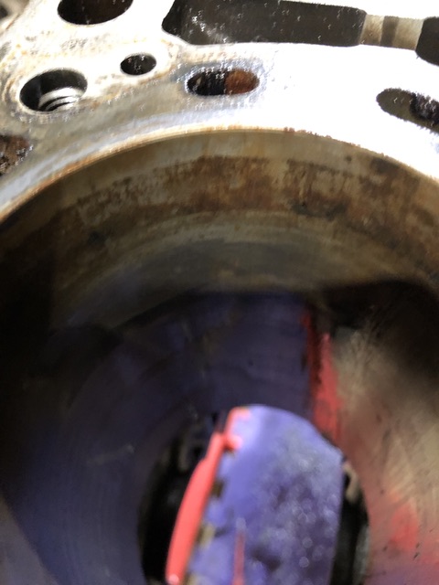

So next week, remove head bolts (going to need the Hulk to help I think!). Will then be able to see the state of the pistons!!

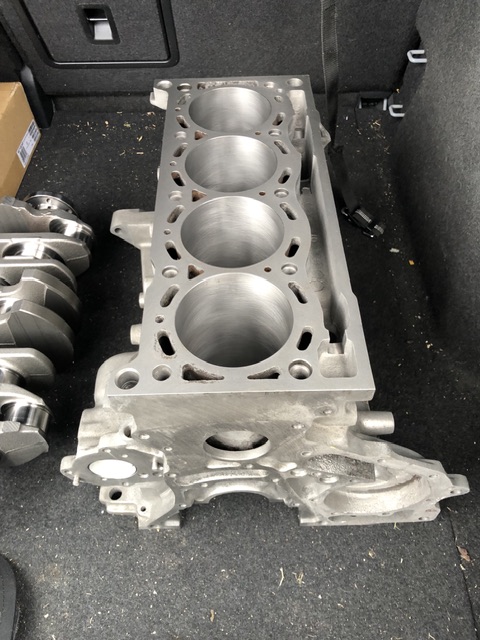

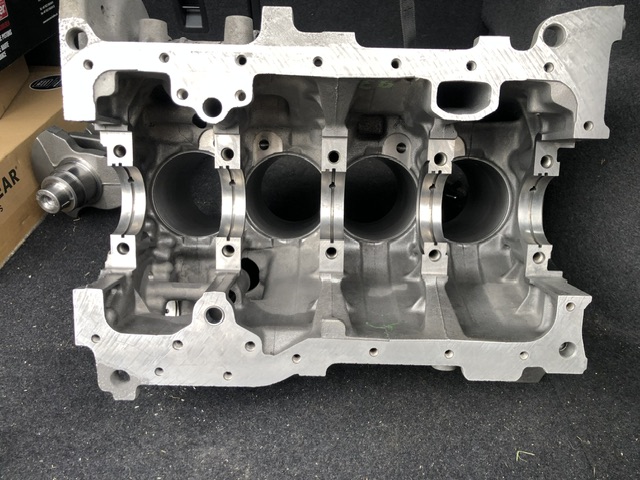

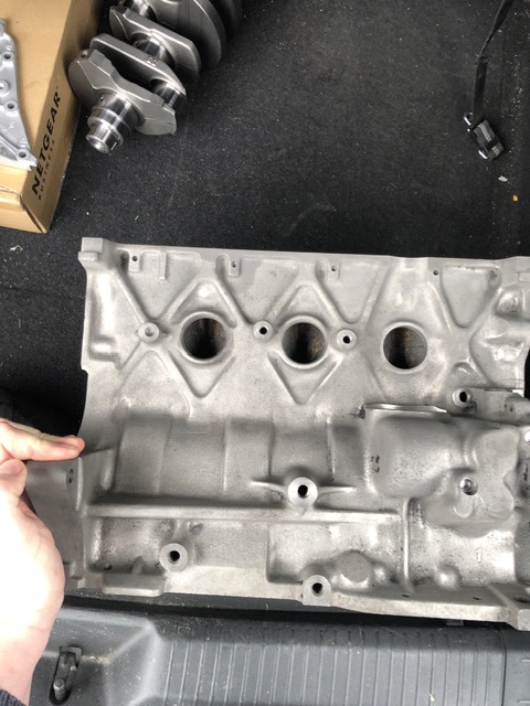

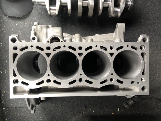

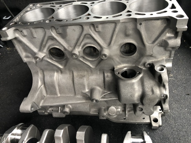

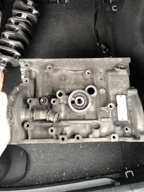

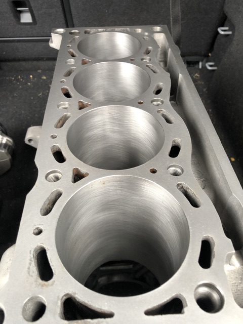

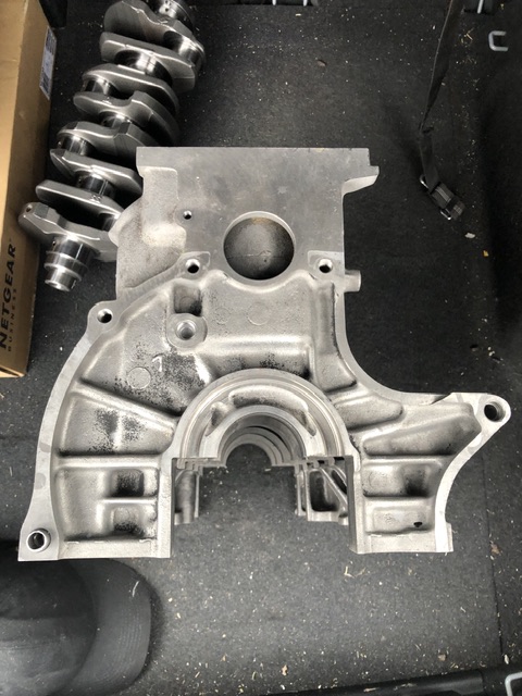

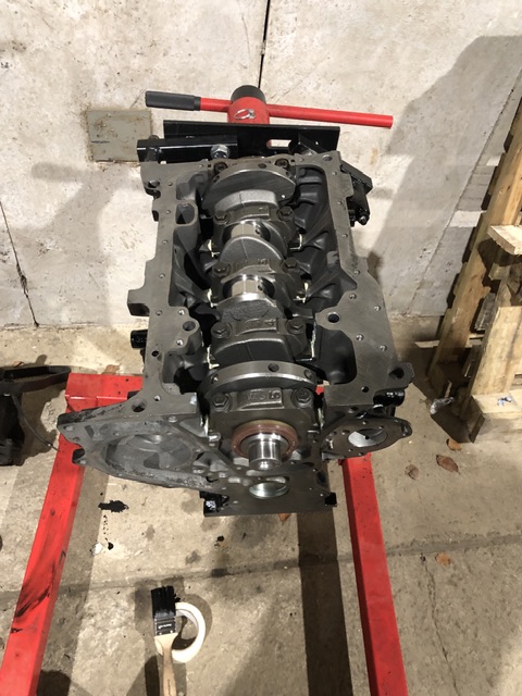

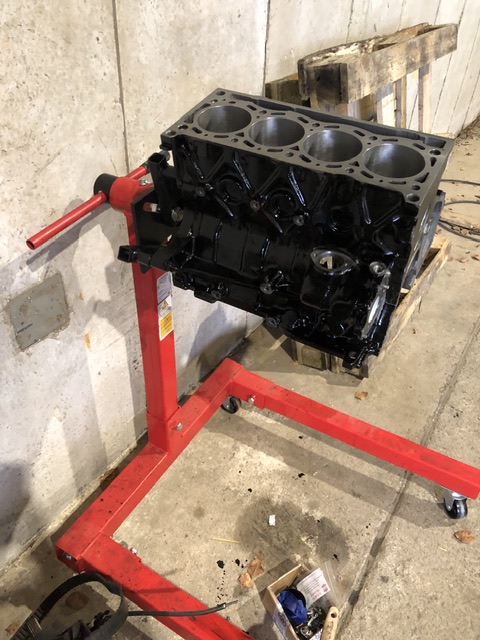

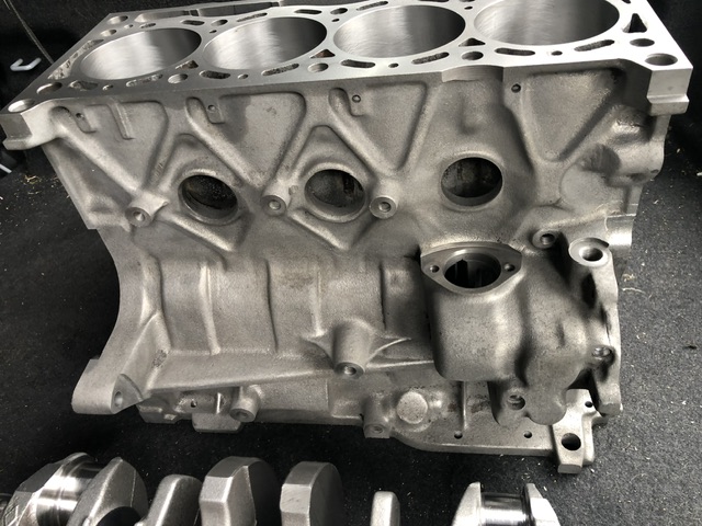

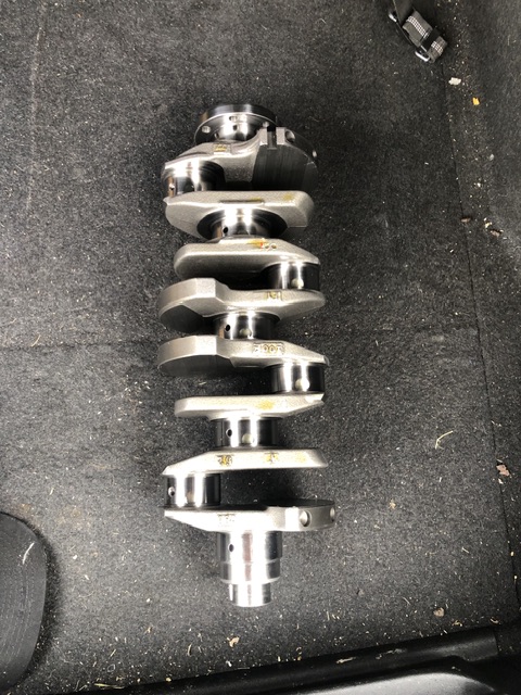

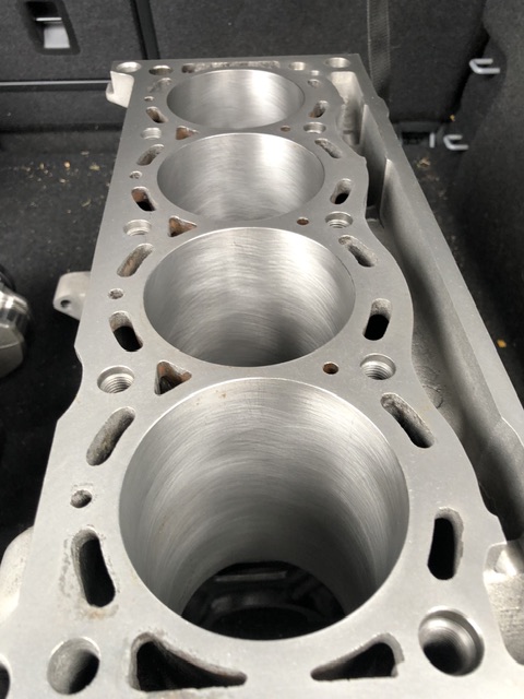

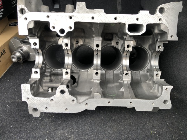

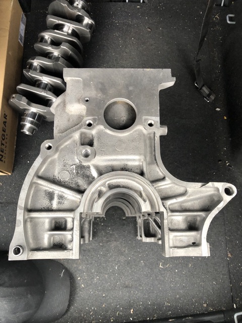

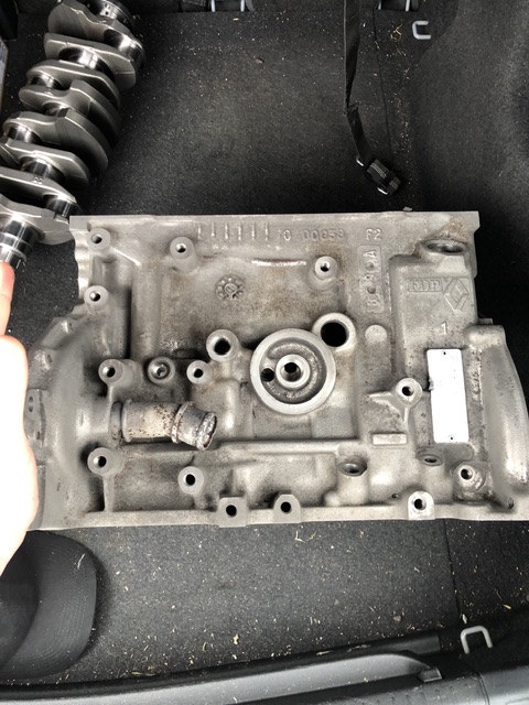

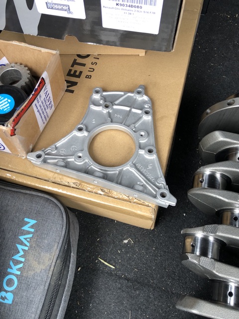

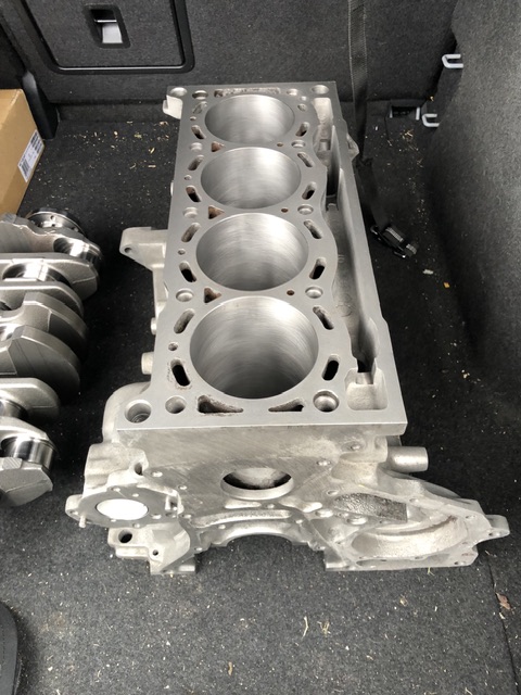

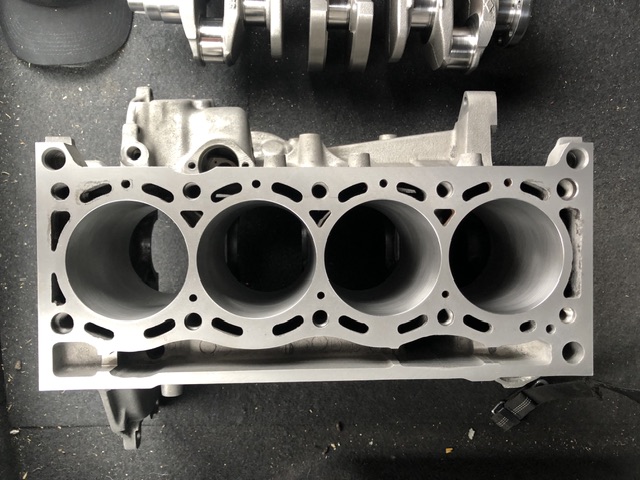

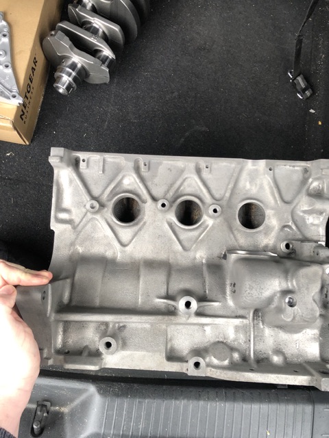

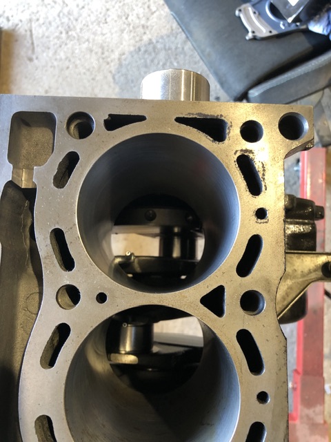

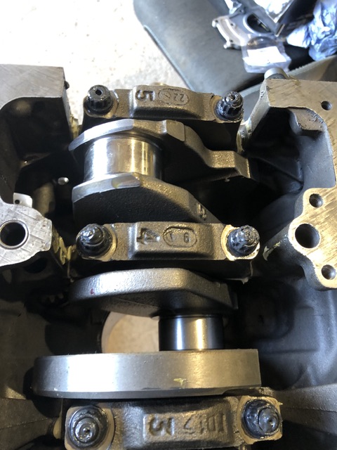

Well it has been a while and the bottom end of the engine has been away being cleaned and bored. It looks so much better now.

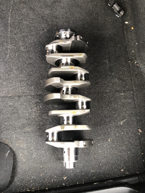

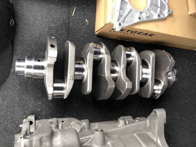

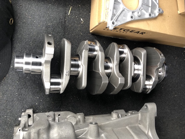

Had the crank cleaned up and polished as well.

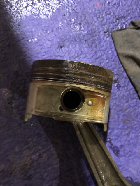

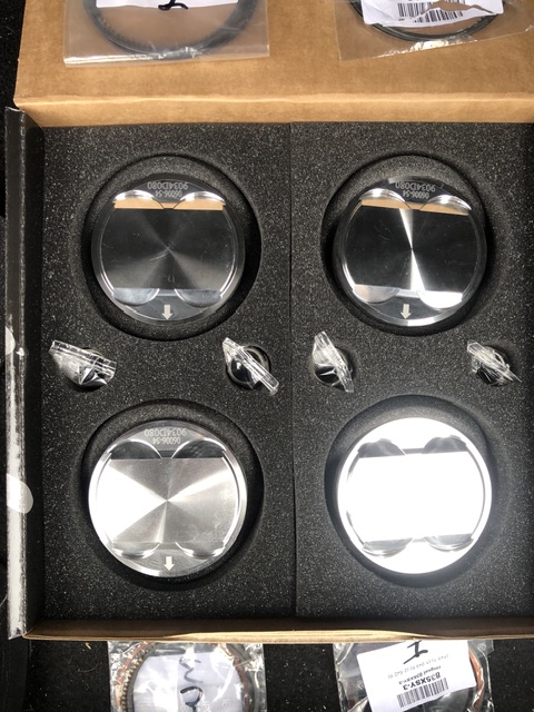

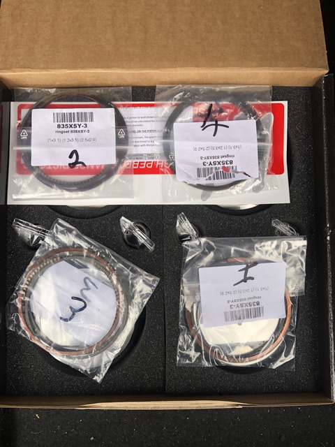

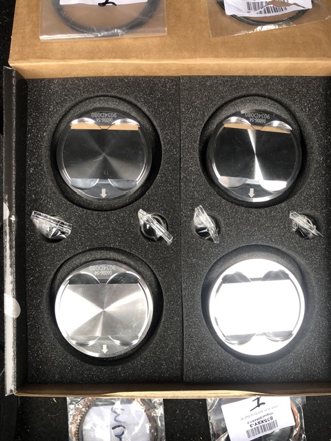

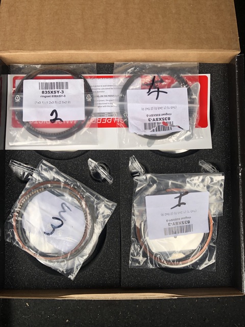

Also new pistons purchased due to the state of the old ones and the reboring.
Just waiting for bearings to arrive for the crank to start the rebuild.

What cleaning process was used on the block? The deck looks very Matt/satin finish, doesn't look like it's been refaced?
Also. Never seen a F7R crank before. Is it standard or from a later model?
The Clio F7R 700 crank is from the F8Q 1.9 diesel engine
The later Mégane F7R 714 & the RS Spider F7R 712 engines have the F9Q diesel crank which is the same as the 1*2 F4R
Then you've got the early Mégane F7R 710 but I can't remember exactly what that crank that used but was different to all the others
Interesting info! Thanks for that.
Read a few threads on the forum regarding cranks. Typically, alot of contradictory information.
From my understanding ph1 cranks are the heaviest of the 1*2 gen (haven't seen photos).
Ph2 172 is the lightest (lesser counter weights).
182 increases the counter weights.
With 197/200's having the best counter weight package (best for high revs).
From the pictures if seen. This F7R crank looks similar to a 182 crank.
It's not the same as a 182 crank as it doesn't have the sprocket for the chain driven oil pump on it.
It's only the later versions of the F7R that had the chain driven oil pump
Oh, true! Didn't notice that.
The more you know.
Thanks for clearing that up.
Counter weight design just seemed similar to my untrained eye.

That cleaning of the block nearly makes it look like aluminium!
Has it been coated with something after it was cleaned?
So the block was acid dipped and then caustic treated. Considering the state of it before hand it looks like a new block. I don’t know exactly how the caustic side works but it apparently helps with rust removal. Also helps the prep to paint the block. It has been refaced as well. This was all done during the boring process.
The crank looks so good now as well. It seems a shame that it will all disappear under the bonnet and not really be seen again.

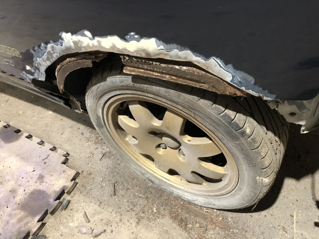

So been a while but here are some recent pics

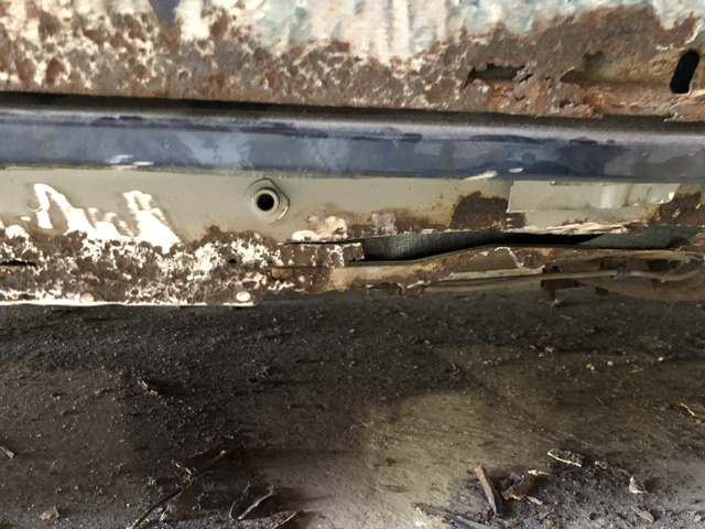

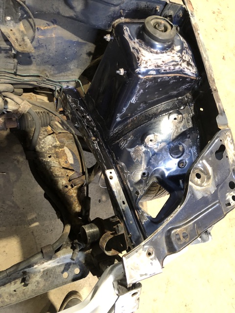

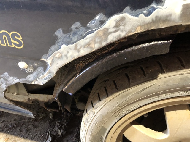

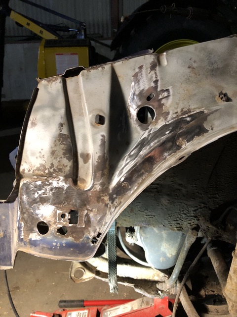

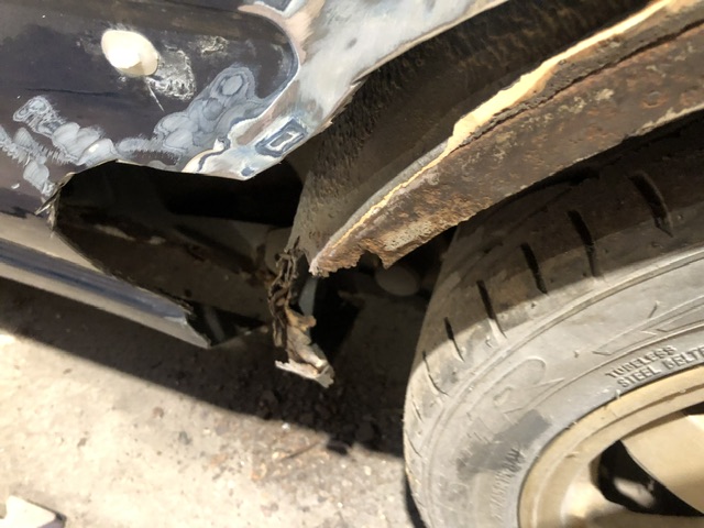

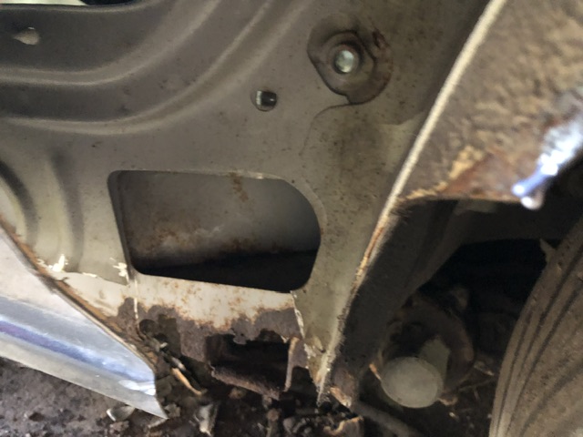

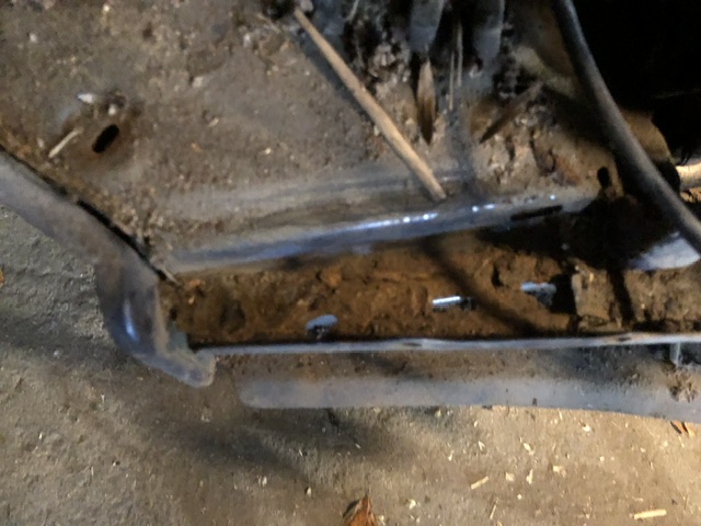

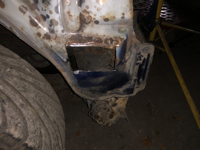

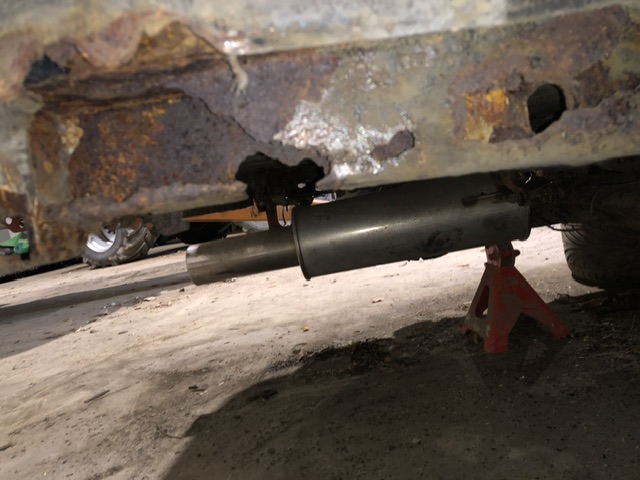

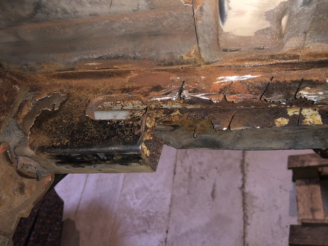

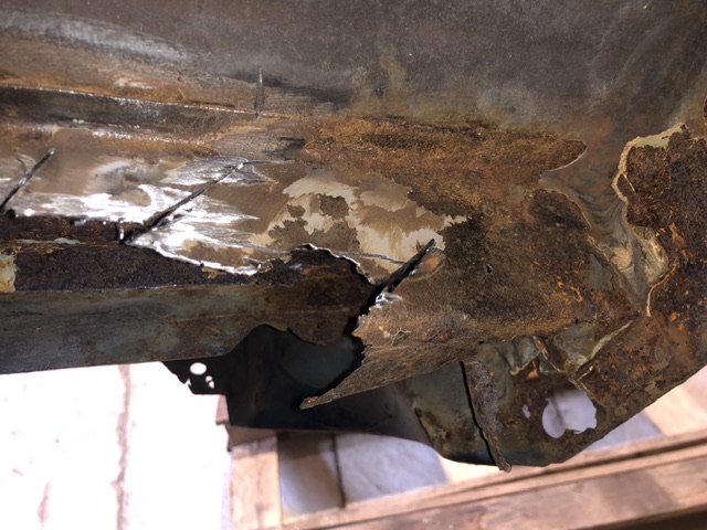

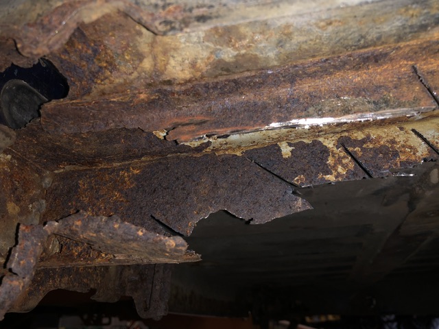

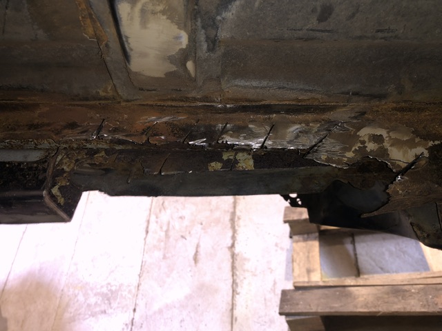

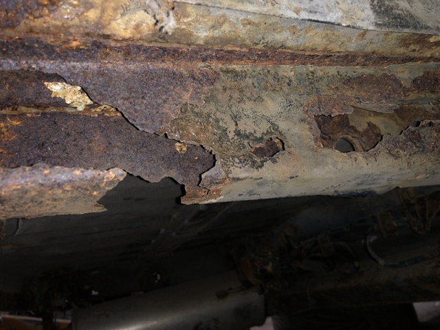

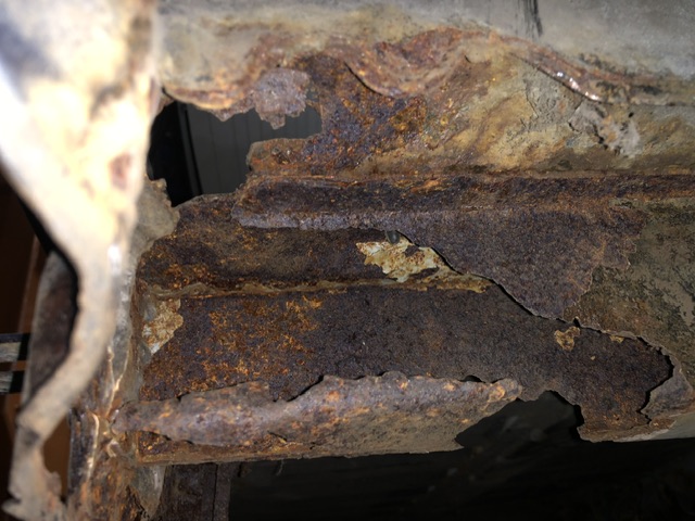

So glad I removed the auxiliary fuel tank as would never have seen the full extent of the rust in there!

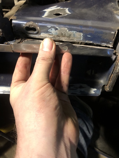

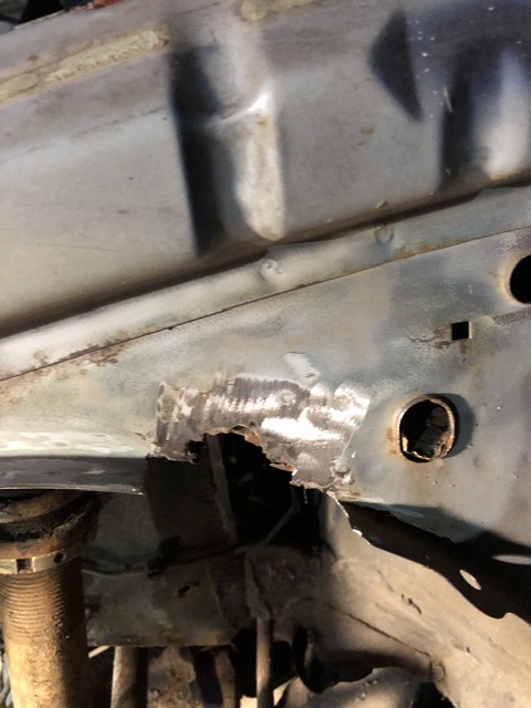

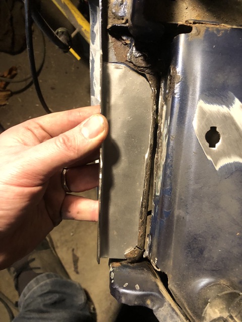

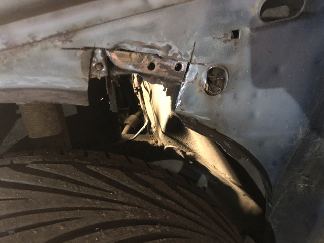

Starting to cut it out. Found some solid metal, but Road grime and masses of old mud has got up inside and rotted it from the inside out!

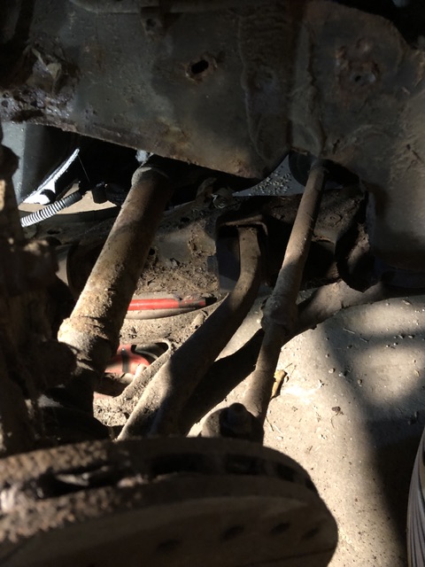

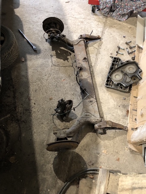

Got the rear subframe off as well which took 2 days which was a lot of fun!!
Also completed the first engine loom overhaul and it looks 100% better!!
Cover on the fuse box has been fully installed. Did not have it to hand when photos taken. All wires checked and repaired!

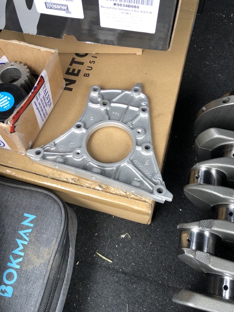

ARP bolts and con-rod bearings have now arrived so can now get these installed.

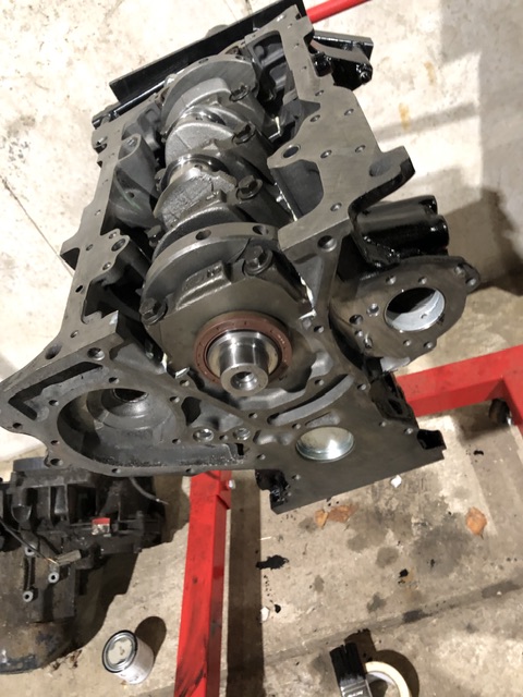

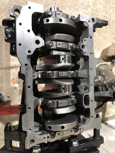

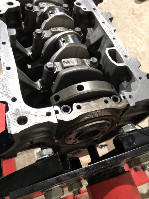

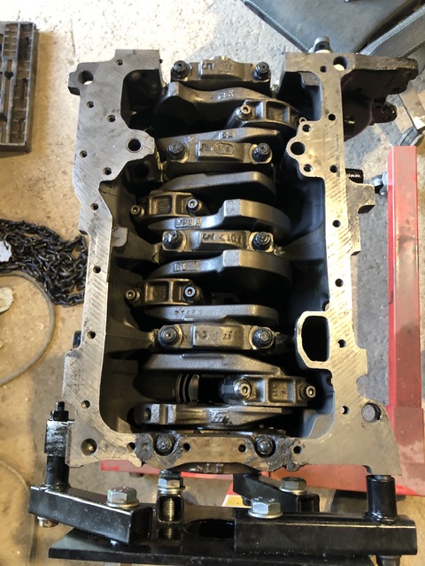

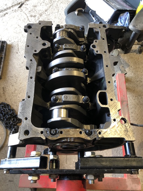

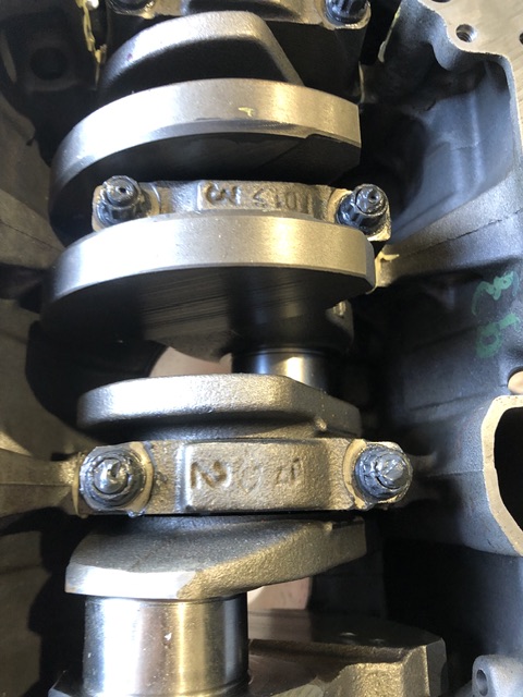

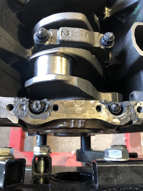

ARP studs fitted to the crank bearing caps. Now all torqued down.

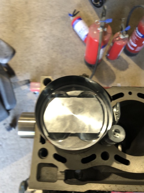

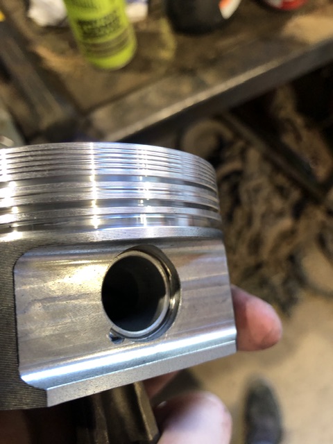

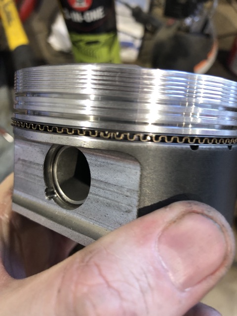

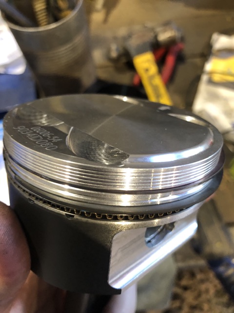

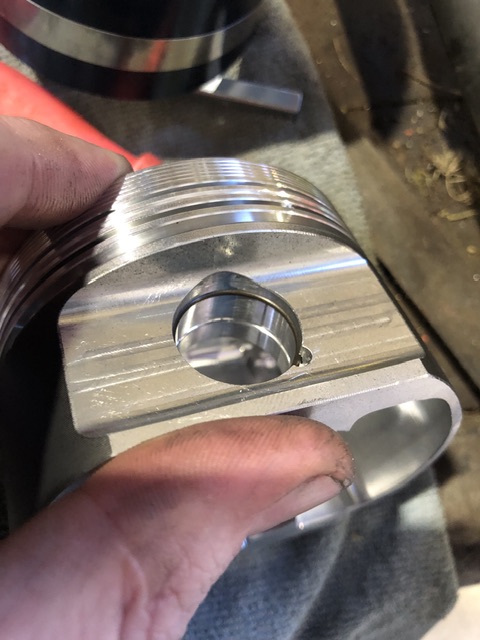

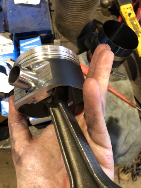

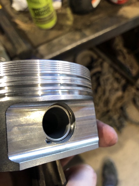

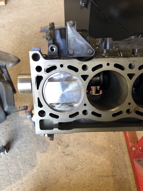

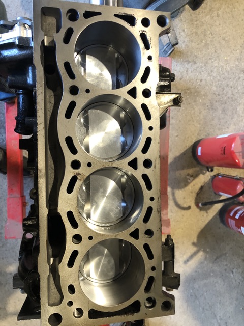

New pistons built up.
Those circlips are the hardest thing I have ever fitted!

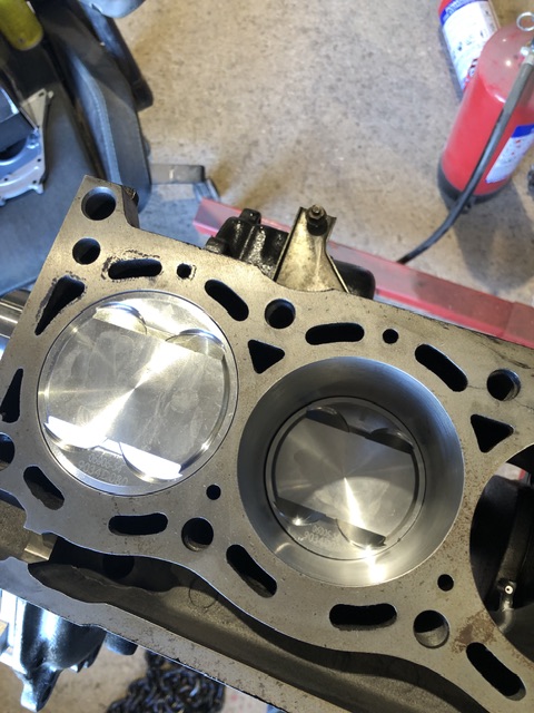

Then install
ACL big end bearings installed and then all clamped down with new ARP bolts and torqued to spec! Next up is oil pump, refit the sump and the bottom end is more or less done!

I’ve got to agree though, those oil rings are a proper f**k on. I spent ages trying to get them on. The first took forever and then I cracked it putting the piston in 🤦‍♂️.
Yeah, I am so glad they are in now. Was dreading using the piston ring compressor but actually found it easier than I thought.
