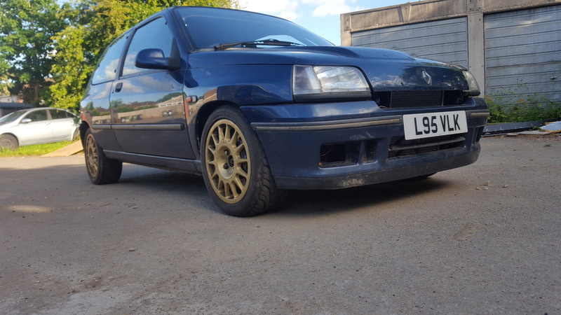

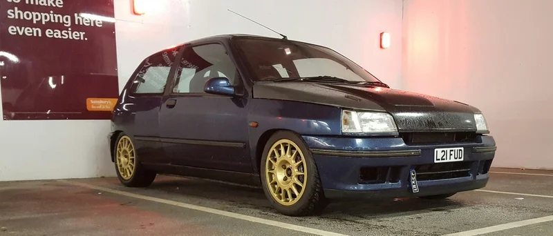

Im making this thread just to keep a progress log for myself really! This is my current valver track car -
Engine is high comp 1.8 but with standard rods and mild cams and emerald ecu (the engine is a proper half assed job!) 160-170bhp
Bucket seats/omp wheel
172 wide track and steering rack with wilwoods

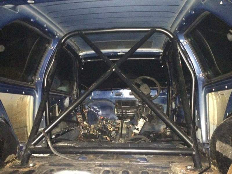

Over the winter i planned on having a cage put in it and repairing the rusty bulkhead, however this Williams become available, it used to be a road rally car and has been off the road since 2001 and dry stored, the shell has absolutely no rust on it, although it does have various damage around it, It has the engine and box and apparently it runs but the fuel pump is missing (along with a lot of other things!)

Has the wrong bumper on it but i have a couple

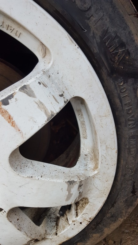

Genuine speeling Group A wheels

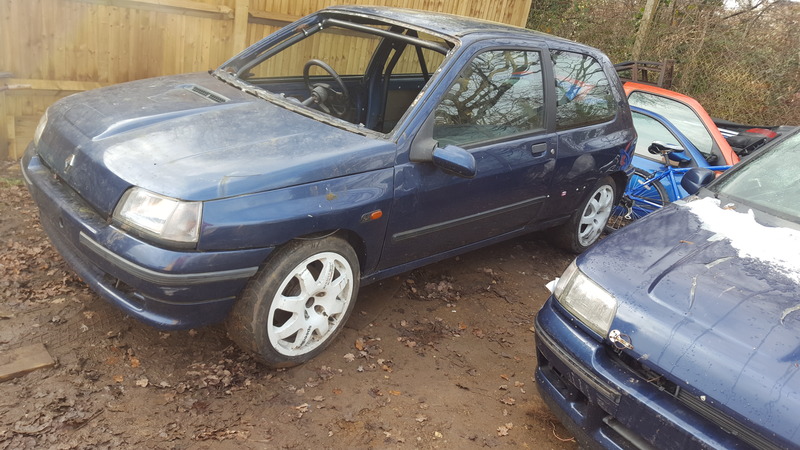

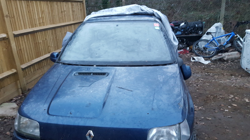

This is how i got it
First job is to clean these mounting points and paint them and then get a windscreen fitted!

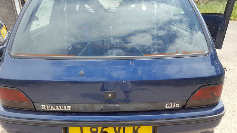

No boot seal
Fitted

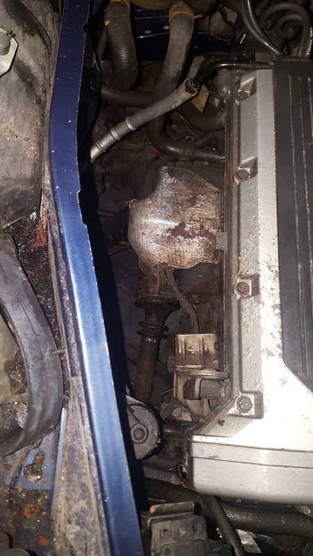

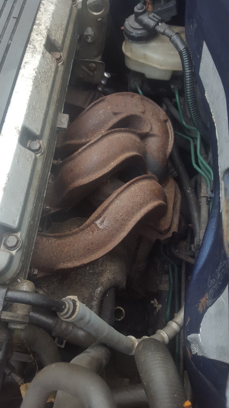

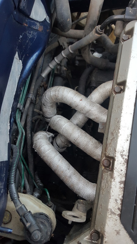

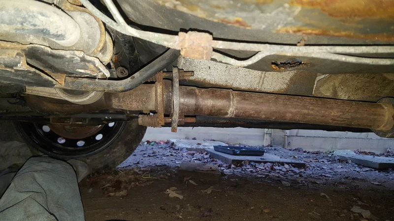

Today i had displeasure of removing this manifold, anyone who has ever removed a 1.8 16v manifold will now how crap this is, the bottom 3 bolts you can get 1 click on the ratchet each turn, the person who fitted this to the williams is an absolute donut.
Assistant

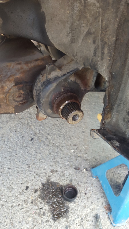

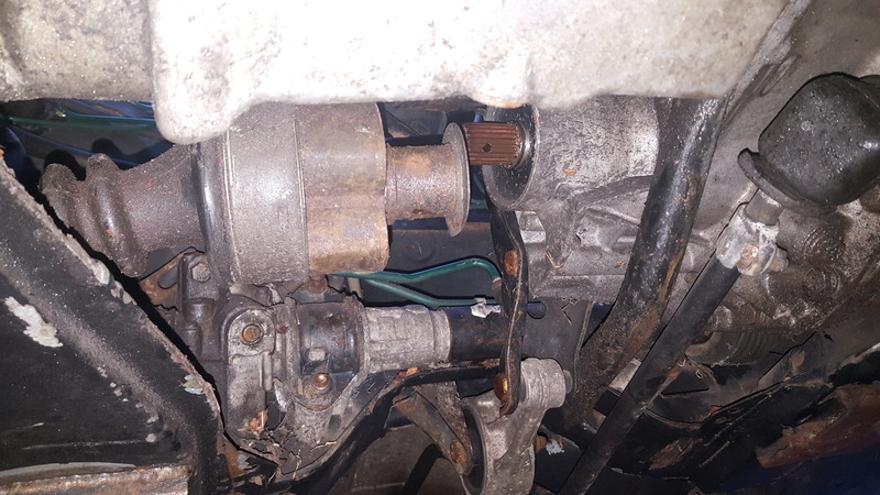

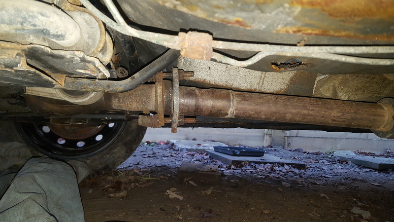

Had to remove the drive shaft to get the down pipe out (looks like a genuine renault sport dog bone on there to)
Success

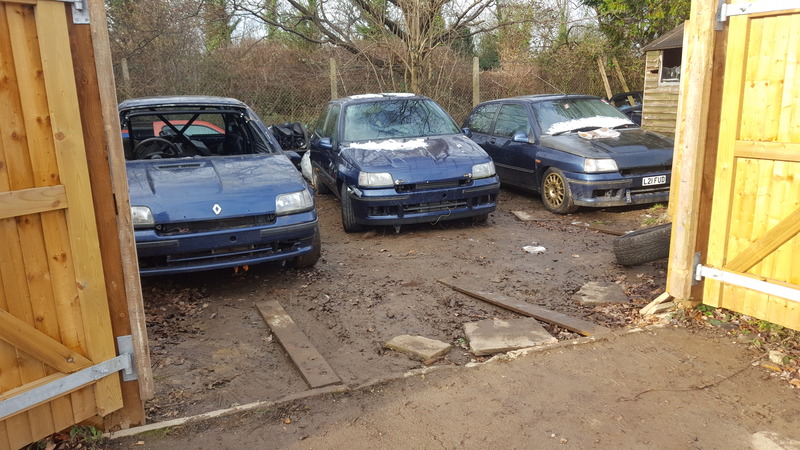

No rust on the williams (it is battered though) my valver in the back ground only has rust on the bulkhead and the 3rd one i have has no rust and is in great condition, its for sale but is engineless, i think that car may end being another long term project!
My plan for the wiliams is to get it running, get my other cars interior in it (seats dash etc) then give it to my friend in Littlehampton on my week off to help (Do) the brakes and 172 track bits, mot it then use it! ive been speaking to a guy about painting but thats a long way off

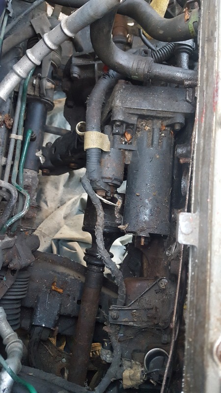

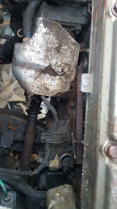

Today the first thing i done was remove this stupid starter motor bracket, its not needed and is in the way and heavy, makes it a massive pain to change the starter motor if it ever needs to be done, also removed the heatshield as only one mounting point left on it and that is the one on the bracket! (ill use a 172 starter heat shield)
And off
Manifold fitted, its a spare supersprint i had from another car
I also fitted the down pipe but it is slightly different to the one that is fitted to my valver which ment i couldnt do a good job of mounting my exhaust, although i did get the exhaust fitted

Im breaking it, using all the best bits on the williams, i still have the itb'd one which is also being broken but will keep it as a rolling shell as its solid and in very good condition, the parts are coming from my shed/other cars etc!

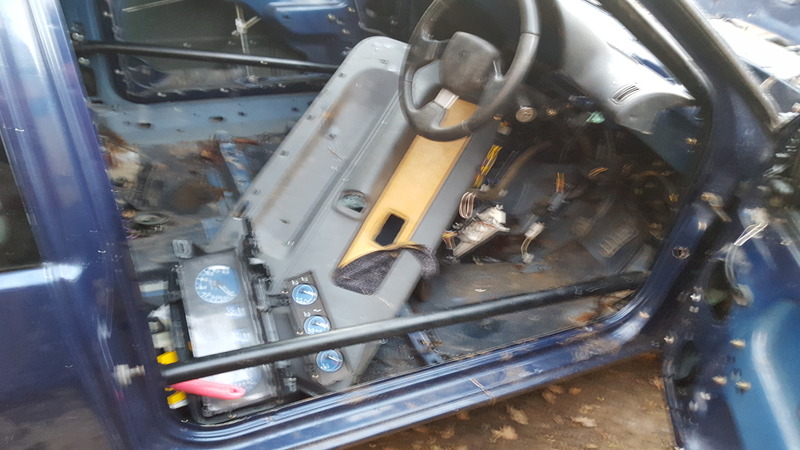

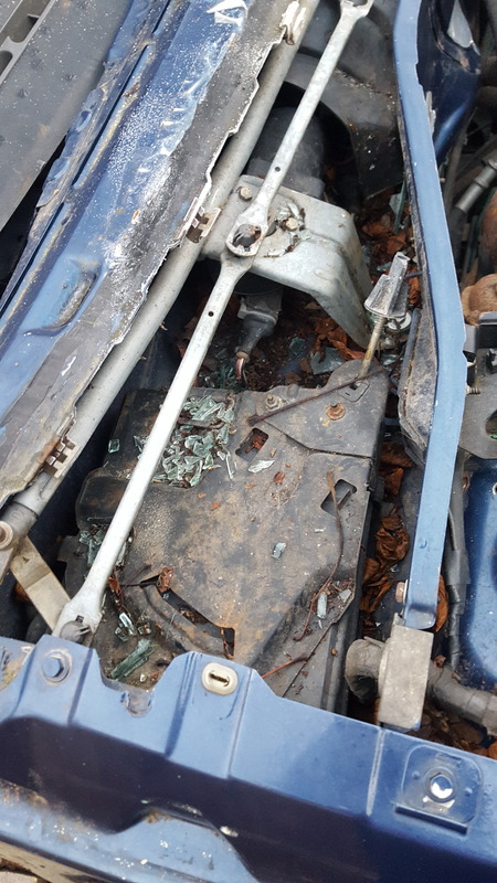

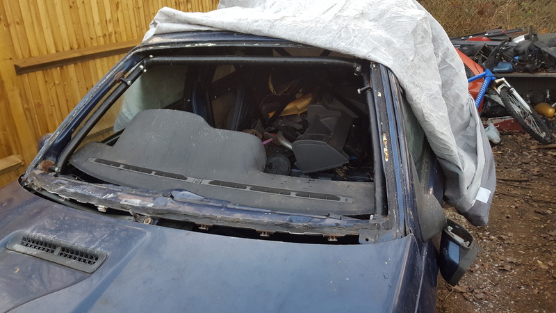

Today the windscreen was swapped over, which means i will be able to start sorting the dash out but again i want to break the other car first as i want the space

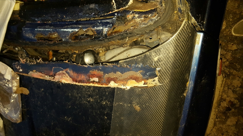

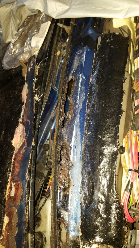

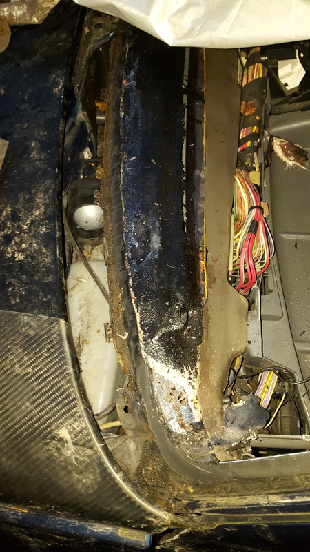

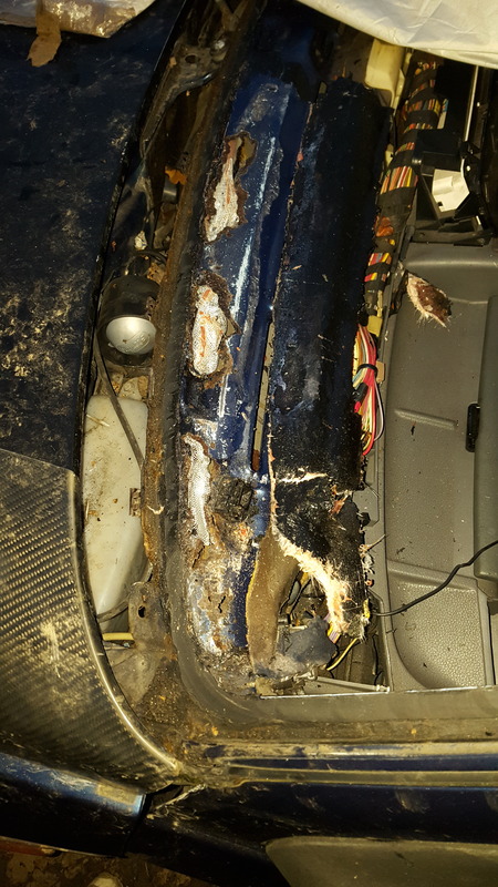

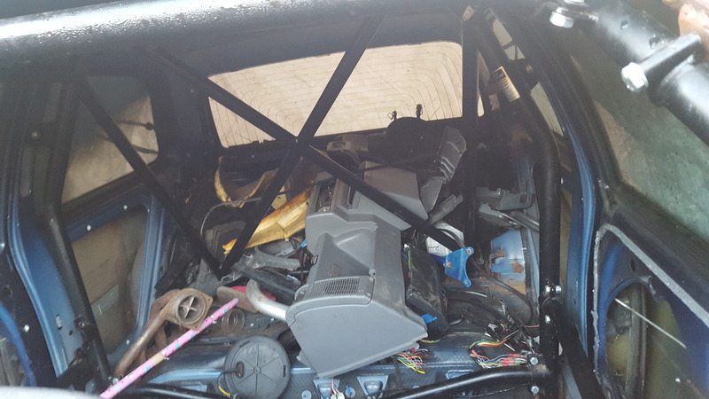

With the screen swapped it ment i could get a better look at the fibreglass that is/was under the dash top L21 FUD
With a little tap the whole top fibreglass piece came off revealing some wire mesh
I took the wool out and then tapped the bottom and the whole bottom fibreglass piece fell off
Outstanding job by a previous owner

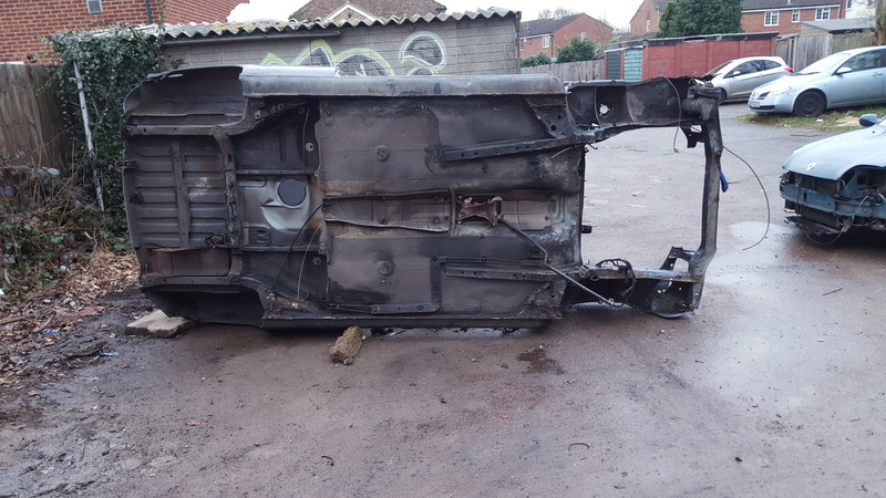

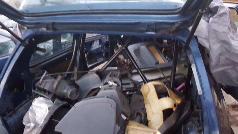

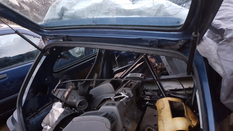

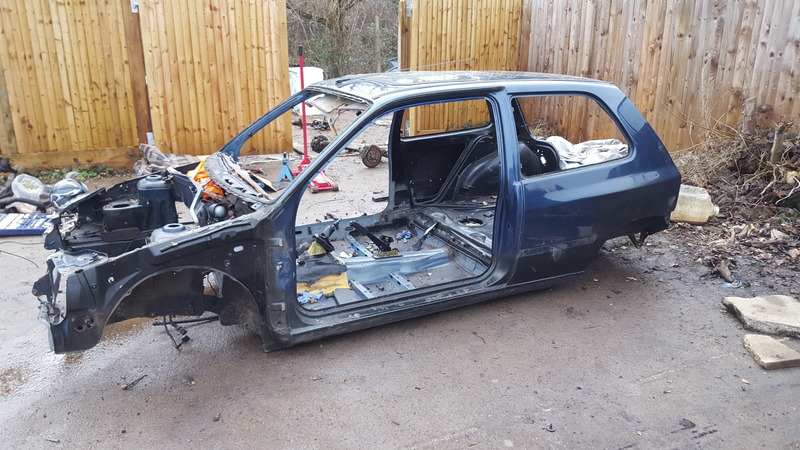

This weekend i hope to rip in to that car and get it completely stripped
that's horrific
Blimey!!!
Looks like you're going to need all the spare cars you've got, to repair the botch ups.

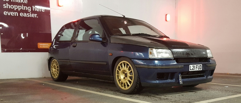

Slow progress over the last week or so (rain every single day) i had been nibbling at L21 FUD taking a few bits off here and there over the last week and today i moved it outside the yard and gutted it, it will be going for scrap tomorrow or tuesday
Struggled with a couple of the fuel tank bolts so tipped it up

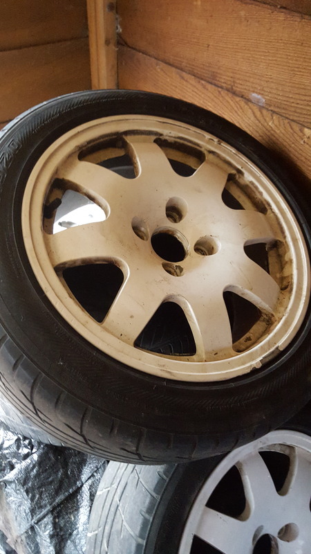

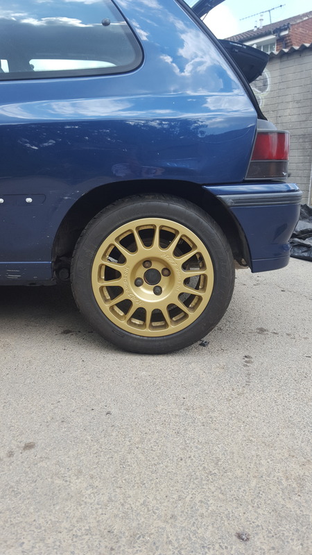

And a very good friend of mine from France managed to find me some Williams wheels and center caps

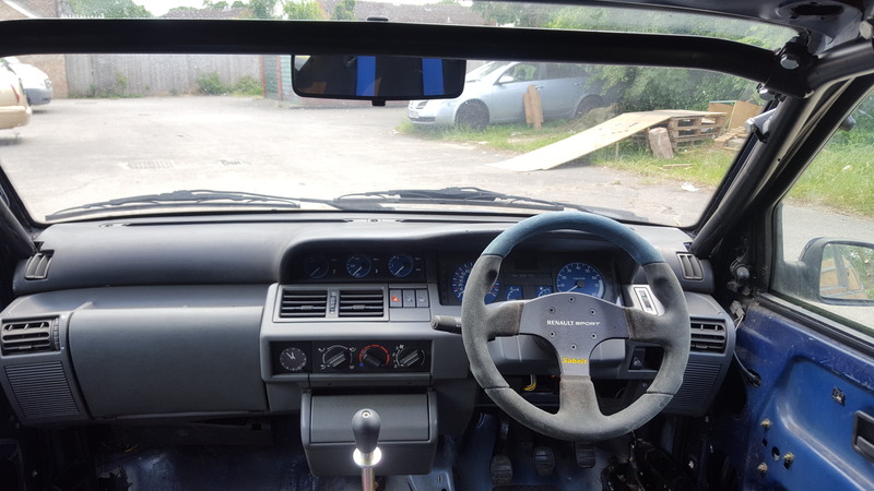

Update time, Before the car went to Gary i put a dash in it, the car went to Gary and had the following work done, i would have loved to have done this stuff myself but the cosntant rain and mud was a big problem, so Gary done -

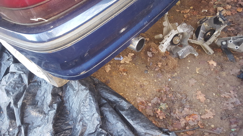

fitted front suspesion, pms top mounts, 172 cup wishbones, ph1 172 front drive shafts, 172 hubs, wilwoods, braided front and rear brake lines (and every other brake line as they all burst when bleeding)

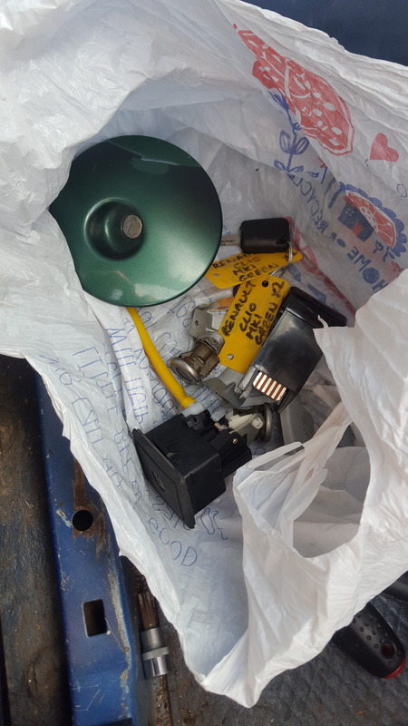

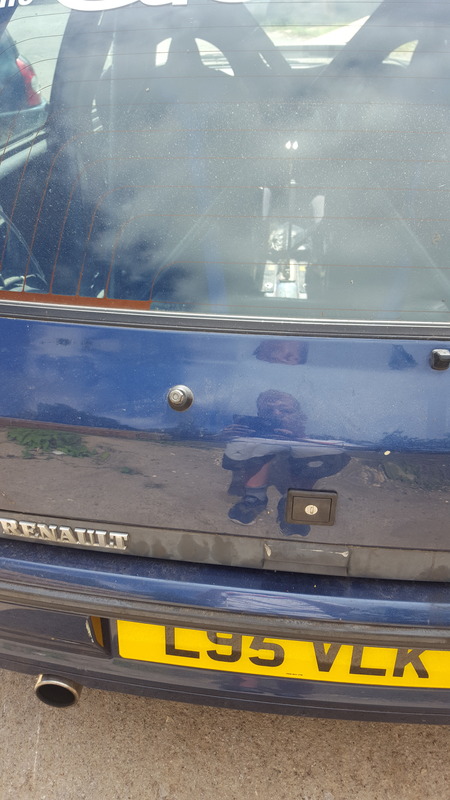

Luckily i have a complete mk1 matching lock set, With the boot lock! and 2 keys, so i swapped it all over (this will be one of very few mk1's where 1 key opens all the locks!)

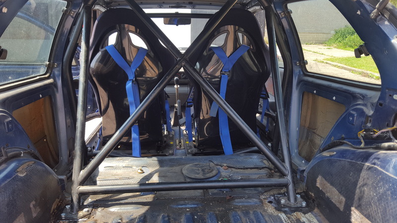

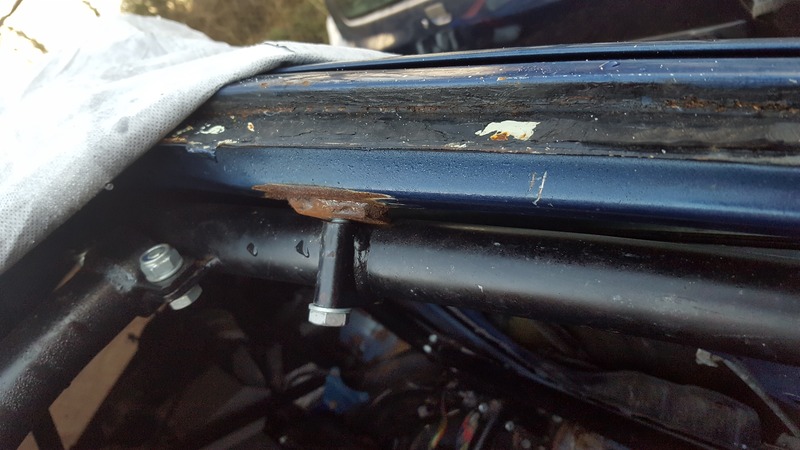

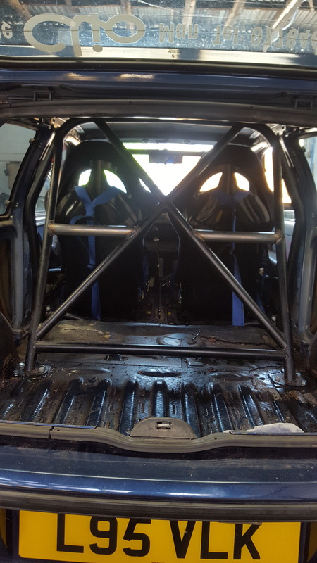

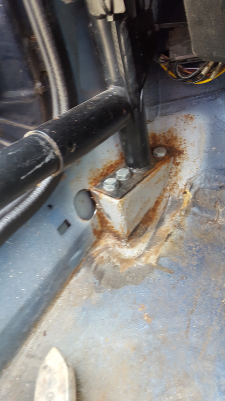

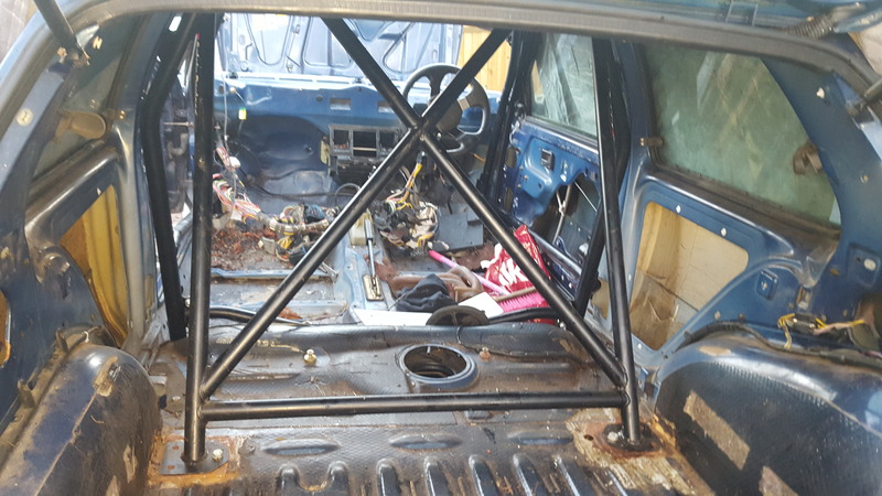

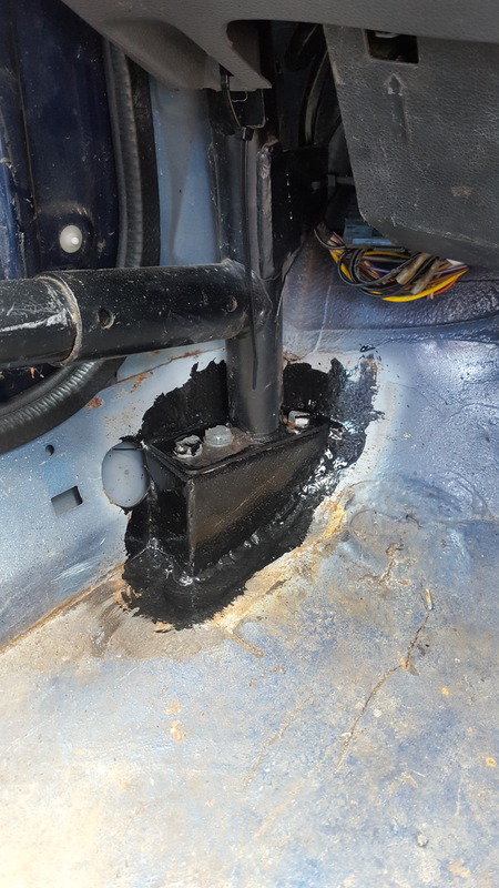

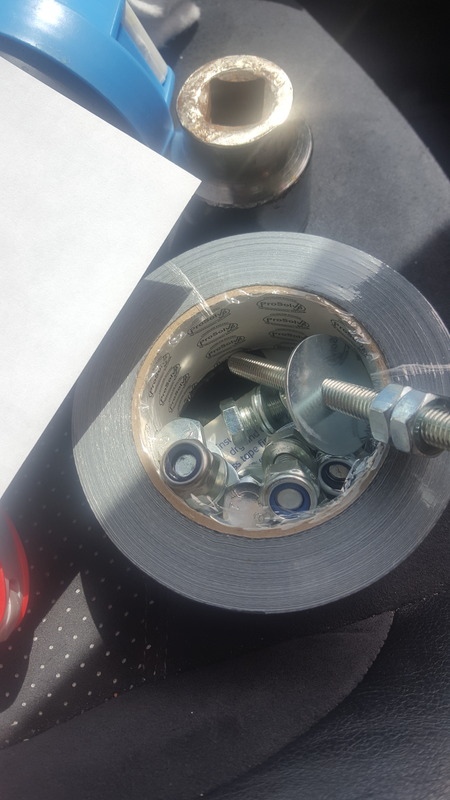

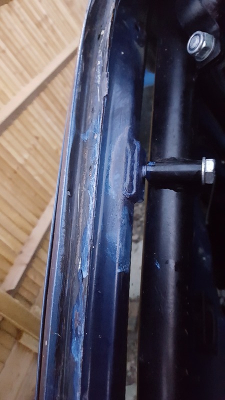

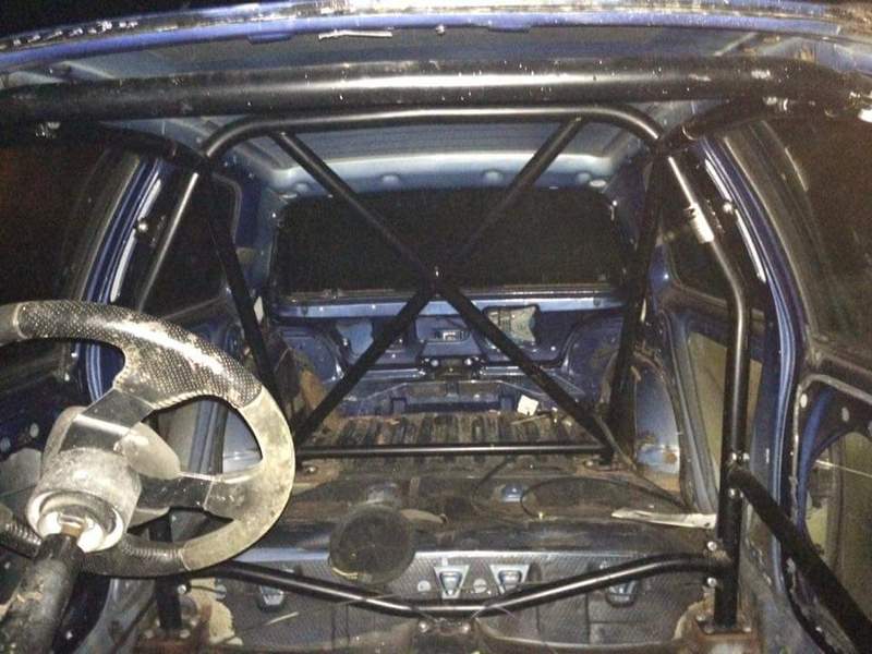

I wire brushed/cleaned/painted all of the cage mountings as they had surface rust from the welding (done it on all of them)

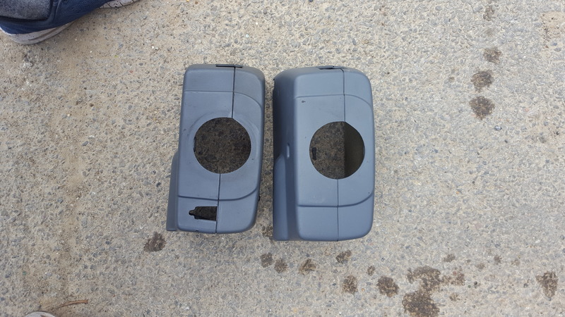

Fitted the missing steering cowling, i used one without a hole for stereo controls (came from the same car as the lock set and the dash board which had only done 34k so everything is in really good condition)
And my favorite part of the day was fitting the steering wheel
To finish off i went to a local fixings place and picked up all the bolts i need for the cage (all the rear ones were missing, like someone had started to take it out then gave up) I also picked up a some wd40 and am soaking the torsion bars as i plan to take the suspension down tomorrow and set the camber at the front

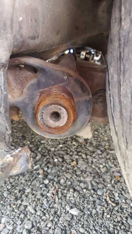

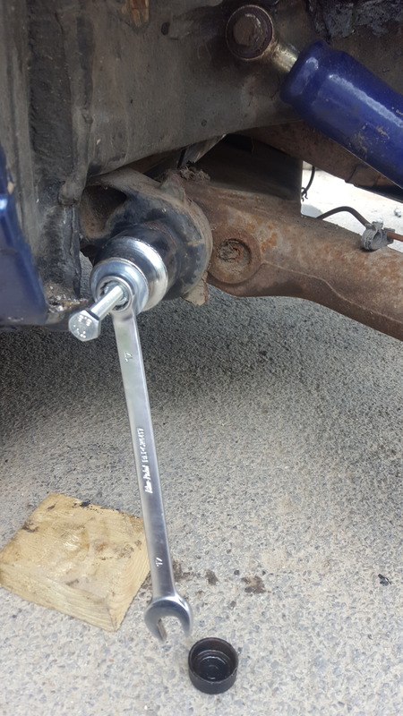

Battle was won, it took a long time though.
This is how we started
'Tool'
One side was seized and took a long time to sort out, however i won the battle
And set, with 16mm spacers on the rear, front taken down a touch and camber set

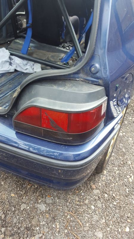

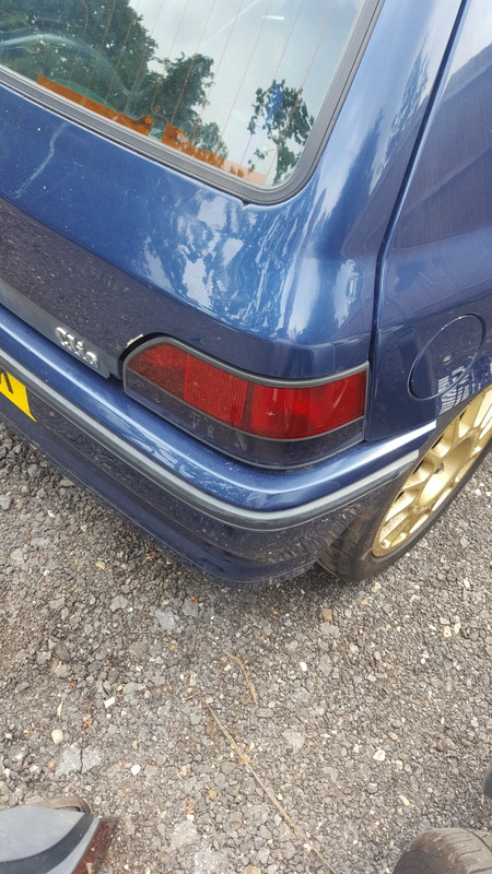

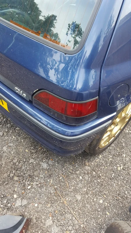

This stuff was one on Tuesday but been to busy to update, rear lights changed for better ones i had

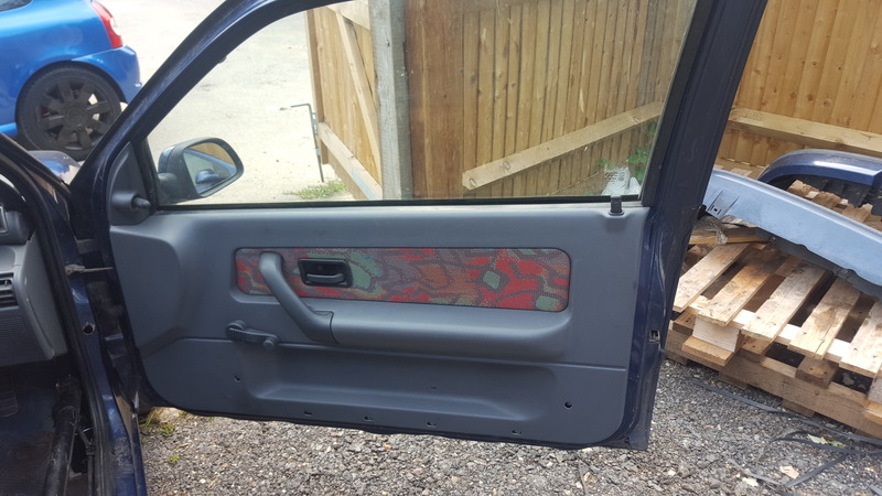

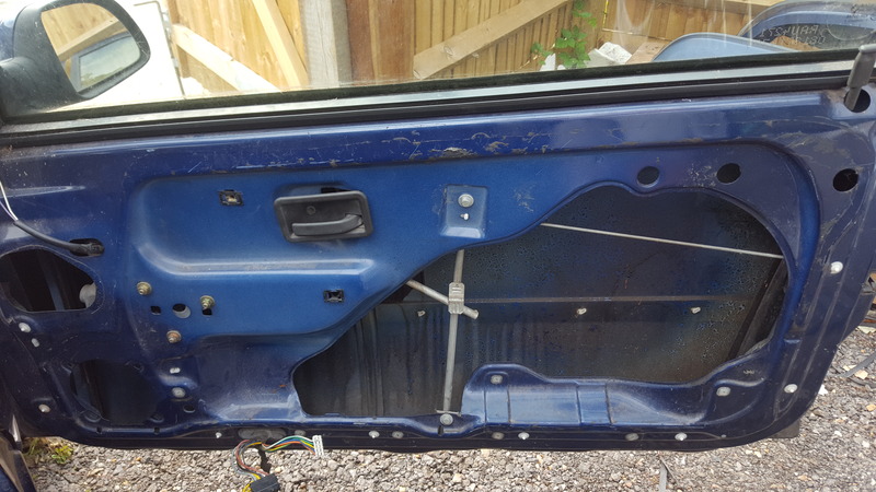

Drivers side door finished with electric window removed and manual window installed

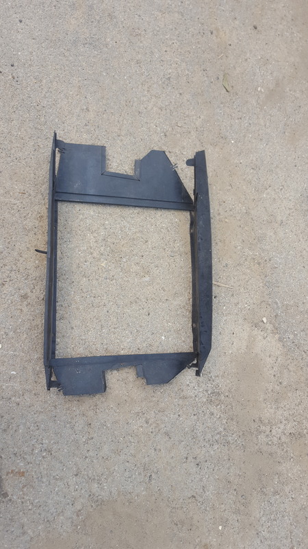

Complete un broken rad Shroud i had in the shed was dug out and fitted
